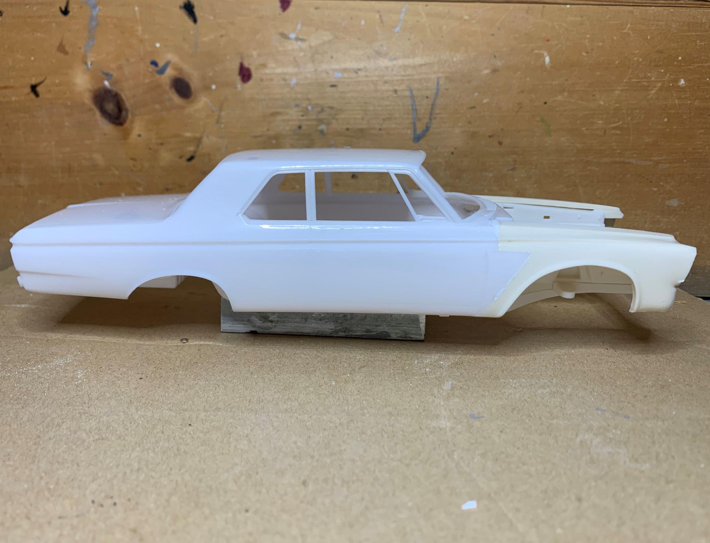

dino246gt Posted February 18, 2024 Posted February 18, 2024 I'm going to try and make the Mobius '65 Belvedere into a '63 using some JoHan parts but mostly Mobius. Here's the kits, and the side by side bodies. Â 2
dino246gt Posted February 18, 2024 Author Posted February 18, 2024 First off, the JoHan and the Mobius kits are decades apart in their engineering, so it's not a simple swap like the real car would be. But I've got the front end fitted, hopefully everything will start coming together as I'm making it up as I go. 6
dino246gt Posted February 18, 2024 Author Posted February 18, 2024 Next up was the rear of the roof, the '65 was straight across, the '63 had this distinctive curve. Had to be cut in the middle but I made it fit. 6

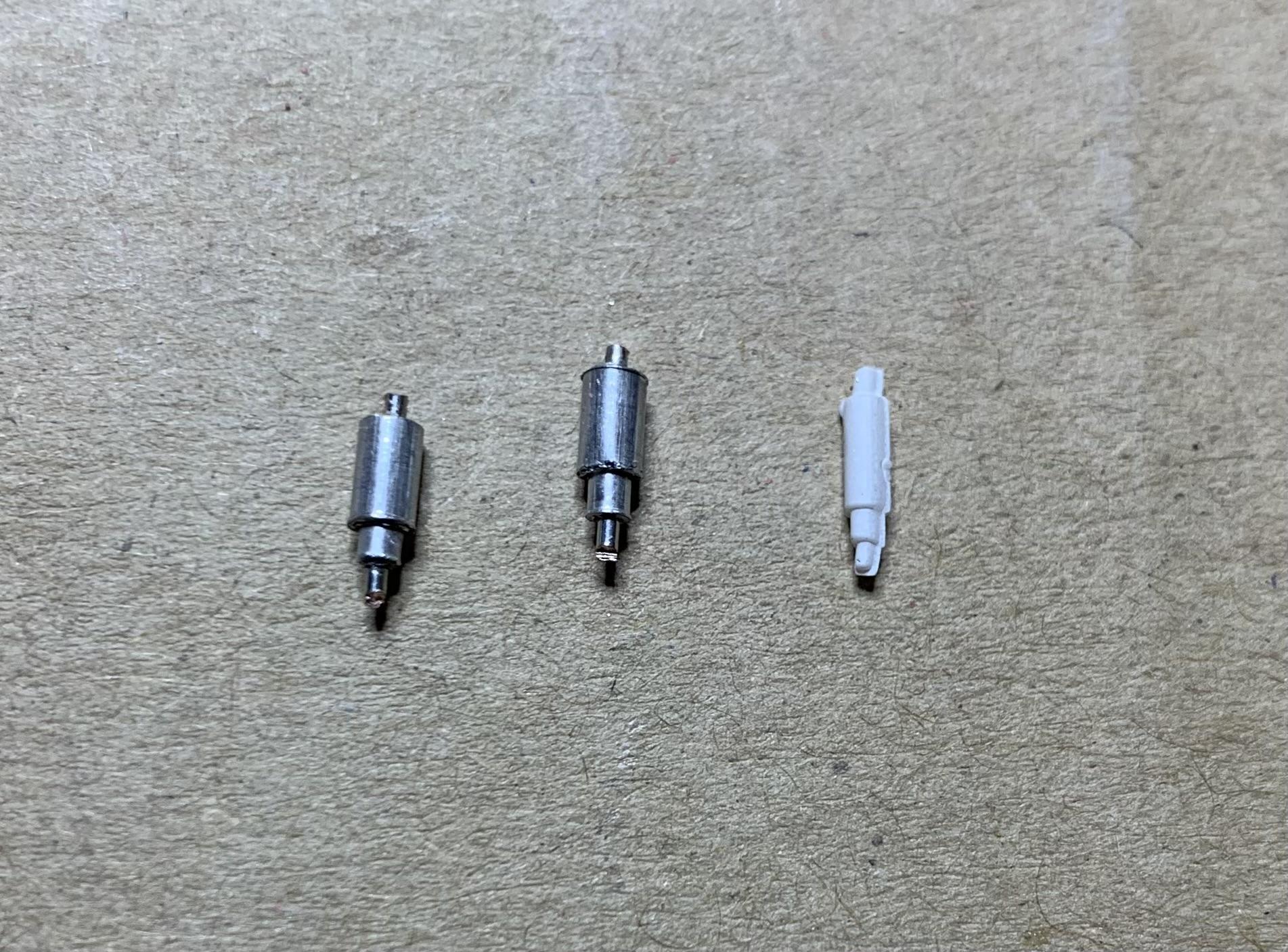

dino246gt Posted February 18, 2024 Author Posted February 18, 2024 Mobius kit front shocks, hmmmm..... It only took about 3 minutes to make aluminum copies, that seem to look much better. I'm using mostly the Mobius kit. Â 1

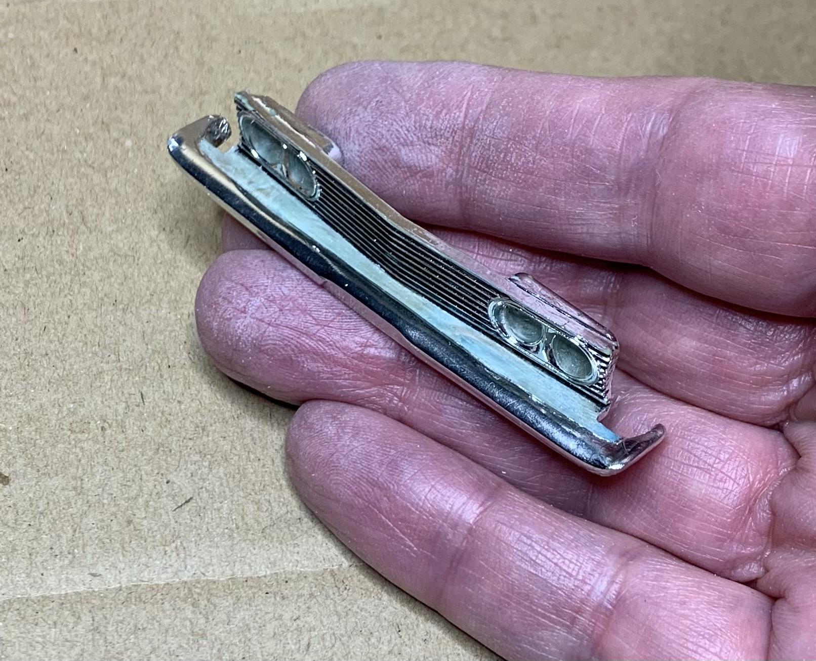

dino246gt Posted February 18, 2024 Author Posted February 18, 2024 Inner fenders got "SIMPLIFIED" I removed the molded on wires. Under the front bumper, I opened that up. I drilled out the chrome headlights and scraped some plastic away to create the separation between the bumper and grille. 4

Straightliner59 Posted February 20, 2024 Posted February 20, 2024 On 2/18/2024 at 4:19 PM, dino246gt said: Mobius kit front shocks, hmmmm..... It only took about 3 minutes to make aluminum copies, that seem to look much better. I'm using mostly the Mobius kit. Â This is very cool, Dennis! I wish I had your knack for bodywork. Now, these shocks--this illustrates the biggest reason I scratchbuild so much stuff. It's often easier than cleaning up molded kit pieces, it's a helluva lot more interesting and fun than cleaning up those mold lines, and, they always look way better than the kit parts! Beautiful work, sir, as always! 1
