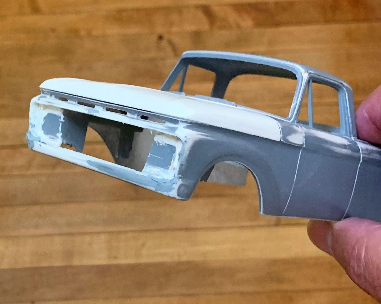

dino246gt Posted March 13, 2024 Posted March 13, 2024 I got this old junker for free and tore it apart. My only disappointments are NO glass and it has the custom front and rear permanently glued on, with a LOT of glue! I won't be using much of it but I wish I could've had the stock front and rear even though I have "plans" for it. 2

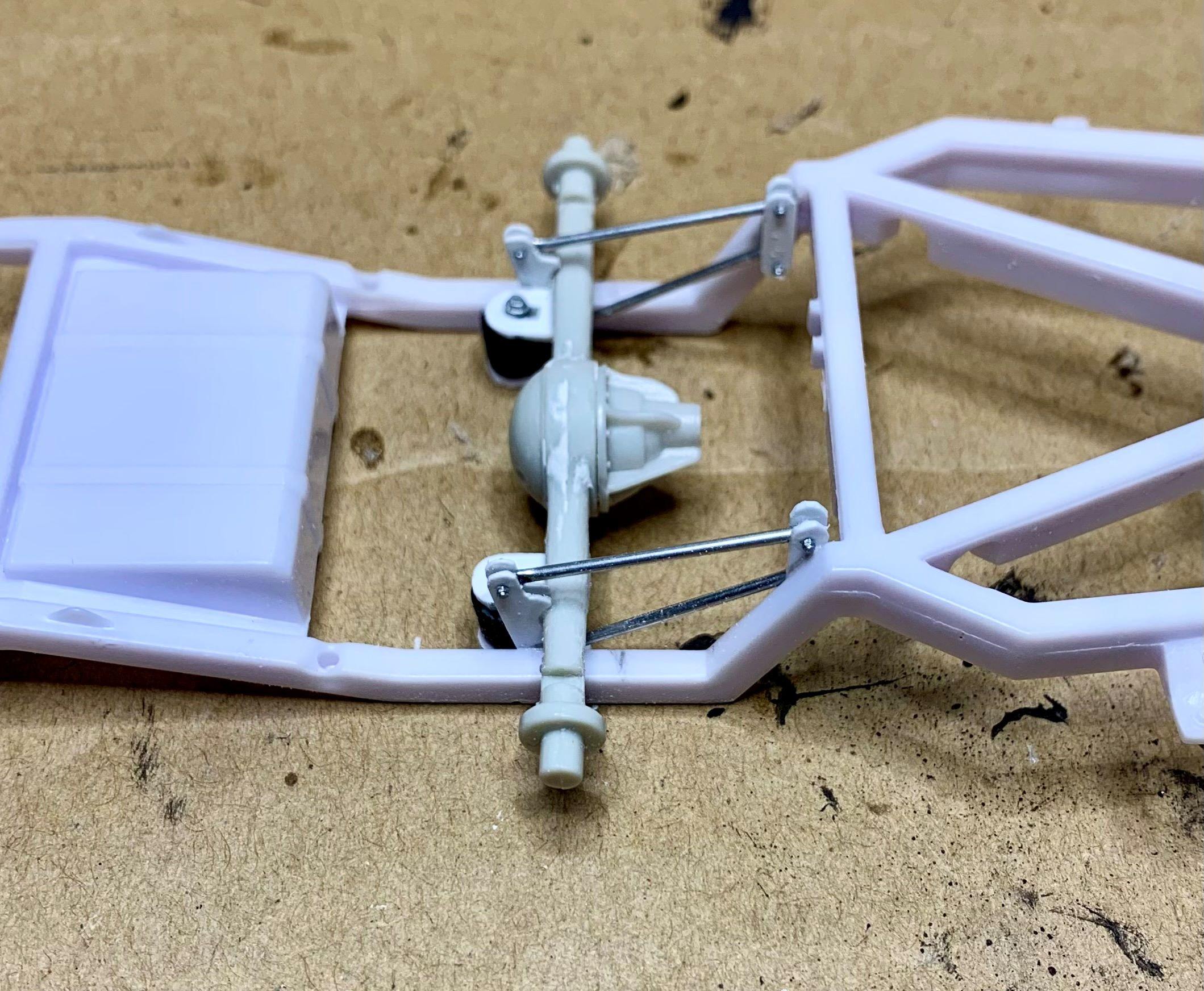

dino246gt Posted March 13, 2024 Author Posted March 13, 2024 (edited) I chose the Foose Caddy frame, so now I'll have to highly modify it to fit the pickup. First I made air bags from thick sprue. Then I fitted them to a parts box rear end that was the proper width. I scratched up some 4 links and, well it's a start! Edited March 13, 2024 by dino246gt 8
dino246gt Posted March 13, 2024 Author Posted March 13, 2024 I fought with the custom front and rear bodywork but ended up putting it away quite some time ago. I did open up the slots under the hood. But now that the kit is re-issued, I brought it back to the "shop" 3

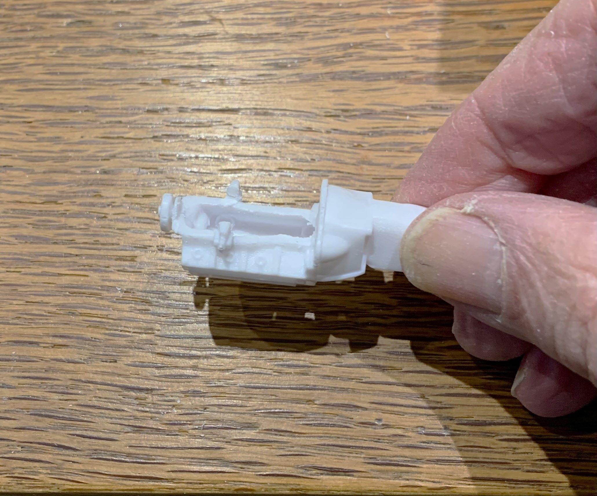

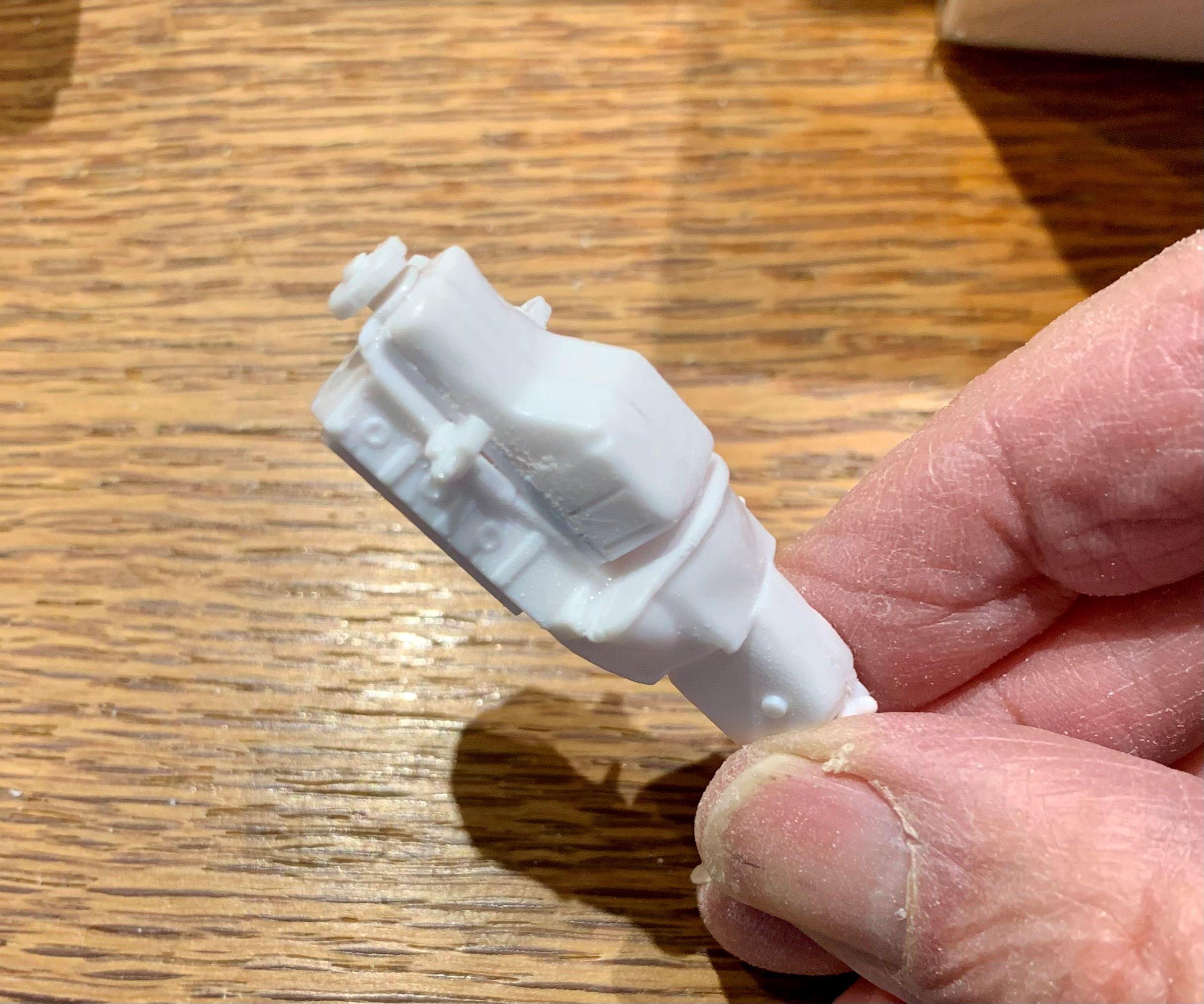

dino246gt Posted March 13, 2024 Author Posted March 13, 2024 Using parts box stuff I found a cool boss 302! But why did I choose an engine with a seam down the oil pan?? Oh well, I cut it off because the front sump wont clear the dropped suspension. And I had to add styrene scraps to build back material removed by cutting. So now that I have the rear sump and oil pan reversed, I can see if those motor mounts work. 4
dino246gt Posted March 13, 2024 Author Posted March 13, 2024 Here's the frame set up for a Chevy, so those motor mounts or transmission mount won't work. I cut off those motor mounts and moved them up front to line up with the 302, and I made a transmission crossmember for the 4 speed. 5

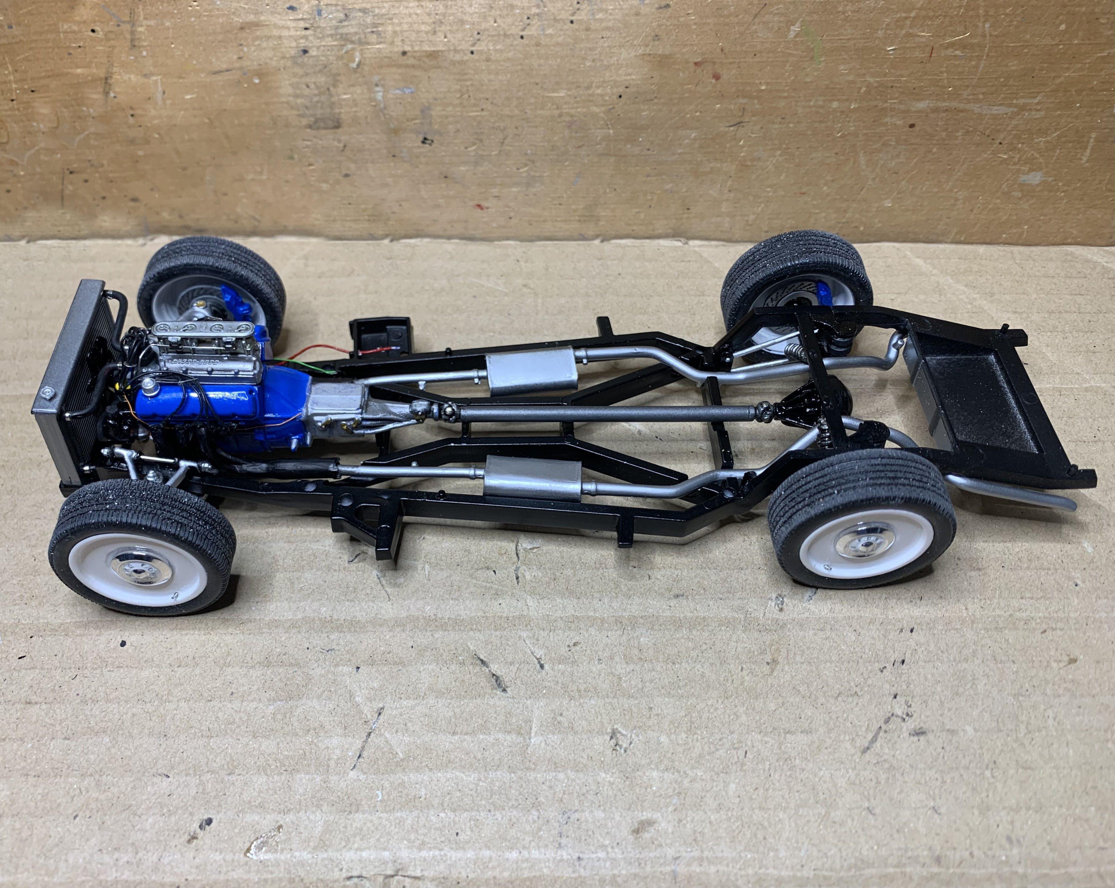

dino246gt Posted March 19, 2024 Author Posted March 19, 2024 I made these "things" to dress up the upper A-arms as they show under the hood. I scratch built a big aluminum rad to keep things cool. So here's where I'm at with this build: Cheers! 3

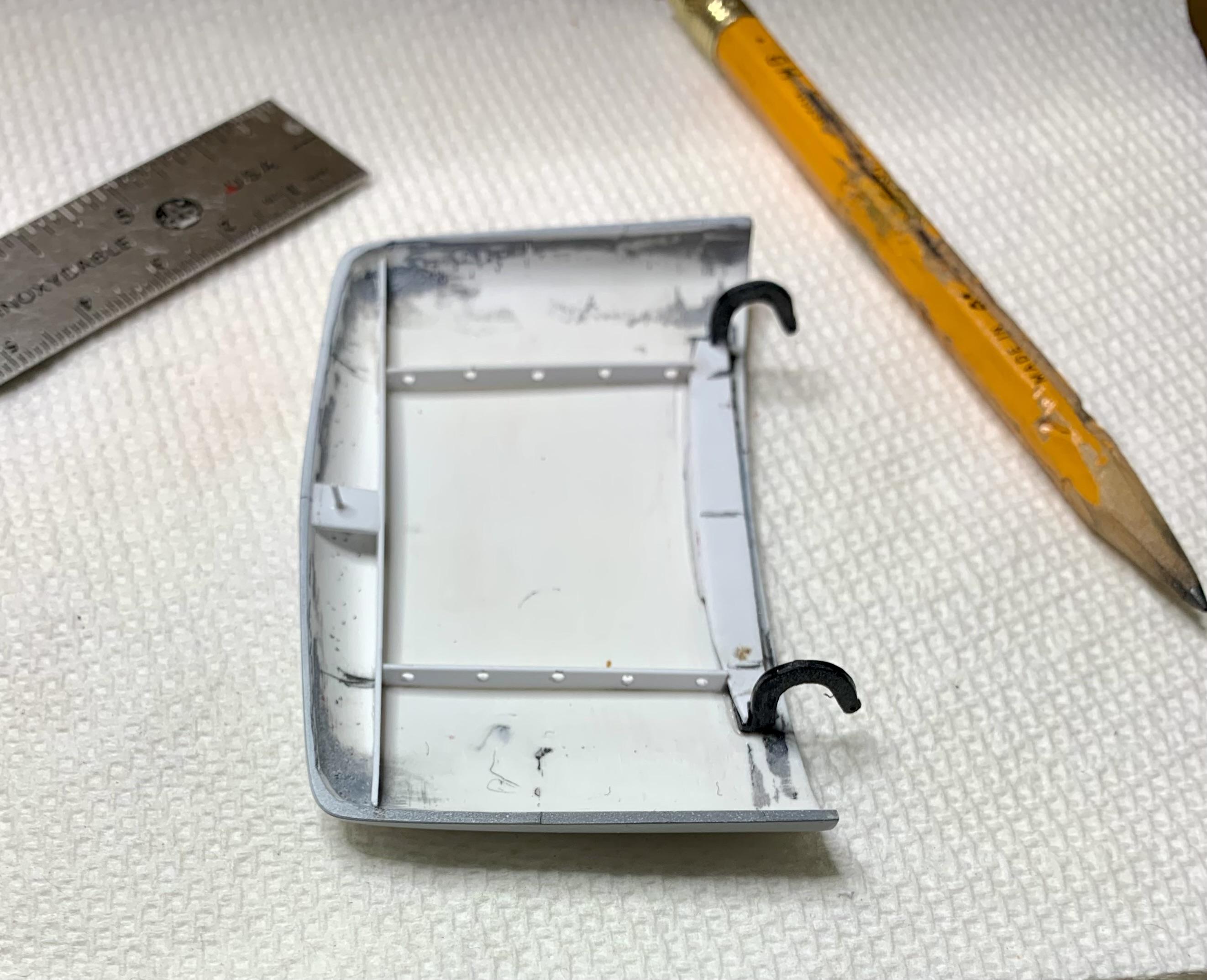

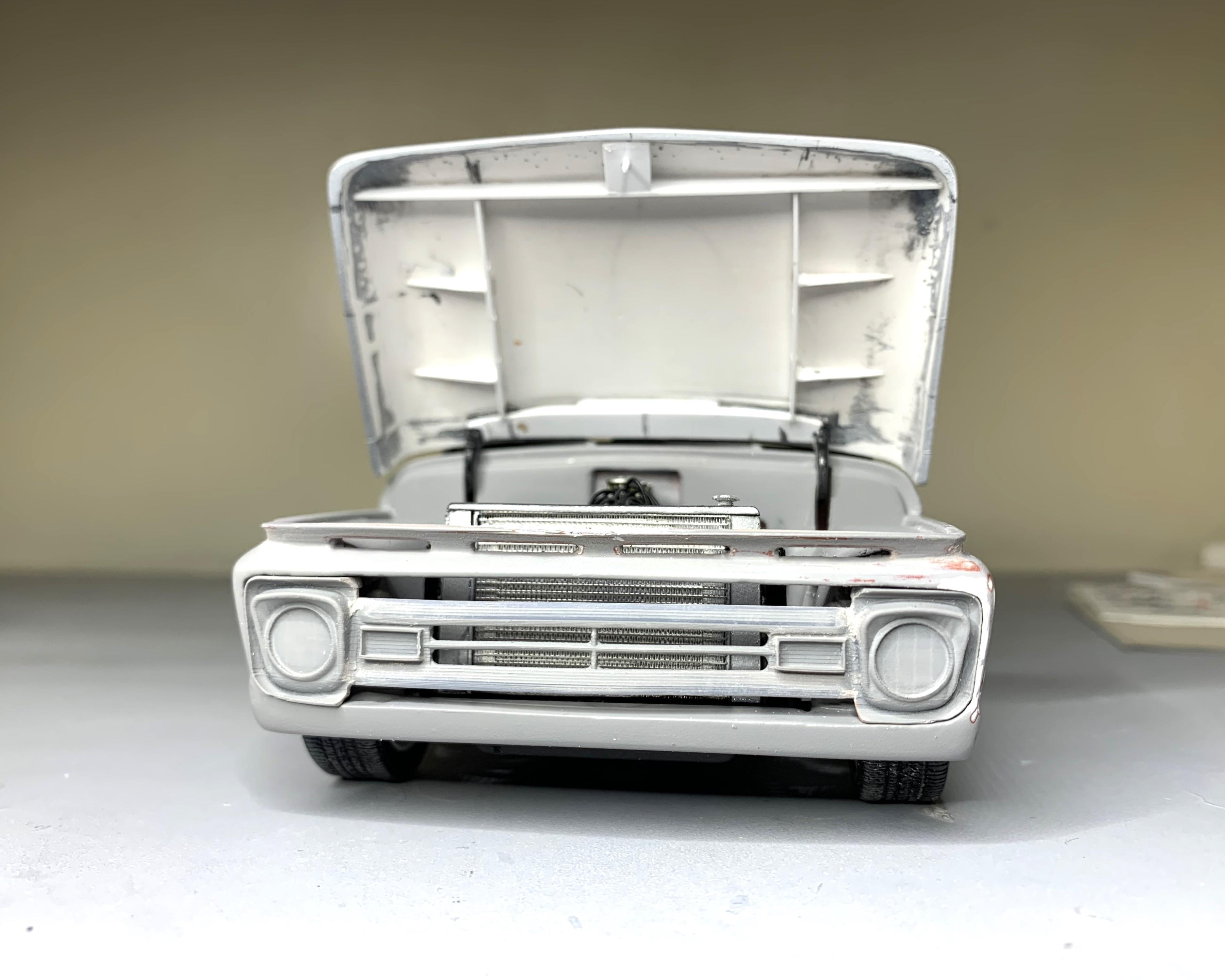

dino246gt Posted March 21, 2024 Author Posted March 21, 2024 I modified a firewall from the scrap heap and fitted it. I made a hinge and some under hood structure. Test fit, should be good enough. Grille is 3D printed '62 with the top and bottom center sections removed. Still working on that. 6
dino246gt Posted March 21, 2024 Author Posted March 21, 2024 From the underside the firewall didn't meet the outer body panels. So I made up little pieces to fill that out. Fun stuff, probably not important but I like doing little things like this. 2

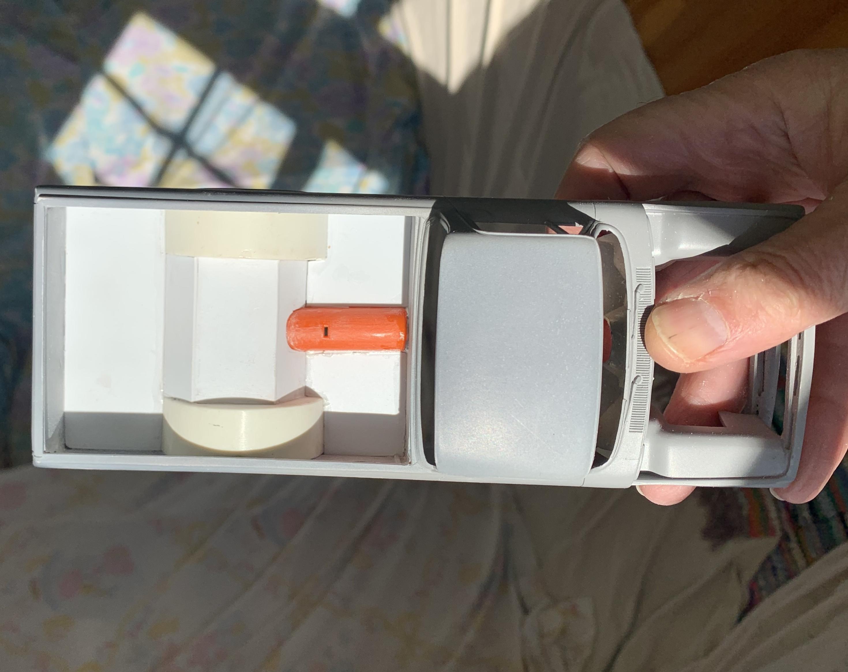

dino246gt Posted March 24, 2024 Author Posted March 24, 2024 (edited) I cut a tunnel and some tubs from junkpile pieces, like this floor. Then I fitted styrene sheet to create a bed floor with clearance for the bags to drop it down. Getting my fingers in to putty and sand was a bit of a problem, but I persisted and got it good enough. Edited March 24, 2024 by dino246gt 1
