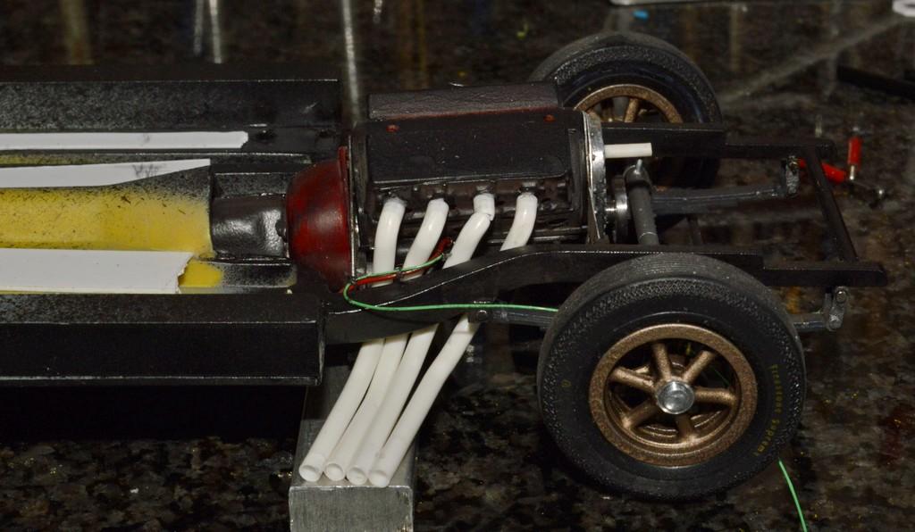

Straightliner59 Posted September 3, 2024 Author Posted September 3, 2024 Thanks, David and Scott. I'll try to keep this thing moving along! I made header flanges, today. I used aluminum flashing that I had measured and folded over, then marked for drilling. Doubling the sheet, I got two for the price of one! I used files, sanding boards, and these Xuron photo-etch cutters to trim close work. I have really found them to be useful, for so many other tasks, involving thin sheet metal. I'll drill them for bolts, so I'm not just cementing them to the flat surface. I also need to remove the broken pipe, and replace it--hoping I can get it out, alone. That will make everything easier, to get it aligned with the existing pipes. I'm hoping to have the exhaust system finished in the next few days. Thanks for looking!

David G. Posted September 4, 2024 Posted September 4, 2024 Wow, those are impressive Daniel! They're as good as any PE set would have given you. In that top-down shot can see how tight those headers are. It must have been quite the challenge to fit and fabricate. Doing both at the same time ? So tell me, do you have a startup day scheduled yet? David G.
Straightliner59 Posted September 5, 2024 Author Posted September 5, 2024 19 hours ago, David G. said: Wow, those are impressive Daniel! They're as good as any PE set would have given you. In that top-down shot can see how tight those headers are. It must have been quite the challenge to fit and fabricate. Doing both at the same time ? So tell me, do you have a startup day scheduled yet? David G. Thank you, David! They did work out, pretty nicely. Getting those bent and fitted was a matter of install, study alignment, remove, bend, install...I must have done it a hundred times! Startup can't happen until I build the injection setup!?

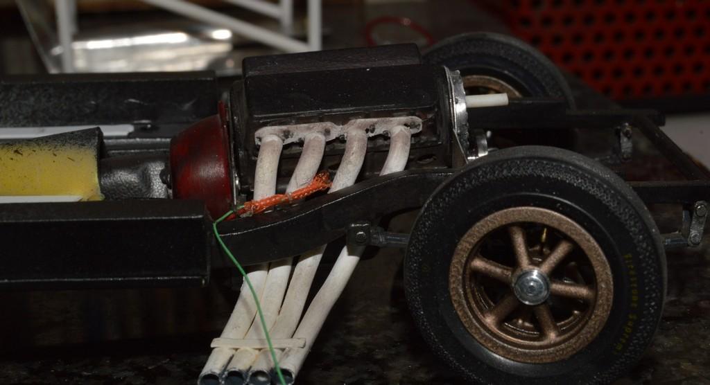

Straightliner59 Posted September 7, 2024 Author Posted September 7, 2024 I finally got the right-side headers where I like them, and did a little weathering, to them. When I went to touch up the white, I discovered that I don't have any flat white. I ended up using some Humbrol gloss. I'm waiting on the flat coat to dry, then I will go over those spots with the pastels, again. About then, I realized that I hadn't left enough slack in the wiring to get it safely away from the header pipe, so, I snipped the wires, and slid a sheath of braided, weighted fishing line to represent heat resistant shielding. I couldn't find anything else that would fit, and look halfway right. It looks better, since I flowed some Vallejo dark grey wash into it, but I'm still not crazy about it. I'm really looking forward to starting the other side...unless I'm not! I am really happy with their positioning, though. Thanks for looking!

David G. Posted September 8, 2024 Posted September 8, 2024 14 hours ago, Straightliner59 said: About then, I realized that I hadn't left enough slack in the wiring to get it safely away from the header pipe, so, I snipped the wires, and slid a sheath of braided, weighted fishing line to represent heat resistant shielding. I couldn't find anything else that would fit, and look halfway right. It looks better, since I flowed some Vallejo dark grey wash into it, but I'm still not crazy about it. I'm really looking forward to starting the other side...unless I'm not! I am really happy with their positioning, though. And that's what model building is all about! It's like I say in my signature line: "Model builders, we're problem solvers who create our own problems to solve!" The headers look great Daniel! Just the right amount of weathering. David G. 1

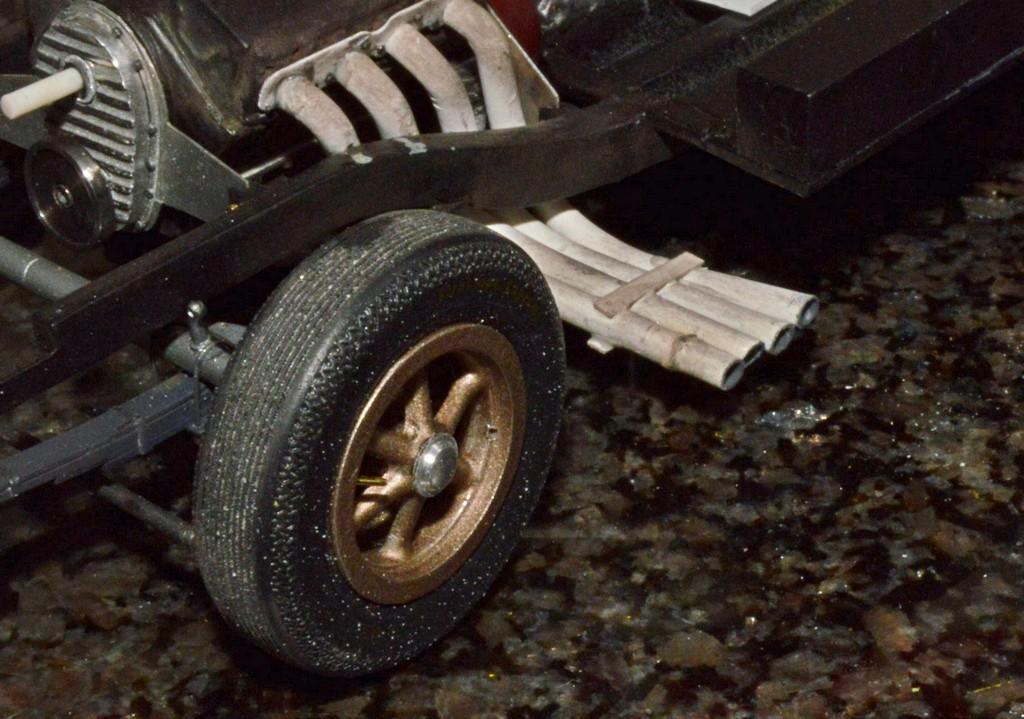

Straightliner59 Posted September 13, 2024 Author Posted September 13, 2024 I finally got the left side headers done! Yay! I'm not sure how I did it, but, somehow, when I got to the last pipe's installation, it was much too short! Hmm, and harumph! So, I made up a story about what weekend warriors might do, if one of their pipes got mashed, or bent. Instead of cutting it cleanly and welding a new end section on, I cemented on a new end, and used some old Floquil model RR lacquer to create a weld bead, by creating tiny dabs with the fast-drying paint (even better if you use some of the thicker stuff, on the bottom). My late friend Dave Abell used the technique to hard face a blade and a ripper for an AMT bulldozer (it was gorgeous, and was in the late running for Best Of Show at GSL, in 1990). I've been dabbling with it, here and there, ever since I saw his effort. I haven't come close to the delicacy of his work, but, I think I'll go with this. I'm not sure where I'll go, next, but it may involve the fuel tank, as I have something I want to try, with that, which while not unique, is not common, either. Questions and comments are always welcomed. Thanks for looking! 1
David G. Posted September 13, 2024 Posted September 13, 2024 That works! Nicely done Daniel! David G. 1

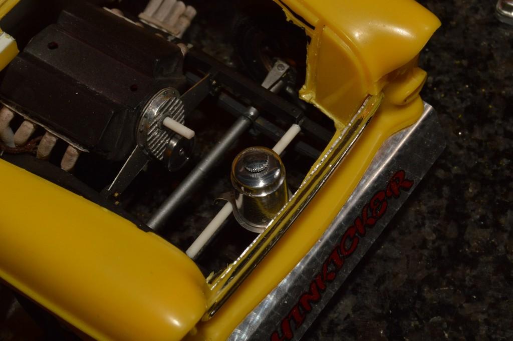

Straightliner59 Posted September 16, 2024 Author Posted September 16, 2024 I glued the floor to the chassis, and the *firewall, as well (*although not yet, in these photos). I turned a bullet-shaped fuel tank from a piece of an old wind chime. As you can see, I plan to mount it, vertically. I added a crossmember behind the first one. That will mount one of Detail Master's Moon tank brackets to carry the tank. I'll be working out the upper mount and its support, next. It will need to appear to be able to open, in order to release the tank, in the real world. I hope to incorporate a bracket for a similar, yet smaller tank for the overflow, into the support/bracketry for the fuel tank. I rummaged through a box of watch parts, and found a stem winder that looks just right, on top of the tank! I also need to drill the tank for the vent, and a pair of return lines. I really like this tank, and its positioning! Thanks for looking! 3

Straightliner59 Posted September 19, 2024 Author Posted September 19, 2024 I had hoped to post these, this morning, but, by the time I finished wrestling these into place, I had to get to bed. I took these with my phone, before work. I have 1/32" brass tube (treated with blackener) that will slip over the wire posts, during final assembly. I still have three holes to drill in the tank, for return lines and the vent. I'm kinda liking it! Thanks for looking! 2
