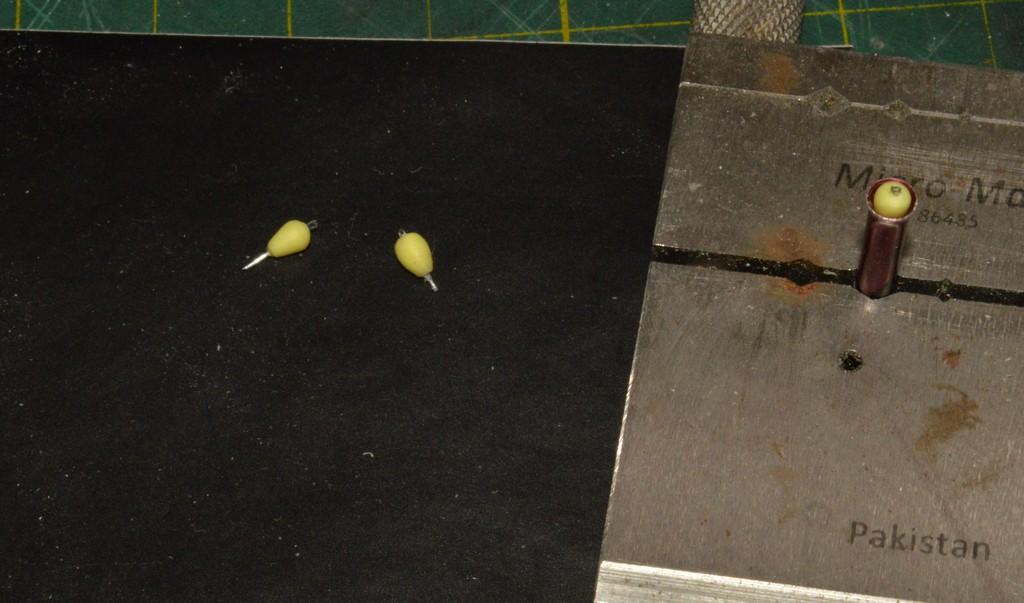

Straightliner59 Posted December 27, 2024 Author Posted December 27, 2024 I stopped at a different Walmart, today, to get some more yellow-headed pins. This one had boxes of nothing but yellow pins! I should be set, now.🙂 1

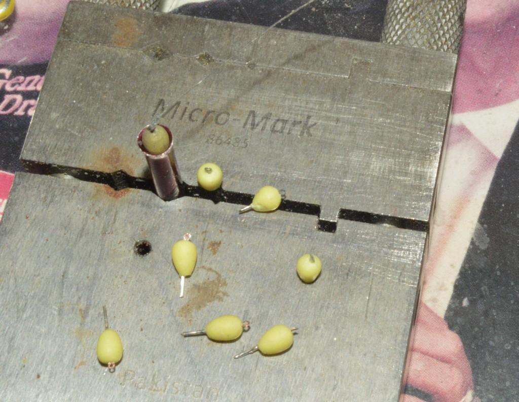

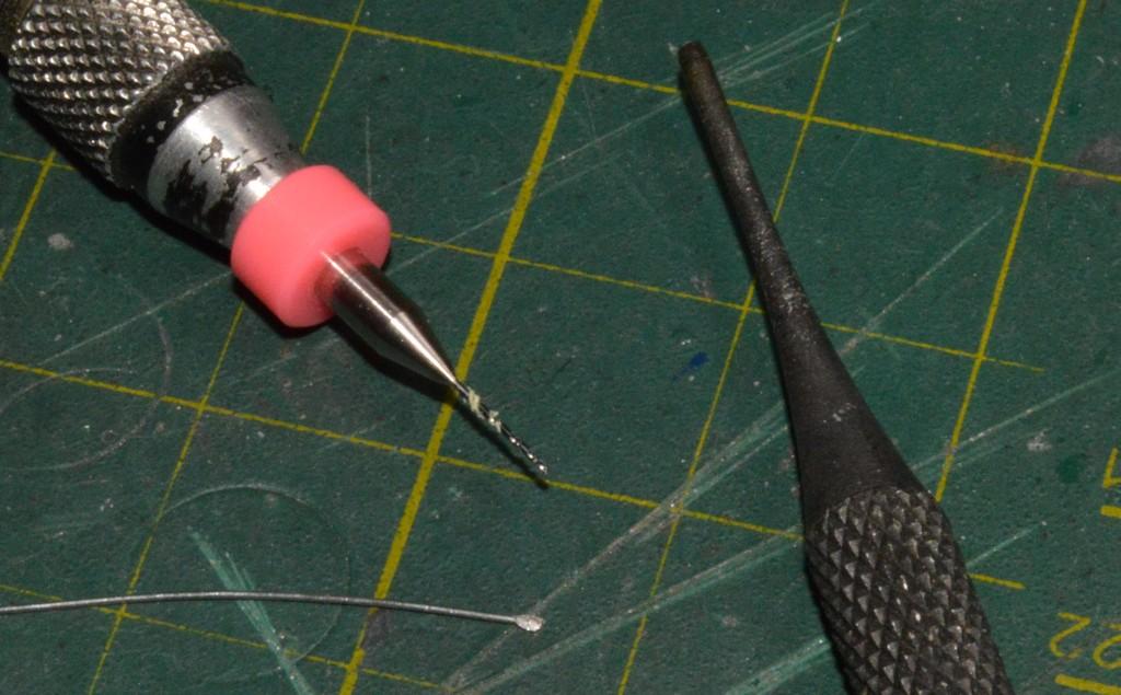

Straightliner59 Posted December 28, 2024 Author Posted December 28, 2024 Okay, so, once the pinheads are turned down to size, I need a way to tether them together. I am using some nichrome wire that's .018", to make tiny eyebolts. I place a length of wire on the anvil, and place the end of a 1/16" pin punch on the end of the wire. A light rap with the ballpeen hammer flattens the end, and flares it. Next I drill through the flat, before using 240/320 grit sanding sticks to shape the eye. All that's left, now, is to push it through the head (which, of course is drilled through--no need to complicate things!🙂), then, hit it with a dab of superglue gel. Done! I am leaning toward some ultra-fine wire from an old armature. I think I have some that's about .003"-.005", somewhere. I hope I can get it to take paint. Some of that stuff doesn't like to! Thanks for looking! 1

Straightliner59 Posted December 28, 2024 Author Posted December 28, 2024 4 hours ago, David G. said: Okay... what's the phrase? ...gob smacked? Yeah, gob smacked. That's what I am! That's just amazing Daniel! Patience and skill sir, patience and skill. David G. I think patience trumps skill, in this instance--I have made at least seven attempts, so far, and four have been successful. Now, I'm trying to figure out what wire I was using. I thought it was nichrome, but that is behaving differently, so I suspect that I picked up a piece of single-strand conductor off the benchtop--I always end up with a big pile of little bits of stuff, right in the middle of the bench, because I think I might be able to use it, later. Add that to the little containers I've saved, of stuff, for the same reason, and it's no wonder I can never find anything!😂 Thank you, David! You're too kind! 4 hours ago, Pierre Rivard said: Way way cool Daniel. It's these little things (literally) that delight when looking at a top notch scale model. I would have figured you would have gone to the sewing kit but I guess even the smallest sewing needles would be too big for what you want to do here. Thank you, Pierre! I appreciate that. I agree about those little details--I have always loved them, since I was a child, looking at a model railroad, in a hobby shop. That's why I build the way I do--because I want to see what that looks like! It's those little details that make models interesting, to me--I believe that we're kindred, that way. A well-built out-of-the-box model, is typically just that--well-built, but uninteresting--unless the builder's done something exceptional with paint, like highlighting and shading interior and engine and chassis parts. Thank you for your comments, my friend!

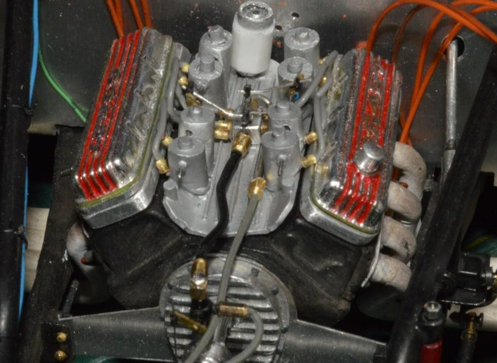

BK9300 Posted December 31, 2024 Posted December 31, 2024 So much detail you’re adding to your engine! Where did you find the ‘brass’ fittings for your injector lines - they are incredibly small! 1
Straightliner59 Posted December 31, 2024 Author Posted December 31, 2024 4 hours ago, BK9300 said: So much detail you’re adding to your engine! Where did you find the ‘brass’ fittings for your injector lines - they are incredibly small! I cheated, a little with those. I just hand-turned 1/32" K&S brass tubing against a sanding board, to taper one end, then cut them off in a little Micro Mark miter box. I'd never tried them, before, but it worked out, well! Previously, I just used wire insulation. Thanks, Brian! 1
Straightliner59 Posted January 1 Author Posted January 1 (edited) Welcome to 2025! Man, that whole Y2K thing was a quarter of a century ago, already! The fuel system is pretty much done. I'll still have to cement the main and the return to the fuel block, but, there's nothing left to do with those, but the cement. I still have a couple of things left to add to the manifold, before I can stick it down, for good. I'm fairly pleased, with it. Your questions, comments and critiques are always welcomed. Thanks for looking! Edited January 1 by Straightliner59 2
