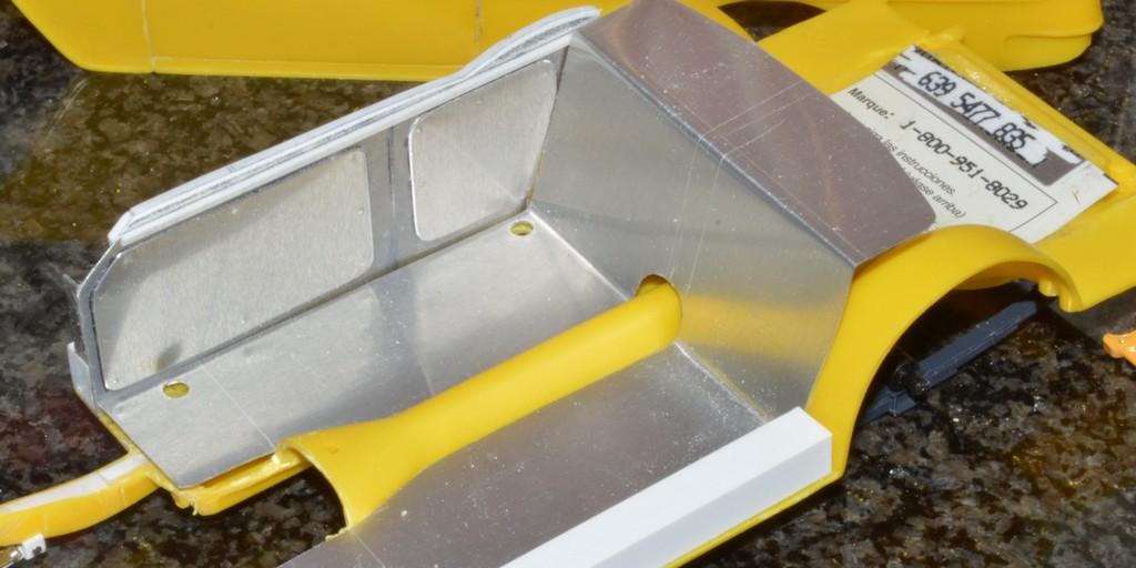

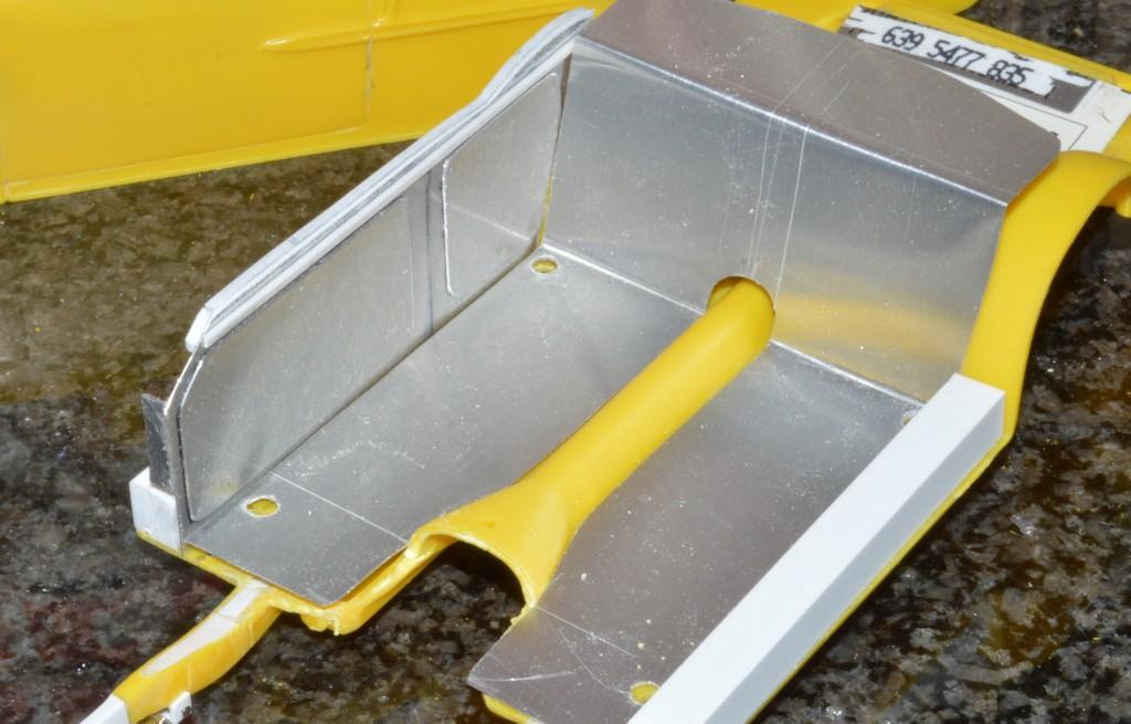

Straightliner59 Posted May 13, 2024 Author Posted May 13, 2024 I made the tops for the inner door panels, and added a trim strip, to give it a more finished look. For the strip, I started with .060" half-round, and laid it on the benchtop, between two strips of metal banding I'd picked up somewhere, in one of the board yards I used to work at. Then, I only needed to sand across them all, until the top of the half-round was flattened. That made the half-round not just look like a strip of half-round. Also seen are the new axle and spindles. Finally, I wanted to look at the gold leaf over a paint color. Since I was curious whether those leaking Testors lacquer cans might still work, I shot some on a spoon that was primered. Seems fine. This can was Root Beer. It won't be this car's color. Comments, questions and critiques are always welcome. Thanks for looking! 3
David G. Posted May 13, 2024 Posted May 13, 2024 That's some impressive metal work. The plastic bits are coming along nicely too. David G.
Ian McLaren Posted May 13, 2024 Posted May 13, 2024 Straightliner59 said I made the tops for the inner door panels, and added a trim strip, to give it a more finished look. For the strip, I started with .060" half-round, and laid it on the benchtop, between two strips of metal banding I'd picked up somewhere, in one of the board yards I used to work at. Then, I only needed to sand across them all, until the top of the half-round was flattened. That made the half-round not just look like a strip of half-round. I like this approach very much, The rest of the interiour is coming along very nicely. 1

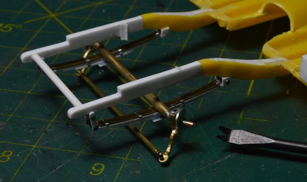

Straightliner59 Posted May 20, 2024 Author Posted May 20, 2024 I got the new front axle made. Once I installed the steering arms, I put the spindles in the mill vise, and drilled through the arms. Now, the kingpin holds them in place! I soldered tiny washers to the axle shafts, on either side of the spindle body, to secure those. This axle is narrower, and everything looks better! It operates very smoothly, too! Here it is, sitting back on the wheels. Your comments are always welcomed. Thanks for looking! 2
FoMoCo66 Posted May 20, 2024 Posted May 20, 2024 4 hours ago, Straightliner59 said: I got the new front axle made. Once I installed the steering arms, I put the spindles in the mill vise, and drilled through the arms. Now, the kingpin holds them in place! I soldered tiny washers to the axle shafts, on either side of the spindle body, to secure those. This axle is narrower, and everything looks better! It operates very smoothly, too! Here it is, sitting back on the wheels. Your comments are always welcomed. Thanks for looking! Amazing straight axle, just amazing?.
Straightliner59 Posted May 20, 2024 Author Posted May 20, 2024 2 hours ago, FoMoCo66 said: Amazing straight axle, just amazing?. Thanks, Ace! I like it much better than the first one!

Straightliner59 Posted May 21, 2024 Author Posted May 21, 2024 17 hours ago, Pierre Rivard said: The front axle and steering system looks so sweet. I imagine you'll add a functional steering box right? No pressure of course...? Thanks so kindly, Pierre! I think I'll save the actual working steering box for the dragster. Not sure I would be able to reach the wheel, in this one!? I'm pretty happy with the new axle. I failed to mention that I shaped the ends of the steering arms by tapping a small pin punch with a ball peen, while the brass rod was resting on an anvil. I little filing cleaned the ends right up. I then drilled them with a .6mm carbide bit. Today, I moved my clamping setup to the mill, and prepped a new piece of aluminum flashing for engine-turning. I used the same tool (3/32" dowel, wrapped with fine steel wool, and superglued in place). The mill works much better, due to the fact that I can run it at lower RPM. I now have a new spoiler! I plan to try it with the previously-mentioned toothpick, with the steel wool, before I dismantle the fixture. The pattern is still slightly larger than ideal, but it is uniform, and it looks beautiful! Comments are always welcomed. Thanks for looking! 3

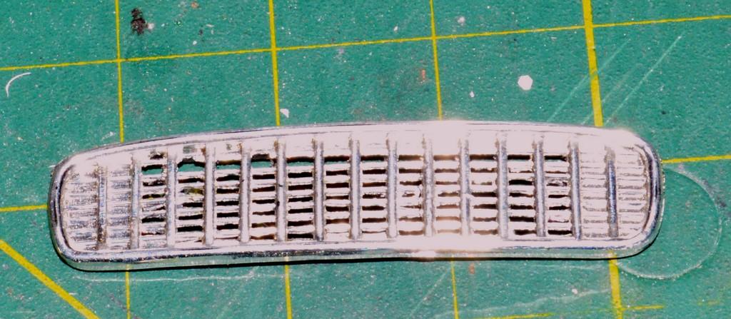

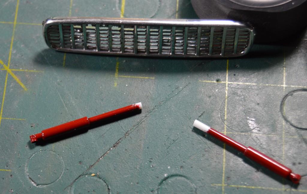

Straightliner59 Posted May 29, 2024 Author Posted May 29, 2024 Here's some of the stuff I have been working on: I found a grille from the Monogram '55 Chevy Street Machine (the black kit), and started milling the back side, to open it up. Still haven't decided if I will use it, or not, but, if so, it needs to be open! Finished up the brakes. I made the lug nuts using .060" hex stock (maybe a little large, but, the .040" looks too small). I bored it to accept .025" rod. I'm pretty happy with the results! I'm going to print some Summers Brothers tags for the axle ends. Also seen are the rear shocks, in both unpainted and painted states. These were really quick and easy to do, and will work perfectly for this project. Finally, I printed and painted the lettering for the spoiler. It's named after a Rory Gallagher song, and i thought it was fitting, given the way the thing sticks out, low, like it does. I should get it trimmed up and applied, tonight... Comments, questions and critiques are always welcomed. Thanks for looking! 1
