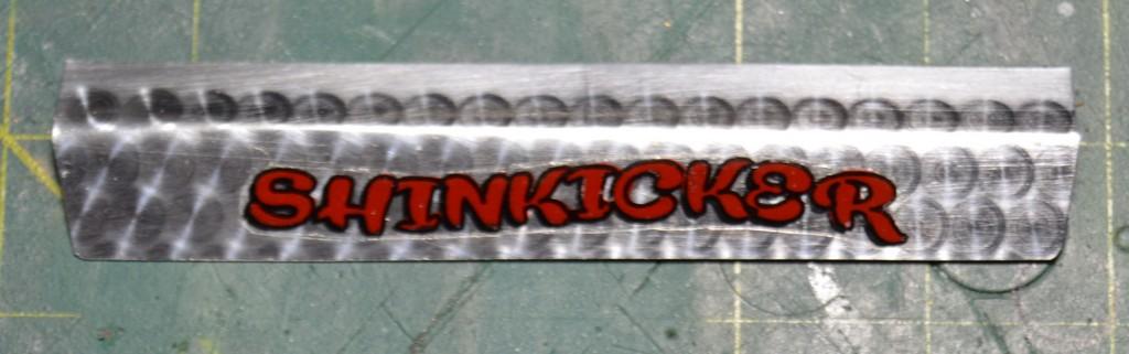

Straightliner59 Posted May 29, 2024 Author Posted May 29, 2024 Here is the "Shinkicker" decal, with the overlay, and installed on the spoiler (I couldn't help myself!). 1

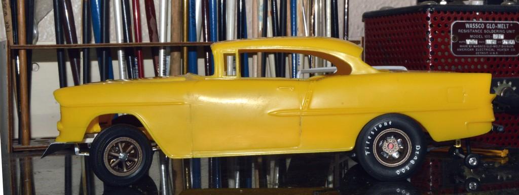

David G. Posted May 29, 2024 Posted May 29, 2024 The wheels look great! I would certainly use the opened grille. I did that on my 55 and I'm quite happy with the way it turned out. "Shinkicker" That just made me smile. Nicely done! David G. 1
Straightliner59 Posted May 30, 2024 Author Posted May 30, 2024 (edited) 15 hours ago, David G. said: The wheels look great! I would certainly use the opened grille. I did that on my 55 and I'm quite happy with the way it turned out. "Shinkicker" That just made me smile. Nicely done! David G. Thank you, David! I am kind of leaning toward using the grille. If not, I am considering adding some perforated aluminum sheet I have, behind the kit grille surround. Glad you like "Shinkicker"! Like I said, it seemed fitting!? Edited May 30, 2024 by Straightliner59
FoMoCo66 Posted May 30, 2024 Posted May 30, 2024 On 5/29/2024 at 5:37 AM, Straightliner59 said: Here is the "Shinkicker" decal, with the overlay, and installed on the spoiler (I couldn't help myself!). Nice job! Hurts my shin already. ? 1

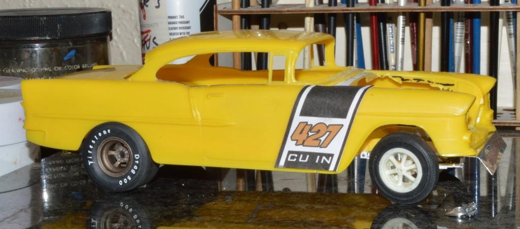

Straightliner59 Posted May 31, 2024 Author Posted May 31, 2024 I decided that I have enough Goodyear and M&H slicks, so I went with something different. I like it! I installed and painted the bolts for the shocks, too. 1

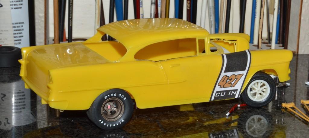

Straightliner59 Posted June 1, 2024 Author Posted June 1, 2024 (edited) Thanks, David! I finished up the rear wheels and mounted the slicks to them. I printed Summers Brothers axle tags on white decal paper. I punched them out with a short piece of 3/32" brass tubing that I sharpened the end on, then mashed it to an oblong/elliptical shape. A couple of taps with a small hammer cut them right out. I switched the previous set of front tires out for a set of Firestone Supremes from an AMT parts pack. I'm not all that happy with the color of the rear wheels, but, without starting them over, or building a new set...meh, I wouldn't call it a deal-breaker. I'll be working on the fronts, next. Thanks for looking! Edited June 1, 2024 by Straightliner59 1
David G. Posted June 1, 2024 Posted June 1, 2024 Wow Daniel, that's some crazy detail with the decals for the axles! ? You're giving this kit way more than it was ever intended to have. Though it's difficult to see them, I do like the Firestones on the front. One doesn't see many of those today, which is odd because they were everywhere at the time. David G. 1

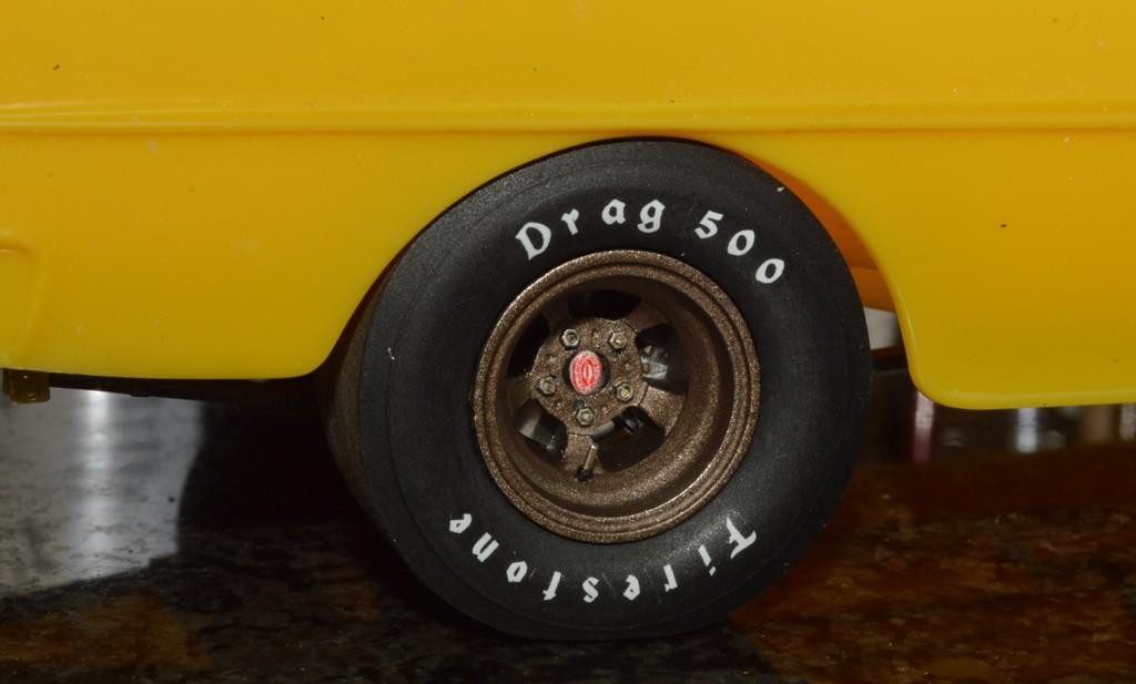

Straightliner59 Posted June 3, 2024 Author Posted June 3, 2024 The front wheels are finished (as with the rears, they'll get some weathering, in the form of dust, and probably a wash). I made the dust caps with aluminum from a dollar store knitting needle. The stuff machines, beautifully! It's perfect for small parts. I mixed some paint, using One-Shot. I call it "Purple People Eater", because I wanted something similar to the Minnesota Vikings' purple. Their defense, right abut the time this car would have raced was called essentially that, so...Thanks for looking! 3
David G. Posted June 4, 2024 Posted June 4, 2024 Love those front wheels! Where's that purple paint going to go? Is it for an accent color or the whole body? David G.

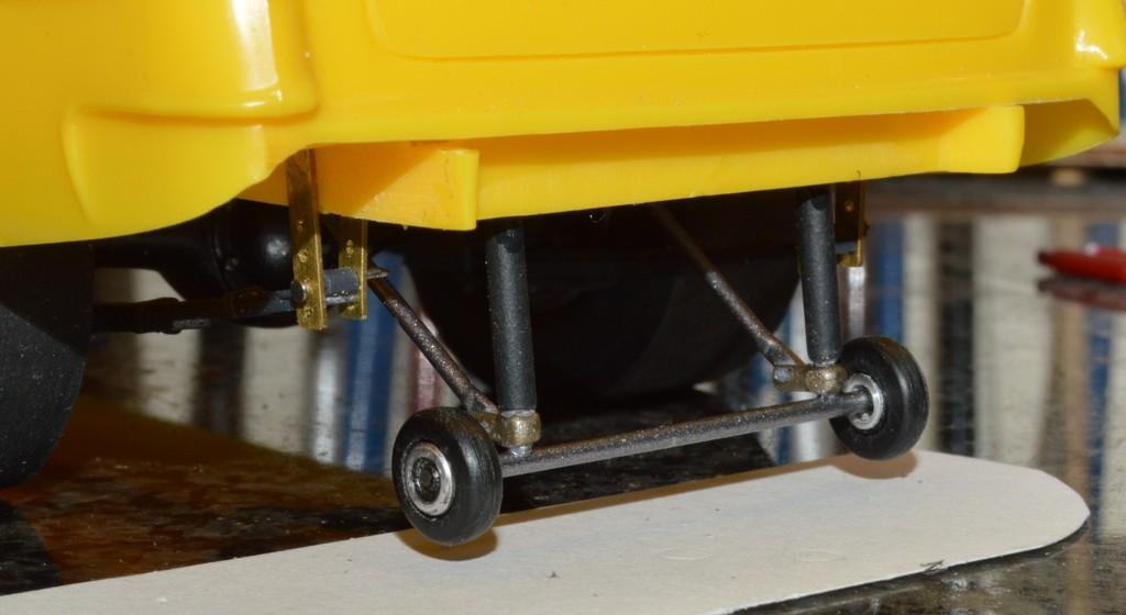

Straightliner59 Posted June 5, 2024 Author Posted June 5, 2024 I've been working on the wheelie bar assembly. I like the vertical bars, on this car! There's still quite a bit to do, with them, but there's plenty done to get an idea of where they're headed. I turned the wheels from knitting needle aluminum, and the tires from Delrin. I may do them all over, again, as I was trying to get by with a piece of Delrin that was left from another project. I managed to make the second tire, but I could do a nicer one, starting with a bigger chunk of plastic! I think it looks cool, under there!
David G. Posted June 5, 2024 Posted June 5, 2024 I don't know that I've ever seen wheelie bars like these before. Maybe I have but with them tucked up under the body as they are, I just didn't notice them. In any event, they're cool and look great. Also, thanks for your comment on the Chaparral Daniel. I think this is the first comment someone has made on one of my builds on someone else's thread. Thanks again, David G.

FoMoCo66 Posted June 5, 2024 Posted June 5, 2024 2 hours ago, David G. said: I don't know that I've ever seen wheelie bars like these before I have! There the same style that's on grumpy's toy 9. The same car I'm working on right now in another WIP.

Straightliner59 Posted June 13, 2024 Author Posted June 13, 2024 I finished the adjustable section of the wheelie bars. I've since added the cross-bracing to the down tubes. Those wont get painted until the chassis does. I'm currently weighing options for how I want to do the traction bars. The ones I made seem like they'd be a little flimsy. I'm deciding whether I want to build a new set, or just add some sort of "webbing", to these, to give them a bit more beef. Once those are done, I think I can get on to finalizing the engine location. Your comments are always welcomed. Thanks for looking! 1
