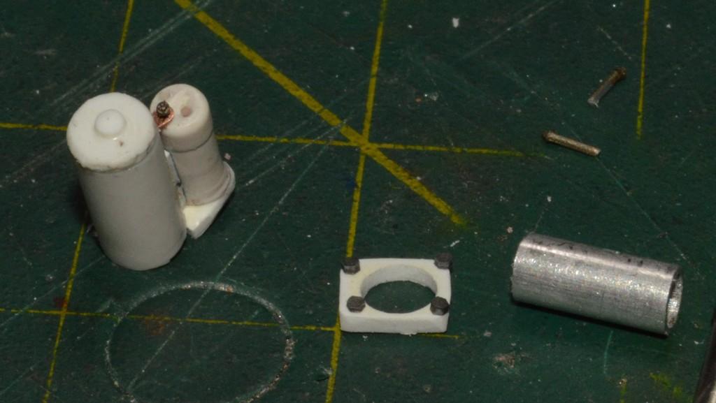

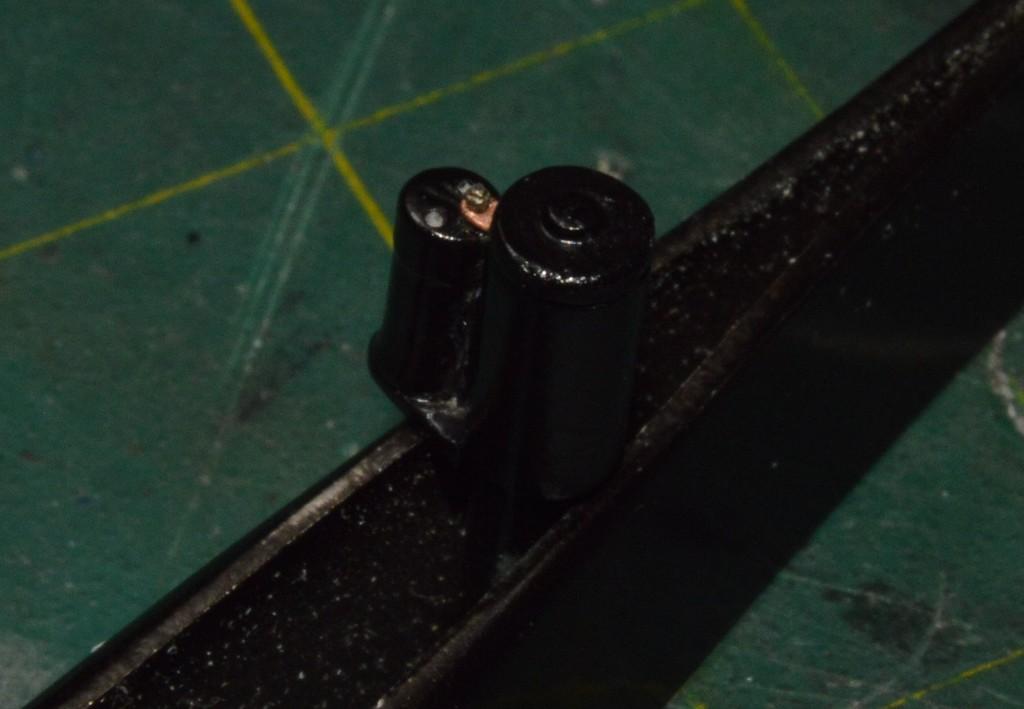

Straightliner59 Posted August 11, 2024 Author Posted August 11, 2024 I've been working on the starter. I've spent most of this time figuring out just how to go about building it. I think I finally figured out something that's passable. I ended up turning the solenoid from styrene rod, in order to create the terminal "block", at the front. I drilled the holes for the terminals. I also turned the front cover of the starter. The bolts on the mounting boss are just stuck on there with the adhesive from the tape I cut them from hex stock, on--mostly so they don't get lost. Two of those will actually be cemented to the bottom of the flange (which, I just realized, can be done, now). The others are backups!? Lately, I've been experimenting some, with a "stamping" technique. I used it, here, to make the copper power connection to the starter. Once I'd drilled the hole, in the main starter body, I found a piece of copper wire of the right diameter, and cut it about 3/8" long. I then sanded one end, so that it was smooth and round. Then, using my smallest pin punch (1/16"), and a 10 oz. ball peen hammer, I flattened it on an anvil, using a light, firm tap, if that makes any sense. I was then able to drill it to accept a plastic model railroad hex nut/bolt/washer (heretofore hex NBW) which as inserted into the solenoid's terminal block. Two more hex NBW will make the other connections. Lastly, I'll add hex NBW to make the thru-bolts. Once it's painted and the detailing is complete, it should be pretty cool, I think. Your questions, comments and critiques are always welcomed, of course. Thanks for looking!

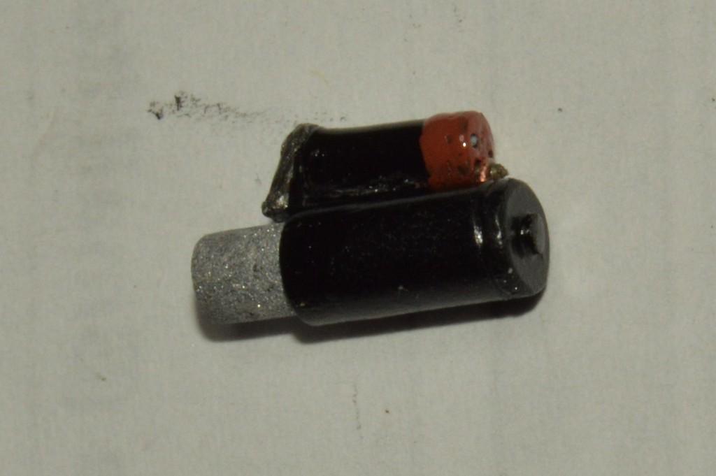

Straightliner59 Posted August 11, 2024 Author Posted August 11, 2024 Starter's done, except for a couple of bolt heads and hooking up the battery cable to the lug on the solenoid, and the wire for the start button. I am happy with this thing! I think it might be about time for a little graphite on the edges, and some dusting. Thanks for looking!
David G. Posted August 11, 2024 Posted August 11, 2024 Daniel, I have to sat that that starter is the most accurate and properly detailed starter I can recall seeing in that scale. ? David G. 1
Straightliner59 Posted August 12, 2024 Author Posted August 12, 2024 19 hours ago, David G. said: Daniel, I have to sat that that starter is the most accurate and properly detailed starter I can recall seeing in that scale. ? David G. I appreciate that, David. Once I figured out what I was doing, it was a lot of fun! I need to get the "battery" cable attached to it, then, I can weather it a little, and install the engine. I forgot to mention that I did the aluminum section with a technique I first used on the injectors for my Supermod. It works great for replicating a cast aluminum look on round objects (aluminum tubing, in this case). I use a piece of flat metal (I used one of my X-Acto aluminum sanding blocks) to roll diminishing grades of sandpaper over the tubing. I used 180, then 240 on this one. I really like the way it looks!

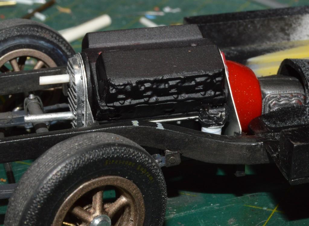

Straightliner59 Posted August 13, 2024 Author Posted August 13, 2024 Thanks, Tony! The engine is installed! I was hoping to post these, this morning, but my cursor decided it was going to take a wild ride. I must have got something damp, when I absentmindedly wiped off the dust! Anyway, here are a few photos. Thanks for looking! 3

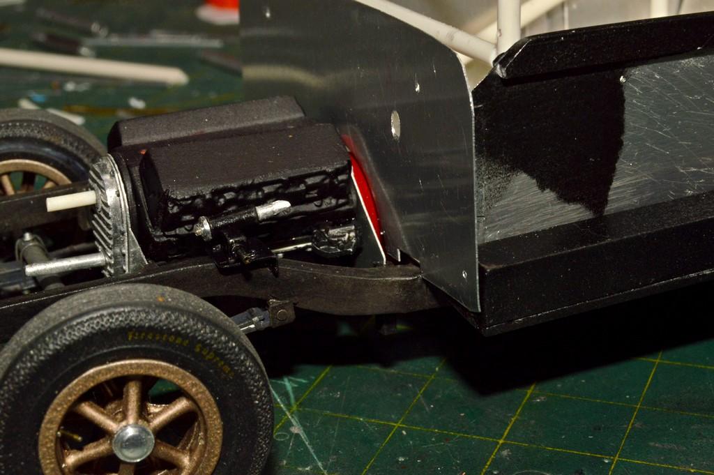

Straightliner59 Posted August 21, 2024 Author Posted August 21, 2024 I didn't realize it had been so long, since I updated this. I haven't done a whole lot. A lot of it has been adding stuff I never had any intention of adding, when I started this. I've somewhat limited myself, based on my initial intent to keep it a "quick and easy" project, without chassis detail, beyond what could be seen below the chassis, however...that starter/battery cable had to go somewhere!? I zip-tied the battery cable and the switch wire together, for a very short distance. Where I really got carried away doing something that will only matter, to me--I didn't want the master cylinder on the firewall, so I scratchbuilt one, and mounted it under the floor. To my way of thinking, explaining why there isn't a master cylinder on the firewall, isn't enough. I figured I had best have one, if I say I have one. Also did a bit of work on the driveline tunnel. I've also been working out the headers and the angled stacks (think Larson's Chevelle). No significant progress, yet, so no photos...yet. I think it's important to build and install the headers, now. Comments, critiques and questions are always welcomed. Thanks for looking! 2
