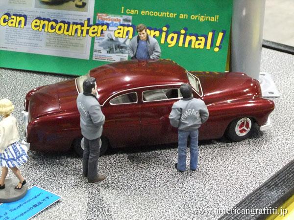

SpeedShift Posted May 12, 2024 Author Posted May 12, 2024 (edited) On 4/28/2024 at 4:56 PM, SpeedShift said: While we're on the brief subject of the Pharoahs....Shuichi Sakamoto , a modeler in Japan, created some 1/25th scale Pharaohs figures to go with his American Graffiti car builds. The likeness of each was really incredible. Does anyone recall what modeling magazine featured his figures? Did an internet search, only found 1999 Fine Scale Modeler (November vol.17 #9) that featured his '32 Deuce Milner hot rod build. Figured out where the article on the Sakamoto Pharaohs figures was...Scale Auto Enthusiast December 1999 Vol. 21 No. 5 issue 126. Sculpting these in 1/25th scale, let alone getting the likeness right, was quite an achievement. Wish he had them mass produced. Edited May 12, 2024 by SpeedShift 1

styromaniac Posted May 12, 2024 Posted May 12, 2024 2 hours ago, SpeedShift said: Figured out where the article on the Sakamoto Pharaohs figures was...Scale Auto Enthusiast December 1999 Vol. 21 No. 5 issue 126. Sculpting these in 1/25th scale, let alone getting the likeness right, was quite an achievement. Wish he had them mass produced. " Tie him to the car... and drag him." 1

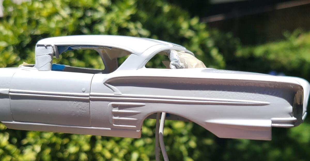

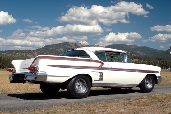

SpeedShift Posted May 29, 2024 Author Posted May 29, 2024 (edited) Noticed in reference pictures the American Graffiti '58 Impala has a slight rake to the stance...the stock AMT kit has the body a bit low on all four wheels. Fabricated a lift kit for the rear suspension. Think this might get it where I want. Edited May 29, 2024 by SpeedShift 1

SpeedShift Posted June 7, 2024 Author Posted June 7, 2024 (edited) I'm just about ready to quit using MCW clear gloss enamel. Maybe I'm doing something wrong and you guys may have some tips on how to address the issue. While I liked the results using regular MCW enamel with their hardener, my experience so far with the MCW clear gloss and hardener has been a disappointment. My first experience ended up with not just orange peel - but orange lumps on some of the surface. I had to sand off the gloss cote to get the surface level again. That required respraying much of the MCW white enamel base coat where the white color got removed. After sanding, polishing and cleaning the body and getting the nice white base back, I thought I might give the gloss another try. Today is a nice day, low humidity. I figured the problem with the first attempt was not thinning the gloss clear enough when I airbrushed it - I had used the MCW gloss and the MCW gloss hardener per their ratio , with just a drop of Tamiya lacquer thinner. Maybe that was too thick, not thinned enough. This morning, after cleaning the body with a Testors Model Masters tack cloth, I did a near 1 to 1 thinner ratio to the same 2 to 1 gloss(#1017E)/gloss hardener (#1017EH) and decided to go with light mist coats first. Well, the mist coats went on ok - but had some slight eggshell surface texture. When I attempted to apply the final wet coat - it did the orange peel /lumps thing again. Didn't seem to want to level out at all. I have a new GREX airbrush, spraying with a static tank pressure of 30 which goes to 20 when applying paint. My feeling - what's the point continuing with this gloss clear...if I have to keep wet sanding the gloss off if I want to get a smooth surface. Not sure where to go next...I don't have any Furure/Pledge and I didn't like the results using Quick Shine on clear windshields...it dried very wavy. (also posting in the Model Building Questions and Answers hoping to get some help). Edited June 7, 2024 by SpeedShift
