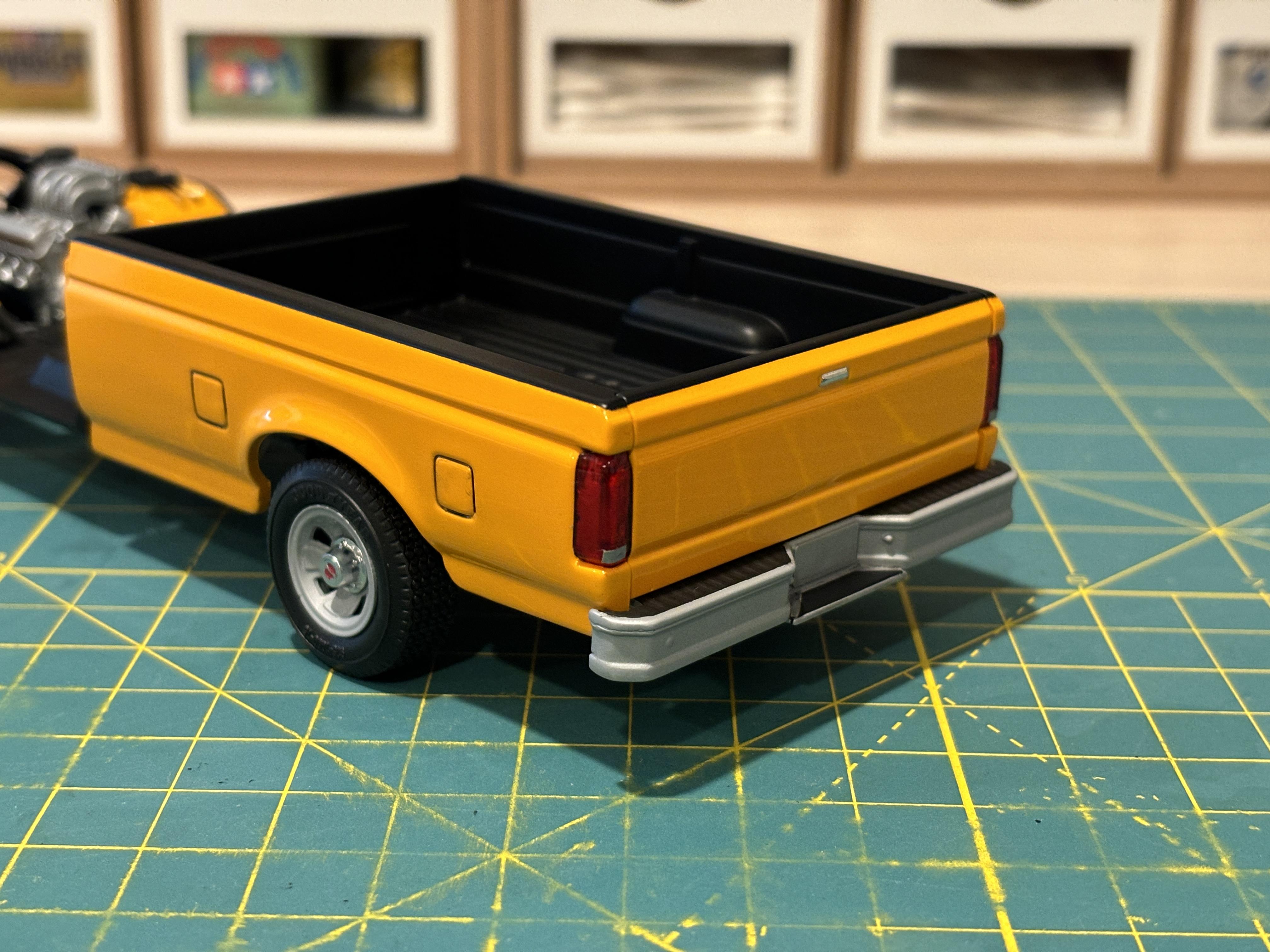

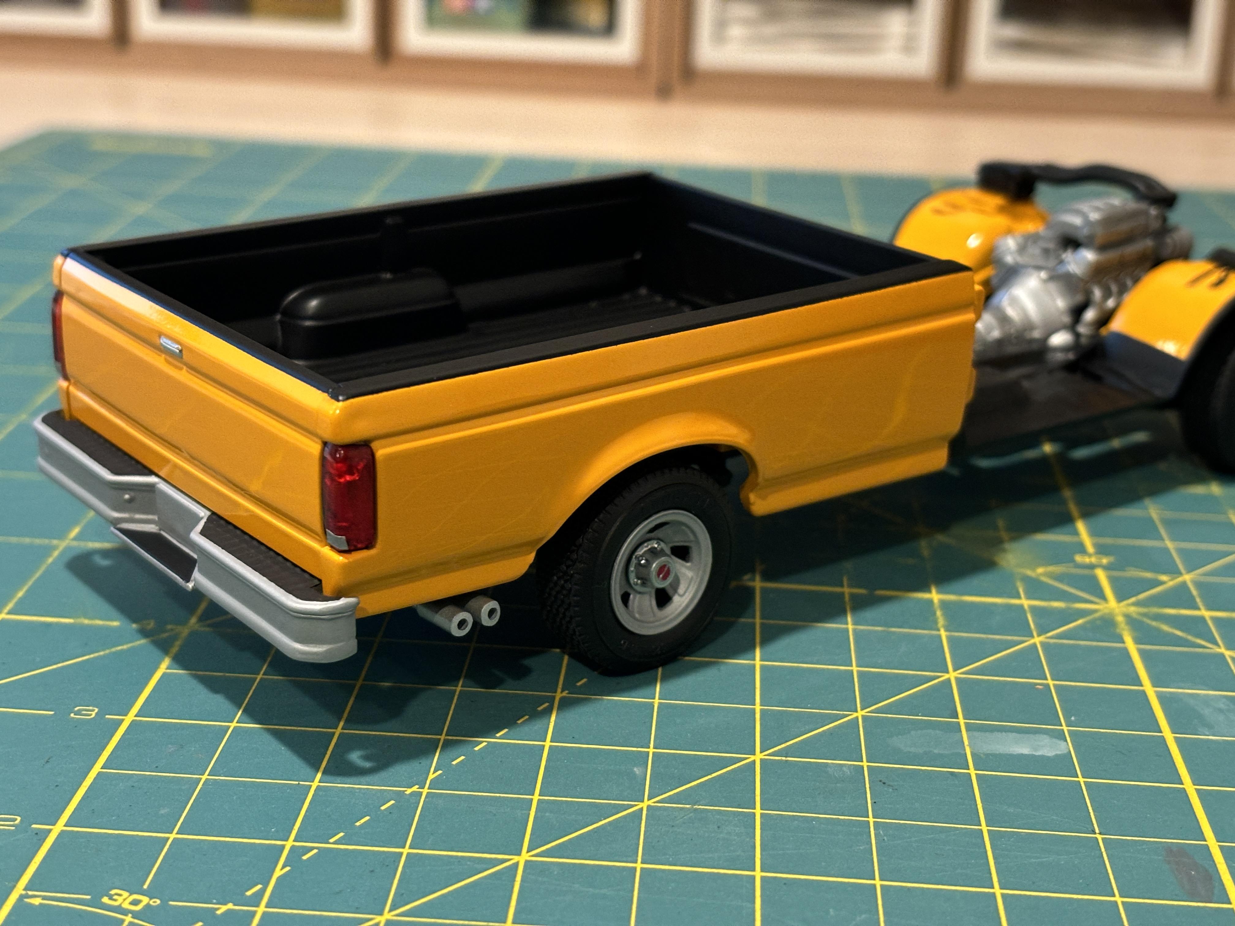

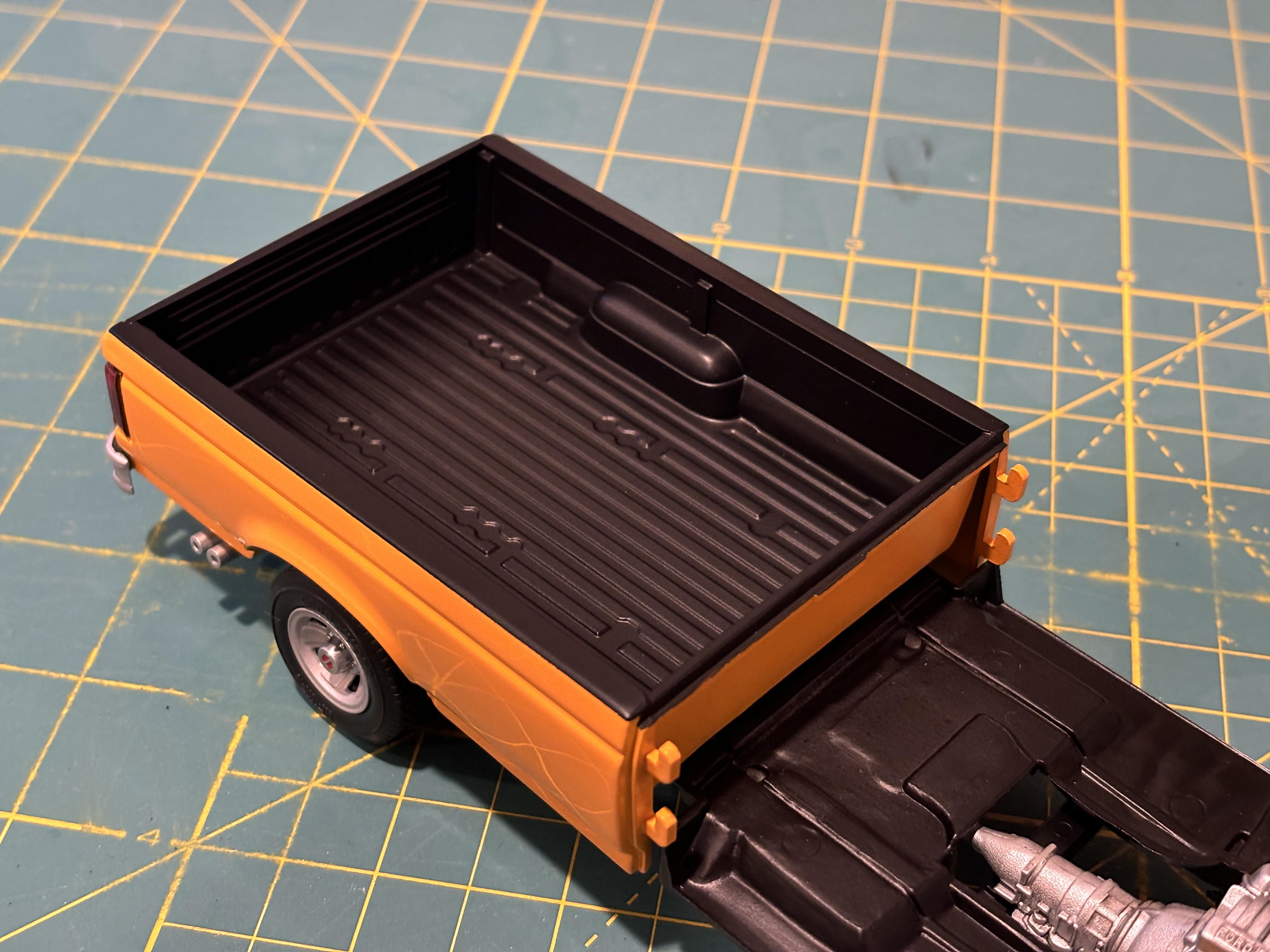

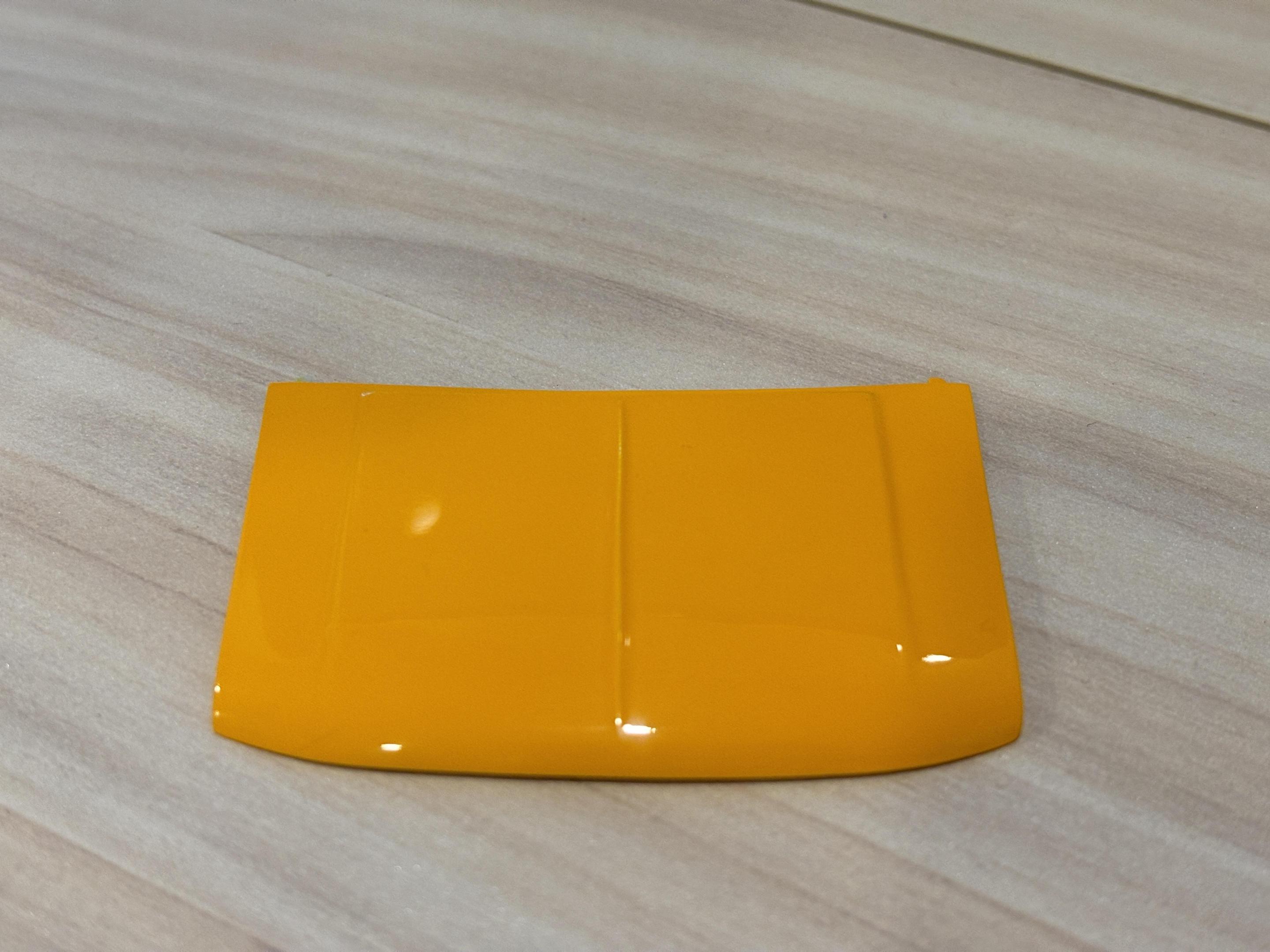

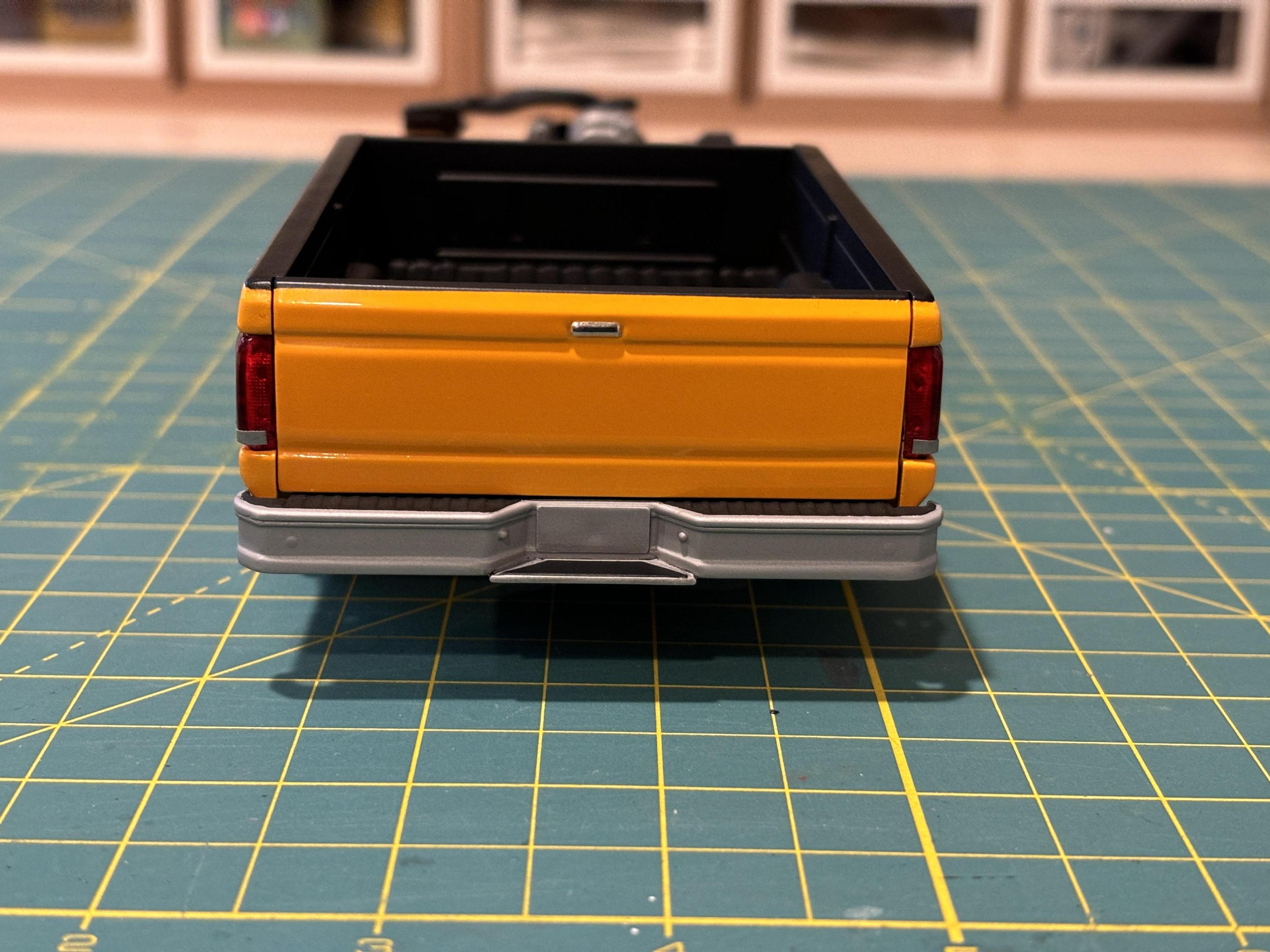

av405 Posted August 9, 2024 Author Posted August 9, 2024 I'll call this update "2 steps forward, half a step back." First, the steps forward: The hood and tailgate are done after wet sanding, compound and polish. I did not have any of the previous paint issues resurface, so I'm very happy with that. After polishing the tail gate, I painted the back with Mr. Surfacer 1500 Black Primer to simulate bed liner. I then put BMF over the latch to get that nice chrome look. Here is the bed all finished and put together: The hood: So what's the half step back? Unfortunately, when I cleared the cab, I sprayed from too far away (long story, won't get into it). I got HEAVY orange peel that I was unable to completely remove with wet sanding and polish. After that was all done, I went back and gave the cab a wet coat of clear. That, combined with the aforementioned sanding and polish, got me the finish I usually get. Granted, that finish always has some orange peel and isn't perfect, but I know I can get rid of it and get the cab to match the finish on the bed. I won't post another picture of the cab as you all get the idea of what it looks by now, but now I have to wait another week to let it dry. Being patient isn't always easy. 6
av405 Posted August 10, 2024 Author Posted August 10, 2024 On 8/8/2024 at 8:11 PM, slusher said: Hood looks good too me. On 8/9/2024 at 1:24 AM, Ulf said: Very inspiring post, Thanks. 13 hours ago, stavanzer said: I do not have your patience. Good On Ya! Thank you, all!

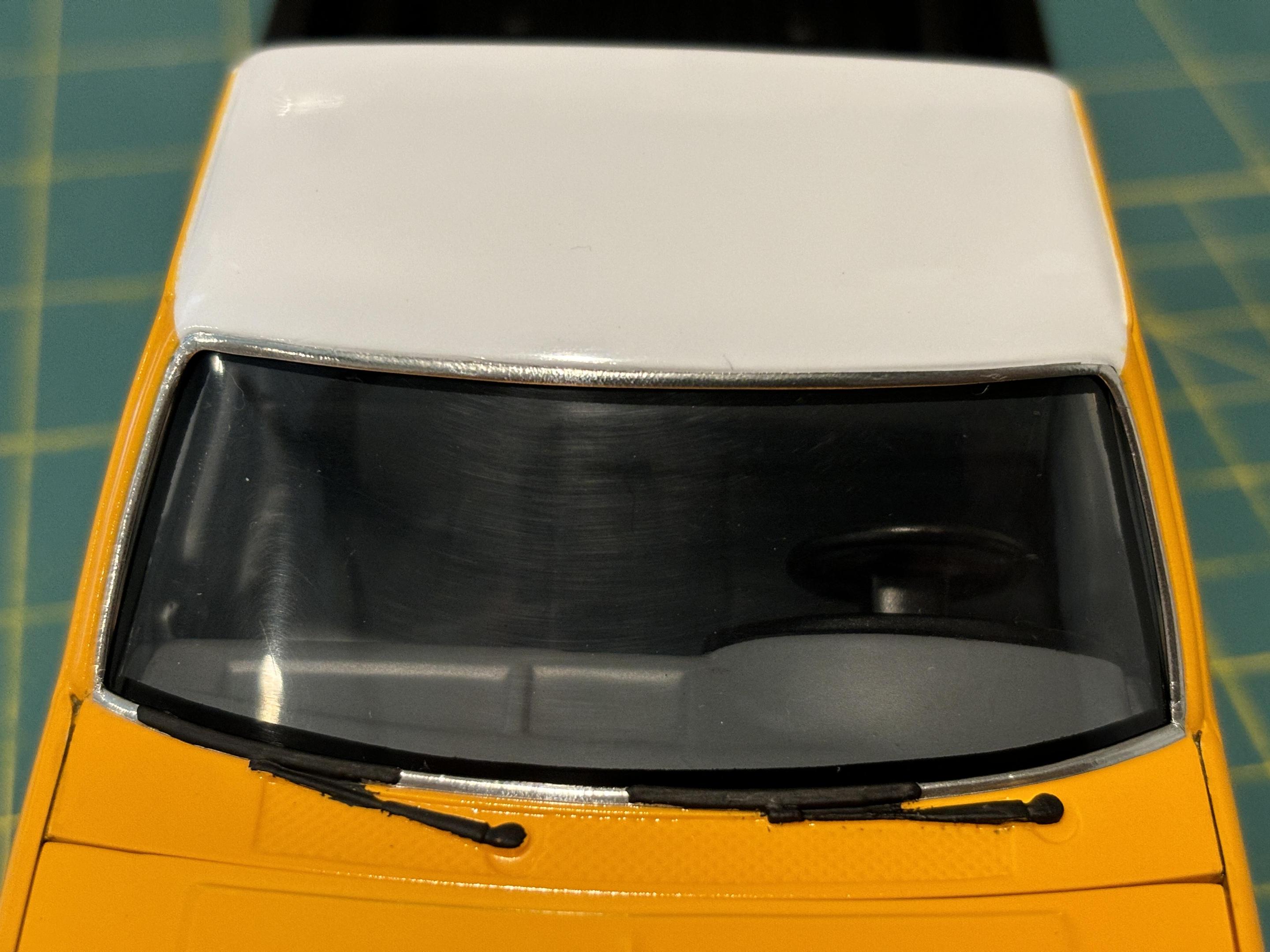

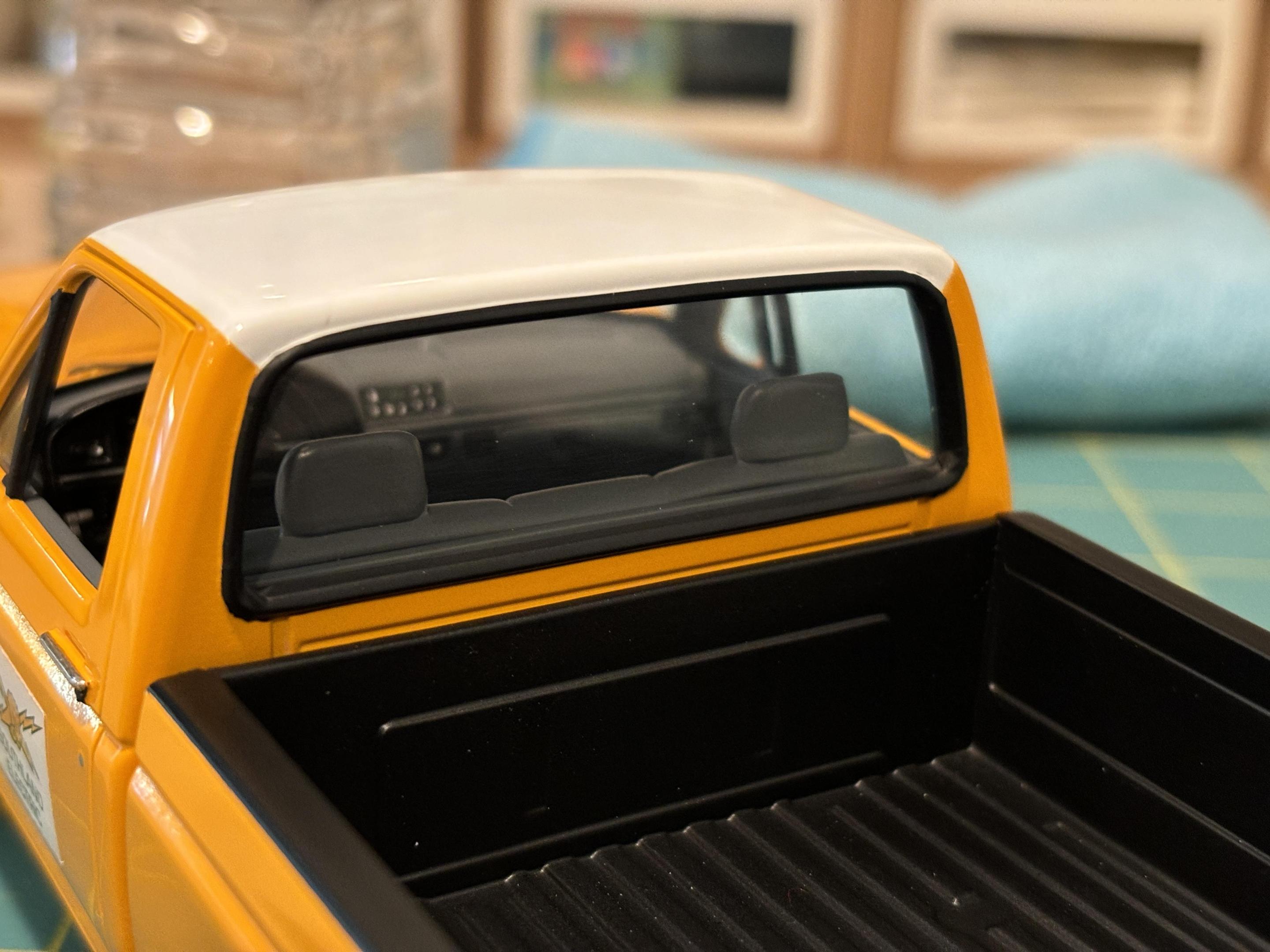

av405 Posted August 15, 2024 Author Posted August 15, 2024 This will be my last in-progress post for this build. I'm powering through to the finish line and detailing the cab/final assembly involves a lot of small parts and steps that I don't feel like documenting here. I wet sanded and polished out the cab and I finally got the finish I wanted (more or less anyhow, always room for improvement!). The more I do this, the better I get at it. I used BMF to detail trim the edges around the front window. Mercifully, this is the only part of the build that really needs BMF. The back window trim is what had me nervous. My initial idea was to hand paint it black, but I was afraid of the streaks and uneven paint edges that would inevitably show up. My second thought was to mask and paint black. I dread doing this and tape + curves usually don't make good friends. I know some of you get great results from this, but my confidence just wasn't high. So I went with this stuff: It's basically trim tape, in a similar vein to BMF but just a bit thicker. I used it on my last build to replicate black side molding and I loved the results and durability. I used 4 sections to cover the 4 sides of the windows and used a brand new blade to cut around the perimeter. I then touched up any small areas not covered by the tape (all on the inside of the window) with flat black paint. To some purists it may not be perfect, but it looks good enough to me and it plugs a modeling void that I still have not mastered. This one should be posted in the Under Glass section soon. 5

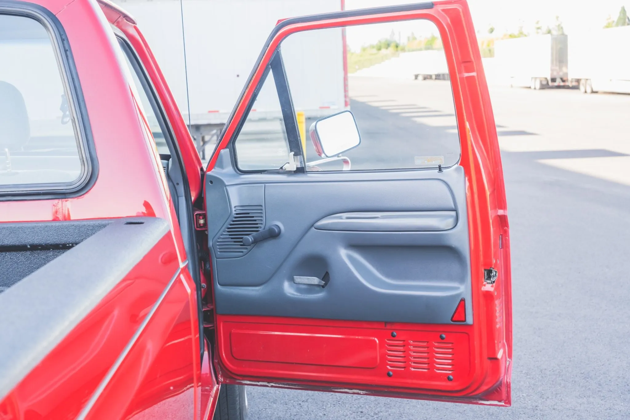

Chuck Most Posted August 19, 2024 Posted August 19, 2024 On 5/13/2024 at 7:06 PM, av405 said: Unfortunately, the interior door details are not accurately molded on the kit, so the location of the crank looks funny despite being in the right spot. Well... in 90's Ertl's defense it is accurate for an XLT with power windows. ? But yes, not much help when your intent is to model an XL.
av405 Posted August 19, 2024 Author Posted August 19, 2024 10 minutes ago, Chuck Most said: Well... in 90's Ertl's defense it is accurate for an XLT with power windows. ? You're absolutely right and I know someone else called me out on that in this same thread. A case of me not wording things properly ?
Chuck Most Posted August 19, 2024 Posted August 19, 2024 2 hours ago, av405 said: You're absolutely right and I know someone else called me out on that in this same thread. A case of me not wording things properly ? Happens to the best of us. 1
