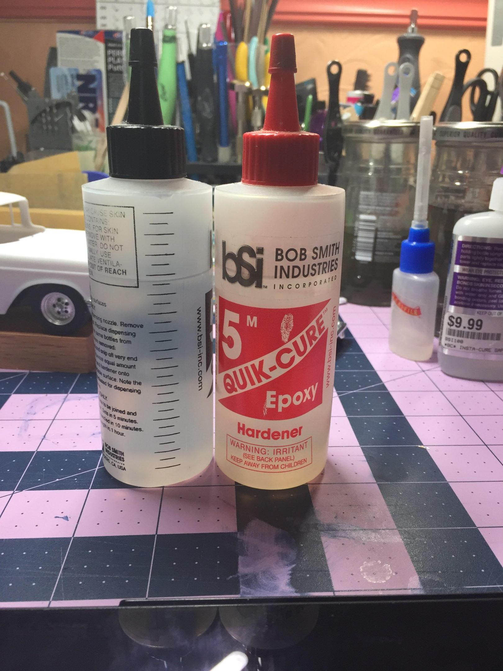

customline Posted September 1, 2024 Posted September 1, 2024 Why not 5 minute epoxy for a glass install? It cures out absolutely clear....in 5 minutes ?
David G. Posted September 2, 2024 Author Posted September 2, 2024 (edited) 23 hours ago, customline said: Why not 5 minute epoxy for a glass install? It cures out absolutely clear....in 5 minutes ? I'm just not good with epoxy. I've never been able to get the mix right. -D- Edited September 2, 2024 by David G. typo 1
customline Posted September 2, 2024 Posted September 2, 2024 2 hours ago, David G. said: I'm just not good with epoxy. I've never been able to get the mix right. -D- Yeah, I get it, Dave. 50/50 can be tricky. ?
LennyB Posted September 2, 2024 Posted September 2, 2024 2 hours ago, David G. said: I'm just not good with epoxy. I've never been able to get the mix right. -D- David I find the most common mistake people make with epoxy is they mix it on a piece of paper. This absorbs some of the resin and throws off the mixture. Have to mix on something solid like plastic or metal. I use the inside of an old plastic jar lid. When I run out of room I simply scrape it off the lid with and start again.?
David G. Posted September 2, 2024 Author Posted September 2, 2024 1 hour ago, customline said: Yeah, I get it, Dave. 50/50 can be tricky. ? Aw, that's just mean I know it's supposed to be that simple it just never really works out that way for me. It usually ends up sticky and never really cures completely. I can eyeball-mix ink and cosmetics colors and I'm really good at specking formaldehyde index ratios for edematous cases but epoxy just eludes me. If I have to be bad at something that's one of the things I can live with. And I use it so infrequently that it usually gets dried up in the tubes by the time I get around to needing some again. -D- 1 hour ago, LennyB said: David I find the most common mistake people make with epoxy is they mix it on a piece of paper. This absorbs some of the resin and throws off the mixture. Have to mix on something solid like plastic or metal. I use the inside of an old plastic jar lid. When I run out of room I simply scrape it off the lid with and start again.? I've tried that Len, thanks though. There are enough alternatives that I can usually find a work-around. -D- 1
customline Posted September 2, 2024 Posted September 2, 2024 12 minutes ago, David G. said: Aw, that's just mean I know it's supposed to be that simple it just never really works out that way for me. It usually ends up sticky and never really cures completely. I can eyeball-mix ink and cosmetics colors and I'm really good at specking formaldehyde index ratios for edematous cases but epoxy just eludes me. If I have to be bad at something that's one of the things I can live with. And I use it so infrequently that it usually gets dried up in the tubes by the time I get around to needing some again. -D- I've tried that Len, thanks though. There are enough alternatives that I can usually find a work-around. -D- I've used the "hypodermic" double tube stuff and it's too difficult to handle for me and I promptly ?-canned it. I have found the Bob Smith "Quick Cure" stuff to be quite forgiving and I mix it on small paper plates. Never a problem (unless I forget what I'm doing and it hardens up before I make the assembly ☺️) Jes' tryin' ta hep ?
DJMar Posted September 2, 2024 Posted September 2, 2024 6 hours ago, David G. said: I'm just not good with epoxy. I've never been able to get the mix right. -D- I find myself using PVA glue for clear parts, especially where the mating surface is going to be visible (headlights, taillights, etc.). For me, using epoxy is a bunch of extra steps, and it doesn't clean up with water. Ever accidentally get some 5 minute epoxy on a finished, painted surface? No fun. And since my motor skills aren't what they once were 30 years ago, I like to give myself a lot more room for error. IMHO, unless you need the bond to be super strong, epoxy feels like overkill. Honestly, I use it very infrequently. Just my two copper.
David G. Posted September 3, 2024 Author Posted September 3, 2024 19 hours ago, customline said: I've used the "hypodermic" double tube stuff and it's too difficult to handle for me and I promptly ?-canned it. I have found the Bob Smith "Quick Cure" stuff to be quite forgiving and I mix it on small paper plates. Never a problem (unless I forget what I'm doing and it hardens up before I make the assembly ☺️) Jes' tryin' ta hep ? I've used both of those types Jim. But after so many disappointments and errors, I'm just not confident enough to take the chance on messing up whatever I'm working when there are so many good, easier to use alternatives. I appreciate your effort but I've accepted that epoxy is one thing I'm just not going to be proficient working with. -sorry 16 hours ago, DJMar said: I find myself using PVA glue for clear parts, especially where the mating surface is going to be visible (headlights, taillights, etc.). For me, using epoxy is a bunch of extra steps, and it doesn't clean up with water. Ever accidentally get some 5 minute epoxy on a finished, painted surface? No fun. And since my motor skills aren't what they once were 30 years ago, I like to give myself a lot more room for error. IMHO, unless you need the bond to be super strong, epoxy feels like overkill. Honestly, I use it very infrequently. Just my two copper. Thank you DJ! I've used PVA on clear parts and PE for years. It is much more forgiving and easier to clean up. 3 hours ago, slusher said: Looking great David! Thank you Carl! David G. 1
