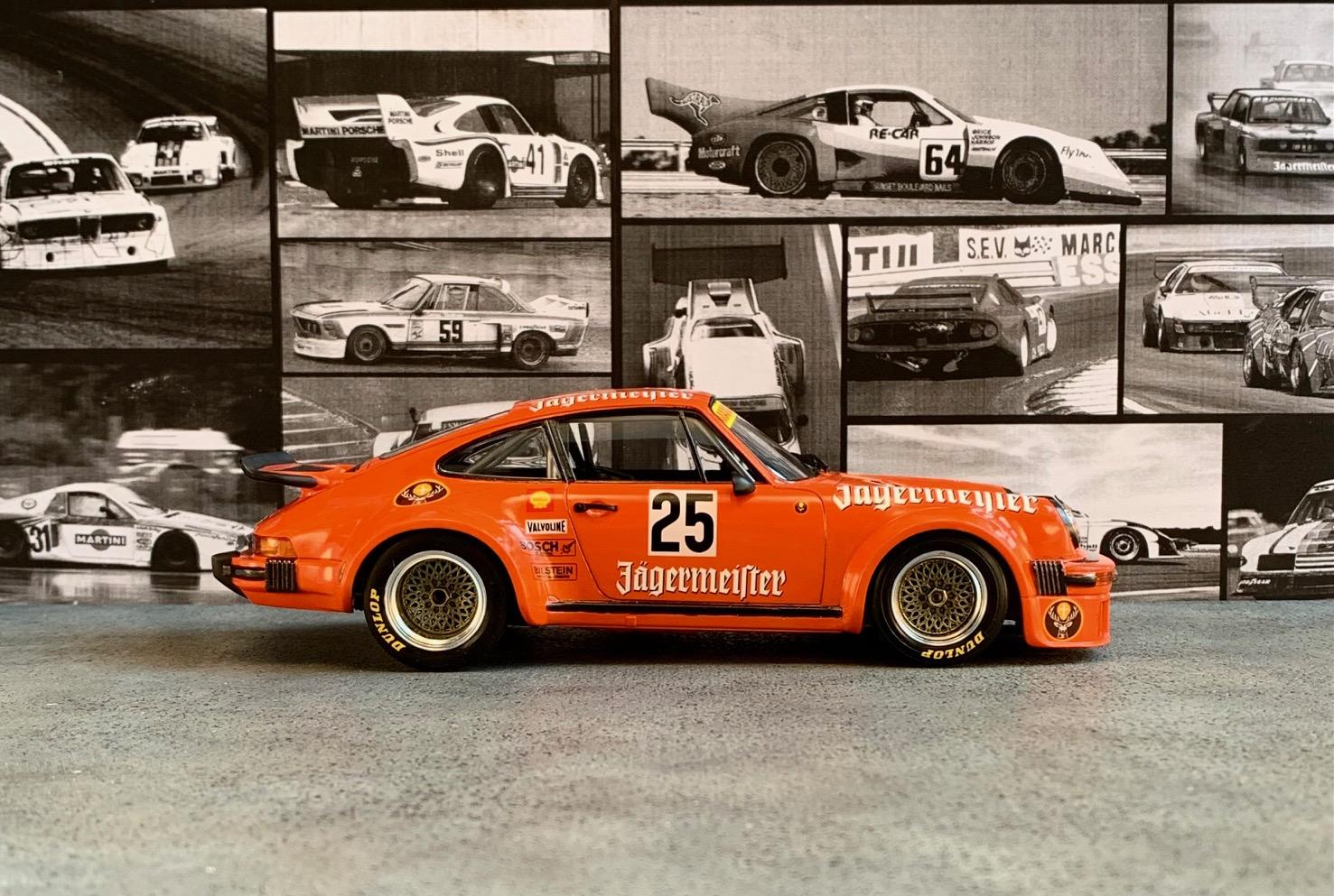

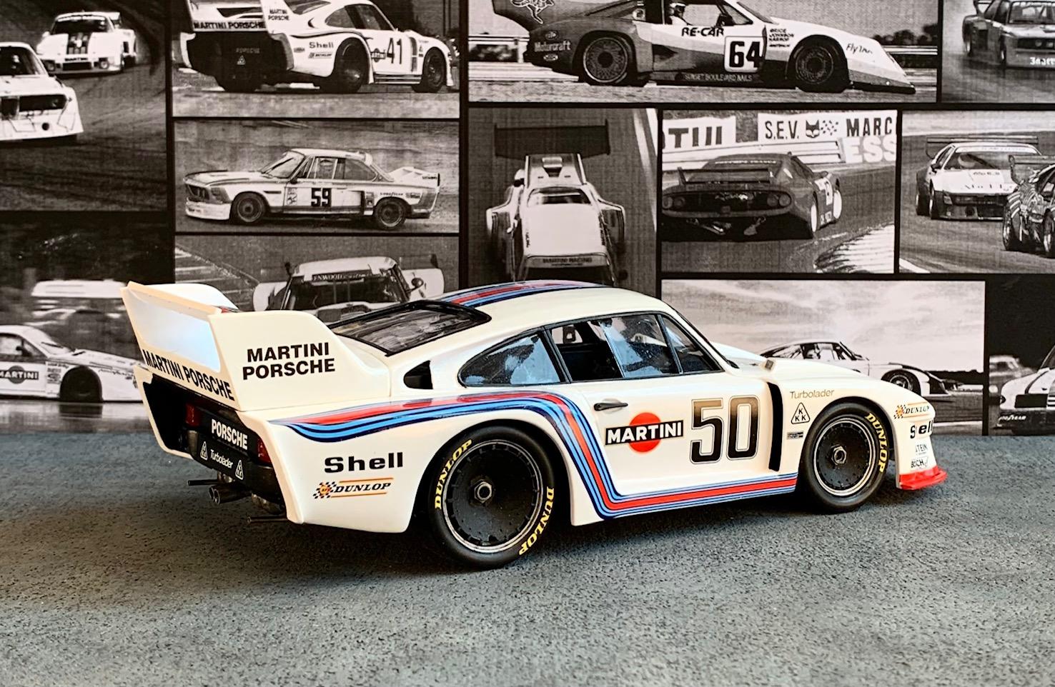

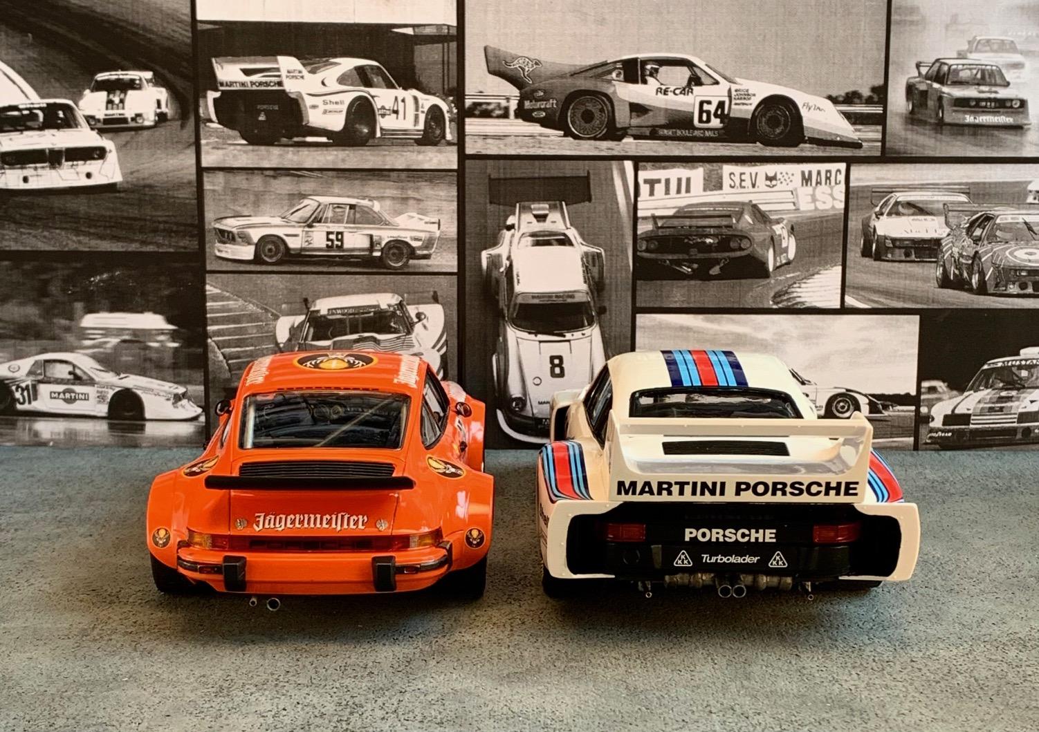

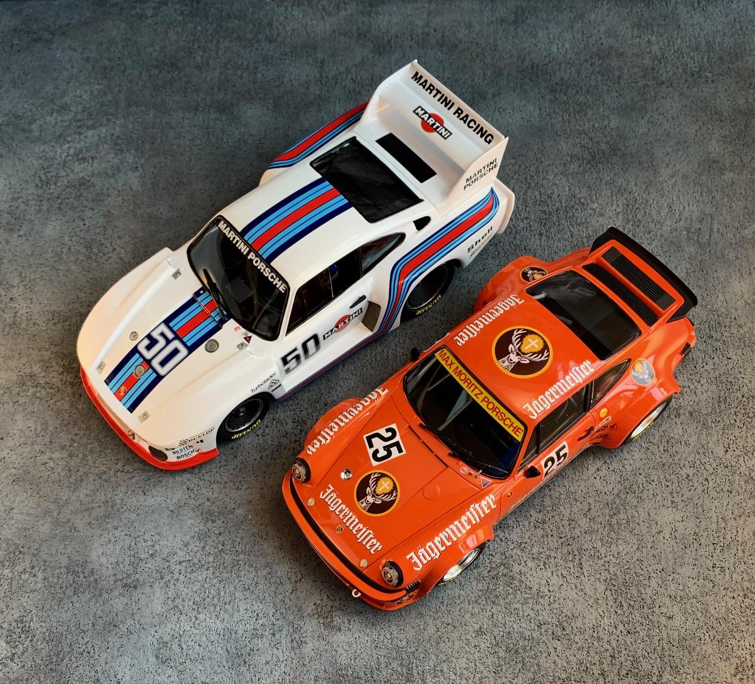

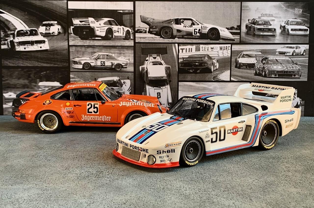

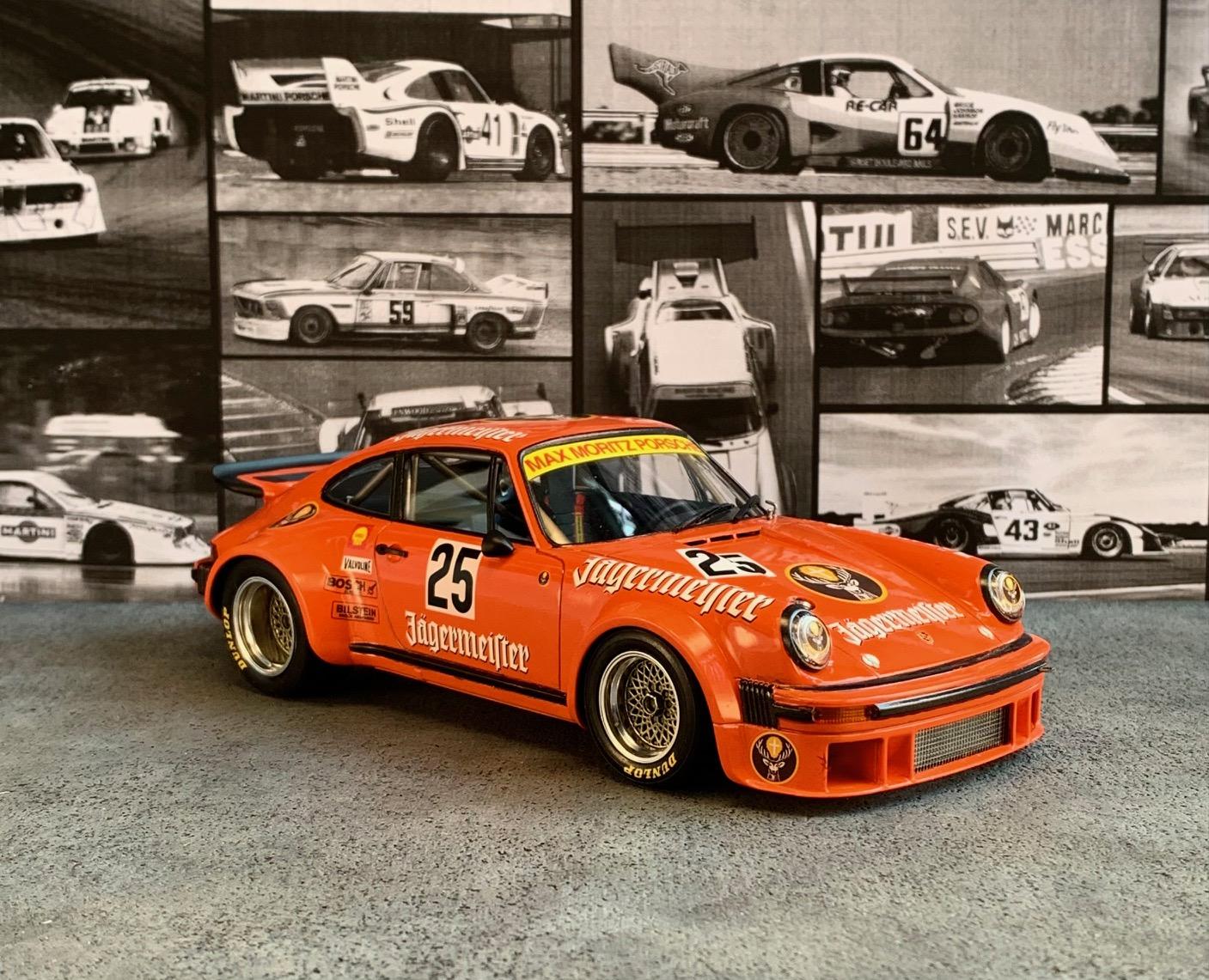

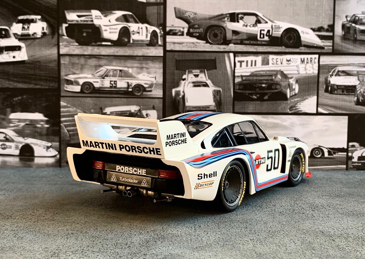

Pierre Rivard Posted May 22, 2024 Posted May 22, 2024 (edited) After a few complicated builds I was in need of some OOB therapy. Looking through the stash I found a pair of Porsche curbside kits and decided to build them both side by side. The 934 is a Tamiya and practically built itself. It is that good, perfect fits, no flash, small part count put somehow detail rich. I only added tire decals not present on the very good kit decal sheet. The 935 is a Italeri release of the 935 baby but really the 935/77 factory race cars with a nose cooler which the Baby did not have. The kit is a re-pop of the period Nitto kit also later released under Entex and then AMT brands. All the same tooling and as basic as it gets but the body appears to be a reasonably accurate representation of the car. I only added some mesh screening over coolers and brass tubes for the waste gate blowout. Kit decals are good except for the Martini side stripes not really fitting the body shape. Edited May 23, 2024 by Pierre Rivard 14

Belugawrx Posted May 23, 2024 Posted May 23, 2024 A beautiful pair of Porsche Pierre ! Did you need to lower the 934 at all ?

ZTony8 Posted May 24, 2024 Posted May 24, 2024 I've seen versions of the Tamiya 934 that sat too high out of the box.You were lucky.
1959scudetto Posted May 24, 2024 Posted May 24, 2024 58 minutes ago, ZTony8 said: I've seen versions of the Tamiya 934 that sat too high out of the box.You were lucky. You might have confused this with the Revell AG version which has too much ground clearance (Jägermeister and/or Vaillant version) ...
Pierre Rivard Posted May 25, 2024 Author Posted May 25, 2024 On 5/23/2024 at 10:36 AM, ChrisR said: Looks great! Thank you Chris for stopping by and providing support. Much appreciated. On 5/23/2024 at 12:36 PM, 1959scudetto said: Very good looking Porsches, Pierre - good idea to build some simpler kits after these exhausting SWB/SLR work ! I'm looking forward to your XK-120 (I have it in my stash too, but the full plastic version - no die-cast body) I am now refreshed and ready to go. It fails me why the XK-120 has a metal body but it provides a new challenge. On 5/23/2024 at 3:52 PM, Gramps46 said: Very well done indeed. Thanks for sharing and offering up some inspiration. Thank you Gary. Starting work on a racing XK-120, so start digging into your database for information. Do I go for a specific car or a fictional one? 14 hours ago, ZTony8 said: I've seen versions of the Tamiya 934 that sat too high out of the box.You were lucky. So have I Tony, but I don't think it is luck as I always test fit for ride height and wheelbase (a pet peeve of mine is ride height) and this kit is so precisely engineered. The ones that ride high are because the chassis is not properly engaged into the locating notches inside the body.

Tommy124 Posted May 28, 2024 Posted May 28, 2024 Porsche 934, Porsche 935... let me guess what's next? ? Pierre, these are beautiful builds from your capable hands, very nice! As regards the origin and correctness of this kit (as a 935 Baby), there were some conclusions made (not by myself) on a British forum as follows: Quote The genesis of this kit is more complicated. I hope I got it right in this summary: Nitto as a regular 935-77, probably 1978, three issues. Nitto went under in 1985 Esci-Ertl as a 935 Baby, 1985 issue or later AMT-Ertl as a regular 935-77, 1991 and 1998 issues Italeri as a 935J, 2007 issue Italeri as a 935 Baby, 2020 issue I think this is the most travelled 935 model! As mentioned, it lacks a number of Baby features, so I condider it a 935-77.
Pierre Rivard Posted May 30, 2024 Author Posted May 30, 2024 On 5/27/2024 at 10:34 PM, slusher said: Two beautiful Porsches! Thank you Carl On 5/28/2024 at 10:33 AM, Tommy124 said: Porsche 934, Porsche 935... let me guess what's next? ? Pierre, these are beautiful builds from your capable hands, very nice! As regards the origin and correctness of this kit (as a 935 Baby), there were some conclusions made (not by myself) on a British forum as follows: Thanks Thomas. I came to the same conclusions, very old kit representing the 935/77 (not the baby). Interesting contrast building it in parallel to the Tamiya 934 released in 2013.
