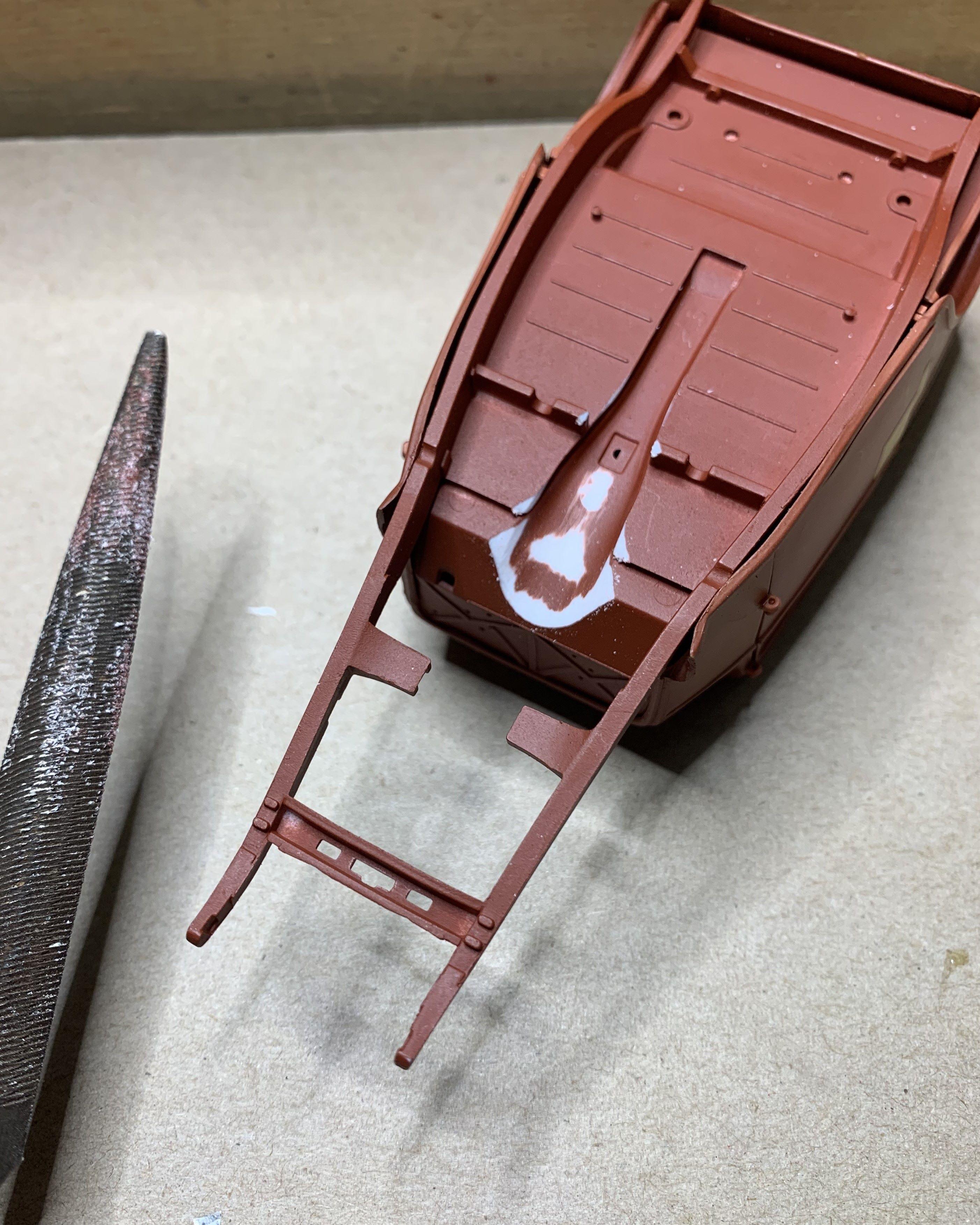

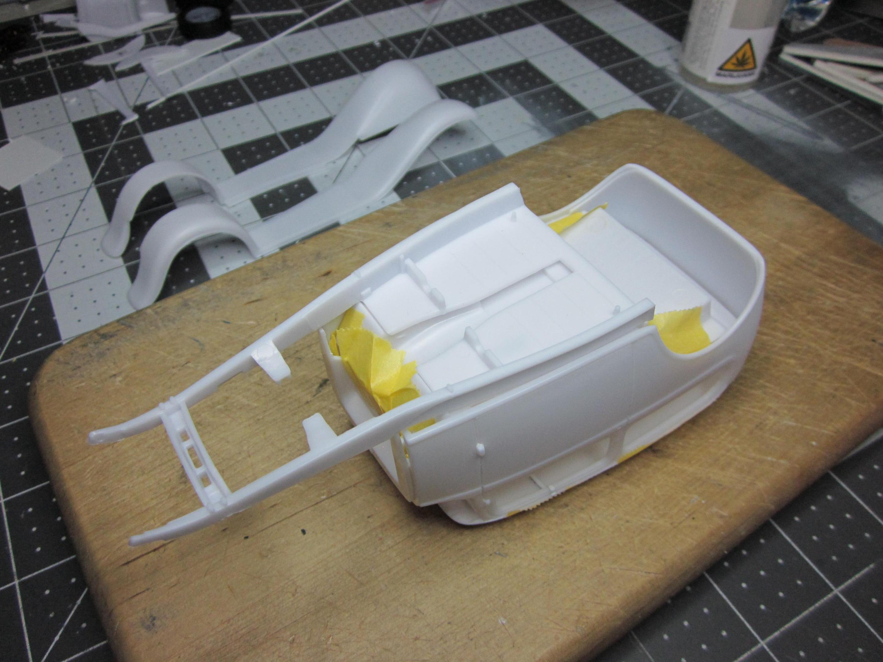

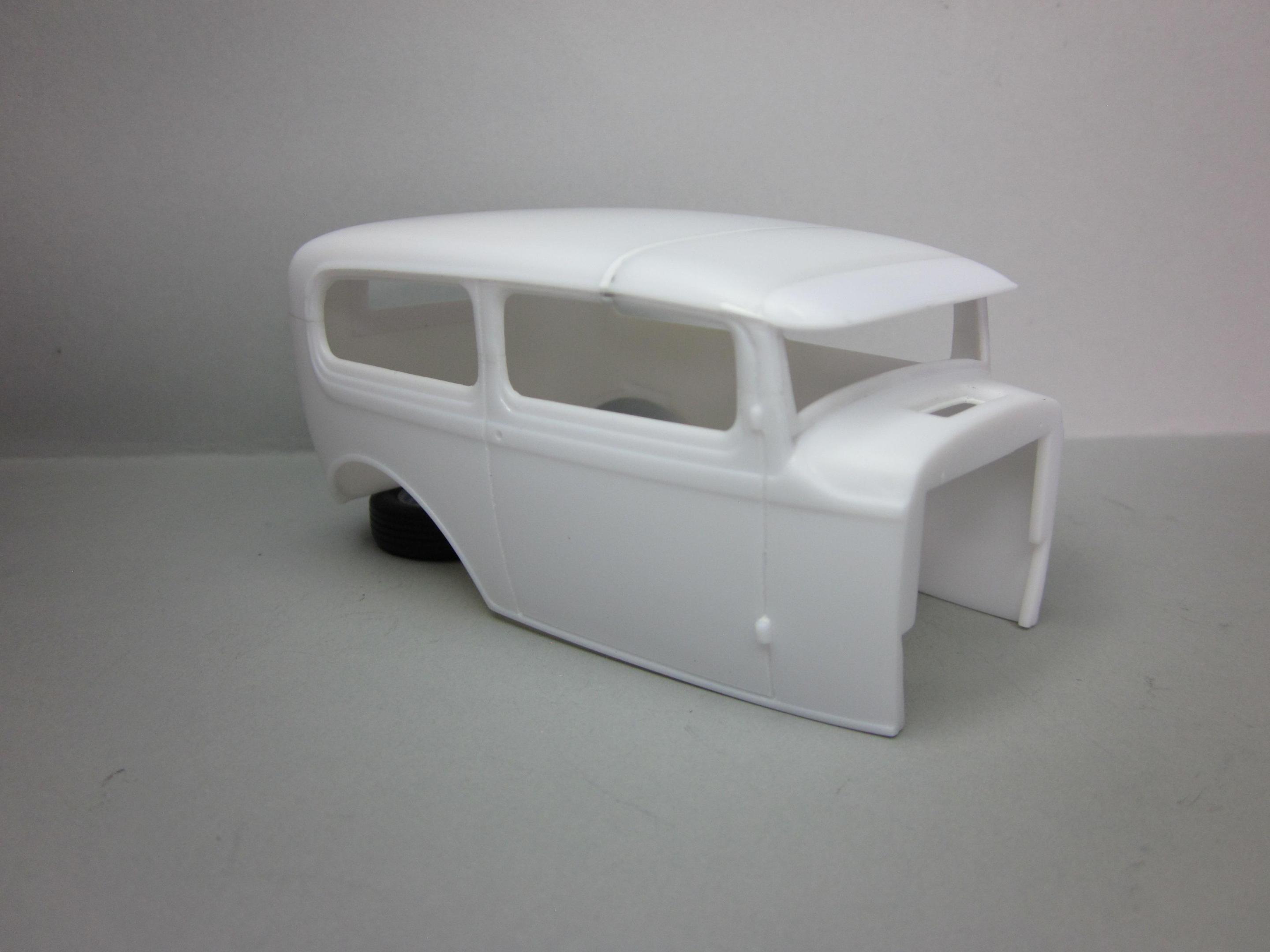

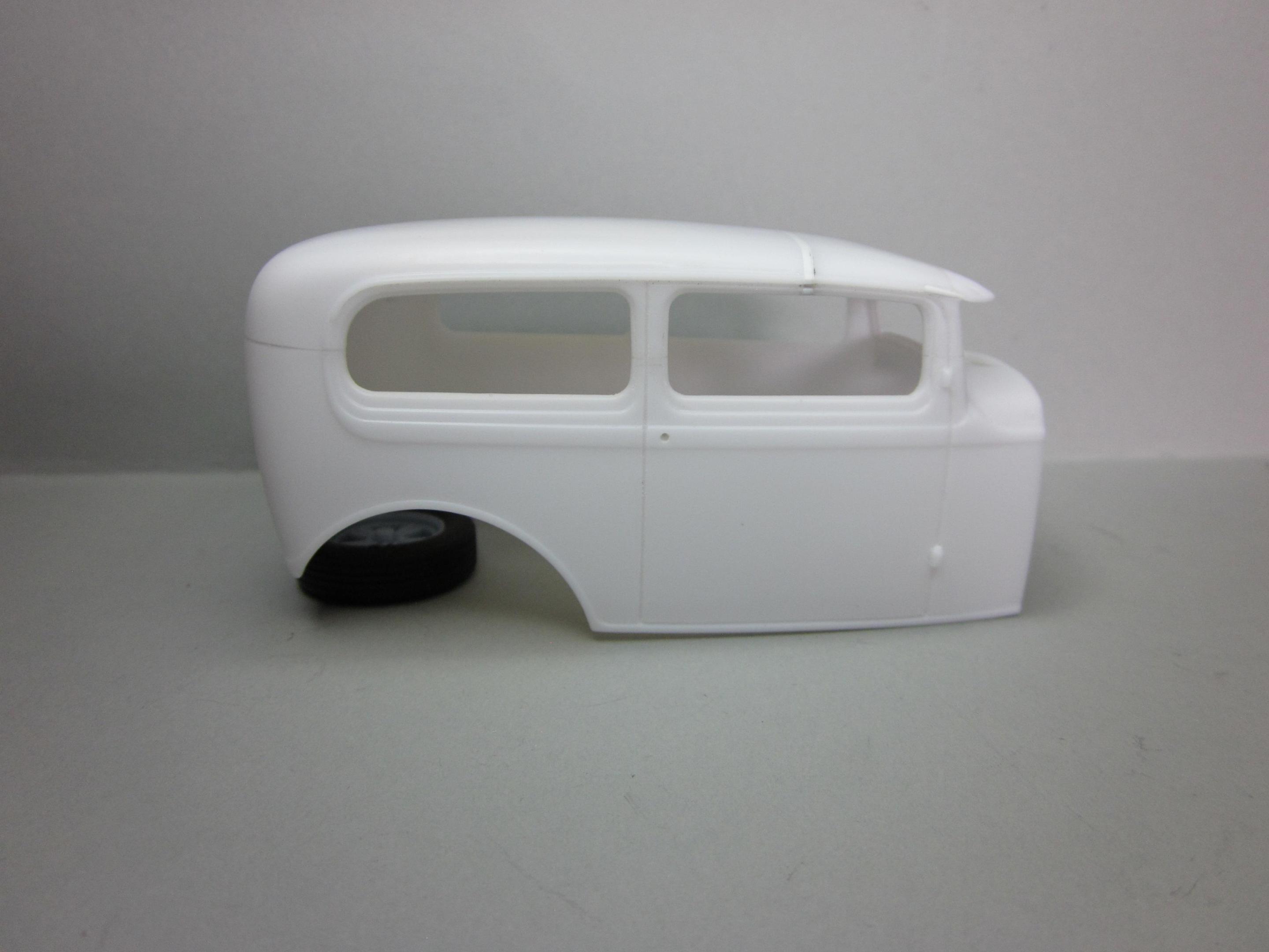

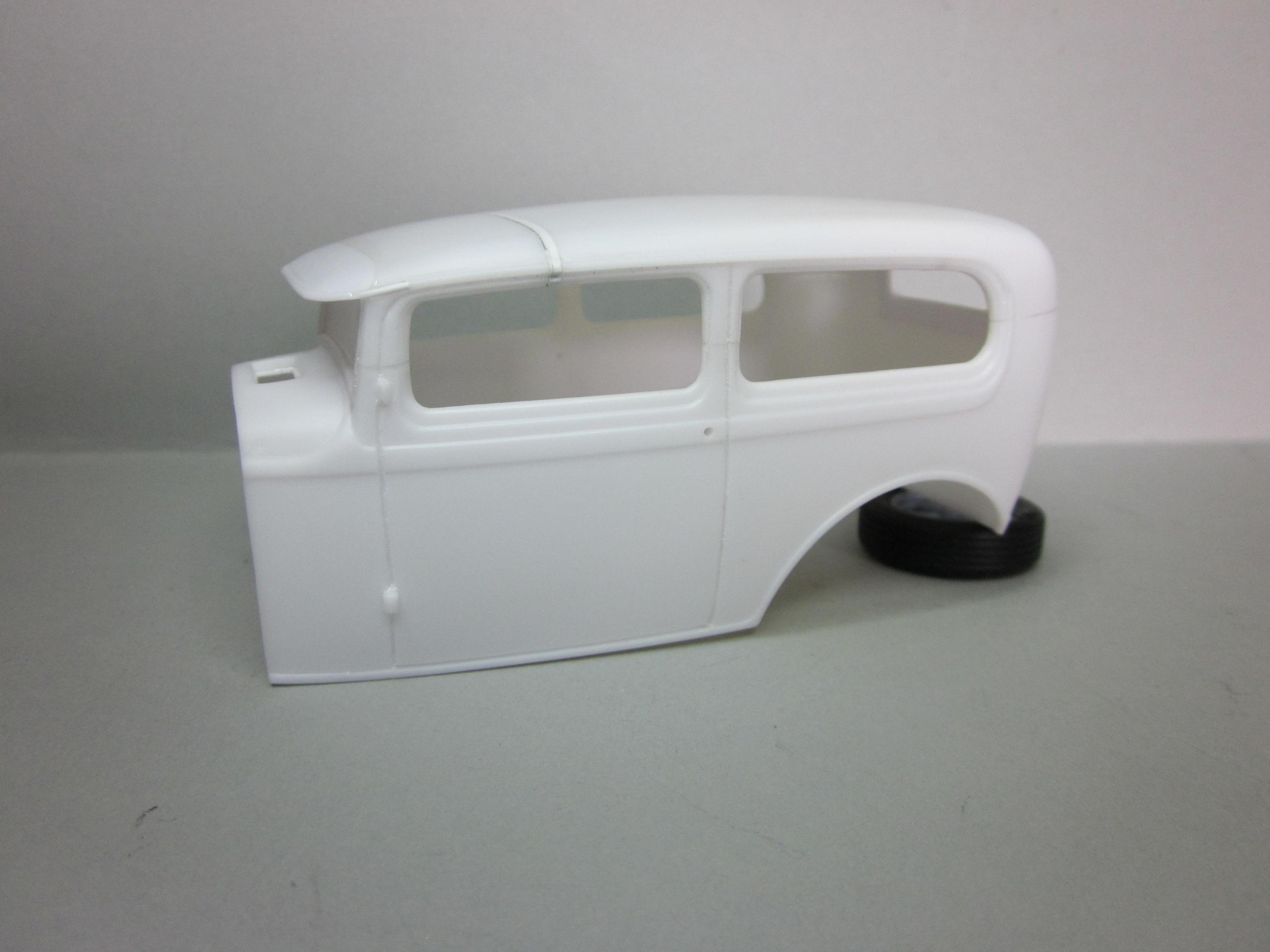

I'll join in the Sedan Build Off with this if I may. It's not really a '32, but I'll use a '32 frame and grille.

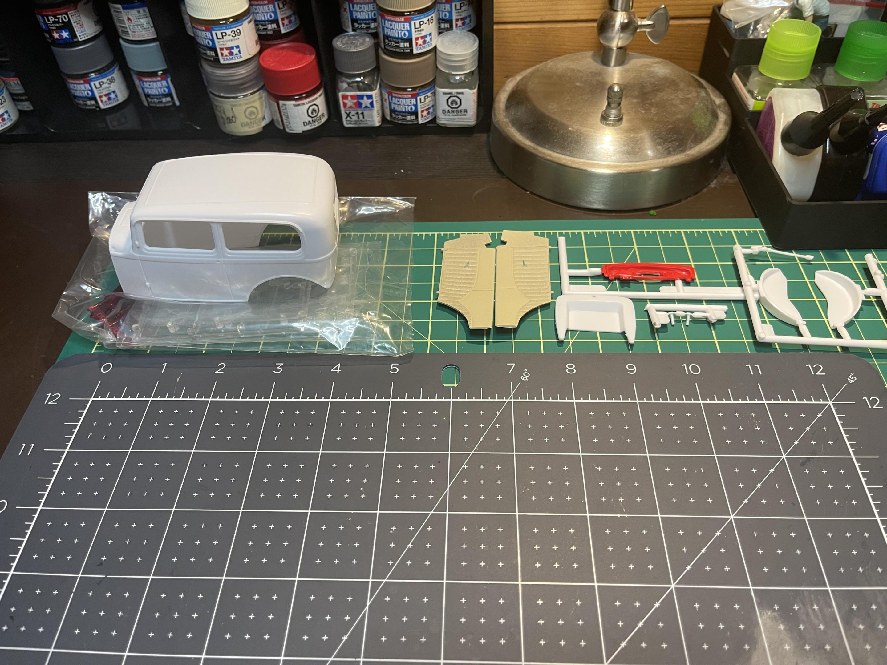

I had this old body, so FIRST, I removed those little rear fenders.
Then I made somewhat of a firewall from styrene sheet and strips.
I removed the fuel tank from a Revell '32 frame.
I fitted some inner rear fenders.
I made a flat rear floor for the sedan, again from styrene sheet.
I cut open a cowl vent hole.
For now it's just sitting in the shop while I work on other projects, waiting to see if it's acceptable for this Build Off.

The old orange crate body looks so cool and I always wondered what it would take to put on a revell 32 frame. Looking forward to your build.

Nice start! I like the new firewall. I see you also removed the insert from the top.

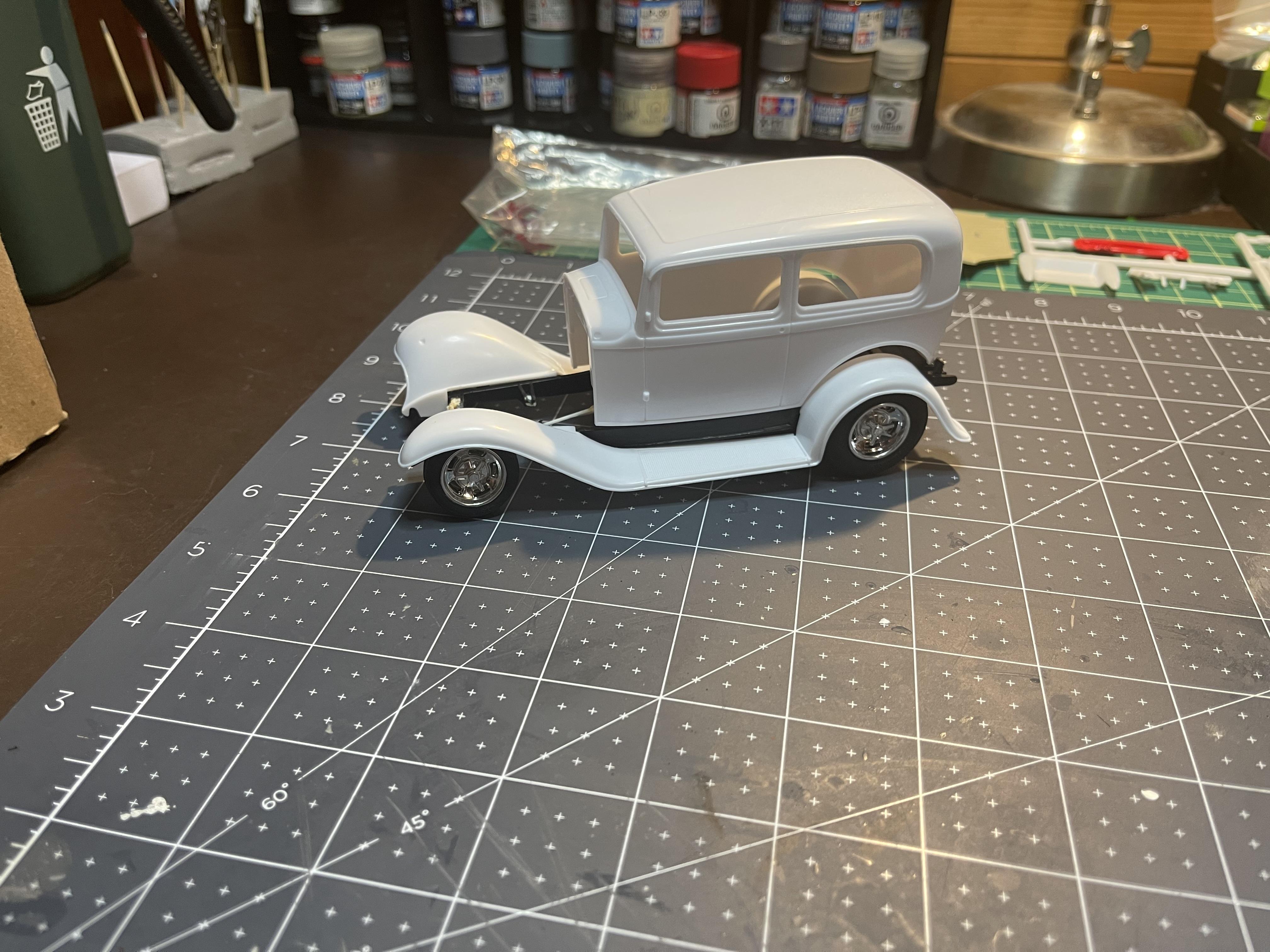

Ok, bench set up is complete and scavengeing has commenced. I had a leftover body from the og issues of the sedan including the windshield frame and glass( lucky to find that stuff). I’ll be pulling parts from the new tool roadster, the og 5 window kit and the stash. Will decide later if it will be fendered, highboy or channelled over the frame. Have to do some more mock up work and source an appropriate engine.
but I’m in!

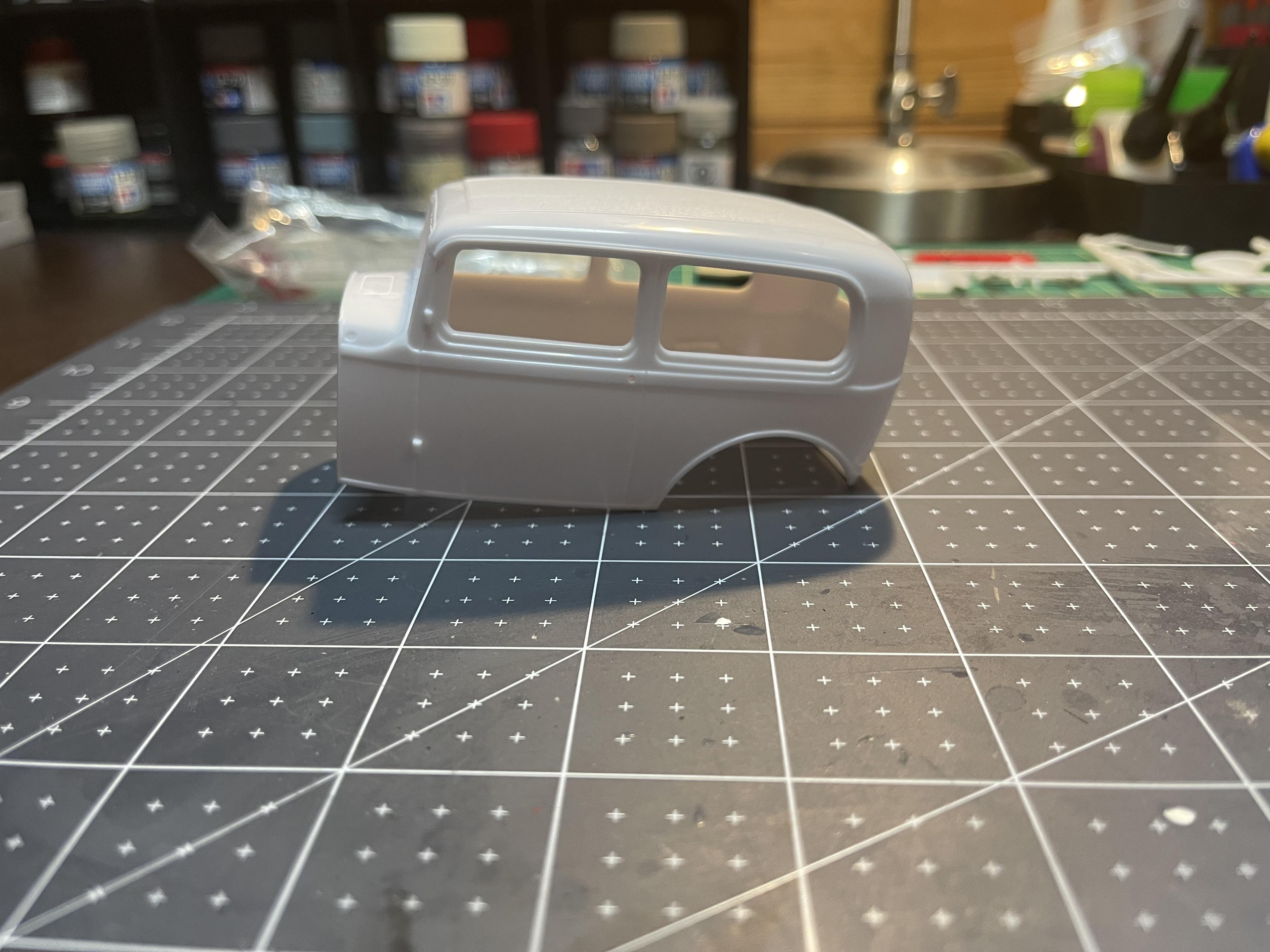

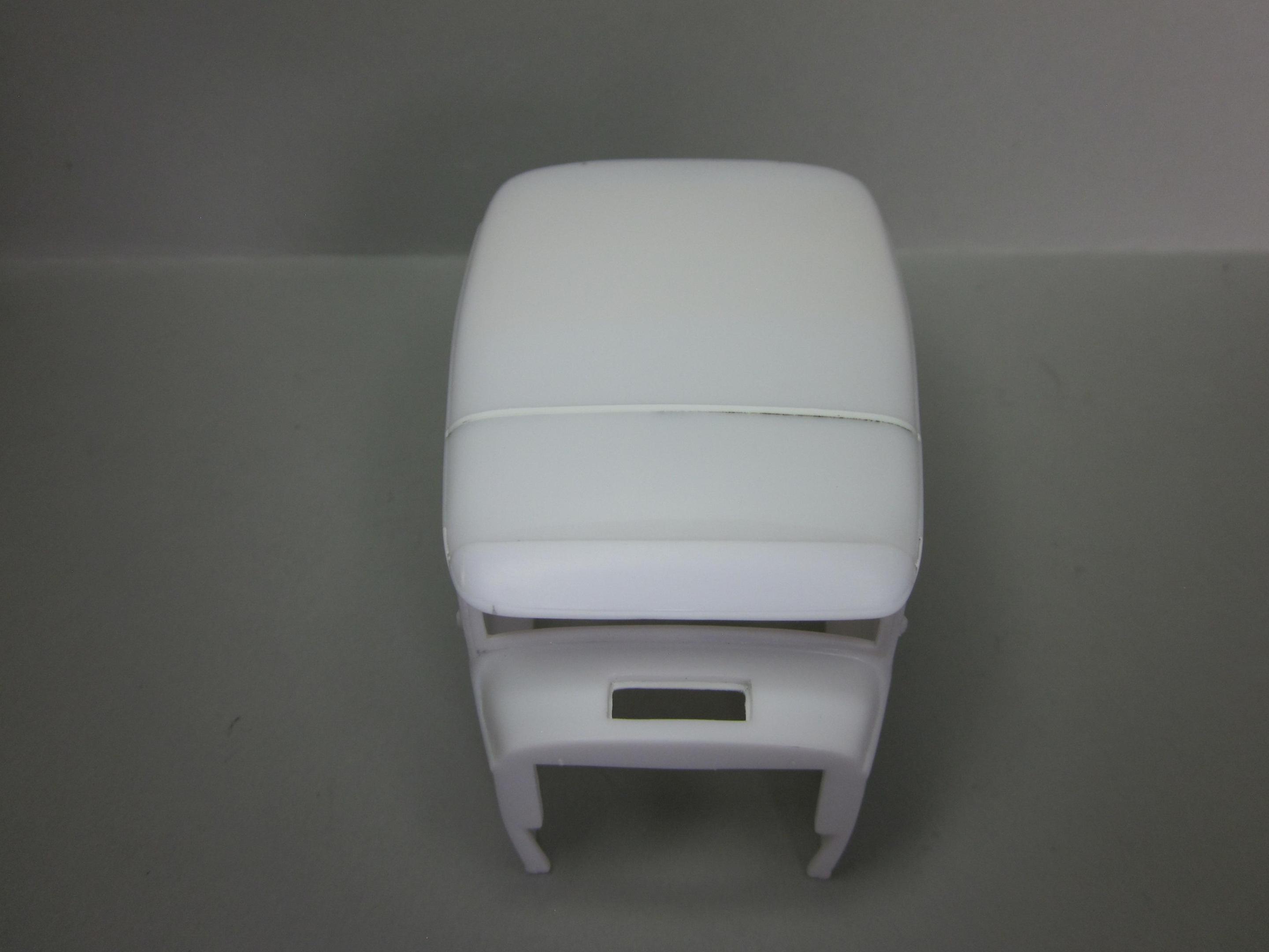

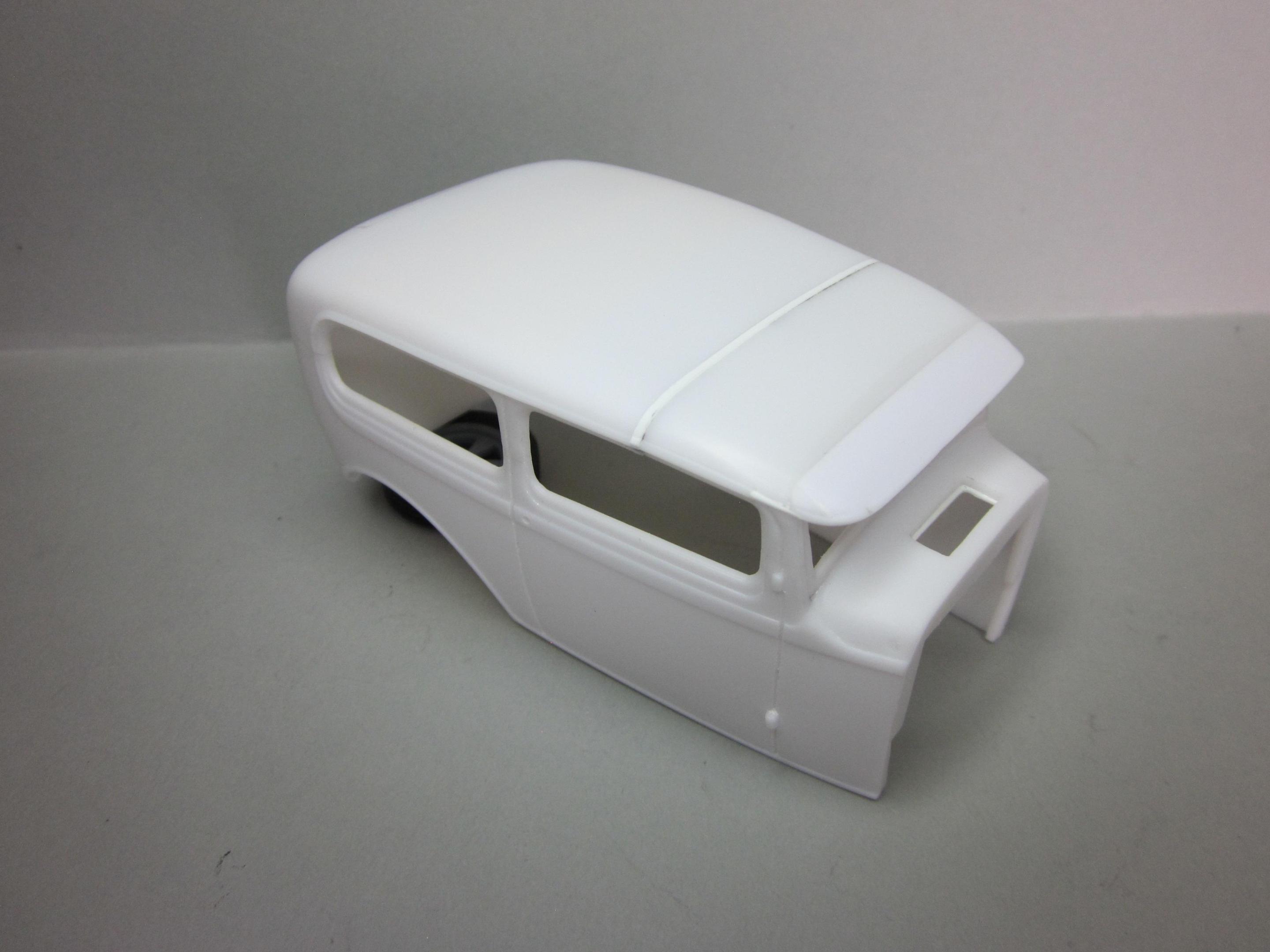

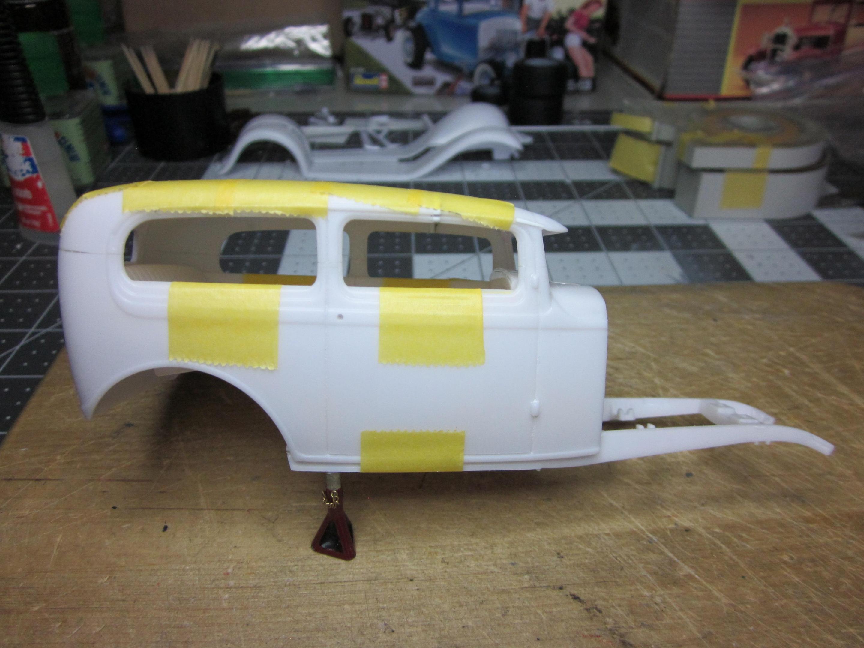

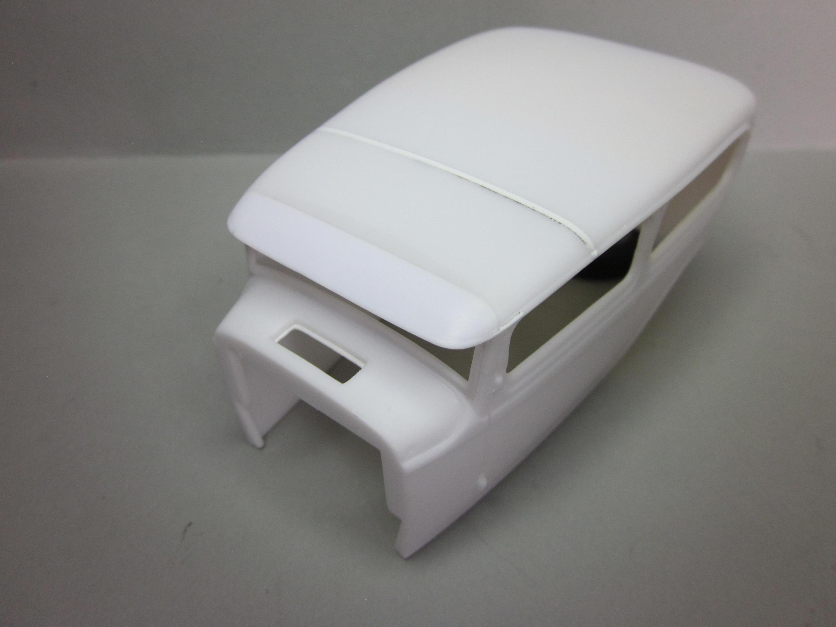

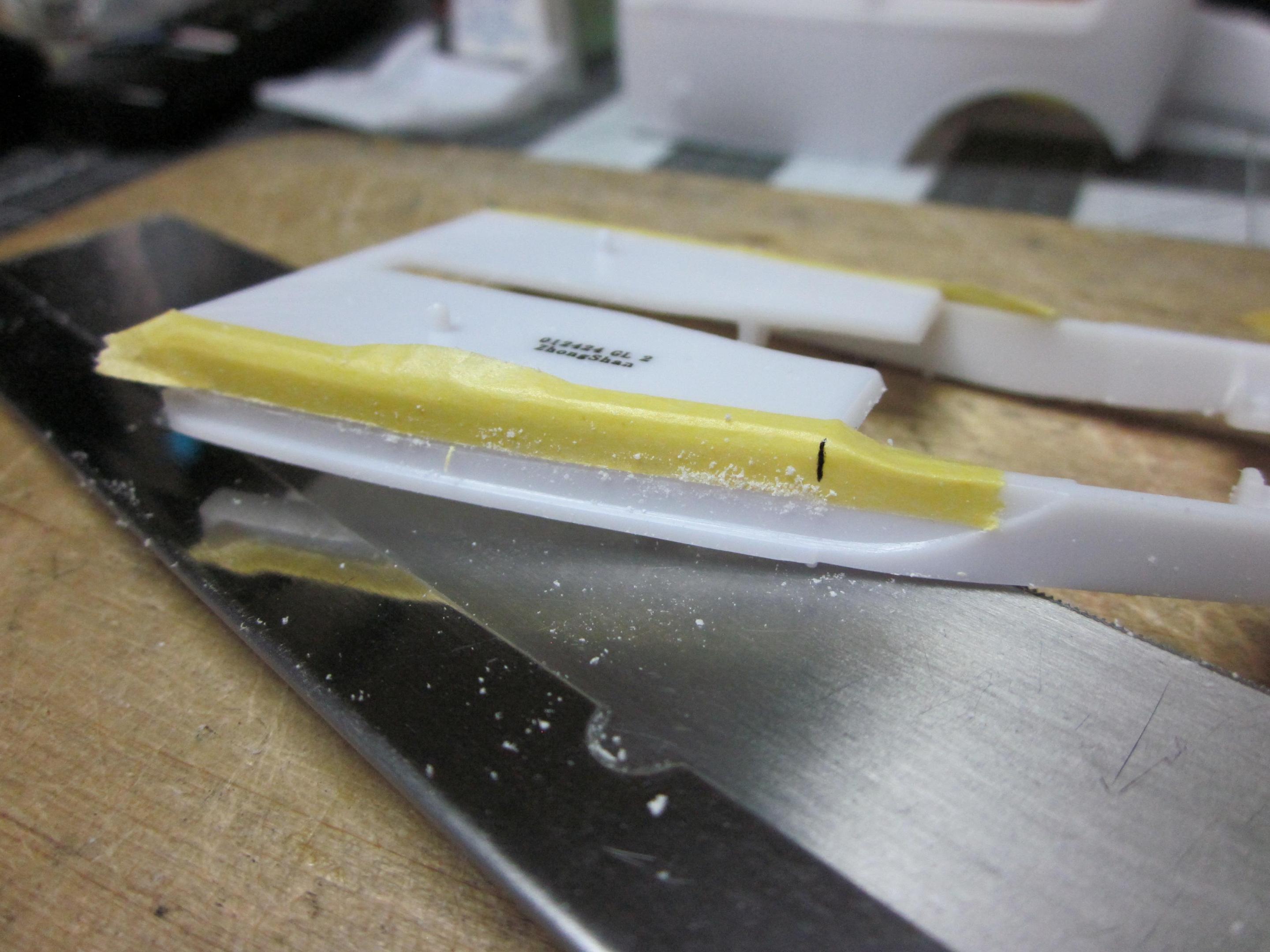

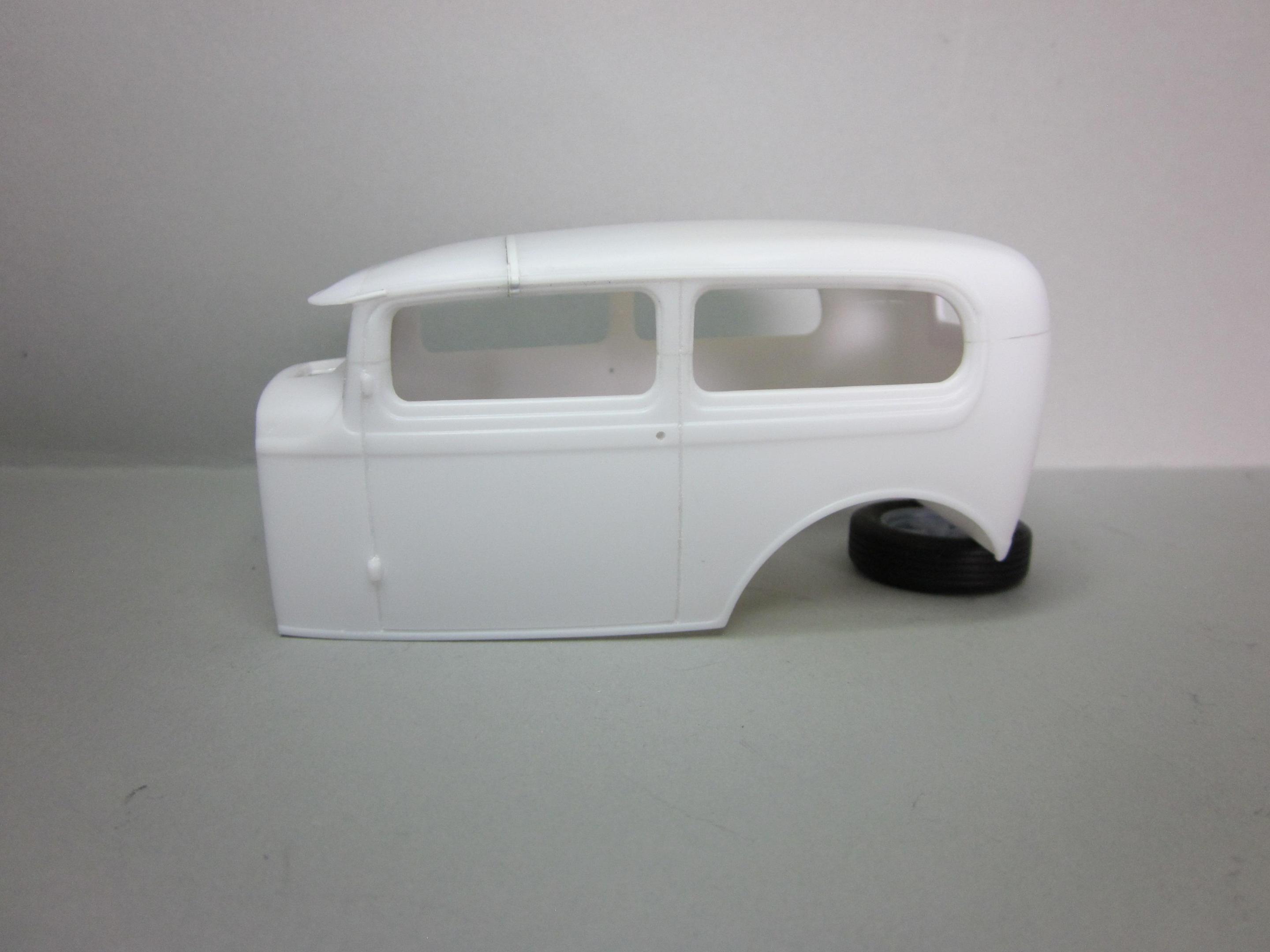

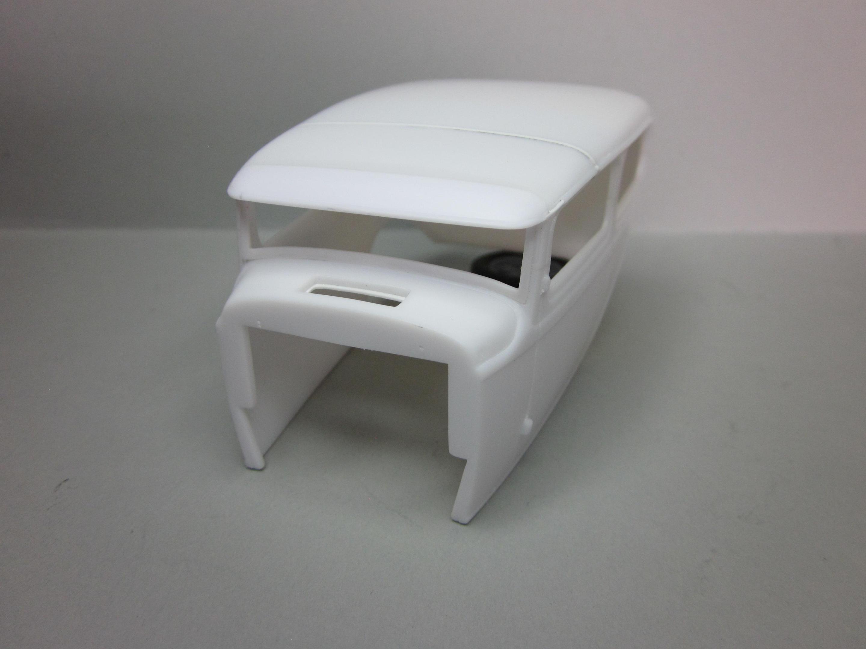

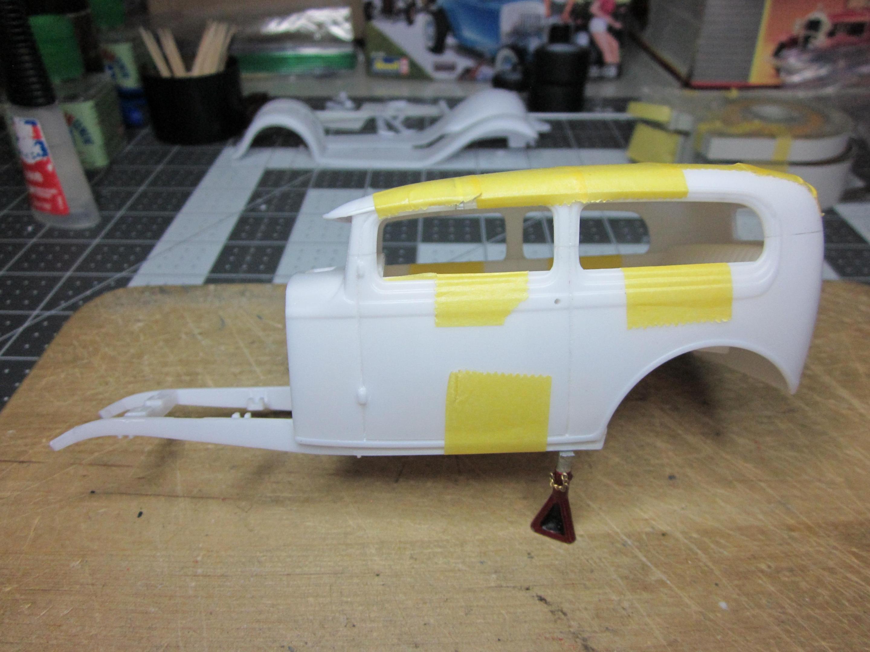

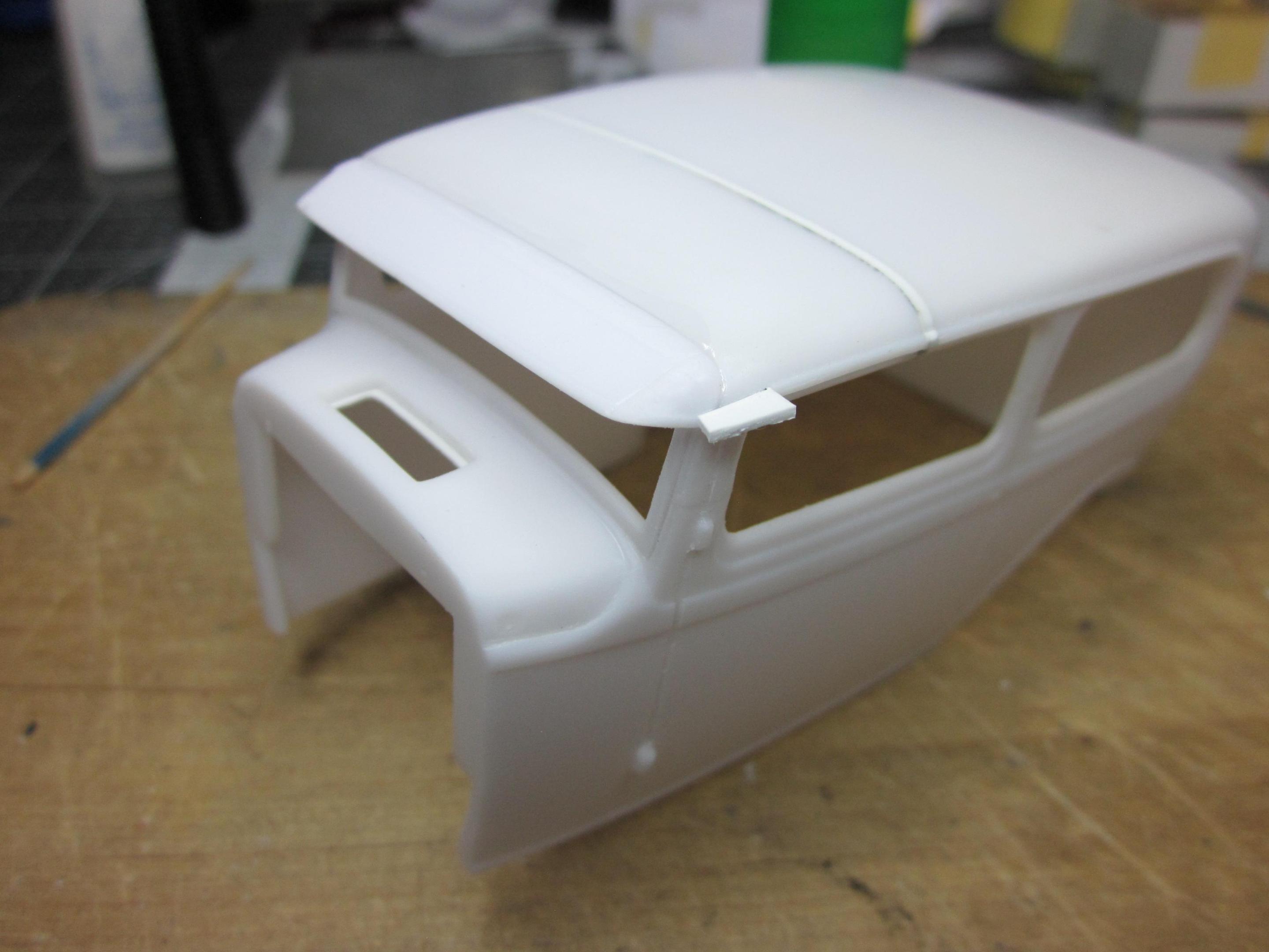

Had a left-over piece from the '30 top I salvaged the back window from. The visor. Was surprised how easily it was to make work. Almost like it was supposed to be there. Had to do a little filling, sanding and blending into the top. Overall, looks ok and was worth the effort.

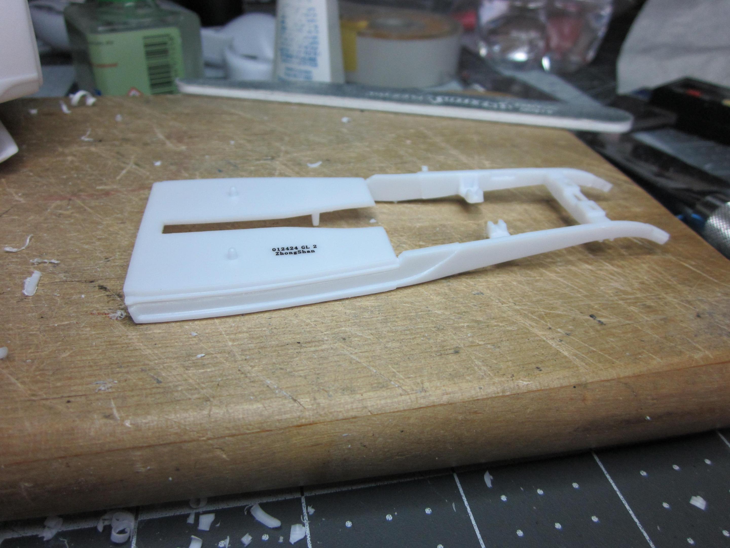

Also started some work on the frame. Decided to channel the body over the frame. What I did was thin down the frame, which in turn made the body look lower. Of course, this brings along a few more areas like the firewall, rear fenders and door panels that will need some work so everything plays nicely together. Didn't want to cover the whole frame from view, just about 3/4's of it.
Till next time....................
  • Like 8

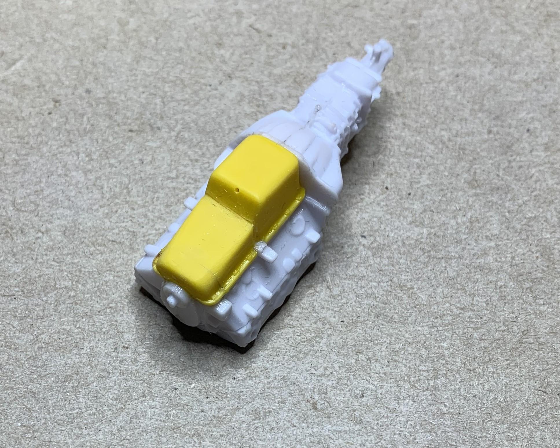

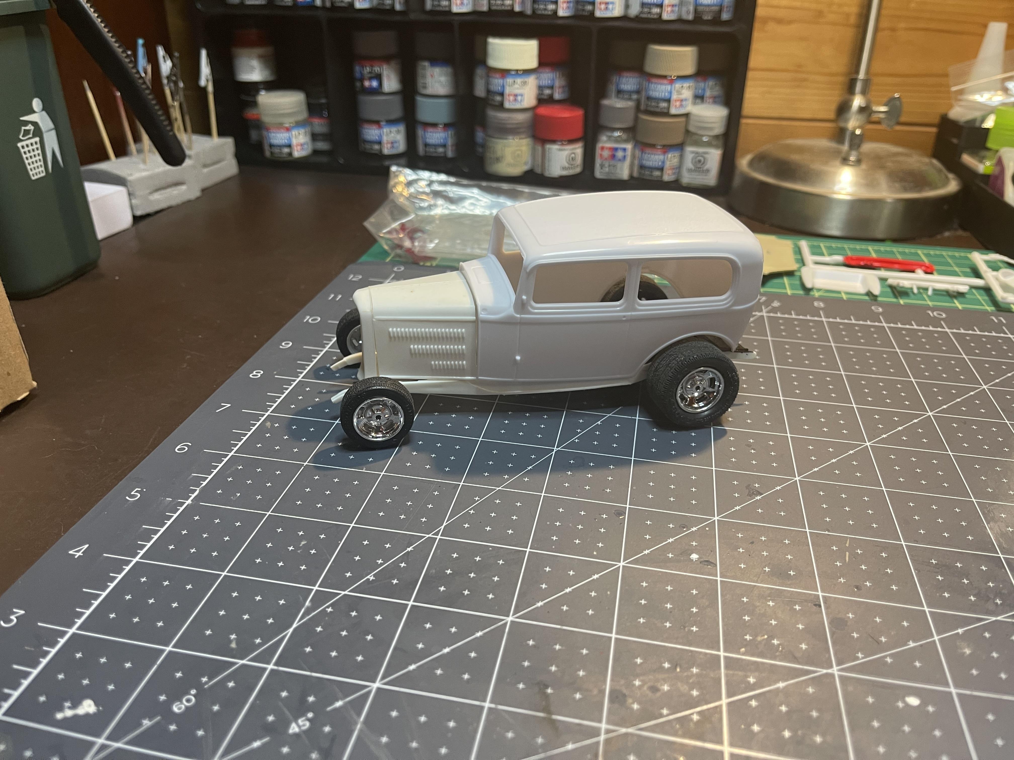

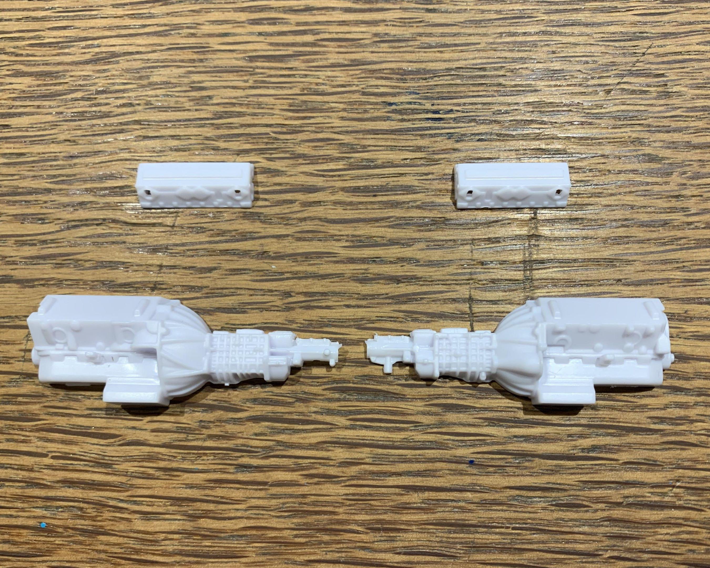

I wanted a small block Chevy in my sedan, old school-ish.
I found this one in the Rat-Roaster kit, but the oil pan was too modern so I took one out of an OLD '55 Chevy kit.
That oil pan had a bump on the top and a pin on the bottom and was too long.
No problem though, I made it fit and kept the side motor mounts. I also drilled for a new drain plug!
After I test fitted it I needed a tiny bit more clearance under my cobbled together parts box build.
Should I keep posting all these pictures of such little progress on this thread or is it too much?
  • Like 7

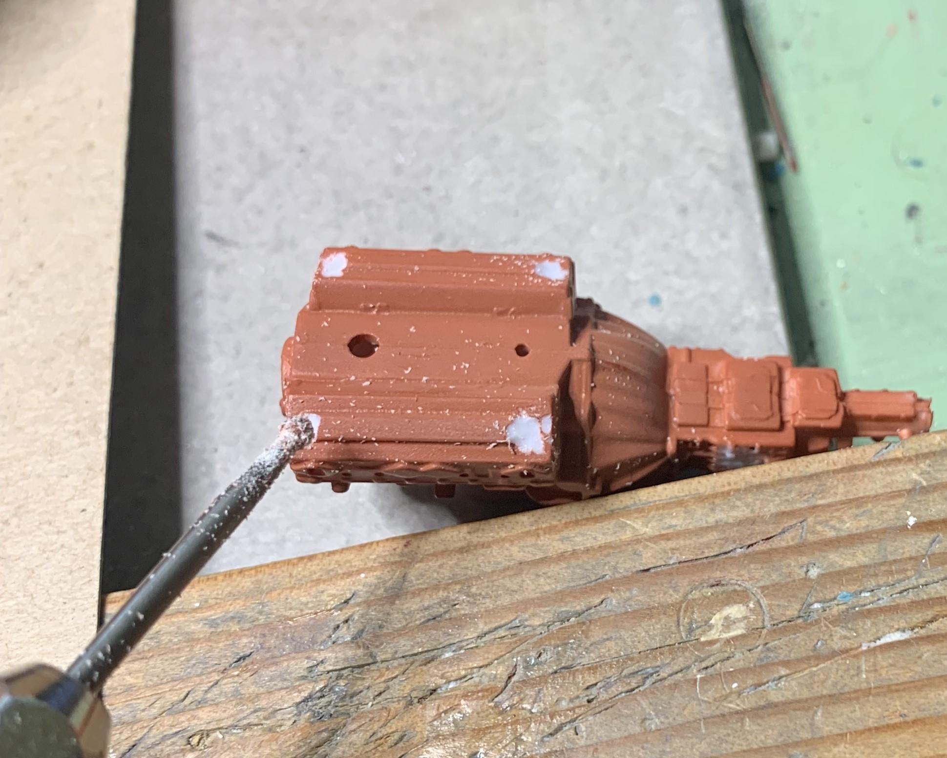

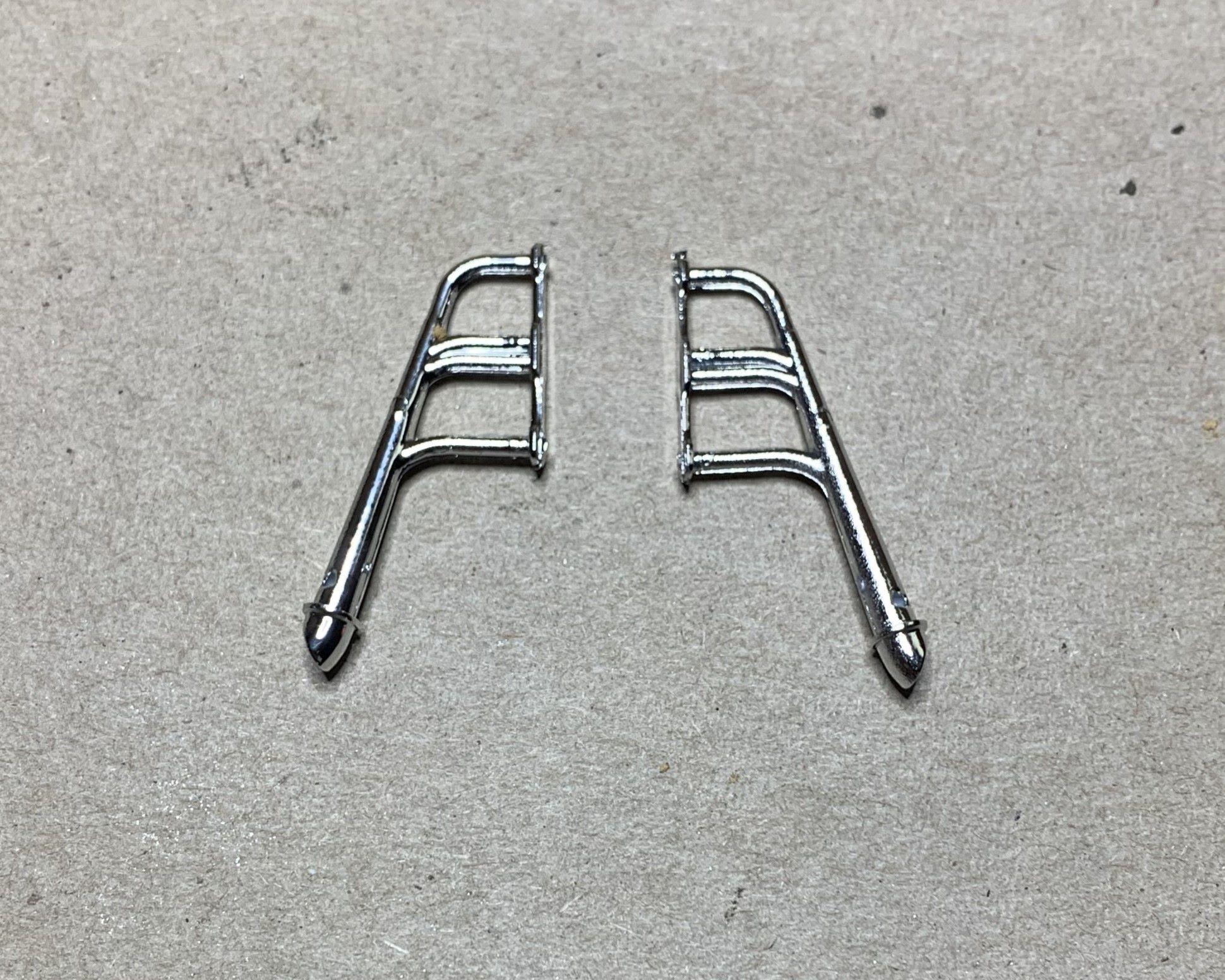

I have these old school finned valve covers with rounded ends, I like those.
The heads have a mounting block that's too long so I used a small grinding burr to make the valve covers fit.
The '29 Model A Roadster Revell kit's triple carb intake also needed the mounting block removed.

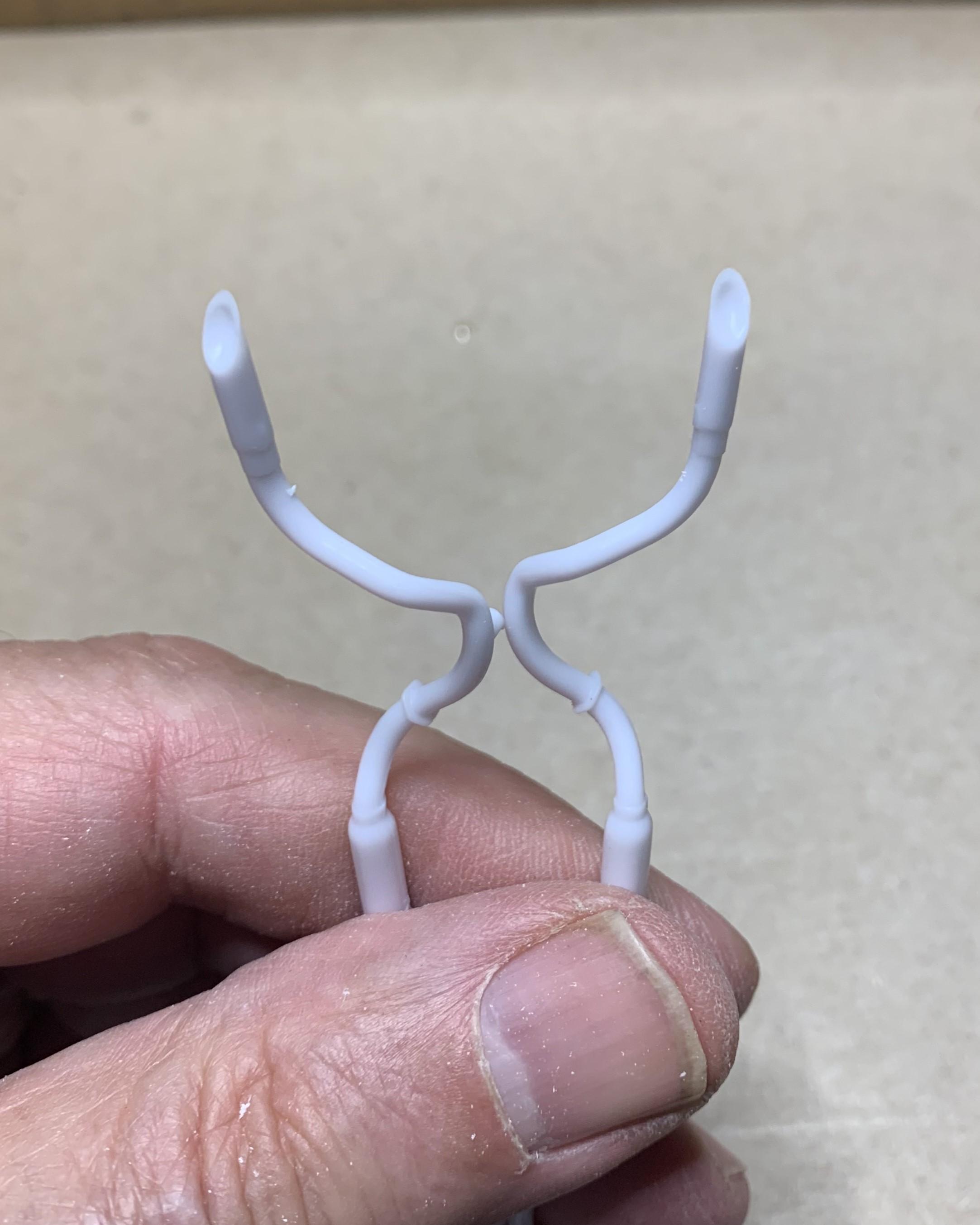

Headers from the '32 Ford Roadster Revell kit won't stay chrome and I've drilled out the ends.

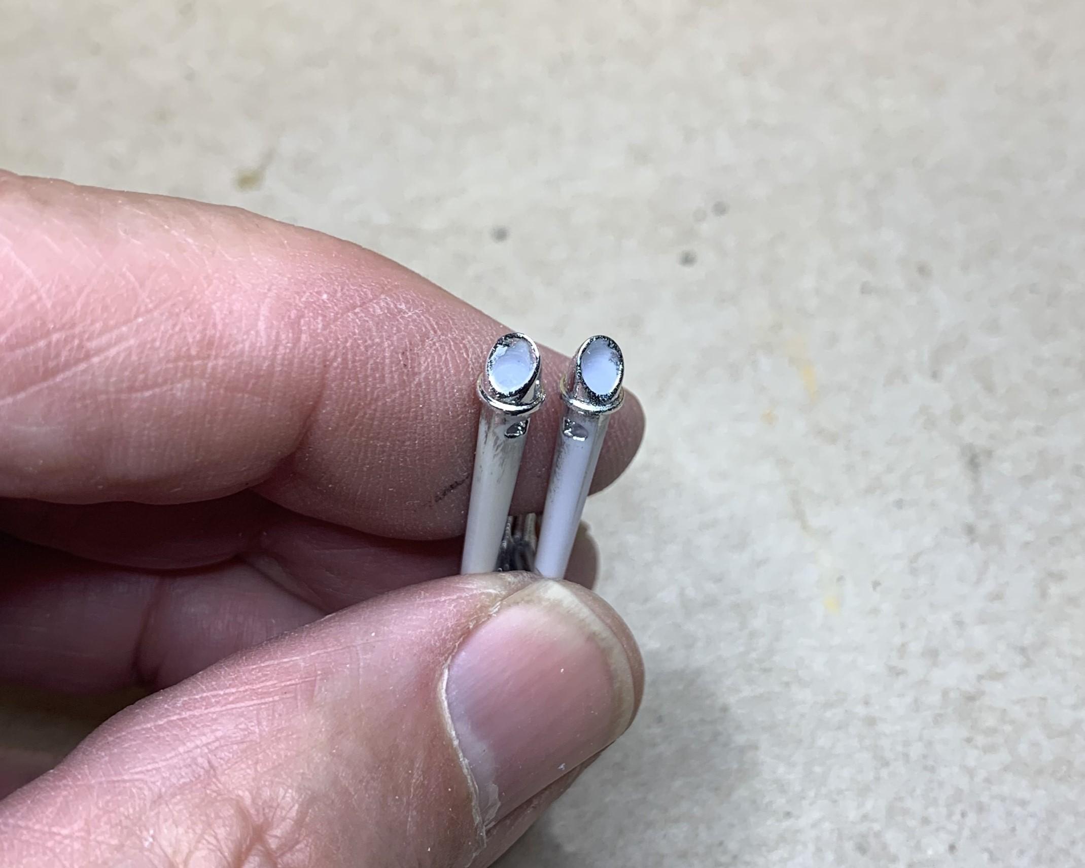

Exhaust pipes and mufflers also from that '32 Ford Roadster kit, and I drilled out those ends as well.
I'm having so much fun with this thing, even though I still don't know what it'll look like!
Building as I go with parts I can find on hand.
Edited by dino246gt
  • Like 5

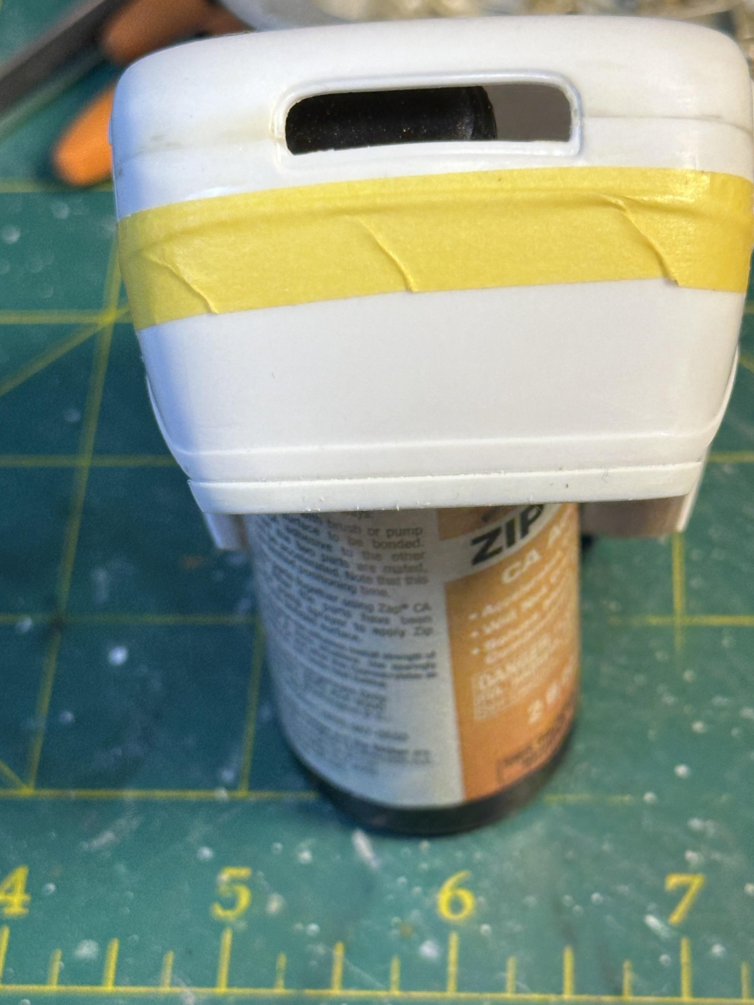

I have worked on the rolled pan and rather than have a big wide slab I have created another moulding to break things up a bit

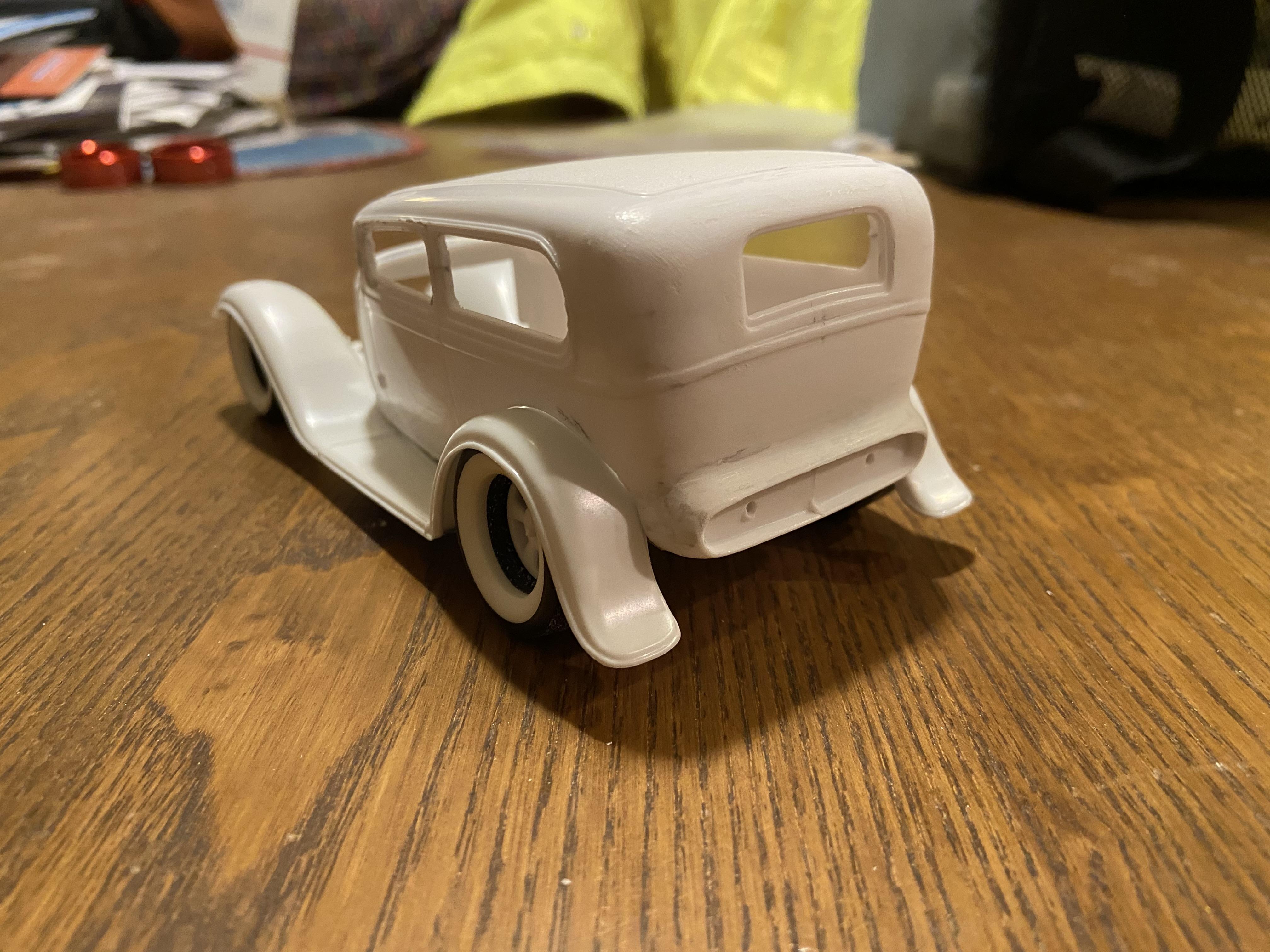

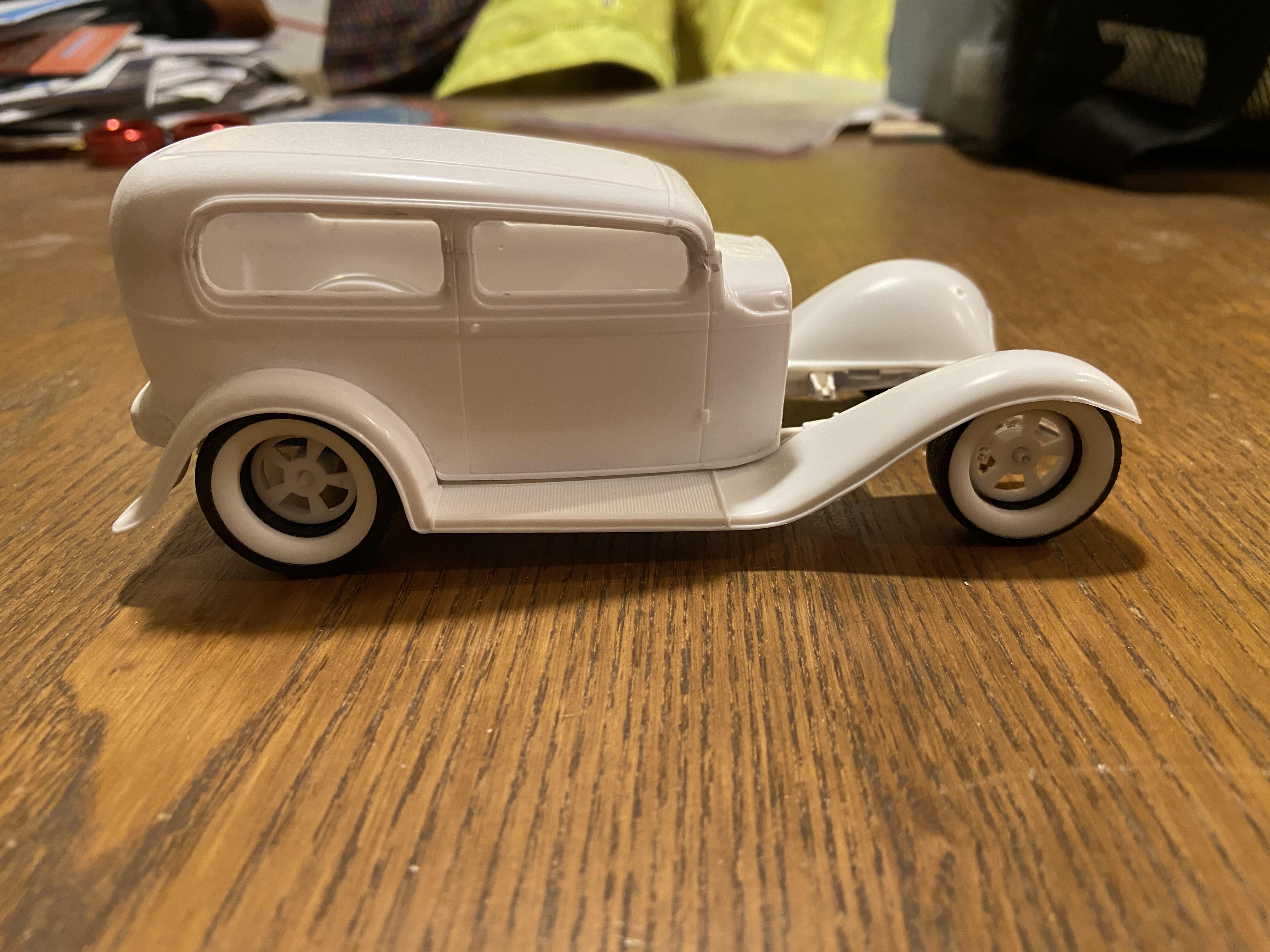

Here is my update. I have filled the cut seams with 3M glazing buddy and now it’s time to send this stuff off and reestablish lines and door lines. I’m definitely taking an early 60s show car look to this with the rear pan. Time for some primer and then some more sanding.
  • Like 6
