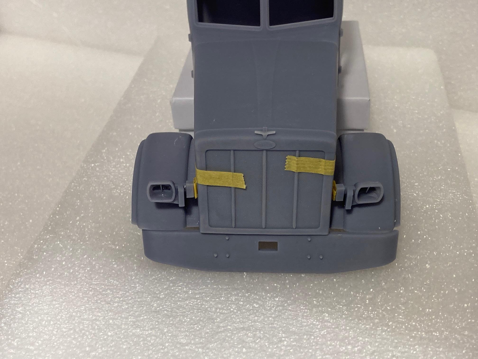

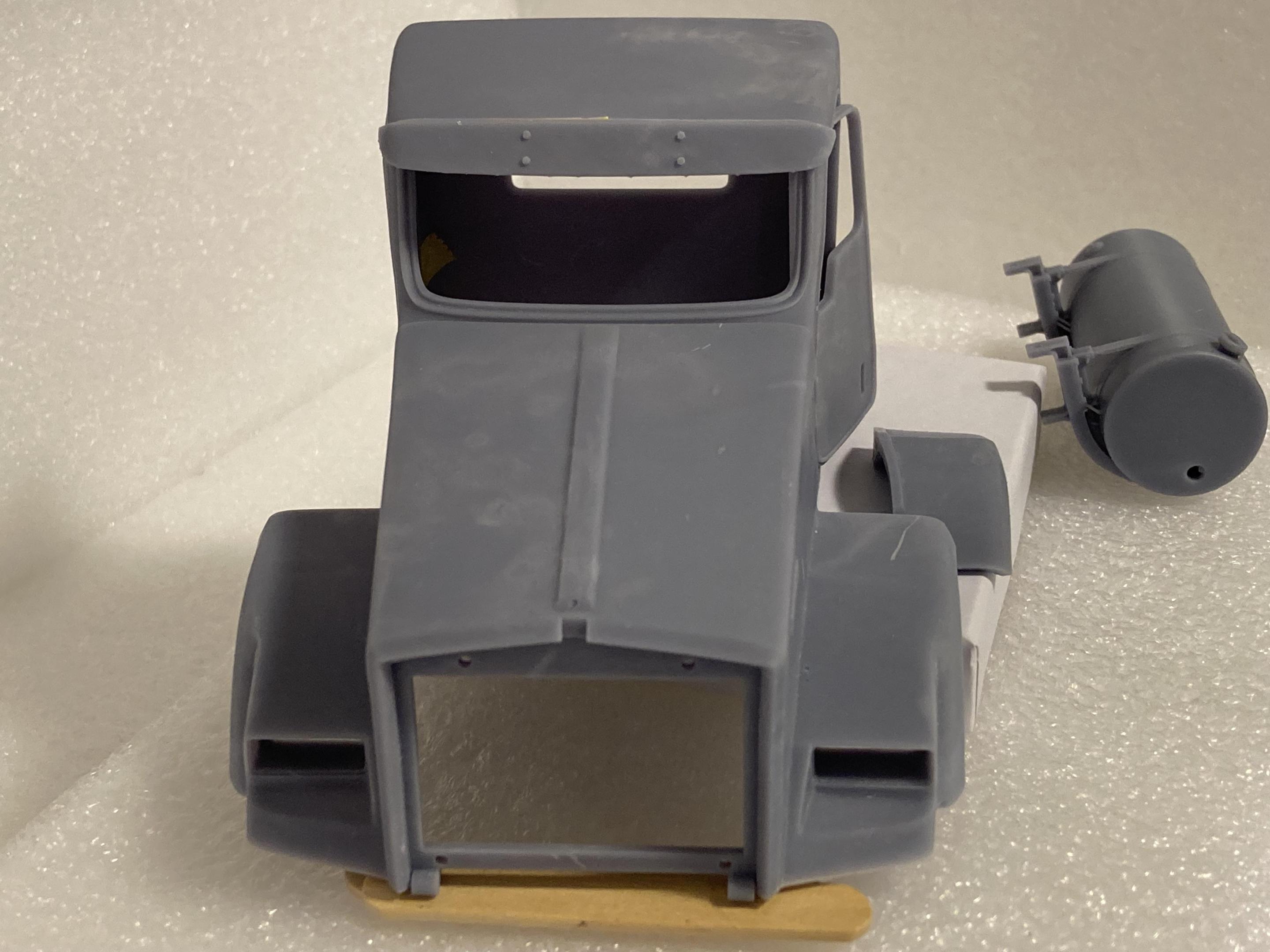

Below is my print of a Peterbilt 367 (held together with tape) as it comes raw out of the printer with no sanding etc. in 1/25 scale. Time to print is 5 hours, cost is about 5 dollars in resin. There are a wide variety of well detailed cabs available - I'll post some more. This file comes with interior, filters, fuel tanks and "glass". No engine/frame/running gear - need donors for that.

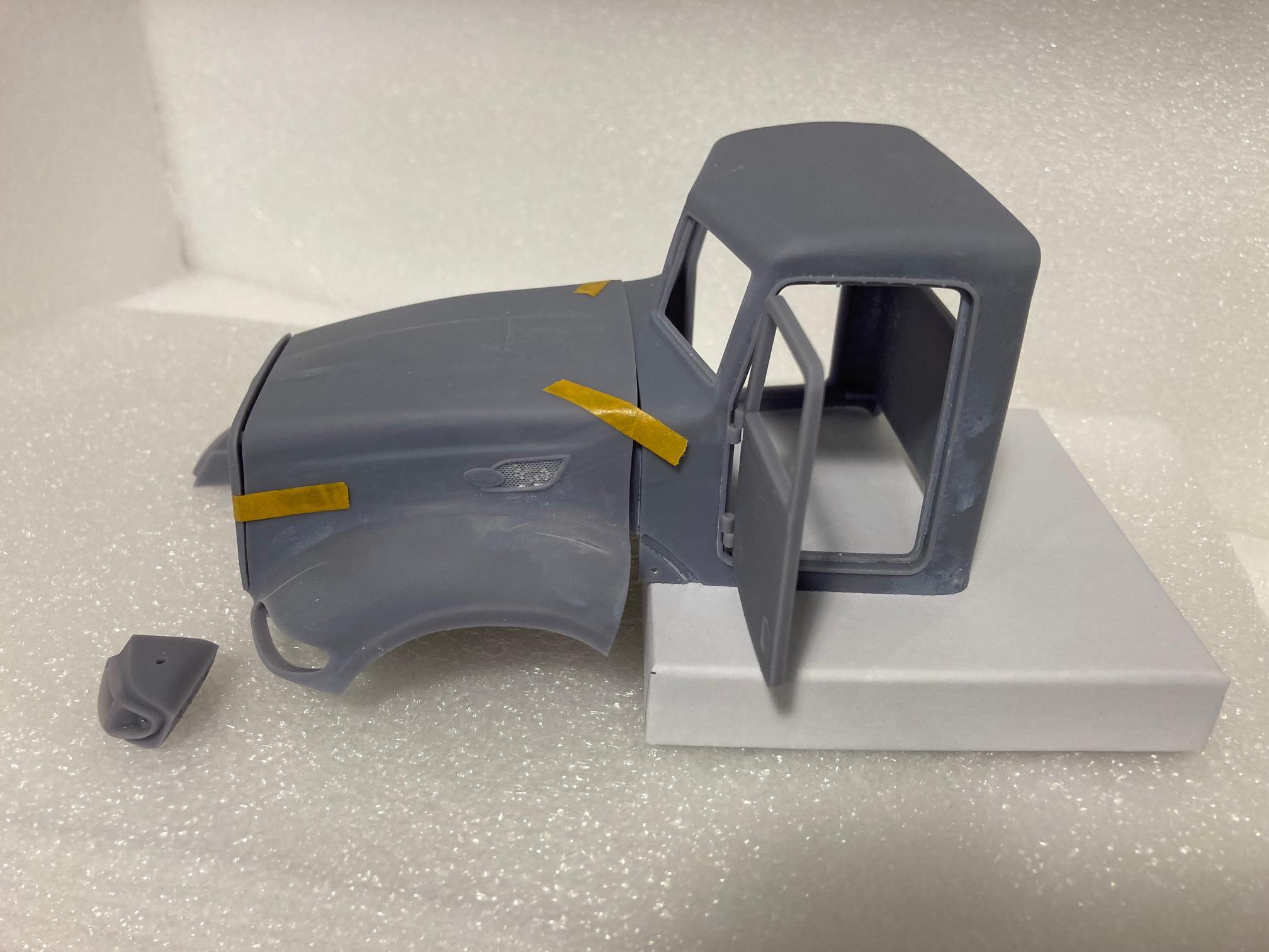

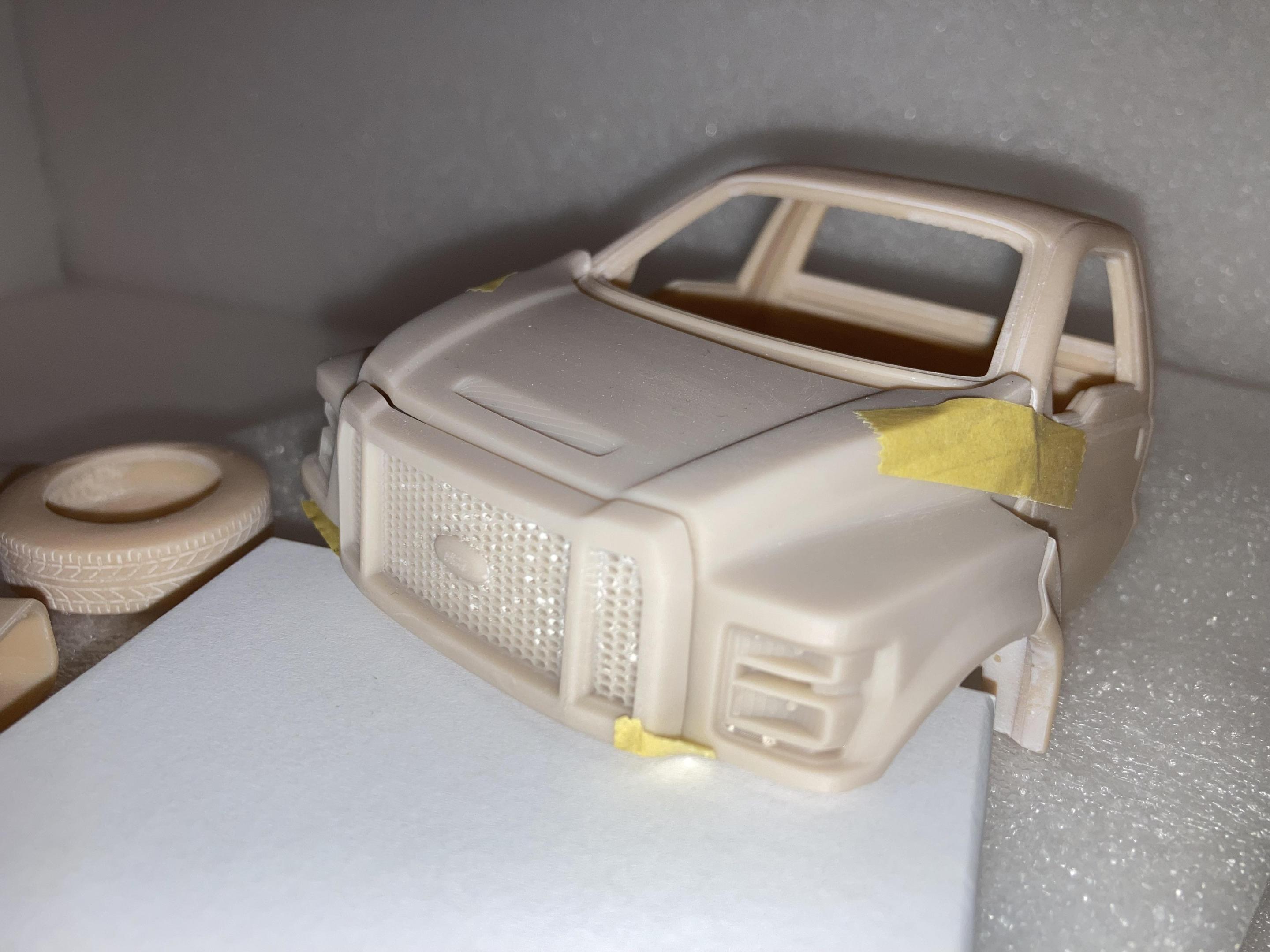

Below are my prints of a Peterbilt 386 in 1/25 scale. Want models of new, modern trucks? There's lots! This is only a partial print of the files - not shown are 'glass' , fuel tanks, bumpers, air filters etc. Requires engine and frame/running gear donor. Time to print about 5 hours - cost five dollars in resin.

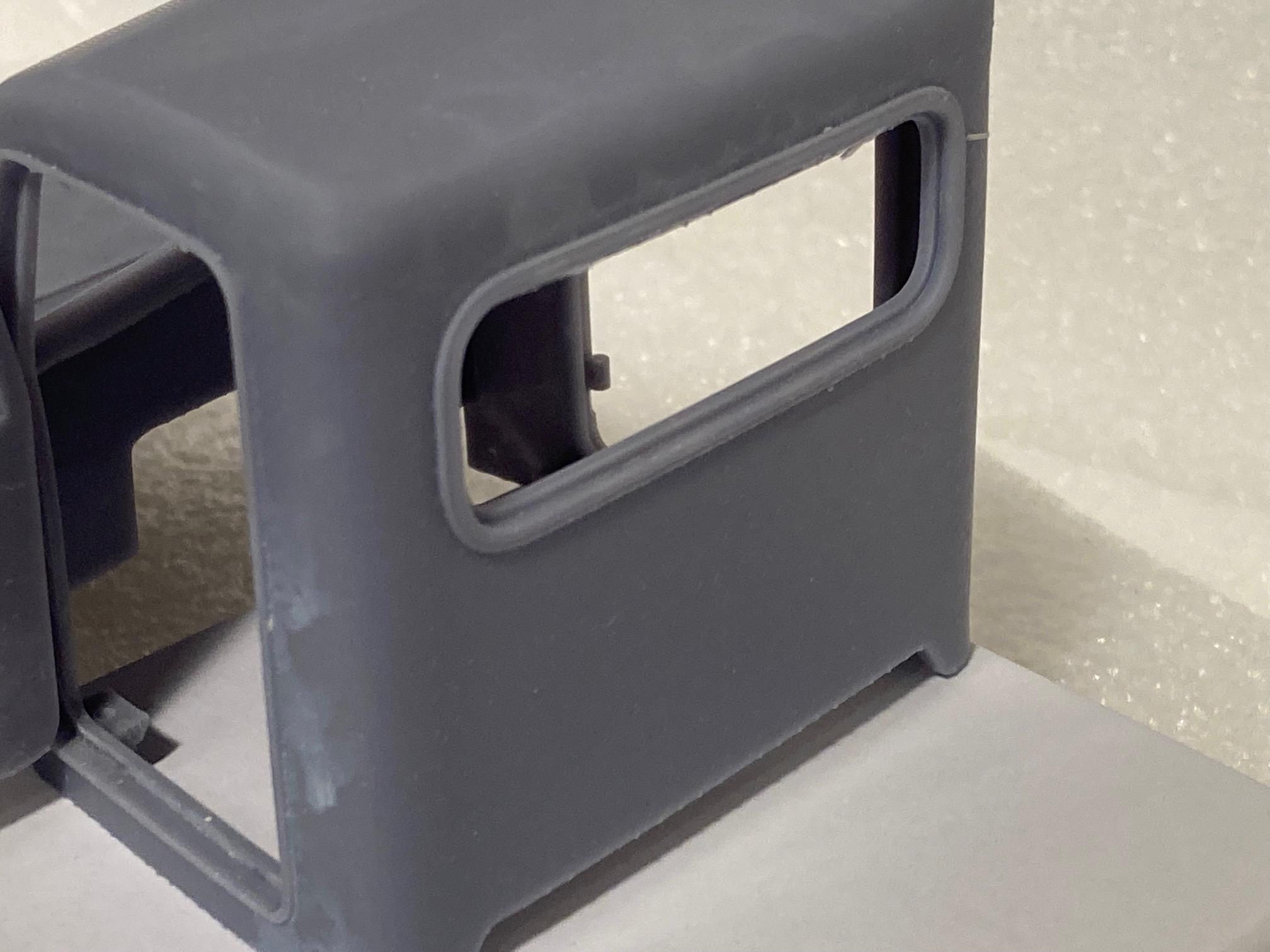

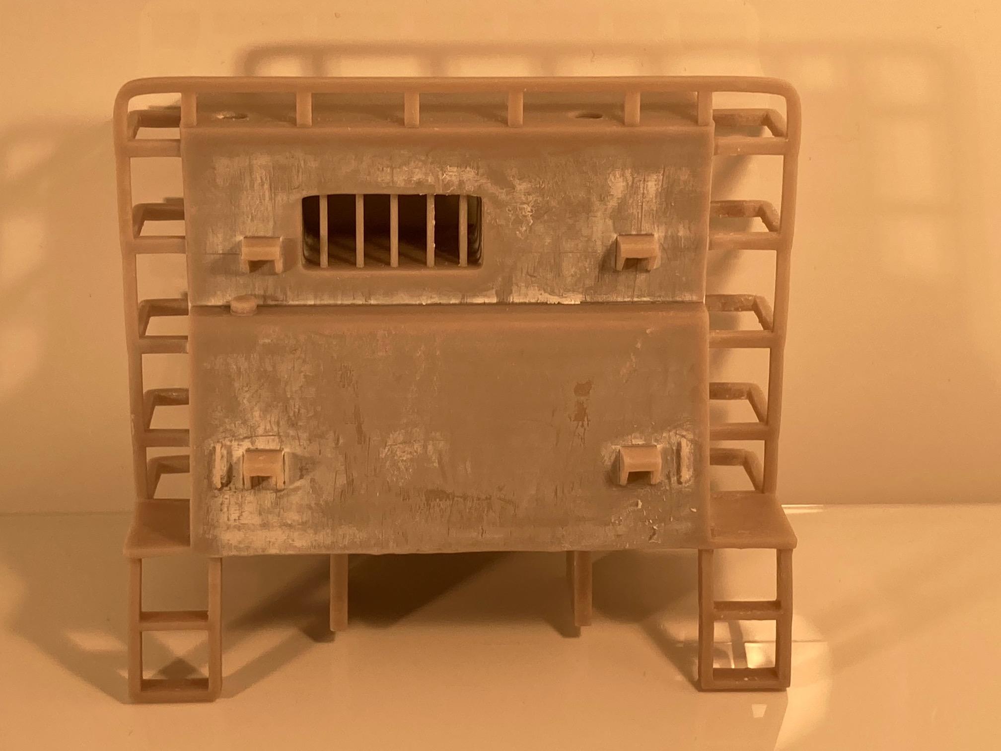

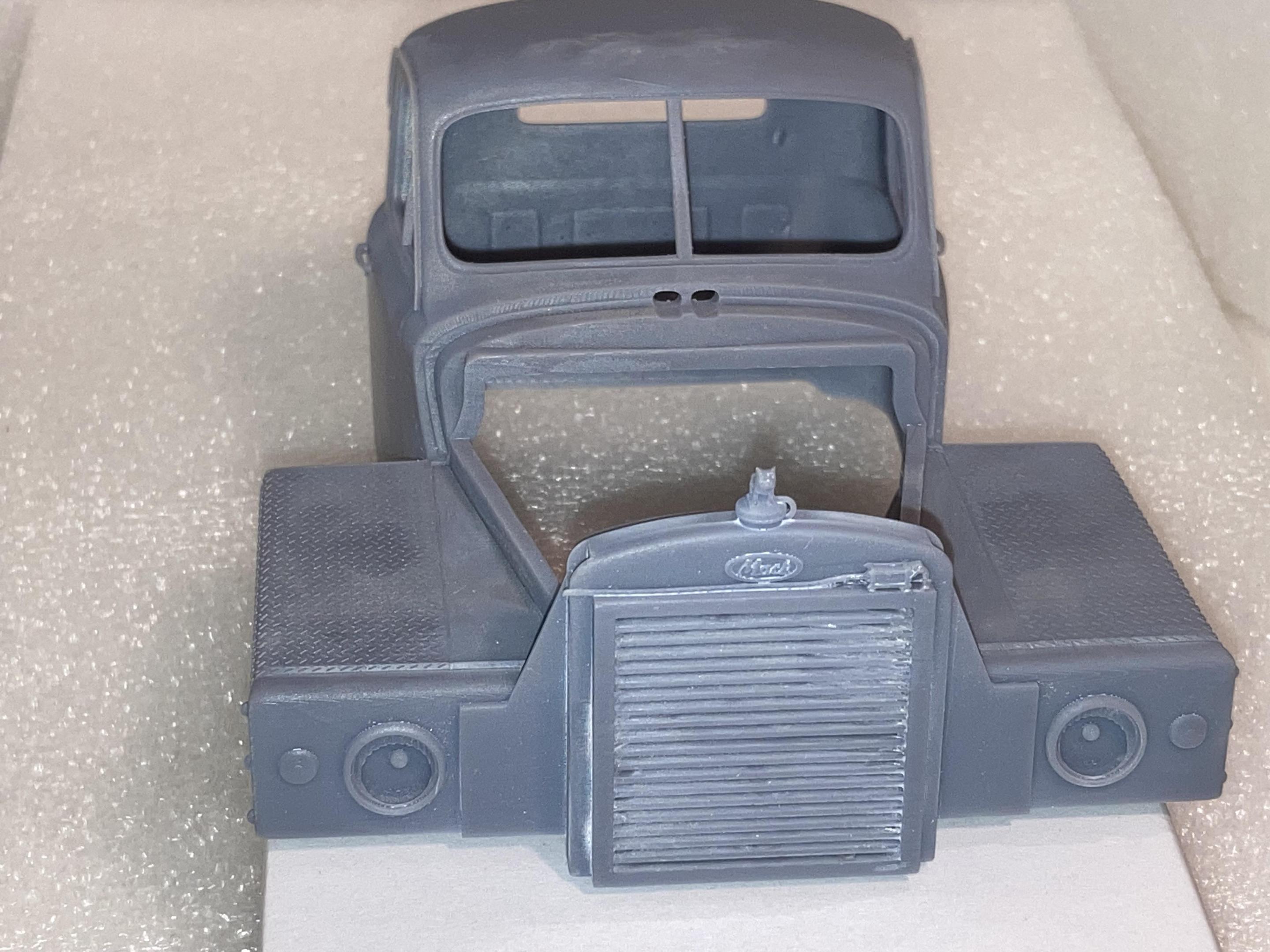

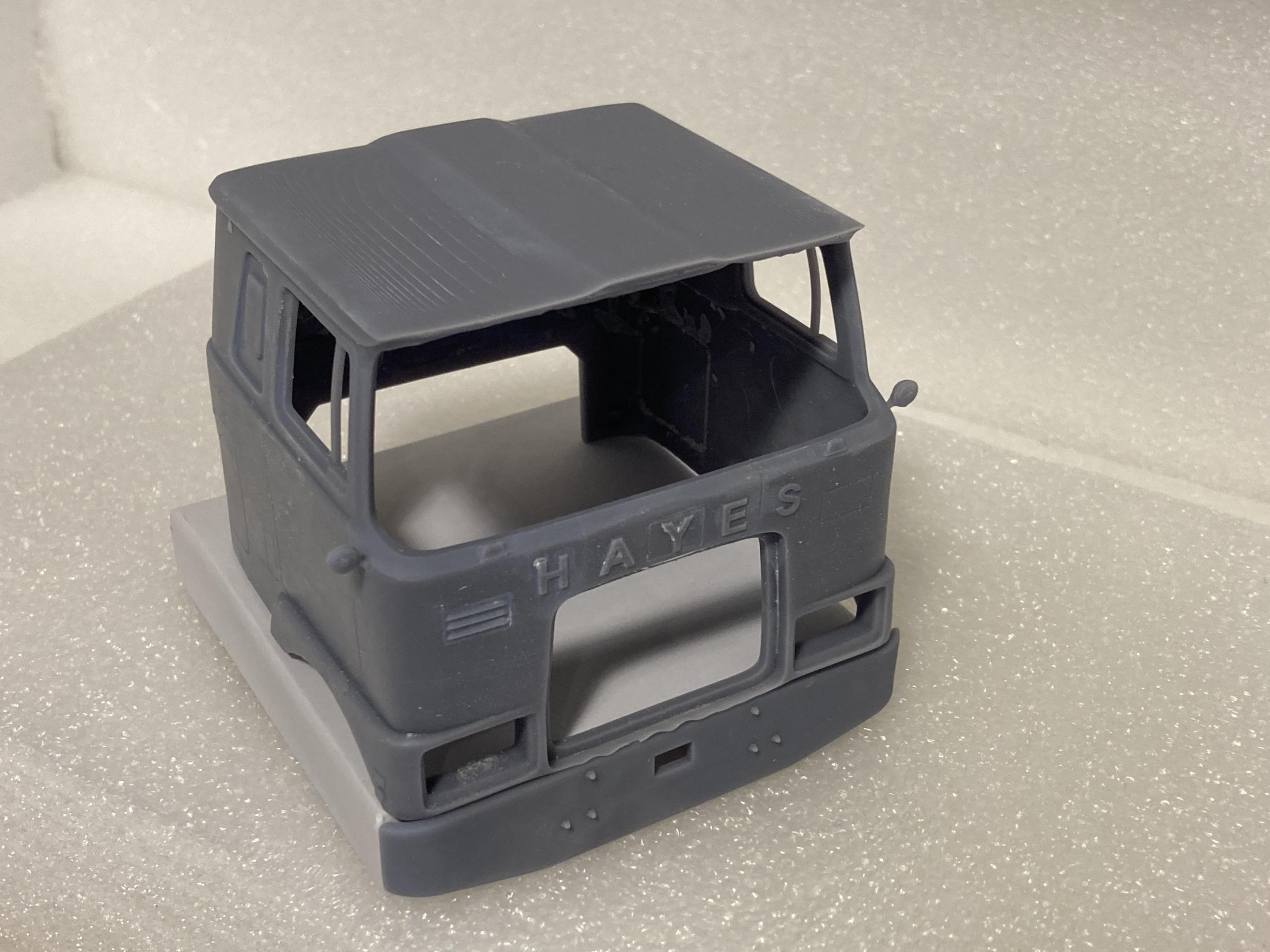

Prefer old classics? - here's two. A monster of an HDX logger, and a vintage Hayes cabover (forgive the quality of the cabover - I printed it flat as it was too big for my printer - I have a bigger printer now so I'll re-pop it.) The grey grill on the HDX shows one of the challenges of resin - it can warp while curing - I reprinted leaving the supports in place and cured it like that - problem solved. Note the headlight guard snapped off the grey one - water soluble resin is rather brittle - handle with care!

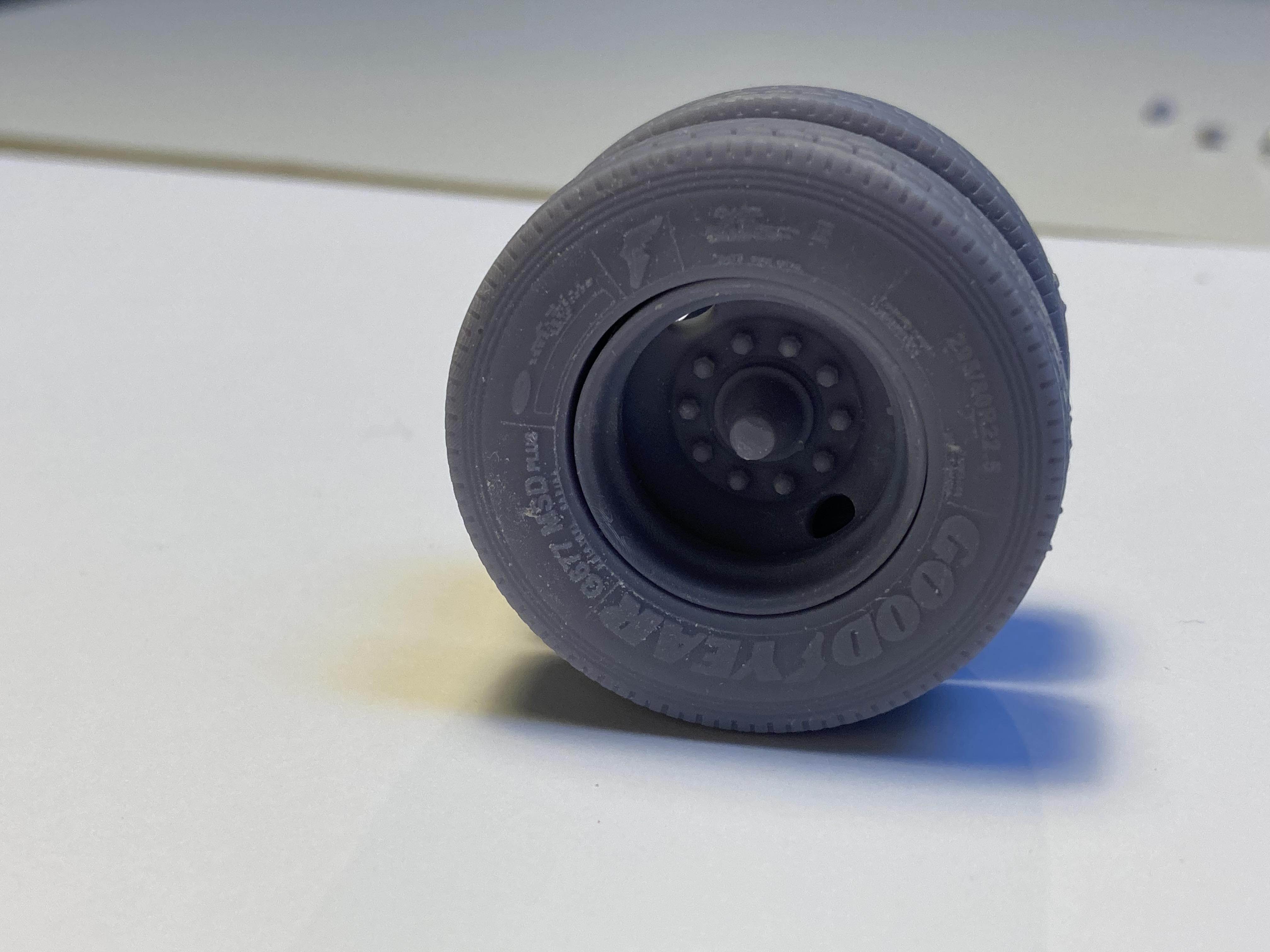

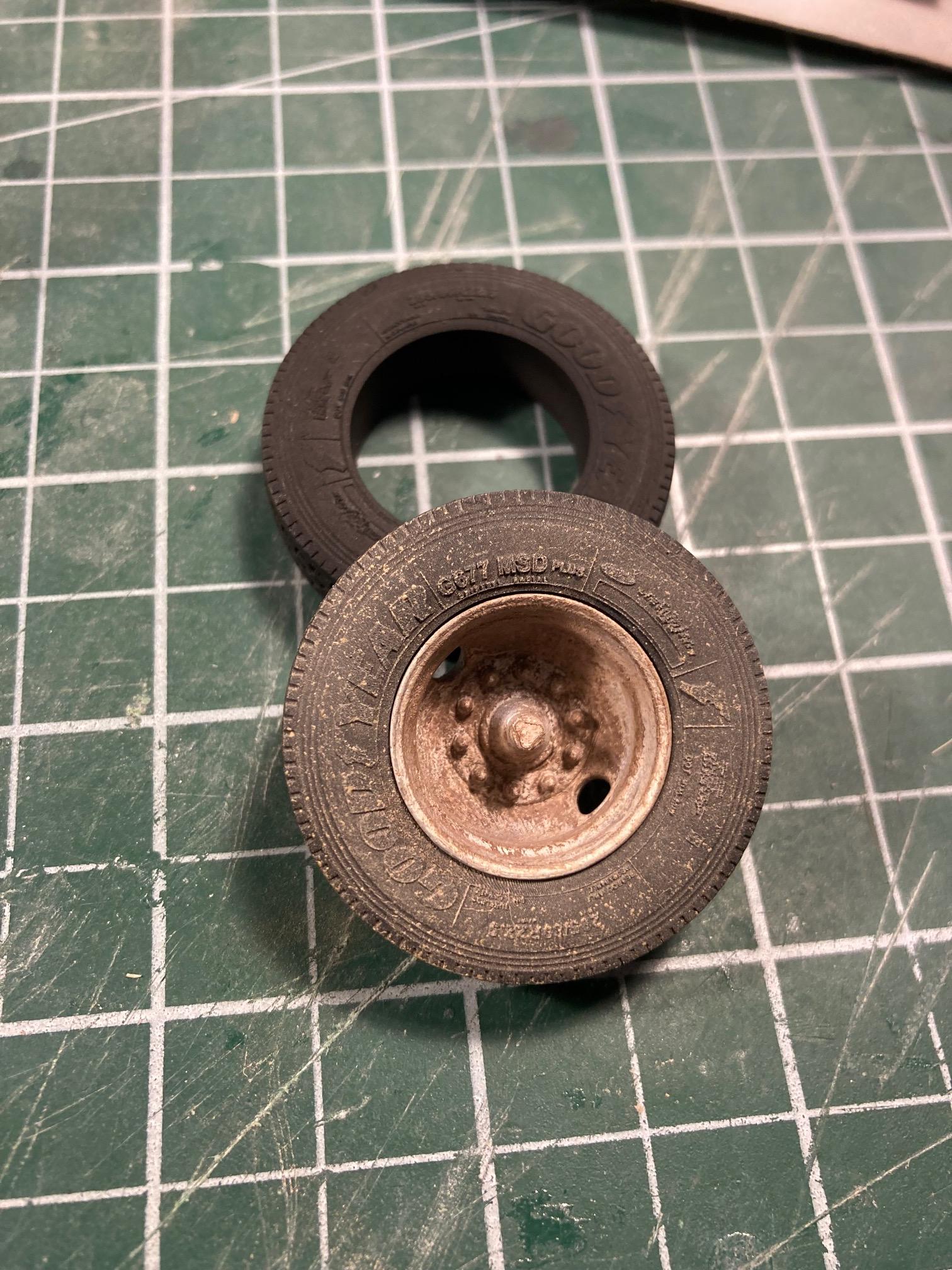

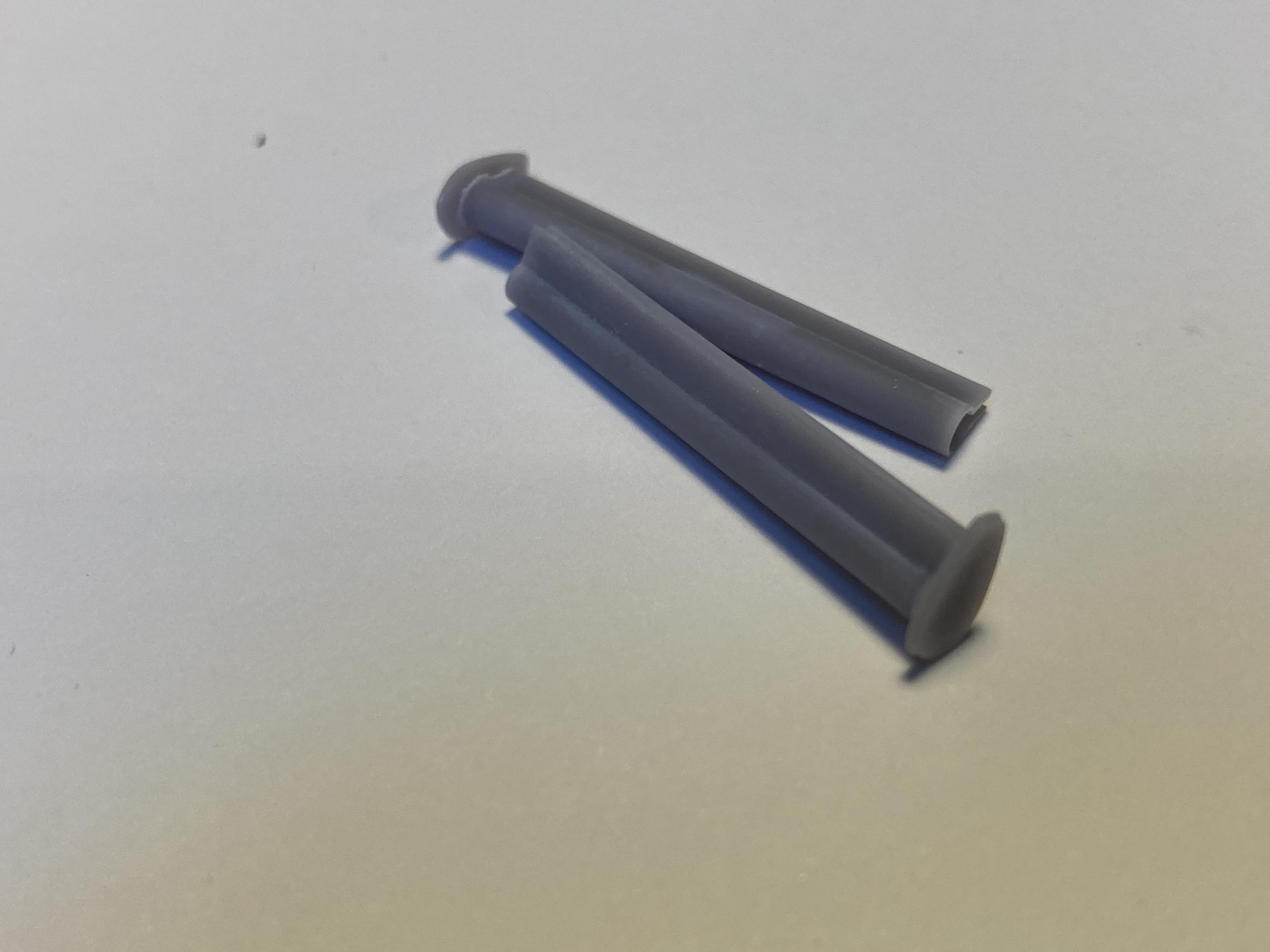

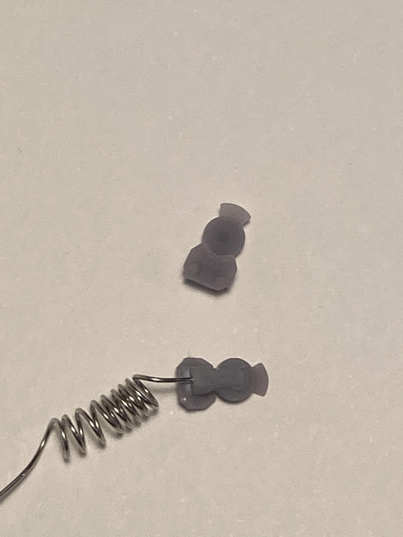

Okay - cool bodies - but how about parts? Well - this is where 3D printing comes into its own. I have collected a binder of thousands of 1/25 scale parts - an amazing resource for my scratch building. Just about anything you can think of is here. 2 hole Buds? - yup. Accurate sidewall truck tires? - yup. Now you can print footwear for dozens of Michigan trailers for pennies (well - a few bucks) - honest! This is from my trailer build I'm doing now.

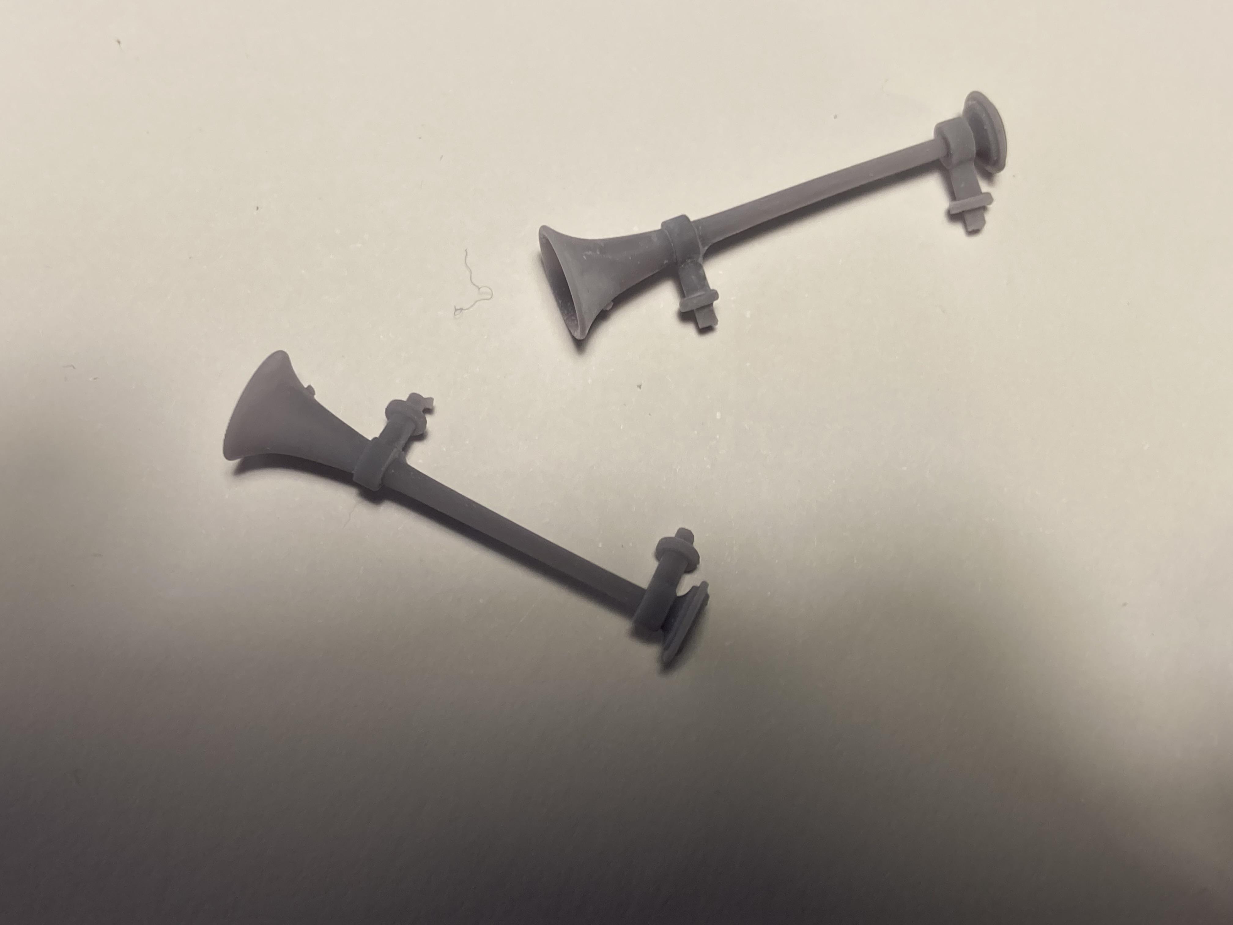

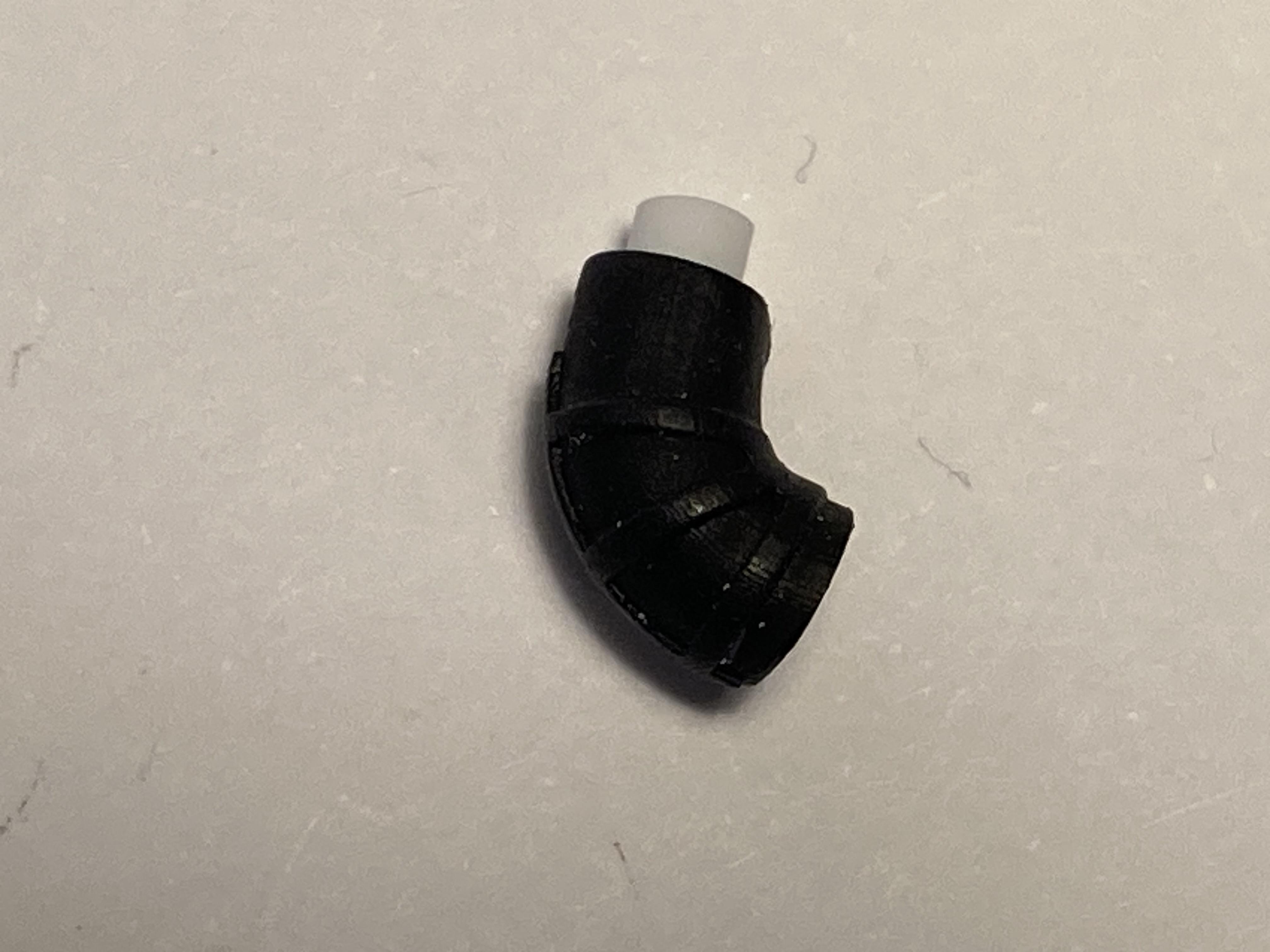

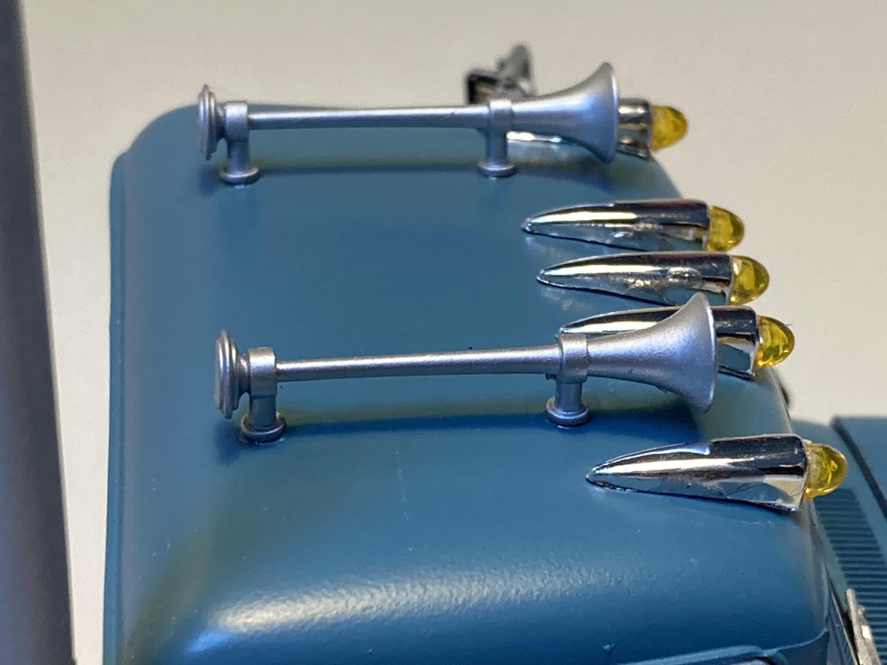

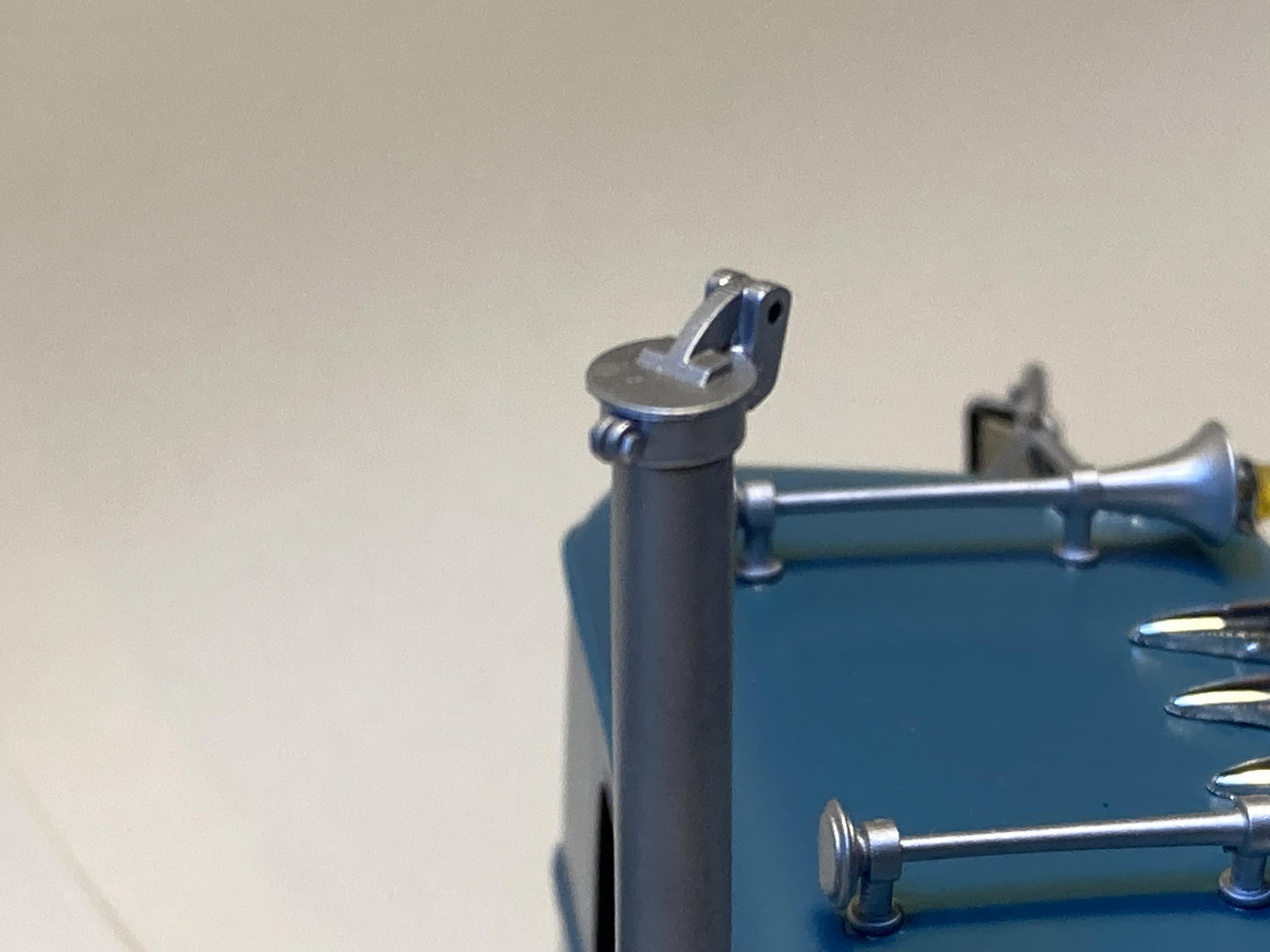

Here are some other prints I've used. Glad hands, air horns, flapper valves, pipe bends, mud flap hangers - you name it, there are files of all of them. Many are free, some are a few bucks. My Diamond Reo, in the completed build section of the forum uses a lot of these, if you want to see the "finished product" (couple of photos below). There are tons of cool things to use for cargo - pallets, tiedowns, construction equipment, pipes, cranes - you name it. Most of these I haven't even seen in the after-market. And for those of you who want to tweak the dimensions - 3D printing is super-easy - your slicer software can scale up or down by fractions of a millimeter. I adjusted all of these to the exact dimensions I needed - simple as 1 mouse click. No 'tech-geek' wizardry required.

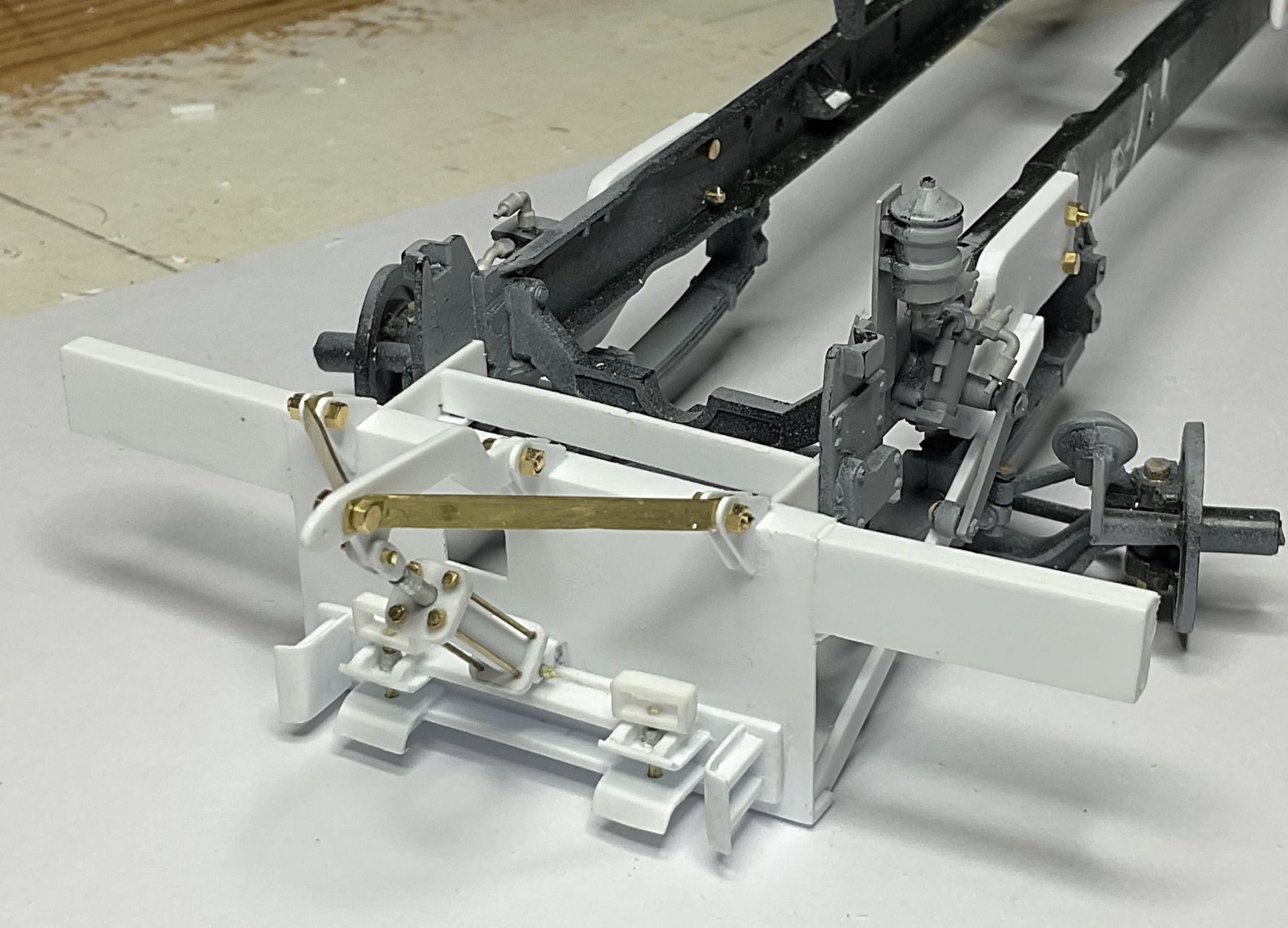

Below is a screen shot from Sketchup for one part of the truck (forms the front bumper of my plow truck), and a picture of what I actually modeled from styrene.  Based on what you've learned, do you think any part of the small Sketchup model could have been resin printed at resolutions similar to the cabs you printed?
Sketchup -
actual

I'm going to hazard a guess and say no Brian. That is very beautiful detail fabrication you've done there - and nothing beats brass and nut/bolt hardware. I print at .05mm resolution - very standard - and some of the latest printers go down to .02mm - but many .stl files are coarser than that - so the point has been made that greater resolution for these files accomplishes nothing. The other challenge is that, as 3D surfaces get thinner (the brass braces above) or narrower (the long bolts on your hydraulic cylinder), they tend to warp or simply fall apart. Things like rear view mirror braces are best done in brass rod. Use 3D printing to pop the mirrors,  but use brass for the thin/strong stuff like mirror mounts. As with all tech (and being enthusiastic as I am about 3D print possibilities) one has to recognize that "just because you can doesn't mean you should". There is much that other techniques are better suited for in modelling. I like 3D for small parts (rubber hood latches, air horns, air relays, hoses etc.) or truck bodies/trailers - curved parts that are difficult to fabricate. Detailed sub assemblies like you've got above would be very difficult to make look any good in 3D. Hope this helps. Can you post a photo if a 1:1 Western Star that represents what you're looking for?
