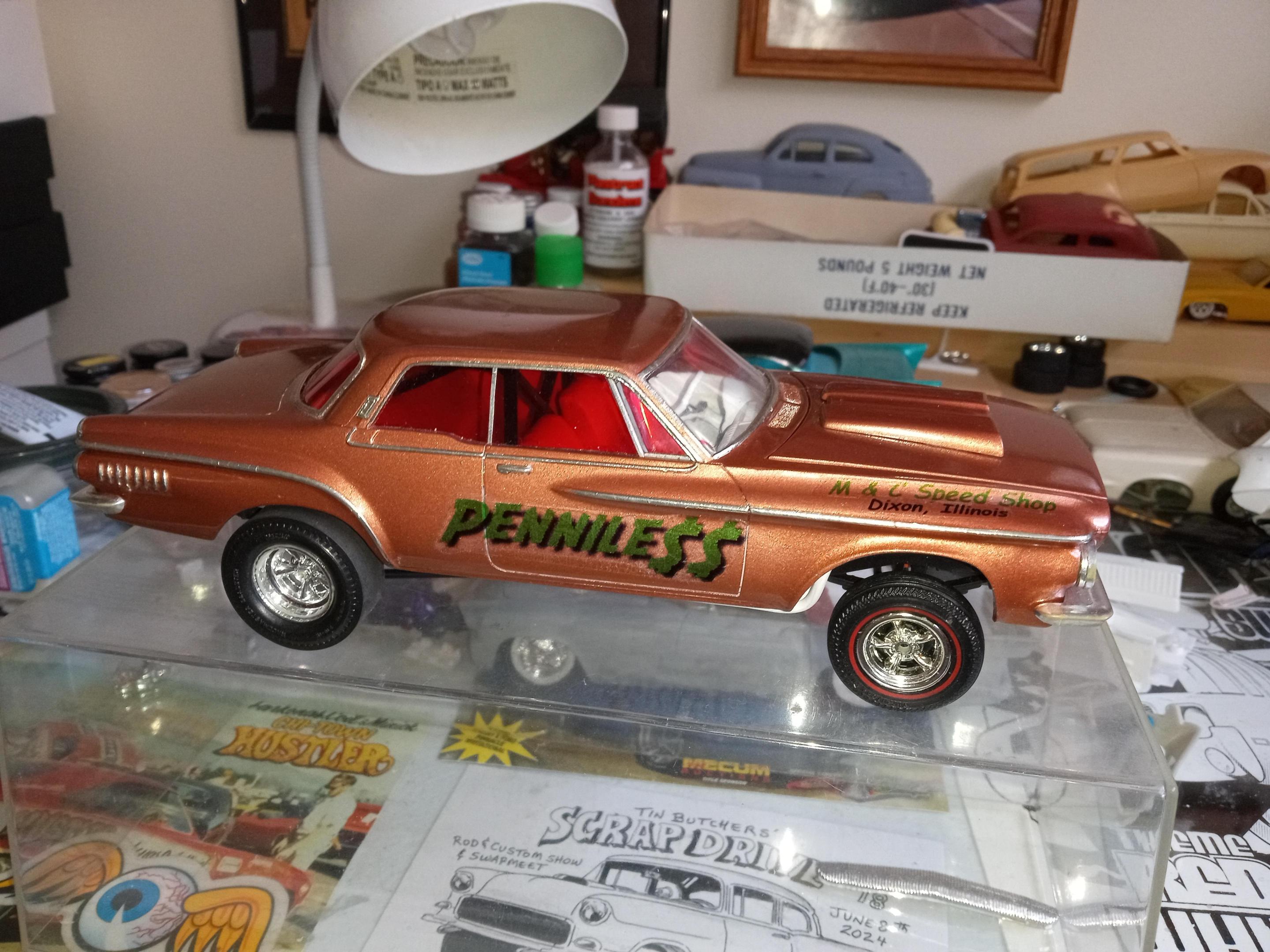

NitroMarty Posted June 19, 2024 Share Posted June 19, 2024 Help! I am in need of a can of Testors discontinued Turbine Bronze Lacquer. Had several cans that I unfortunately had to leave behind when we moved back in 2022. Now I'm wanting to build a stable mate to the "Penniless" Dart that I built back in 2009, and,of course, there is none to be found!☹️ Quote Link to comment Share on other sites More sharing options...
Bainford Posted June 20, 2024 Share Posted June 20, 2024 Can't help, but that Dart is COOL! Quote Link to comment Share on other sites More sharing options...

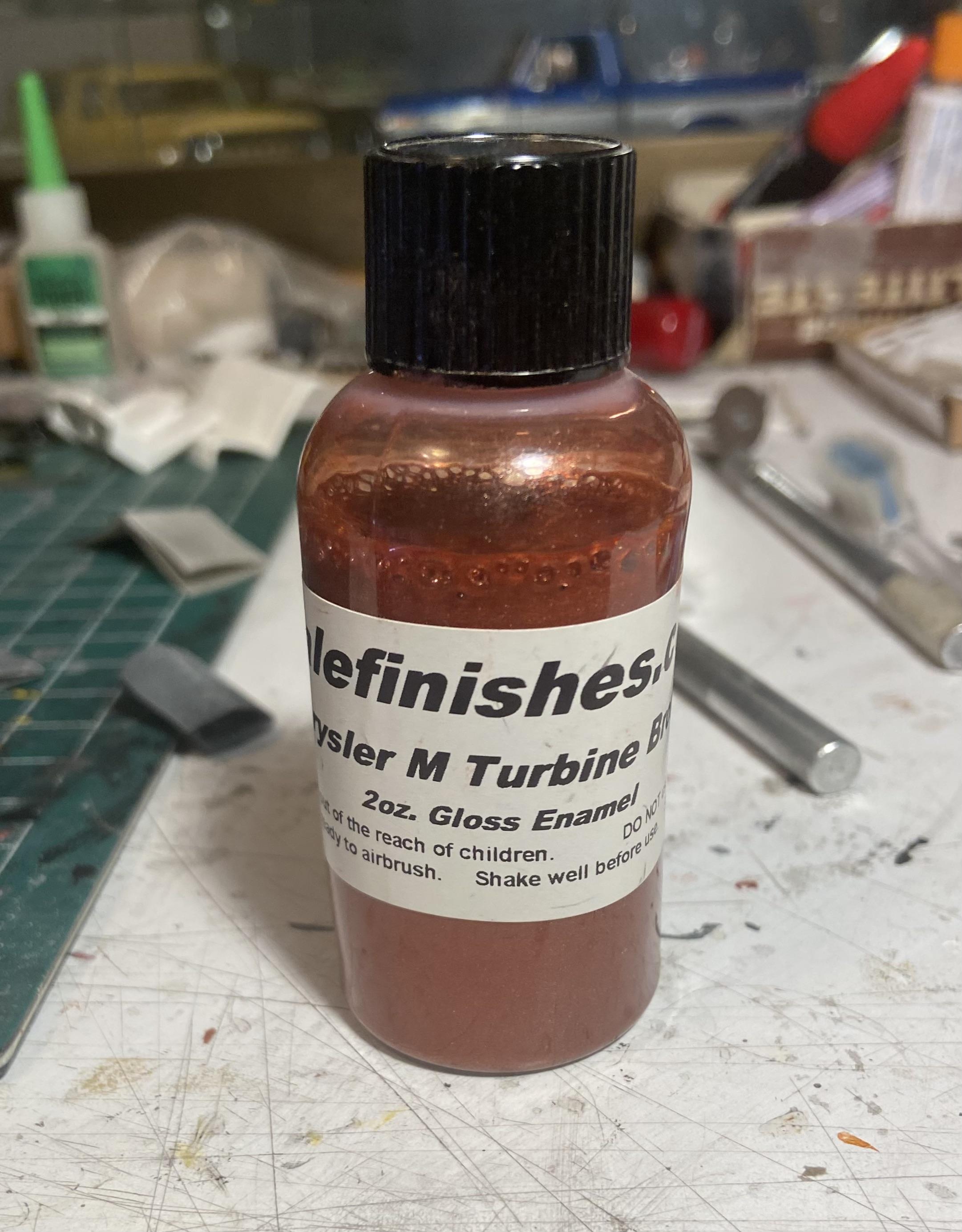

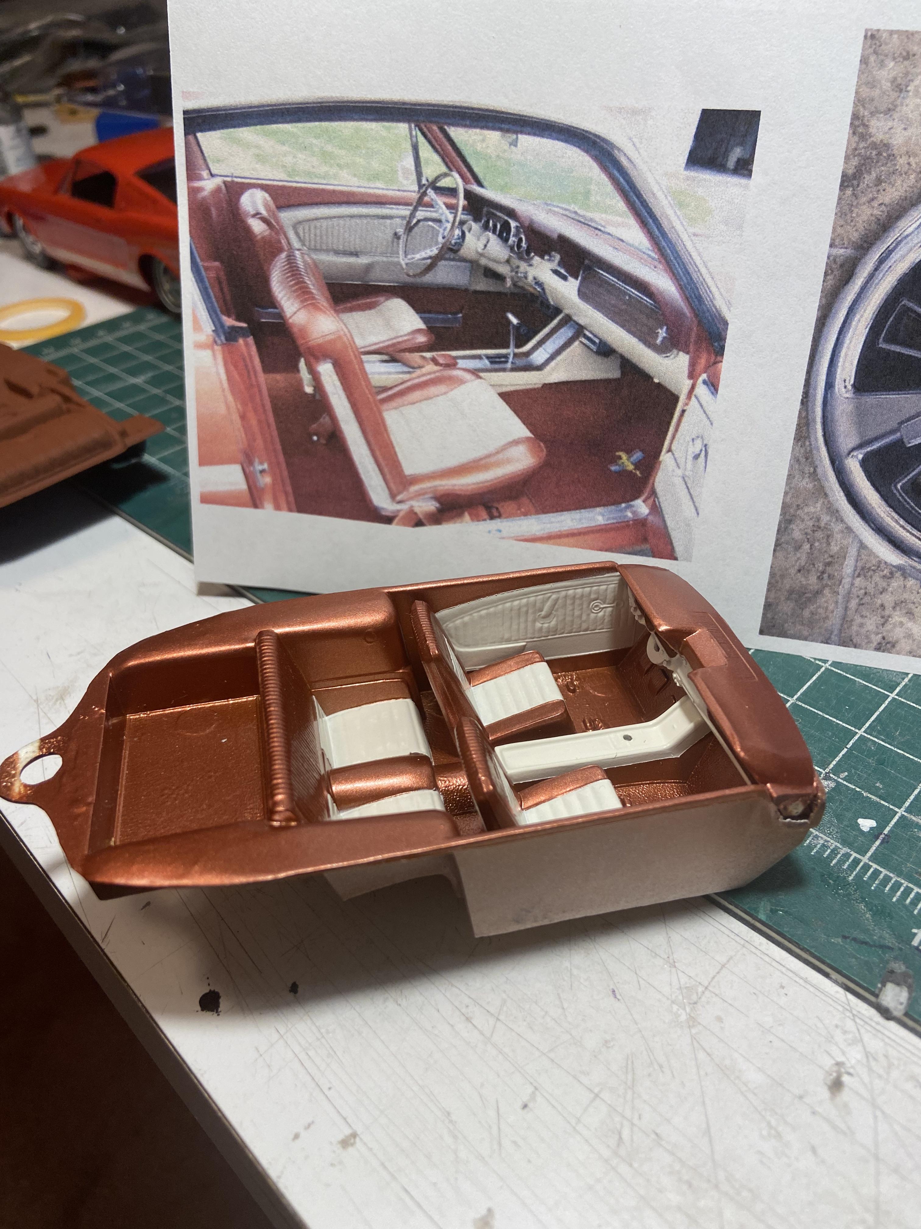

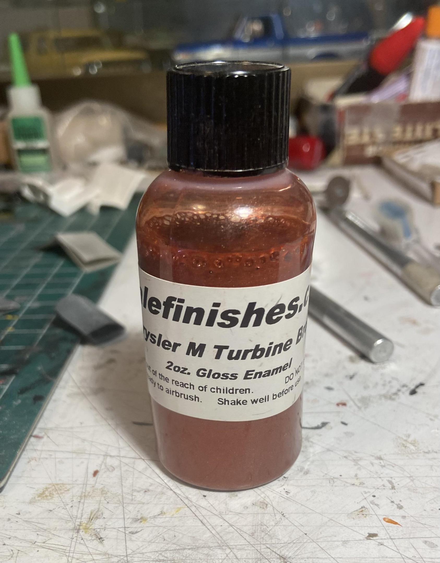

Maindrian Pace Posted June 20, 2024 Share Posted June 20, 2024 Honestly, you want Scalefinishes Turbine Bronze. I painted this interior shell with it, great match to factory. The problem with the Testors lacquer cans is that they are all old now, and are almost all leaking from the seams. So there is little or no pressure inside, and the clear carrier is what is leaking so the mixture is off - meaning you would have to decant and airbrush it anyway, and who knows how it would come out or if there would be enough; the leaked cans are much lighter in weight than the full ones. Quote Link to comment Share on other sites More sharing options...

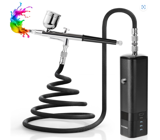

Exotics_Builder Posted June 25, 2024 Share Posted June 25, 2024 45 minutes ago, stavanzer said: What part of "It's part of the Lease" is hard to understand? I checked my stash Marty. I do not have any. And Like others, I had to dich 4 more cans myself. I'm sorry I could not Help. Doesn't MCW Put paint in spray cans? Or was that somebody else. I remember seeing the ads in SAE years ago. I don't know if MCW offers aerosols at the moment, but he does have a contact us on his page where one could ask. Ass regards the portable airbrush, whether the poster meant it or not, it could be used as one would use a shaker can as no power source is needed when spraying. I have one for small jobs. It charges via USB and I can connect an airbrush hose with the brush to it and use it wherever. Ideally a booth is helpful, but not necessary. No control of PSI, so you get what you get. It works well for my uses. This is the one I use: Quote Link to comment Share on other sites More sharing options...

Exotics_Builder Posted June 25, 2024 Share Posted June 25, 2024 3 hours ago, NitroMarty said: Thanks, Gerry.... A suggestion that actually helps!? I am going to check into these options. There are small bottle options for the Preval if you go that route. But I would recommend first considering the portable airbrush. You can attach existing airbrushes you own. I personally use one of my Iwata's with it. Quote Link to comment Share on other sites More sharing options...
Maindrian Pace Posted June 25, 2024 Share Posted June 25, 2024 11 hours ago, Exotics_Builder said: I don't know if MCW offers aerosols at the moment, but he does have a contact us on his page where one could ask. Ass regards the portable airbrush, whether the poster meant it or not, it could be used as one would use a shaker can as no power source is needed when spraying. I have one for small jobs. It charges via USB and I can connect an airbrush hose with the brush to it and use it wherever. Ideally a booth is helpful, but not necessary. No control of PSI, so you get what you get. It works well for my uses. This is the one I use: That thing is neat! Put the mini compressor in your pocket or a belt loop, go to the parking lot, and fire away. I think we have a winner. 1 Quote Link to comment Share on other sites More sharing options...
NitroMarty Posted June 25, 2024 Author Share Posted June 25, 2024 4 hours ago, Exotics_Builder said: There are small bottle options for the Preval if you go that route. But I would recommend first considering the portable airbrush. You can attach existing airbrushes you own. I personally use one of my Iwata's with it. One portable airbrush system on the way..... Supposed to be delivered by the weekend! Hopefully the compressor will be enough to push my Grex T5... If not, I also have an ancient paasche that was Dad's. 1 Quote Link to comment Share on other sites More sharing options...
Exotics_Builder Posted June 25, 2024 Share Posted June 25, 2024 2 hours ago, NitroMarty said: One portable airbrush system on the way..... Supposed to be delivered by the weekend! Hopefully the compressor will be enough to push my Grex T5... If not, I also have an ancient paasche that was Dad's. It'll run my Iwata HP-BS, so, hopefully, it will run the Grex. 1 Quote Link to comment Share on other sites More sharing options...
