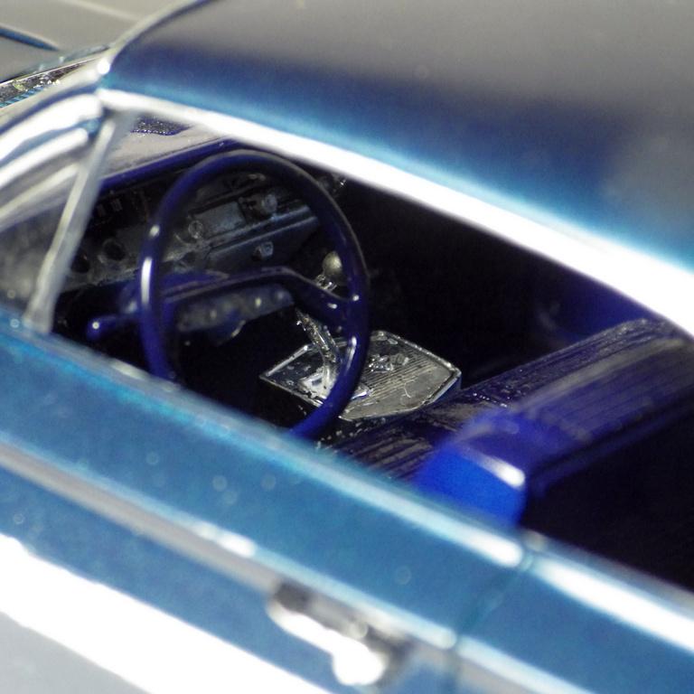

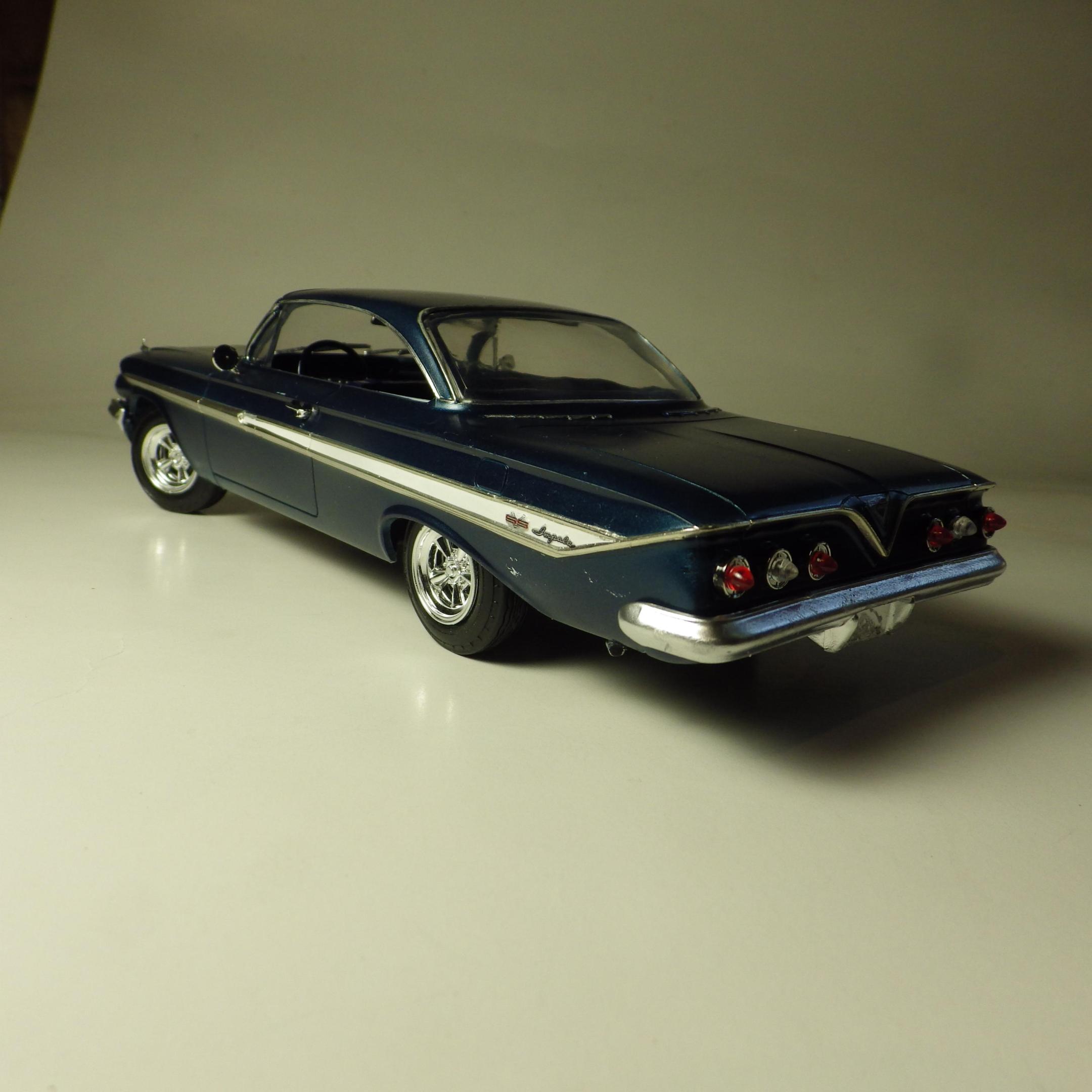

bluestringer Posted June 21 Share Posted June 21 (edited) Had a few problems with this one, but finally got it together, warts and all. The color is ScratchesHappen Azure Metallic Blue. This was a bottle of touchup paint I had for my Buick Encore GX. It mixed well with some cheap lacquer thinner and sprayed good through my airbrush. The interior is Tamiya Acylic Blue. Clear is floor polish sprayed with airbrush. Straight out of box build, I added plug wires and a fuel line to the carb. I had the kit in my stash for about 2 years, the chrome trees were spotted, looking like the plating was coming off. The small bits were ok like that, but I stripped the bumpers and grille, then sprayed them with Krylon Original Chrome. It looks good but not as bright as the kit chrome. I did the side trim with BMF, and really messed it up. After that I finished the rest of the trim with a Molotow pen. Lost one of the rear backup lights bezel, so had to make do without it. Not a show car, so it will do. All comments welcome, and thanks for looking. Edited June 21 by bluestringer 9 Quote Link to comment Share on other sites More sharing options...
espo Posted June 21 Share Posted June 21 Great looking dark blue color and finish. The bumpers sheen looks close to the body trim. Like how you posed the front wheels and the wheel and tire combination look good. Quote Link to comment Share on other sites More sharing options...
