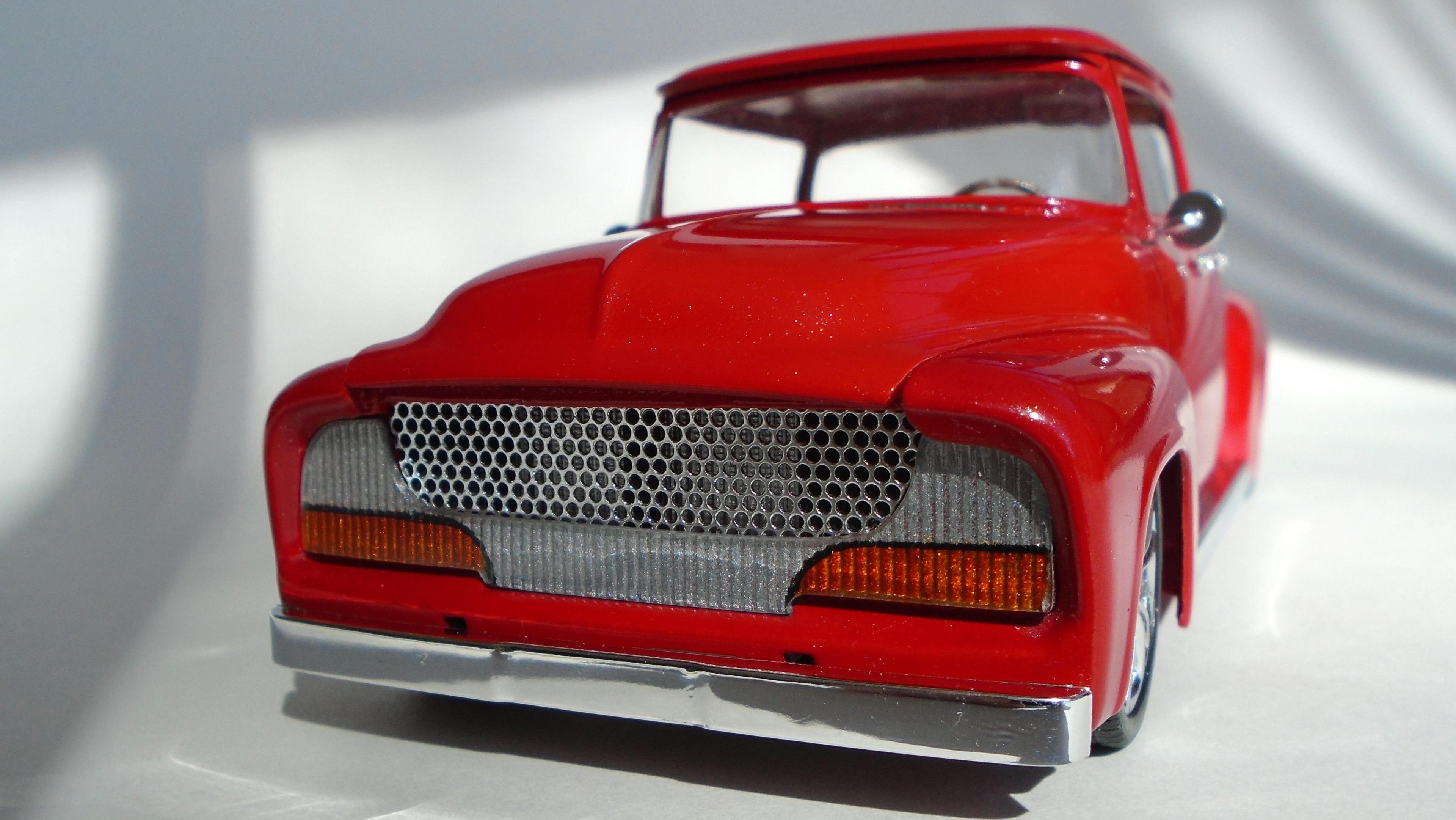

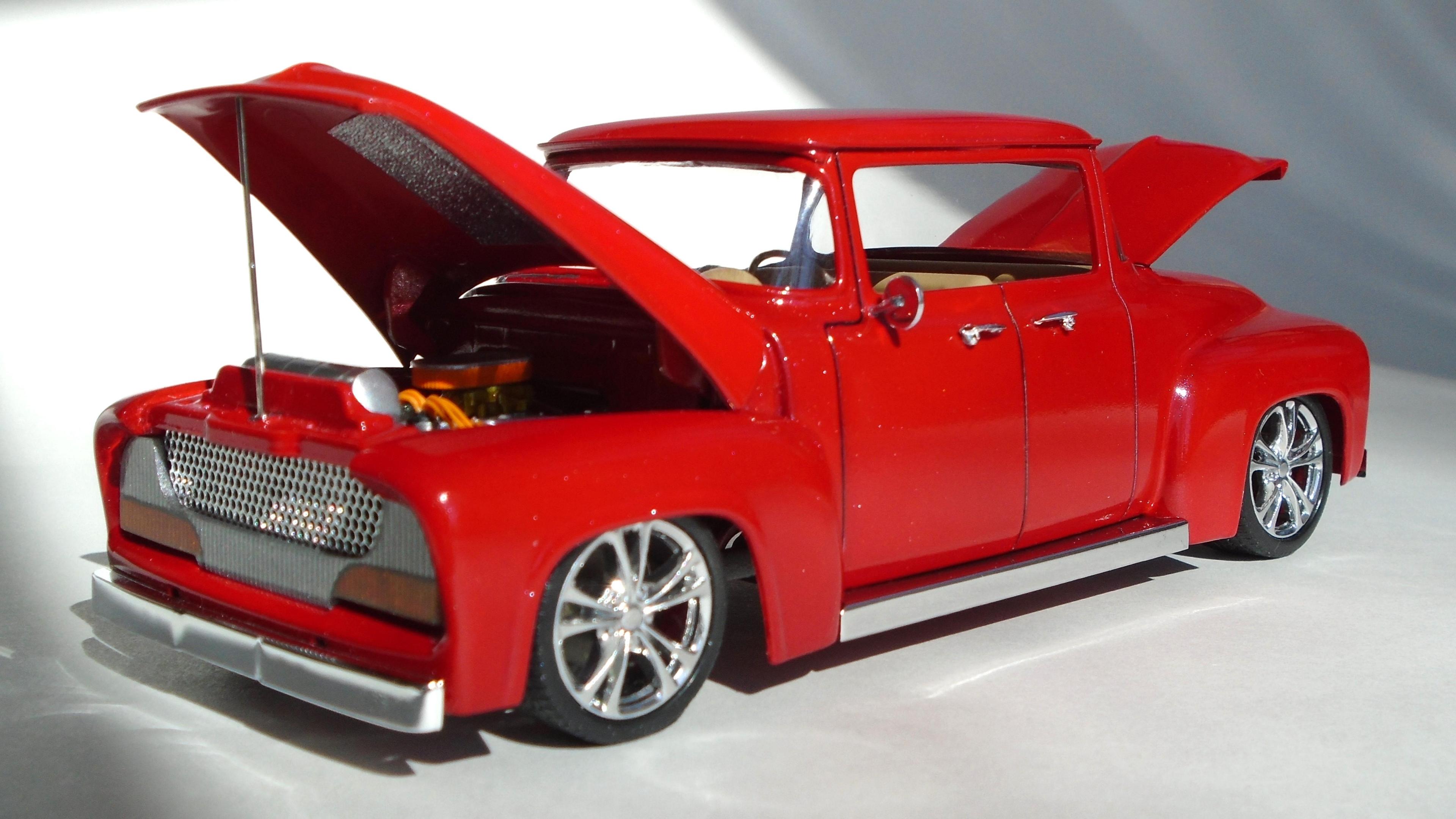

Claude Thibodeau Posted July 2, 2024 Posted July 2, 2024 Hi! I concur. Most chrome don't react well with clear. I have used Revell's spray chrome for a year now, and I must say it is very satisfactory, and if you leave it to dry (harden?) for about 10 days, it will resist to reasonnable handling needs. See wheels, grille and runningboards on the following pics. CT 1
