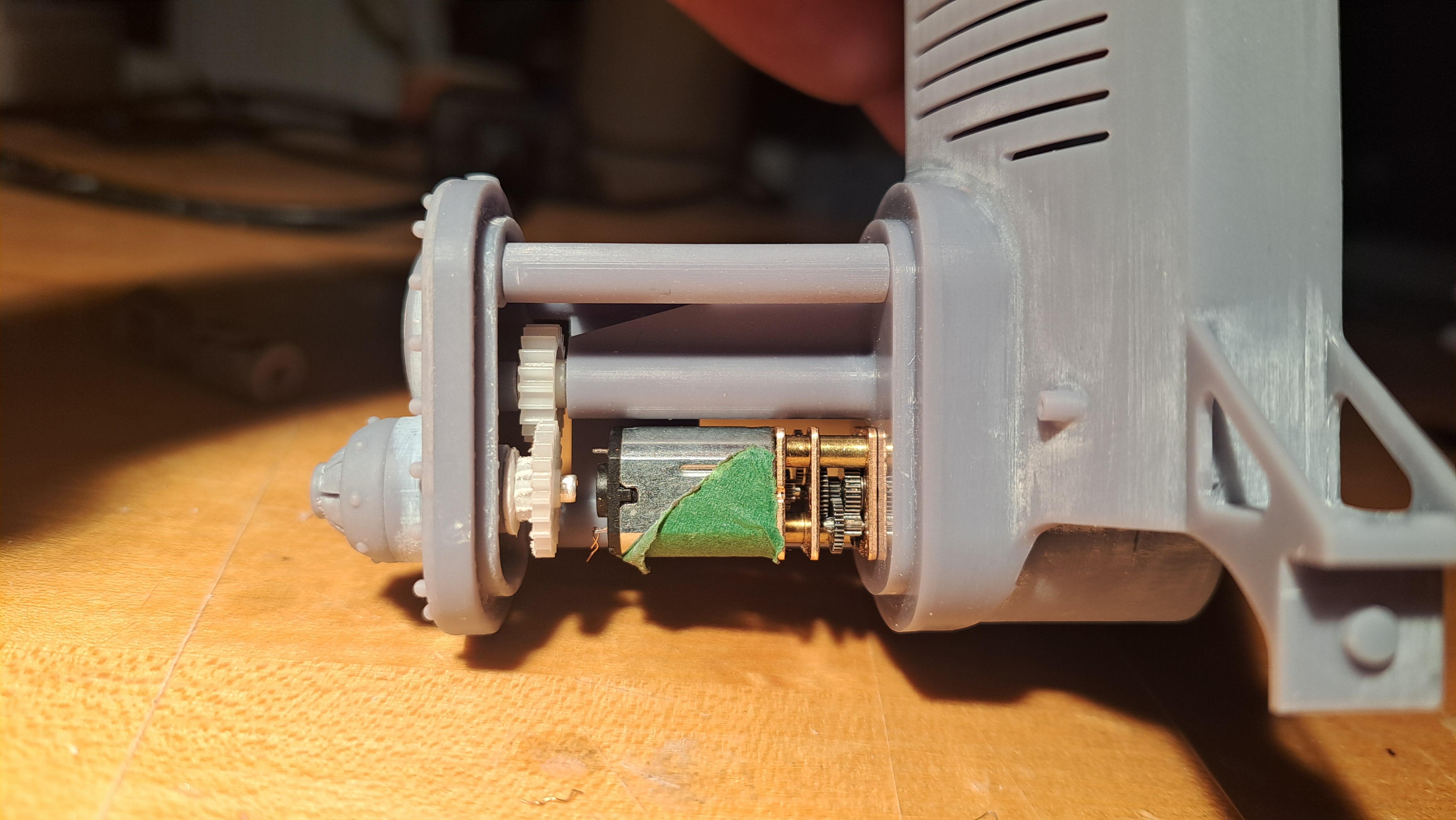

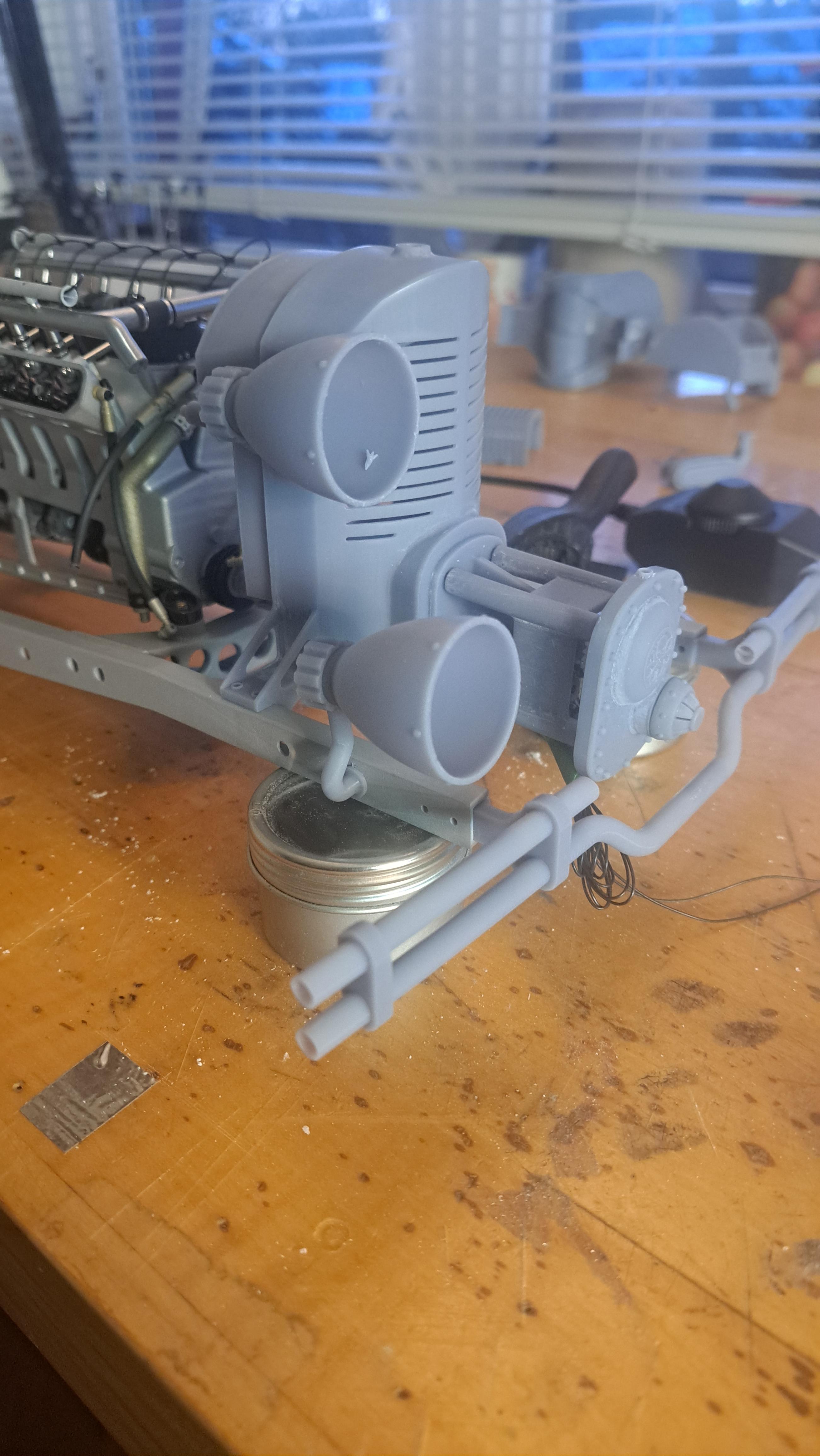

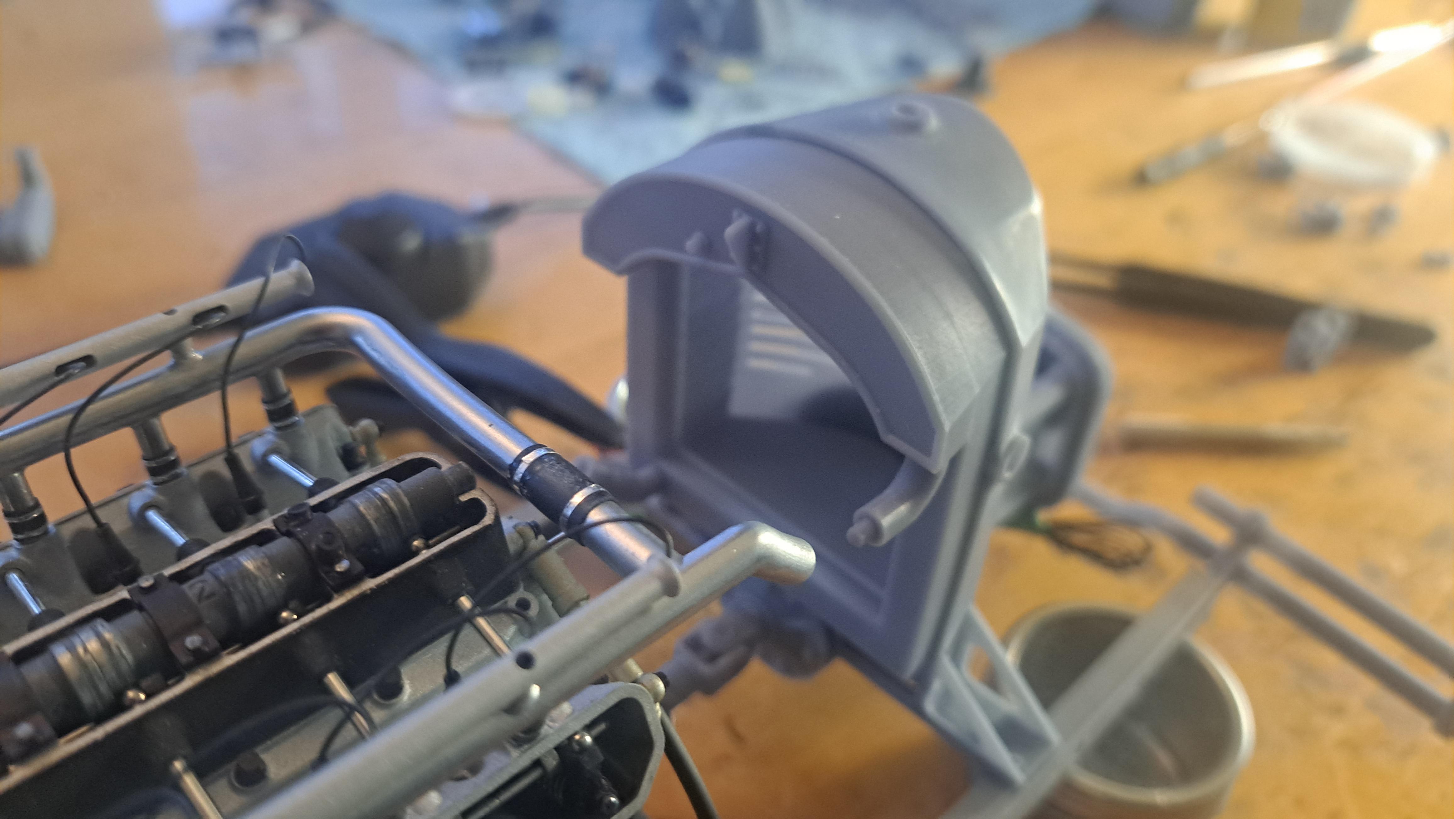

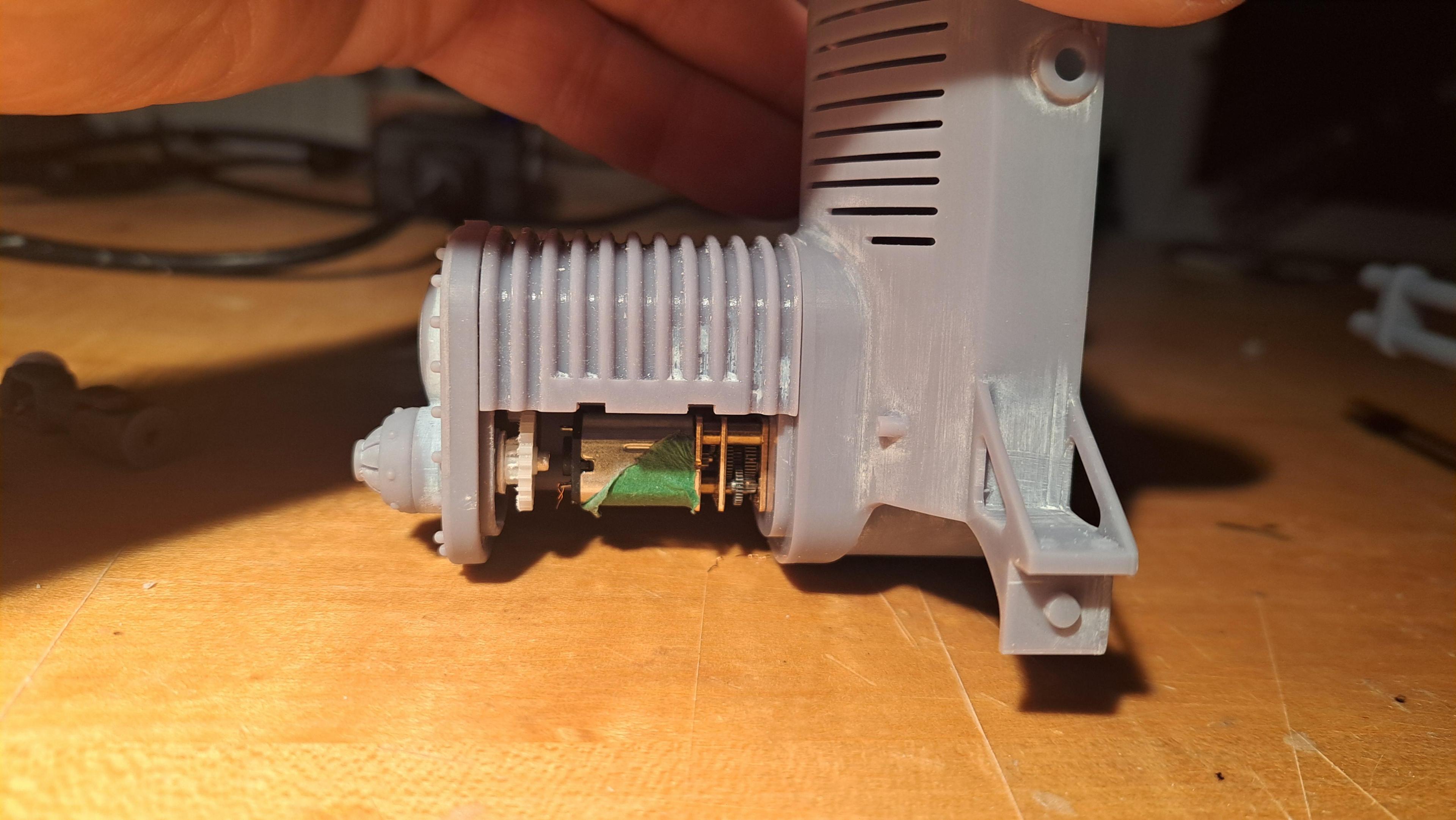

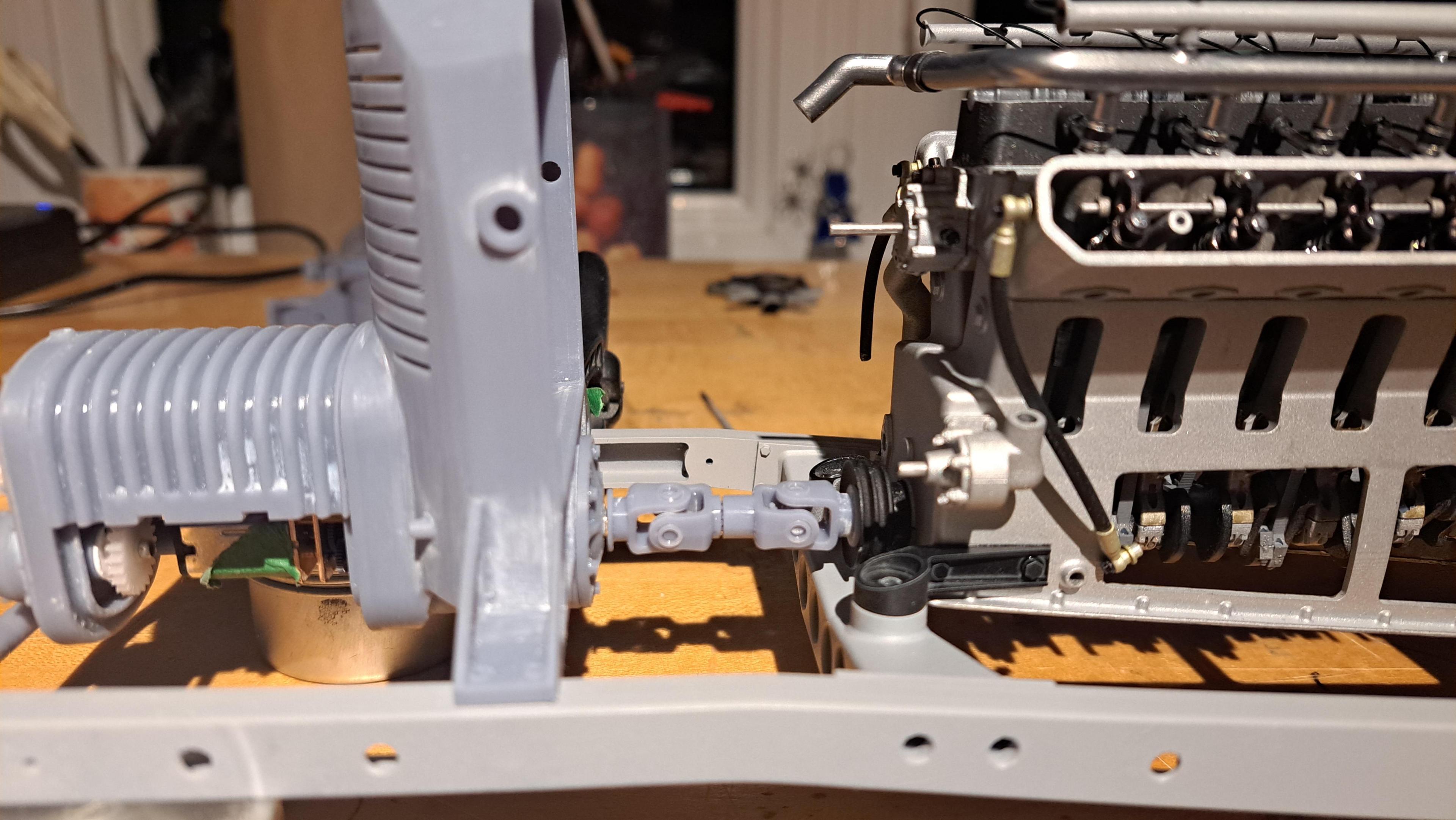

I've been more busy skiing than modeling this past week but I still managed to finalize the blower drive. I decided to add a subframe between the radiator and blower's front face to facilitate the assembly and paint. This way, I can chrome both the radiator and blower front face at the same time without having the blower housing in the way. Since the blower housing will be painted the same color as the bodywork (color to be determined), I made it in two halves that can easily be assembled later. I also made a small drive shaft between the crankshaft and the blower. If this was a real car, this shaft would drive the blower from the engine but on the model, since the gearmotor is hidden in the blower it's the other way around.
Blower drive
With half of the blower housing in place
Small drive shaft
Gearmotor spur gear (bottom) driving blower spur gear (top)

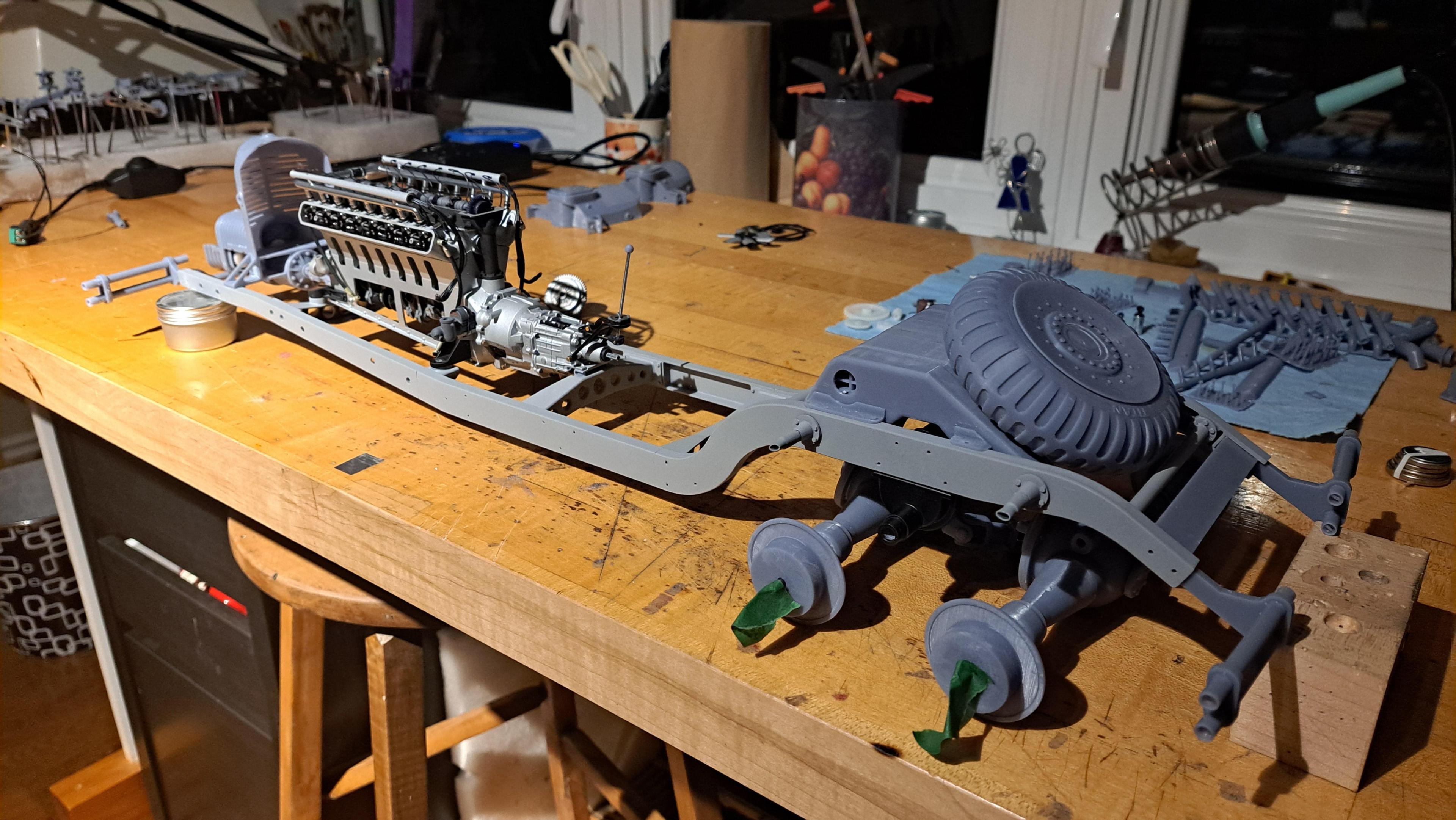

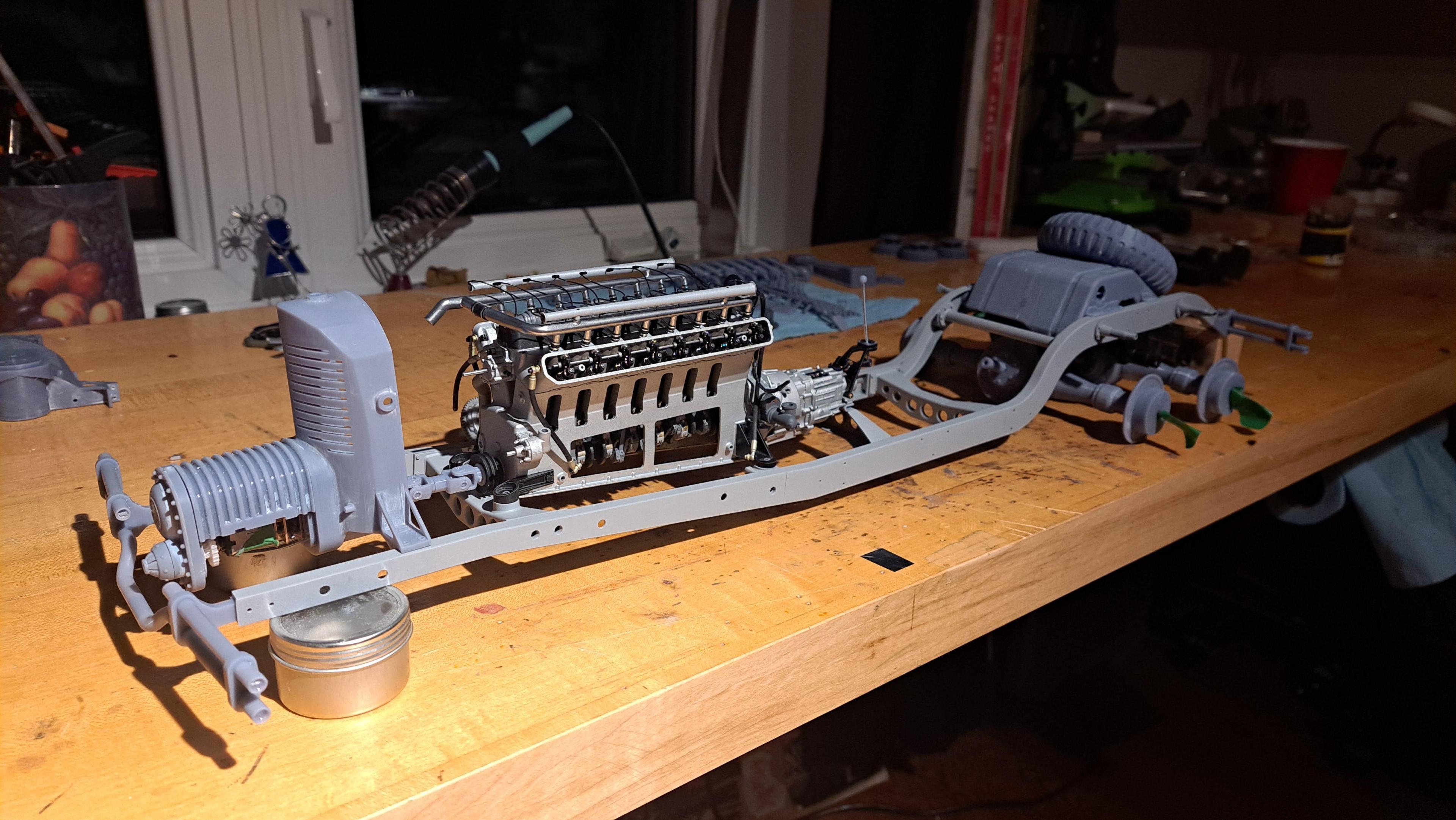

Overall view of model so far

I was finally able to drive everything from the gearmotor hidden in the blower. From the blower spinning dome to the 4 rear wheels. I small victory for me!

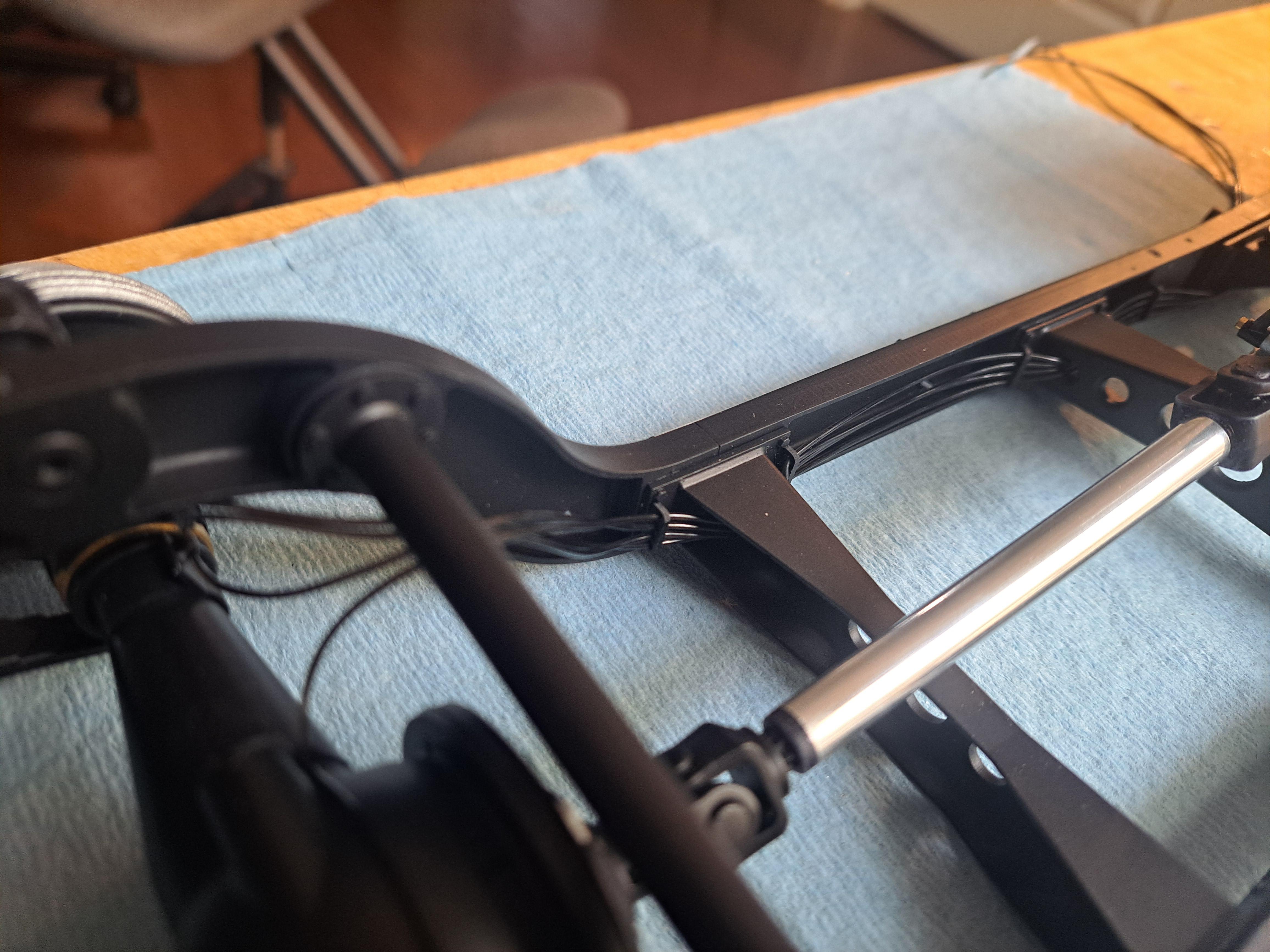

 I'm printing parts while waiting for a revell paint order I did for the frame, suspension and drive components (silk black).

All the steering components have been printed and assembled, everything fits and works as should.

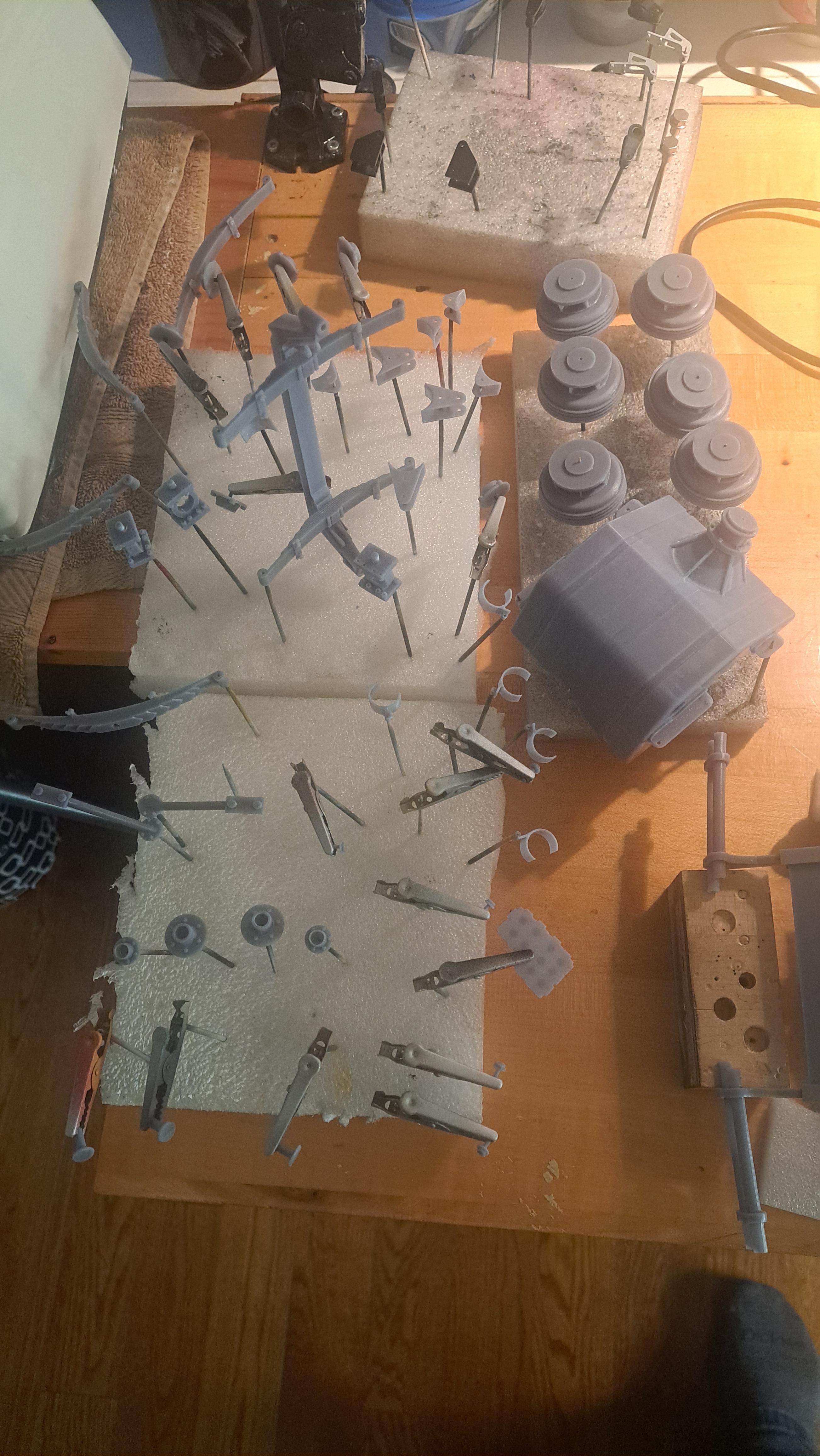

I also started to print some boby parts,  here's a test print of tge right side tool box.
