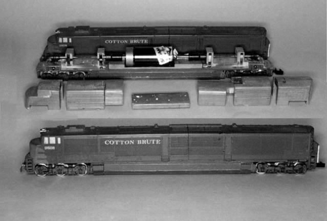

Actually depleted uranium was used as a counterbalance weights in Boeing 747 Jumbo Jets, and for a more fun application Jim FitzGerald (founder of the NTRAK modular N scale system) build an N scale locomotive called "Cotton Brute" which used depleted uranium as weights to maximize its pulling ability.
By Jim Fitzgeral from NTRak NewsletterSept/Oct 1983
The "Cotton Brute" and long trains.
The origional goal was a 500 car train based on a N&W 500 car train that ran from West Virginia to Ohio when remote control mid train helpers were first used by N&W.
The “Cotton Brute” was the star of a series of special locomotives that I built for long train tries. I did a word search for four and five letter words starting with "B". Other locomotives were Cotton Bell, Cotton Bull and Cotton Boss, all in SP / Cotton Belt scarlet and grey.
The photo of the Cotton Brute is a composite showing the complete engine in the foreground and an exploded view. The long fuel tank/frame is indeed depleted uranium. Where I worked we had made some experimental gyros of the material. Other materials were easier to precisely machine.
The top weights are machined from lead and completely fill the thin shell. The engine weighs 24 oz, 1-1/2 pounds and has a Sagami 1630 motor. The longest train with just the Cotton Brute on the head end was 560 Kadee (MicroTrains) two bay coal cars. The custom layout had 72" minimum radius curves in a folded dogbone shape.
There were 560 Kadee two bay hoppers with modified Rapido couplers used for the long train efforts.
The layout used was built just for long trains. It was single track with 6 foot minimum radius in a “dogbone” shape. There was one trailing point turnout from a siding used to set up additional strings of cars to add to the train. The modules were about 4’ long and made from 3/8” particle board.
Sorry for going a bit off-topic but it is such a cool story.
That is a cool story Peter.
At 24 oz that is one heavy N-scale loco! ? It must have felt like a brick when in hand.
I actually did look into depleted uranium and it's currently about $35 per gram. Knowing that I need around 2 oz to balance the plane, that would be about $2000.00 worth of depleted U!
And I don't even know how to work with the stuff! ?
If I did buy several ounces of the stuff, I'm sure it would be delivered by an agent of whichever federal regulatory agency is most applicable.
I'll stick to lead shot, thanks :)
