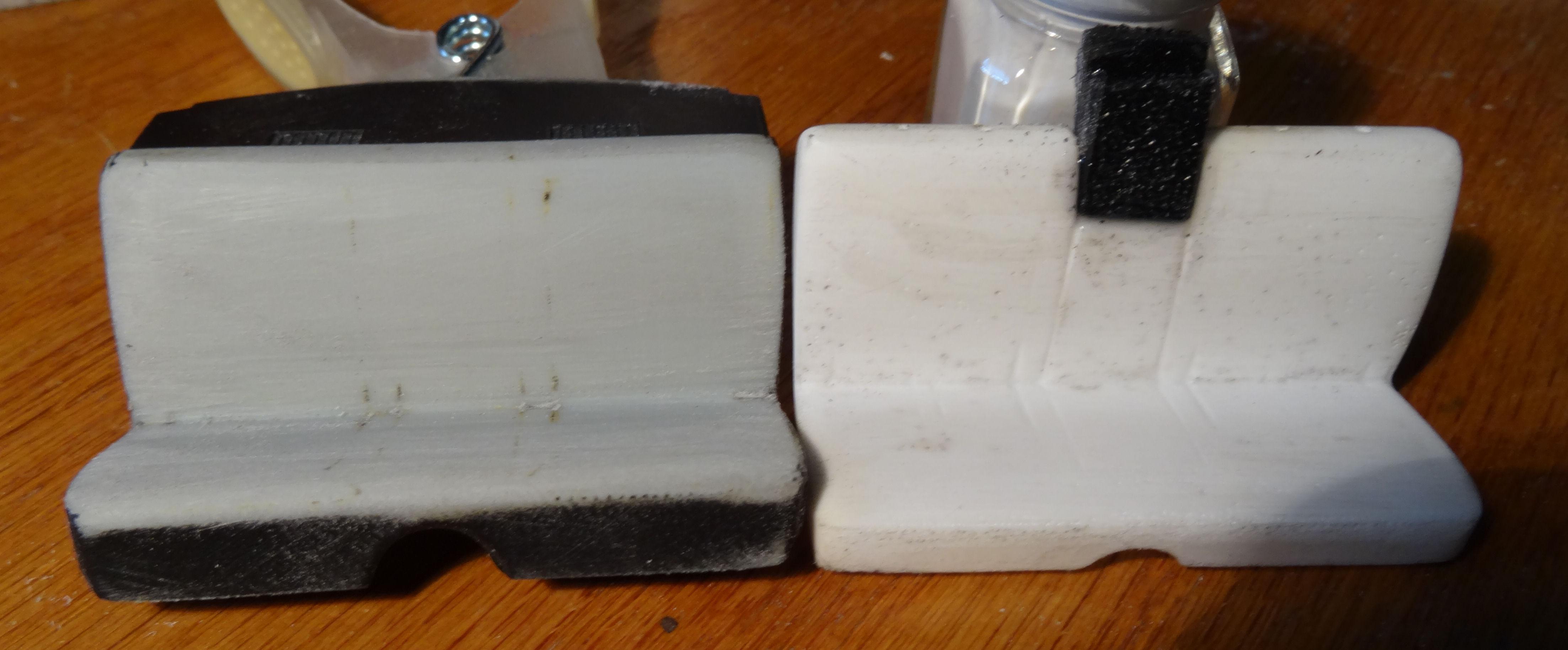

LennyB Posted September 7, 2024 Author Posted September 7, 2024 Spent a lot of time sanding last night to get rid of the pattern on the seats. Still have a ways to go on the front resin bench. Took some flat styrene to fill the gap in the center. Glued it in with some CA and will cut it down and shape it when it's good and set. Figuring I'm going to need to used some 1:1 scale auto body filler to smooth it out. WDYT?

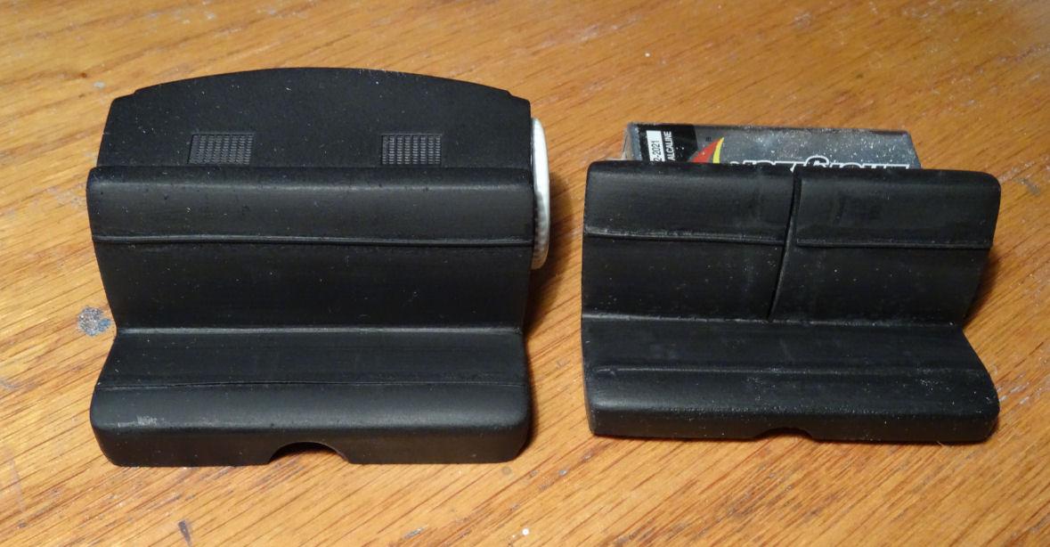

LennyB Posted September 8, 2024 Author Posted September 8, 2024 Got some more work done on the front bench. Filed down the block of styrene I inserted and cut a slot down the middle to separate the seat backs. Found the resin became a bit flimsy once I did this so I epoxied a piece of styrene sprue to the underside for support before I broke something...again. Dug out some 3M glaze and skimmed over the seat. Cleaned that up, added some .020 round stock to mimic the separation welt between the sections on the seat. And gave it a shot of flat black. Looks like my welting on the rear seat top is a bit crooked. Need to take that off and redo it. I thought I was going to get some painting done on the body this afternoon as the humidity finally subsided, but when I sprayed out the Tor RED I bought I found it to be too Orange. Looked on line at samples of that color and they appear orange also. Went back to ScaleFinishes.com where I bought the paint and their color swatch looks nothing like the actual color. Can't always trust what you see on the screen. So I ordered a batch of Rally Red and hope that comes out like I need it to. We shall see next time....? 1
