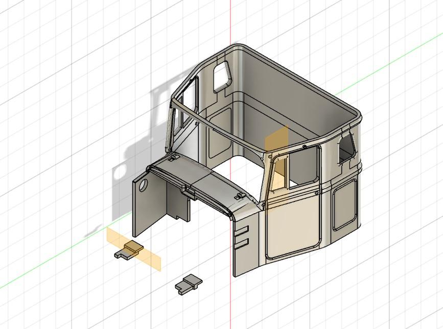

Jürgen M. Posted August 20 Share Posted August 20 Hi everyone, I found a new Idea for a print project and just couldn't hide it! It'll be a mixture of these two trucks: Both a version of a 1960 Autocar DC75T with a sleepercab. I like them both so I'll try to extract the best of each and combine them to a hopefully successful build! I chose this truck because I always try to build at least one cabover and one conventional of a brand. Like I did with Marmon, Diamond Reo, GMC, ...! And since I built the ACX cabover last year, I needed a conventional to match it! And it's also not an everyday truck! The integrated sleepercab wasn't built that often if what I read was correct. Maybe some of you guys know more about it! Hope you'll like the build. I'll post the first design pics soon! 1 Quote Link to comment Share on other sites More sharing options...

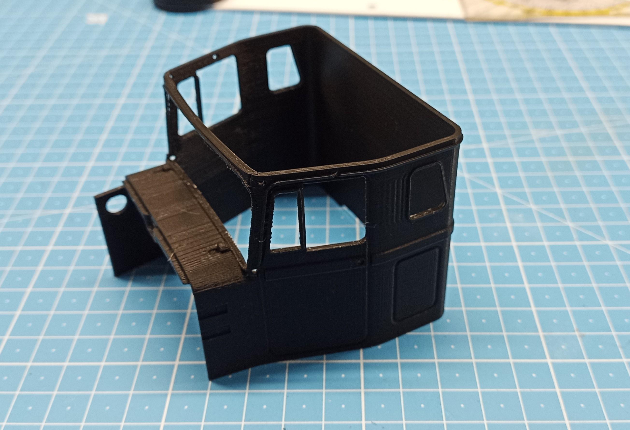

Jürgen M. Posted August 21 Author Share Posted August 21 The first part designed and printed! I might have to print again after I made some corrections but generally it looks pretty good I'd say! I decided not to put the mirror brackets on the doors. Freedom of art! 😊 The roof is in print! 1 Quote Link to comment Share on other sites More sharing options...

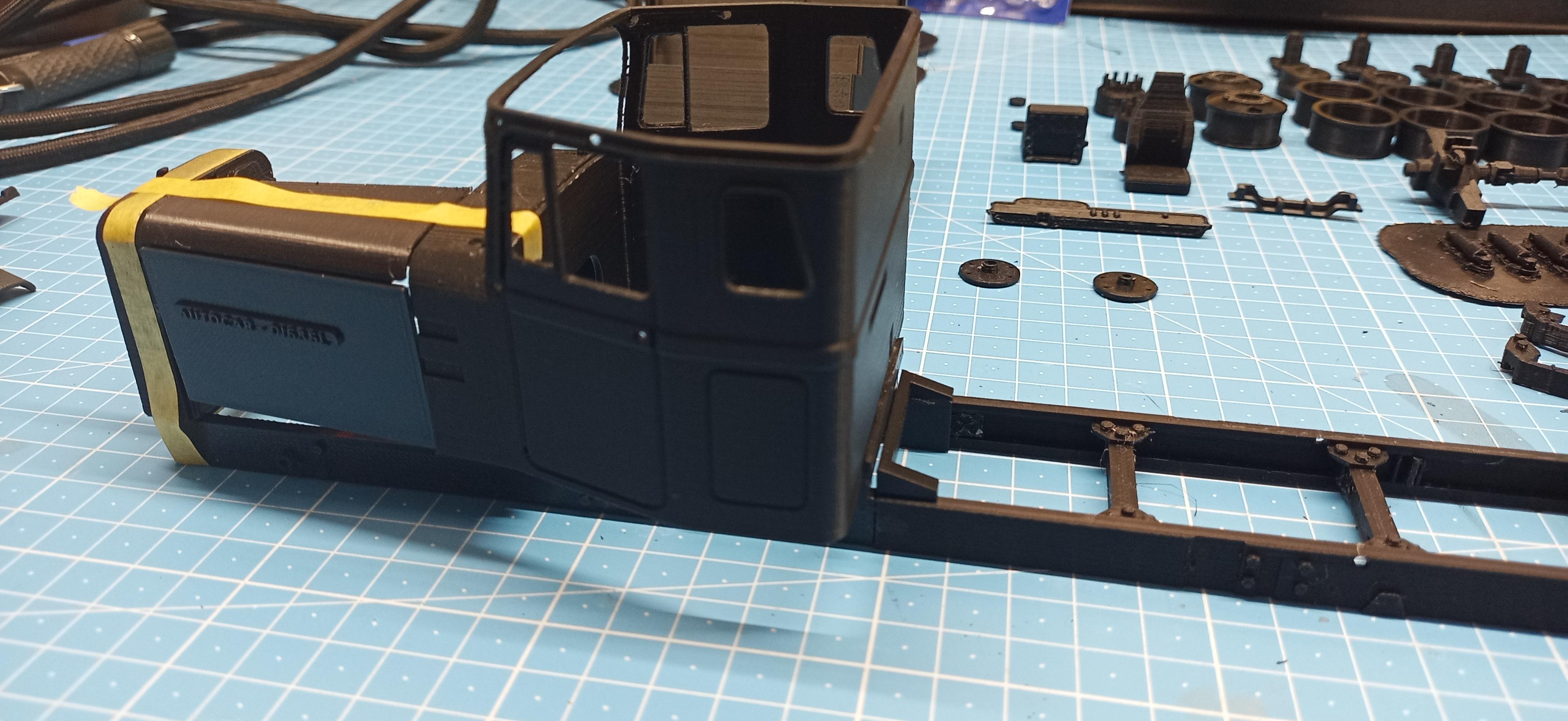

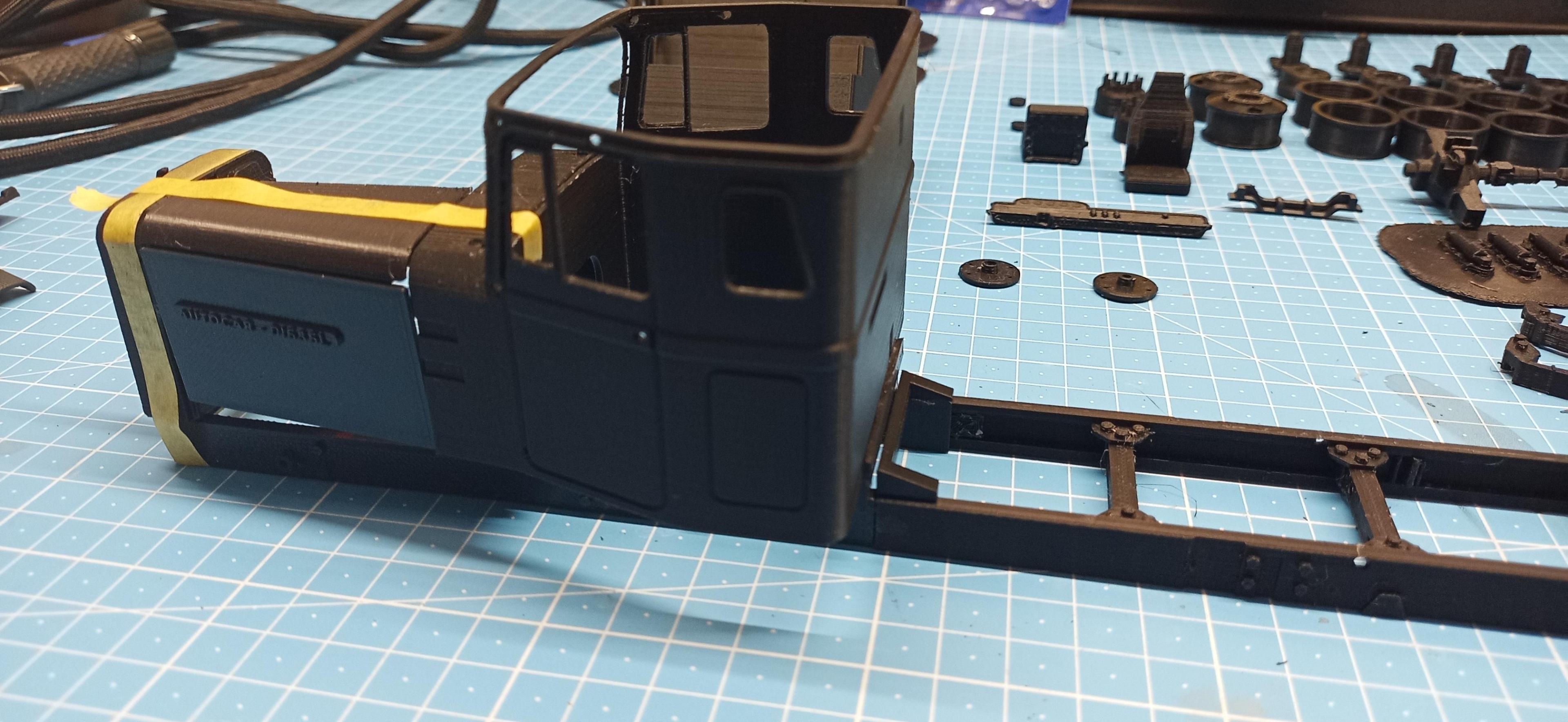

Jürgen M. Posted September 4 Author Share Posted September 4 (edited) Little mock up to see if the hood fits in! I'll install some kind of "stopper" for the Back of the cab to be sure to fix it in the correct position on the chassis! Don't want to see the hood falling through or not fitting in later. Edited September 4 by Jürgen M. 1 Quote Link to comment Share on other sites More sharing options...

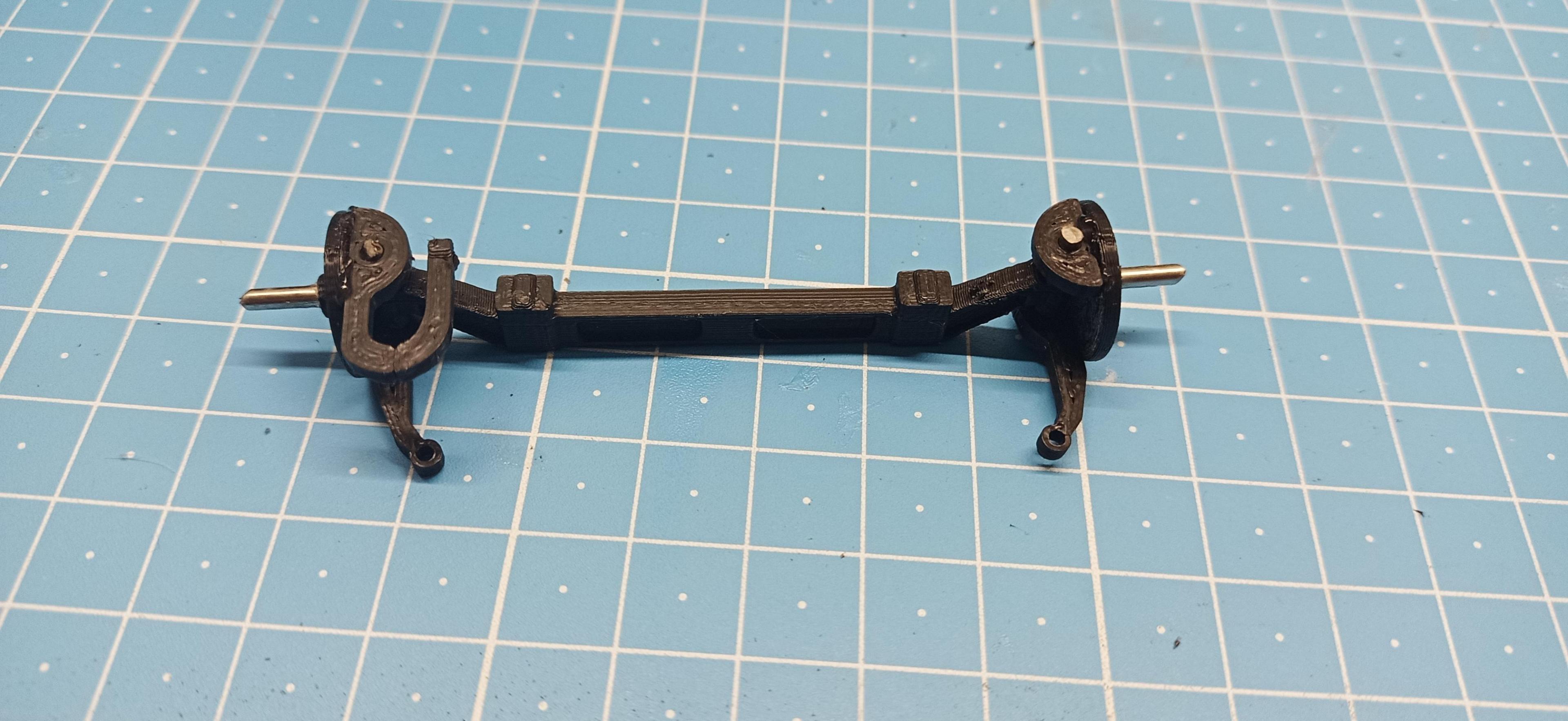

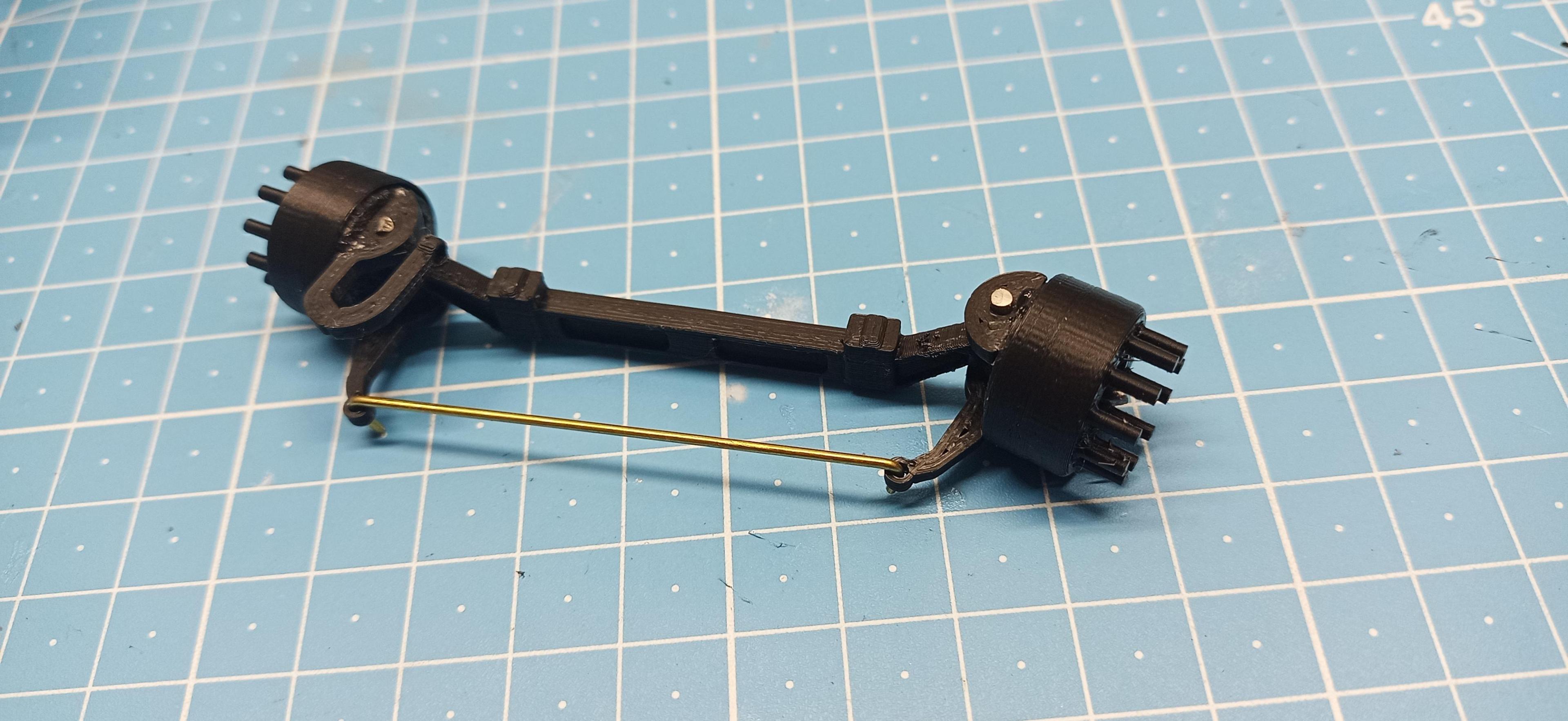

Jürgen M. Posted September 4 Author Share Posted September 4 Here's the beginning of the front axle assembly with steering components: 1 Quote Link to comment Share on other sites More sharing options...

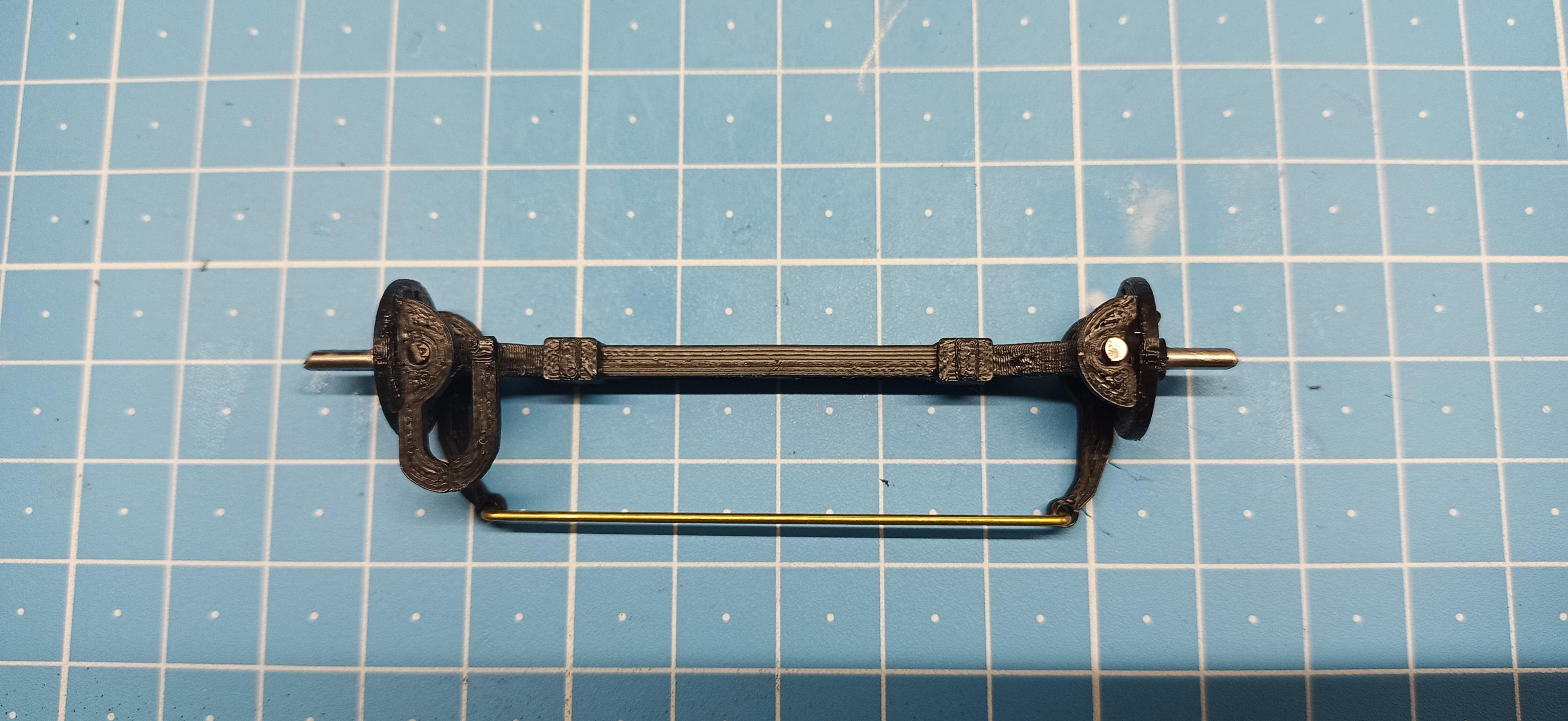

Jürgen M. Posted September 4 Author Share Posted September 4 (edited) Steering is completed! The hardest part to me is making the tie rod exactly the right length so the wheels are straight. The brakedrums are just fitted on to see if everything works! They turn perfectly and without wobbling. They'll be fixed on the axles by rings. You can find them on the picture with all the printed parts. Still I'm not sure If I'll use the brakedrums with the printed bolts! If they break during assembly that would be awful. As a plan "B" I actually cut a 1.5mm Allen key to short pieces looking like chromed bolts. The brakedrums would then have fitting holes to hold them. I'll prepare one and show you. Plan C would be the printed 6-edge rods to be Cut down to size. Easier than cutting a hardened steel Allen key but also fragile. 😊 Edited September 4 by Jürgen M. 2 Quote Link to comment Share on other sites More sharing options...
