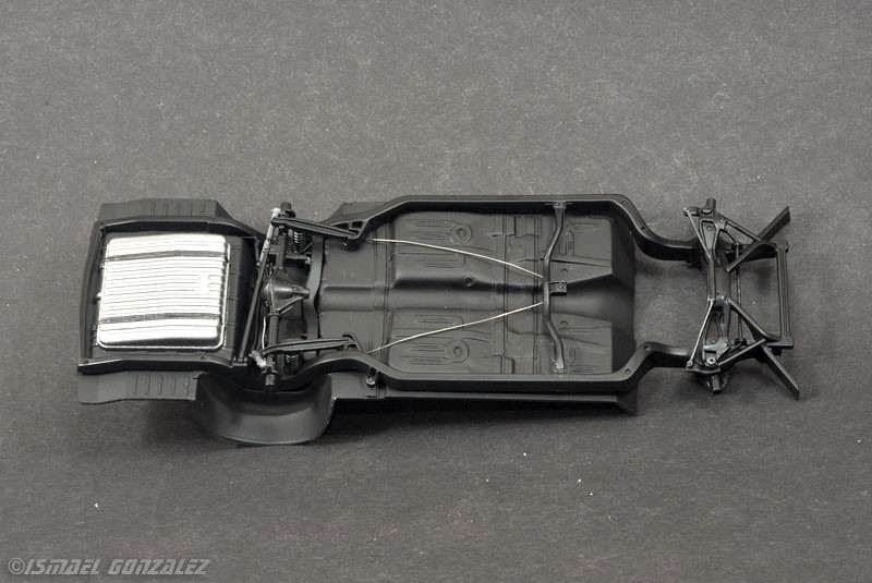

ismaelg Posted September 24, 2024 Author Posted September 24, 2024 Hello, Quite busy at work so not much bench time these days. But I managed to work the gas tank, straps and parking brake lines/cables. Thanks, Ismael 3

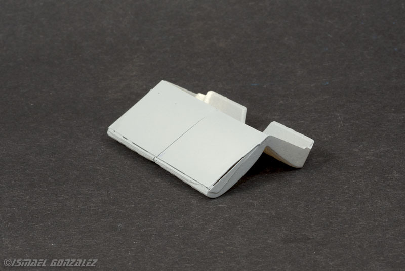

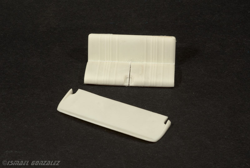

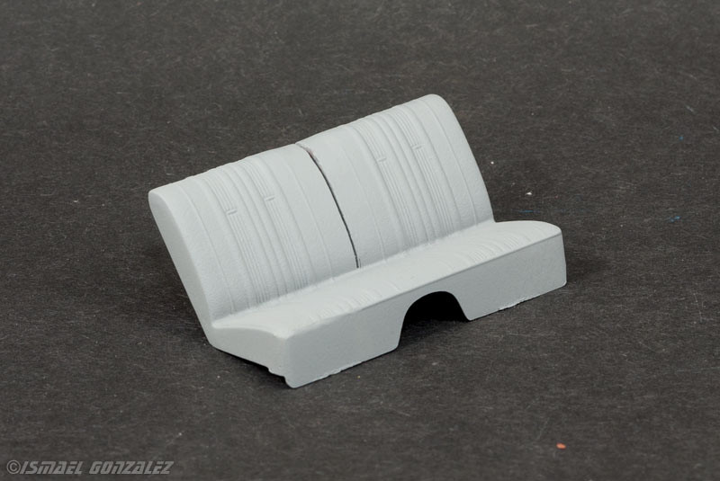

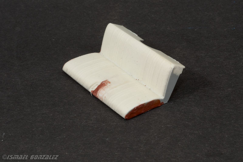

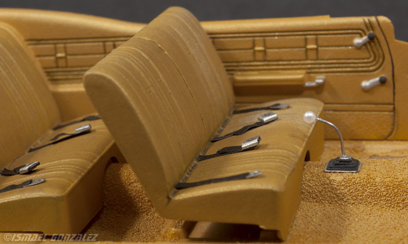

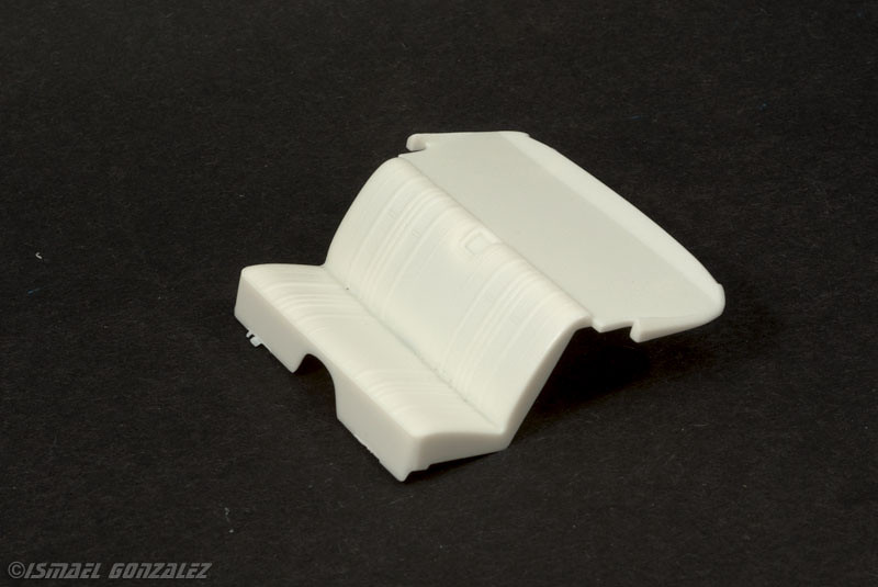

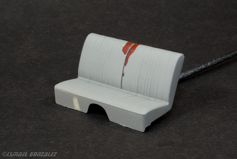

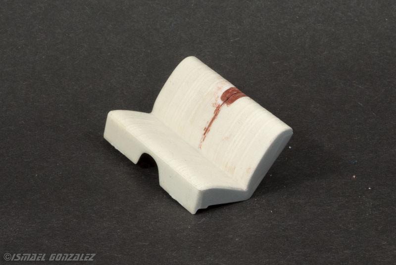

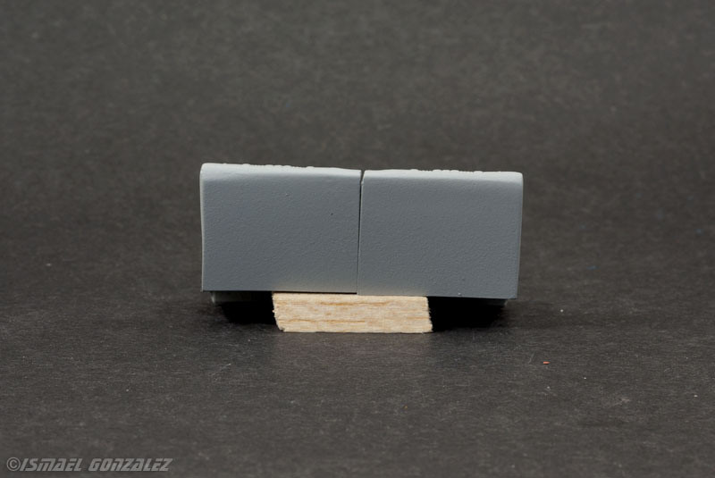

ismaelg Posted September 28, 2024 Author Posted September 28, 2024 Hello, This is the only hobby I know where you spend considerable efforts to "downgrade" something. The model comes with bucket seats and center console. Very upscale trim level. But I'm going for the "sleeper" look. I want my car to look like a base model, as cheap initially as possible because I wanted to tinker with it to go street racing. That is the essence of a muscle car. Not sure if the base bench seat was available in the 2 door coupes, but here is the story in pictures of how a second rear seat became a front 50/50 split base bench seat. By the way, there are like 2 weeks of work here because I have been (and still am) very busy at work. Very minimal workbench time. Start with a spare rear seat. Let Rusty Trusty go to town. Rusty Trusty is my decades old little hacksaw. Add sheet styrene bits for the basic shape. Go to town with putty. Shape and repeat about 5 million times. Primer to check progress, then a few million more cycles of putty. Round all hard edges to avoid the "blocky" look and give the illusion of cushion. Refrain from making the center seam perfectly symmetrical for the same reason. TA-DAH!!! A base model split bench seat. Thanks, Ismael 3

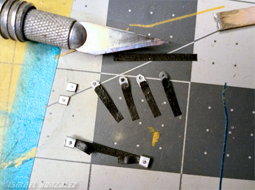

ismaelg Posted October 1, 2024 Author Posted October 1, 2024 Hello, Safety! It is all about safety! Not that masking tape seatbelts and styrene buckles would be of much help... Thanks, Ismael 1 2

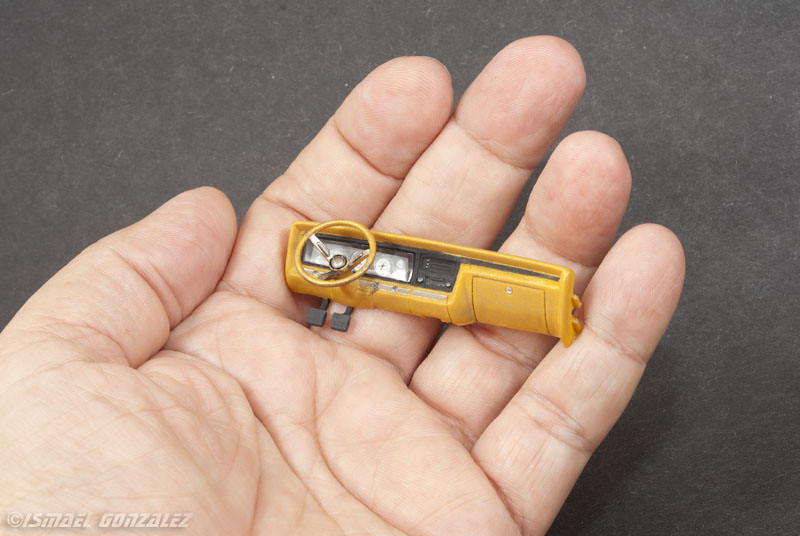

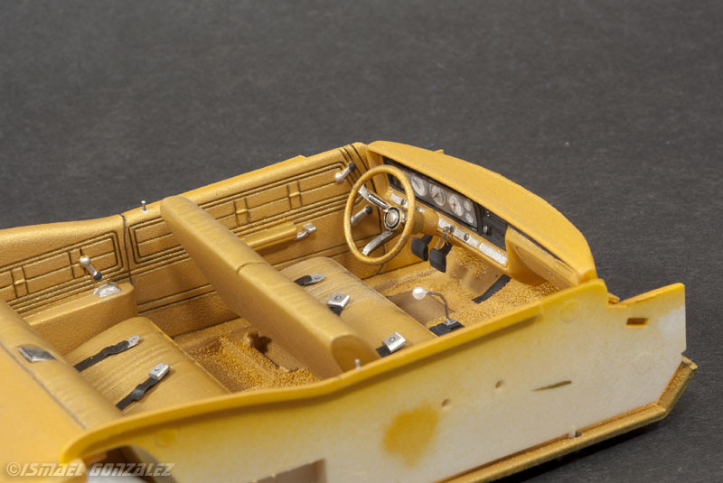

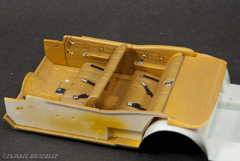

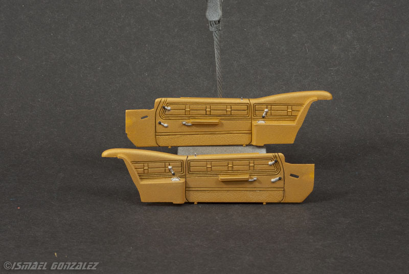

ismaelg Posted October 1, 2024 Author Posted October 1, 2024 Hello, Interior teaser: Notice the door locks. Thanks, Ismael 6

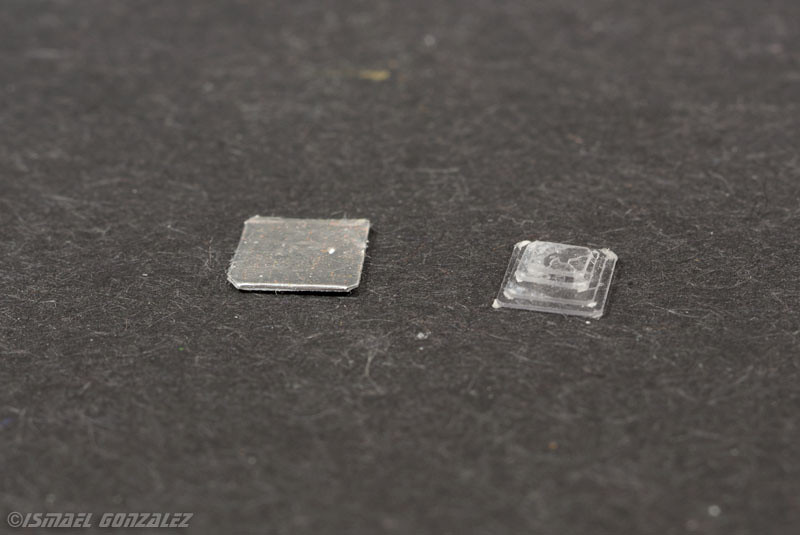

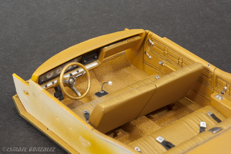

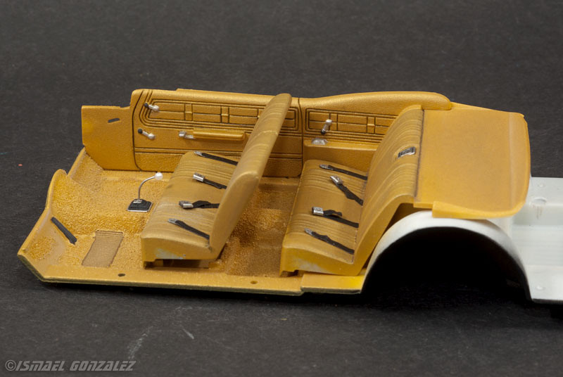

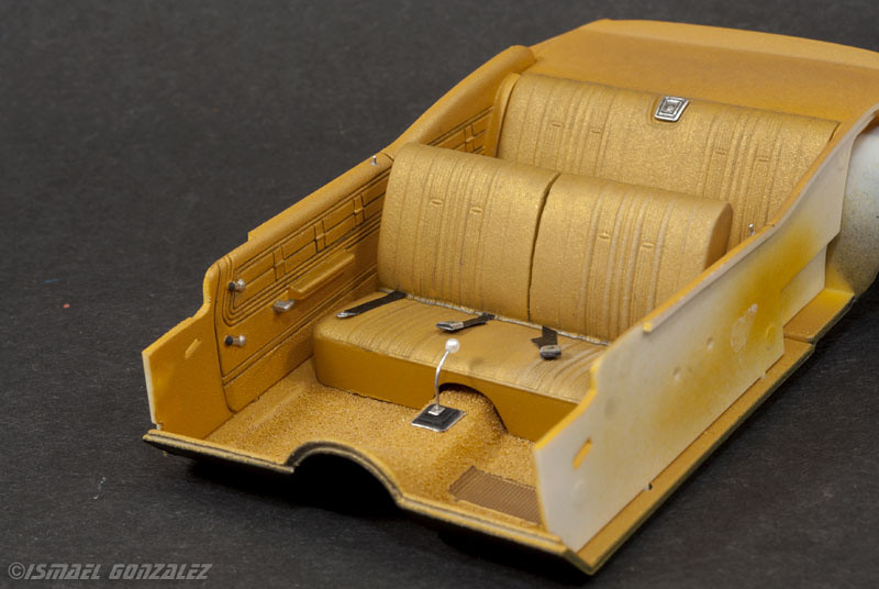

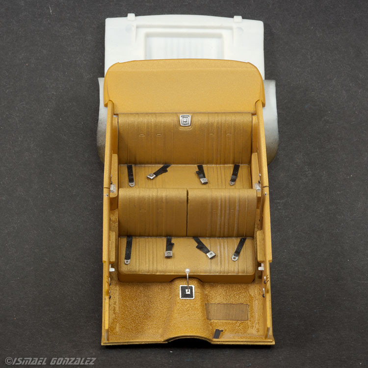

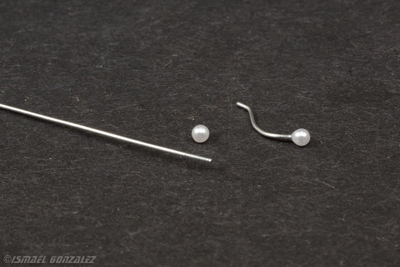

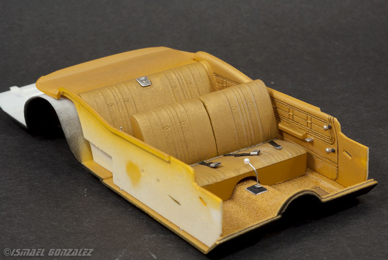

ismaelg Posted October 3, 2024 Author Posted October 3, 2024 Hello, OK boys, time to shift gears and floor it! Wire, a tiny craft ball and superglue. Alum tape square plus 4 styrene squares of different sizes. Glue, paint and you got yourself a period correct floor shifter! Ohh you want to see the rest of the interior? Notice the driver's seat is a bit more weathered than the passenger seat and the rear seats are pristine. Tells the story of usage. Thanks, Ismael 3

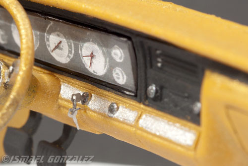

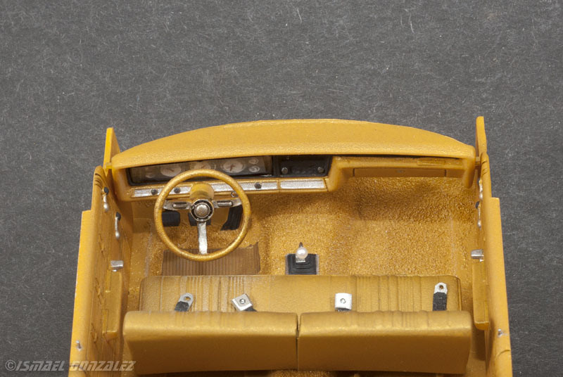

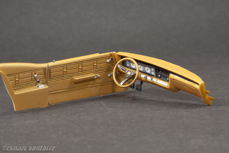

ismaelg Posted October 5, 2024 Author Posted October 5, 2024 Hello, Dash pretty much done. Instrument needles are painted wire. Yes, there is a key in the ignition and another key in the keychain. Prototypically correct for Chevrolets of the era. Square key for ignition, round key for door locks. Thanks, Ismael 5

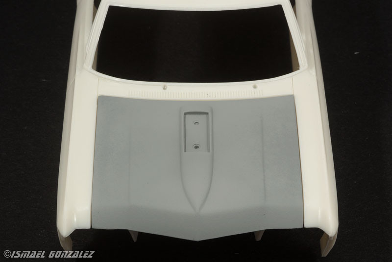

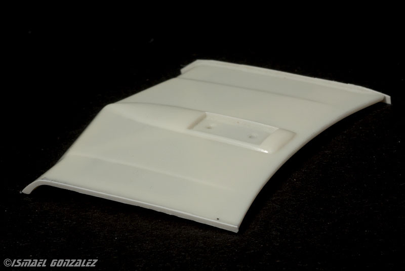

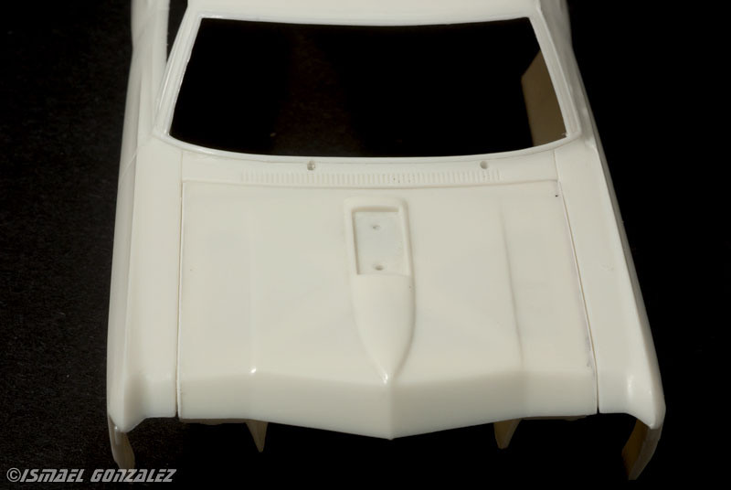

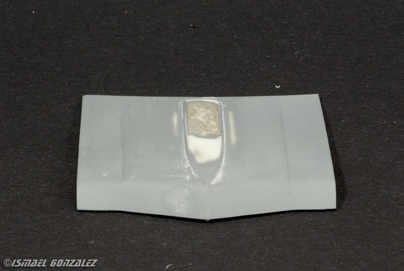

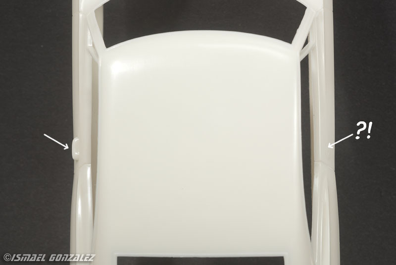

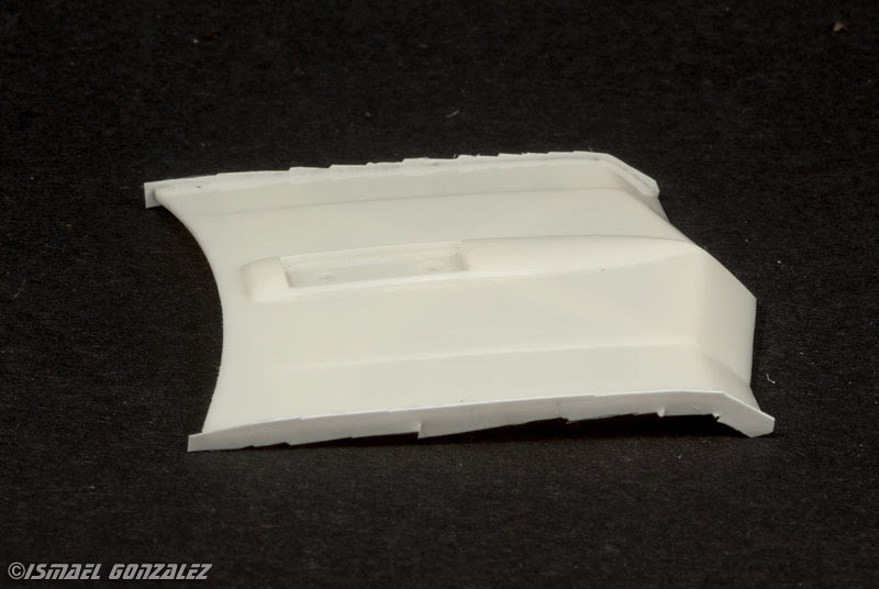

ismaelg Posted November 8, 2024 Author Posted November 8, 2024 Hello, Shaved door handles in process. Added styrene strips to the sides of the hood to tighten the gaps. HUH? Ohhh, going for a more sleeper look you sneaky. Only the sharpest eyes will note this is NOT a base Impala hood. Thanks, Ismael 1
