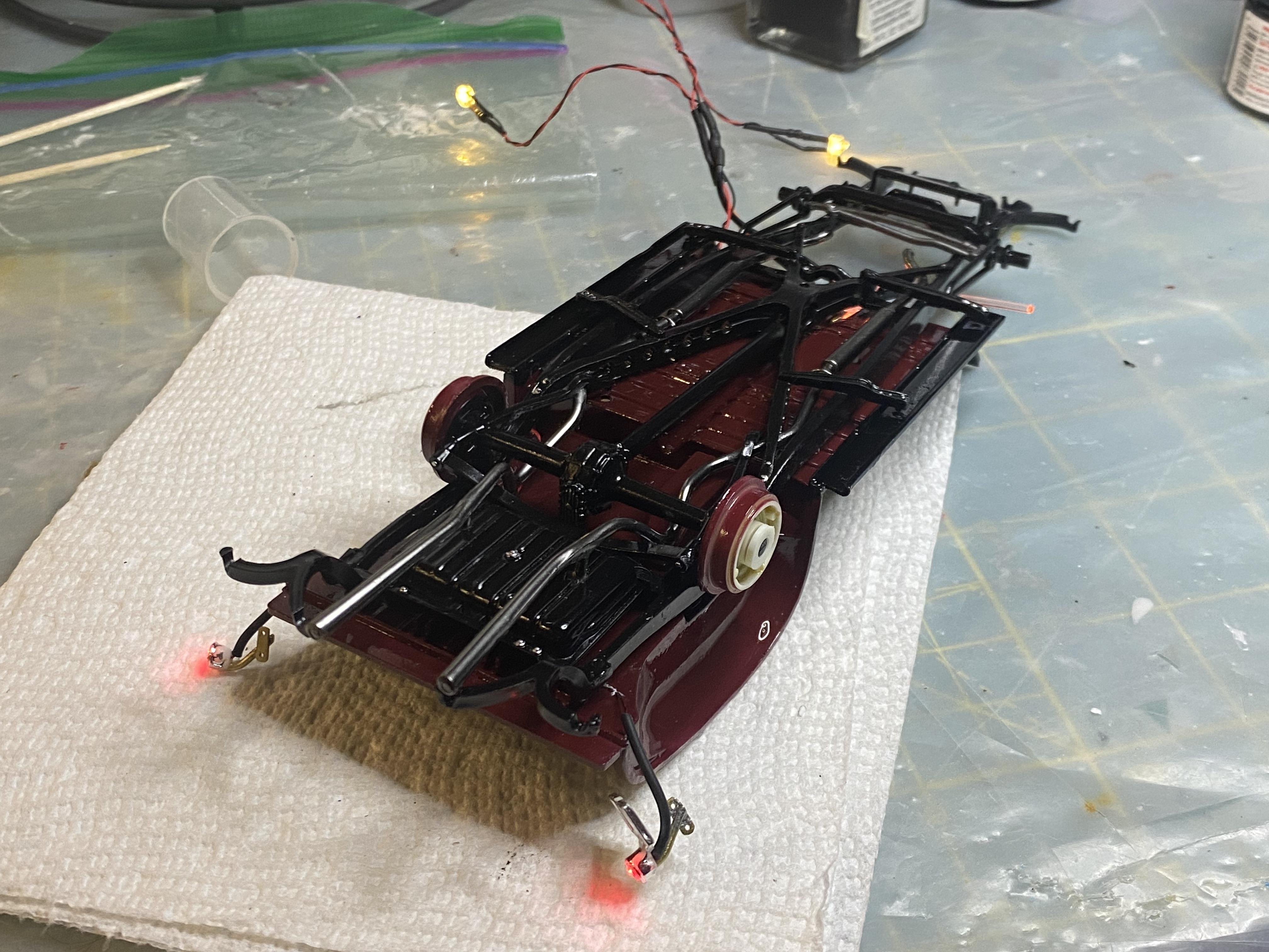

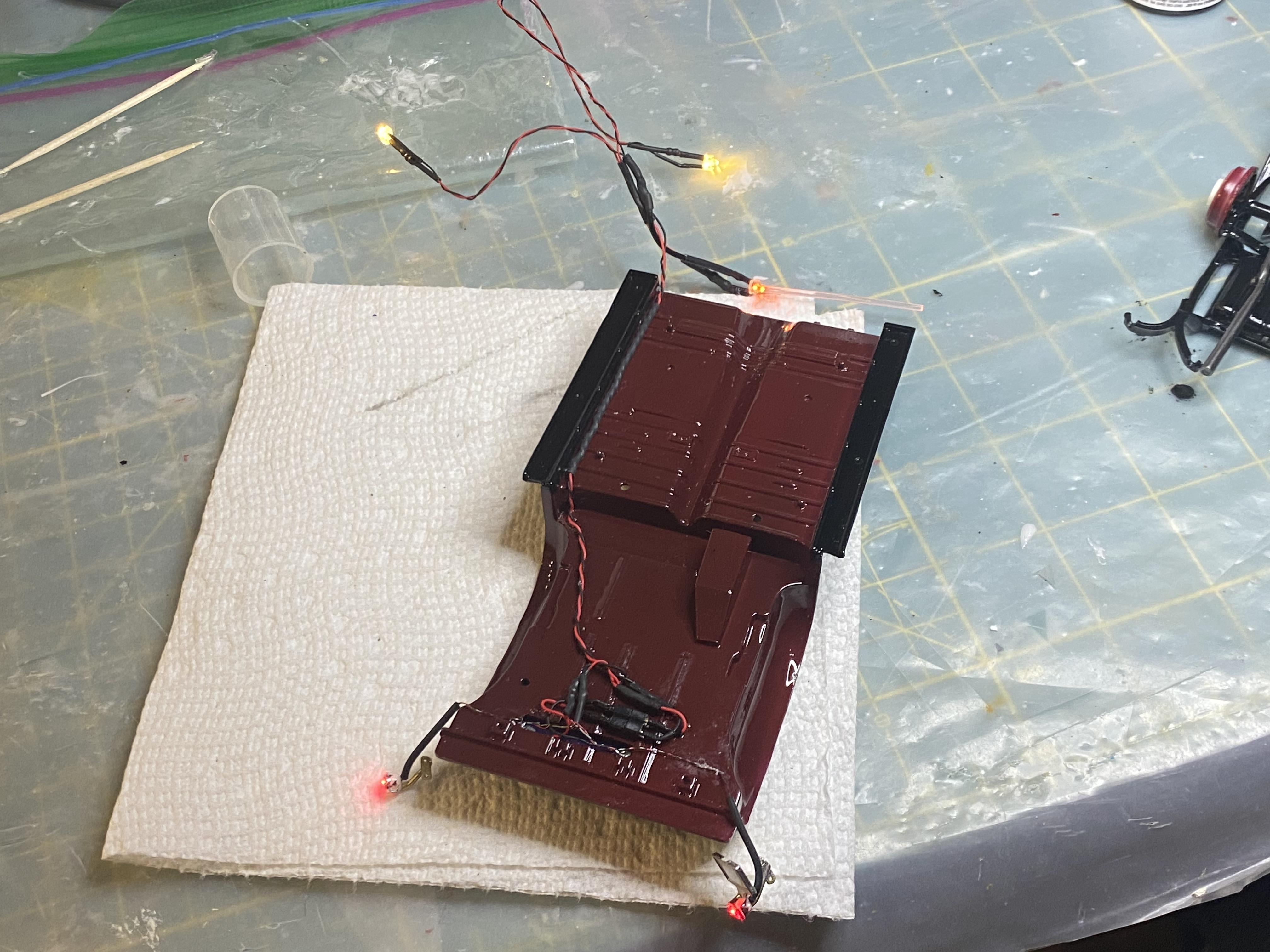

With the body mods and the lighting, here's so much to like about what you're doing with this kit.
Spectacular work on this Donald!

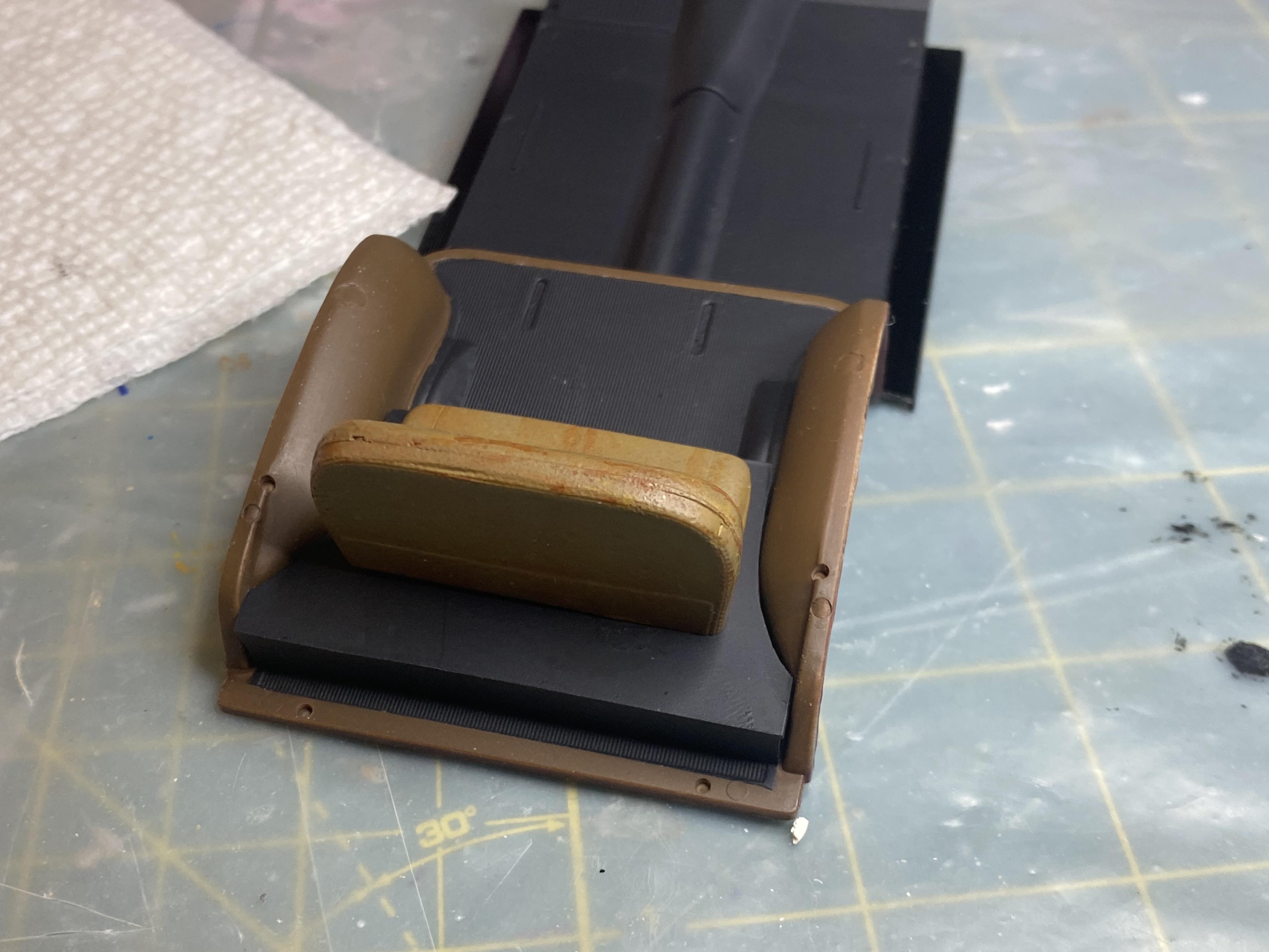

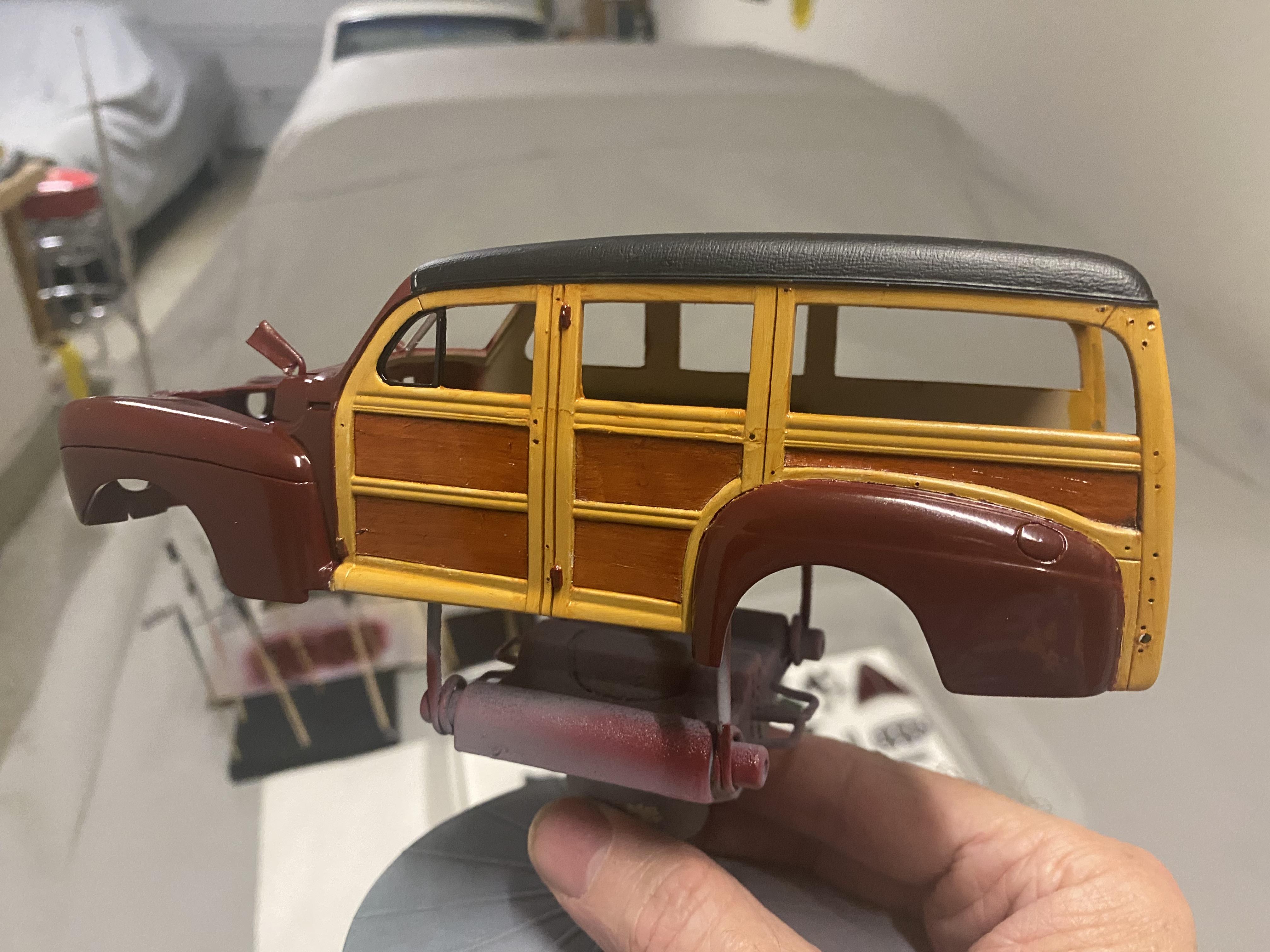

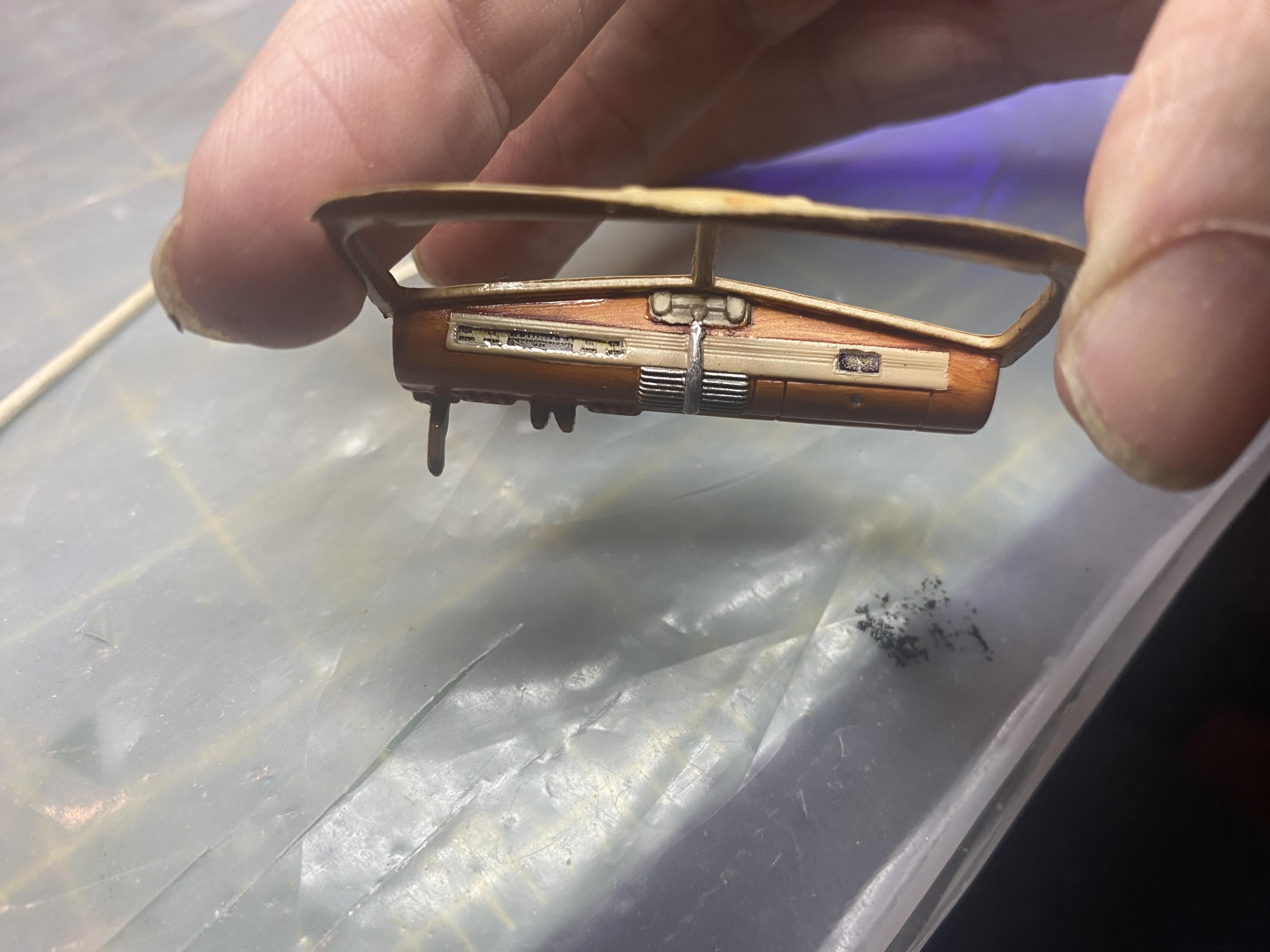

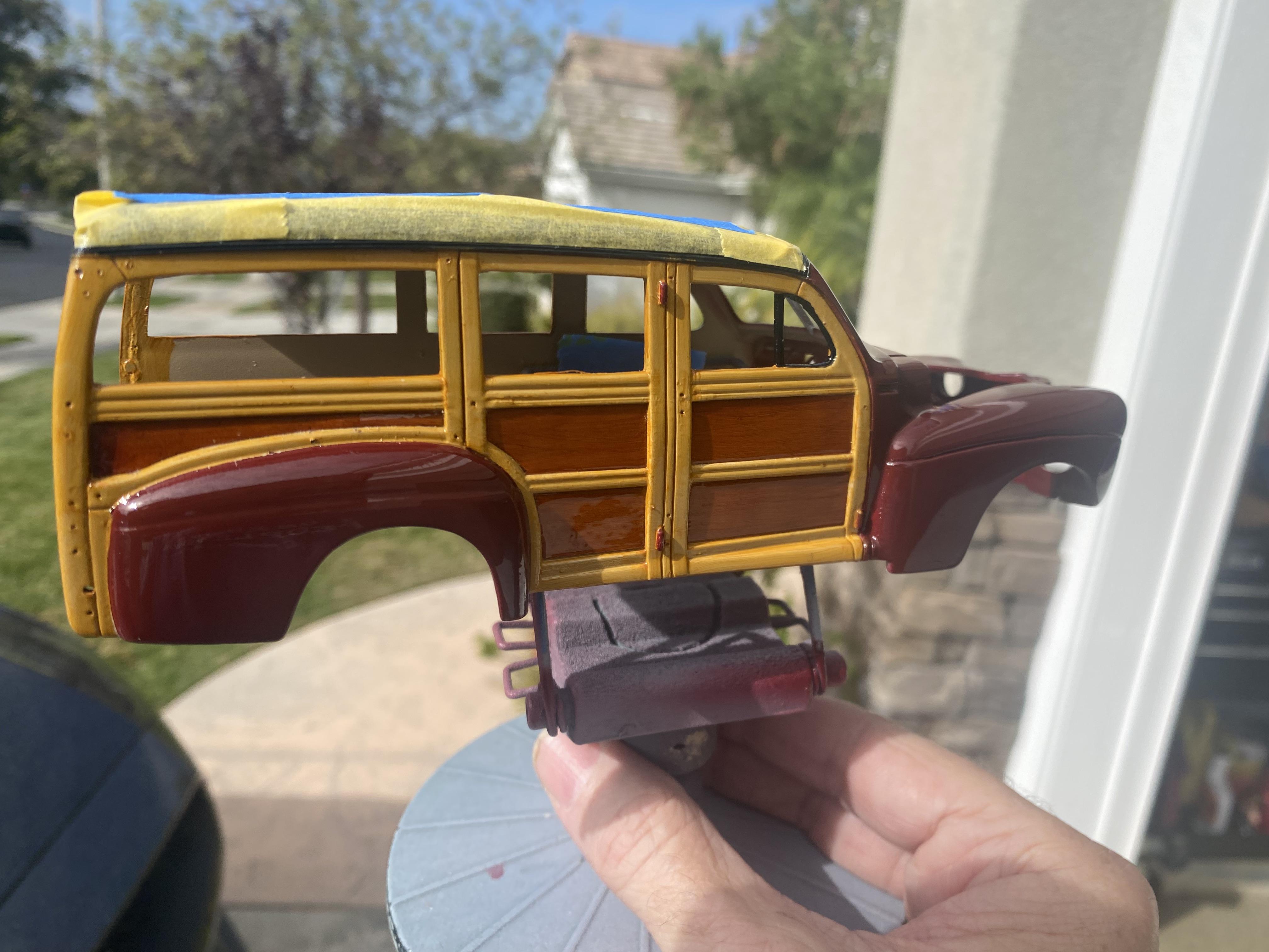

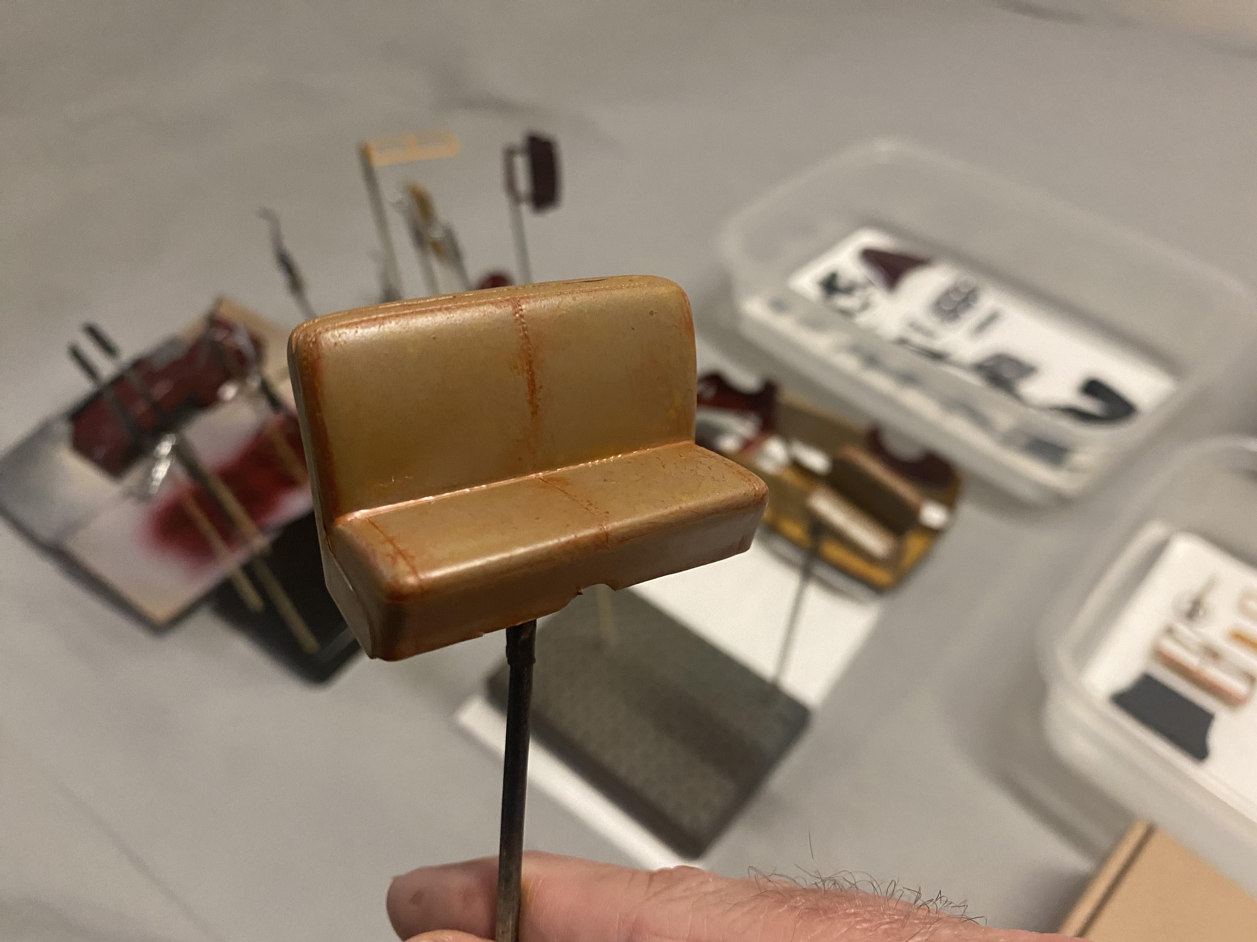

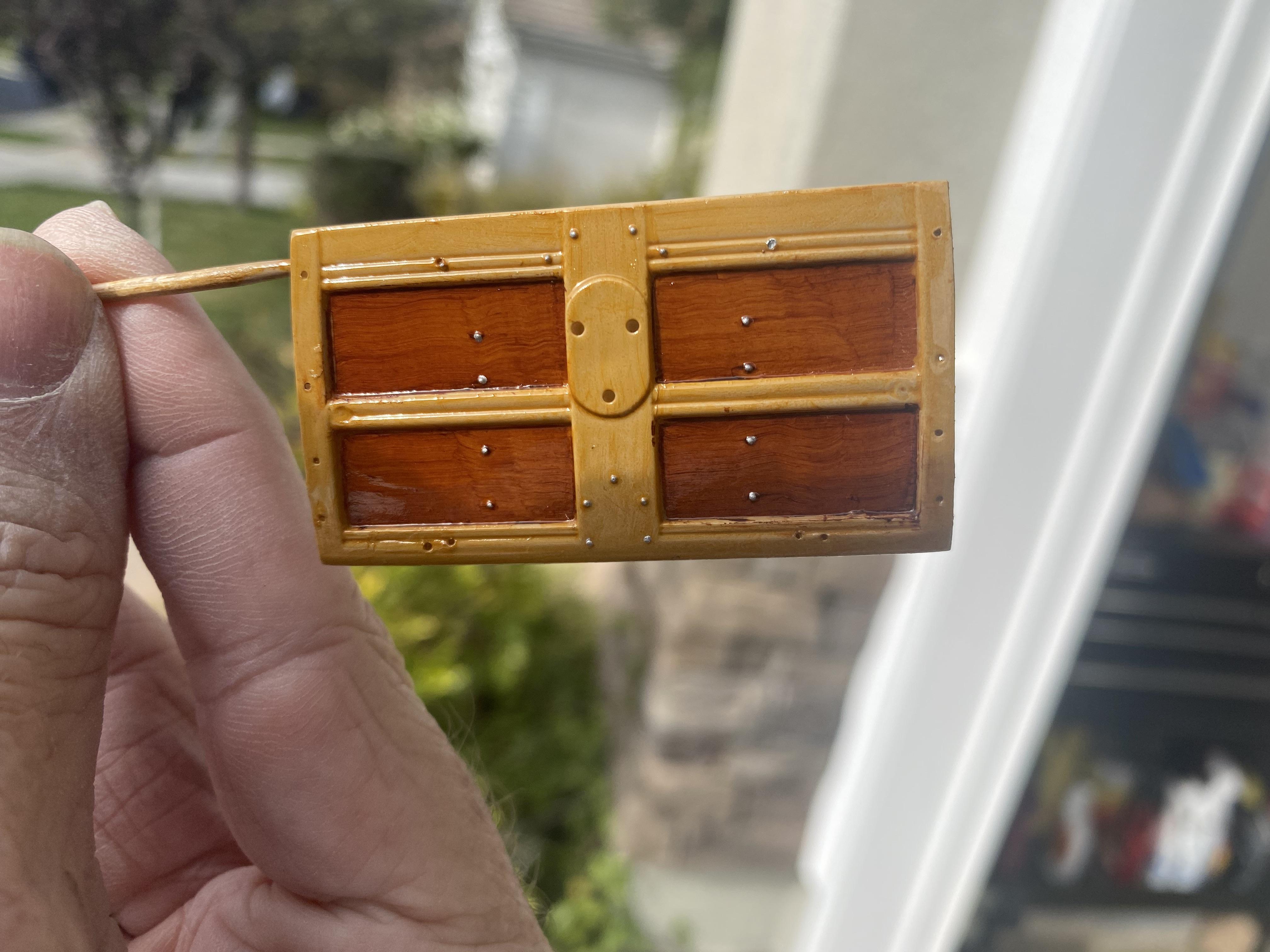

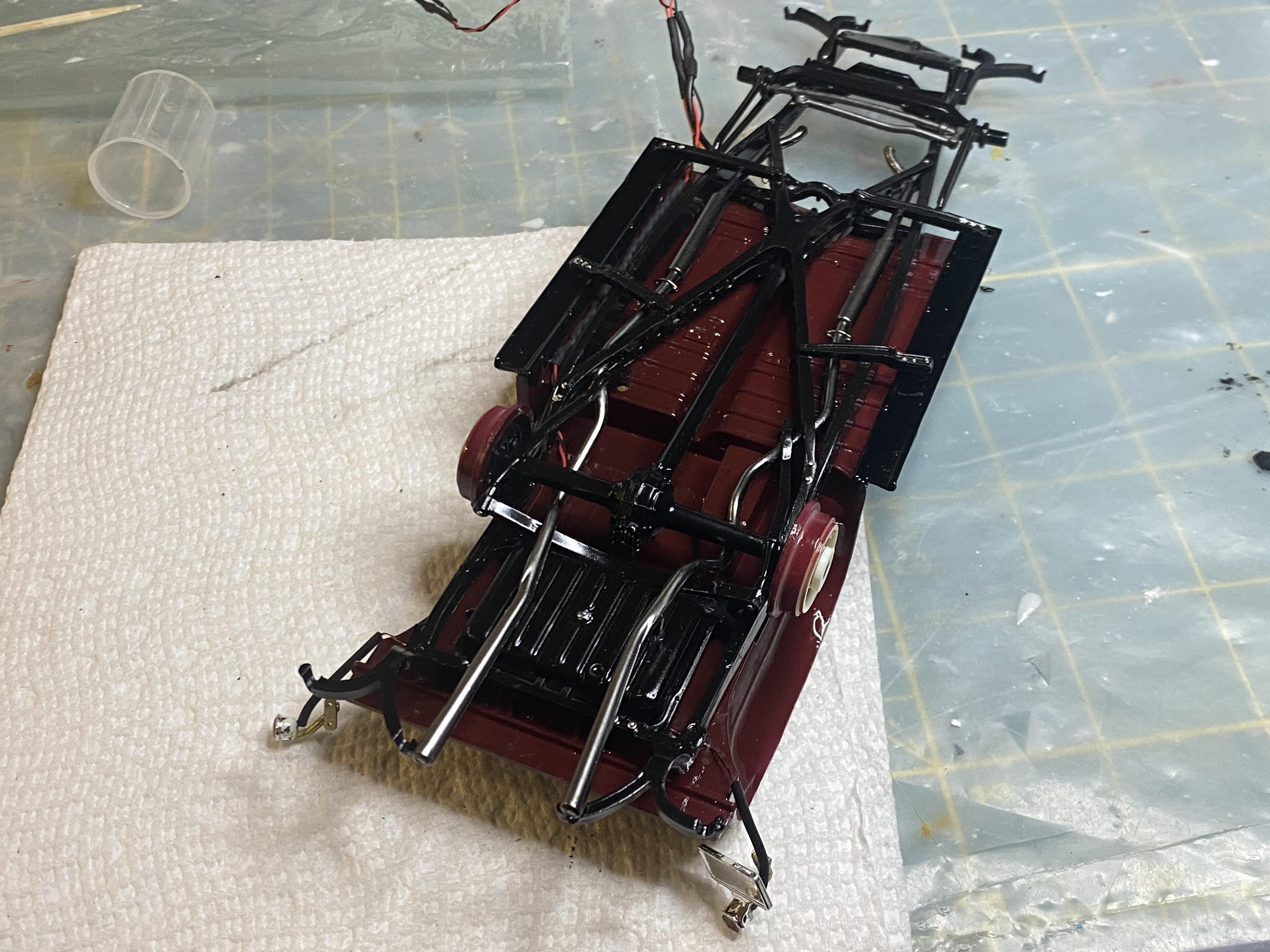

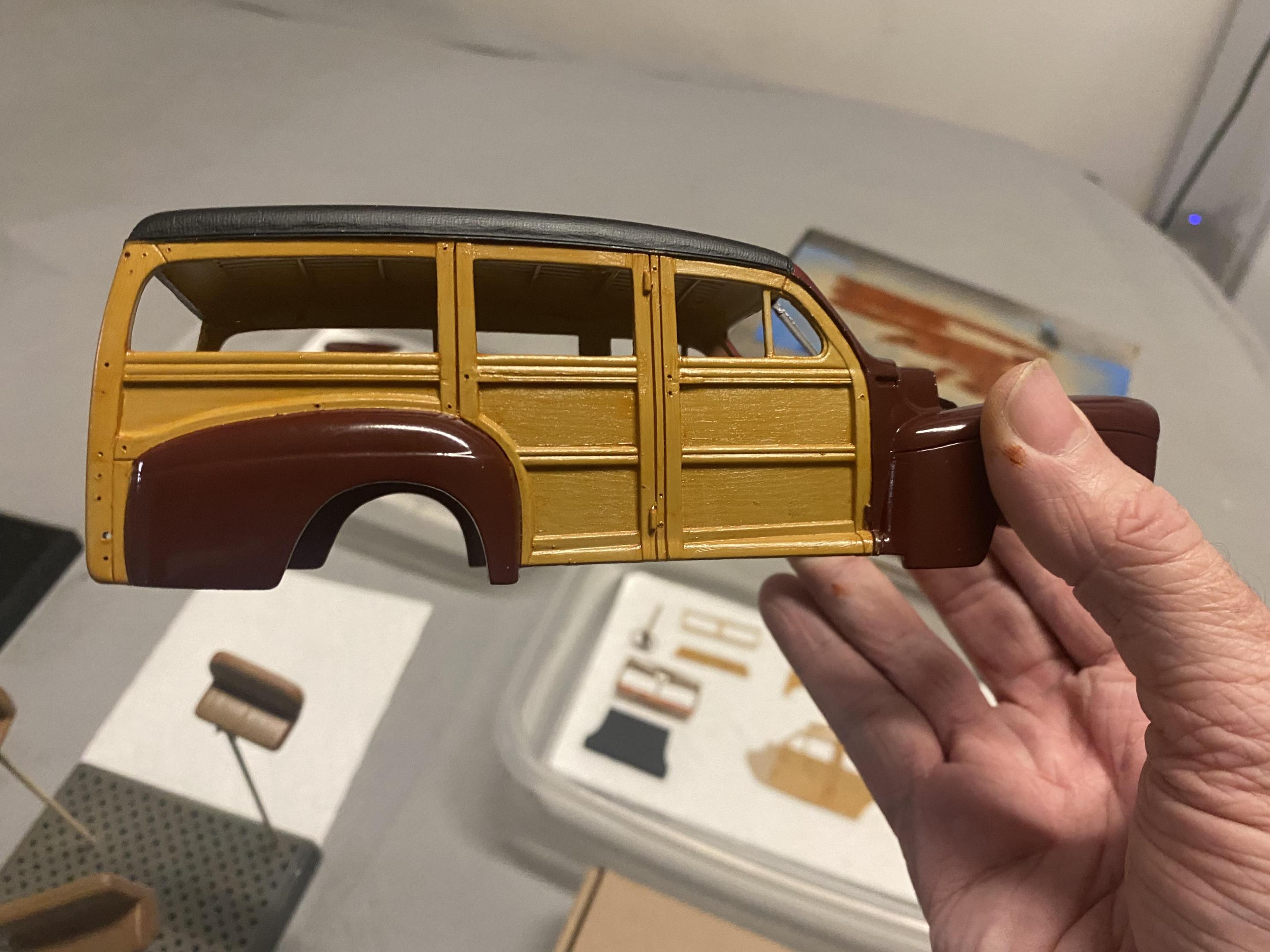

Interior detail pretty much done, very simple interior. Aged the leather just a bit.Woodgrain work pretty much done. Next to 2K clear the body and a bunch of parts.
IMG_5655.thumb.jpeg.c2df686e6264e2715140ad3f7d12a900.jpegIMG_5656.thumb.jpeg.bb7a613d6cac9ae1aef8a9864cef8030.jpeg
IMG_5658.thumb.jpeg.6509bca994bc809ddd45e8d4929952d2.jpegIMG_5659.thumb.jpeg.0fca01988c6b848a03d38ba6953b3080.jpegIMG_5663.thumb.jpeg.7e699037ddcbe624c72e89ba6e43dcb9.jpegIMG_5665.thumb.jpeg.877477a9c9af48ea5e2225b2104fb398.jpegIMG_5667.thumb.jpeg.04c2c7731a43fae11cacb552805ccb26.jpeg

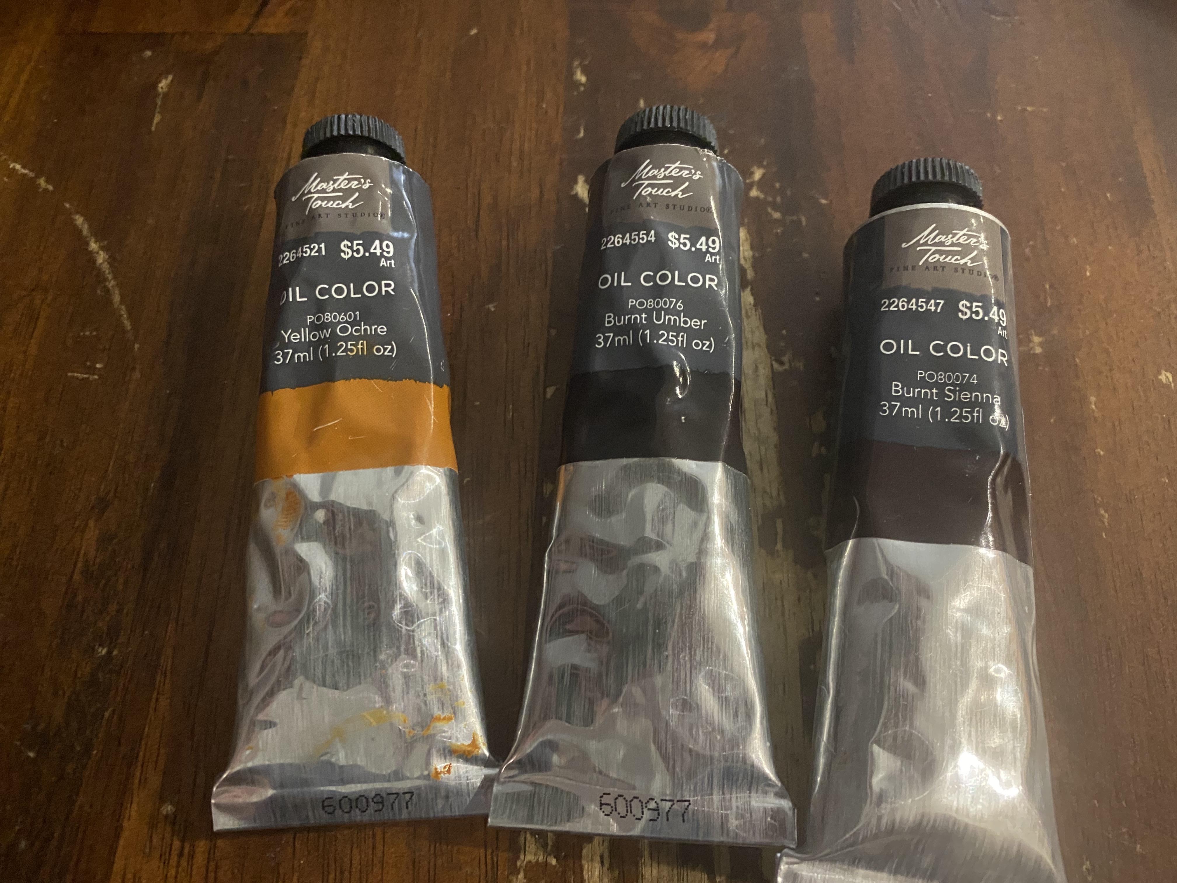

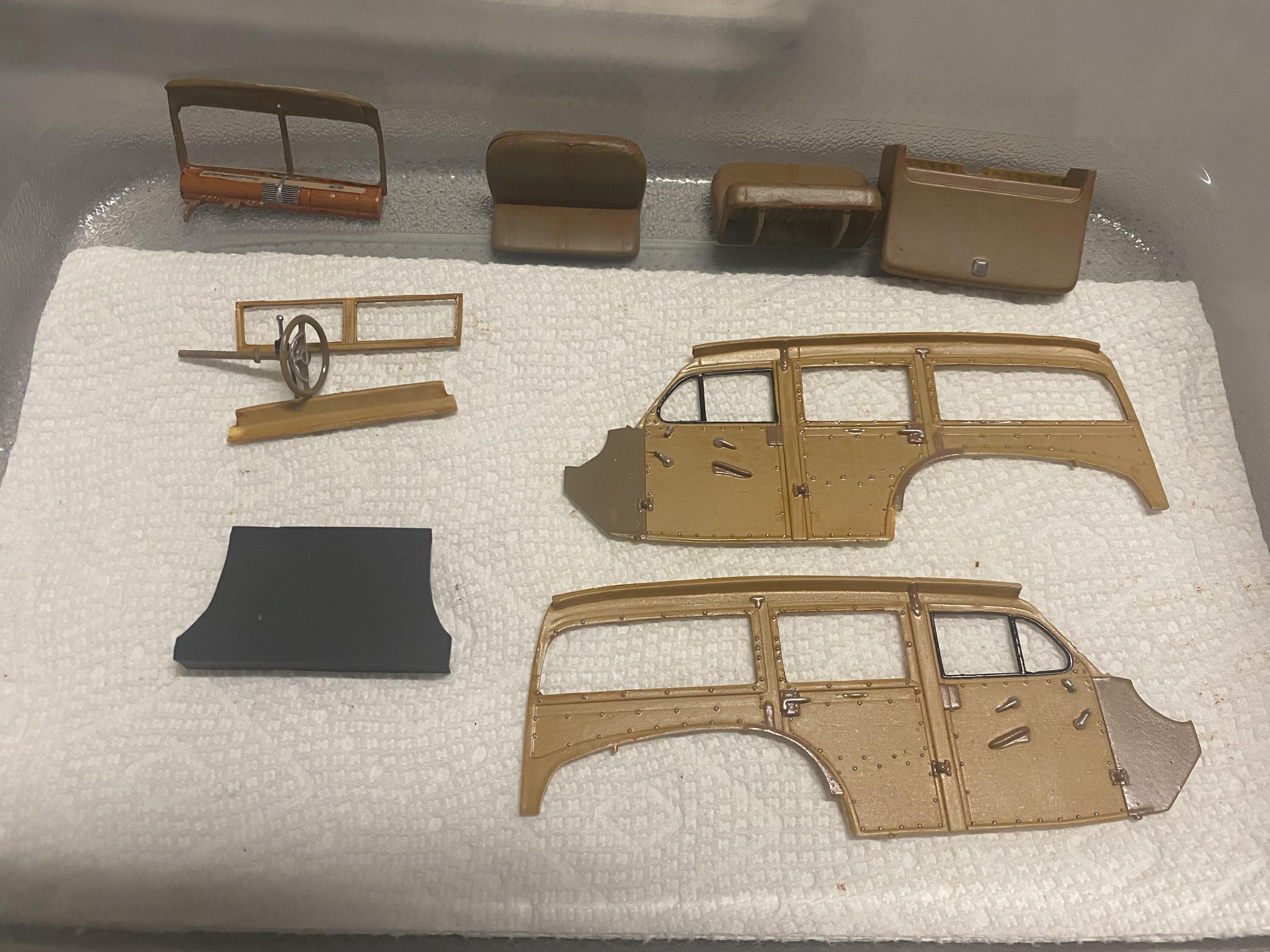

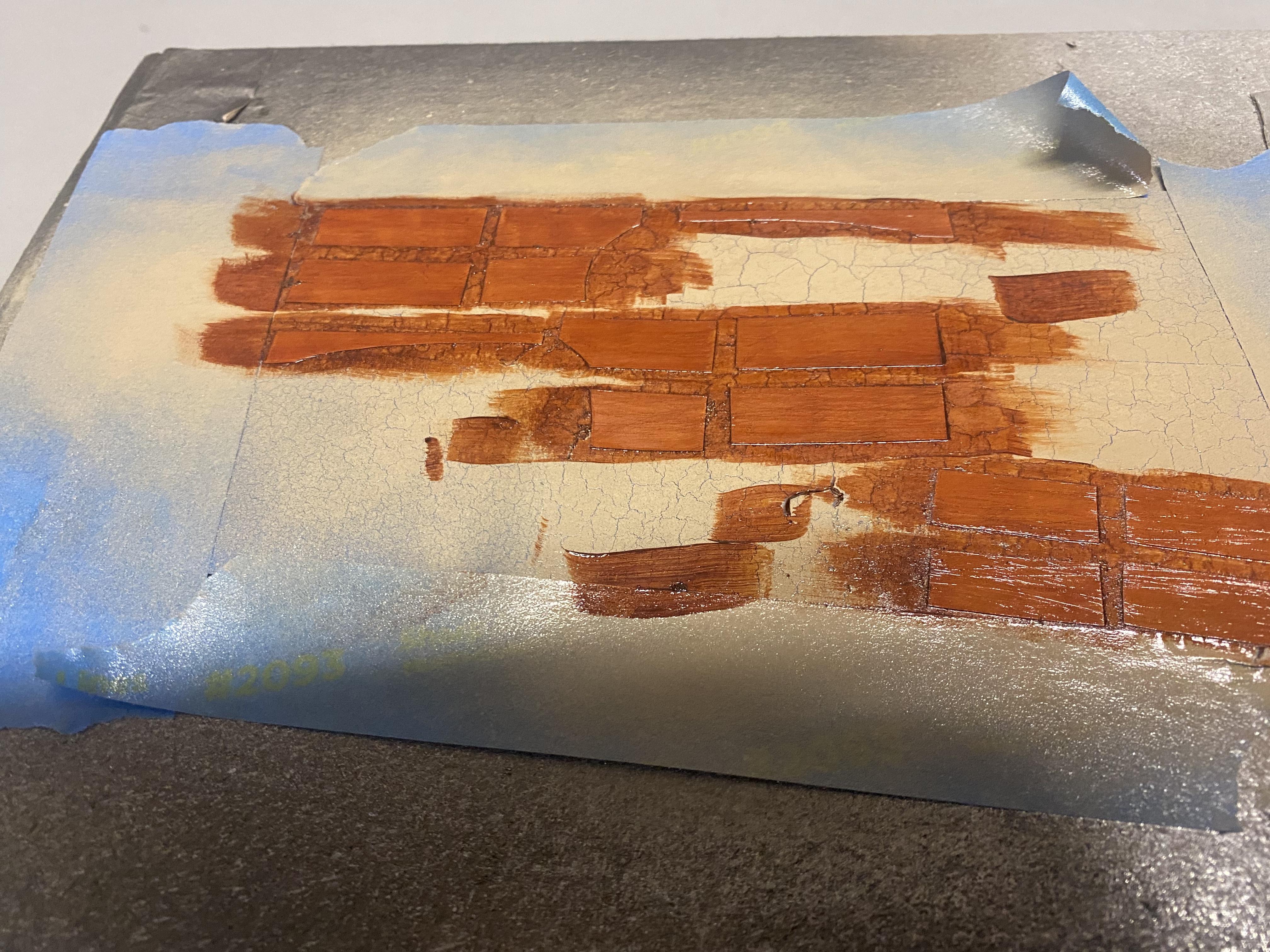

someone in DM was asking how I do the woodgrain. This is a video I found useful.
The first thing do spray the wood area with Tamiya TS-68 wood deck Tan.
these are the oil paints I use.
IMG_5669.thumb.jpeg.2af0f49c170147065e8c828073bf2109.jpegdarker color is about 50/50:burnt umber & burnt sienna. lighter is yellow ochre with a small amount of burnt sienna. Some old ragged paint brush and drag it across the panel. Don’t stop in the middle too much. You have plenty of working time so don’t rush it. My last post is before I clear the whole body including the woodgrain which will bring it out even more.

Wow! Excellent work on the leather and wood!

Besides the body color the wood grain finishes are realistic looking.
  • Like 1
Thanks, the body color is a 1940-1941 ford maroon I got from MCW finishes. I try to keep my paint colors as accurate as possible to what would be available for the year and manufacturer.

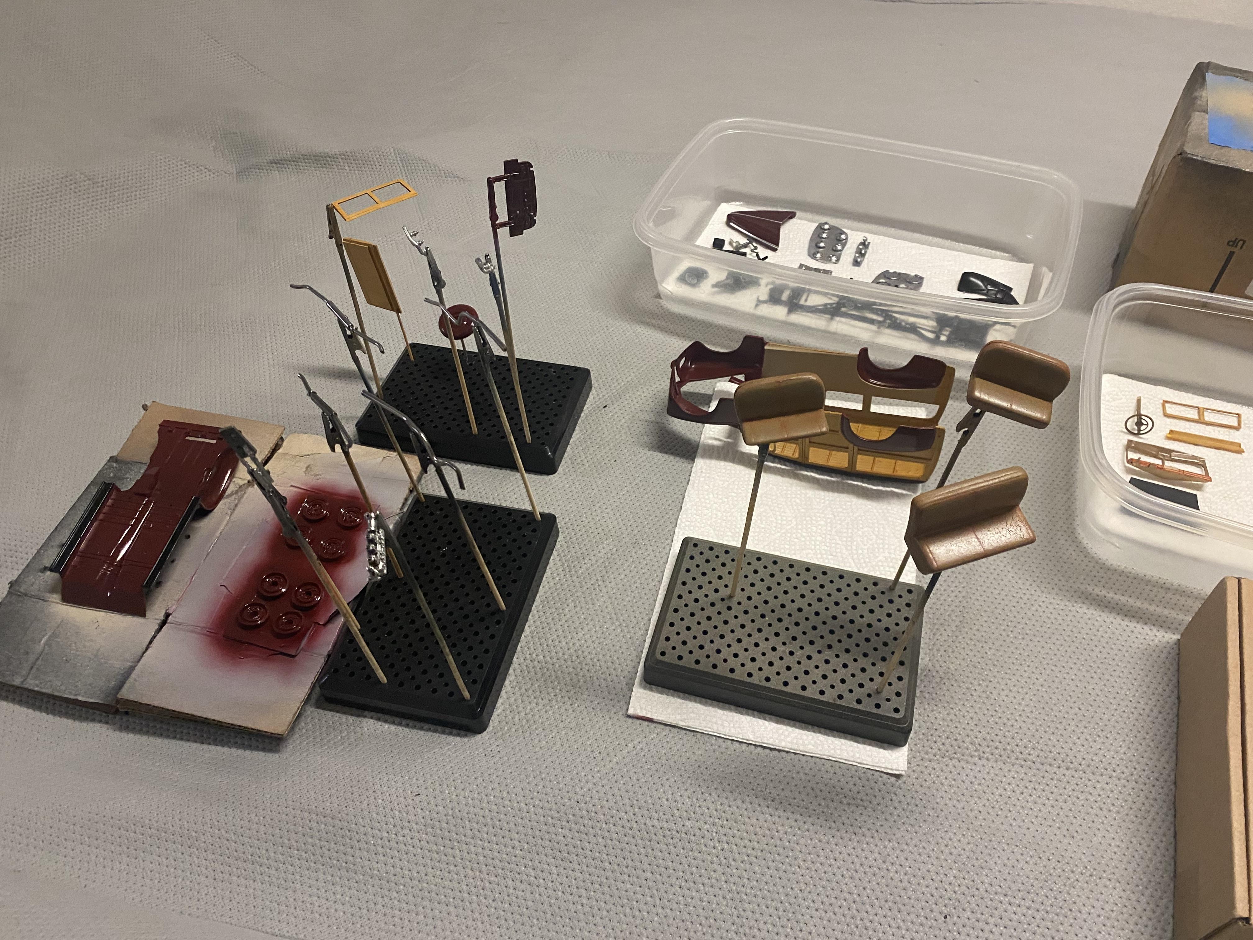

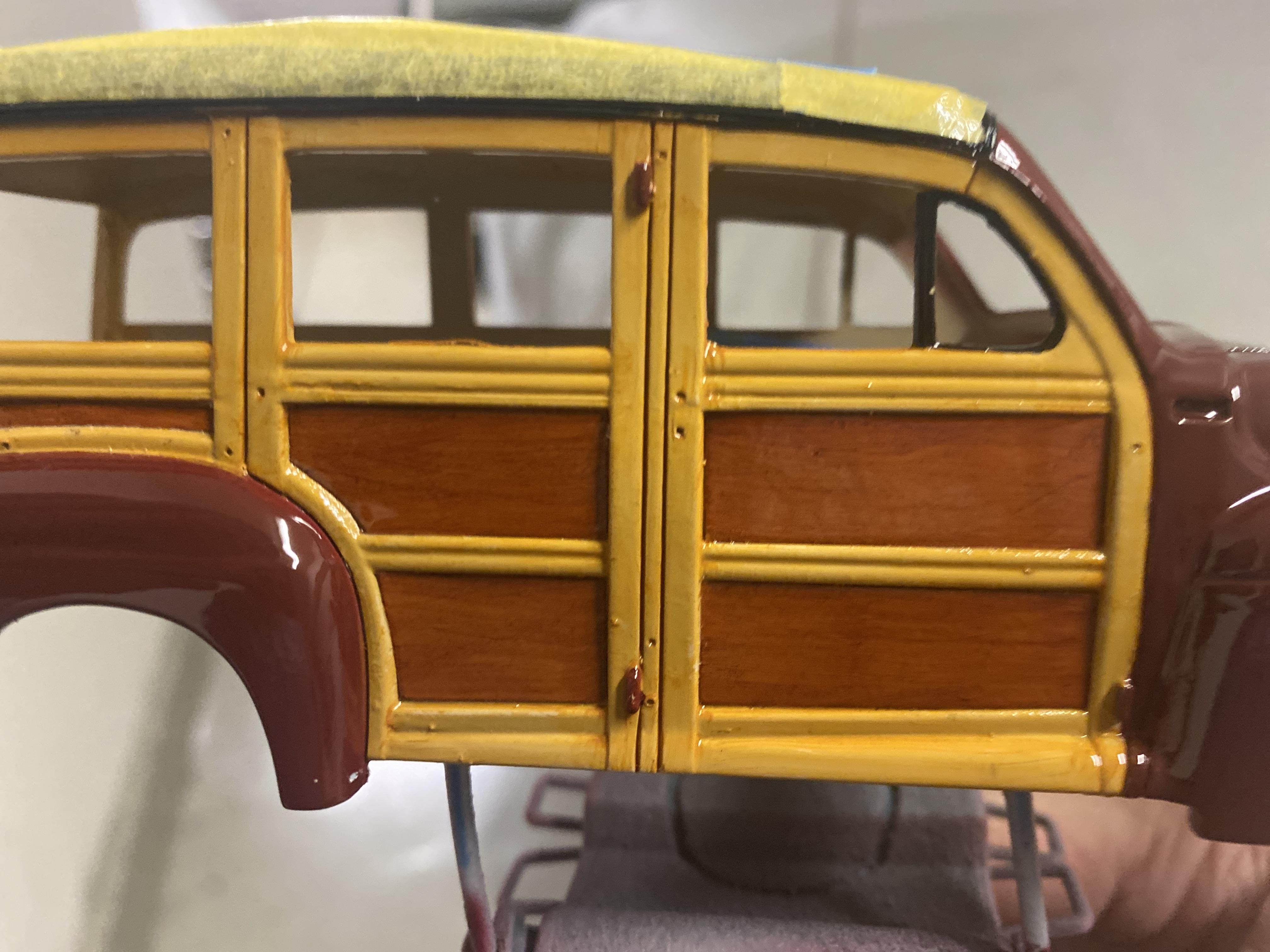

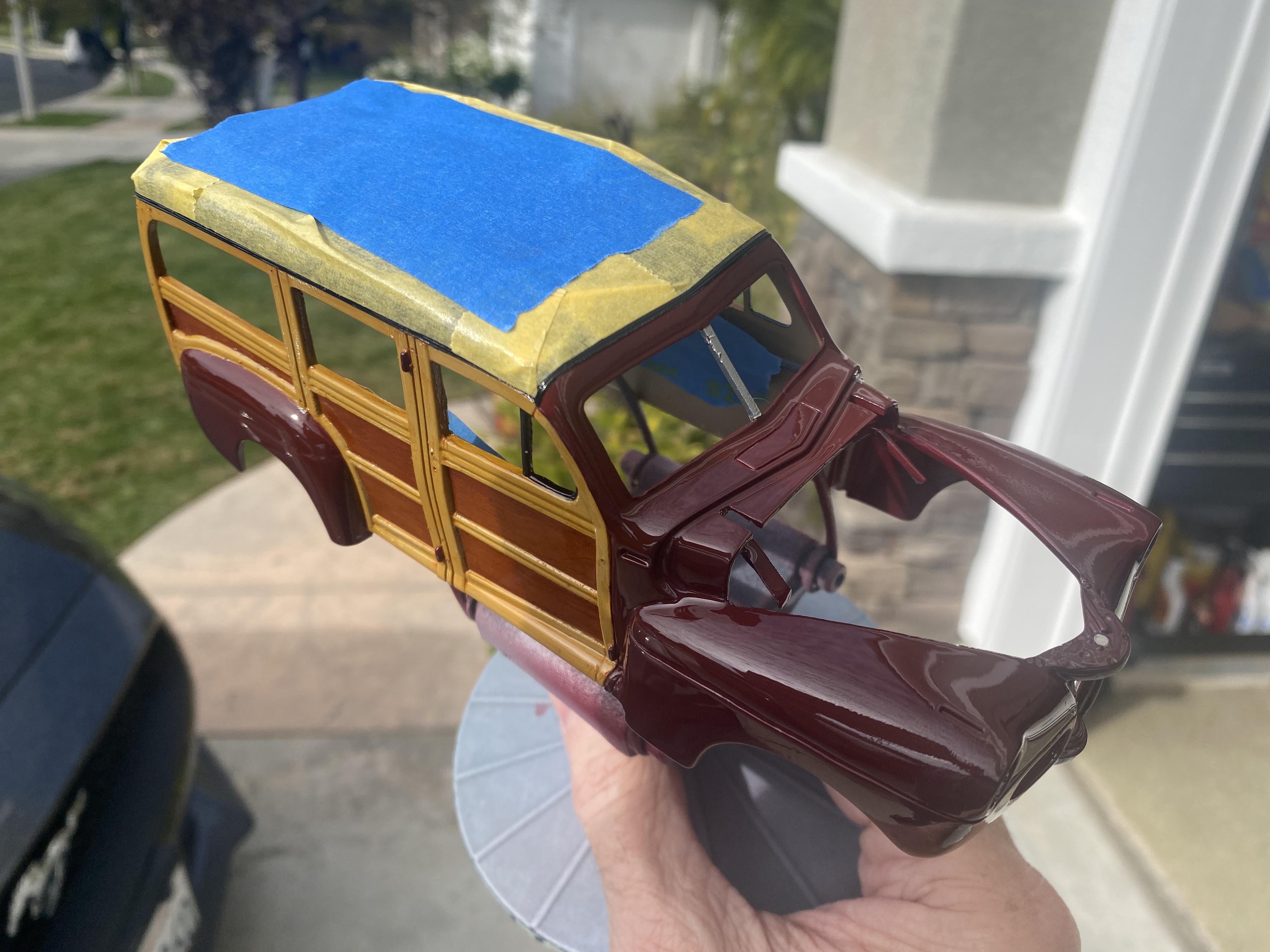

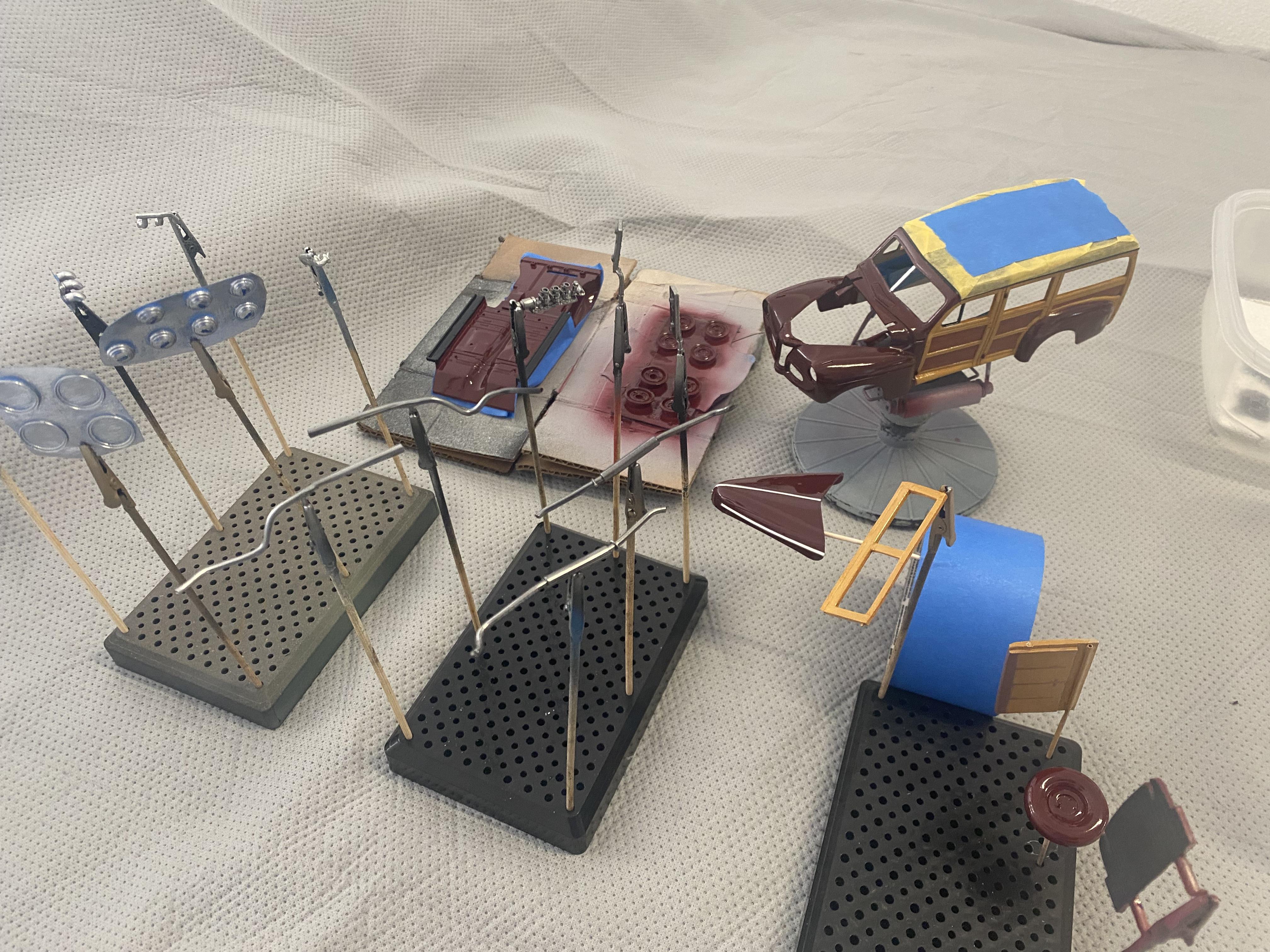

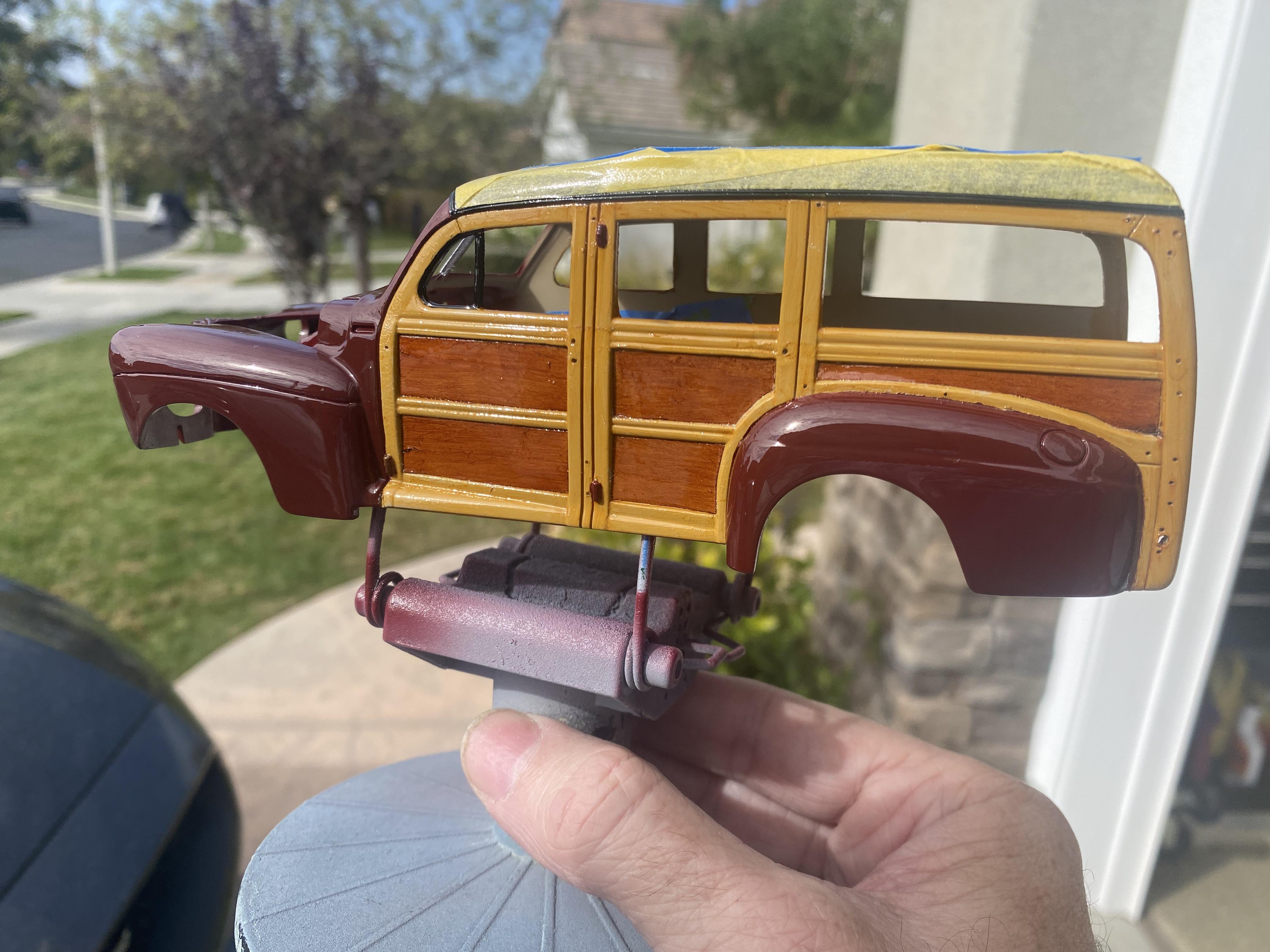

Sprayed all of these components with a coat of 2k clear this morning. I got a little trash in the hood but not bad, will disappear when I wet sand and polish. Starting to see it turning into something now. Roughest next part is going to be installing more than 40 little top studio rivets in the body for the wood frame bolts. IMG_5670.thumb.jpeg.5d0236c5ecb35c411edc5645ad693e25.jpegIMG_5671.thumb.jpeg.c36ed8ad6e79a3a9ecfe818b8769e342.jpegIMG_5672.thumb.jpeg.5fadefce9e94f9e4edffaa62f1c716b9.jpegIMG_5673.thumb.jpeg.5522526e2fae688b9b44e640e7f24c7b.jpegIMG_5675.thumb.jpeg.33b9f2c6a559404a91c74826a253b4bb.jpegIMG_5679.thumb.jpeg.c8960d7a291de5f95479beea3913c947.jpeg

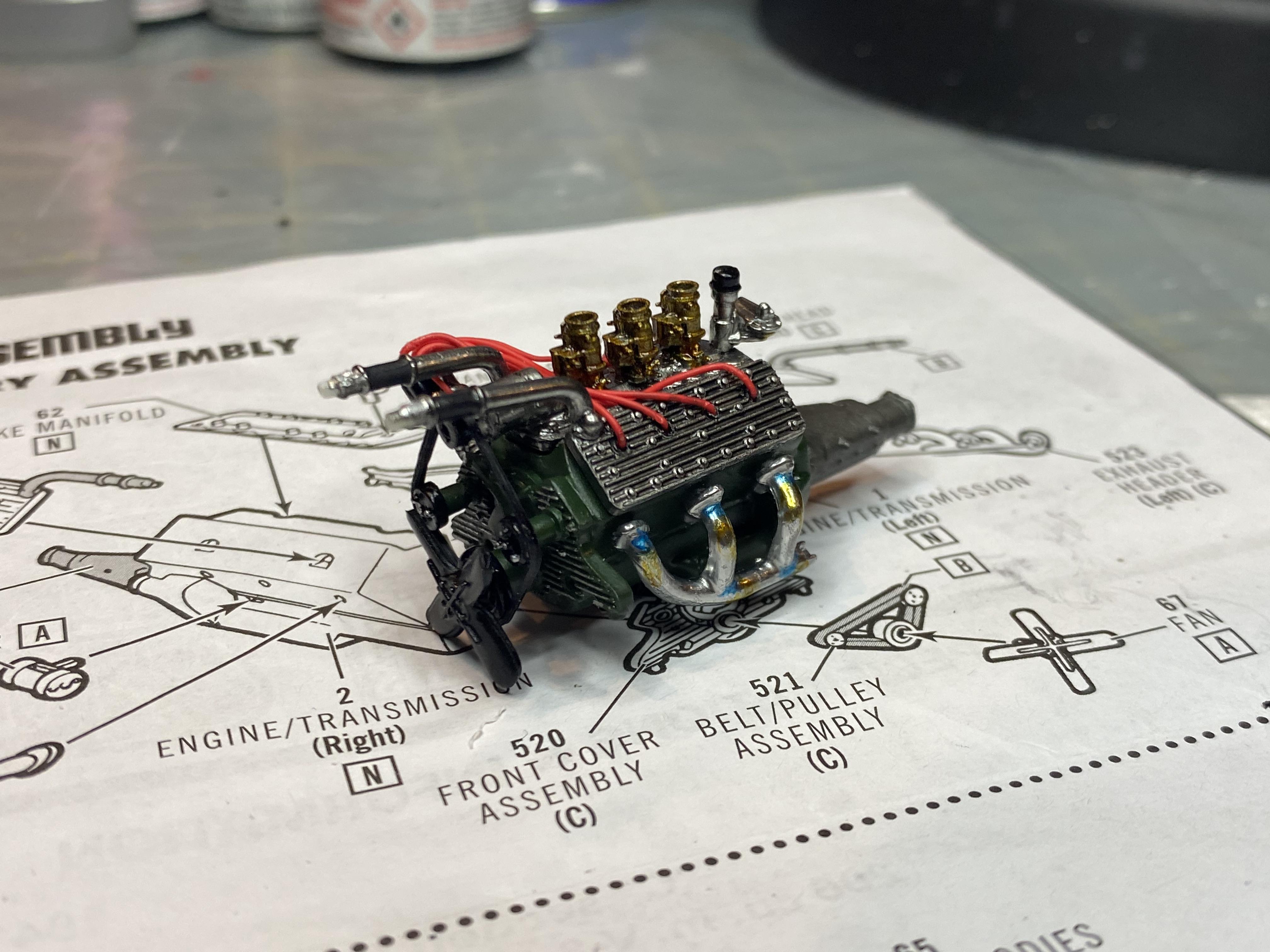

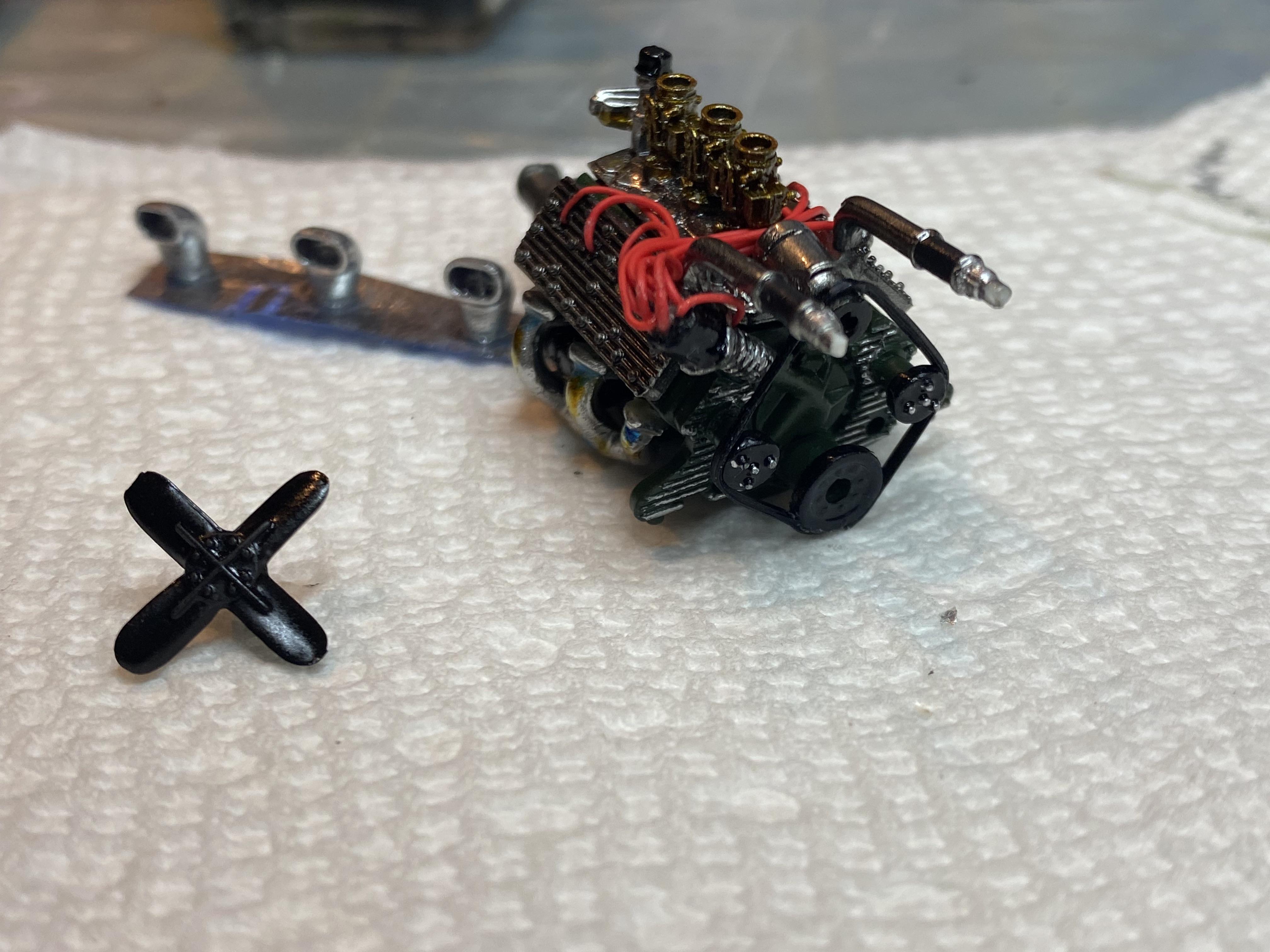

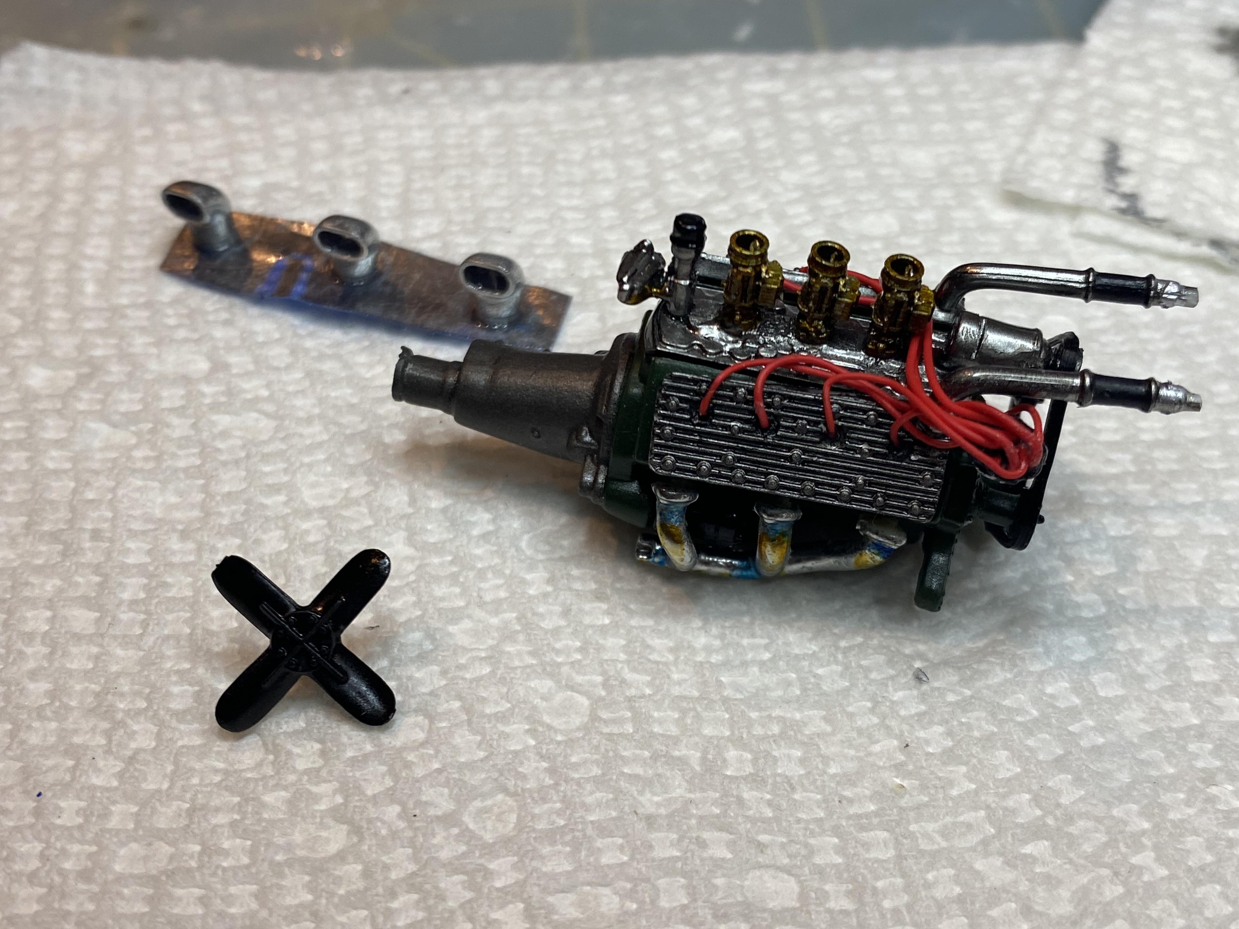

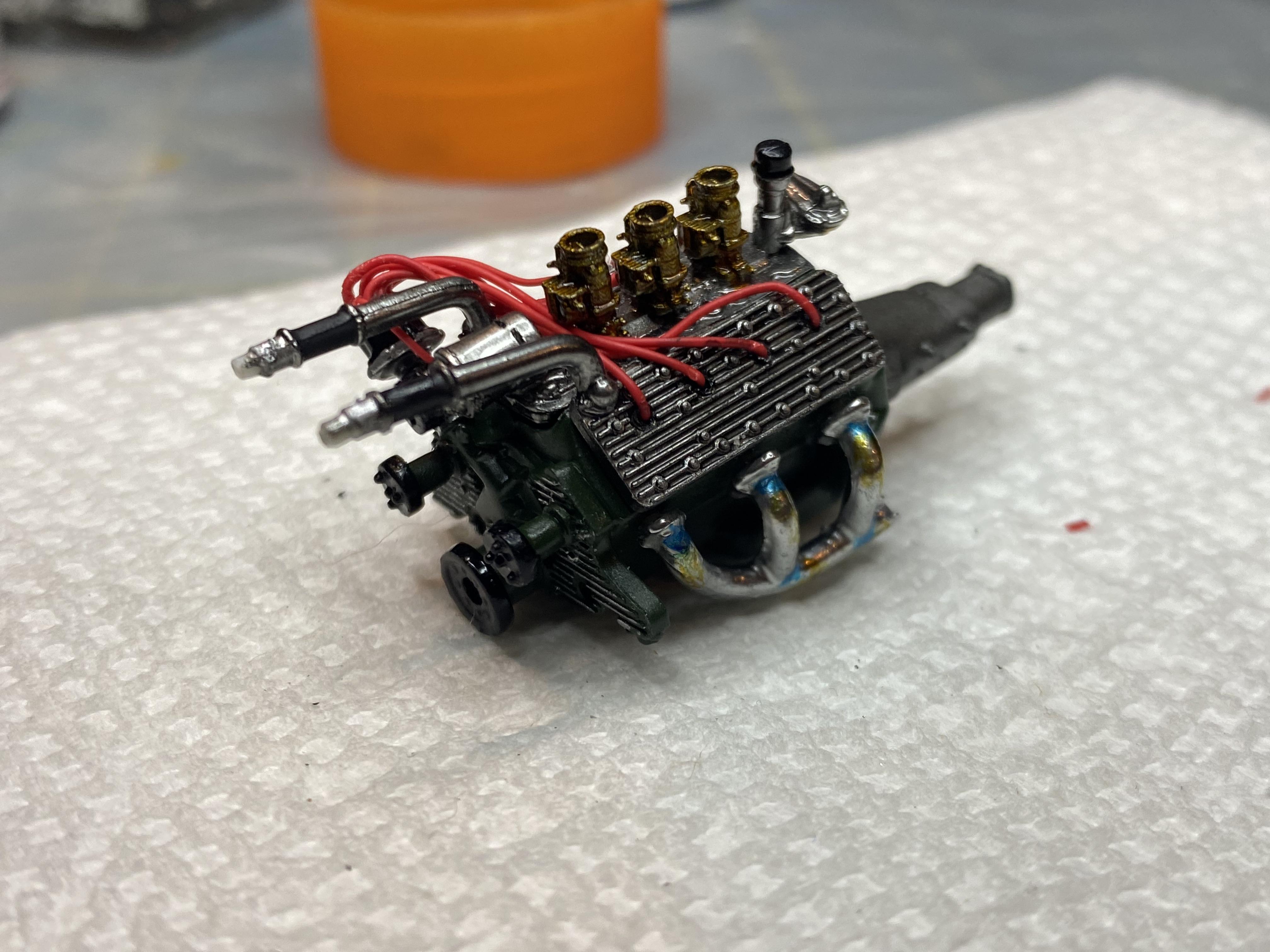

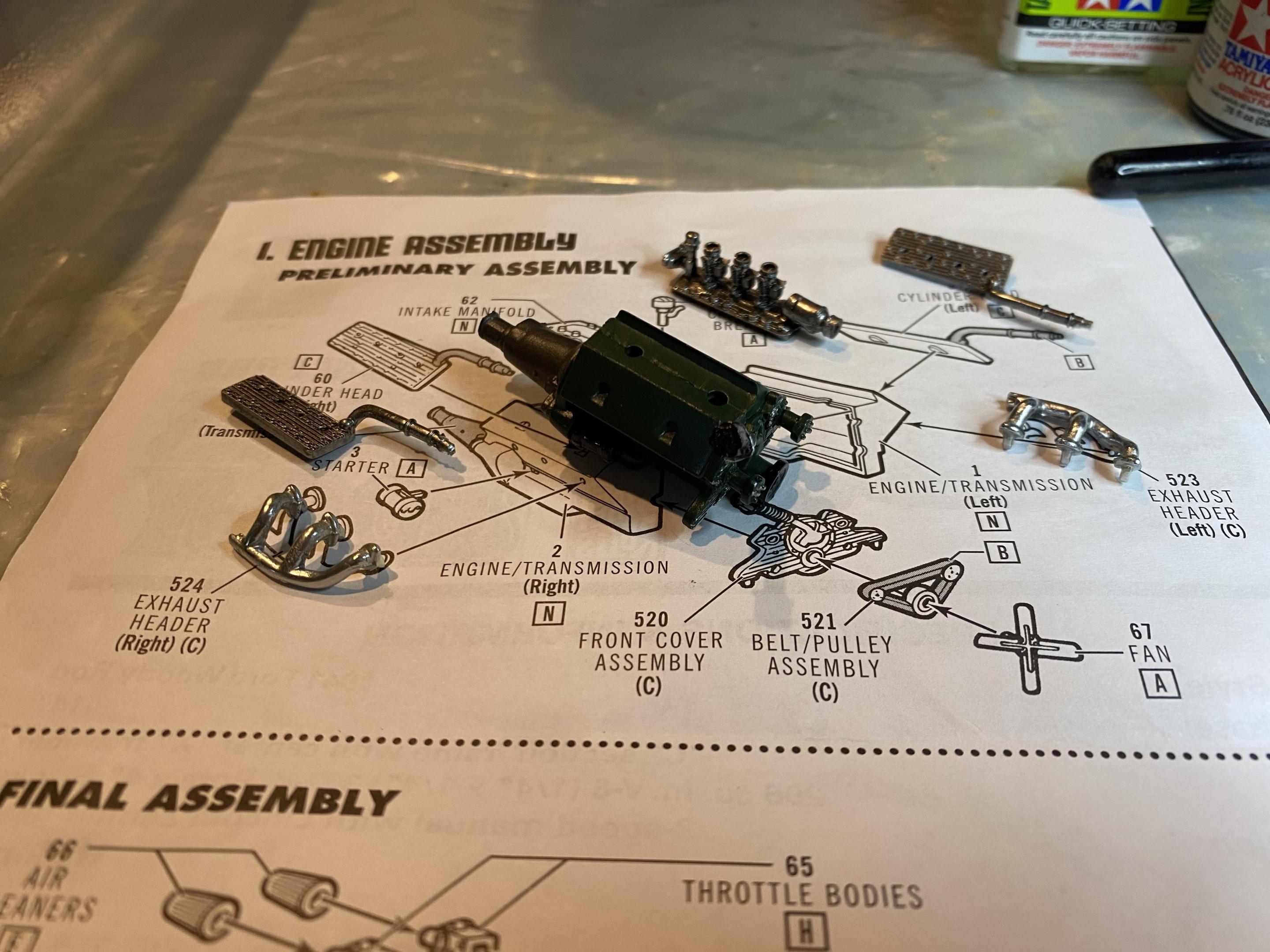

While I am semi-patiently waiting for the 2K to clear I decided to put the engine together. As this is supposed to be hot rodded a bit I decided to go with red plug wires and heat stained the headers. First time I used .005 flat band for the belt. It does look better IMHO.
IMG_5680.thumb.jpeg.c934ea524ef532866532e3bf14f59fc2.jpegIMG_5683.thumb.jpeg.6583a186295c3b2dcce51a178f0fad9f.jpegIMG_5685.thumb.jpeg.6f7828830281266d6447bf98acee41ef.jpegIMG_5687.thumb.jpeg.b6b000be0438f1d2e350dd4aa26f27ed.jpegIMG_5688.thumb.jpeg.b394f78e0d4ee4ed727a773396c9b3ec.jpegIMG_5689.thumb.jpeg.2027c8ce7be6785257aff8265bd0e0dd.jpeg

Nice work on the engine Donald. Good use of weathering techniques, I especially like the heat staining on the headers.

That engine looks really nice. I have a 40 Ford project that needs one of those. I'll have to check the leftovers box from my Woody project to see if there is one in there.

Thank you! The stromberg carbs and frog mouth breathers are from IceMan Collection. They make a world of difference. The generator is scratch built, the plug wires are left over LED wiring and the belt is .005 flat band. The rest is out of the box.

Wood grain looks really great. I like to color too. The flatty is no joke either. This will be one cool surf wagon.

Thank you! Trying to get some progress made while I wait a little while to wet sand and polish the body panels. Not really much to wet sand other than the hood and fenders really, woodgrain shouldn't get smoothed too much.
