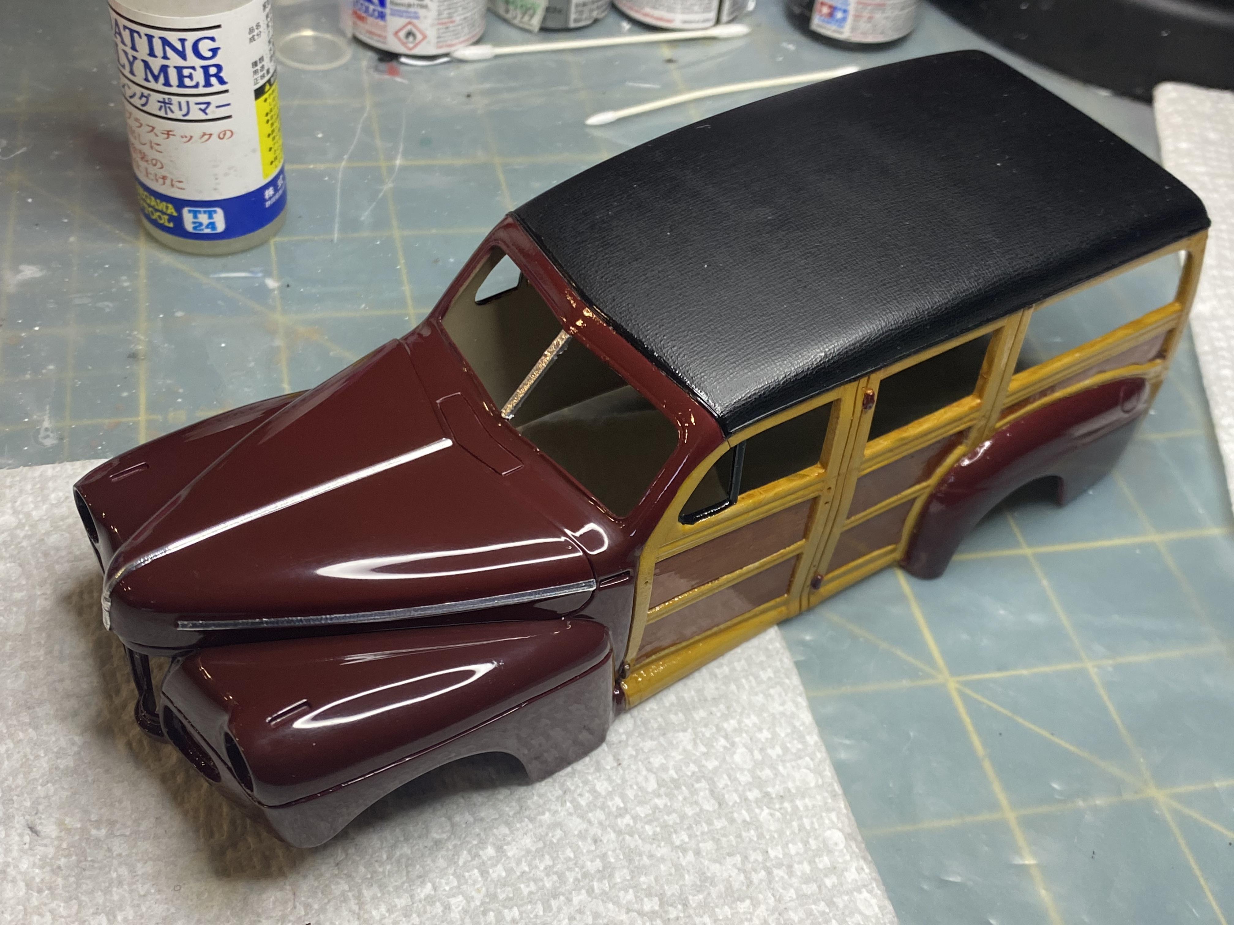

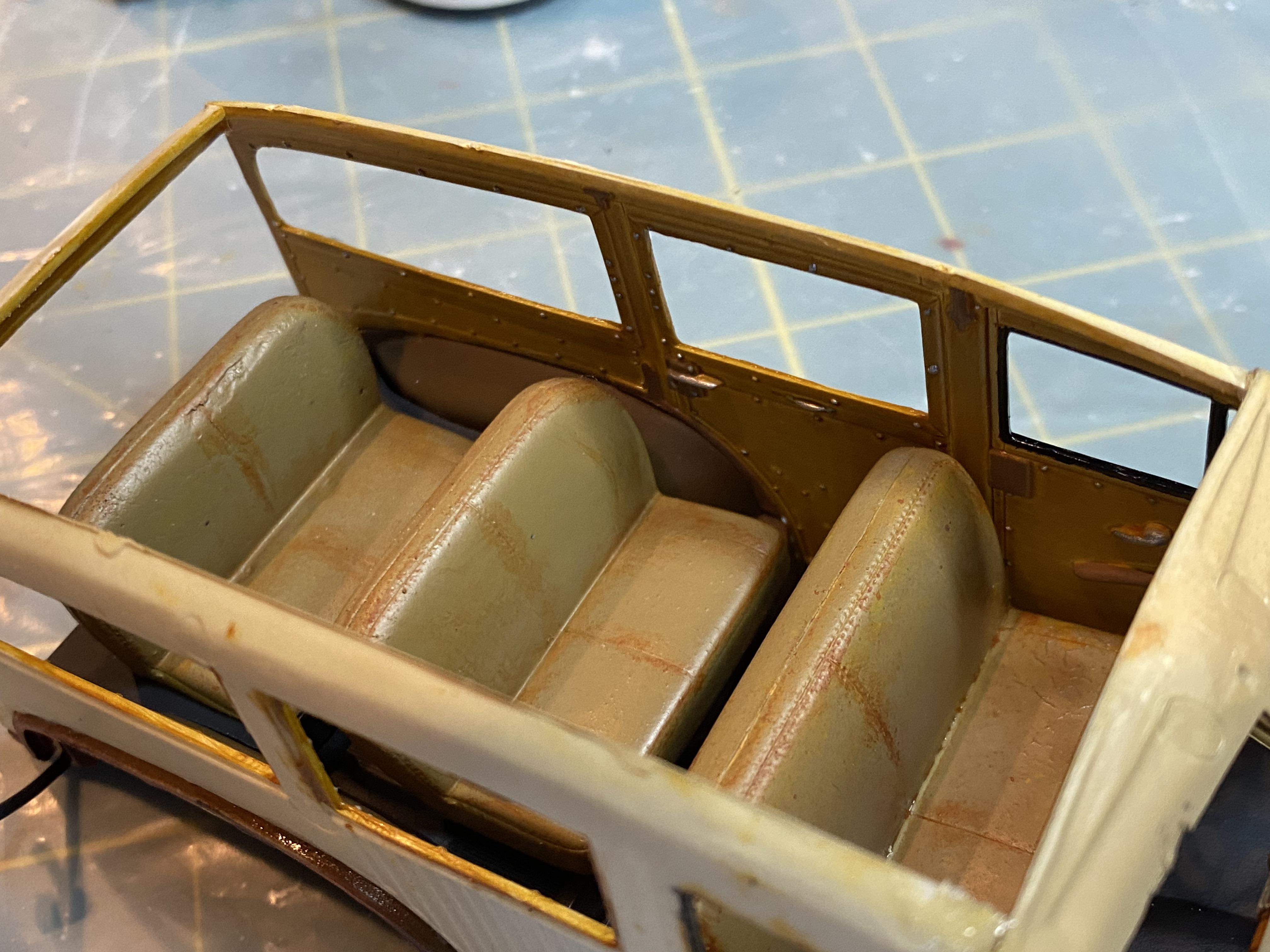

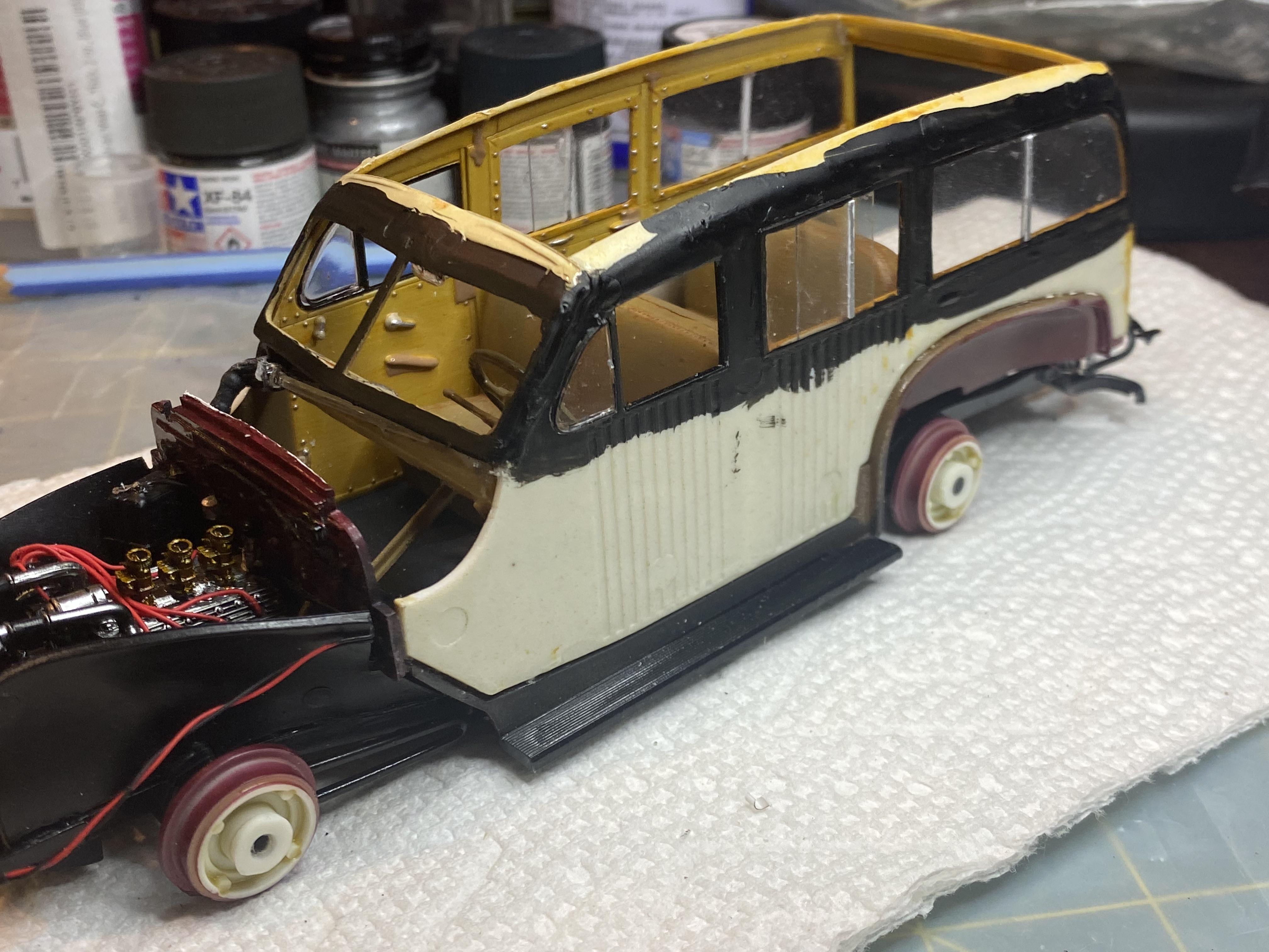

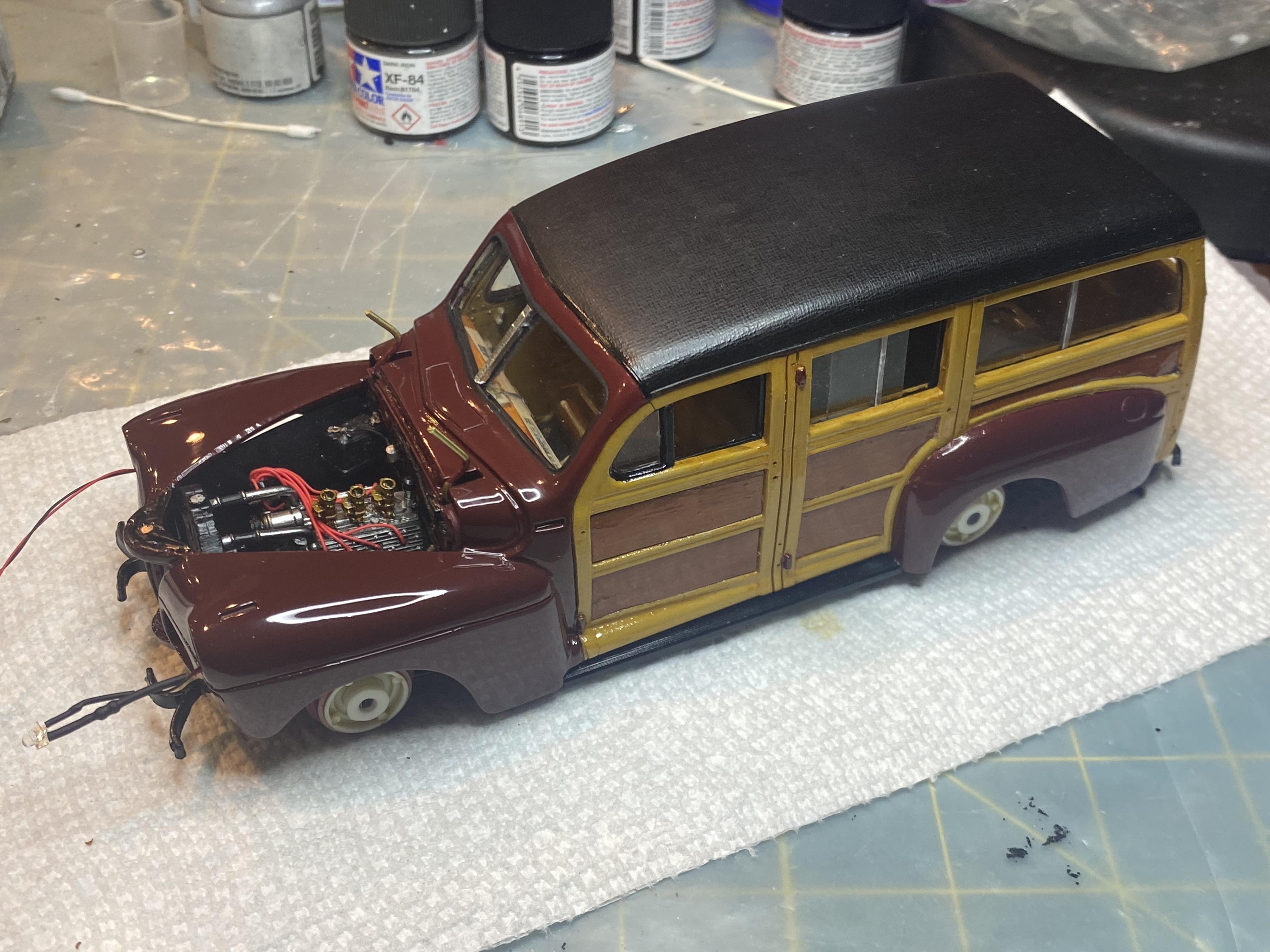

Assembly is under way. I test fit the body after installing the side windows and noticed I needed to black out the edges, there isn’t much gap but it does show if not painted.
IMG_5698.thumb.jpeg.721cd32c754f121e81b306e28936f621.jpegIMG_5699.thumb.jpeg.f53007835d7c6918421bc6ff8000f970.jpegIMG_5700.thumb.jpeg.ea3169ce15b9a5ada88c0d0c19e19150.jpeg

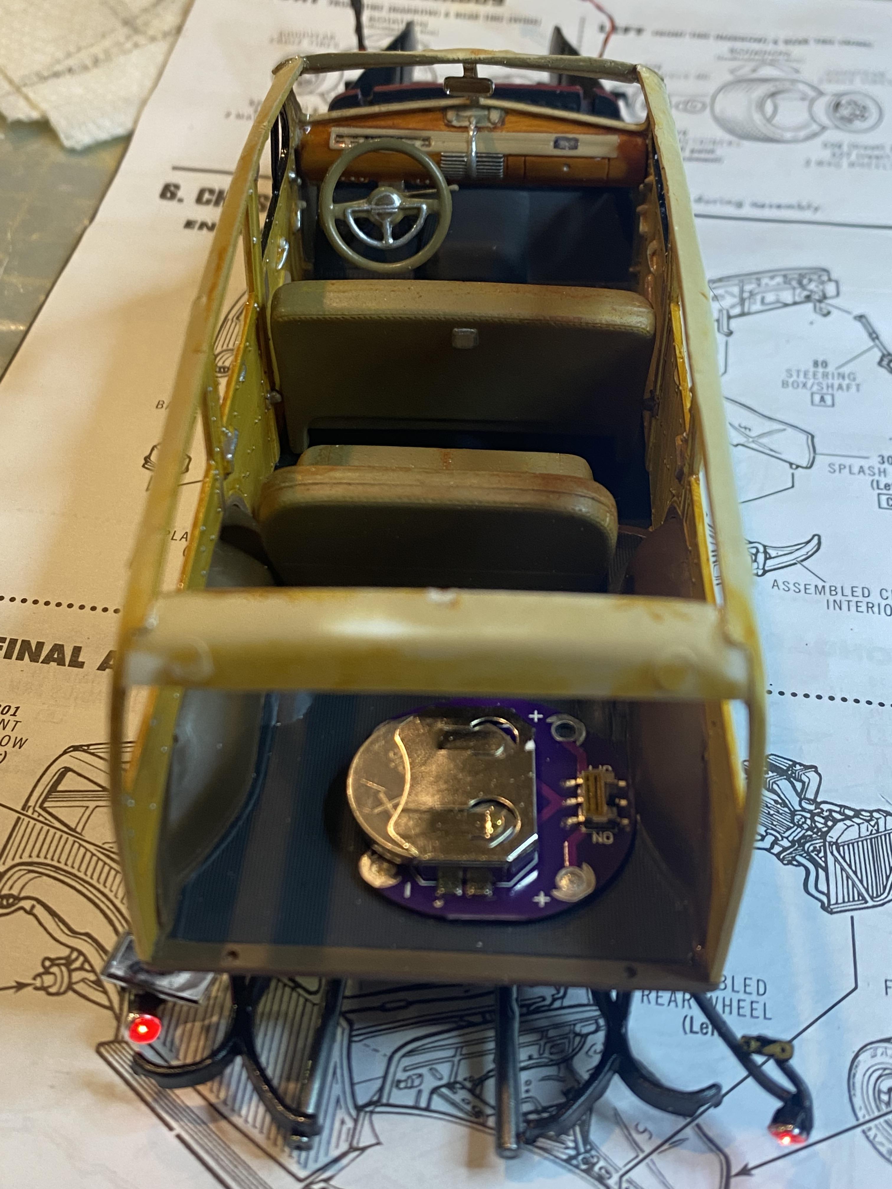

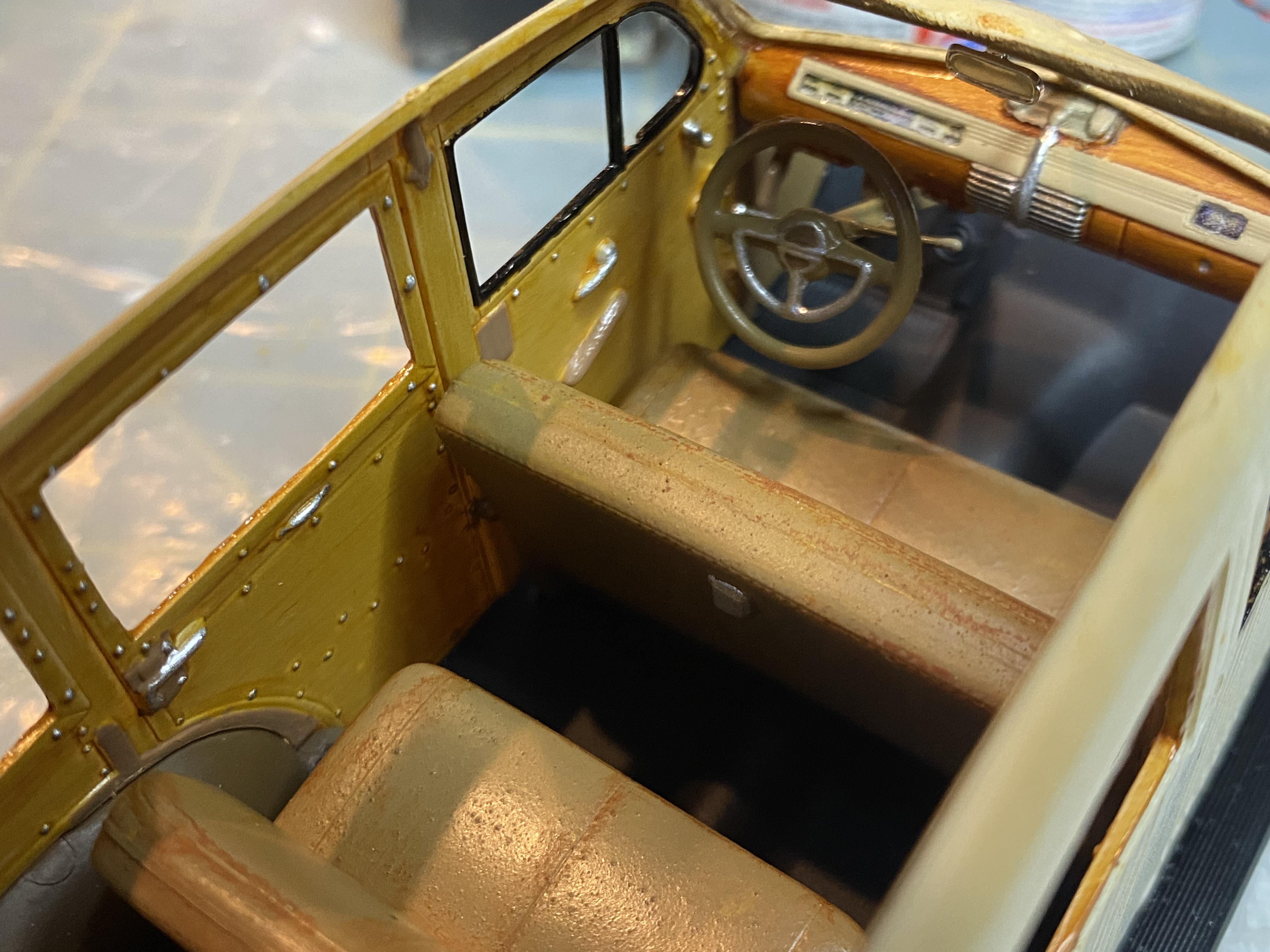

interior is coming along pretty well I think.IMG_5702.thumb.jpeg.554cc8e80f95afcac4f564b6fd338aeb.jpeg

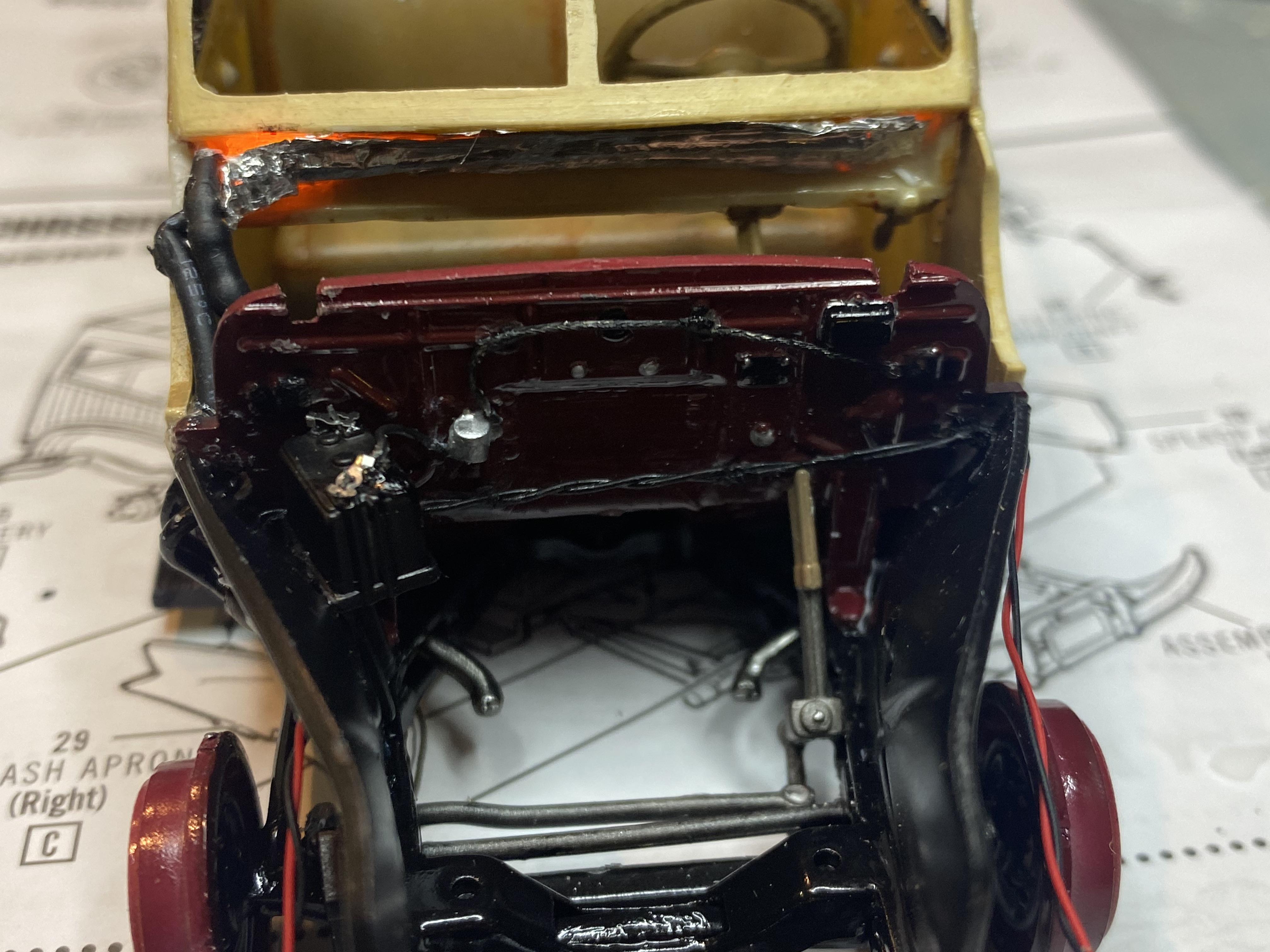

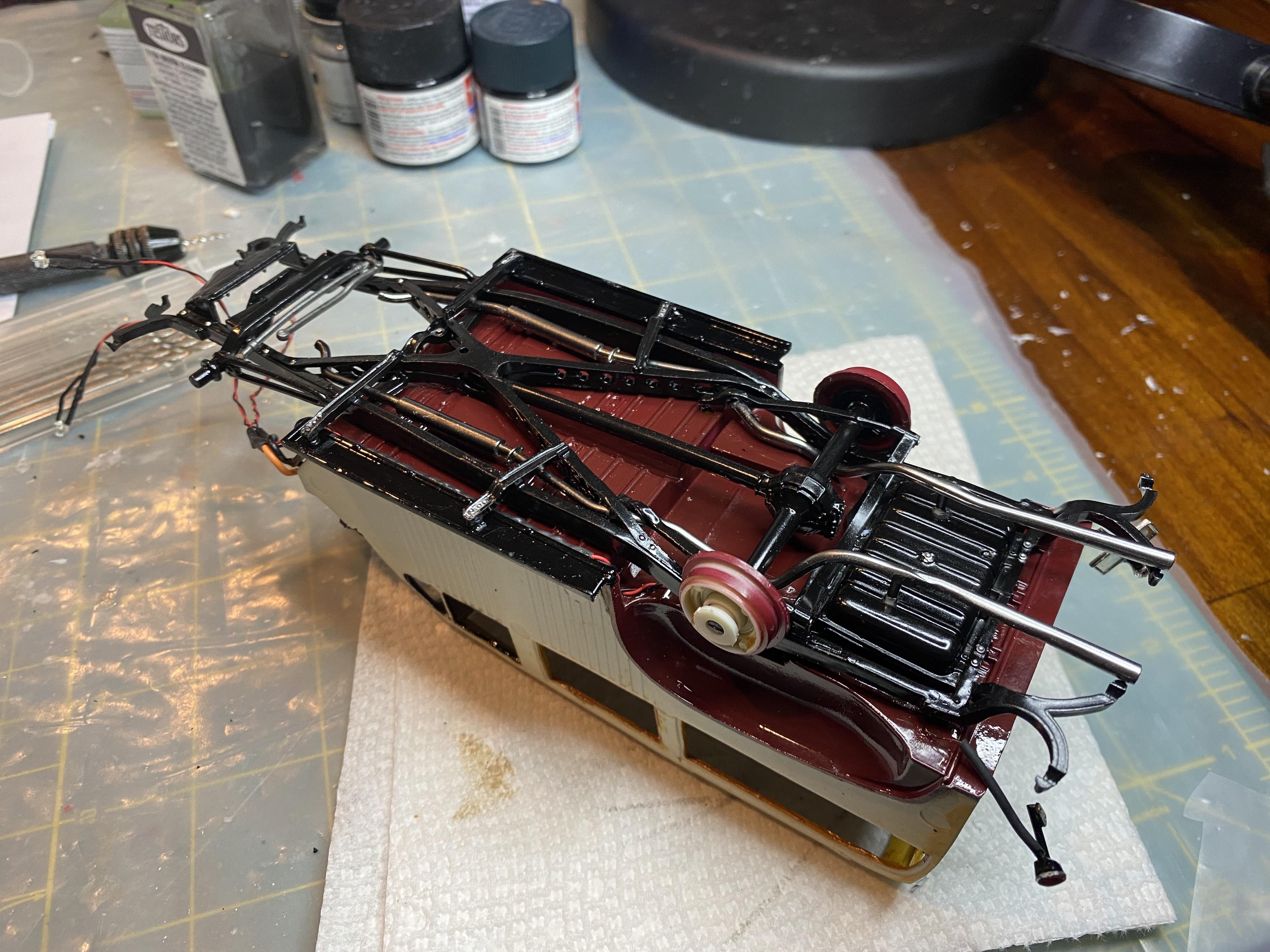

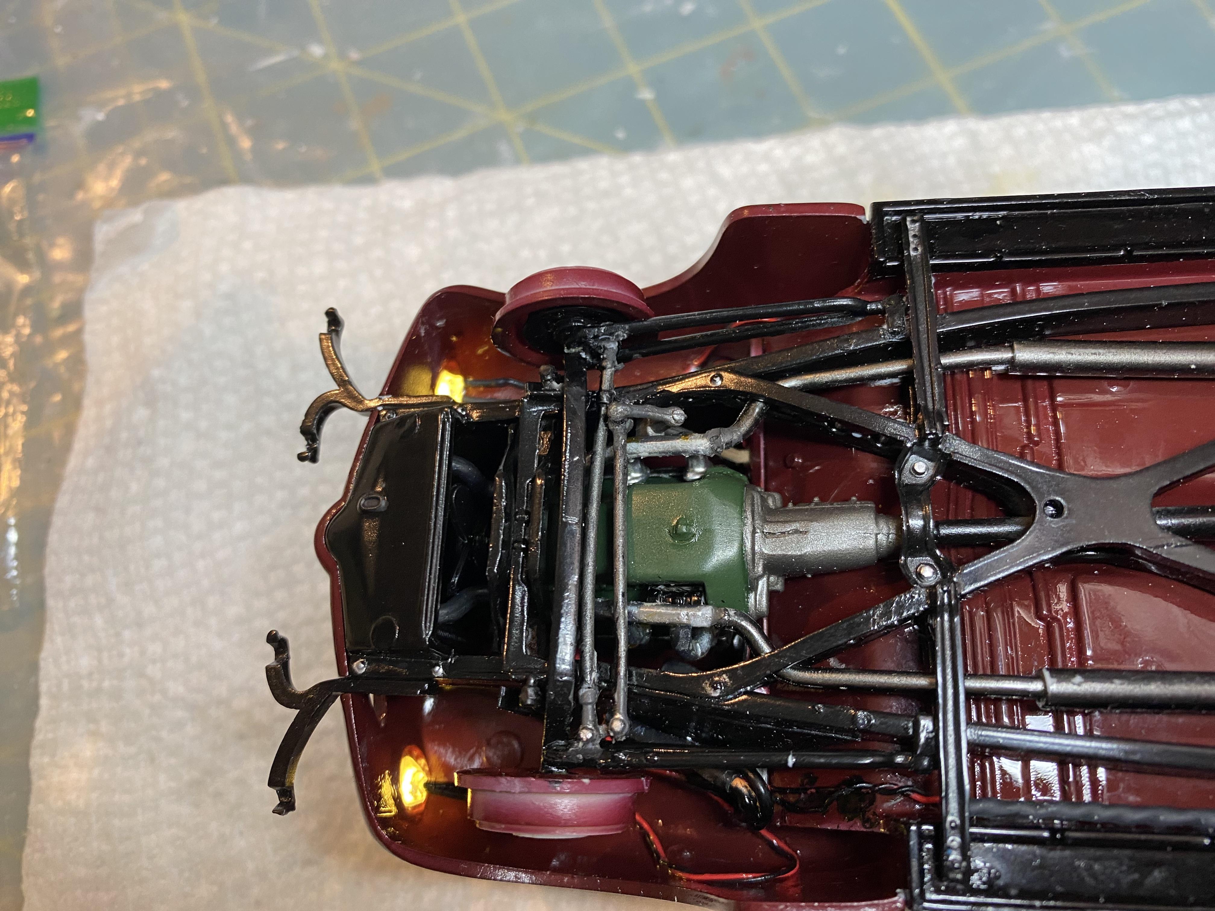

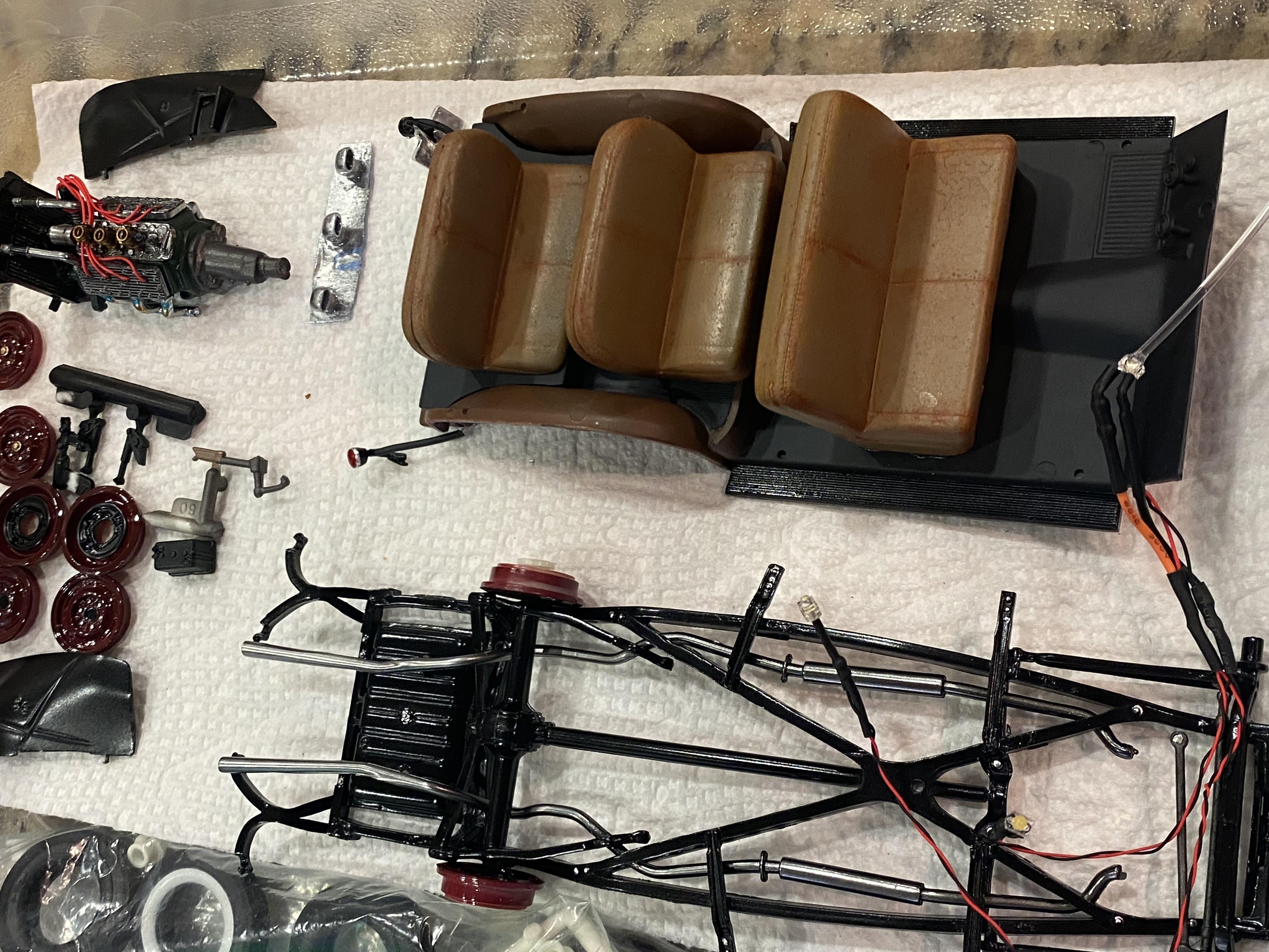

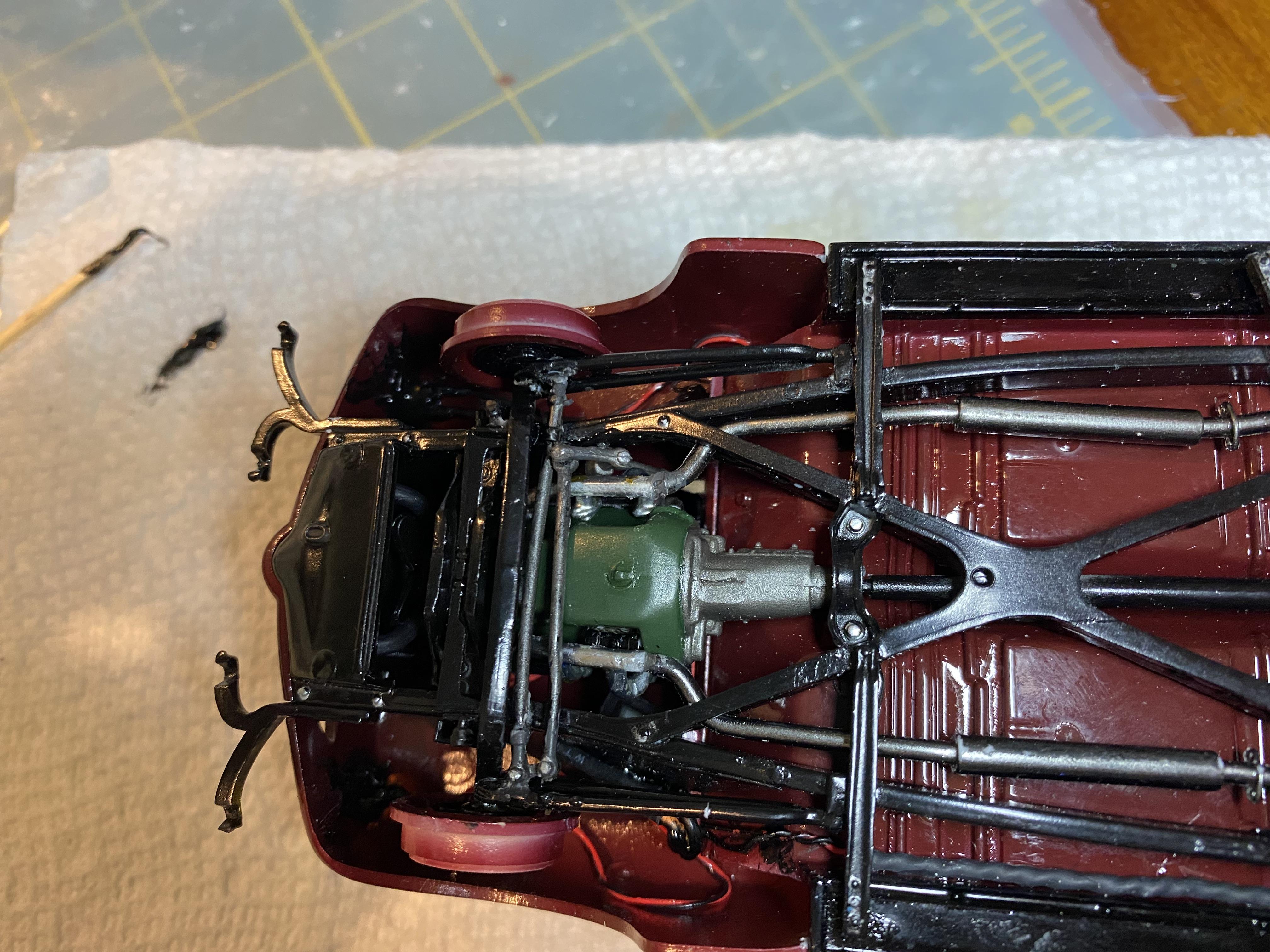

Wiring run and hidden with chassis install. Wire through engine compartment for driver side headlight hidden in plain sight.
IMG_5703.thumb.jpeg.9b29844d89ca123009d7bc87e2664033.jpegIMG_5705.thumb.jpeg.554852b1695ea389bcb1ee79c935308c.jpegIMG_5707.thumb.jpeg.b1ef3eab95a80362adb27cfcaac98eac.jpegIMG_5709.thumb.jpeg.ecd0e254912a35b3e2677a9f4653163a.jpegIMG_5710.thumb.jpeg.4e87e5f351dbd6902071375be16c9486.jpeg

Actually, not really any at all most of them are exposed except a little area under the gas tank where it comes through from the battery, running along the right floorboard underneath and through the engine compartment. It just looks like they belong. :)

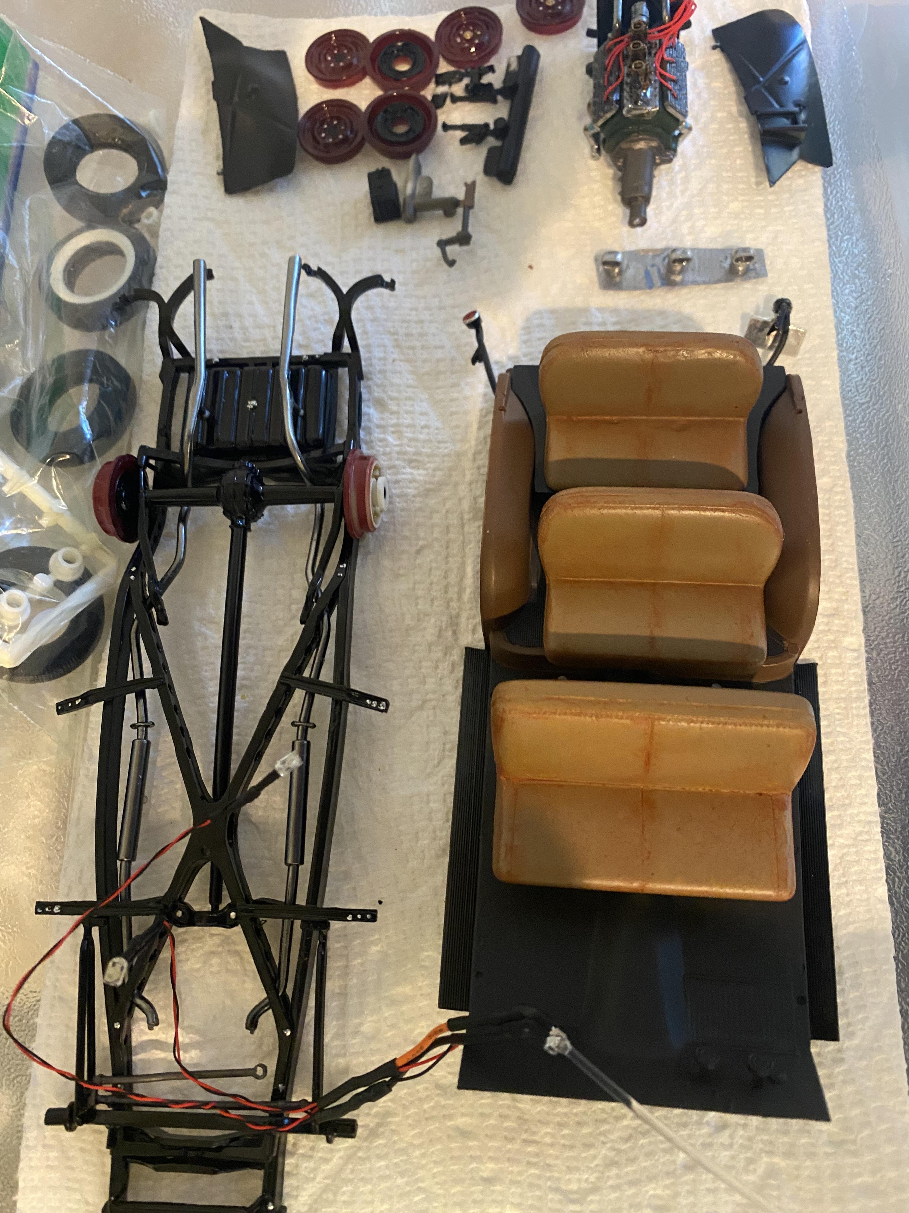

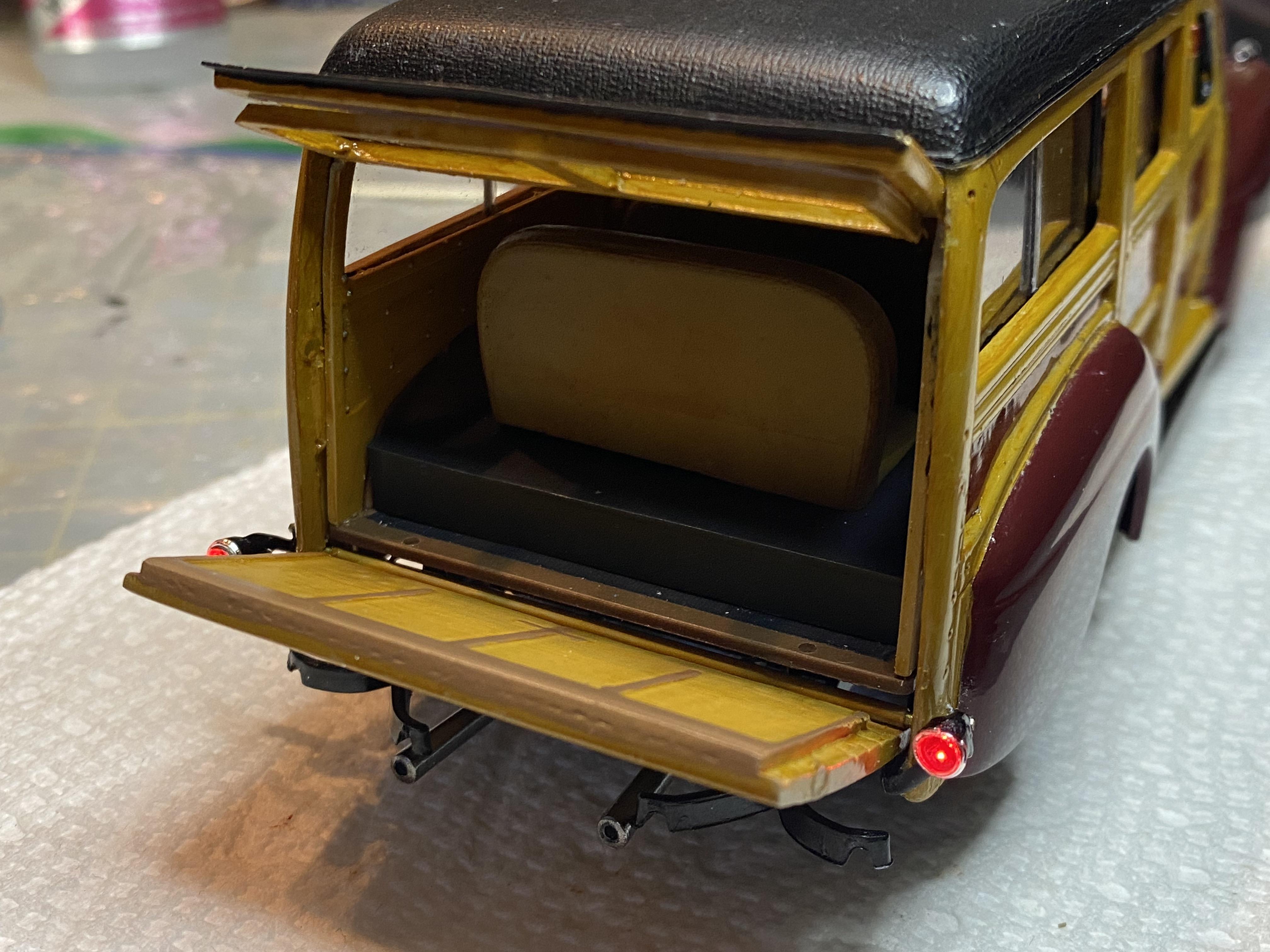

Final assembly is now well underway.
The hood had quite a bit of trash but able to wet sand an polish it out. Still will need more polishing in the end but it’s looking better.
IMG_5711.thumb.jpeg.bbb33812c6056498fe311bbce4b5863c.jpegIMG_5715.thumb.jpeg.aeb8a830263618d000972f5865f5b6d5.jpegIMG_5716.thumb.jpeg.9f4f211704319ffe9781a4f07072202c.jpeg

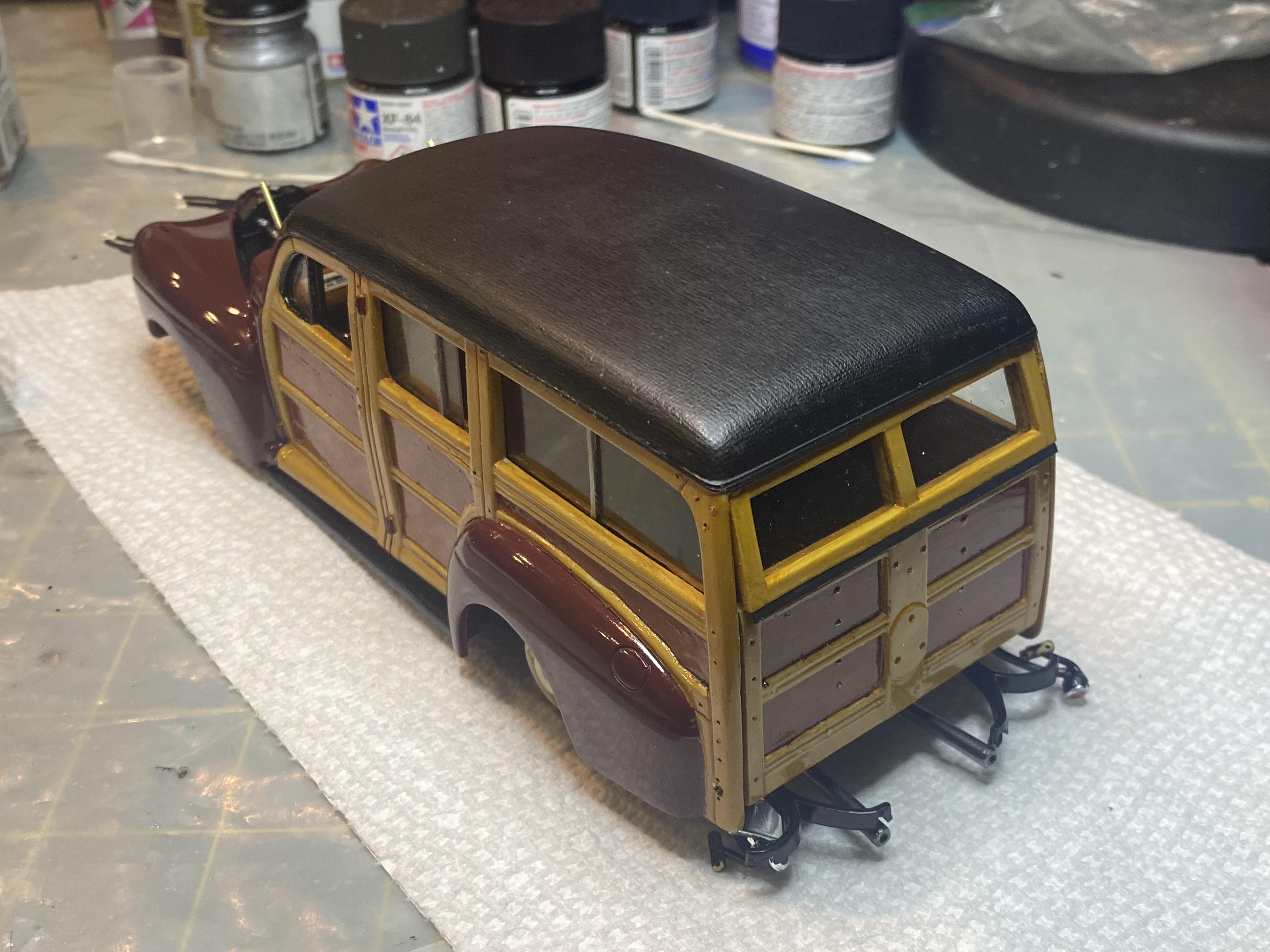

assemble body and chassis/ interior. This was actually a bit of a pain. Had to trim and adjust to get them to mate up well.

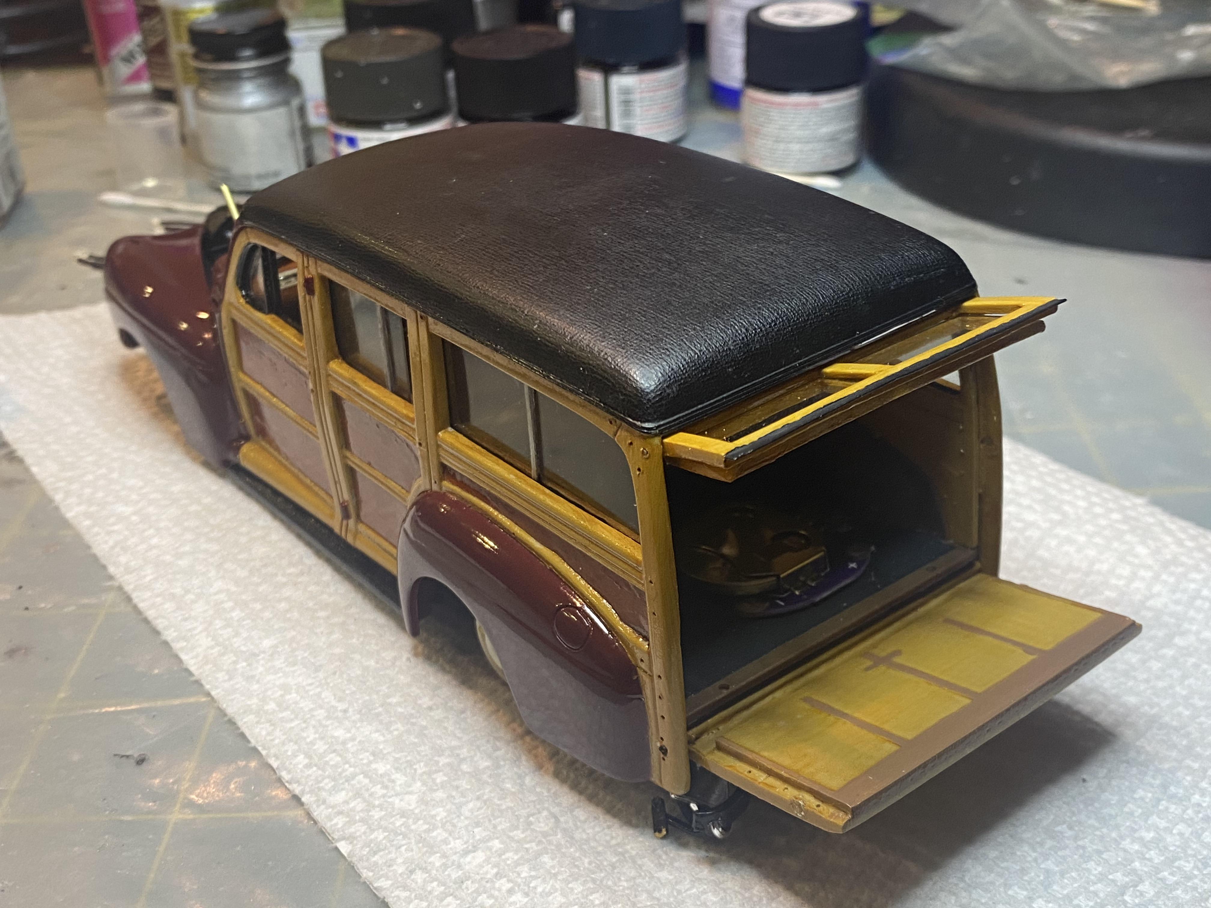

installed the rear door and hatch
IMG_5718.thumb.jpeg.521a79e204fcf3986e0a92258c54cc2f.jpegIMG_5719.thumb.jpeg.7d38314e98f1322ea4cecd7ba2d2b372.jpeg
and the hood and attached the taillights. Taillights turned out pretty well I think, now to the headlights and the LEDs will be done.

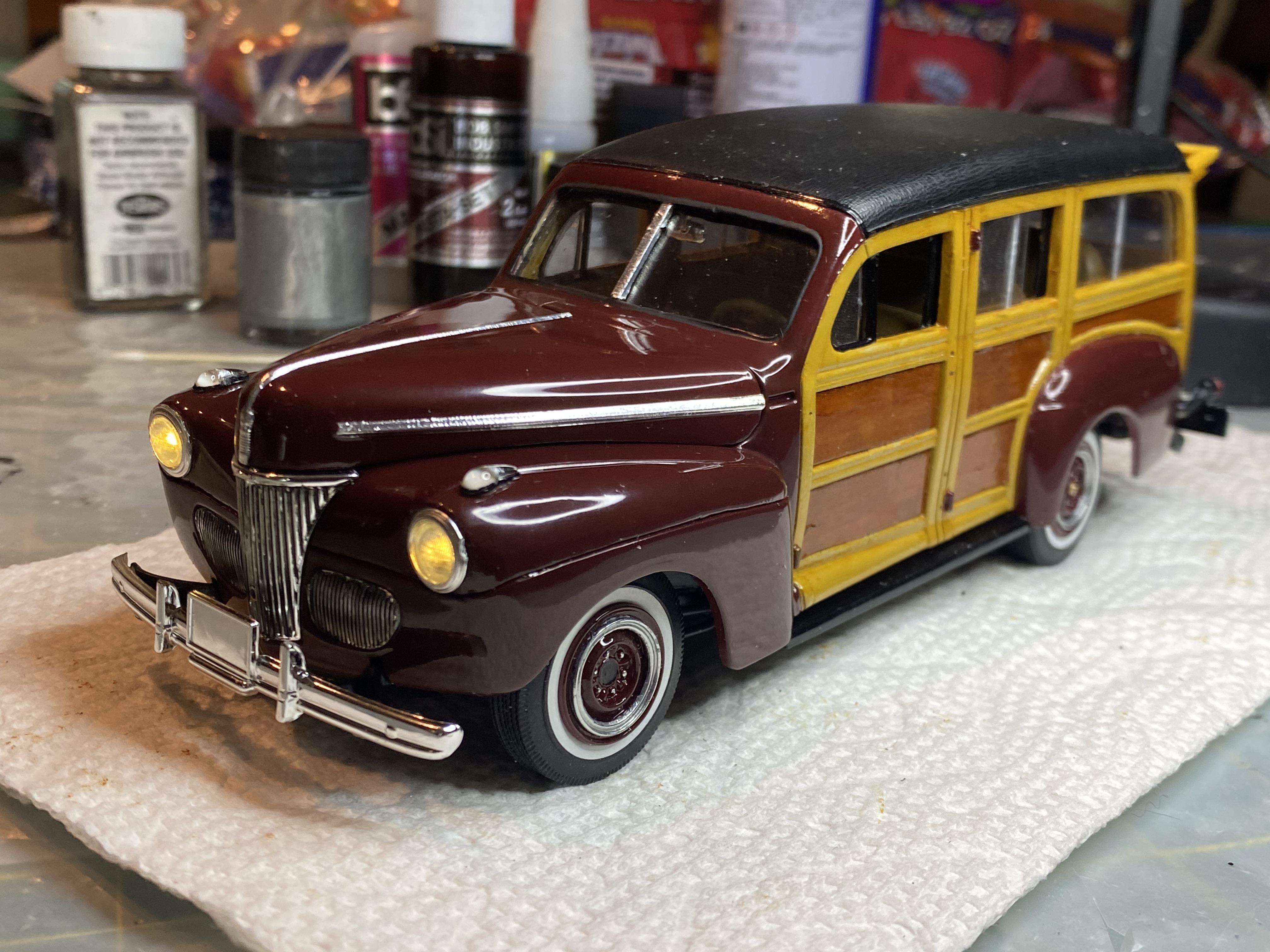

I still have a whole lot to do but made some progress today.

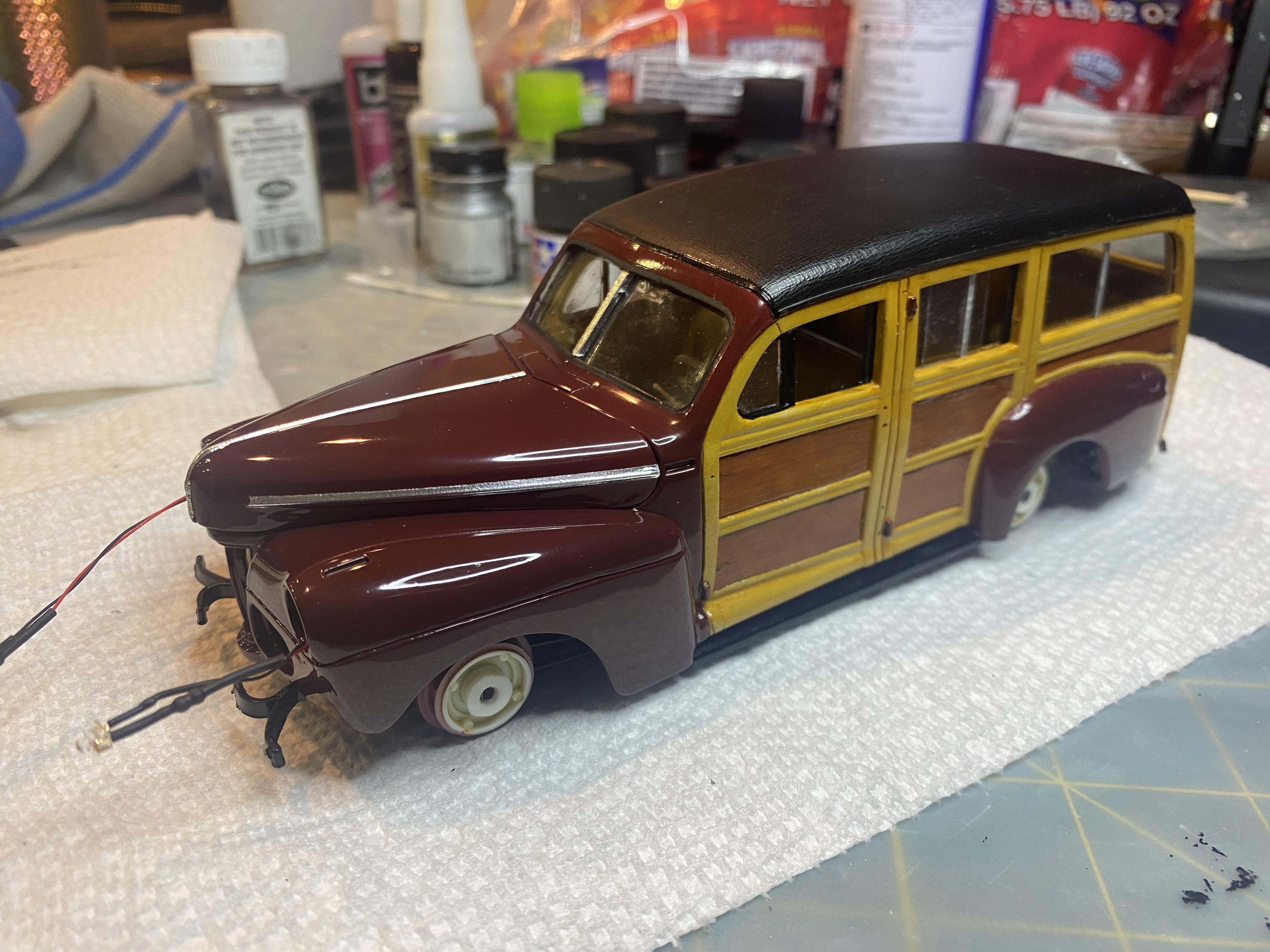

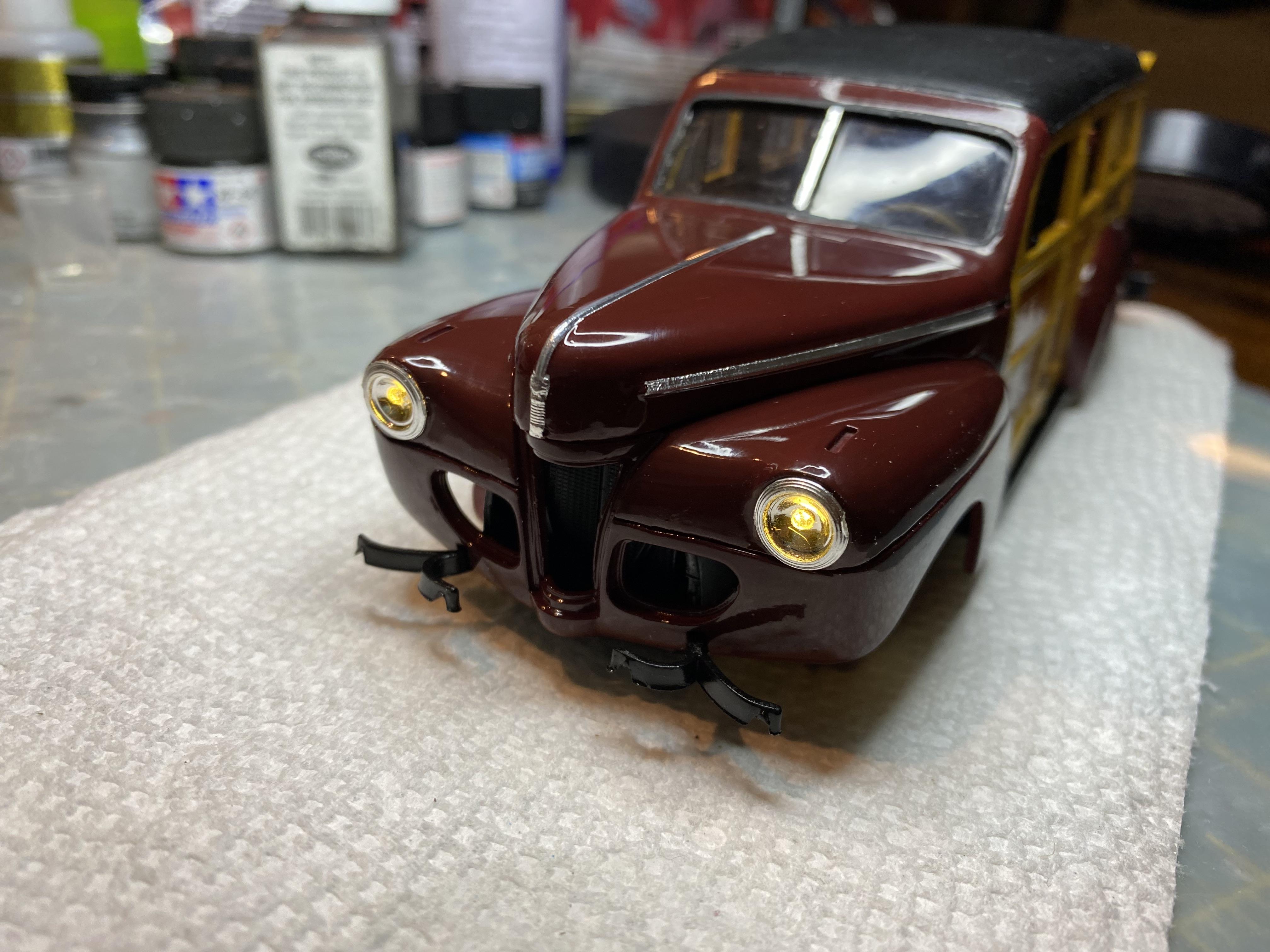

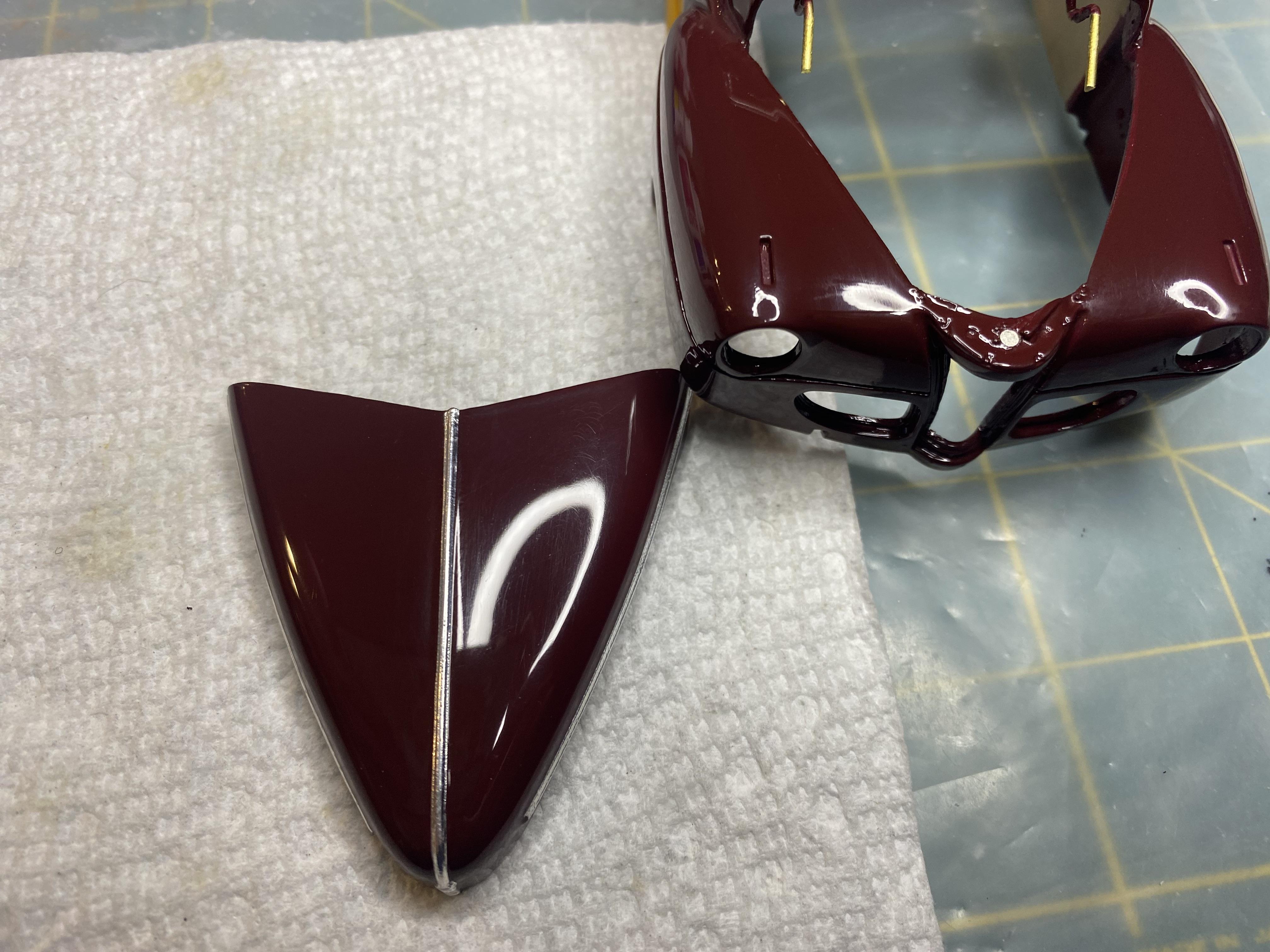

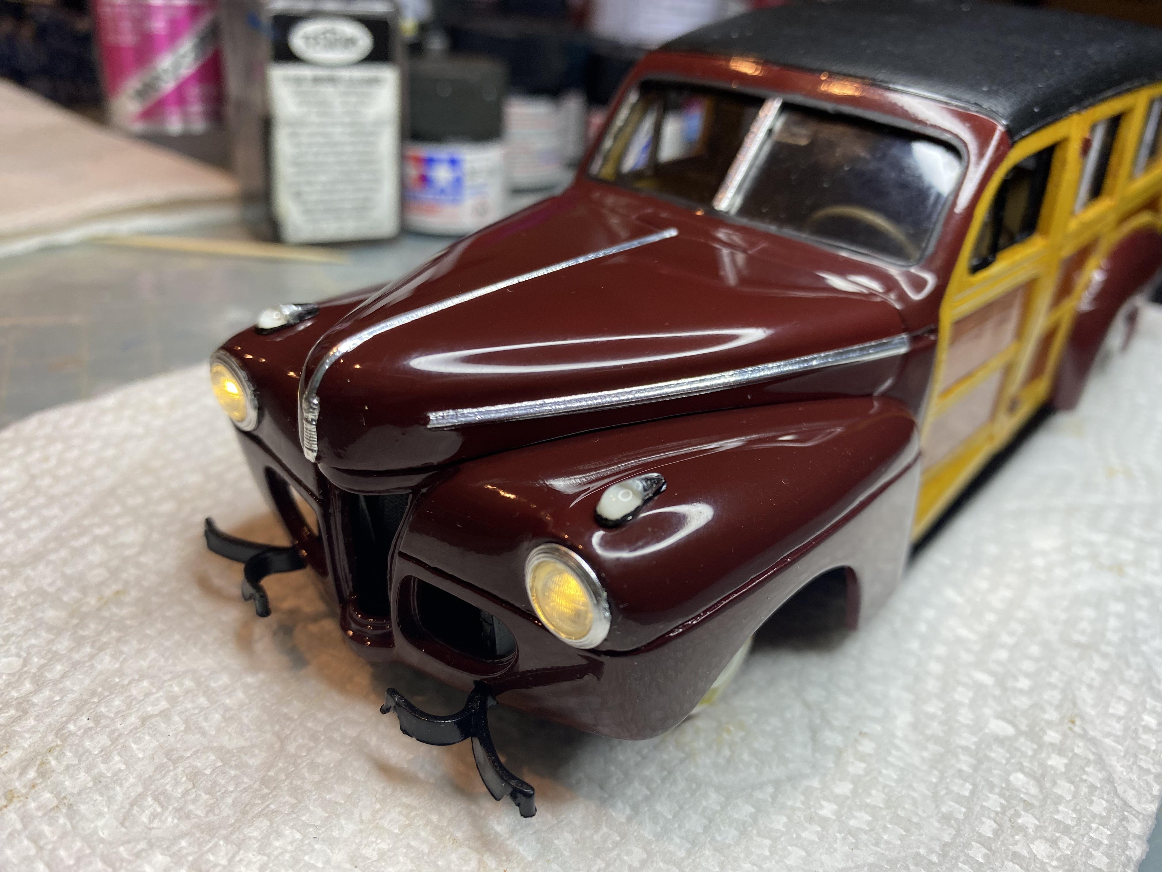

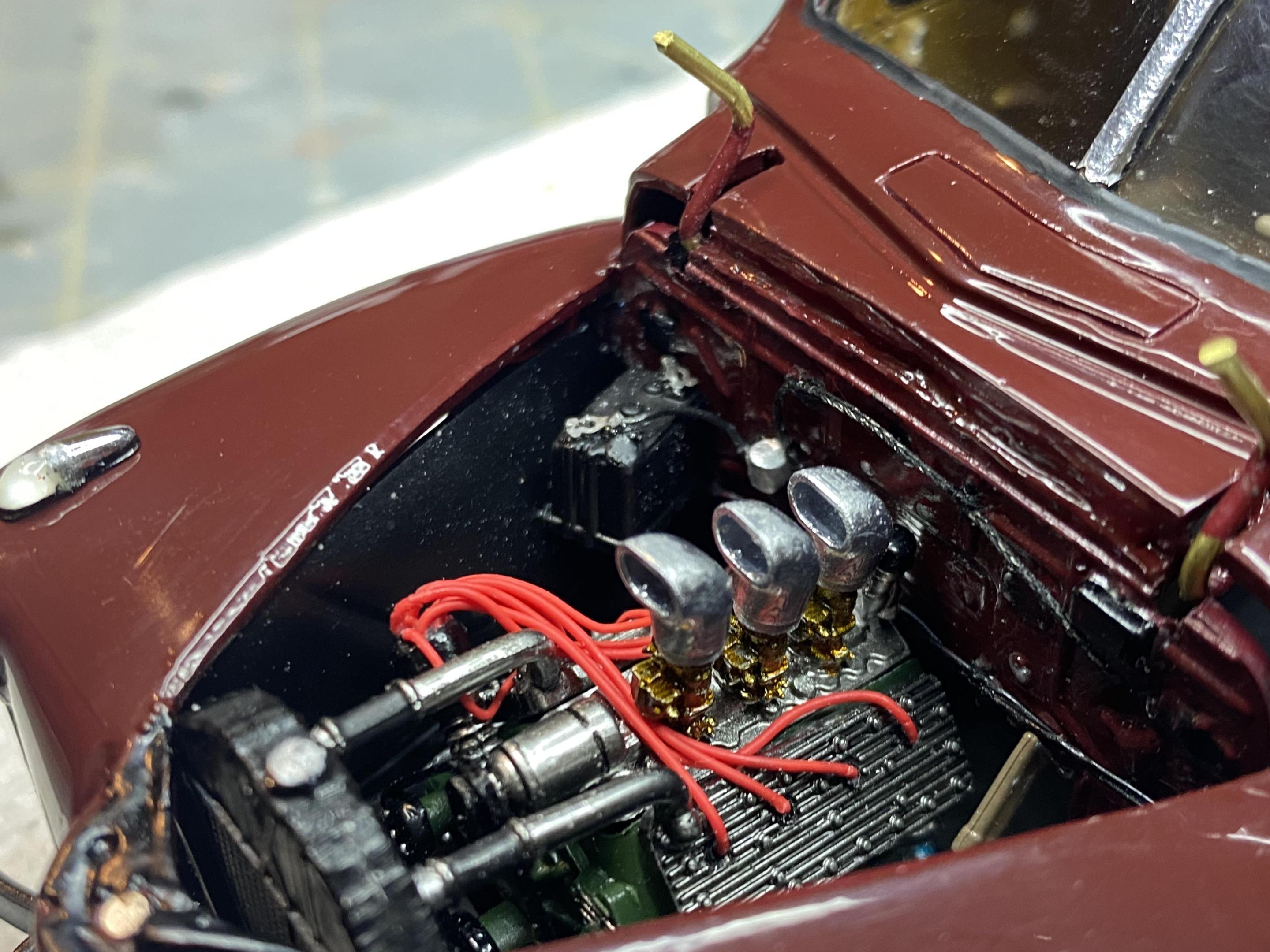

Installed the headlight buckets and front LEDs. Sealed underneath so light doesn’t show where I don’t want.
IMG_5729.thumb.jpeg.2d9ab1c95a49331249b5e25a034103ec.jpegIMG_5730.thumb.jpeg.e3ceca9d5153ce5d57431cad461778ae.jpegIMG_5731.thumb.jpeg.1f04629448022e0422bcd4feb9df2da8.jpeg

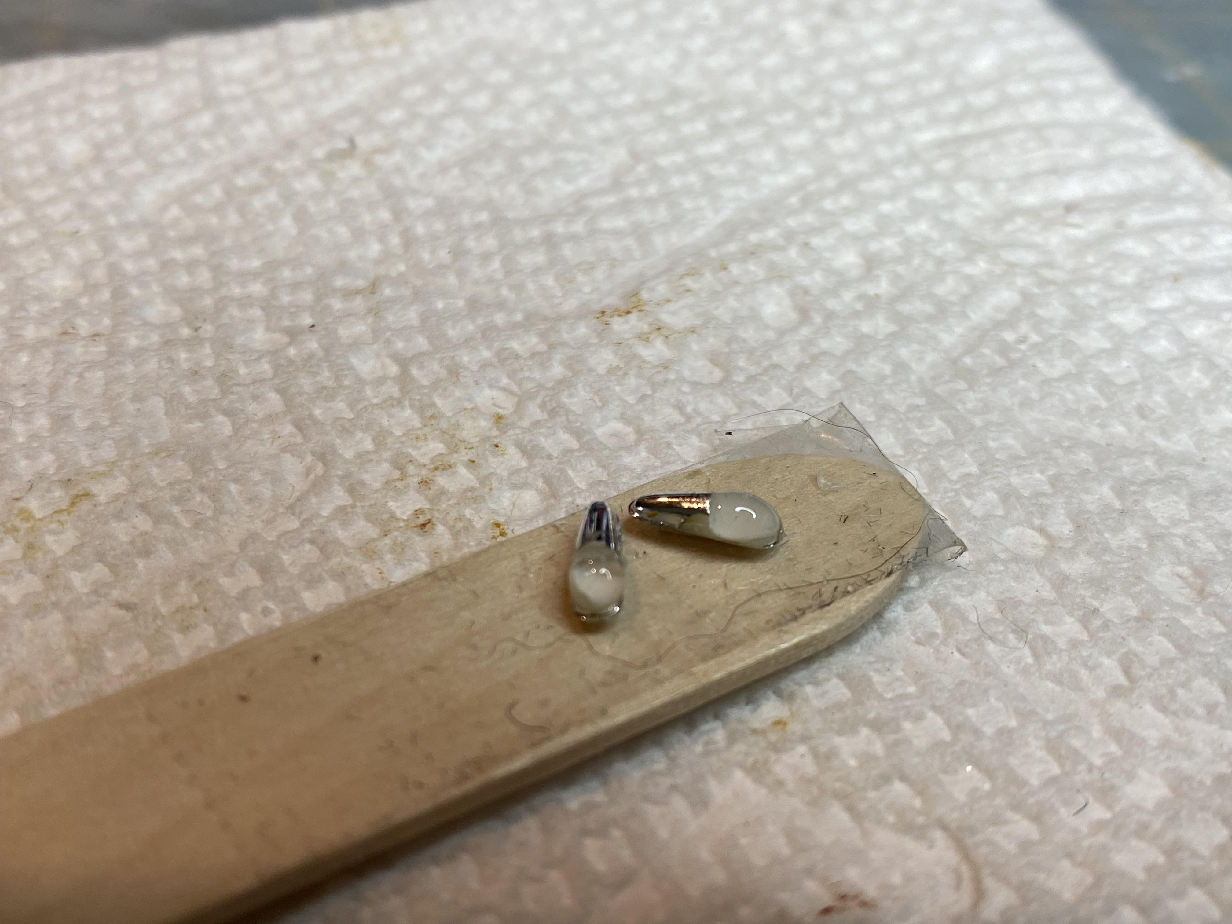

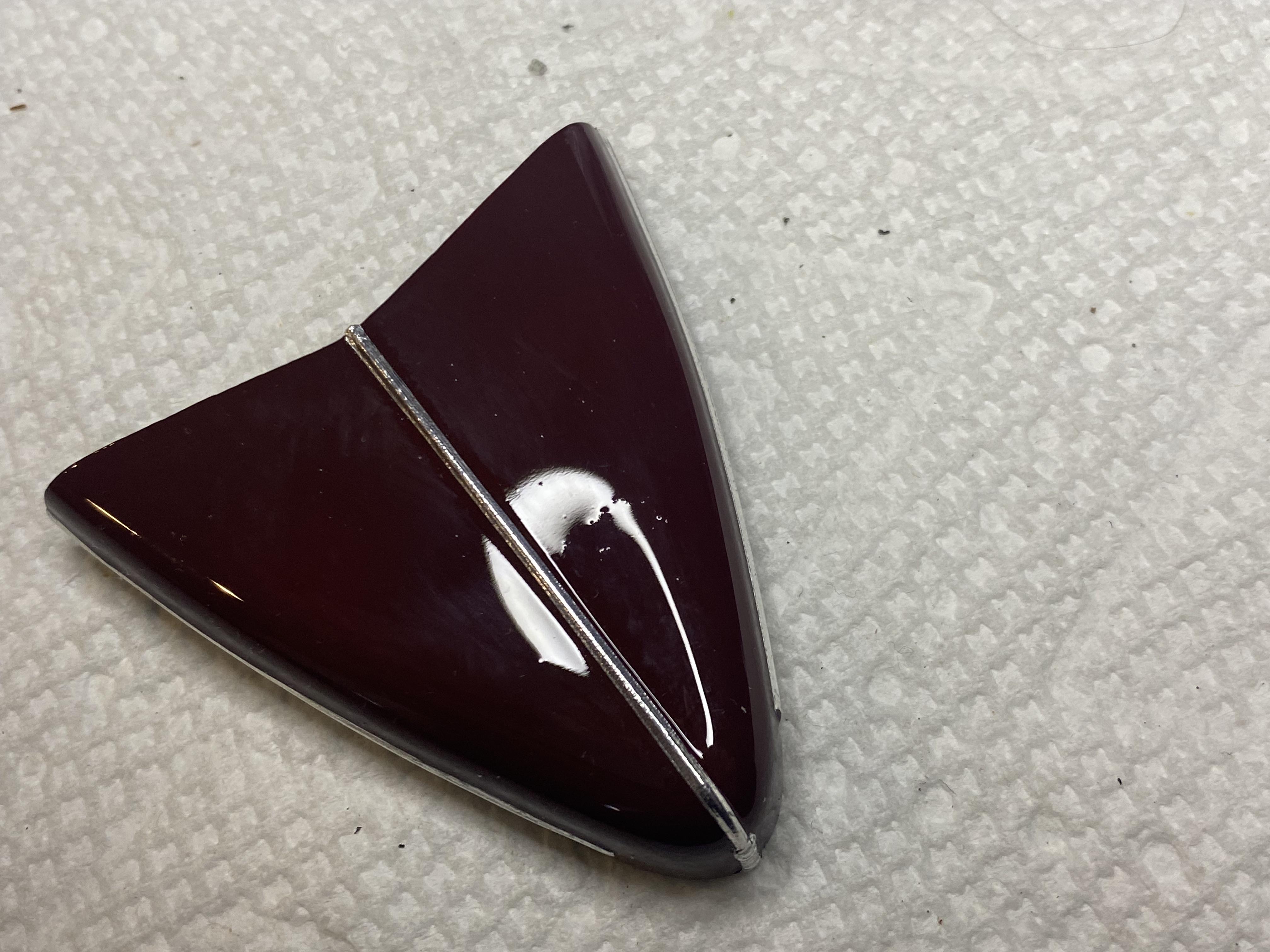

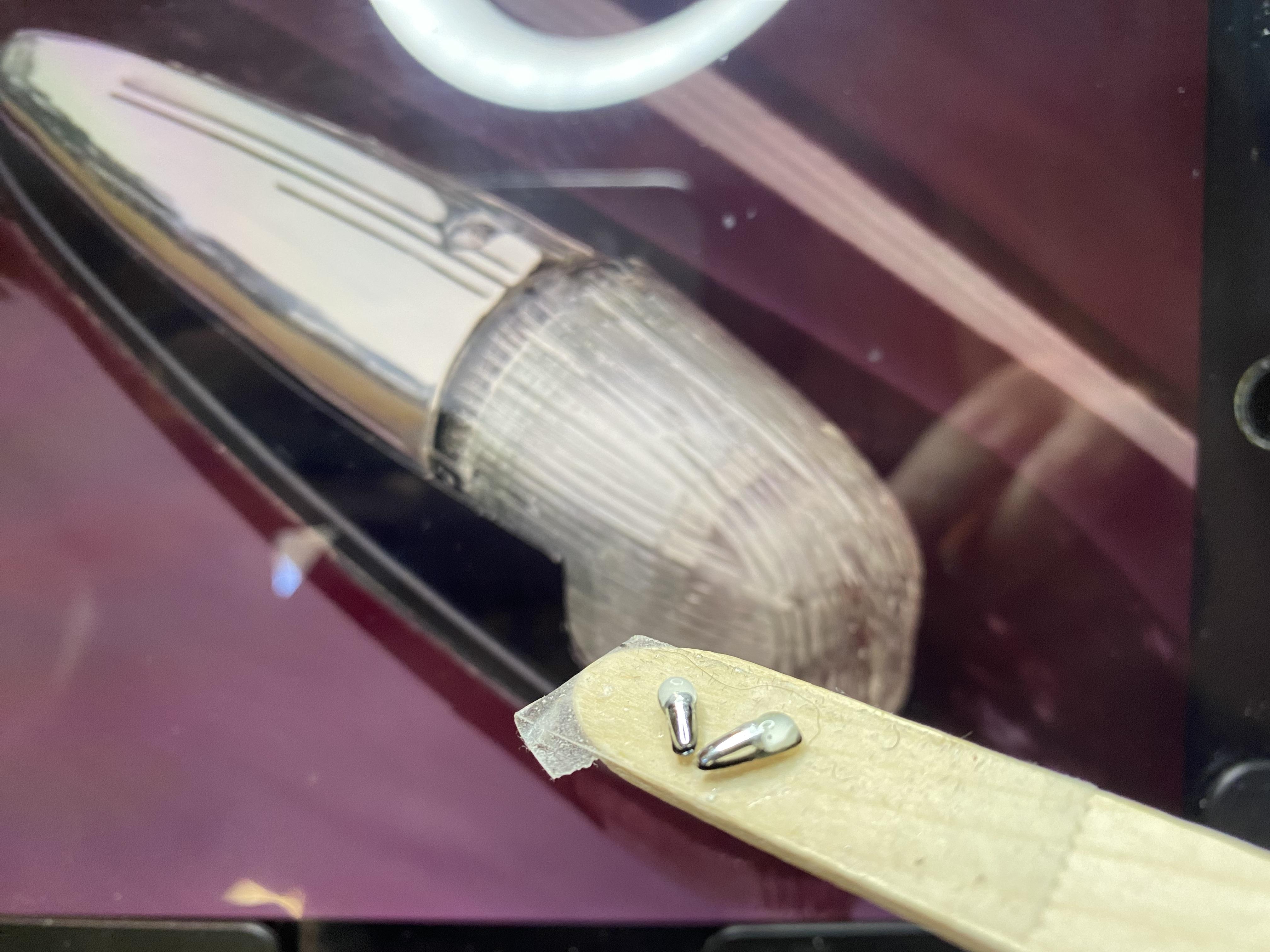

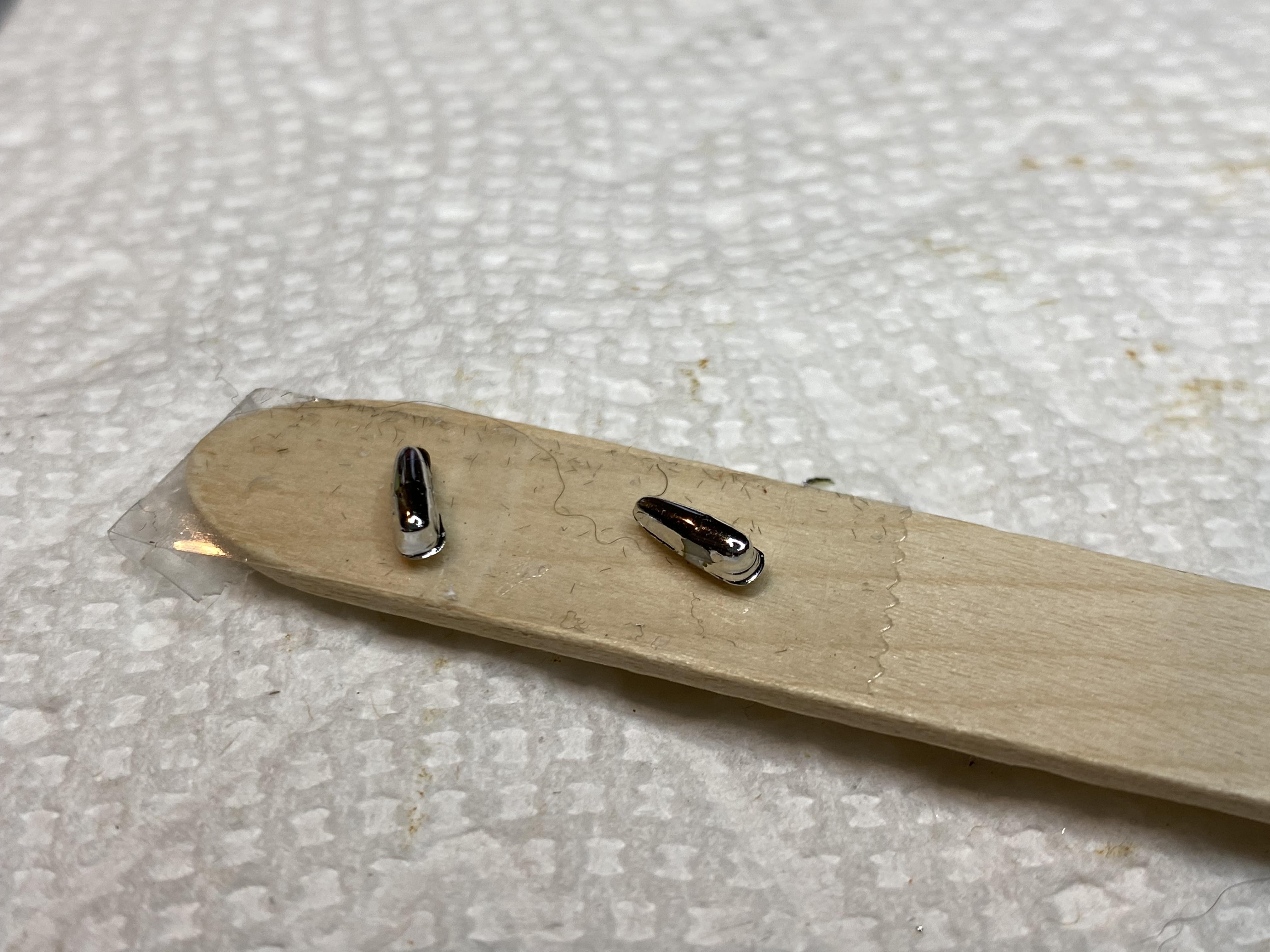

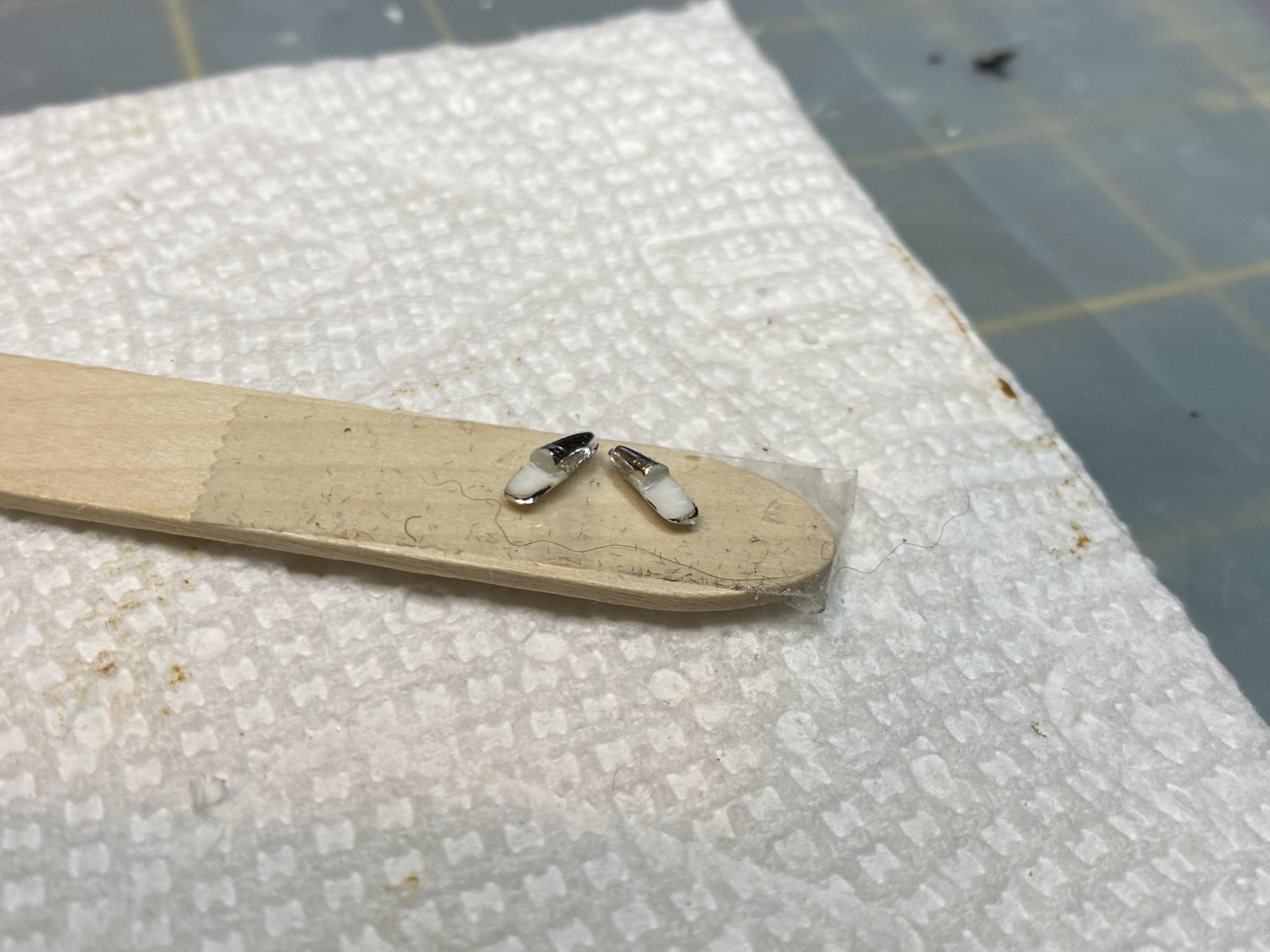

I could not stand the blobs of chrome that were meant to be front turn signals so I removed the area the lenses should be, added clear UV resin and painted.
IMG_5732.thumb.jpeg.fe81357c6792e30f52f311a5a6527c39.jpegIMG_5733.thumb.jpeg.75be3f43dab9db22246ef73bfd389bef.jpegIMG_5734.thumb.jpeg.f2f13e1098352626f07574a2e380c695.jpegIMG_5739.thumb.jpeg.3b49b23e2bd5aa5a57416f857d015e47.jpegIMG_5741.thumb.jpeg.0acabc25a295e496316cde81712b7e54.jpeg

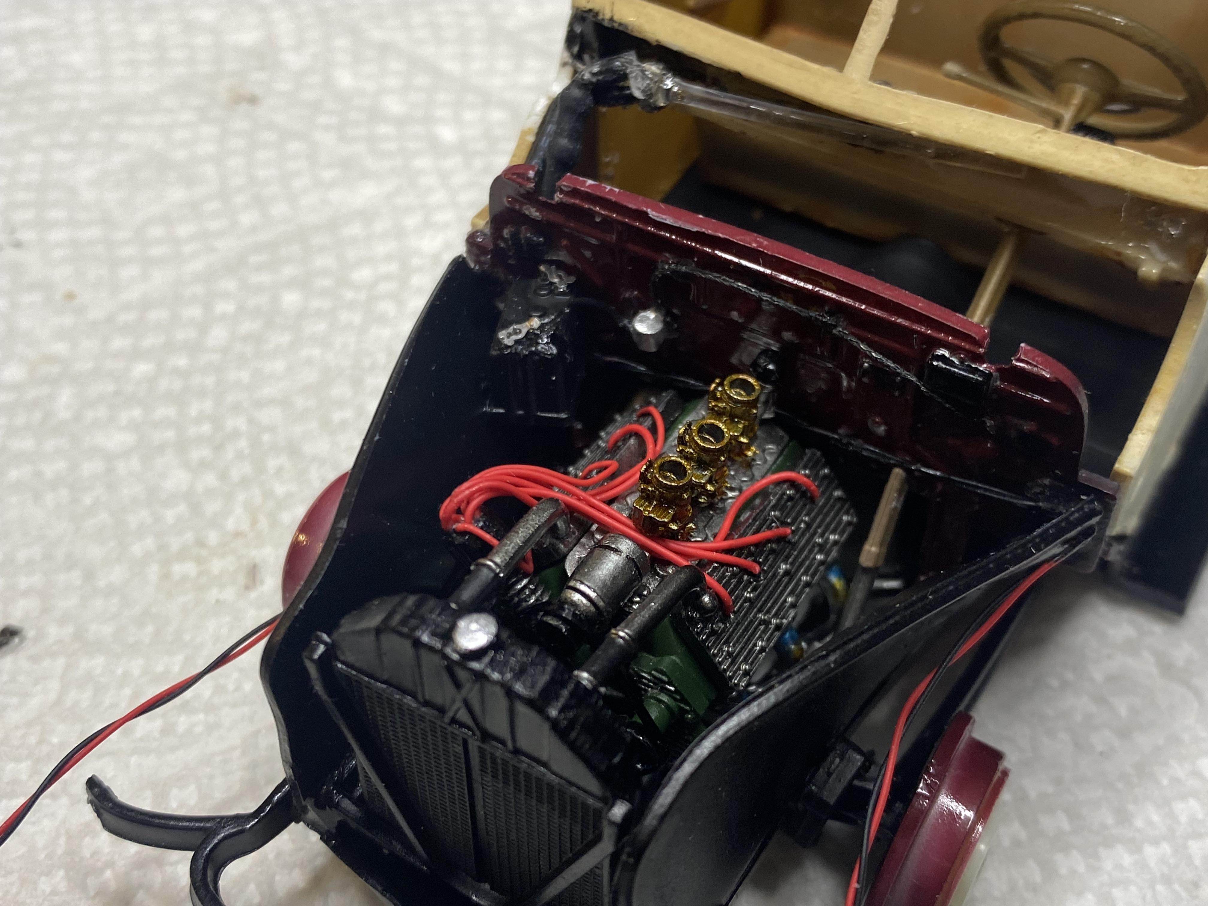

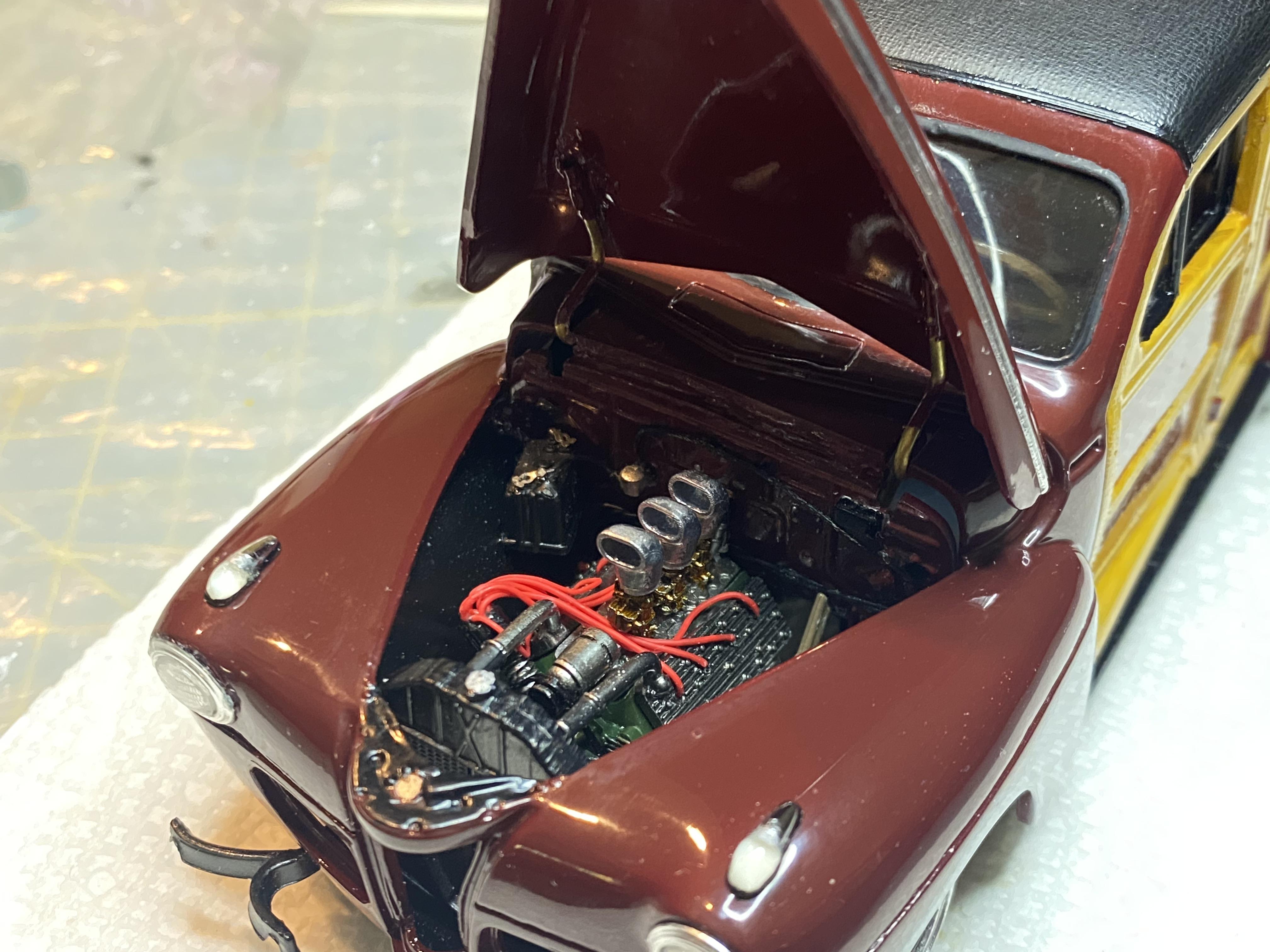

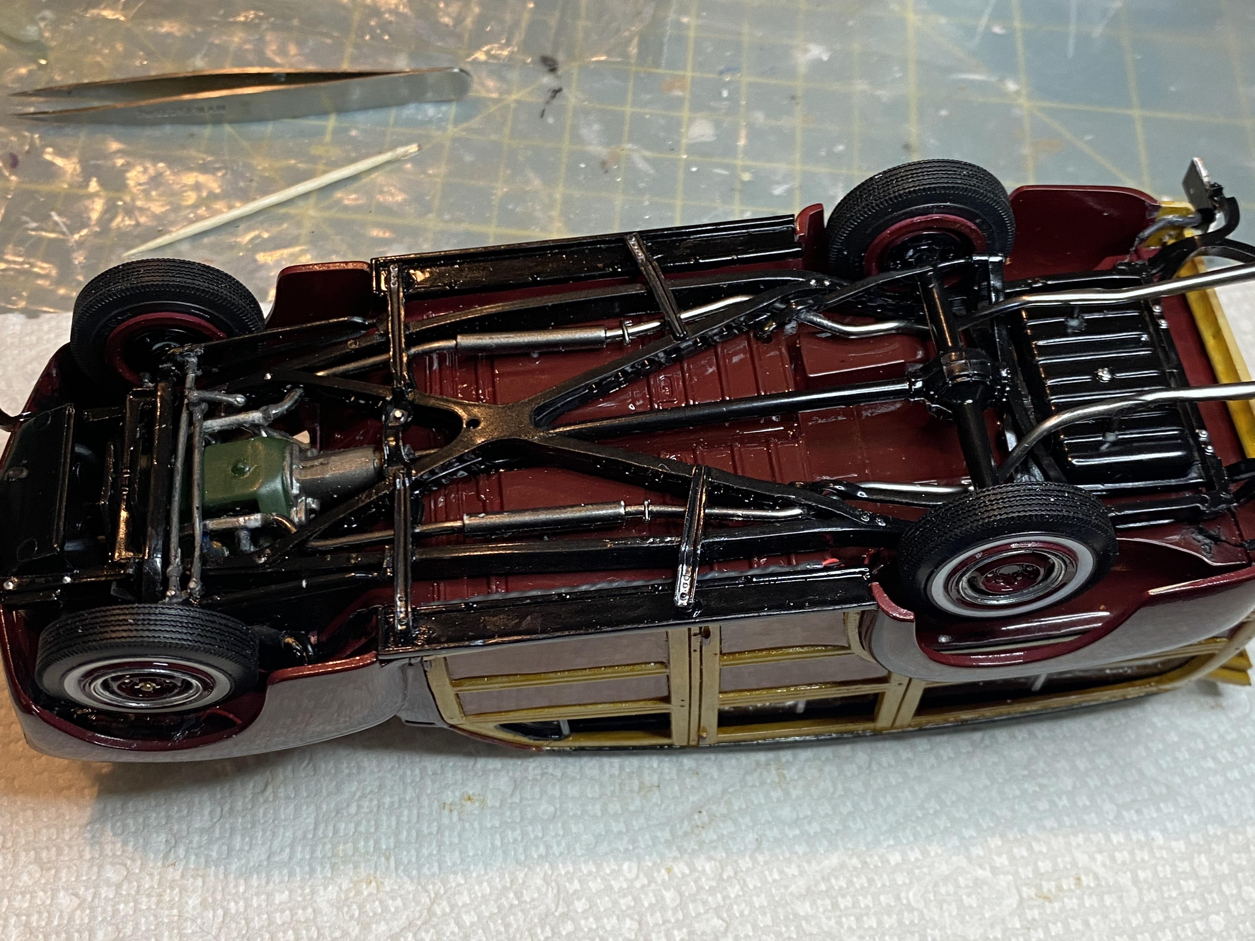

I added the frog Mouth breathers and tires finishing up the engine compartment and chassis.  Much more period correct I think. IMG_5742.thumb.jpeg.a46019ae8ed612fee41908f9e9616bc8.jpegIMG_5747.thumb.jpeg.85963a86709c273fe86c7a2085880d11.jpegIMG_5745.thumb.jpeg.2f781b9bc2a98a8953d03176f651e389.jpeg
The rear seat hides the battery quite well.

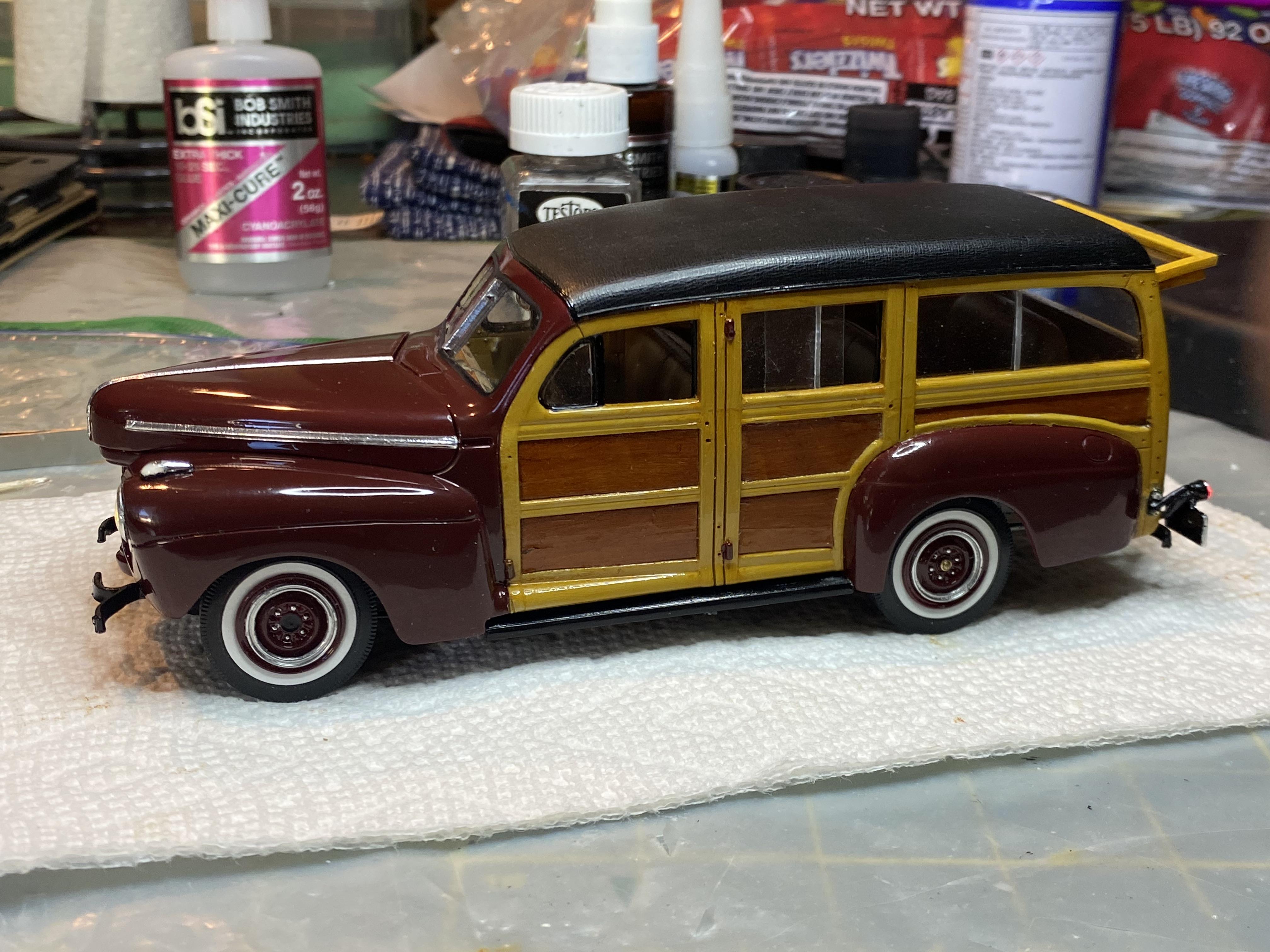

I actually love the slightly lowered stance. Added the bumpers and grill.
IMG_5750.thumb.jpeg.f535fbdffc7da6f7c9a9b23b9b56c040.jpegIMG_5753.thumb.jpeg.a16869ecaed6482dd316e066bcee2793.jpeg

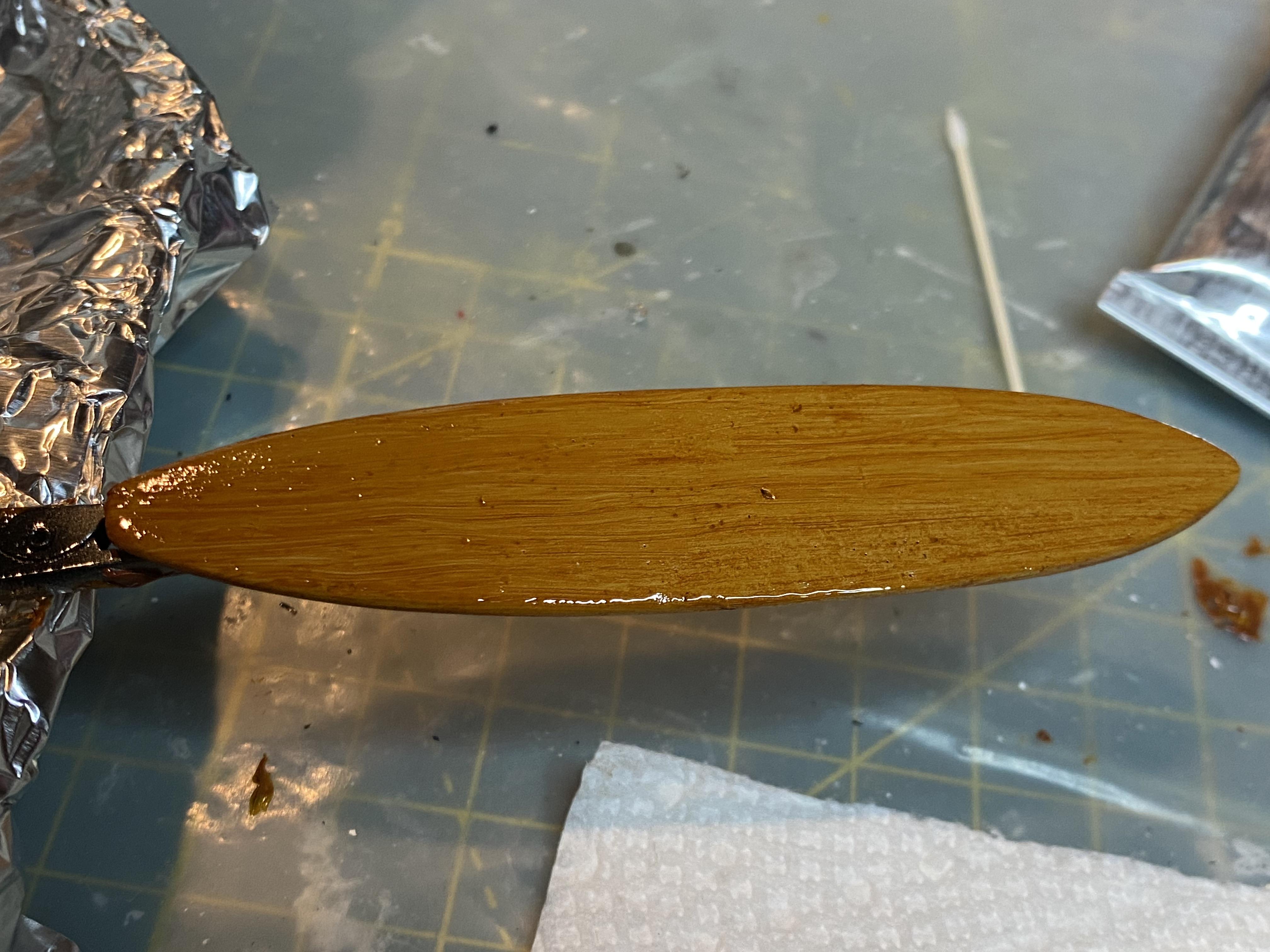

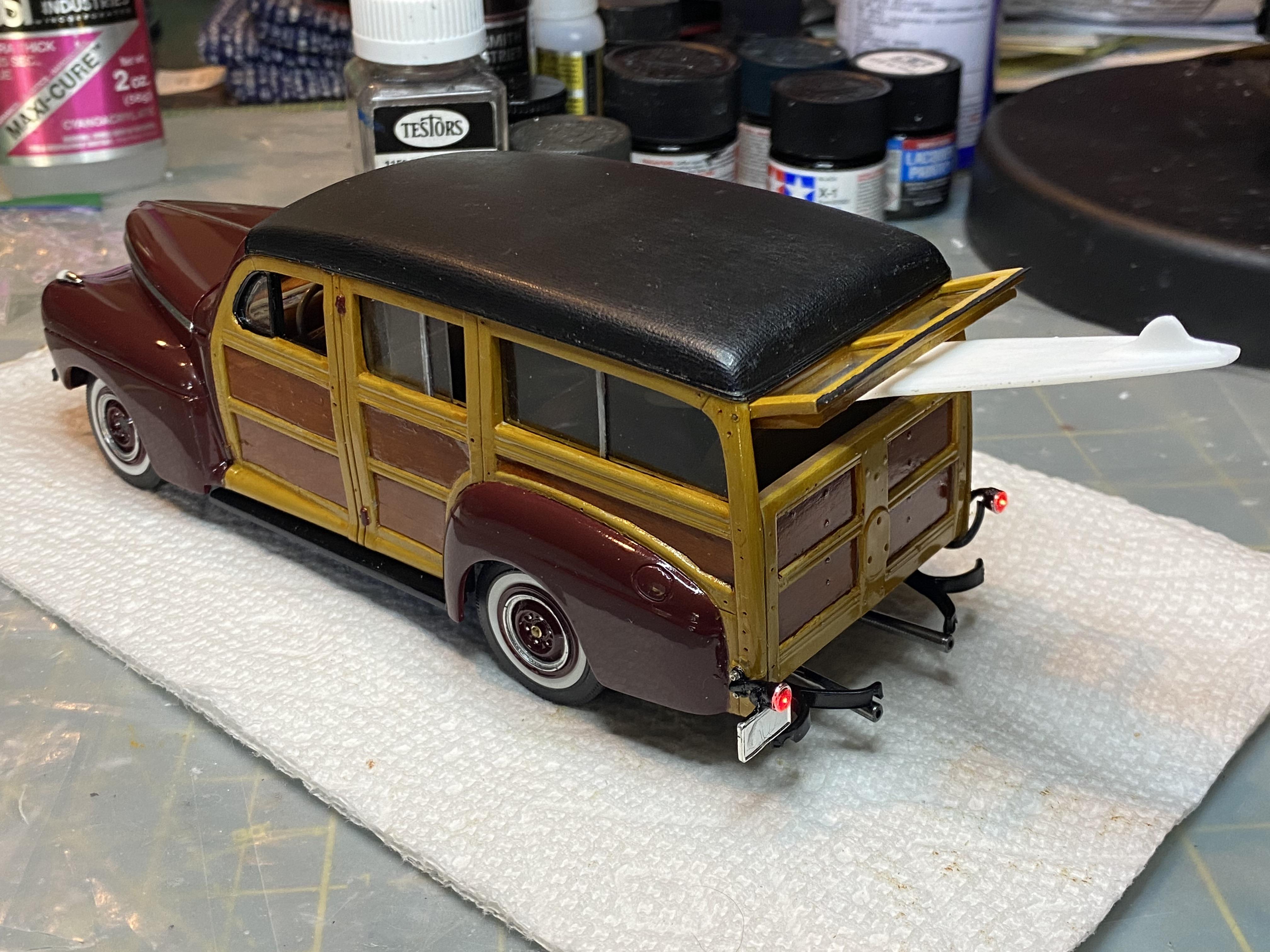

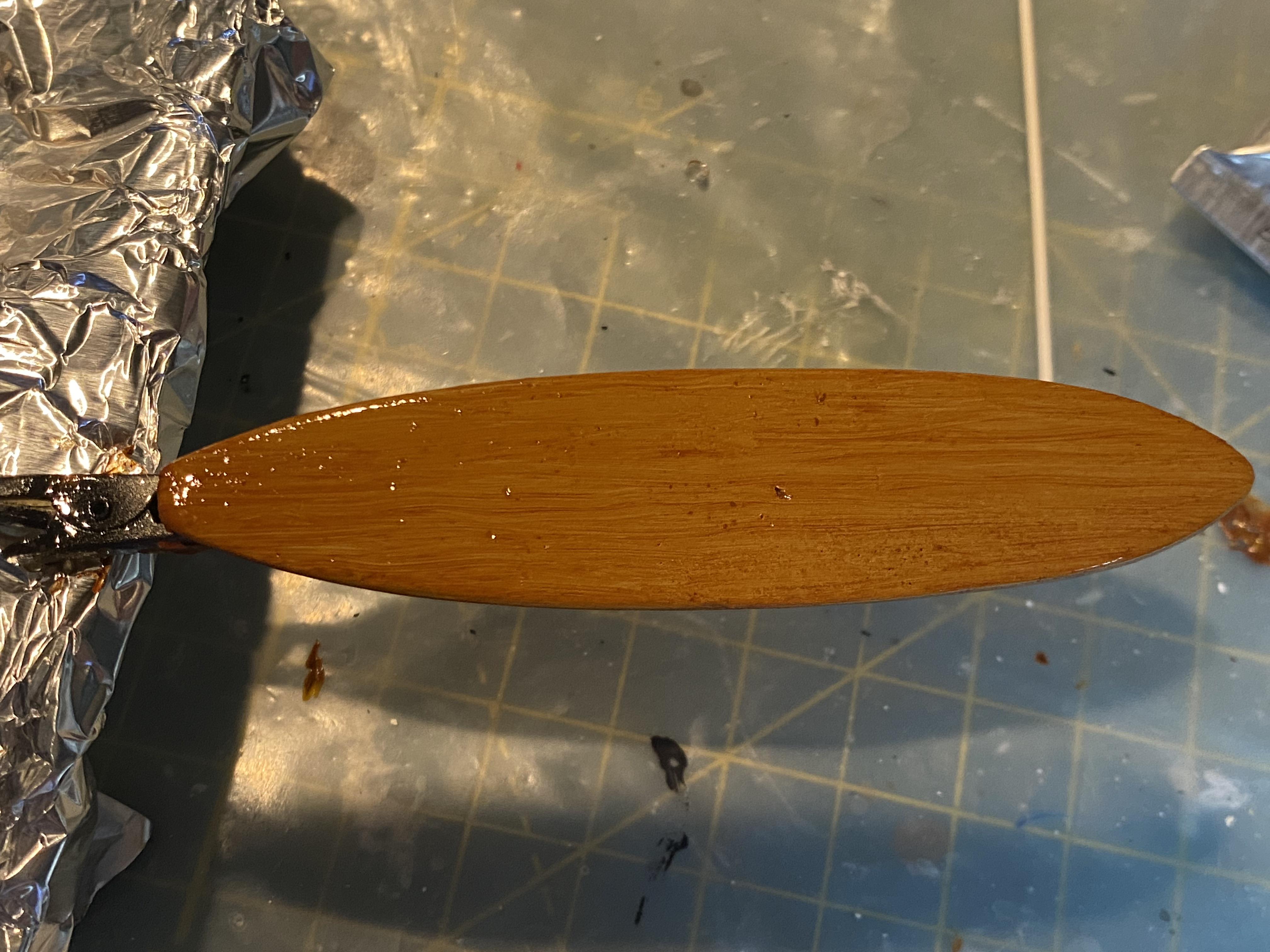

I decided not to do a roof rack, I just have the surfboard hanging out through the rear hatch. First pass on painting the surfboard.
IMG_5752.thumb.jpeg.a5db8d65d84390b4bf26bfebed2de59c.jpegIMG_5754.thumb.jpeg.8418c83c7163c1041518077be435878f.jpegIMG_5756.thumb.jpeg.403f71a581cd752e3ca06aacf005f1dc.jpeg

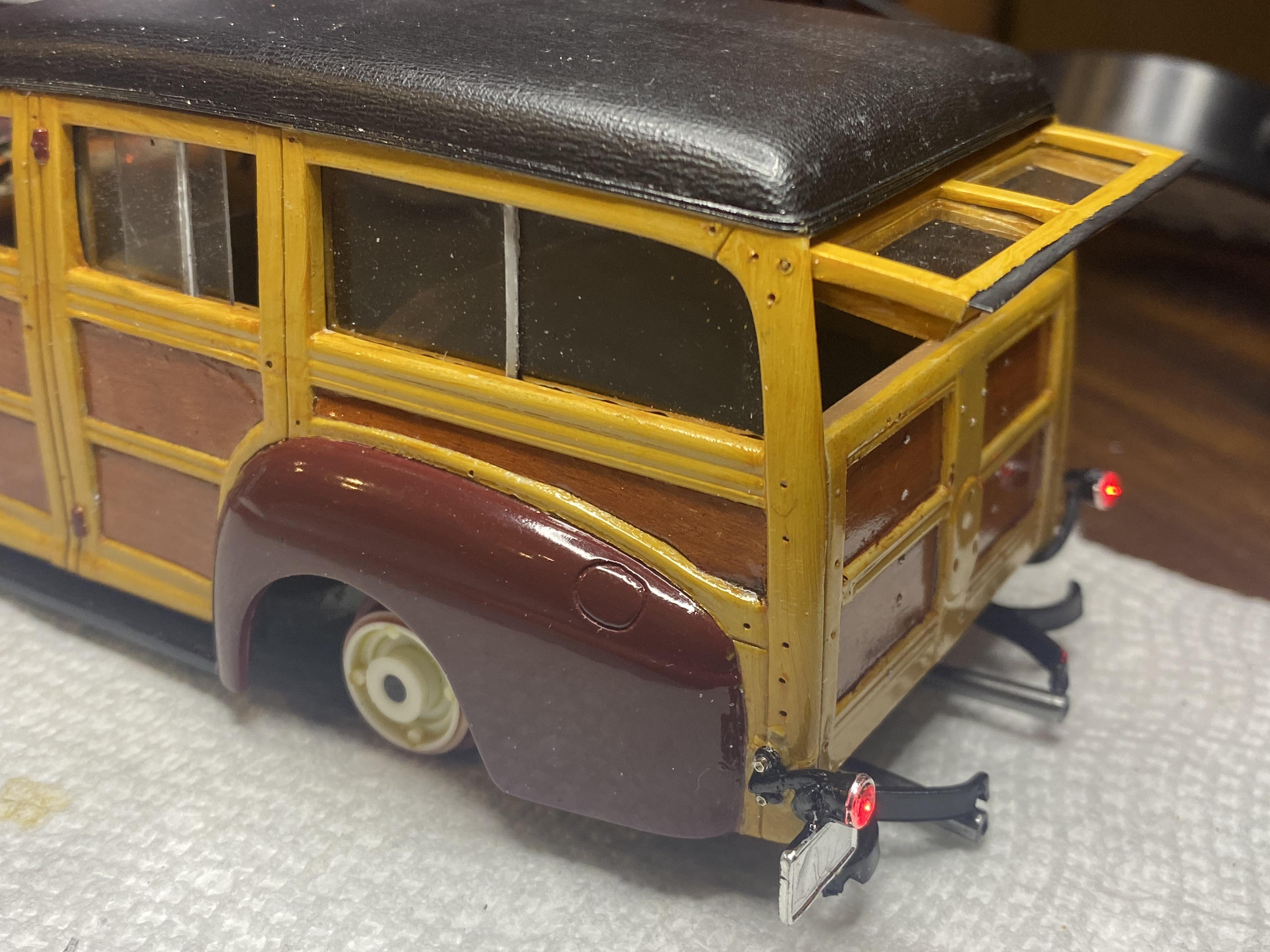

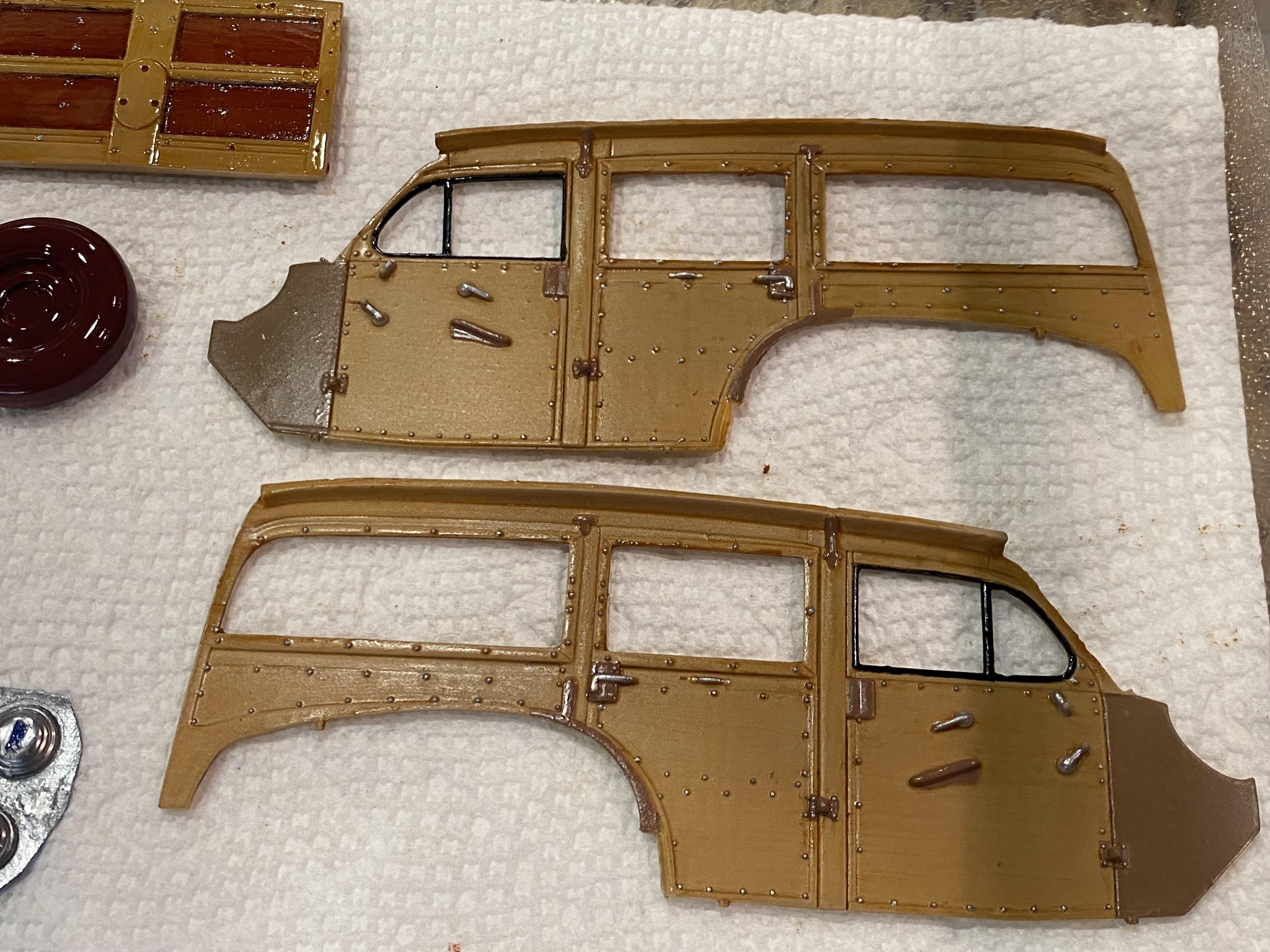

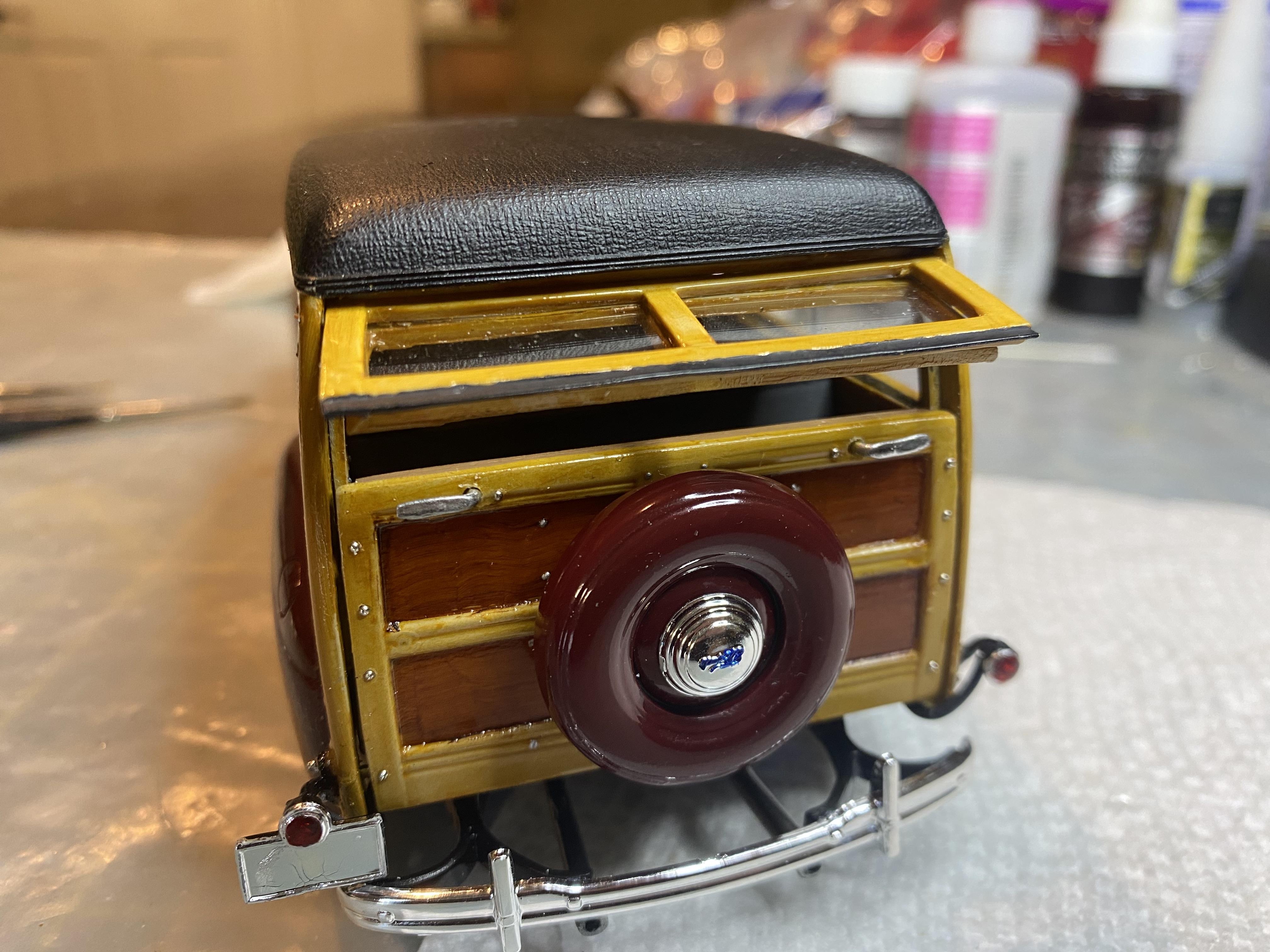

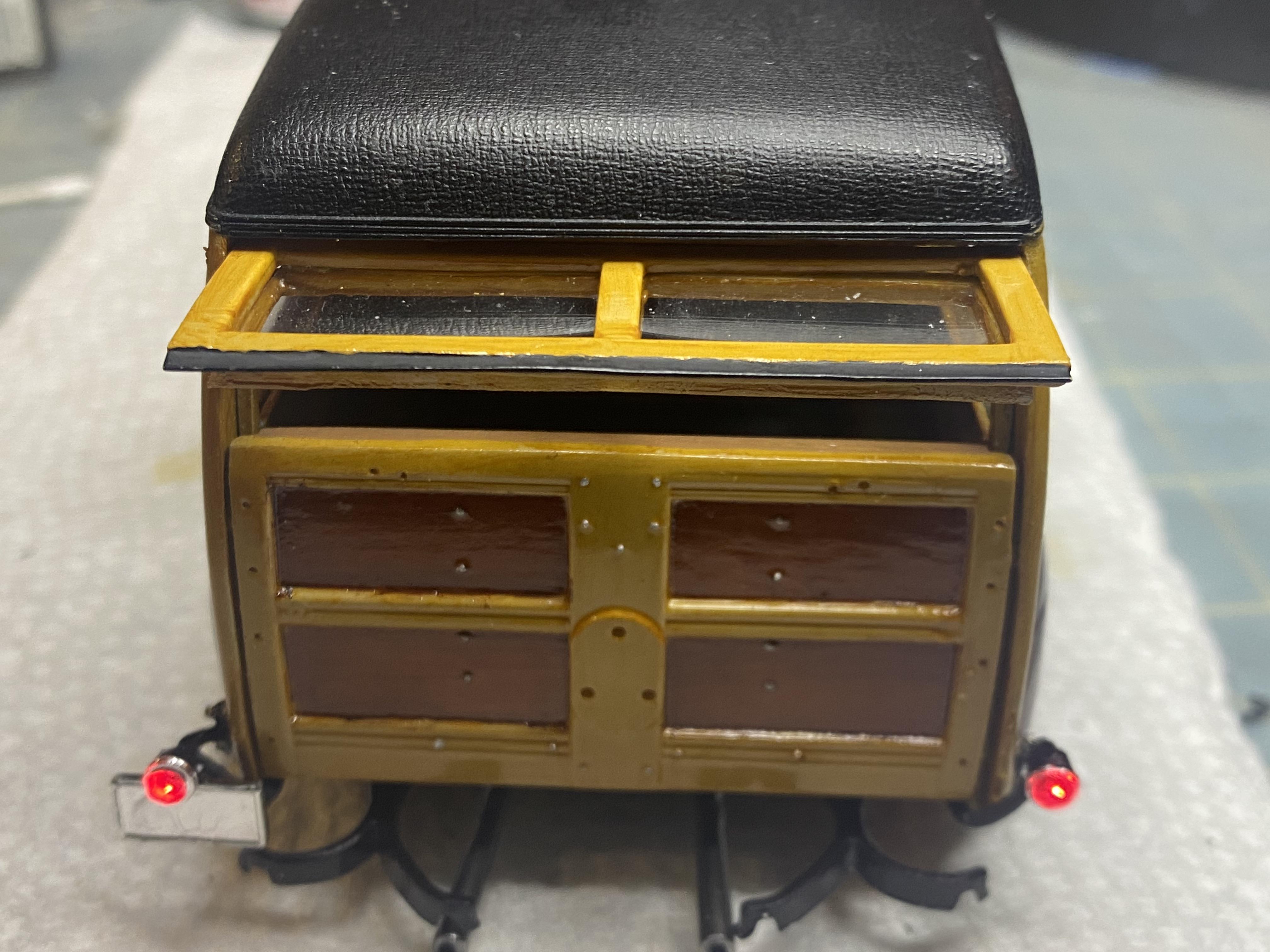

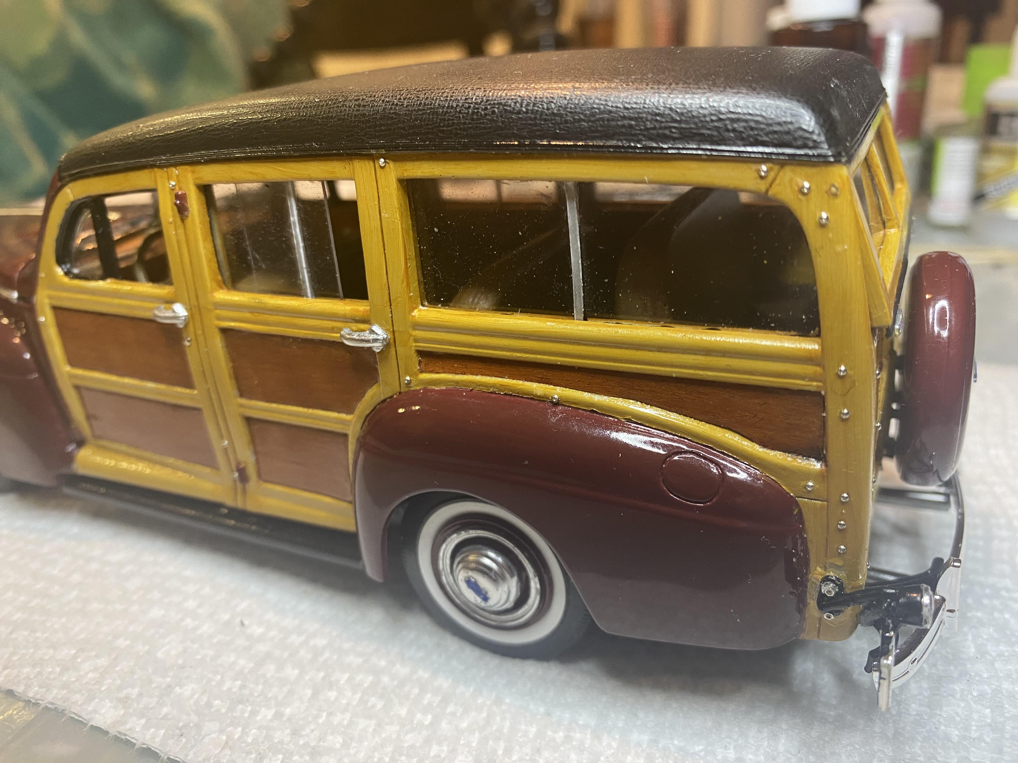

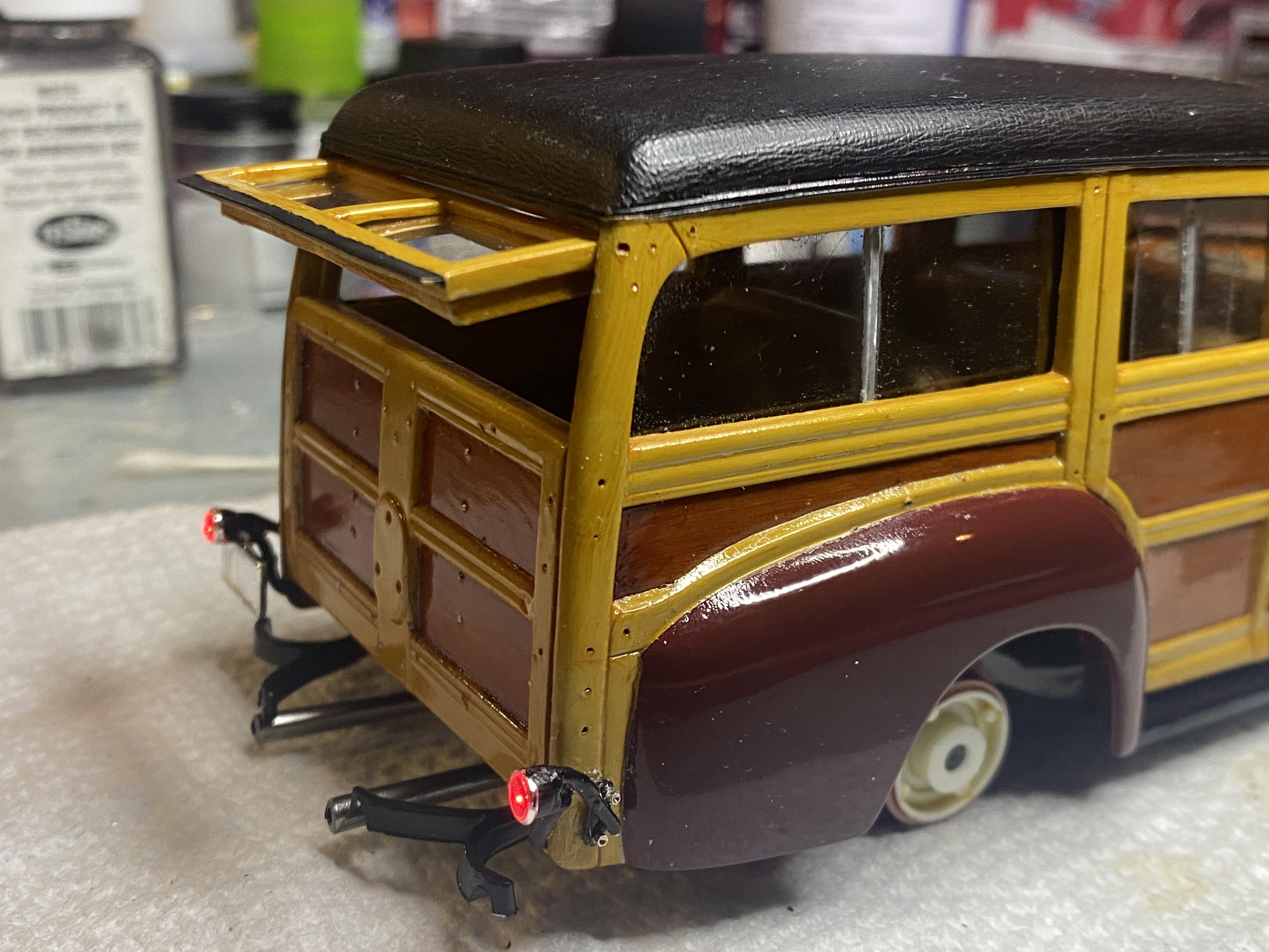

Not much new. Added the rivets to the rear door and scratch built the rear door handles from brass rod, hammered into shape. I think the rivets are very tiny, but add a lot to the look of the wood panels. Went ahead and added the hubcaps.
IMG_5798.thumb.jpeg.cdbe103a526d02c813d77323f9364092.jpegIMG_5800.thumb.jpeg.d66908768c07083d254671458d403485.jpeg
Look at all of those holes on the sides I still need to add rivets to! ?

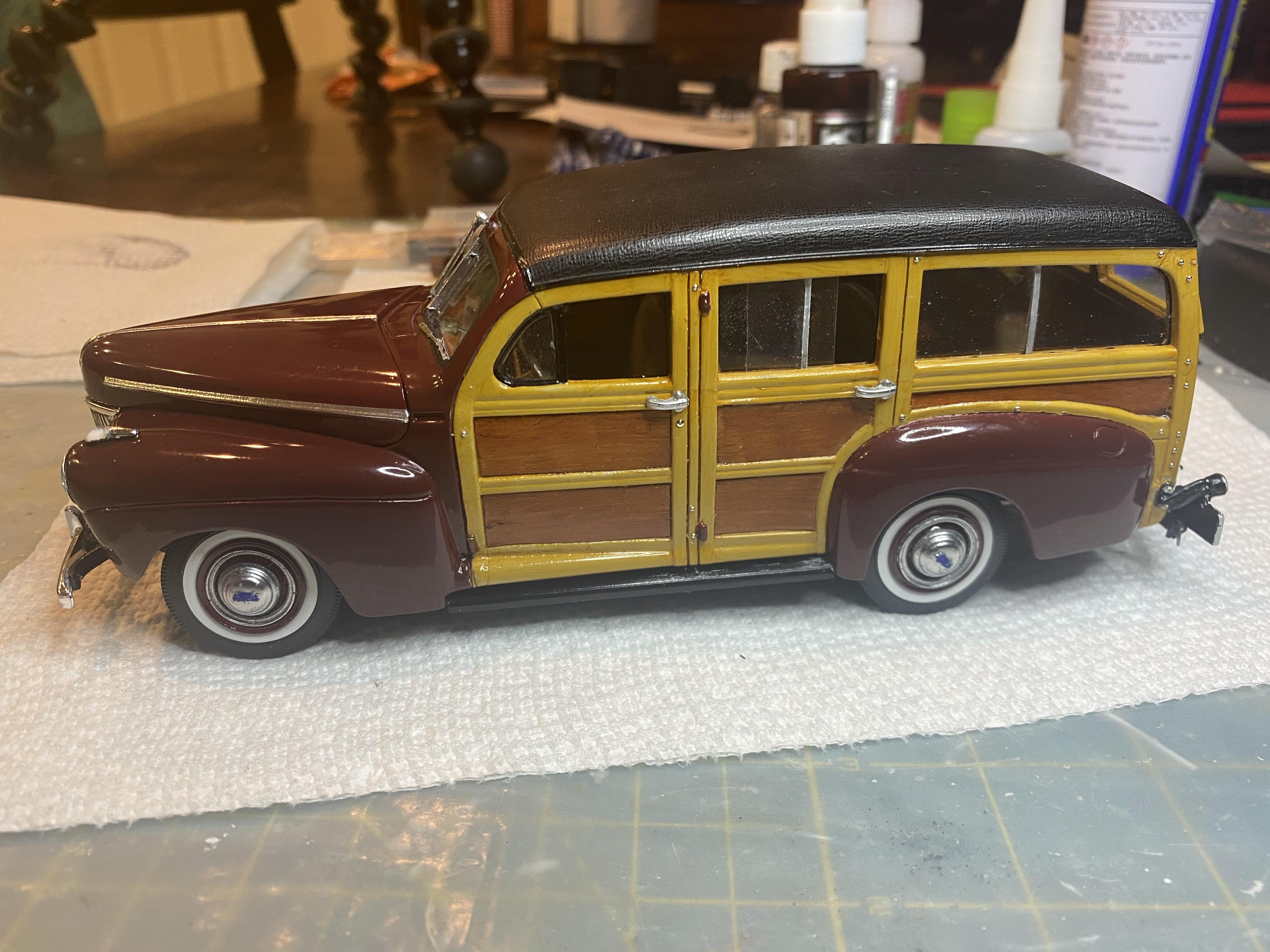

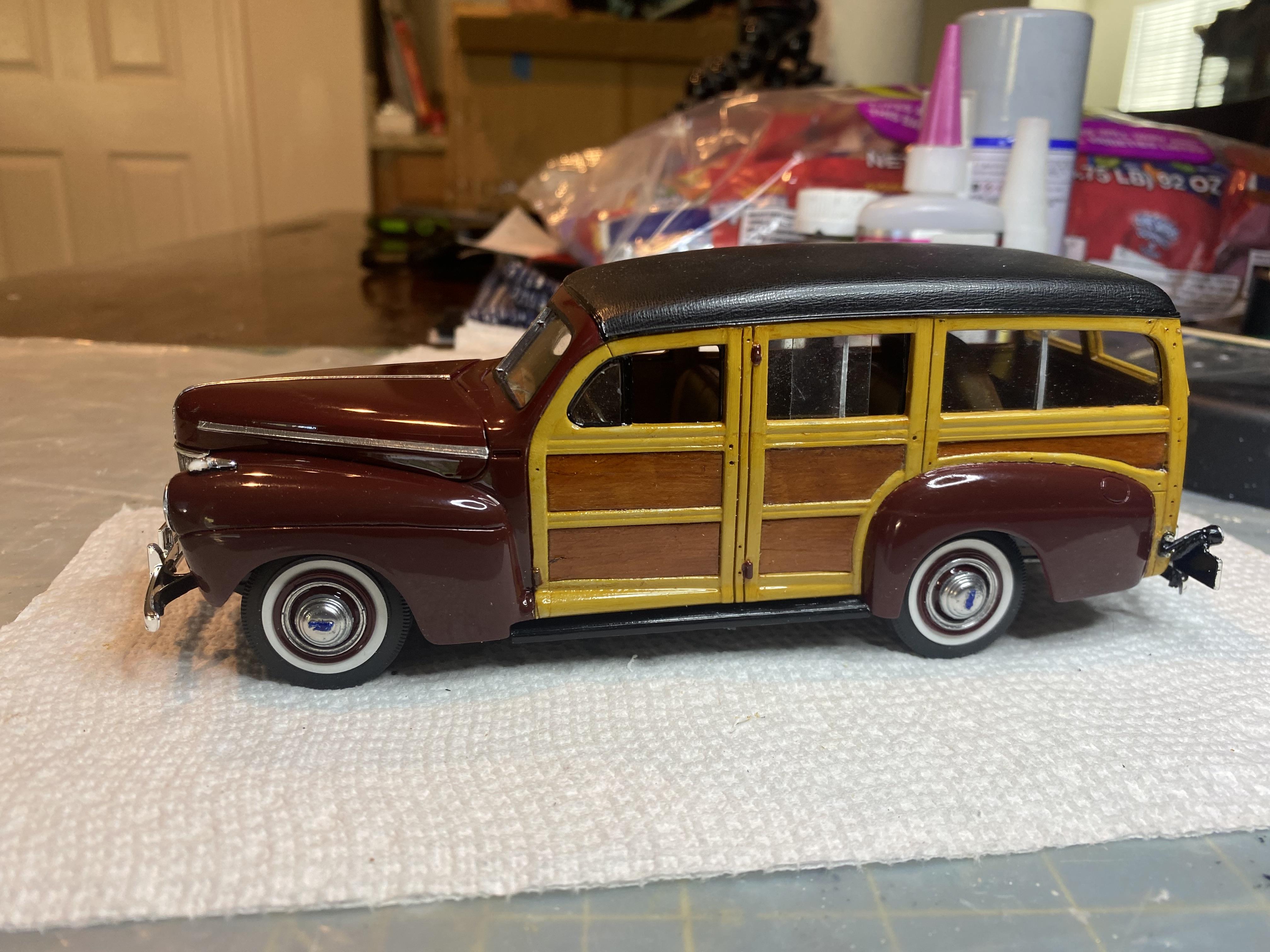

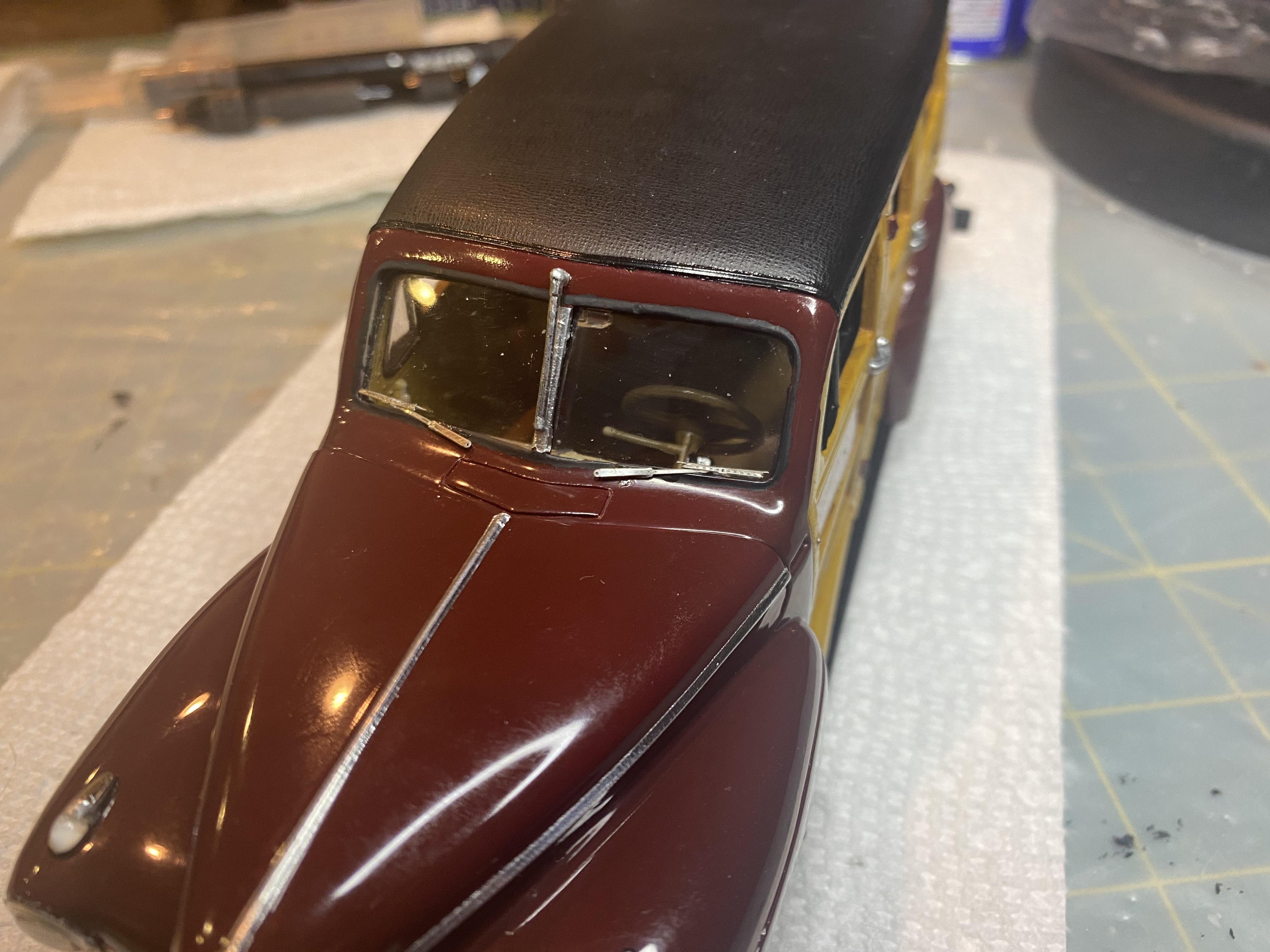

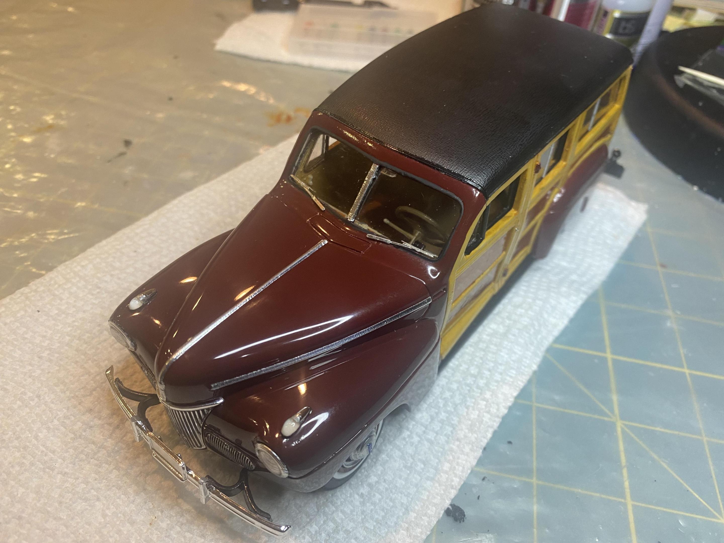

A little more work. Added the wipers, door locks, door handles, pinned and added the antenna so it can be rotated as desired. Turns out I am a few 0.9mm rivets so I ordered another batch for Australia. They are really hard to get sometimes. One side done and missing four for the other side.
IMG_5801.thumb.jpeg.7e44d1b0e8e0652f60b7f5c0df9c8039.jpegIMG_5802.thumb.jpeg.25be8bd93562e28685b56efef875e3dd.jpegIMG_5803.thumb.jpeg.4606806c67f43e3230ef66bab61866c6.jpegIMG_5804.thumb.jpeg.f75641ff82412c2c4cd46d982c39dde9.jpeg
  • Like 3
Nice progress on this!
In addition to all of the features you pointed out, I like the slider windows on the rear side door. They look operable. Is this something you came up with or is it in the kit?
David G.
