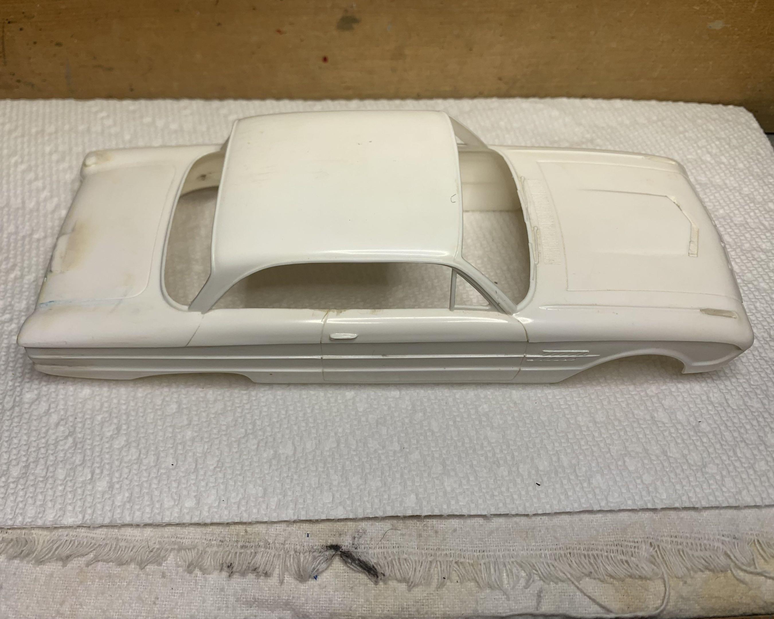

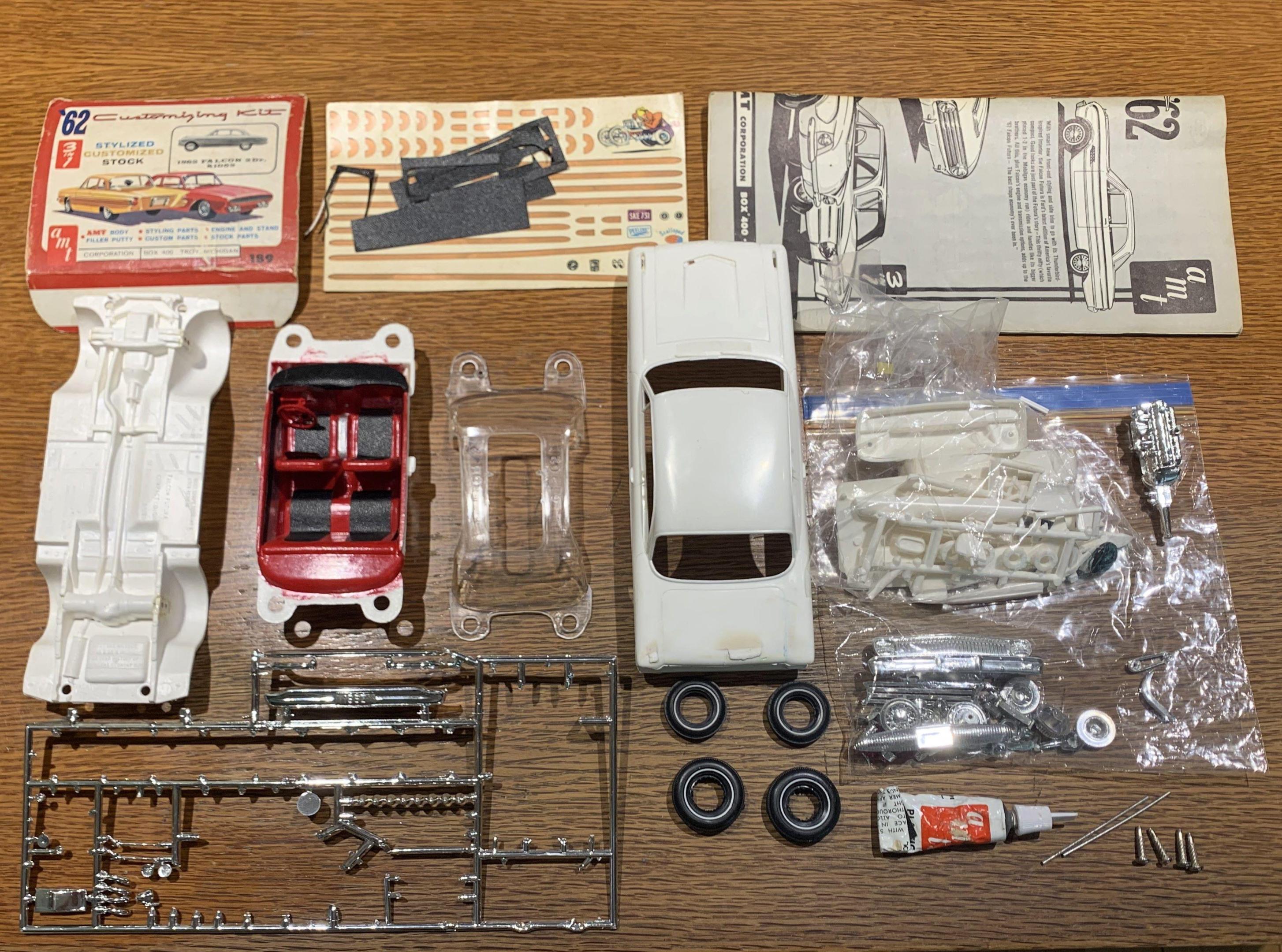

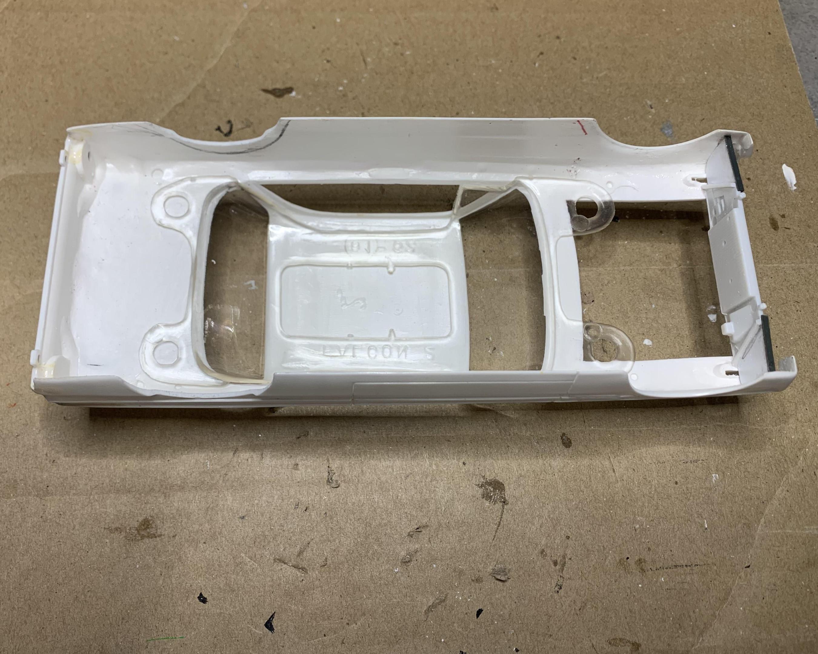

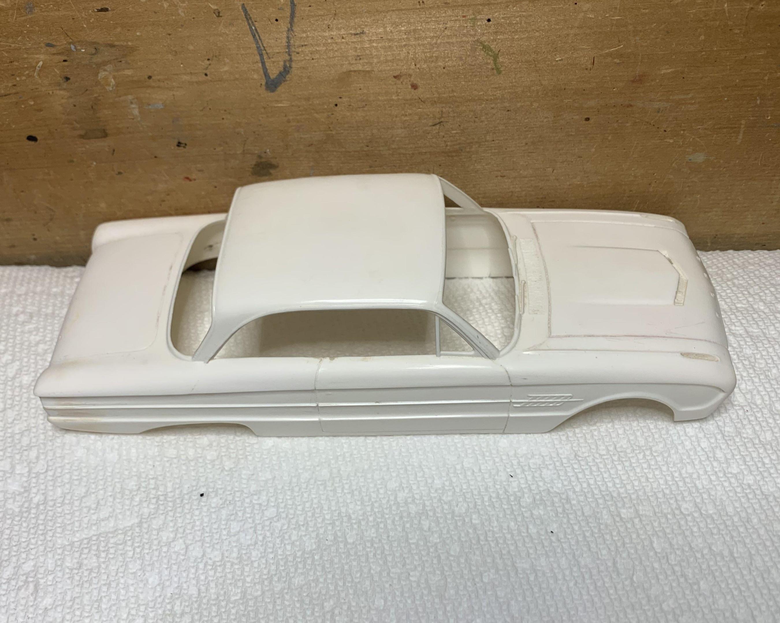

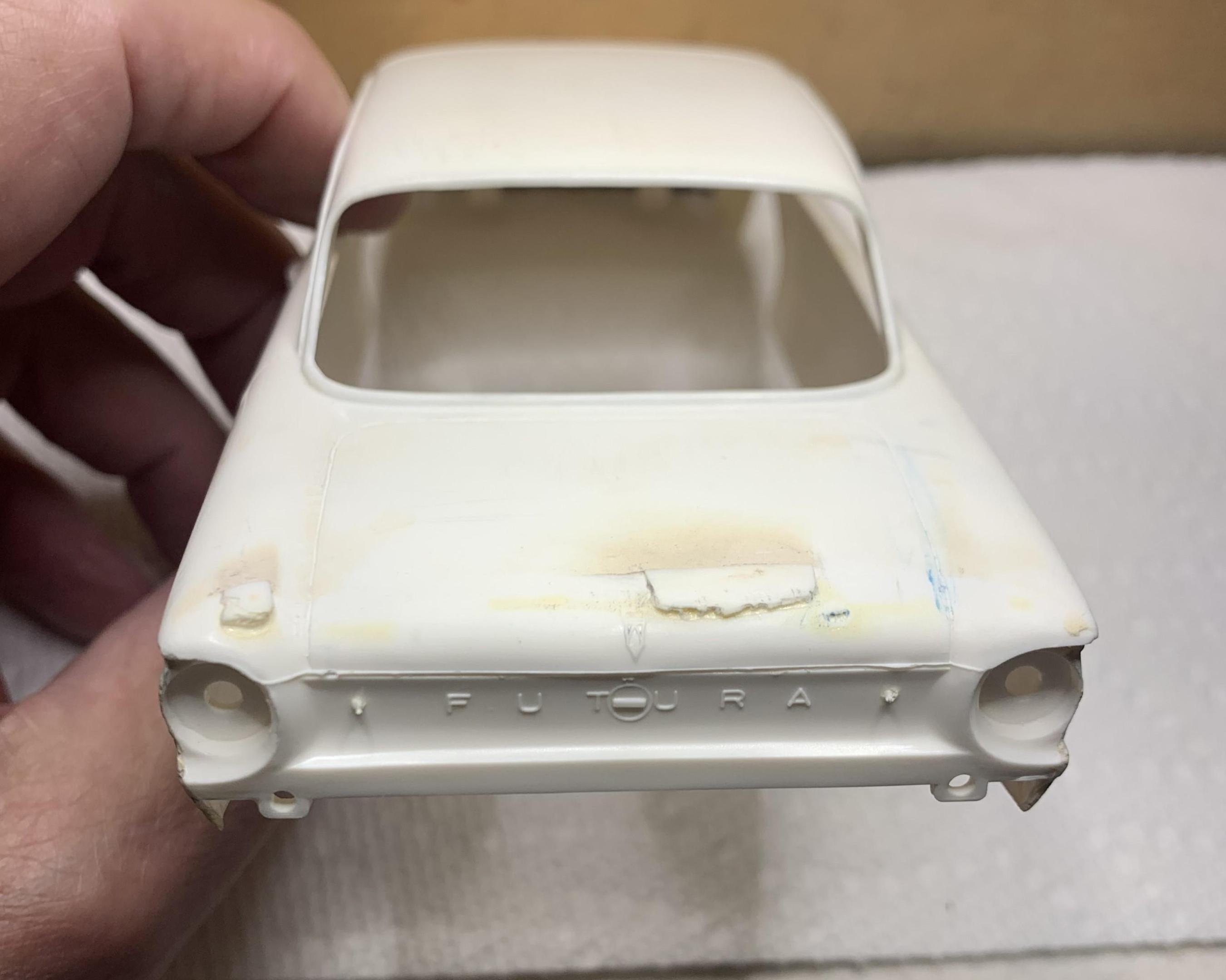

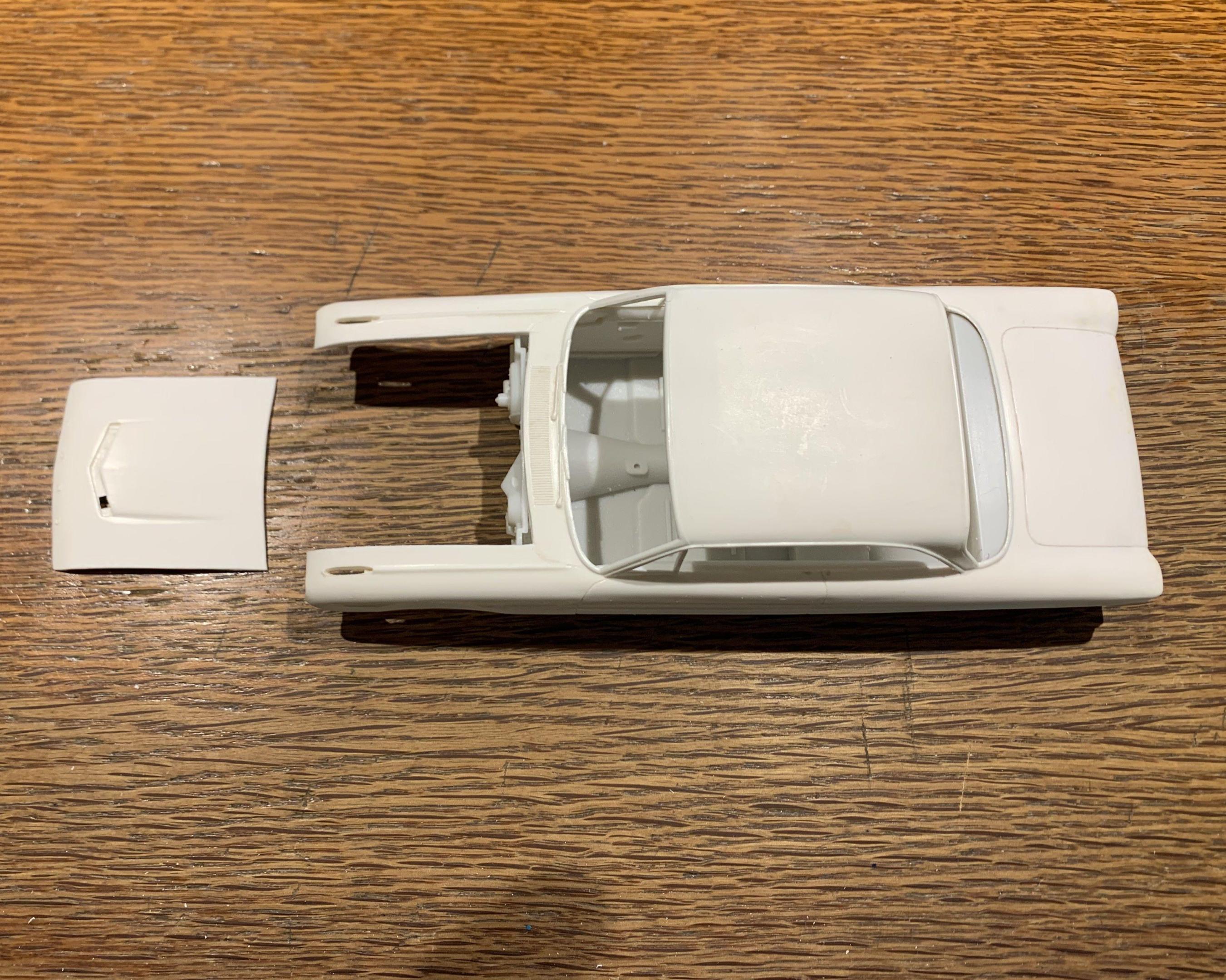

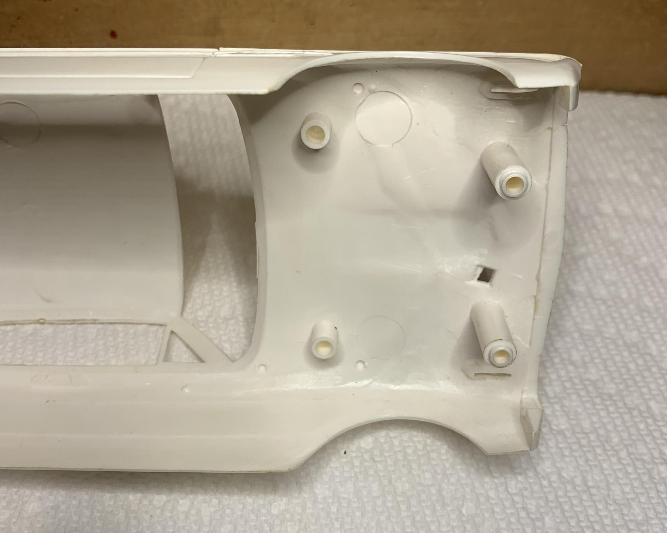

dino246gt Posted September 20, 2024 Posted September 20, 2024 I've always loved the first gen Falcons, but no detailed kits are available. I found this old '62 and decided to give it a gasser look. It had the Styline rear puttied on, but I removed that first. Next I removed all the protrusions from under the one-piece body. Then I smoothed out some of the serious mold seams and removed the door handles. 7

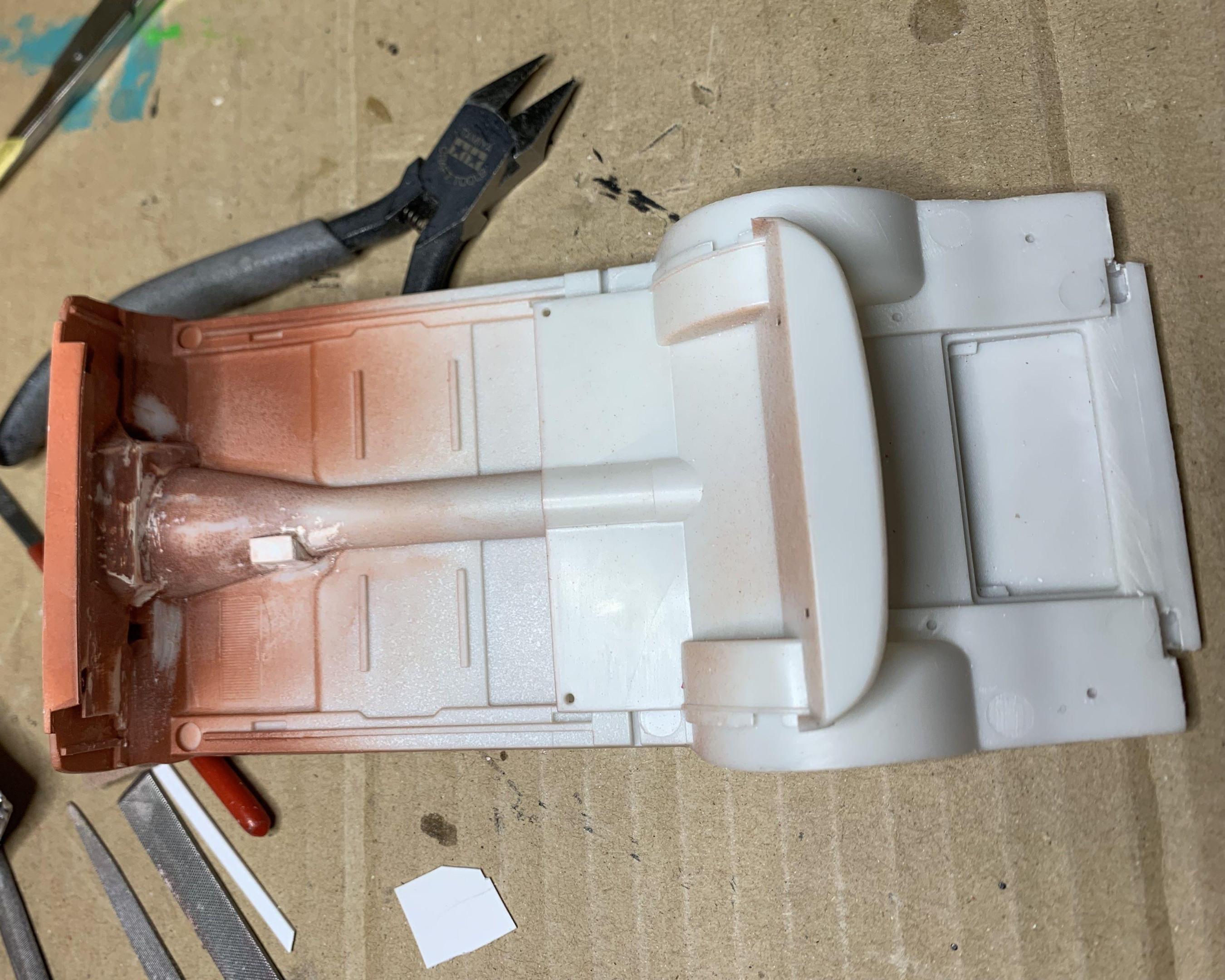

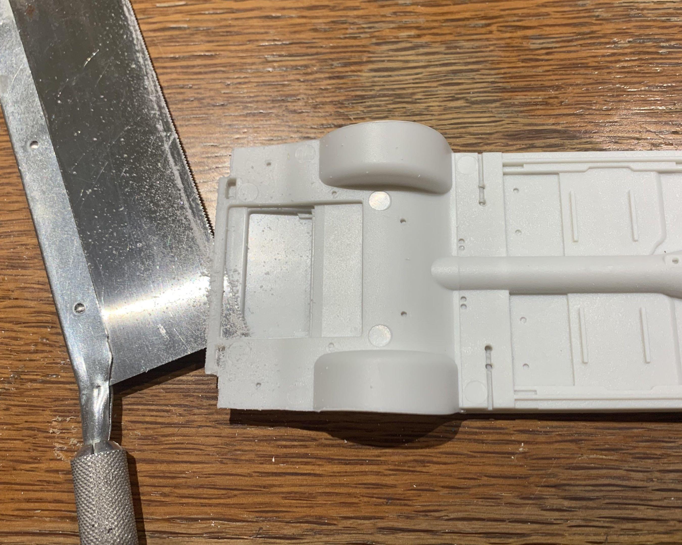

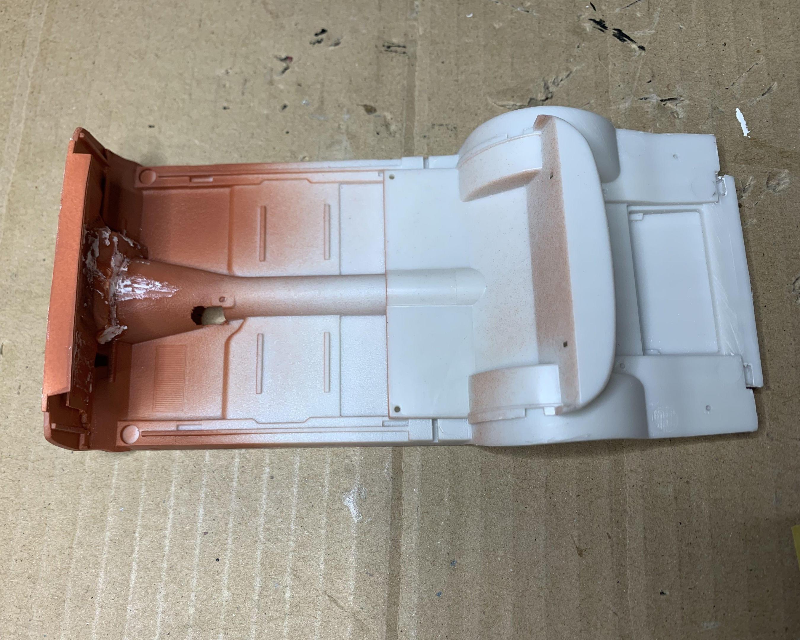

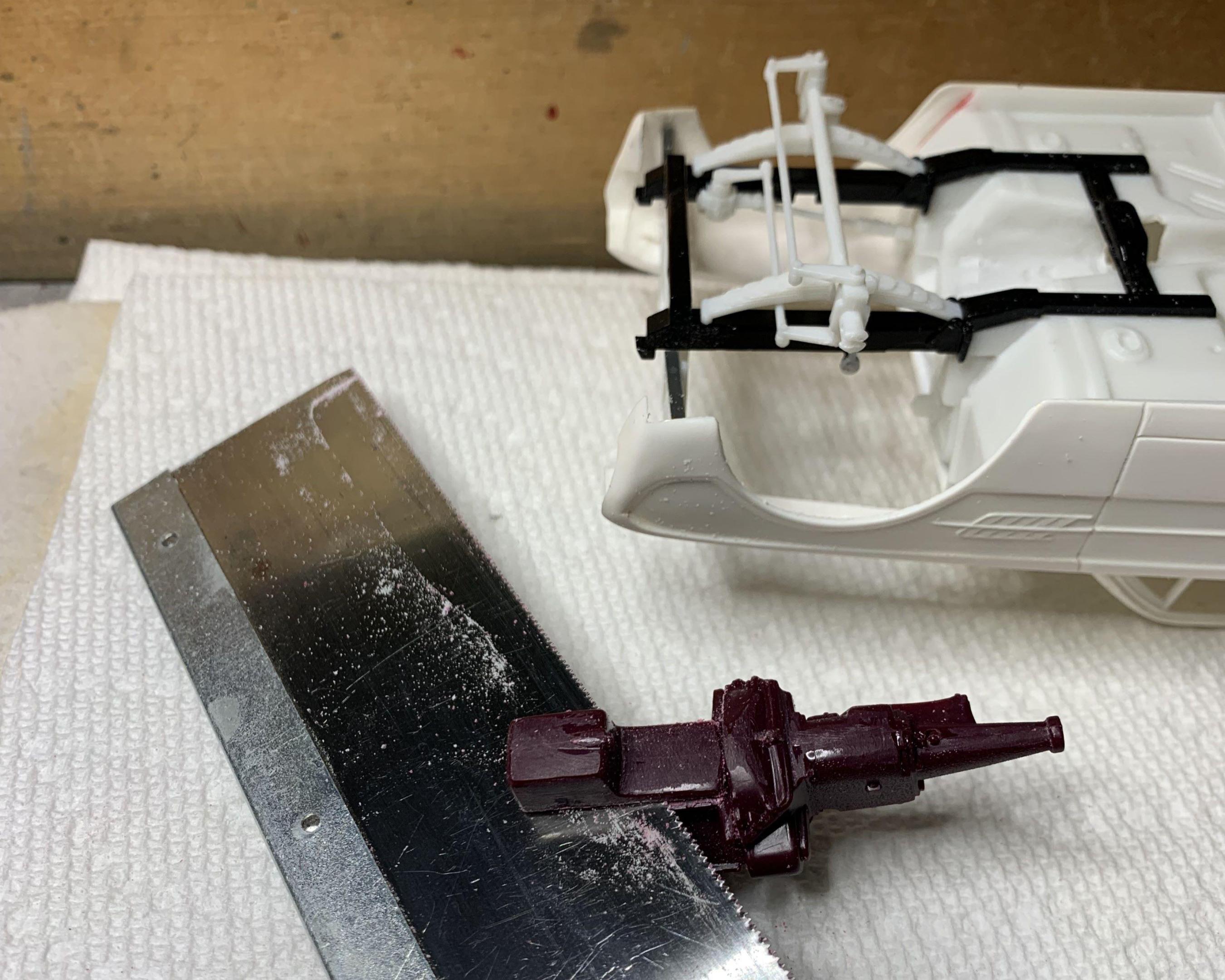

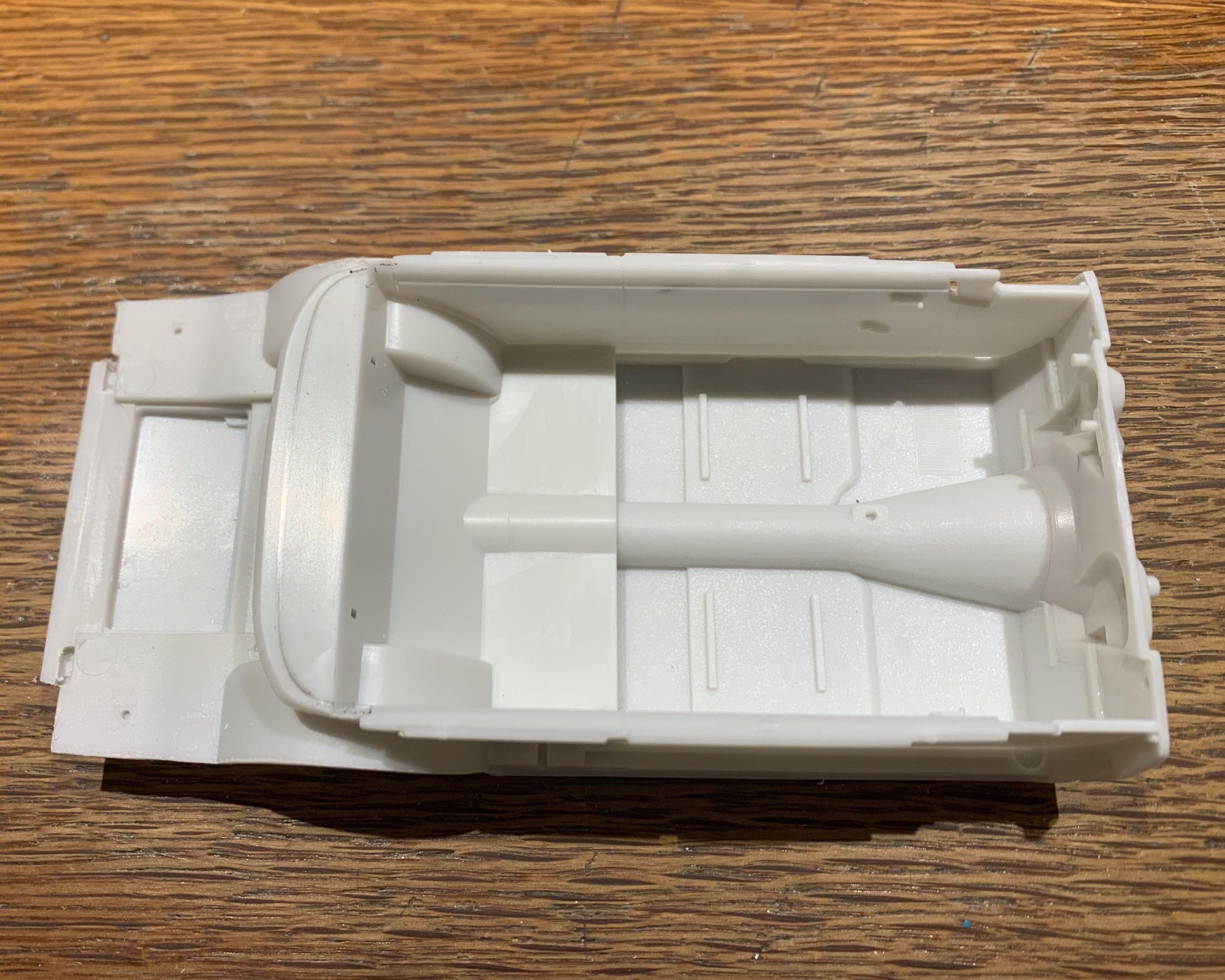

dino246gt Posted September 20, 2024 Author Posted September 20, 2024 I modified the Mobius Chevy ll floor pan and interior (I'll modify the Falcon dashboard to fit). I cut the hood out and thinned it. 8
Mr. Metallic Posted September 20, 2024 Posted September 20, 2024 (edited) Off to a good start. For a more detailed chassis can you use one of the many first gen mustang frames to save you some work? edit- oops, I see that you're using the Moebius frame already Edited September 20, 2024 by Mr. Metallic 1

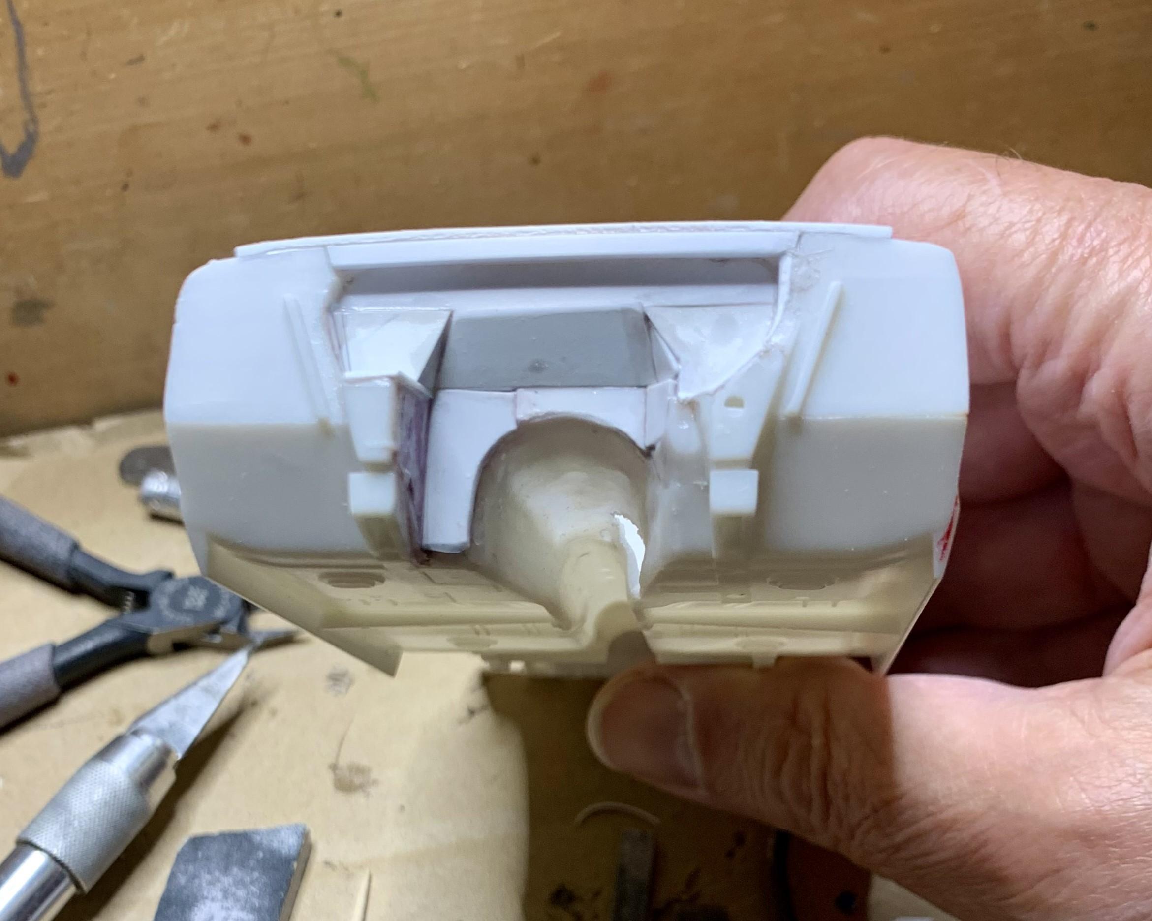

dino246gt Posted September 20, 2024 Author Posted September 20, 2024 I modified the Chevy rad wall to fit. I decided to use the 427 FE from the Thunderbolt kit, but it just won't fit......................yet! 6

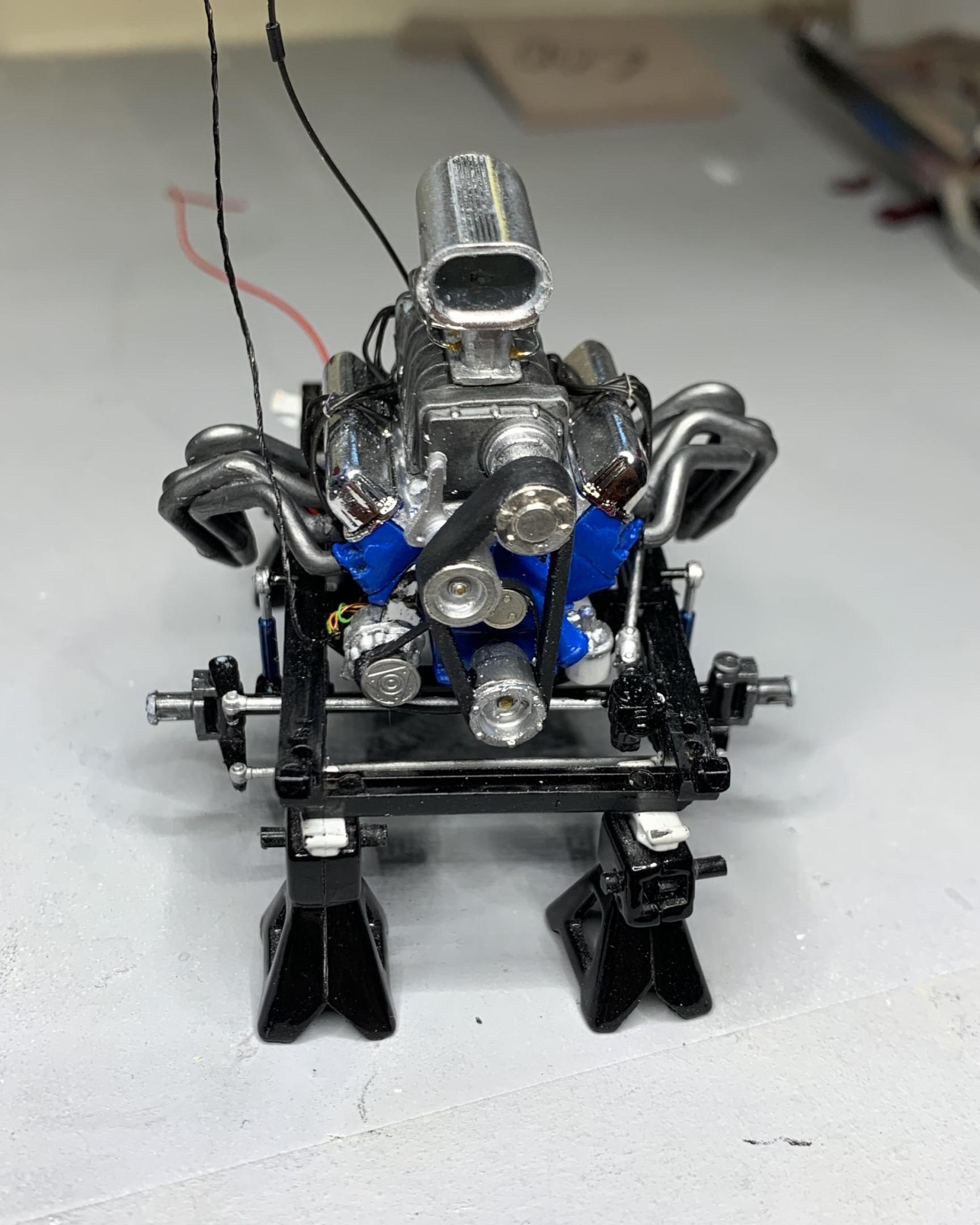

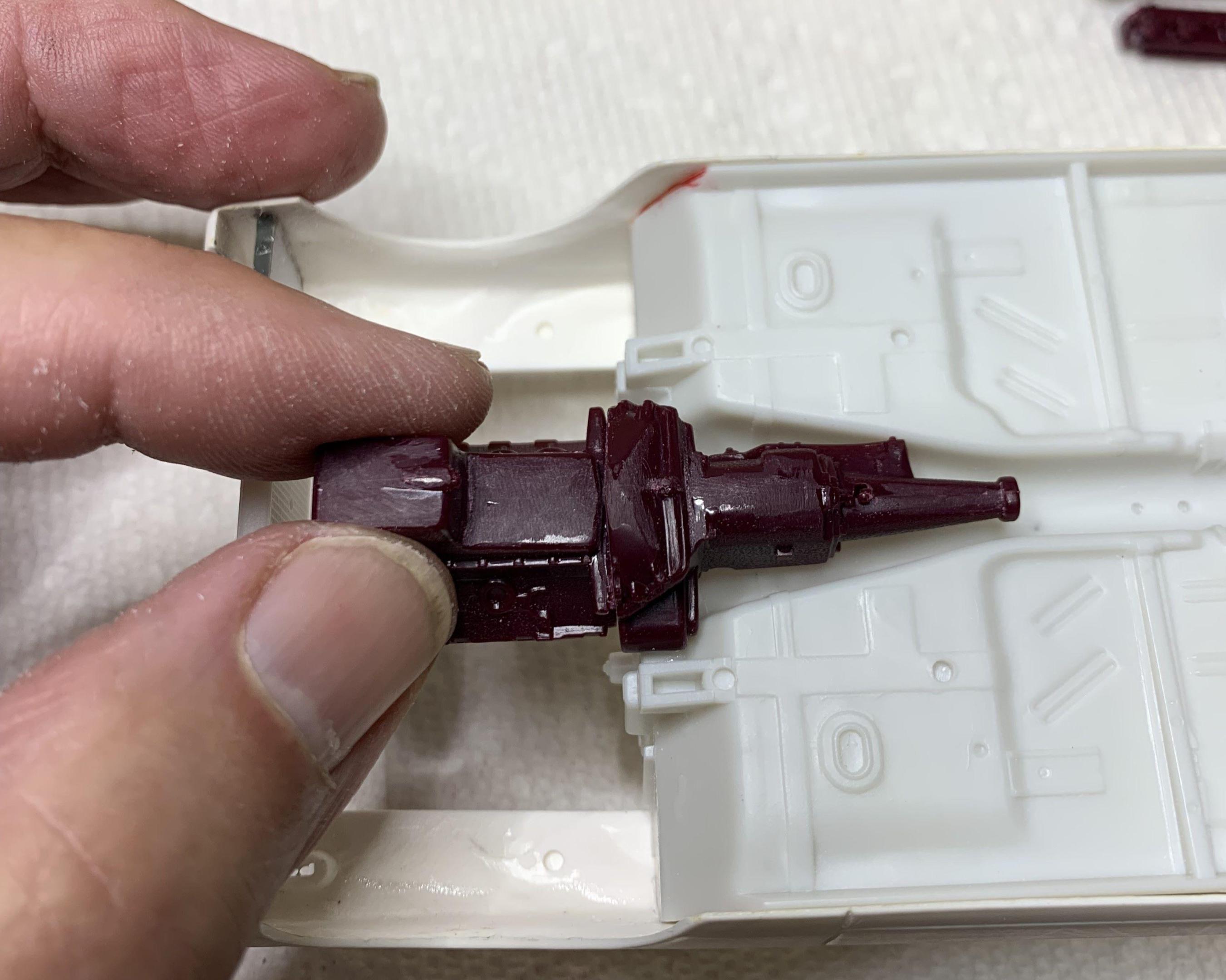

dino246gt Posted September 20, 2024 Author Posted September 20, 2024 I mocked up the front suspension, but I'll need a rear sump oil pan, so..........out came one of my favorite tools! With the oil pan modified and intake manifold sanded way down, I tried to fit the supercharger. Ford FE engine's distributor location just isn't good for the blower belt, at least in scale! Even the all chrome parts pack 427 moves the distributor to the rear, opposite side, when supercharging. So I added a blank off plate at the front and proceeded to relocate my dizzy to the rear, and wired it. 6

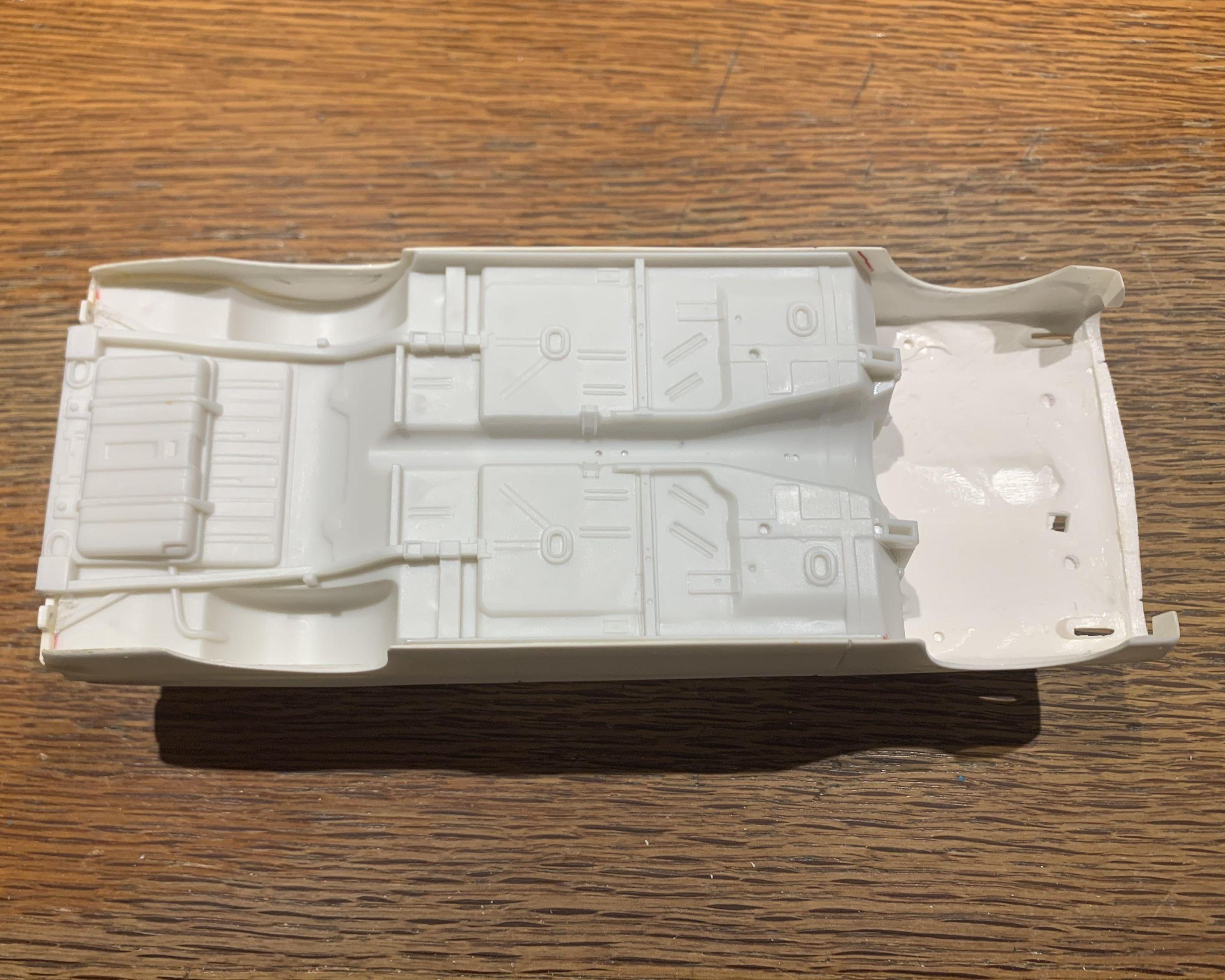

dino246gt Posted September 20, 2024 Author Posted September 20, 2024 Now I had to make up firewall mods to accommodate that big supercharged 427. Transmission tunnel also had to be enlarged and I had to make room for the 4-speed floor shift mechanism. 9

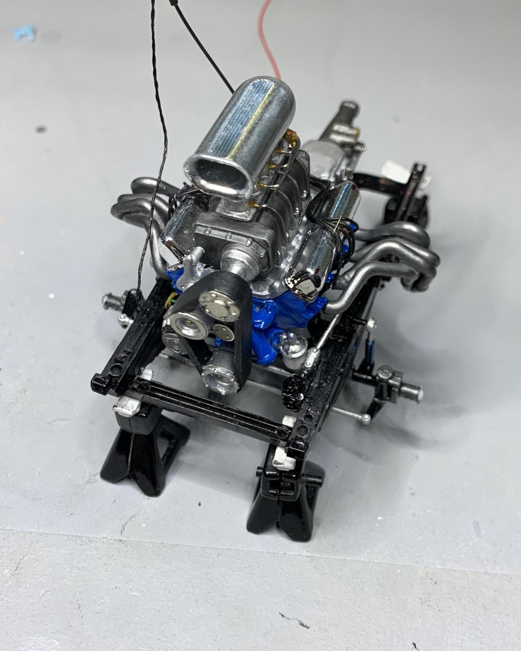

dino246gt Posted September 20, 2024 Author Posted September 20, 2024 (edited) I concentrated on the engine build, making mods along the way. Made up a second set of pulleys and a belt for an alternator mounted way down out of the way. I shortened the oil filter, removed the attached coil (I'll put it on the firewall later), modified the headers to fit the FE port spacing, added fuel lines to the injectors, etc. In that picture above, I see my alternator bracket isn't painted black yet, I forgot. I painted the inside black before I glued it on because I couldn't get a paint brush in there without touching the blue. Now I can easily reach the front with a tiny brush..........wait a minute..........okay, done! LOL Edited September 21, 2024 by dino246gt 12

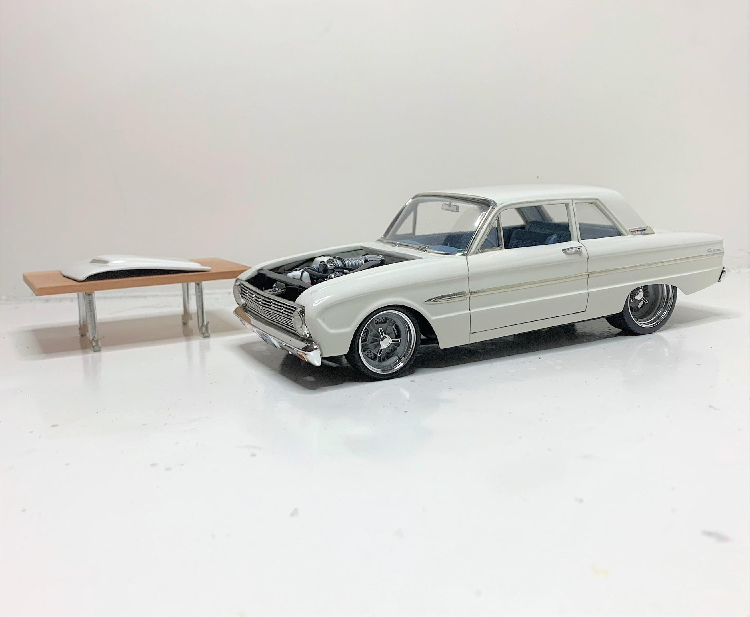

dino246gt Posted September 20, 2024 Author Posted September 20, 2024 2 hours ago, Zippi said: Killer project Dennis. I really dig the old 63 and 63 1/2 Ford Falcons and especially a Gasser. Thanks Zippi, I already did a '63, post car, but in a way more modern take, supercharged coyote and all modern suspension. Almost bought a real 63 and a half hardtop! I love those! This one though will be more old school, and although it's a '62, I have a 3D printed, see-through, '61 grille that I'll use. I'll also be making it back into a post car, previous customizer removed the B pillars! 12

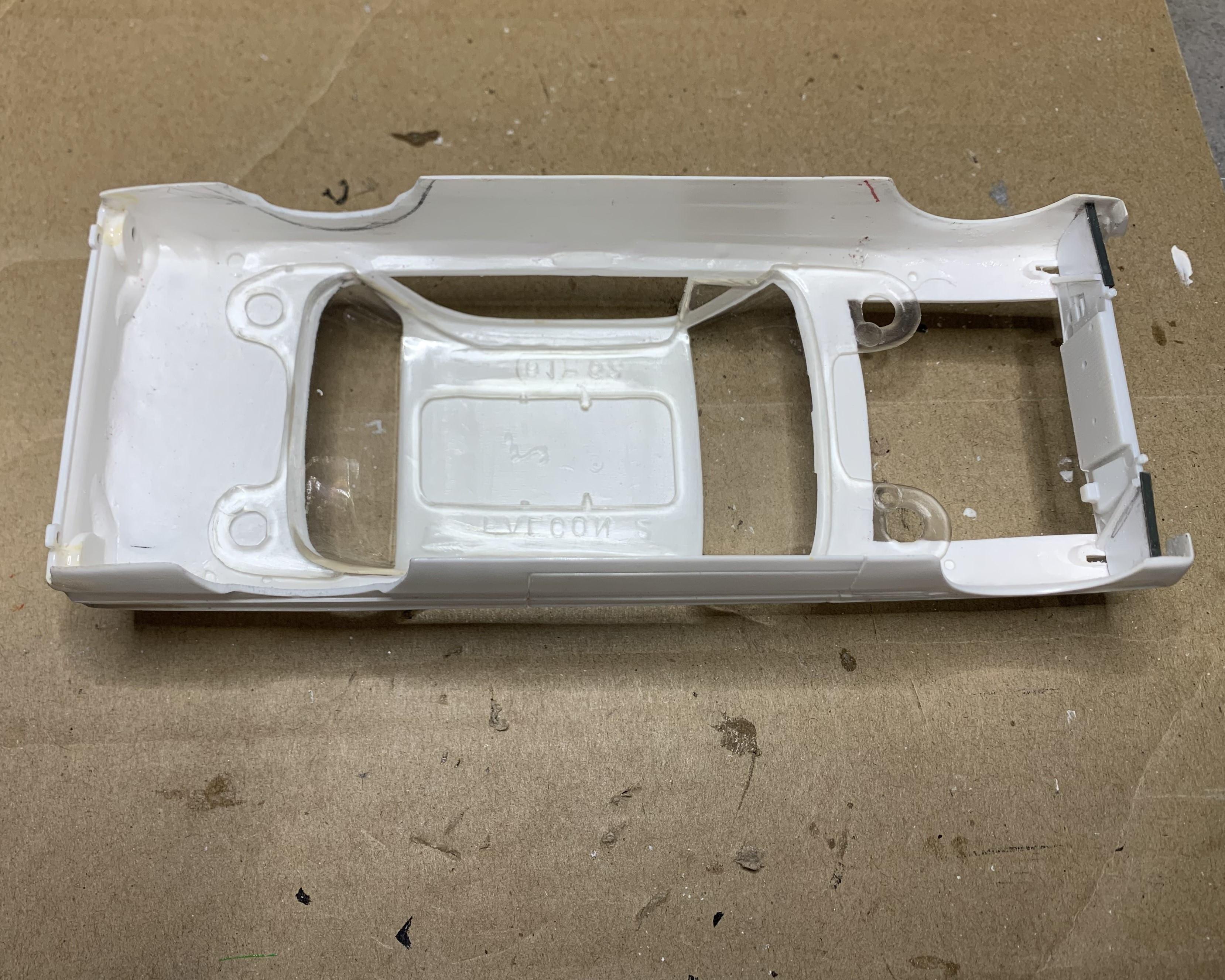

dino246gt Posted September 29, 2024 Author Posted September 29, 2024 I took the kit glass which doesn't include rear side windows, I'll make those, and cut it apart! I am going to put B pillars in but after I have the interior and glass fitted, those new B pillars will be fragile. 5

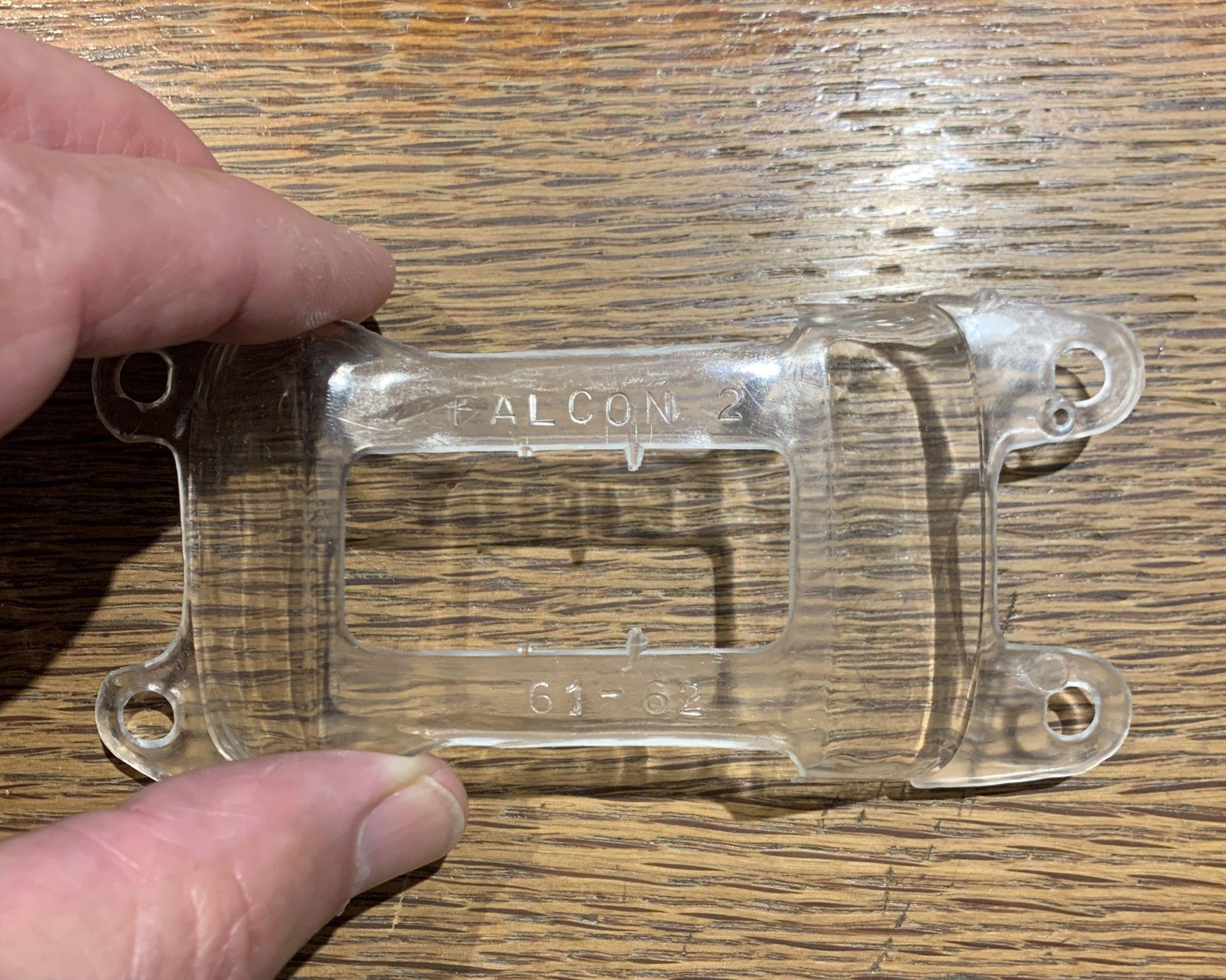

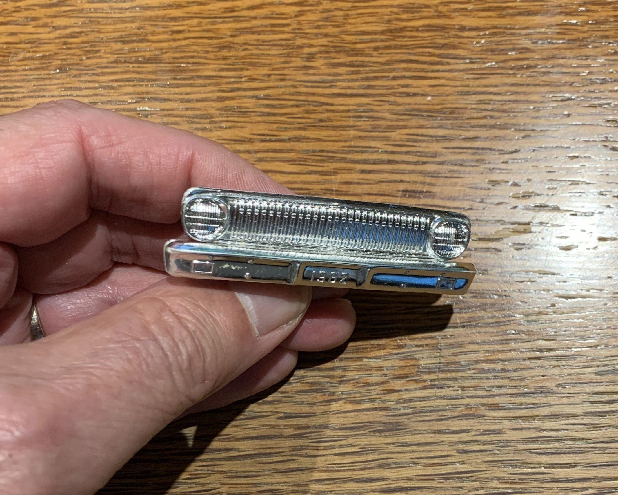

dino246gt Posted September 29, 2024 Author Posted September 29, 2024 I wanted to try and find a 3D printed grille that was see through, but so far I haven't. So, I did this to the kit grille. I drilled out those horrible chrome headlights, chromed the buckets with Revell spray, then added clear lenses. I tried some black panel wash, not sure I like it, but it's way better than the one piece unit AMT provided. I won't have a front bumper, but I'll have to scratch build the sheet metal behind it. 7
