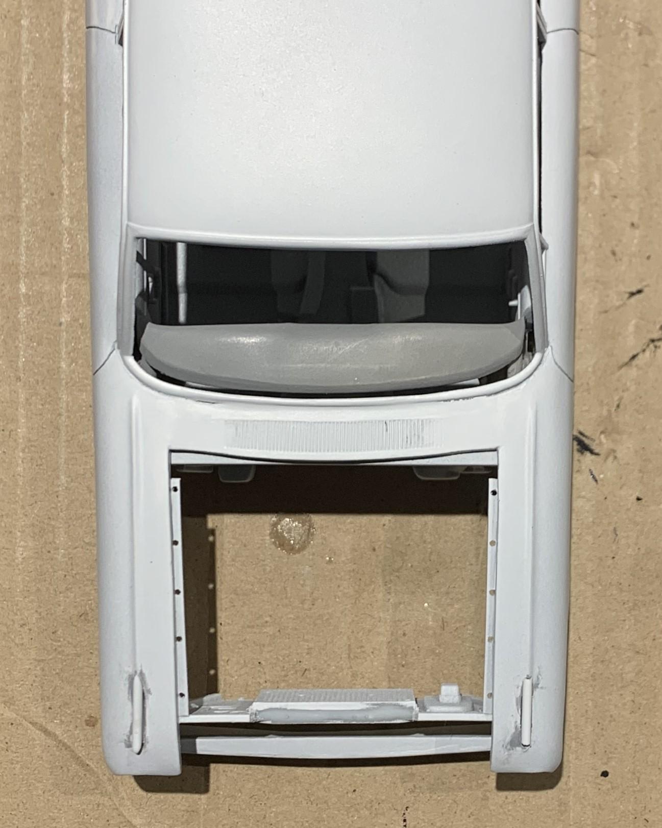

dino246gt Posted October 22, 2024 Author Posted October 22, 2024 (edited) On 10/3/2024 at 8:44 PM, Maindrian Pace said: You just need to smooth the inside of the curve next to the taillight bezel tapering down so it's flush with the rear panel at the bottom. Tops of the curve remain untouched. Easy mod. Mike, now that I've finished my '32 sedan, I'm getting back to the Falcon and I agree I must make the mods you suggested. Any tips before I start on that rear bodywork? Thanks Edited October 22, 2024 by dino246gt

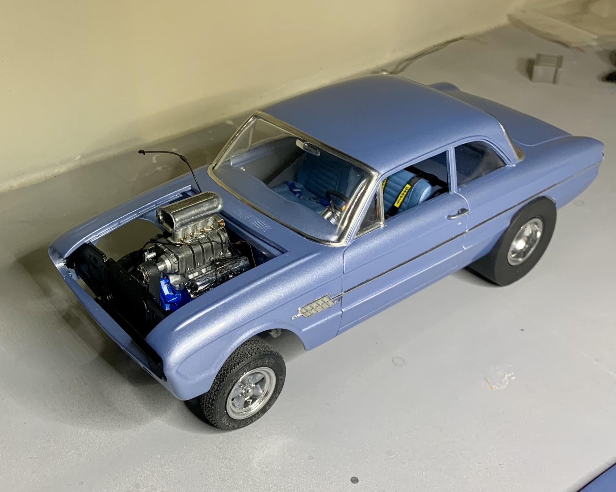

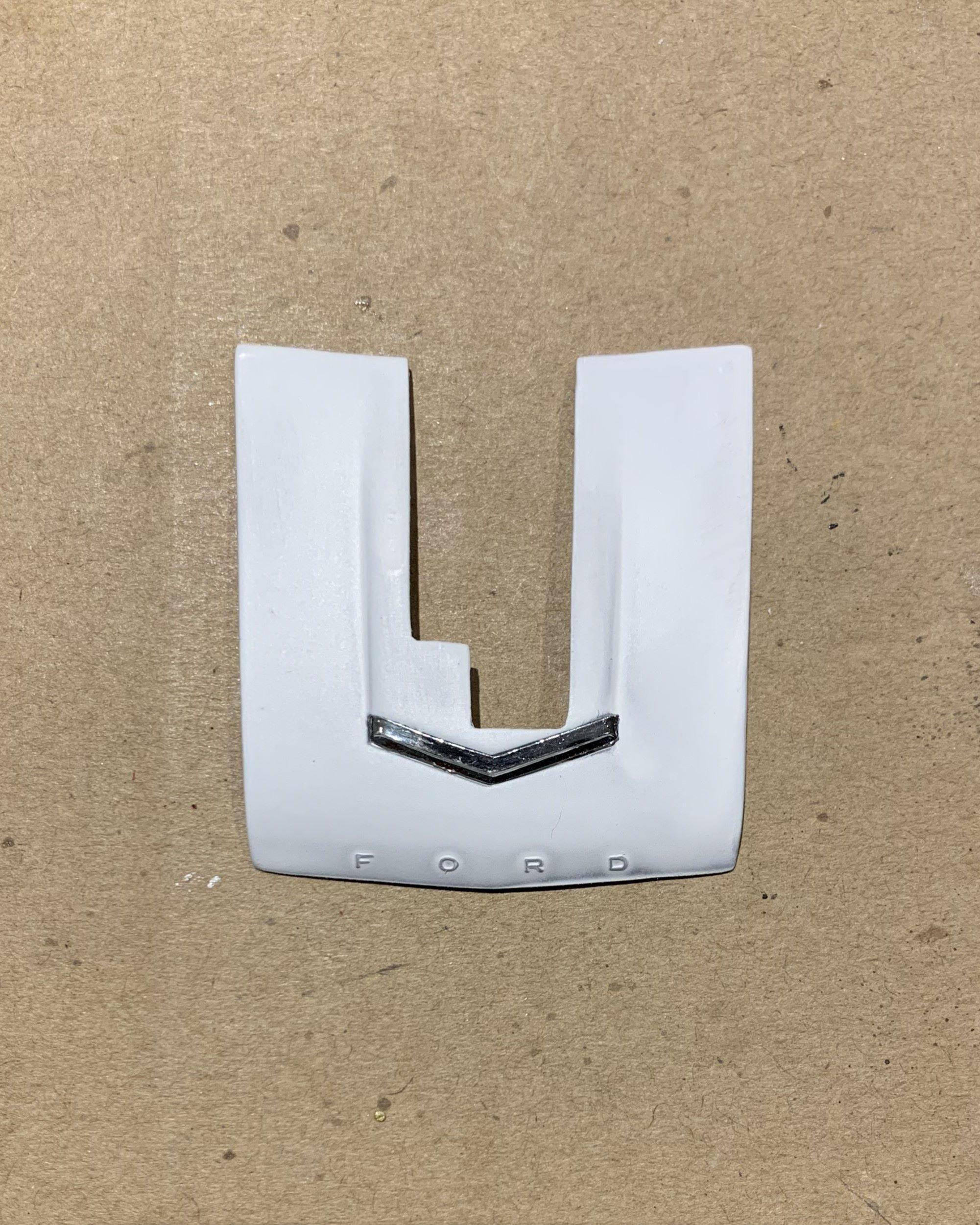

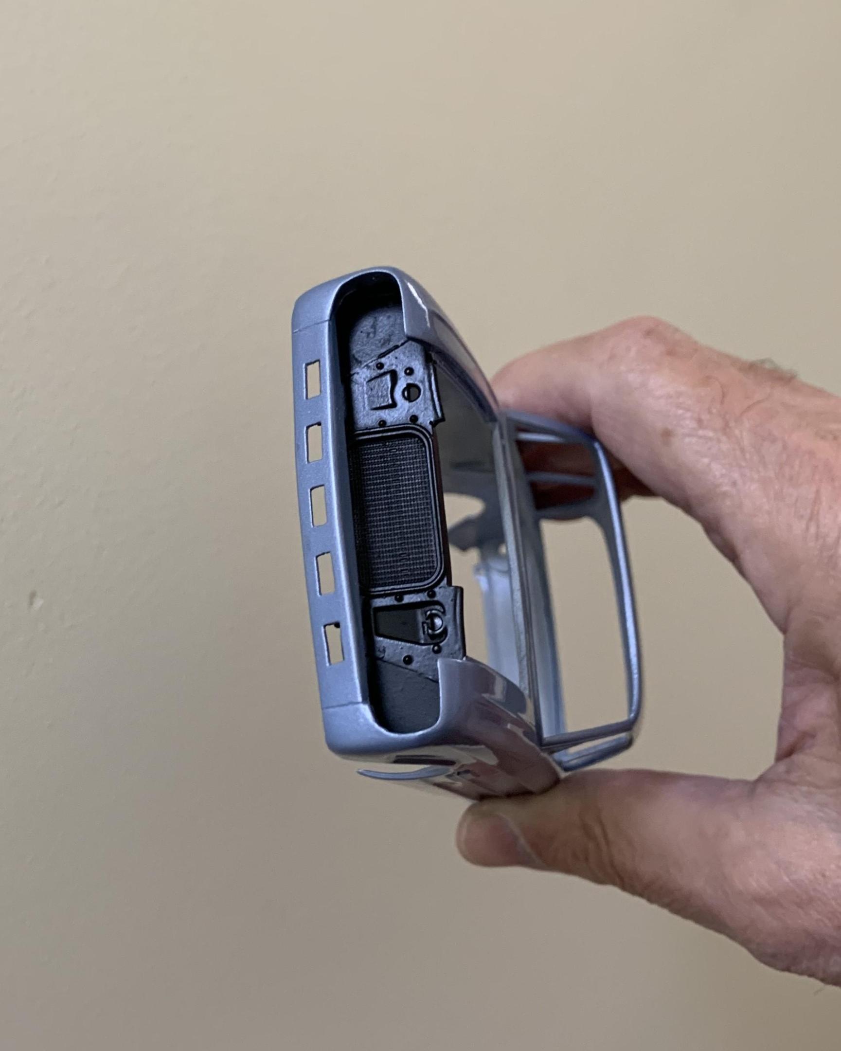

dino246gt Posted October 22, 2024 Author Posted October 22, 2024 With the hood opened up to clear the blower drive, there's not much left between that and the chrome insert. So I decided to blank it off, and those fender ornaments, they were missing, and because I eliminated the chrome hood insert, I decided to fill those in as well. Still need tweaking but I'm liking the look of less chrome. I do want to try and keep the "62 only" side chrome though. 6
Maindrian Pace Posted October 22, 2024 Posted October 22, 2024 2 hours ago, dino246gt said: Mike, now that I've finished my '32 sedan, I'm getting back to the Falcon and I agree I must make the mods you suggested. Any tips before I start on that rear bodywork? Thanks Yes, In addition to tapering those brows down to flush at the bottom, I'd also suggest scribing the panel lines inside of the taillights that separate the 1/4 panels from the rear panel. (circled) It's a light line on the real cars, but it's there and adds to realism. The car's looking great. 4

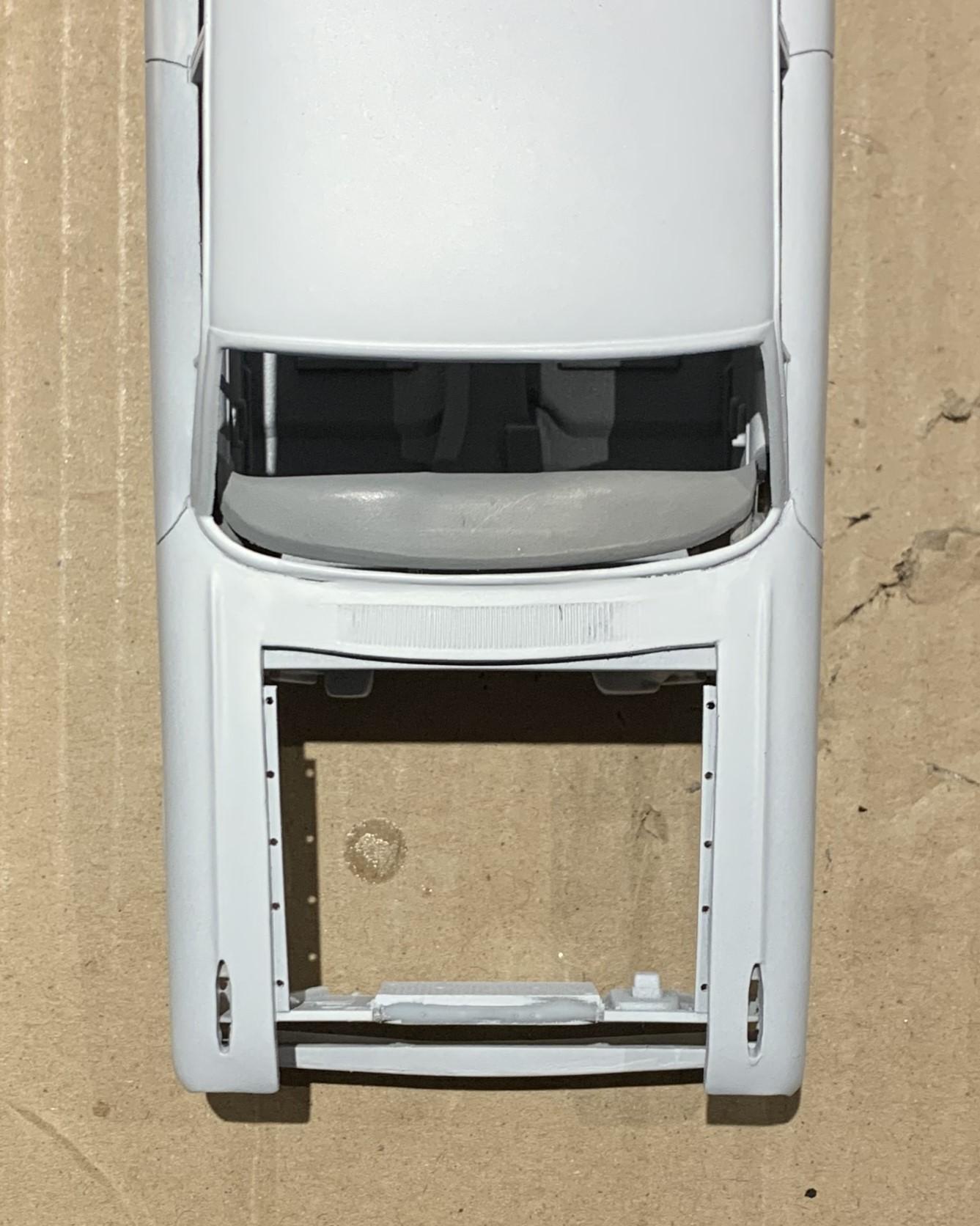

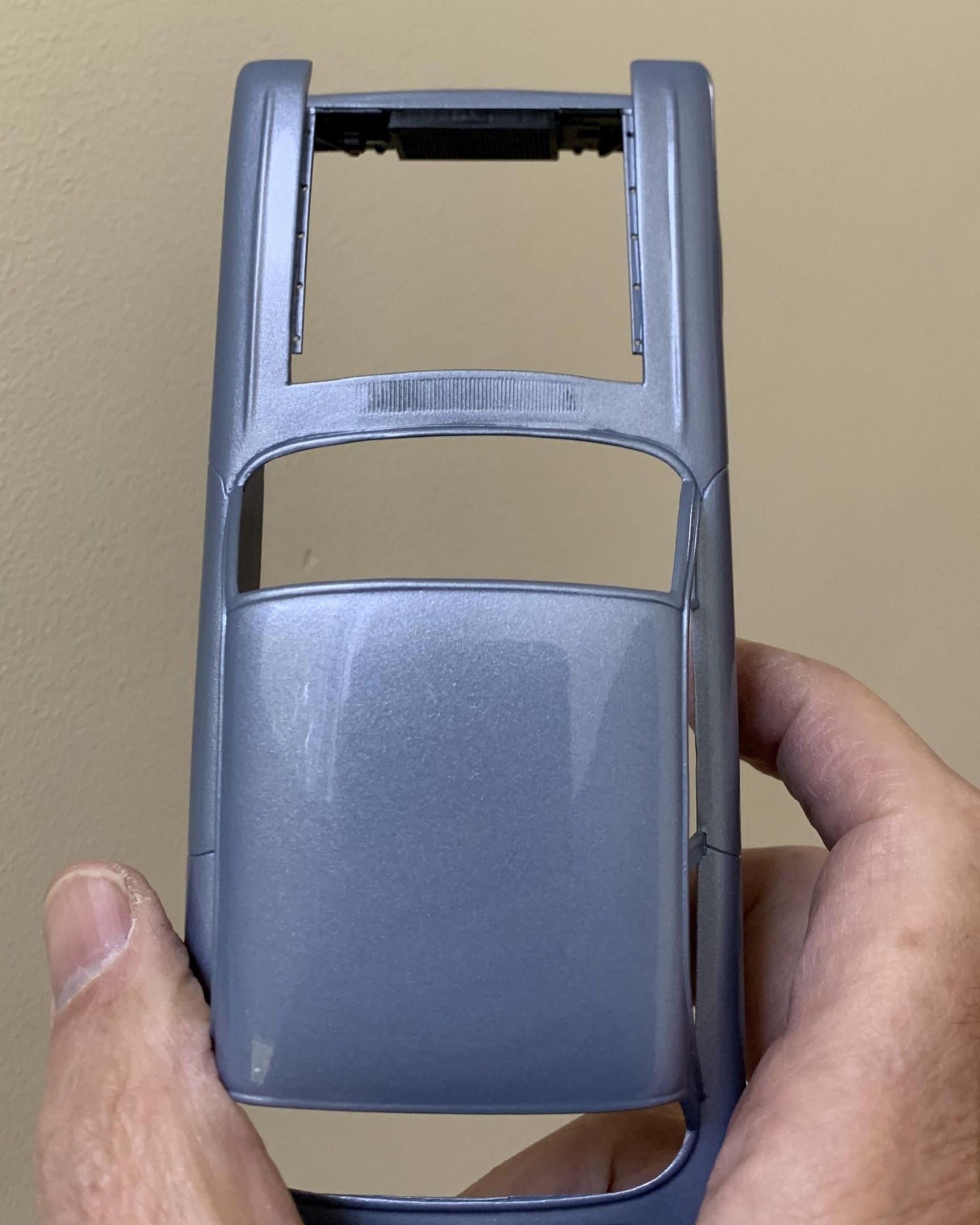

dino246gt Posted November 4, 2024 Author Posted November 4, 2024 Okay, so it wasn't that easy, but it sure is essential, the difference is noticeable. It looks like a '62 or '63, not a '60 or '61. I went with a factory color, Acapulco Blue Poly, but nothing else is factory correct! 6

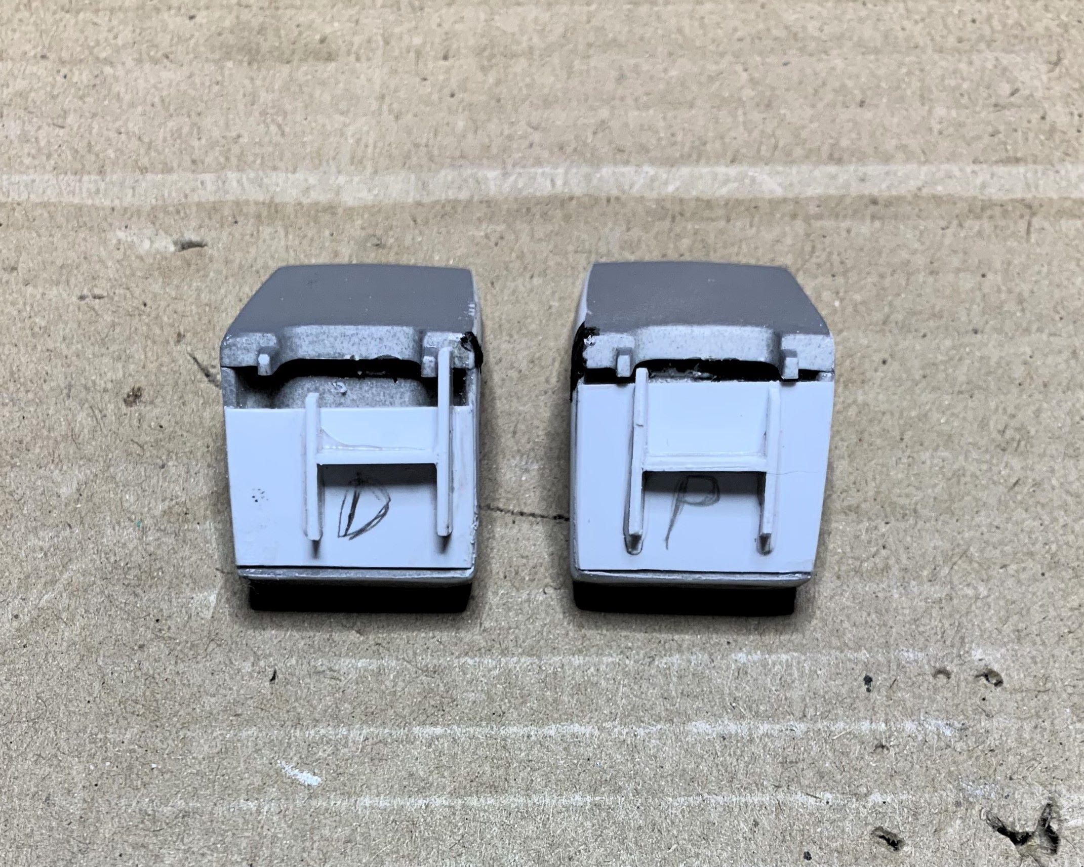

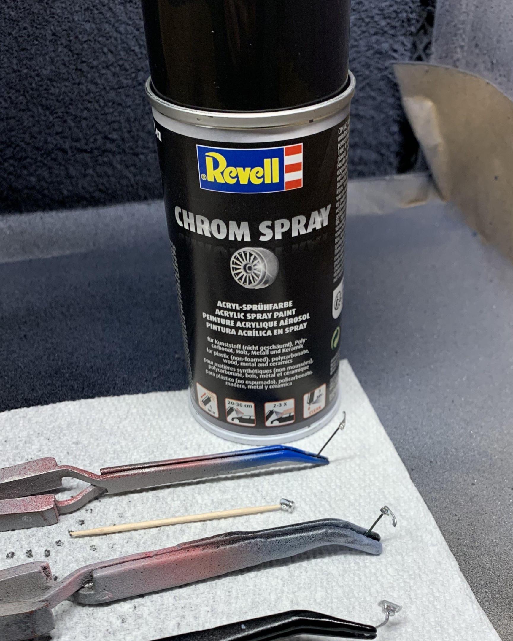

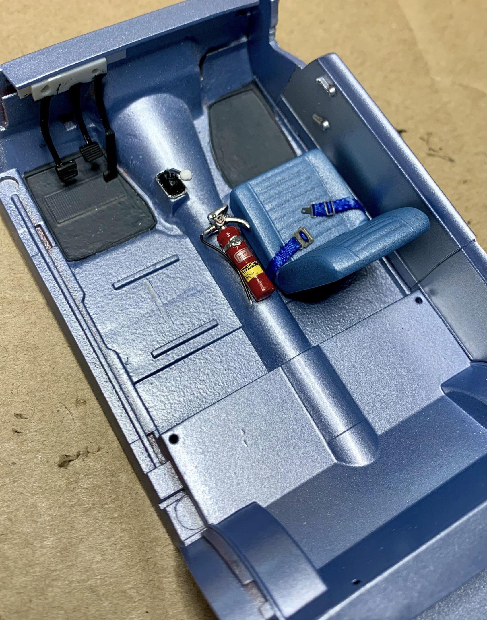

dino246gt Posted November 4, 2024 Author Posted November 4, 2024 I made a plate for the floor shifter, drilled some parts box door handles and glued wire in them, cleaned up a fire extinguisher, drilled out a column mount tach, and sprayed them all chrome. 4
dino246gt Posted November 4, 2024 Author Posted November 4, 2024 (edited) I did some re-shaping of the '64 Fairlane bucket seats and made stands to raise them slightly off the floor. Edited November 5, 2024 by dino246gt 4

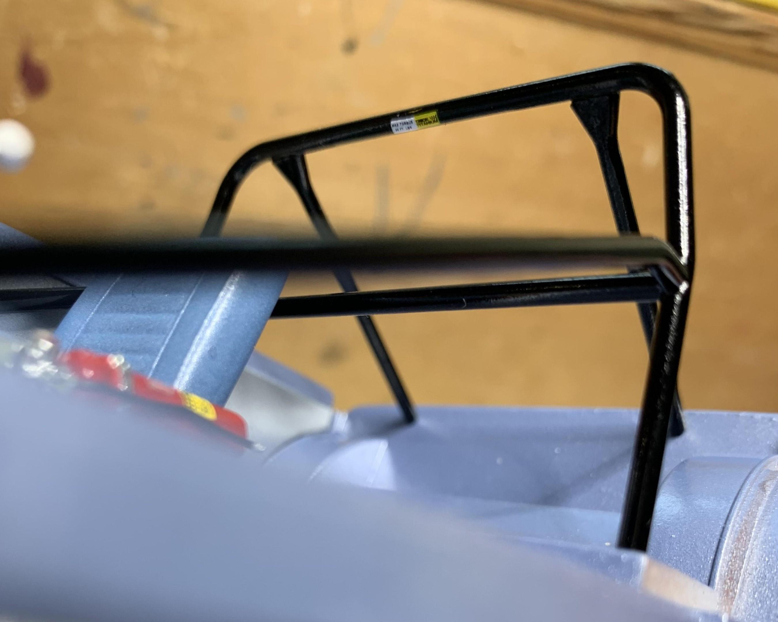

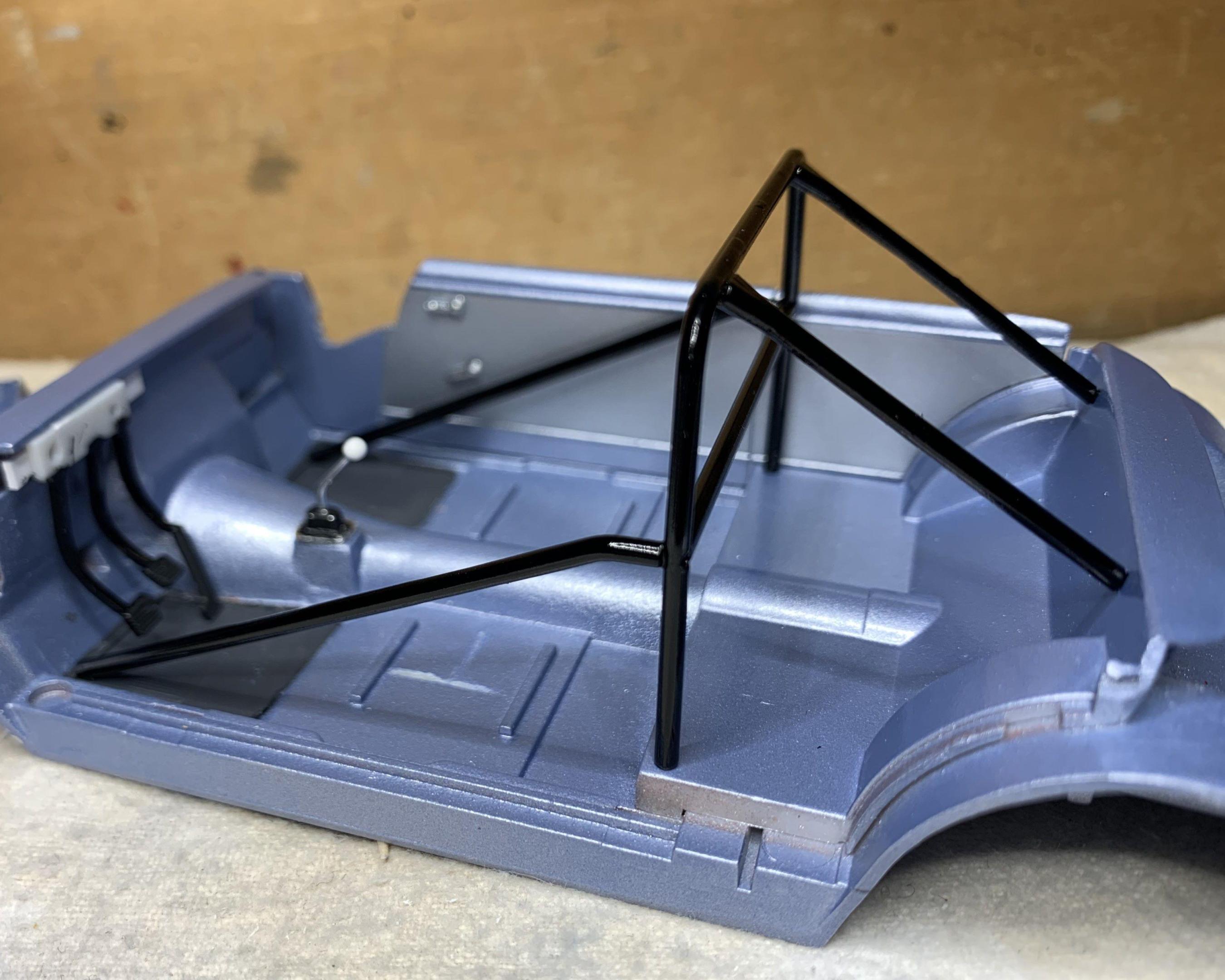

dino246gt Posted November 4, 2024 Author Posted November 4, 2024 I fitted pedals, the shifter and a roll cage from the Mobius Nova gasser kit. Fire extinguisher detailed and installed. Passenger seat has Ford lap belts, driver's seat will have black racing harness. I added a decal to the upper roll bar that will probably not be seen! 6

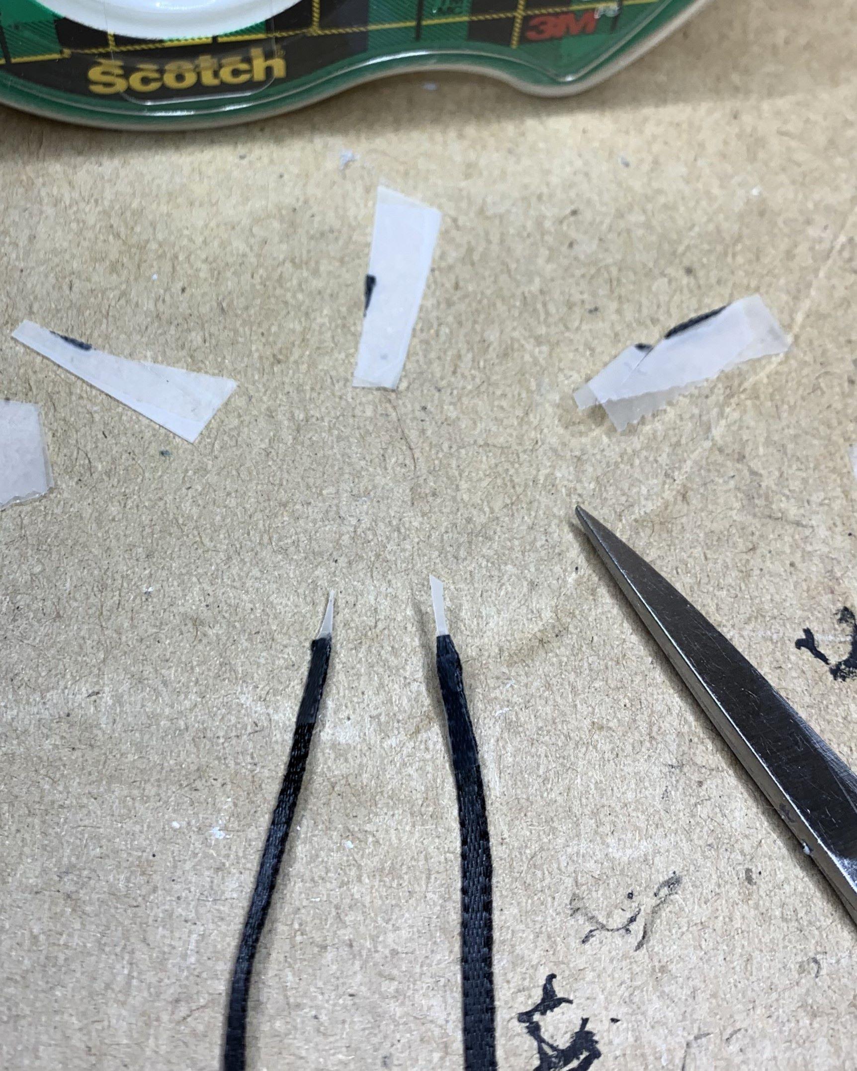

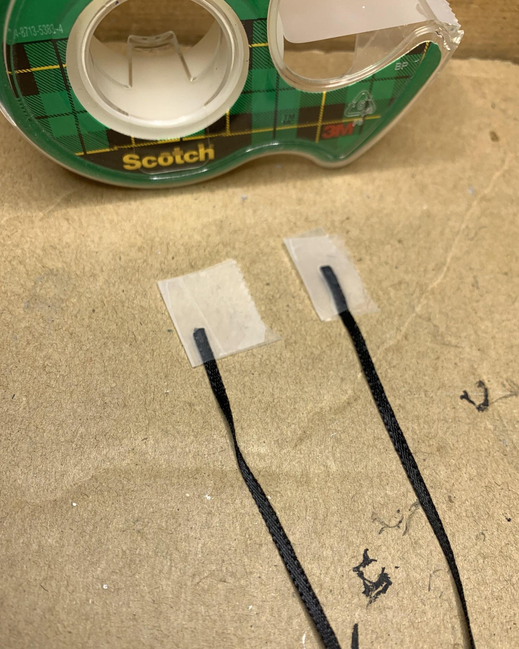

dino246gt Posted November 6, 2024 Author Posted November 6, 2024 TIP: This is how I make using photo-etch seatbelt hardware much easier to use. I put tape over the end, then cut leaving a tape pointed end. Now it's easy to push in and pull through, without all the hassle of the ribbon coming unfrayed and hanging up part way in. 3

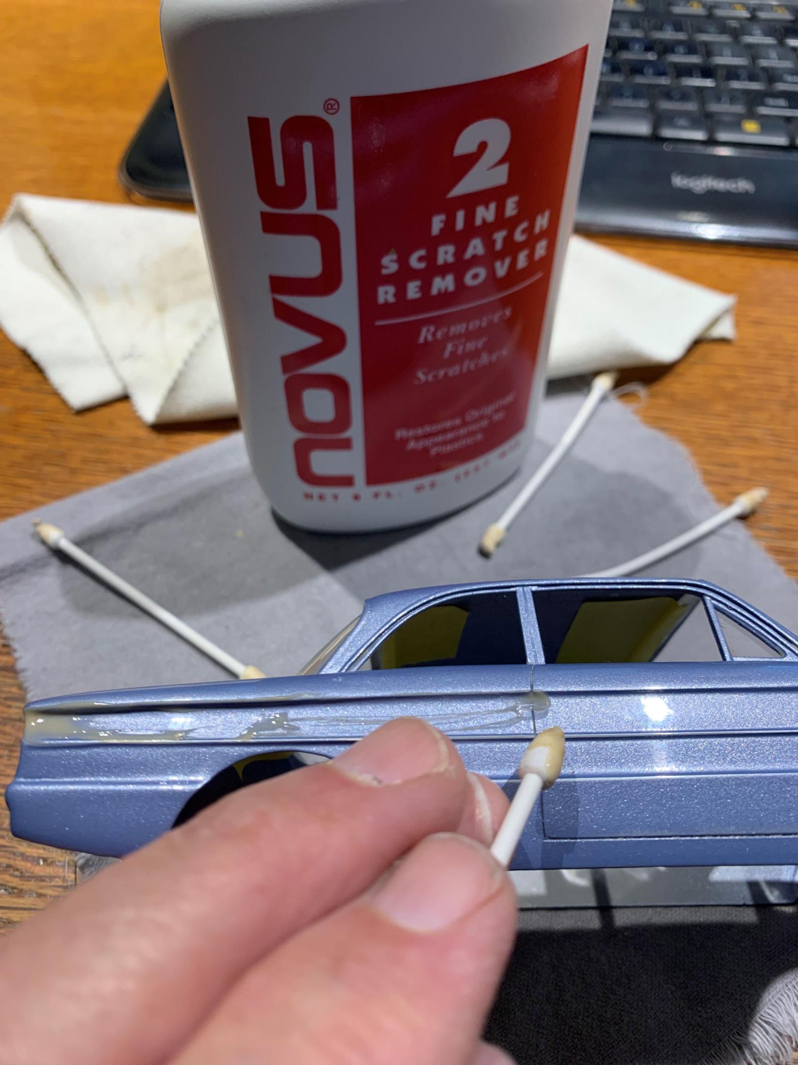

dino246gt Posted November 6, 2024 Author Posted November 6, 2024 Got the body polished out using Novus 2: 3

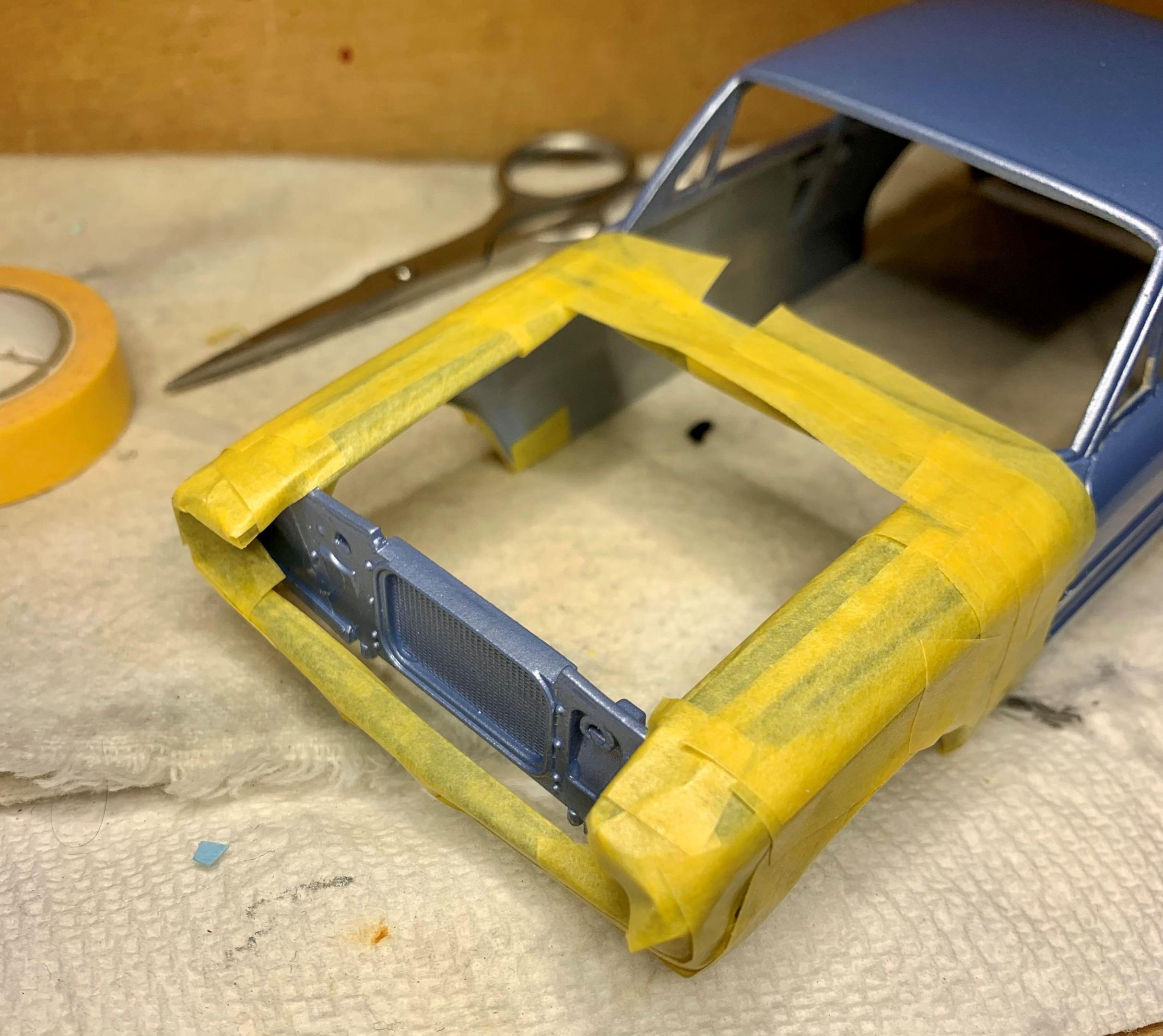

dino246gt Posted November 6, 2024 Author Posted November 6, 2024 45 minutes of masking for 45 seconds of airbrushing! 6
