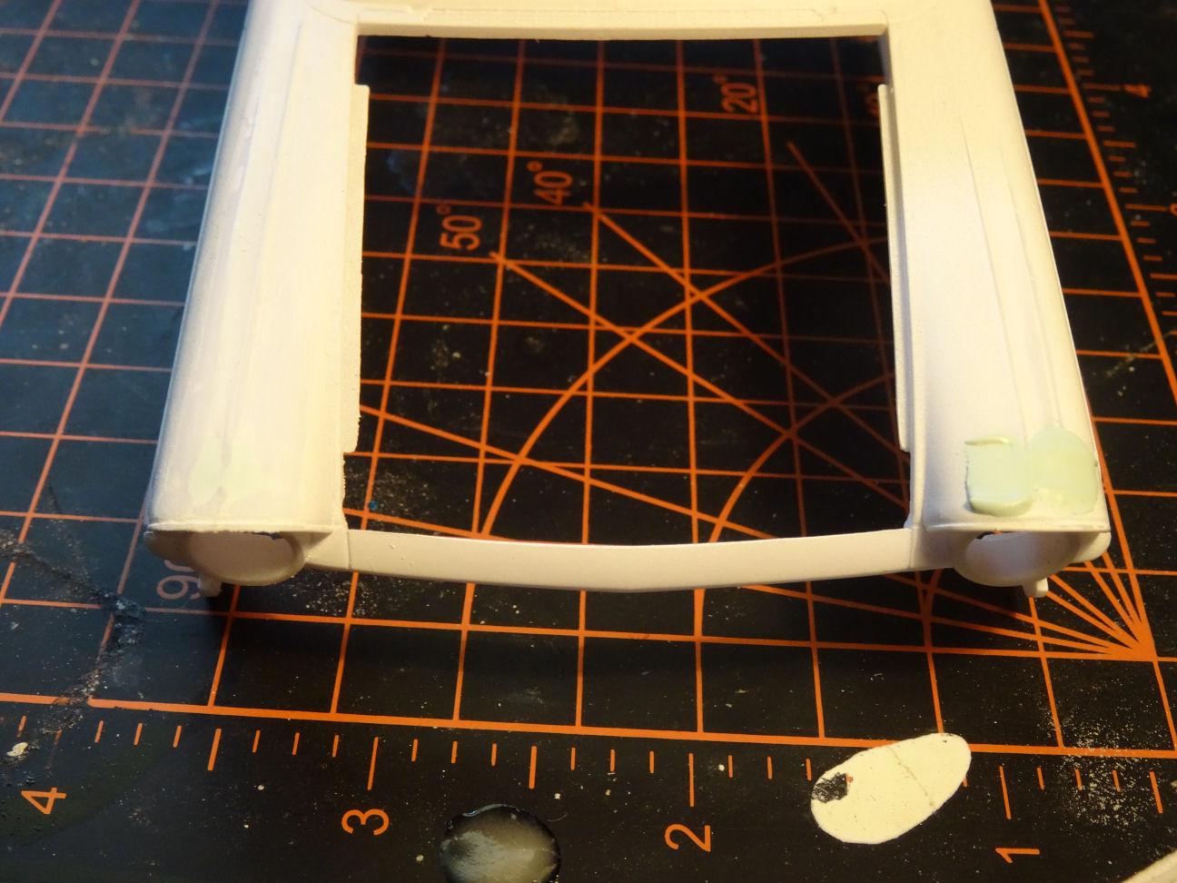

While I haven't posted anything about the Del Rio Wagon in a while work has been going on in the background which basically has been planning and buying parts.
The sink marks on the top front of the fenders have been rectified. Although hard to see in the pictures.

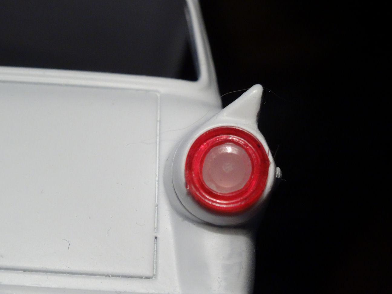

Next was trying to sort out the taillights. The real McCoy has 61 Ford Starliner taillights but that's not what I'm going with. For decades (yes you heard me right) I've had this little taillight floating around on my desk/workbench. Anyone know what it's from.  Hint, it's AMT early 60's
I decided I was going to use this instead but with a twist. I made a mold of the taillight and cast the outer chrome ring in translucent red and the center taillight section is white.
And this is how it looks on the wagon.

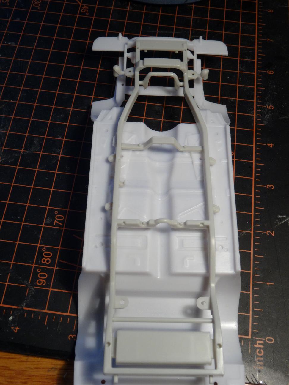

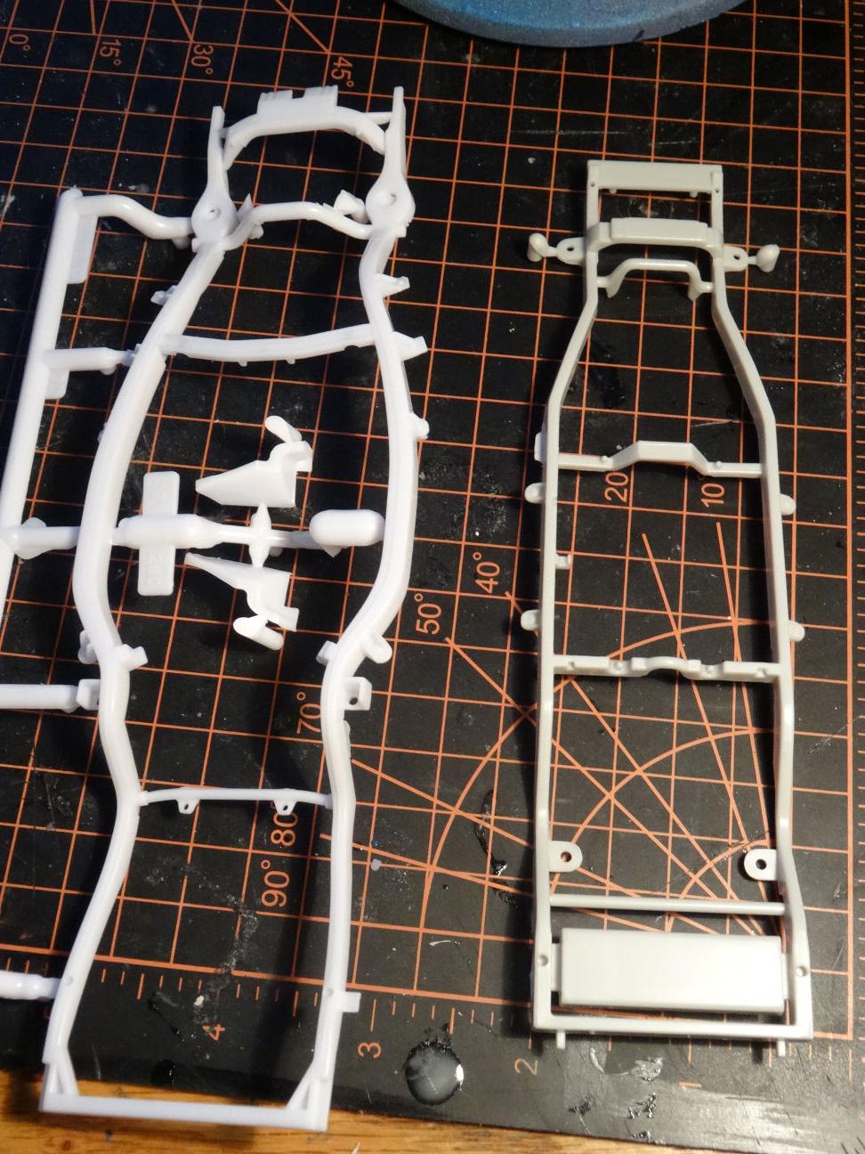

Chassis on the 1:1 is an Art Morrison. This is going to need a bit of work as well. Picked up an AMT 39 Wagon Rod which comes with an Art Morrison chassis. That is the one on the right with the Del Rio chassis on the left.
The AM chassis is narrower overall so as it stands it clearly doesn't fit the Rio.
Not sure yet if I'm going to just use the front and rear of the chassis and fabricate new rails for the center. Or if I should just start from scratch and make the whole chassis and just add the front and rear suspension. Or adapt the suspension to the stock chassis. Jury is still out at the moment and they just ordered dinner for the night, it doesn't look like it will be a quick decision.
DSC01438.jpg.3d740d6e2bac58aa563a3d379c1f465a.jpgDSC01440.jpg.b12eba78073c25c21c323e2b3992d1fe.jpg

Been wondering what had happened to this build. The front and rear "clips" from the AM chassis may be one idea.
