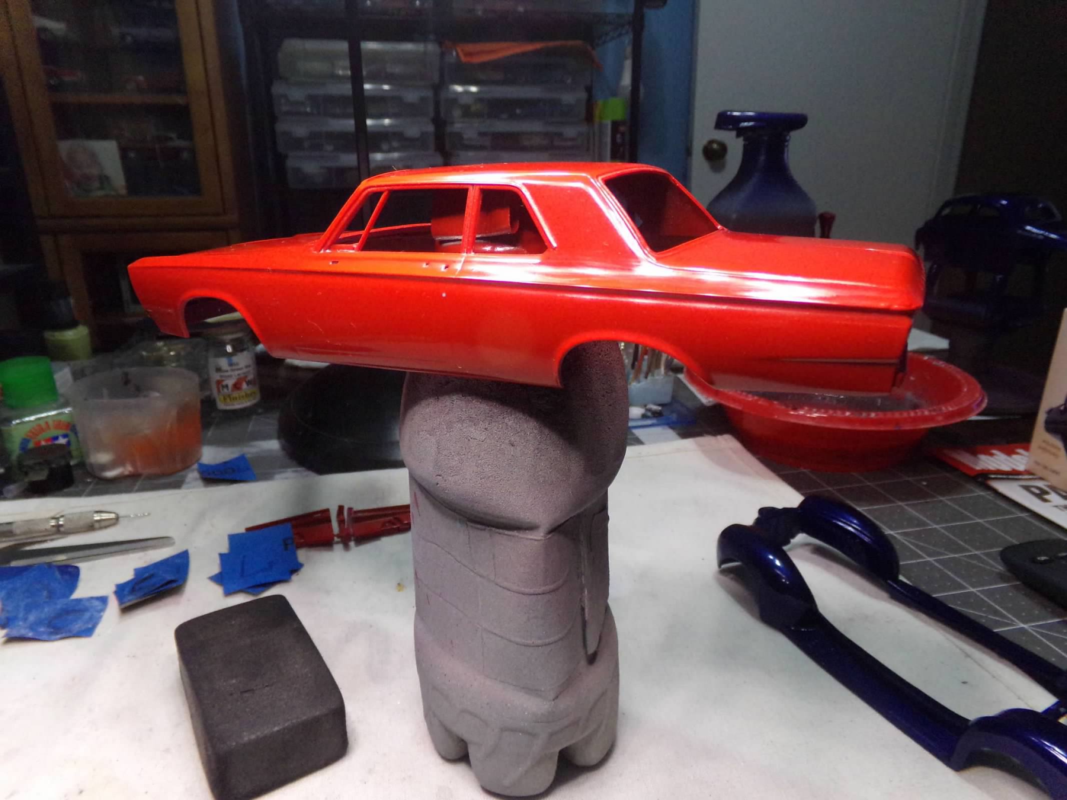

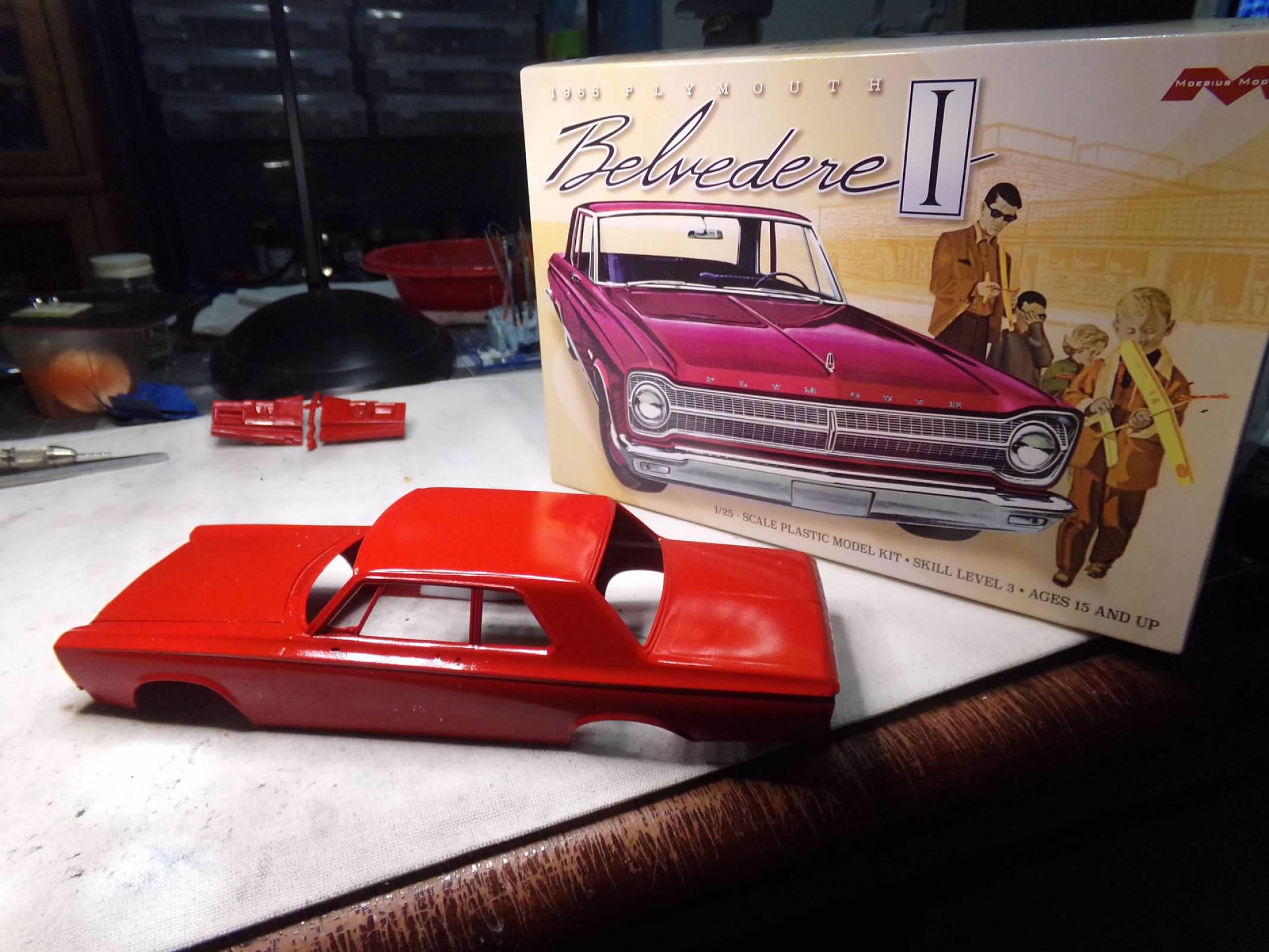

I am starting this Moebius kit by first painting the body and related parts. I used a dark gray primer under the Dupli=Color Bright Red for the body in order to get a darker red that might be considered Medium Red or even stretch to Ruby Red. In any event, I think it looks pretty good so I'll rub it out tomorrow. In the meantime, since the weather is nice here, I am going to get some more bodies painted.

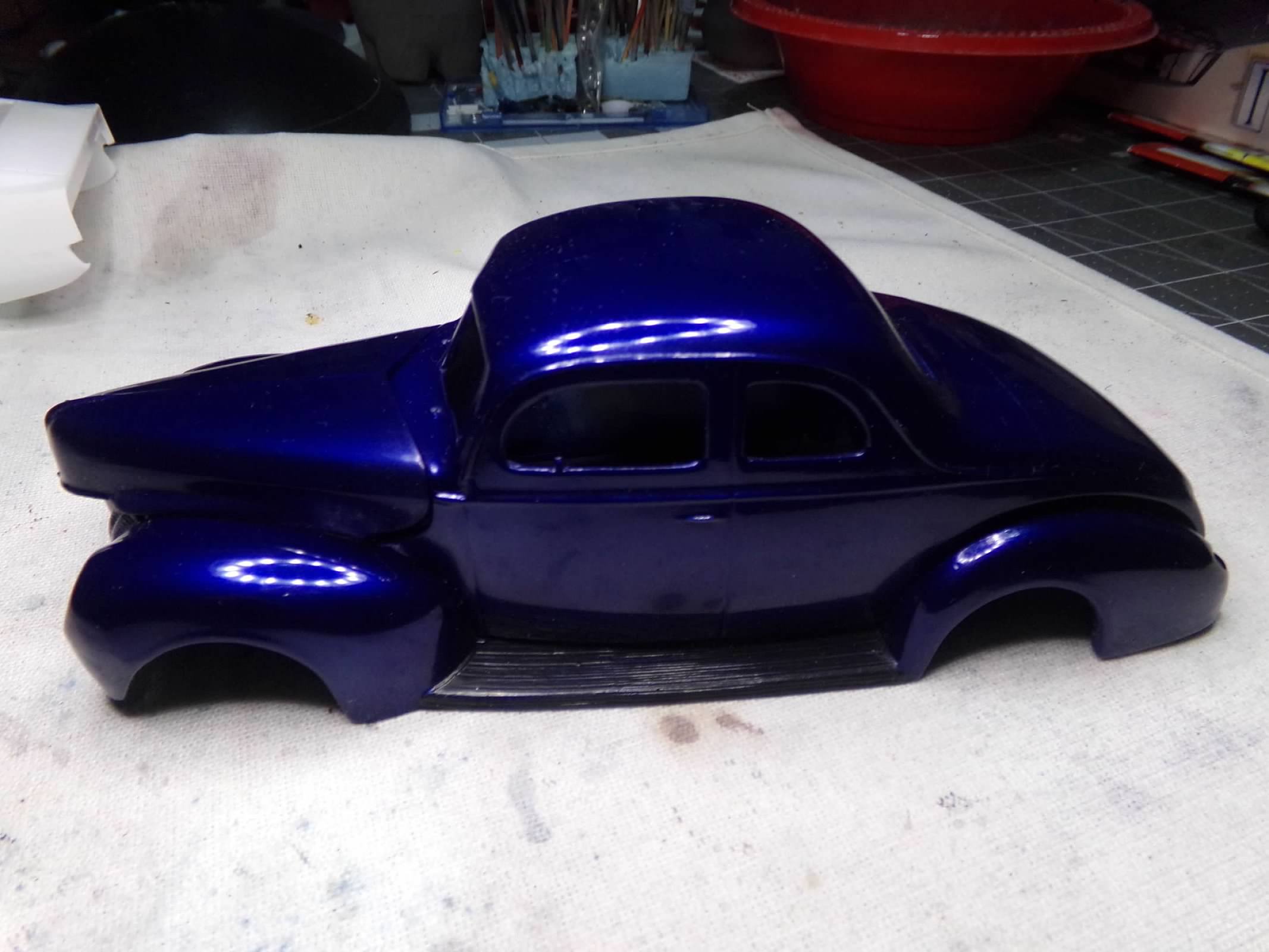

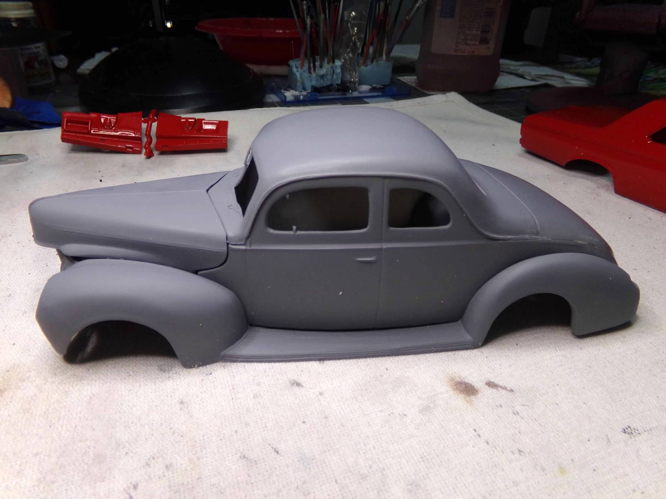

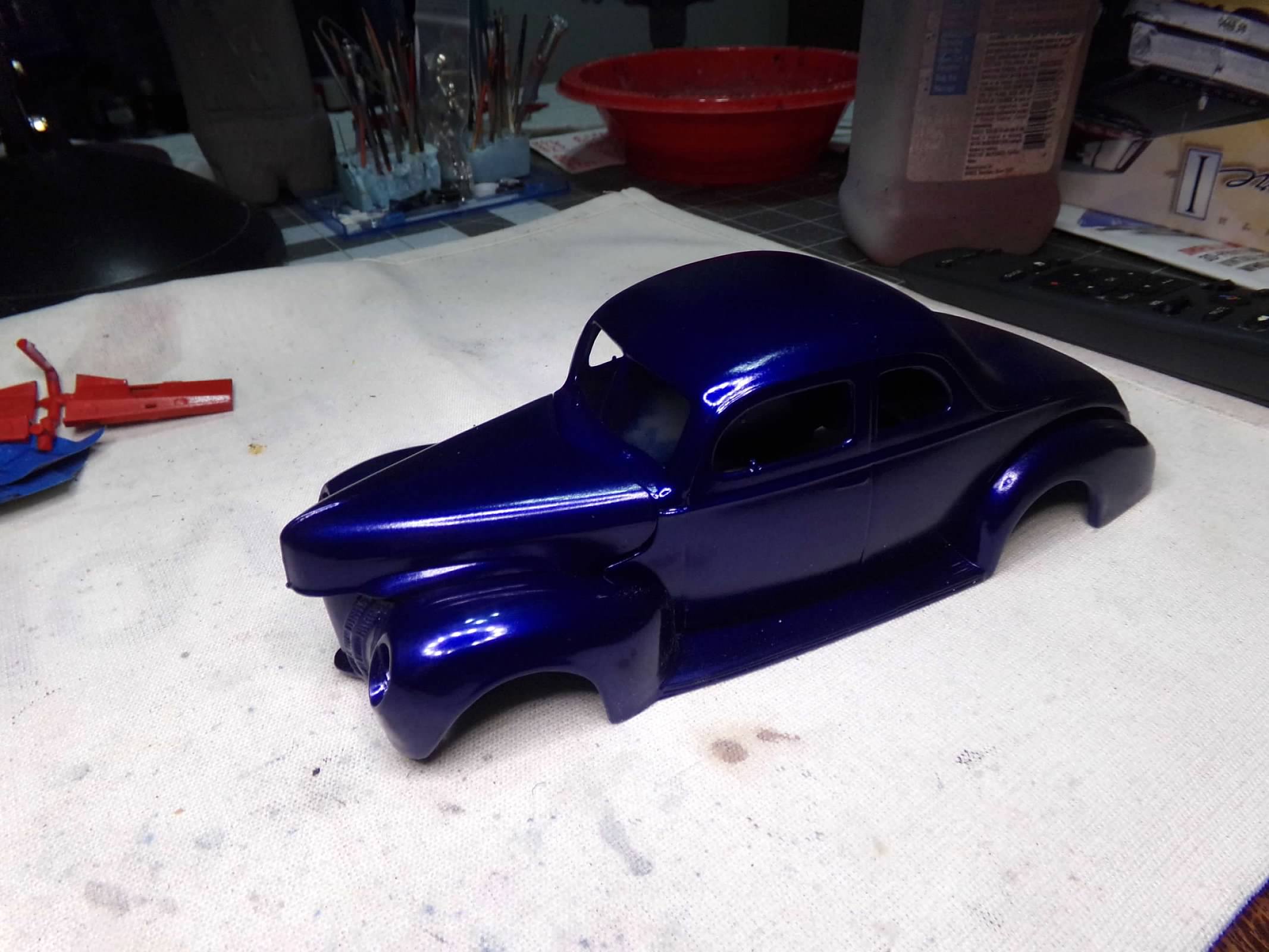

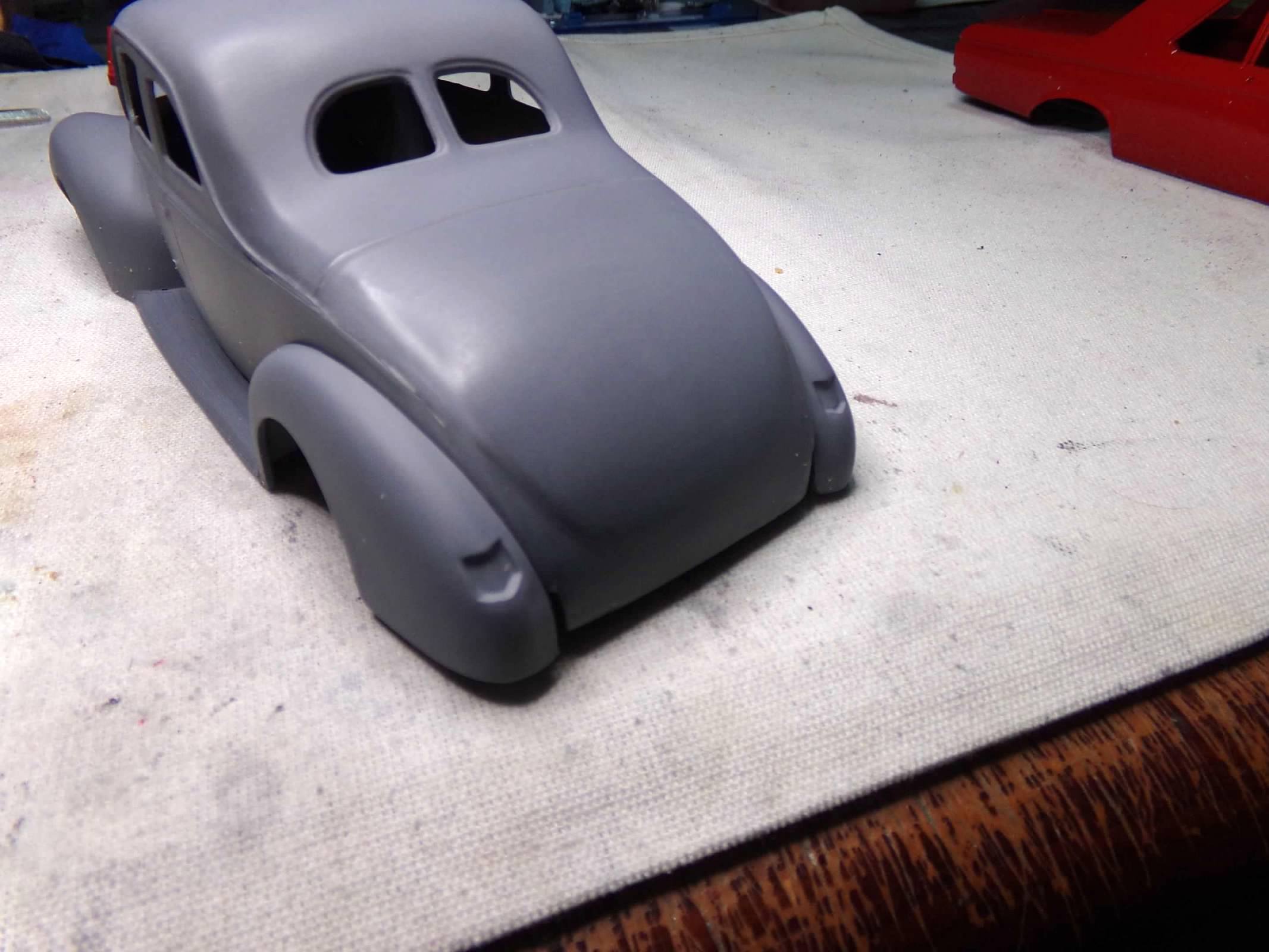

Here's one that needed a lot of prep work on the body - lots of flash and a nasty mold line on the both sides of the trunk, along the trim line tapering off at the rear of the trunk. Its a WalMart "Blue Light Special" from years ago with the Dodge L-700 truck and trailer. I'll paint it with my new favorite color tomorrow, Dupli-Color Royal Blue. I need to get some bodies painted while the weather is good to get ready for winter. Thanks for looking! ?

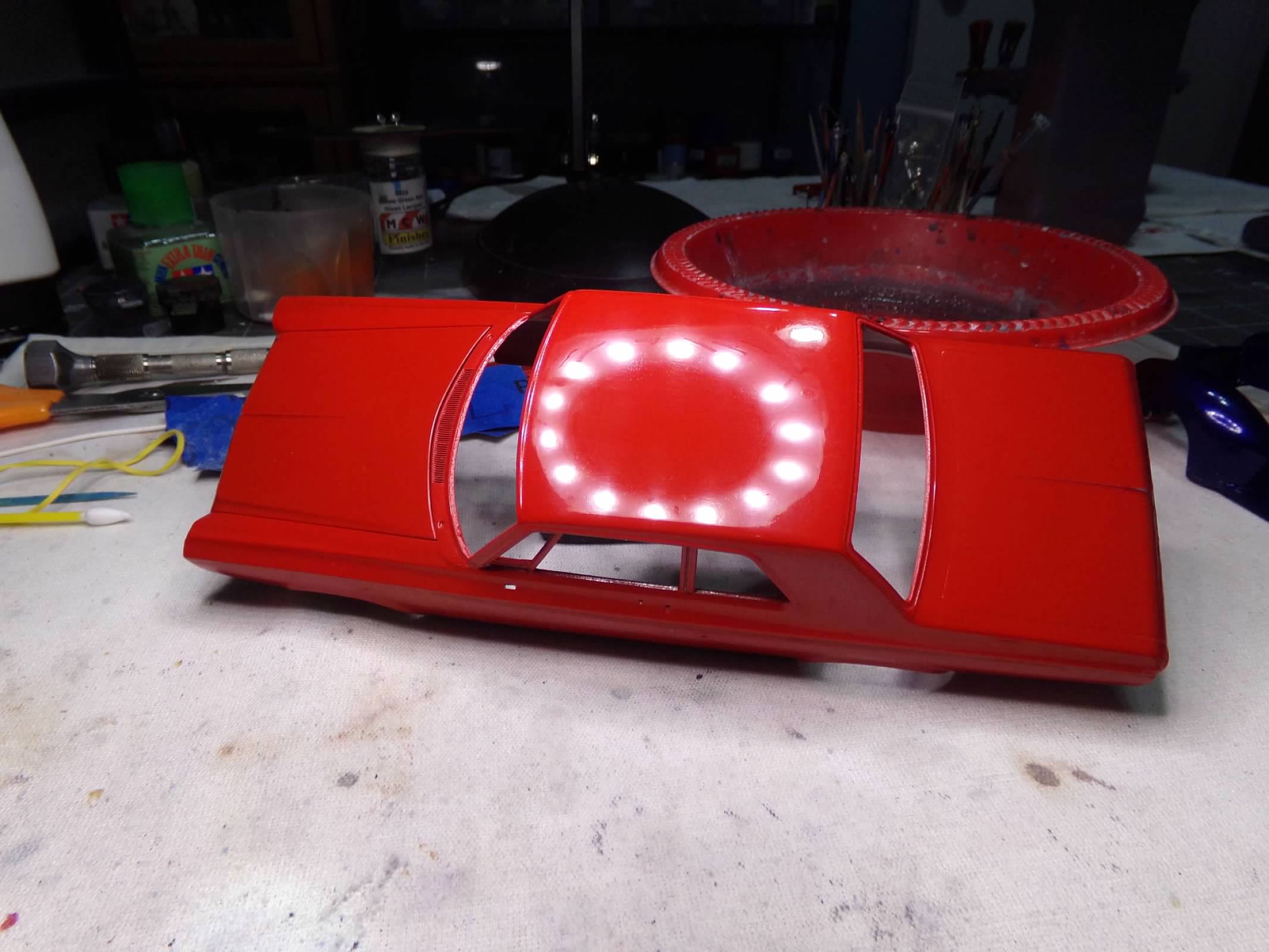

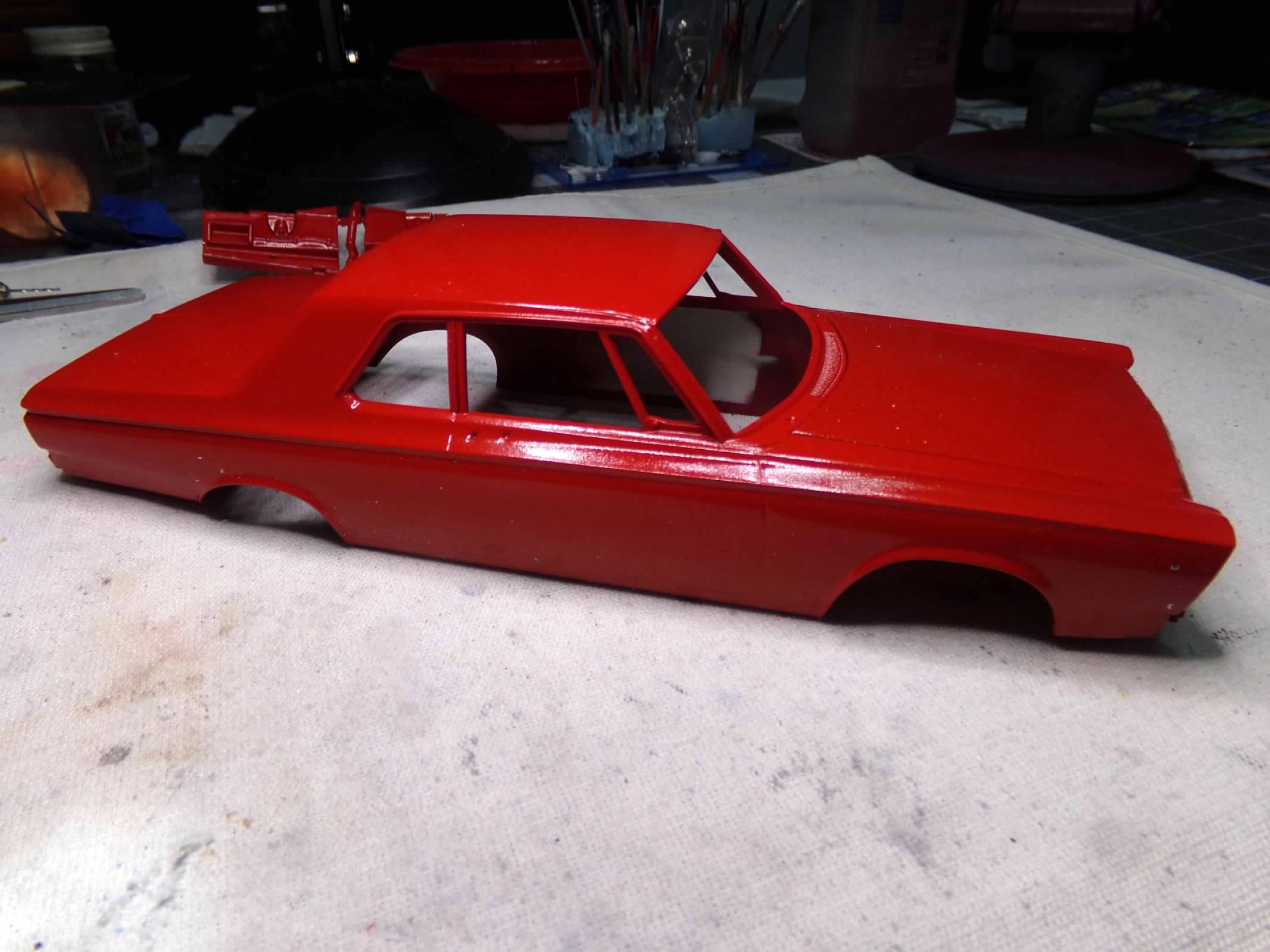

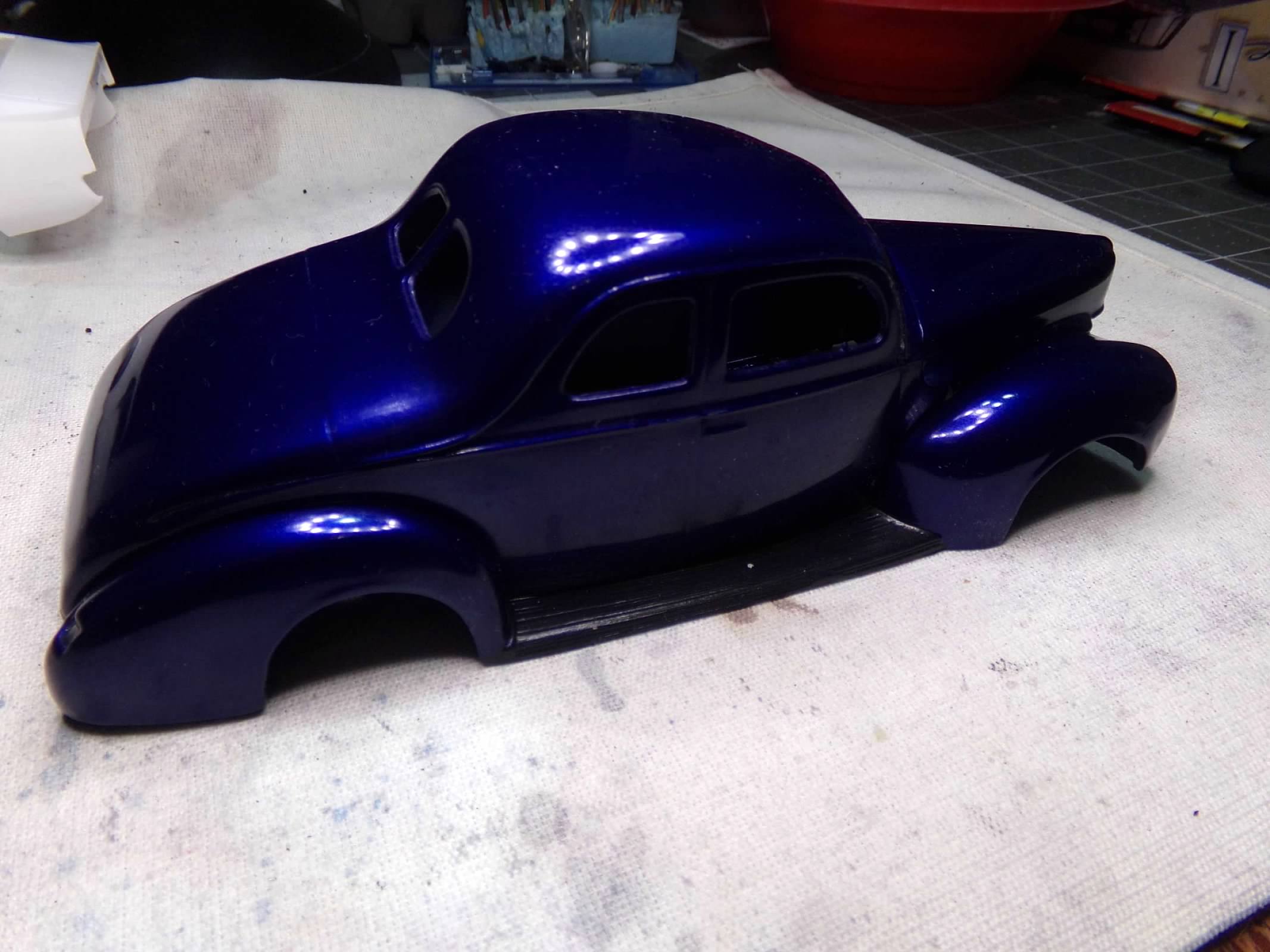

I rubbed out the Belvedere and got it foiled.  Now I just have to paint all the other parts.  The 40 Ford is a different story. I noticed while I was rubbing it out that there were half circle thingys on the cowl. I can't imagine injector pin marks there and I missed them while prepping the body. There was also a flare of plastic on the lip of the hood that needed to be sanded out. So this Lindberg body was a mess out of the box. I sanded everything out and repainted it. So tomorrow I'll rub it out and hopefully can move on.  I'll also try to get some more bodies painted while the weather here is good. Thanks for looking! ?

Like the blue on the '40 Ford. Great looking paint on the Plymouth. I built one of these last year, more like the box art. Really like that kit.
Thanks, David! I appreciate your comment! I like all the Moebius kits too. The only weaknesses are the decals and they never seem to leave enough space or have any detail for the spark plugs.
Not much done today. Painted all the other parts for the Plymouth and I'm still rubbing out the 40 Ford.

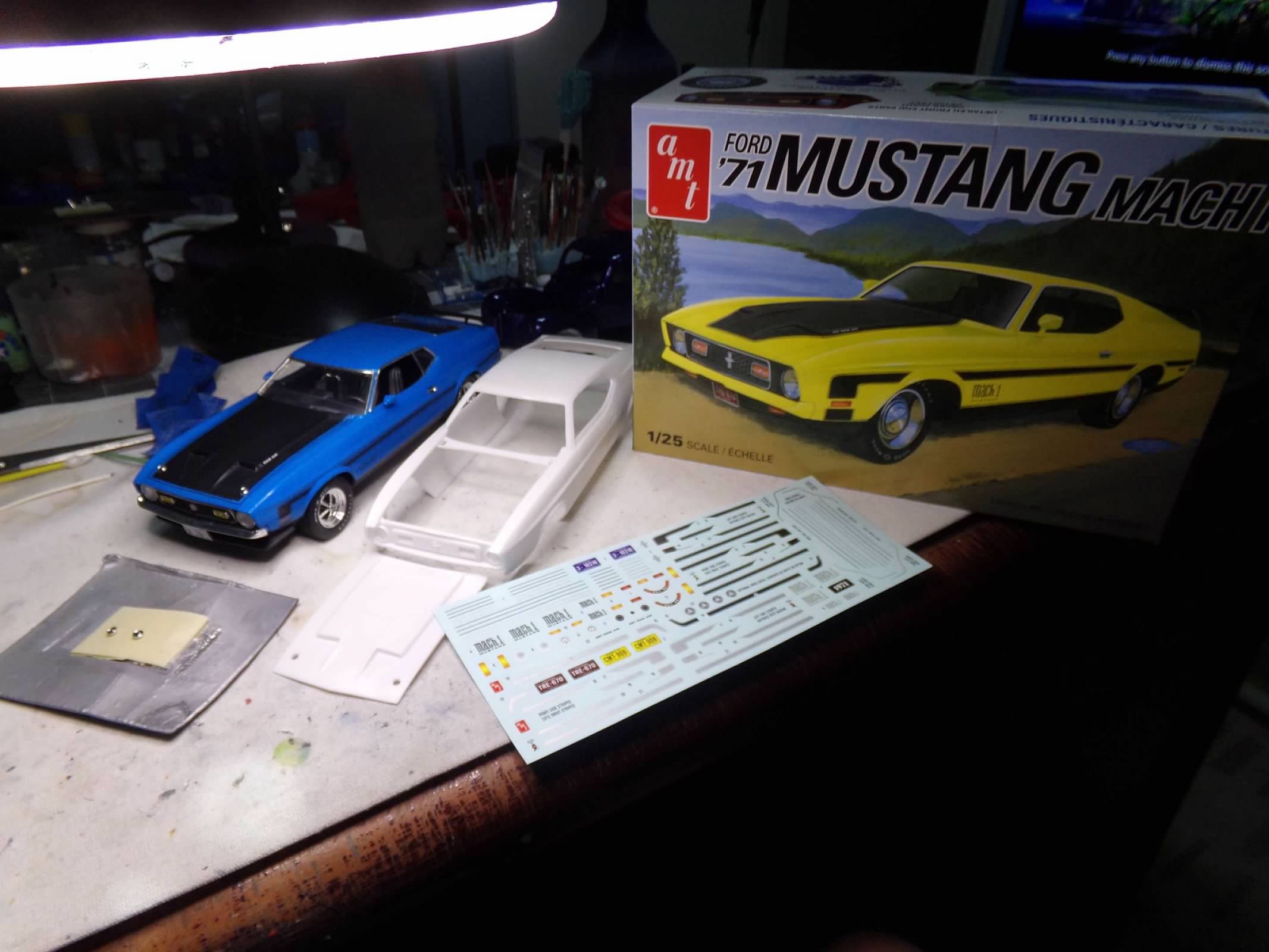

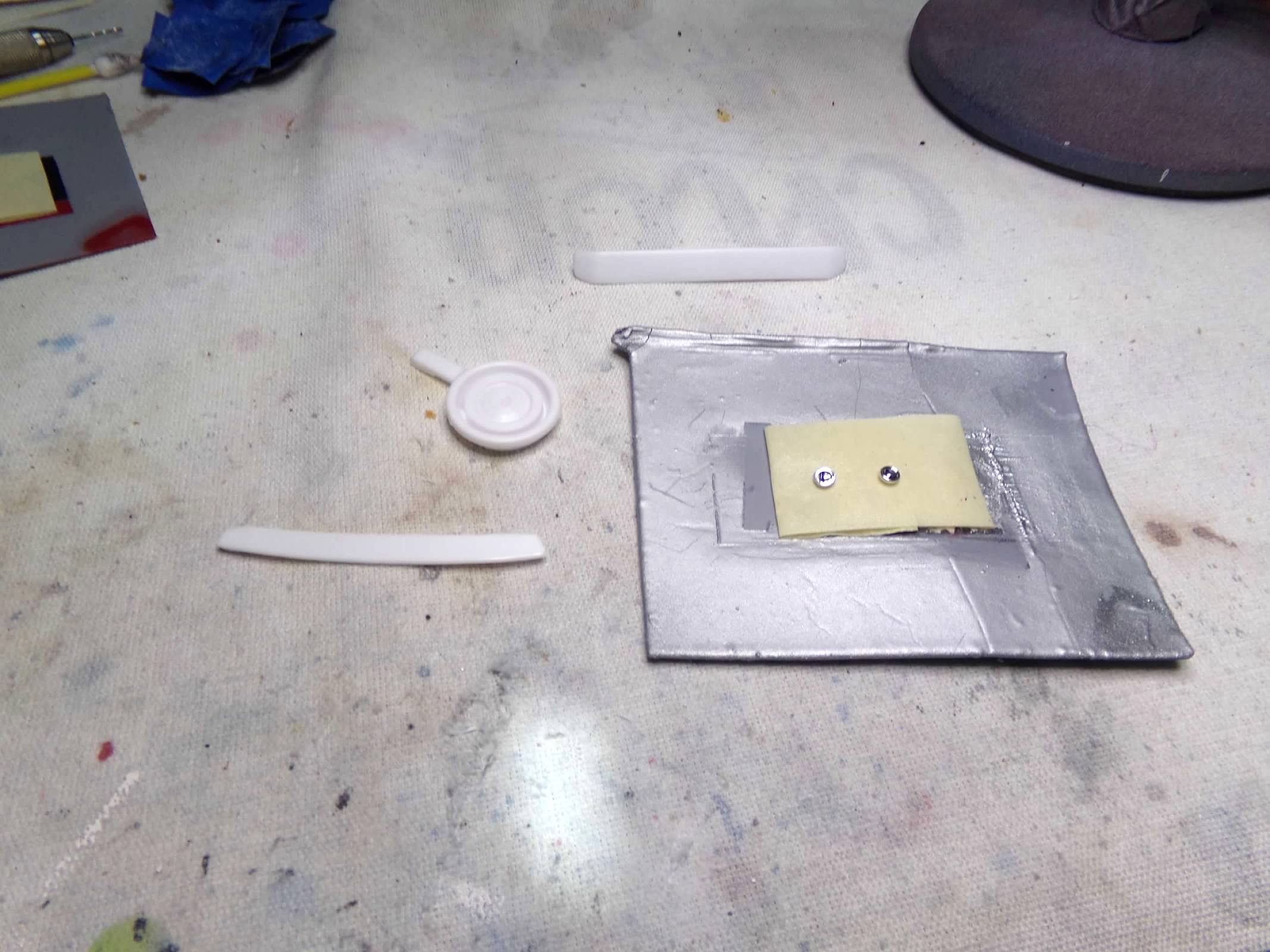

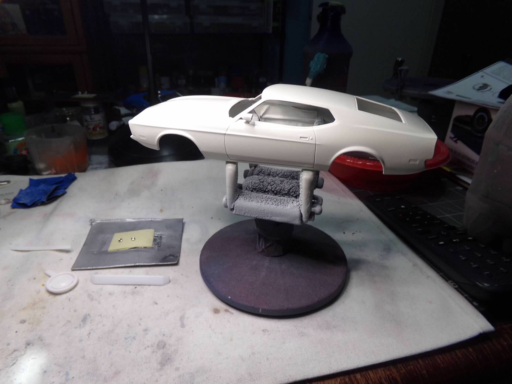

Well, I am still on my quest to paint a few bodies to store for when the weather gets bad. I bought this AMT 71 Mustang Mach 1 a few days ago and thought I would build it since it has the decals. I built the AMT 007 71 Mach 1 and bought the Revell 007 Mach 1 and thought I would build it as a performance 71 Mach 1. But there are a few parts missing in that kit as well as the decals. Then I remembered the review article in Model Car Magazine that indicated that the parts missing were the hood locks, rear spoiler, front air dam and the decals. Well, I looked at the Revell kit again and saw that the hood locks are still included on the chrome tree although not used in the 007 kit.  Then I found a rear spoiler and an air cleaner that should work. I still have the silver decals from the Boss 351 that I built for the stripes and I can use the silver pin stripes and Mach I decals in the AMT kit while painting the hood silver. I still haven't found the perfect front air dam or "chin whiskers", if you prefer, but I have something that will substitute possibly.

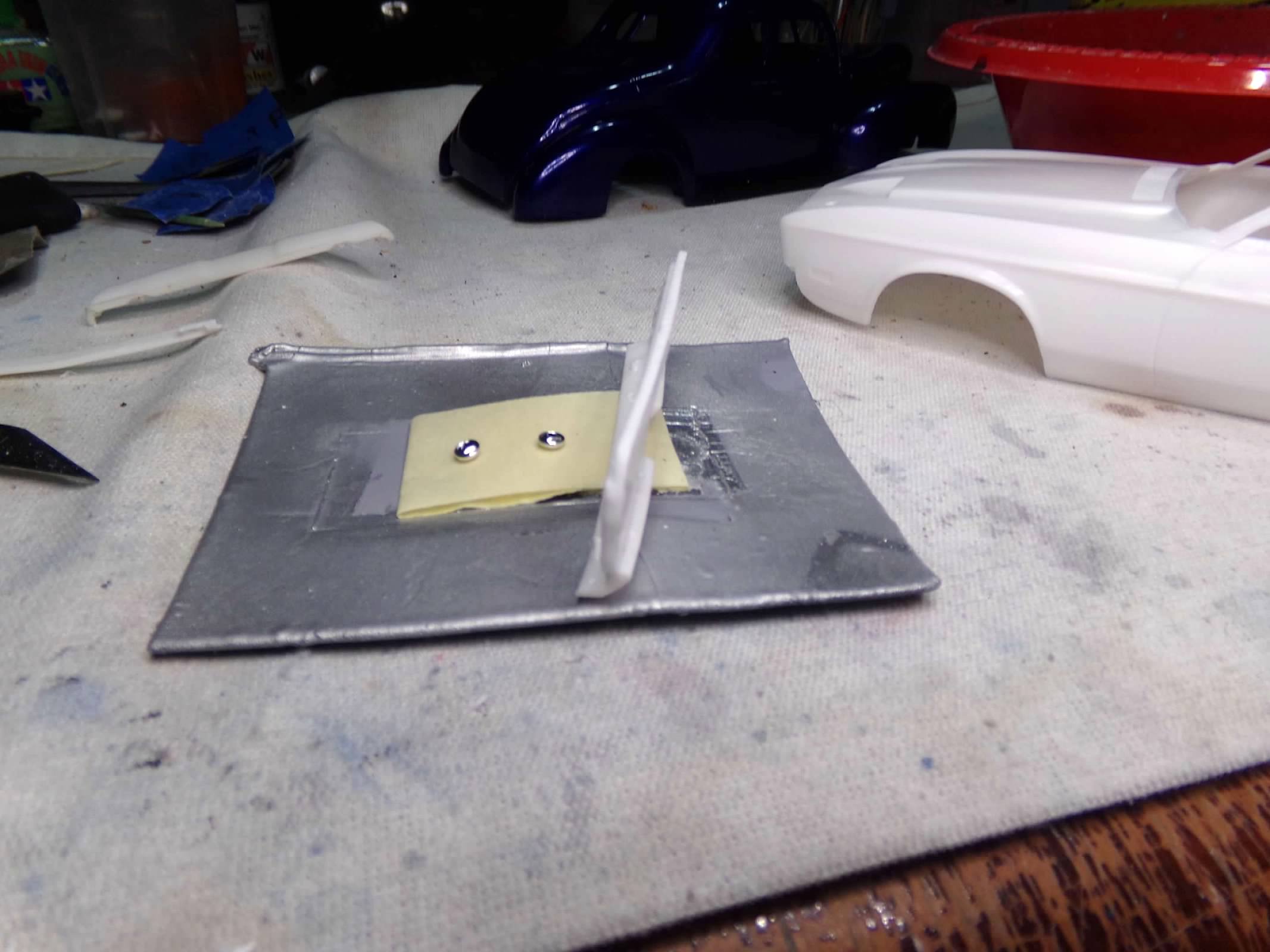

So I have a plan! paint the AMT kit white and use the black decals and paint the hood center and bottom trim black. By the way, the rear panel of the AMT kit is severely warped. I straightened it out with some hot water but it still isn't perfect. Then, I'll paint the Revell kit Light blue Metallic with the silver decals from the Boss 351 kit and the AMT kit with the hood painted silver in the center. I'll use these additional parts and I'll have a performance 71 Mach 1 instead of a 007 movie car.
Oh, and I finished rubbing out the 40 Ford. I'll get back to the Belvedere in a bit. Thanks for looking! ?

Sounds like a nice project for the Mach1.  Please fill in those vents on the back of the hood as they were not there on any 71-73 Mustang.
Thanks, Rex! I didn't notice that! But its too late for the AMT kit as I already have it painted. The Revell kit is much better and does not have the vents in the hood. I only bought the AMT kit because I thought I could use some parts for the Revell 007 kit to convert it to a performance Mach 1. But the AMT kit doesn't have a front air dam, hood locks, and the rear spoiler has poor supports that i doubt if I can pin. So I am leaving all of that off of the AMT kit and I found or made parts for the Revell kit to convert it. I only need the pinstripe and Mach i decals from the AMT kit and I can use the silver side stripes from the Boss kit that I already built on the Revell kit. I am starting WIPs on these and the 40 Ford above because this one is getting too cluttered with these other kits. Thanks for your info and thanks for looking! ?

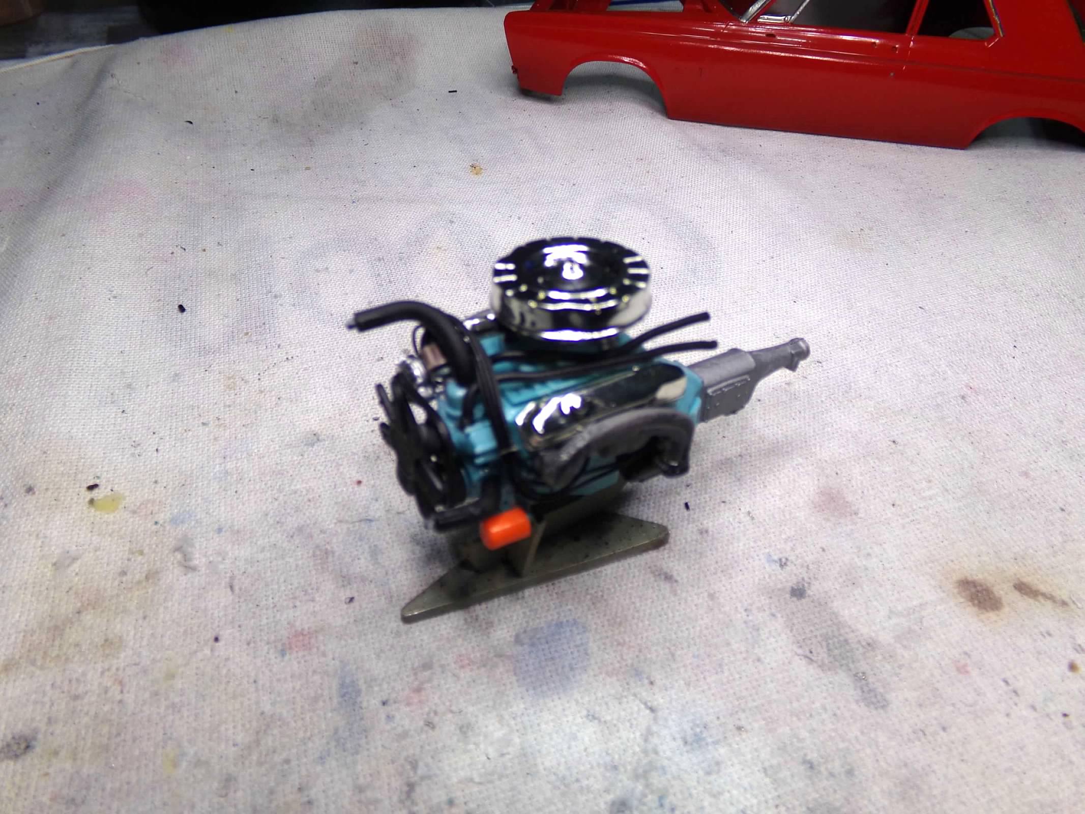

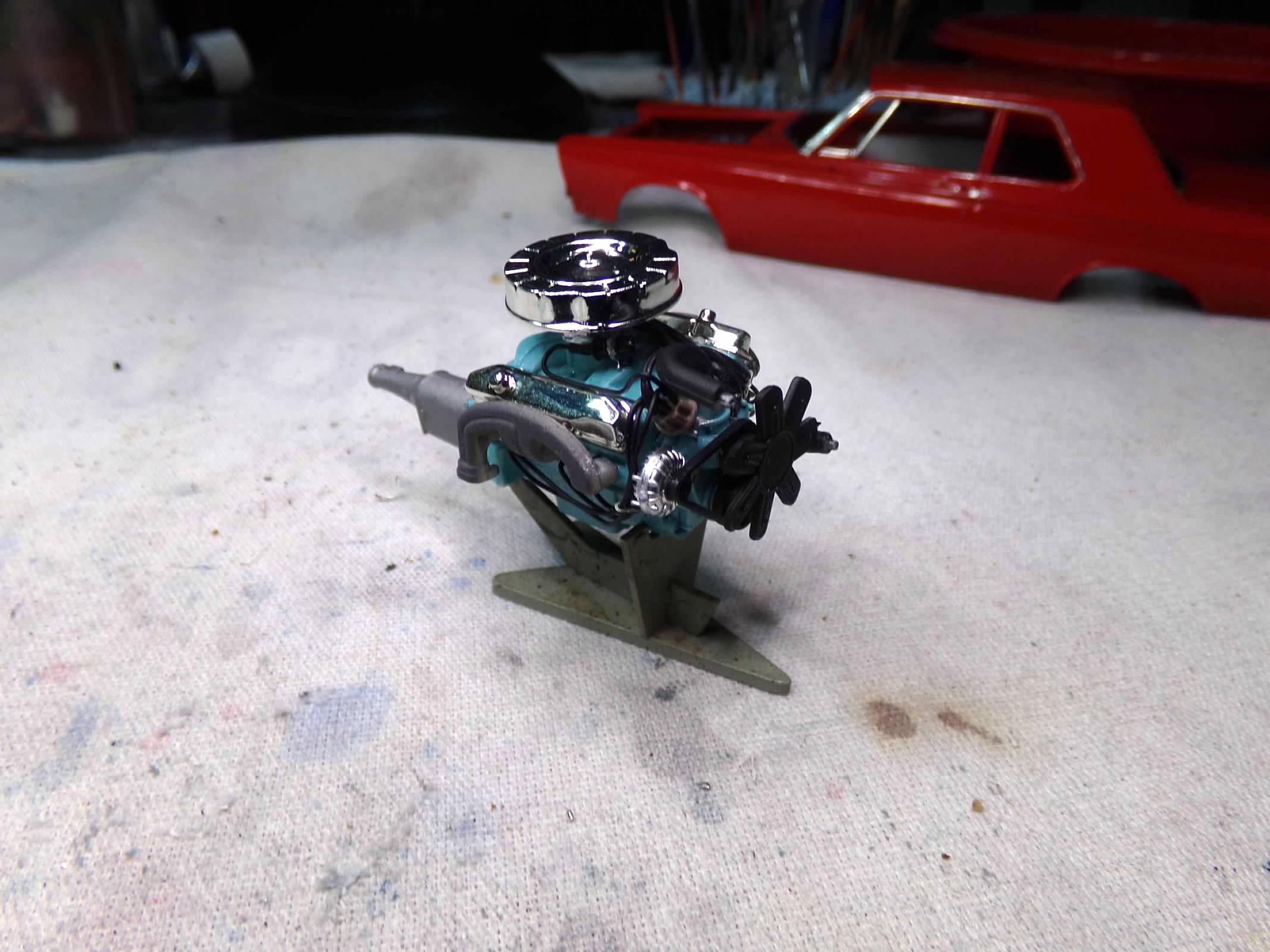

So I am back on this one and will stay with it until completion, Today, I finished the engine. I can't believe I spent most of the day on it but I added plug wires and heater hoses and detailed some of the parts.  This is the Commando 426 engine that I mixed up some paint for and painted turquoise. There are actually two engines in this kit with the Max Wedge being the other one. I'll save it for something else, I noticed by looking at photos on the internet that the heater hoses route over the intake on the left side of the engine on this one. So the left side is busy and its hard to see the plug wires but they are there. Interior is next. Thanks for looking! ?

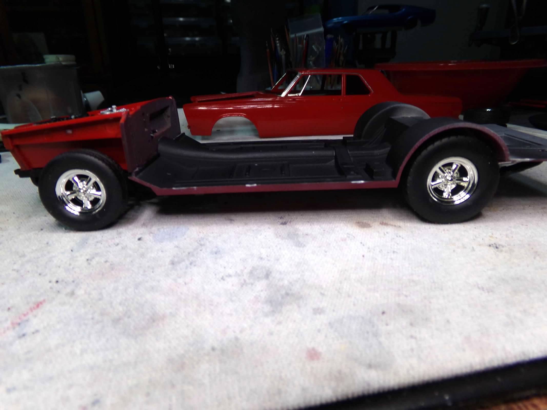

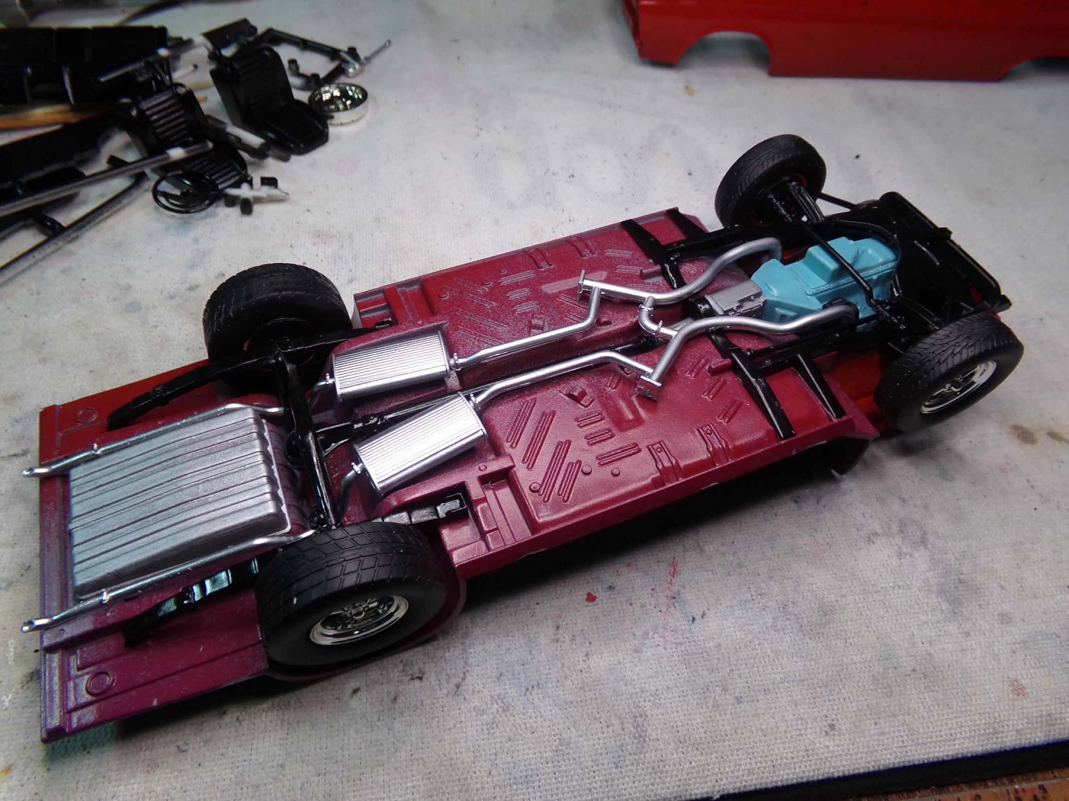

I forgot that this one was one of those kits that build the interior on the chassis so I had to complete the chassis first. I think I have the doghouse square, at least as square as i can get it. As usual, its not an easy assembly. A couple of issues with this Moebius kit; the steering box doesn't really fit. Its suppose to attach to the firewall and dangle while you put the engine in. It doesn't really connect to the tie rod so I just left it out. The other issue was that the main chassis platform is missing a drilled hole on the right side to attach the subframe. So that was easy to fix by drilling a hole for the mounting. Other than those two items it went together pretty well. I used the bigger wheels and tires (which are treaded)  on the back. Tomorrow the interior! Thanks for looking! ?

A quick mock-up update: Read the instructions when putting the body on the frame. Put the rear in first and work to the front. It doesn't work the other way.

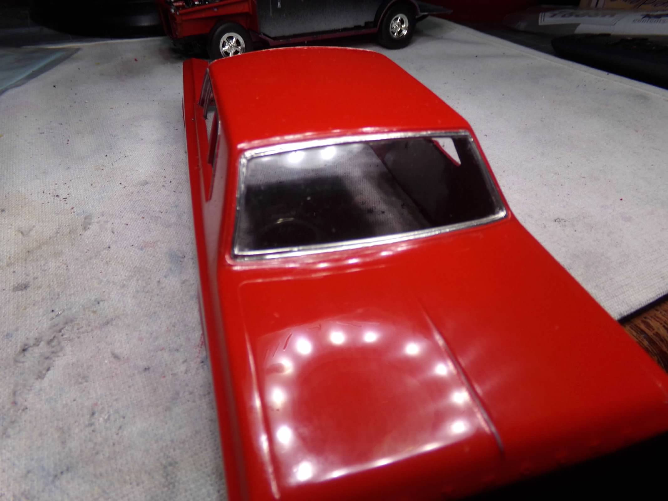

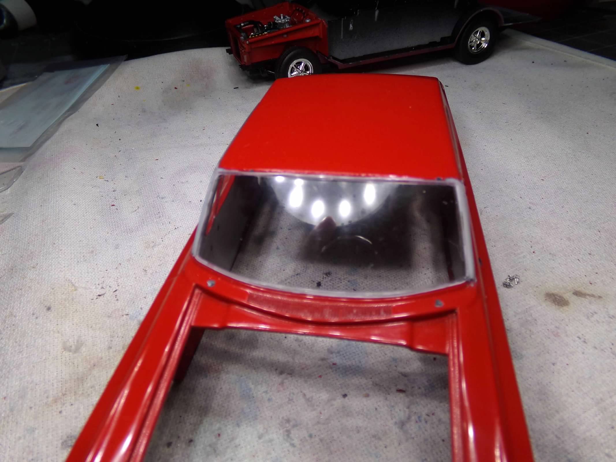

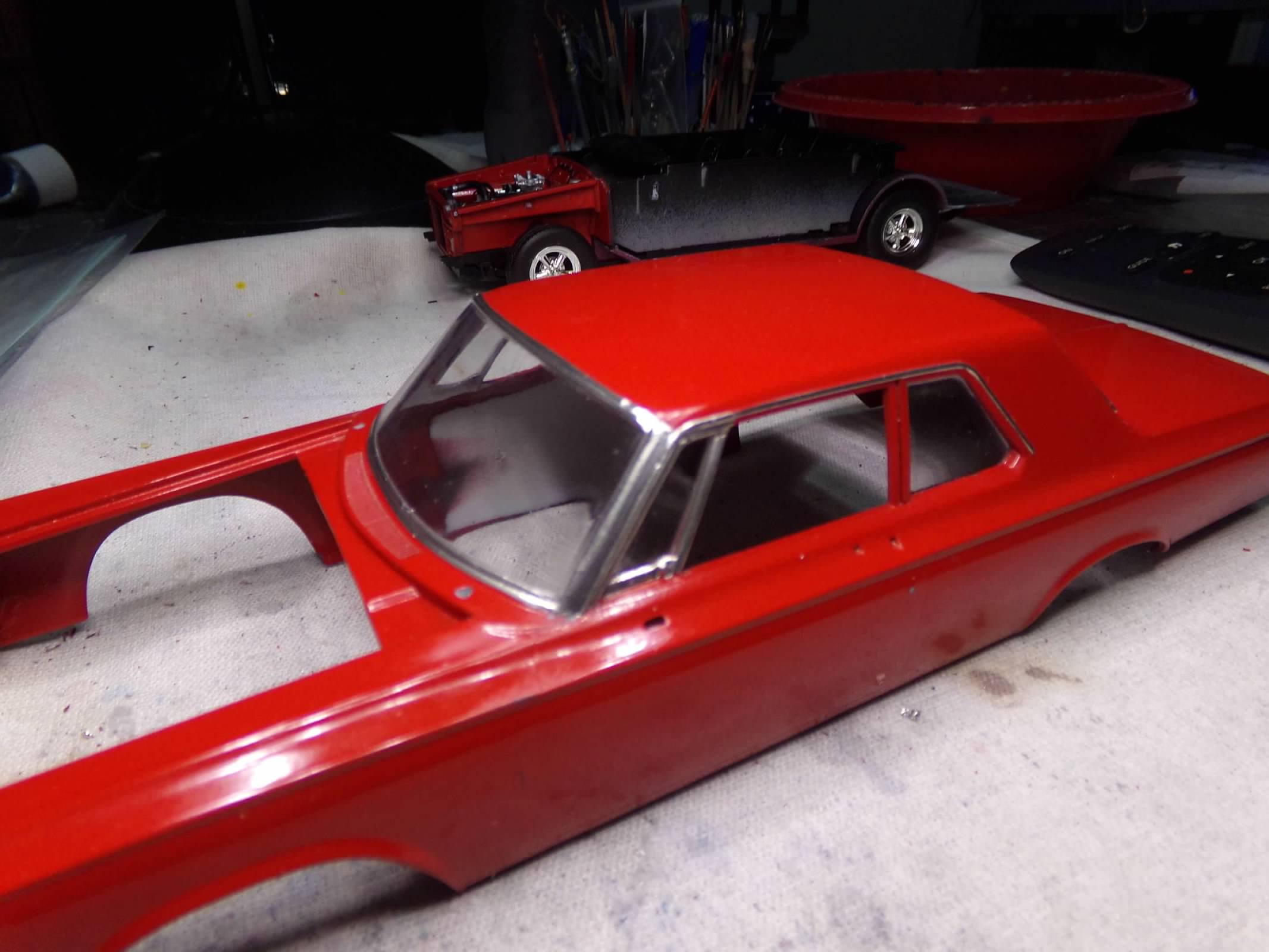

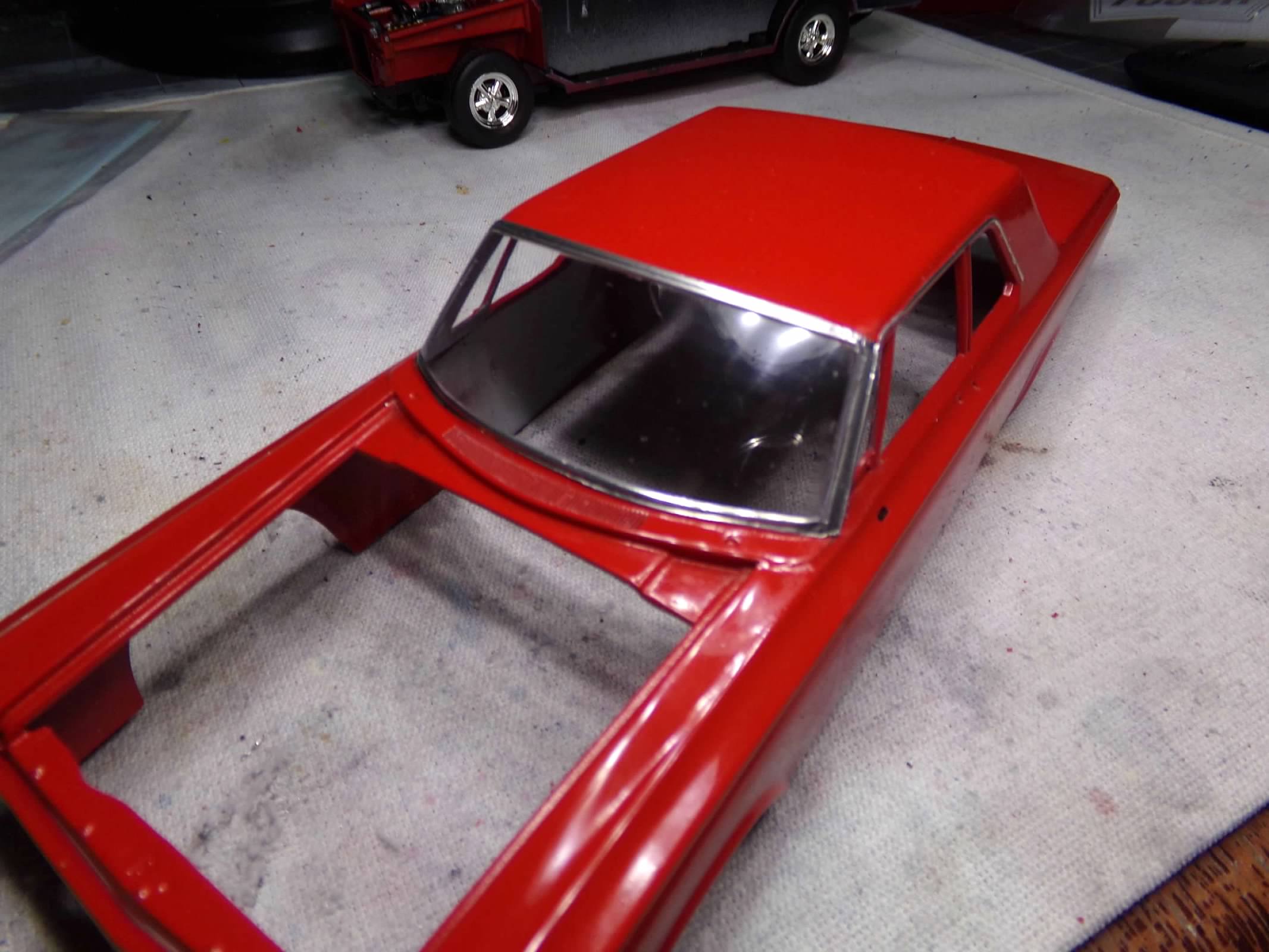

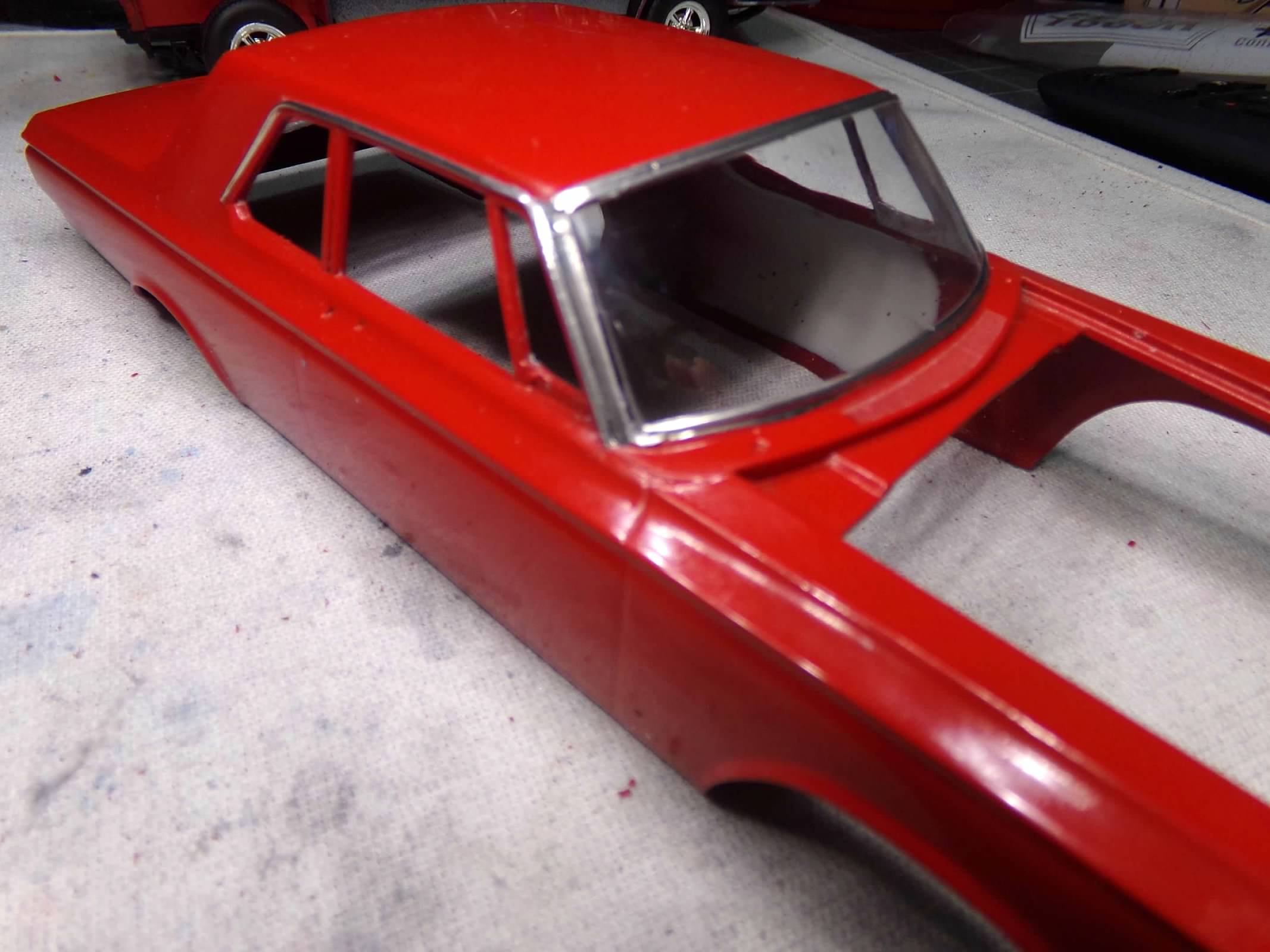

Well, I thought I would be finishing this one up today but the modeling gods and the instructions got me again. In this step, the windshield and back glass go in from the outside, Well, I already have the trim foiled and as many of you already know, glue on foil does not work. so I had to remove the foil from the front and back and while I was at it I removed the foil on the wing windows, The only original foil left is the piece on the roof and not all of it survived either. So while I was at it, I scraped off the paint from the "A" pillar so that I could address the mold indent or cut into the plastic on both pillars, I sanded them down with some sandpaper and a file to remove the ugly cut since the paint isn't really necessary as both are completely covered with foil.
Once all that prep work was done, I glued the windows in as best I could. Neither fit well. Normally, when kit makers have windows that mount from the outside there is a groove inside the window that the window actually just fits in. But not on this one. So once the glue had dried I re-foiled the front and back windows. The windshield came out OK and the mold indents in the A pillars are gone and the foil went on OK. The back window on the left side looks a little ragged because some of the paint on the trim chipped off in the process and I wasn't going to remove the paint from all the trim on the back window.  So I'll just have to live with some chips in the rear trim under the foil.
I've been working on this a good part of the day and still have the wing windows and rear side windows to install.  Makes me wonder if anyone at Moebius has ever built a model. I would call this kit a Moebius Manufacturing Fail! Thanks for looking! ?

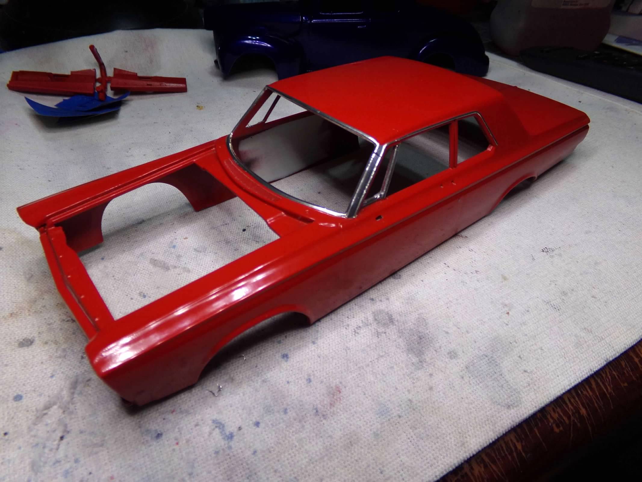

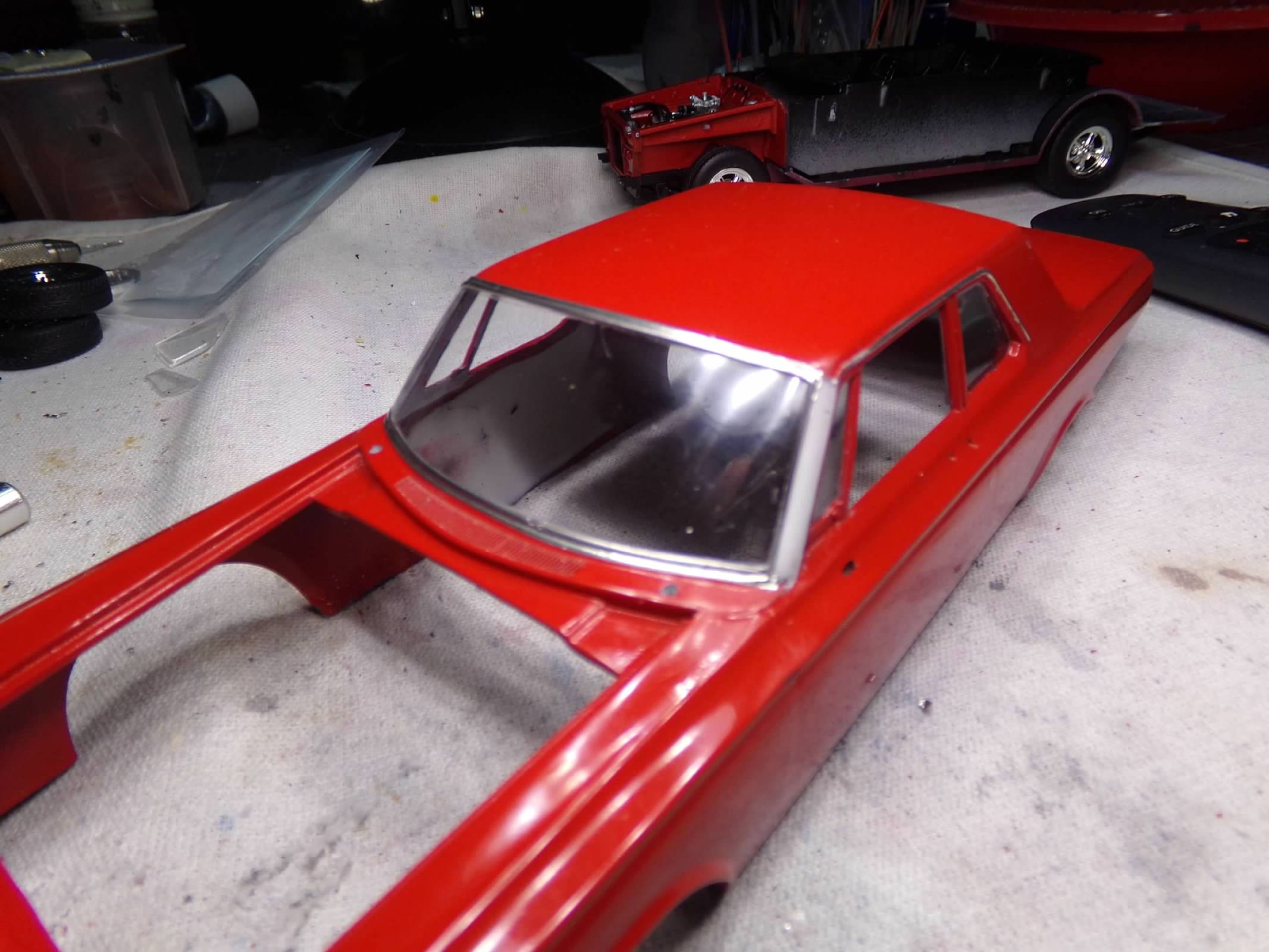

I knew I could do better on the windshield and not leave a gap on that right side, so I stripped off the foil and started again. I think it turned out much better. Third time's a charm! Thanks for looking! ?
