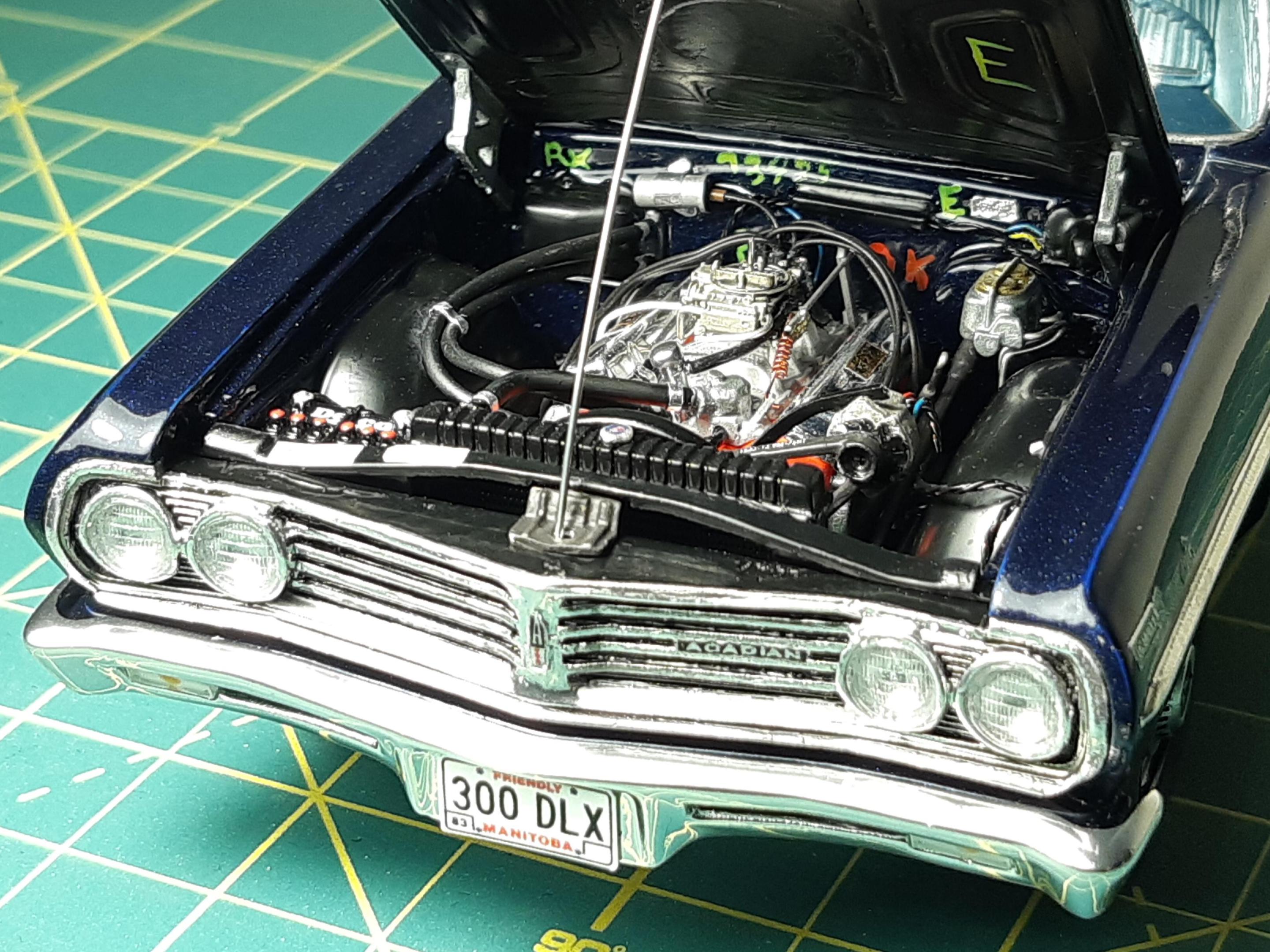

TheBEAUMONTGURU Posted October 6, 2024 Posted October 6, 2024 Nice to see others interested in Beaumont models. Im the one that built the 65 and 67 wagons. I made my grilles from scratch with evergreen strips, then resin cast them for multiple copies. Im sure the 3D printing guys will eventually do the grills to much greater detail. Looking forward to seeing a Sport Deluxe version, keep up the good work! You can search out my detailed build threads on these 2 cars for a bit of inspiration. Also, welcome to the forum! you will like it! 7

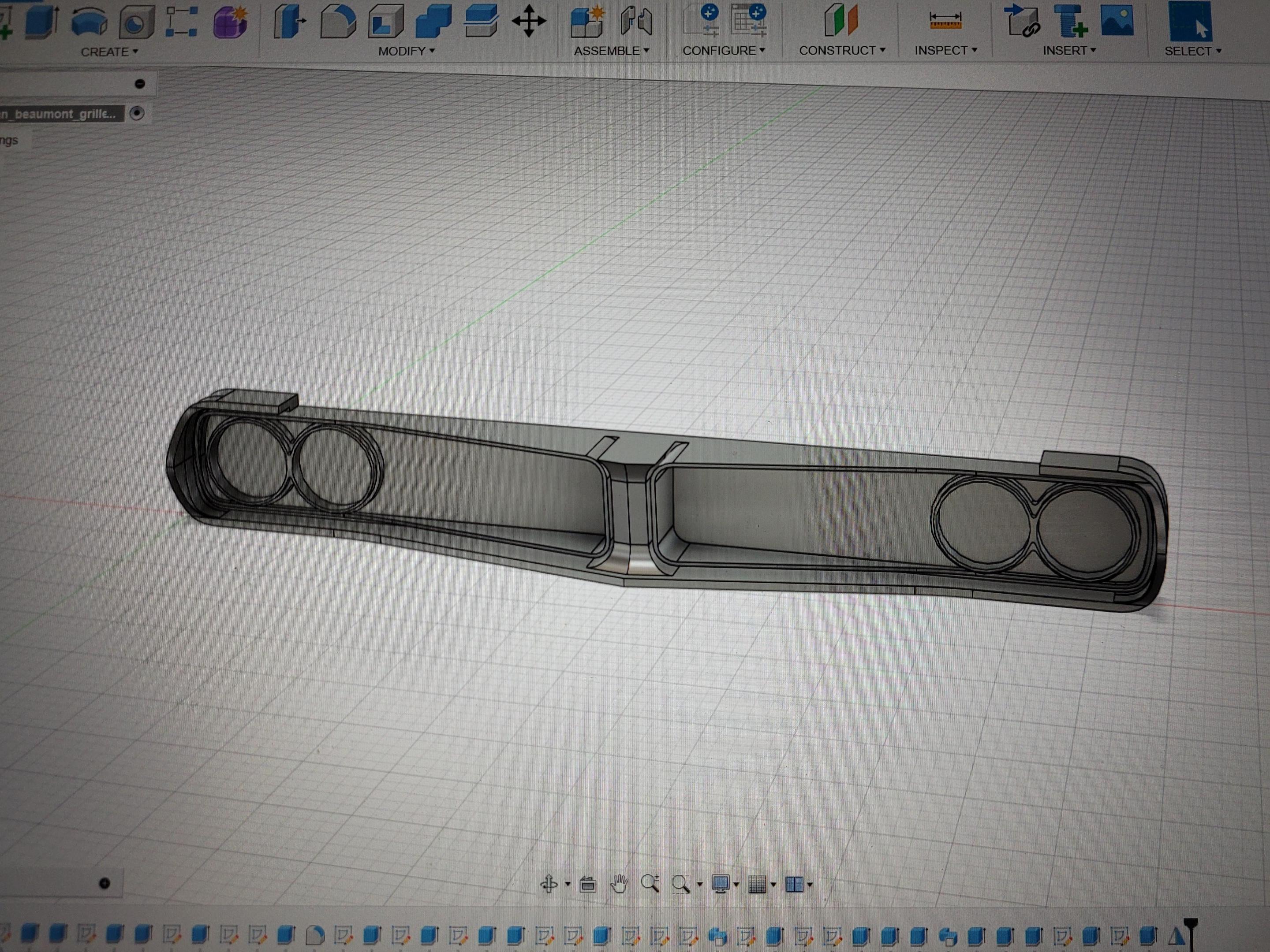

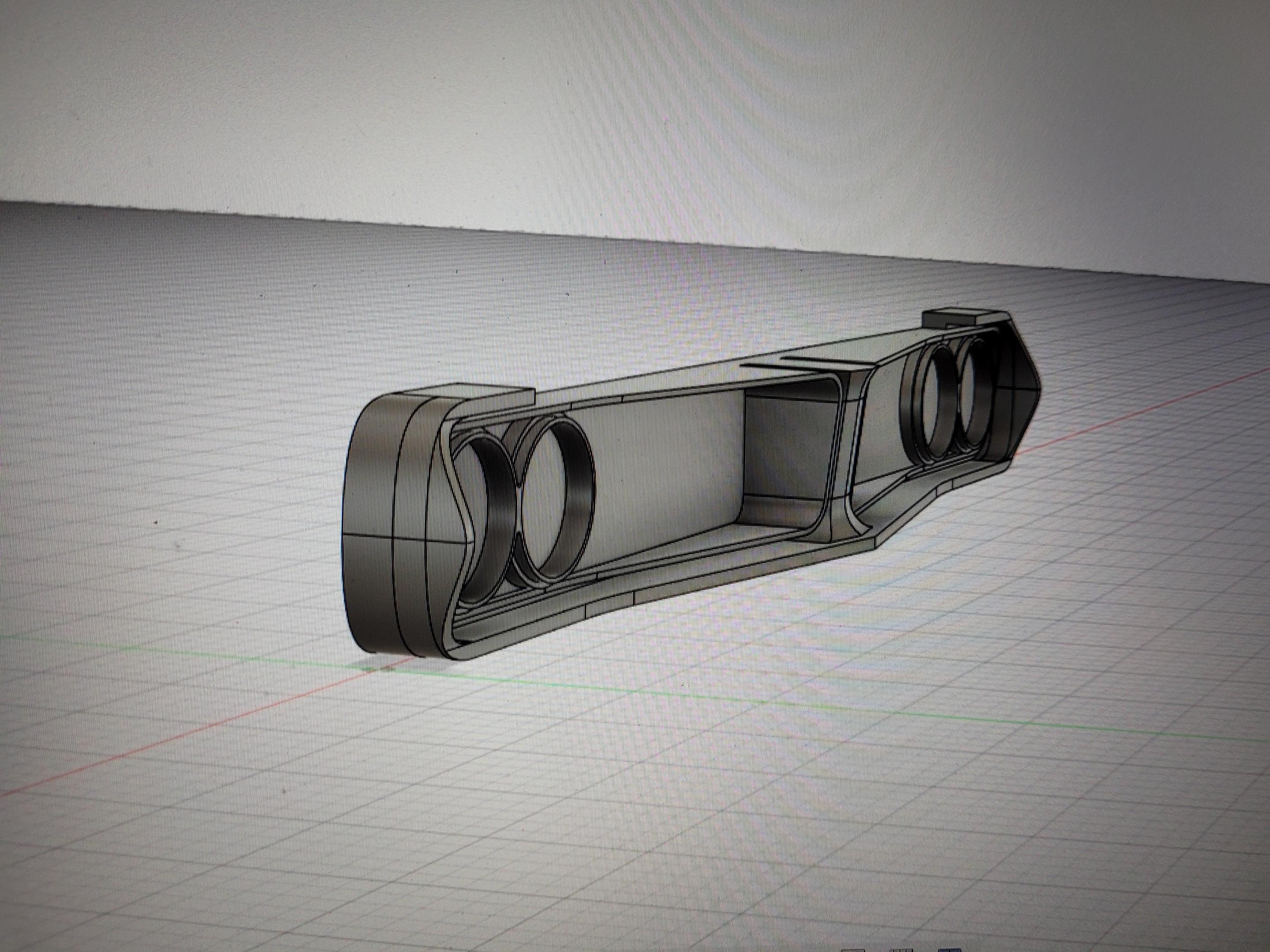

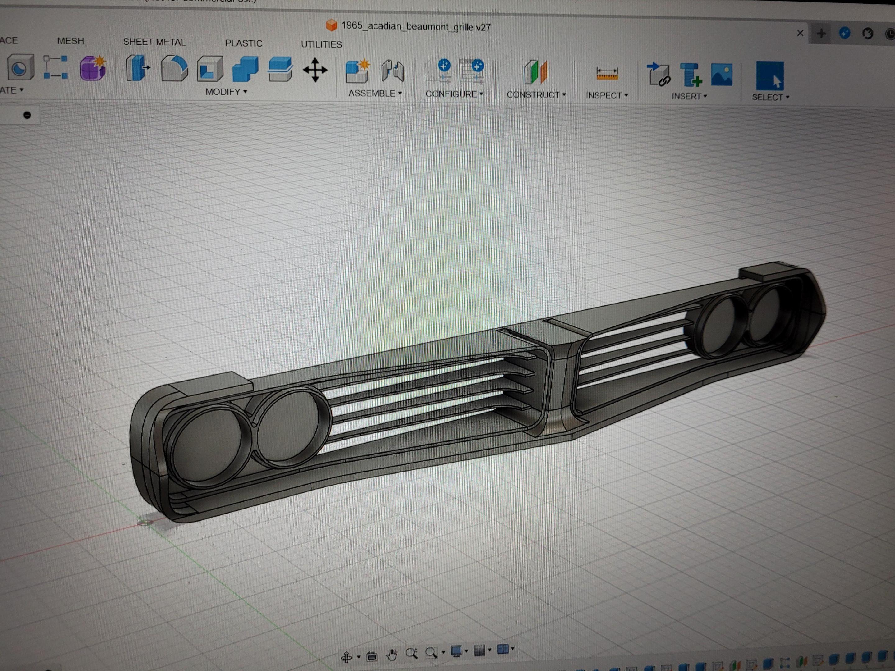

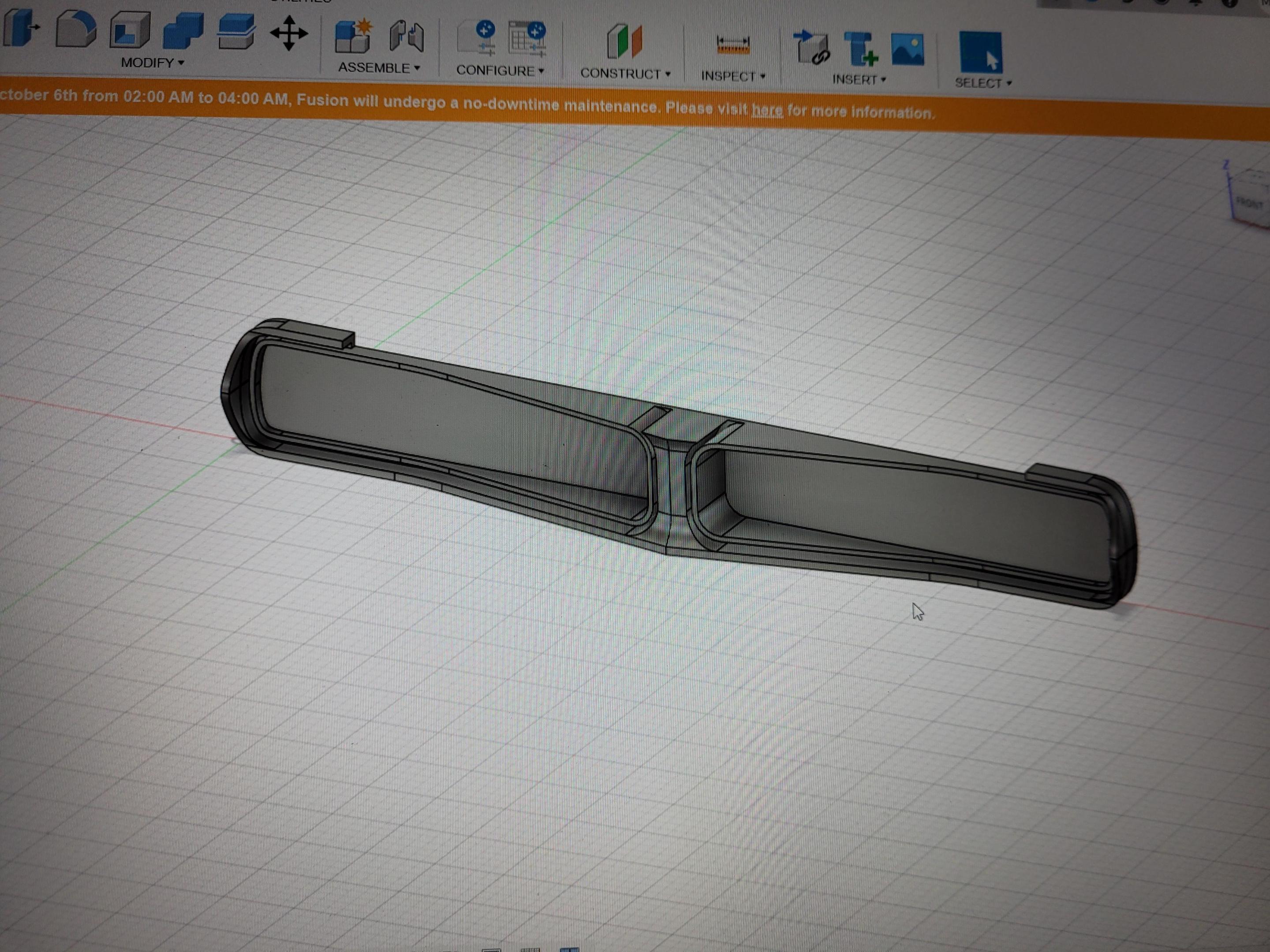

Mike Slapattack Posted October 6, 2024 Author Posted October 6, 2024 @TheBEAUMONTGURU Here's my progress to date on my 3D printed grille if you're interested! 2
Mike Slapattack Posted October 6, 2024 Author Posted October 6, 2024 (edited) Here's another update on the grille! Edited October 6, 2024 by Mike Slapattack Wrote more than I wanted to. 2

Mike Slapattack Posted October 8, 2024 Author Posted October 8, 2024 (edited) Update on the fascia! It's not finished but I'm close! The blacked out sections of the grille will most likely be a separate insert to make painting easier. I haven't made those yet and they are the next big thing on the to-do list. I will likely end up purchasing my own resin printer soon. Still undecided as to whether I will be outsourcing the printing or not, but I've been browsing some stores and have found some good prices on printers and curing stations. I tried to print a grille for a fitment test on my dad's FDM printer but that just didn't cut it unfortunately. The supports were too difficult to remove without damaging the piece and the detail was all garbled up to boot. MSLA printing is just far better for minute details, so I'm going to be patient and do it right. Anyway, here's a screenshot from Autodesk Fusion with all of the edges hidden so you can see a closer representation of the real part. Once again, this is entirely my own work I've drawn up from scratch with basic dimensions from the kit and lots of staring at reference photos! Most of the dimensions of the details are estimated to the best of my ability to get the right "look". Edited October 8, 2024 by Mike Slapattack Forgot to add some things. 3

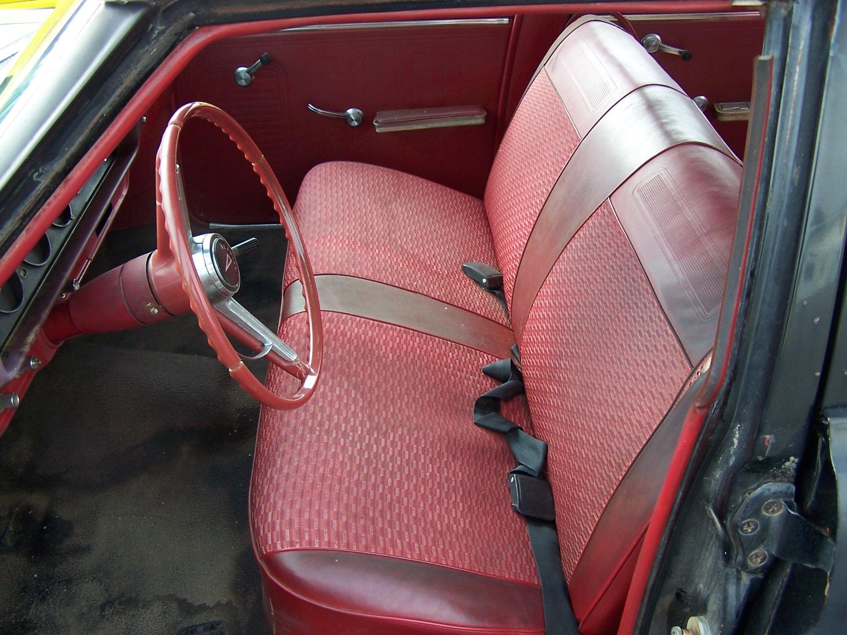

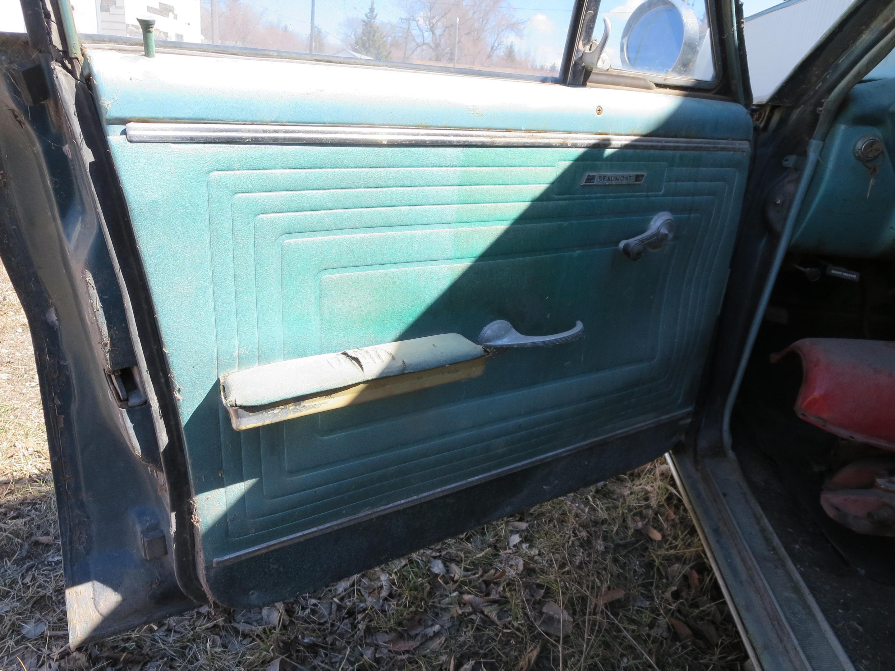

TheBEAUMONTGURU Posted October 8, 2024 Posted October 8, 2024 When it comes to an interior, if you are building a Sport Deluxe(SD) then Mike is correct, the interior would swap over from the 65 GTO kit, just putty up the Pontiac logo on the seats. But if you wanted to build a "Beaumont Deluxe"(the base model like a chevelle 300) OR a "beaumont Custom"(like a chevelle malibu-NON SS) then you could keep with the 65 z-16 interior panels and make the seat inserts look like cloth with a fleur-de-leys pattern. of course you would always need a GTO kit for the dashboard. Sorry to derail your thread! 2 1
