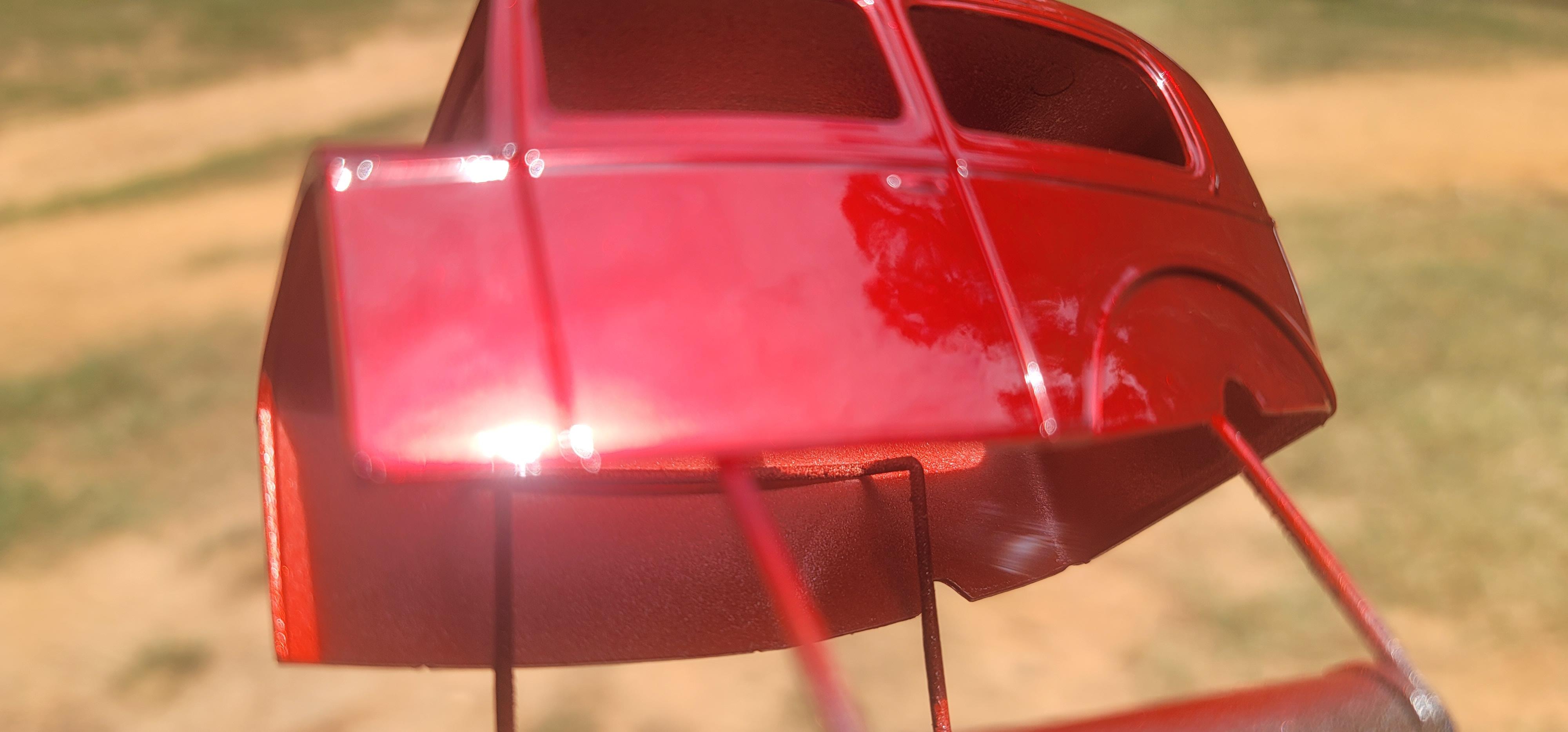

TopherMcGinnis Posted October 16, 2024 Posted October 16, 2024 I painted one with Createx, cleared with Tamiya and it reacted. I dunked it in purple stuff, the paint would all come off. I used brake fluid and it took all of the paint off. Cleaned it with Dawn dish soap and have it primered with MCW lacquer primer. I need to sand it one more time to make smooth for for paint. 1

TopherMcGinnis Posted October 16, 2024 Posted October 16, 2024 3 hours ago, mrm said: Tamiya clear is something I try to stay away from. It is stronger and more aggressive than any other Tamiya paint. It will eat through decals and really soak into whatever is underneath. That aside, any lacquer based clear will lift Createx as it is acrylic. It has been discussed at nauseam that there is a simple principle to follow when painting model bodies. Enamels and acrylics over lacquers is OK, but never spray lacquer over enamel or acrylic. The other thing about Tamiya clear is that it will yellow up over the years. Ever so slightly, but it will. That is fine over most colors, but does not look good on white paintjobs/decals and especially on silver. This is PPG 2k over Createx Blood Red Candy over Createx Cosmic Copper base. No issues. 1

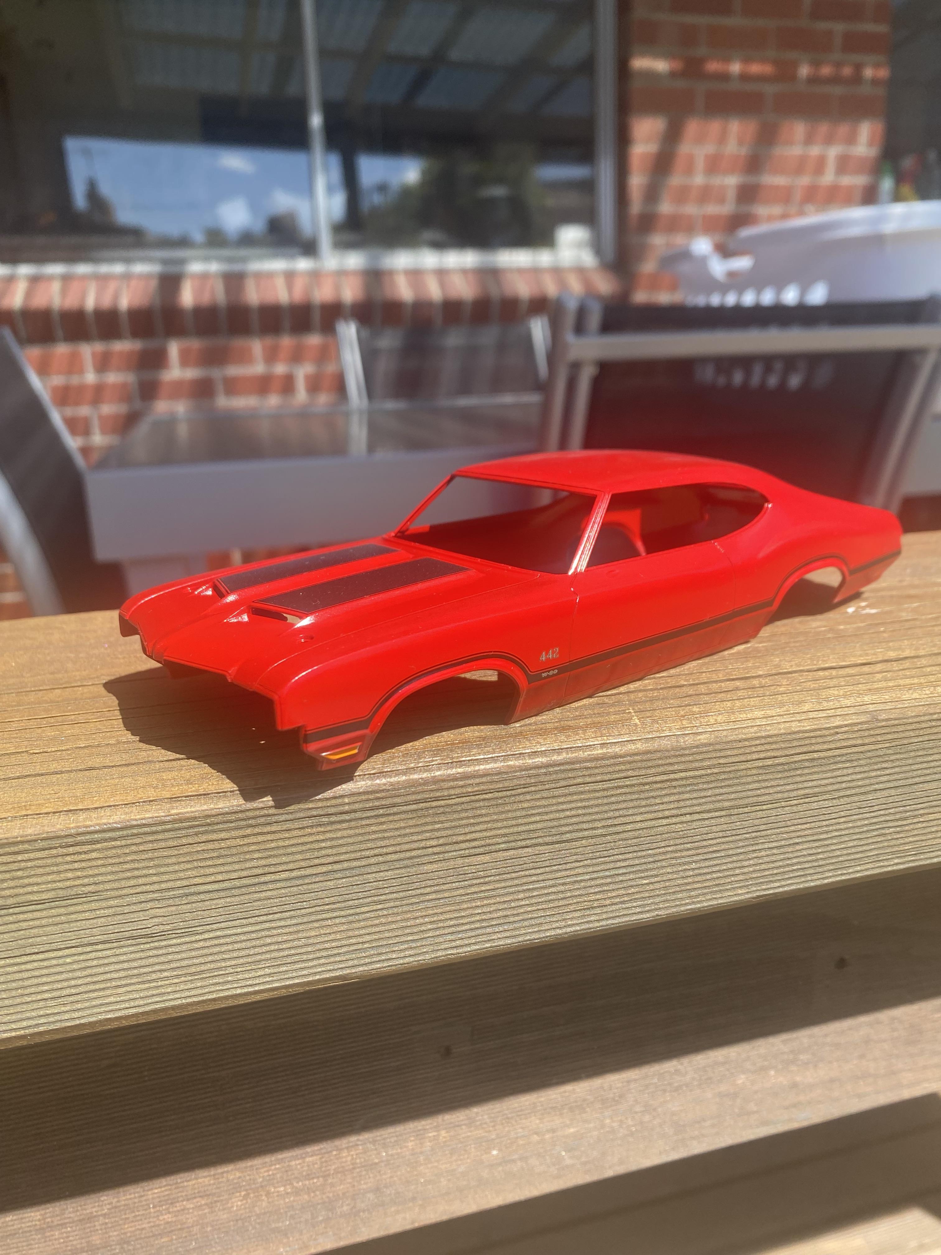

STU111 Posted December 17, 2024 Author Posted December 17, 2024 The Olds is looking a little better now. After painstakingly removing all traces of my botched attempt to paint it some time back, I had another go at it. I really wanted to build it matador red with black stripes so with a little bit of trepidation I applied 4 coats of Tamiya TS-8 Italian red and this time I’m happy with the result. After applying the decals I’ve put a couple of mist coats of TS-13 clear over them and will slowly build up to a final wet coat . 4
johnyrotten Posted December 18, 2024 Posted December 18, 2024 50 minutes ago, STU111 said: The Olds is looking a little better now. After painstakingly removing all traces of my botched attempt to paint it some time back, I had another go at it. I really wanted to build it matador red with black stripes so with a little bit of trepidation I applied 4 coats of Tamiya TS-8 Italian red and this time I’m happy with the result. After applying the decals I’ve put a couple of mist coats of TS-13 clear over them and will slowly build up to a final wet coat . Great job on the paint.
