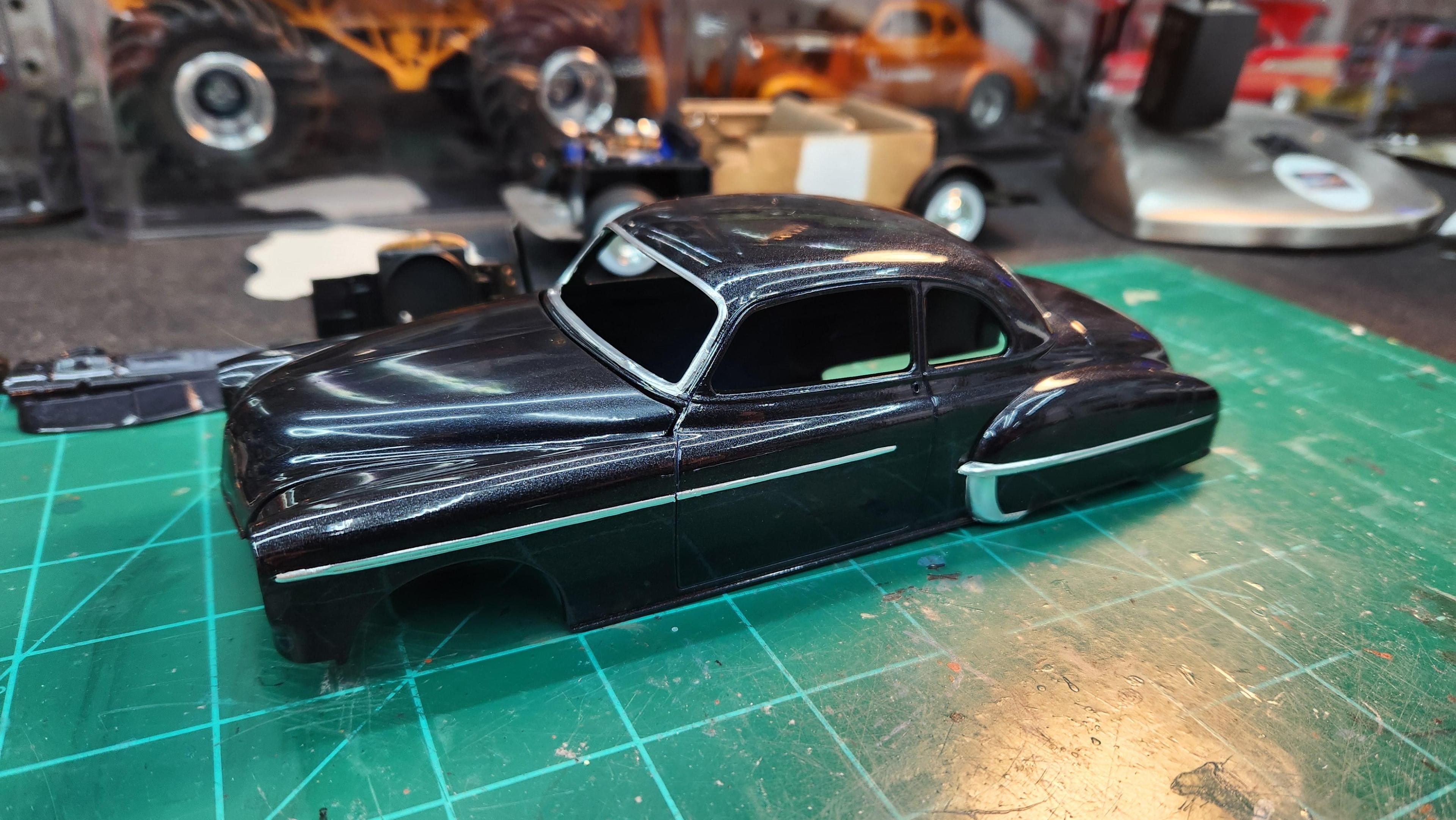

Zippi Posted November 21, 2024 Author Posted November 21, 2024 Well...I started the foil work this morning and things are not going well. Not only does the Matte Aluminum bmf not match the color I painted the bright work it doesn't want to stick very well. Also, I'm not getting straight cut lines. My eye sight and shaking hand are the culprit. I'm starting to loose interest in this build because of these issues. 1
customline Posted November 21, 2024 Posted November 21, 2024 4 minutes ago, Zippi said: Well...I started the foil work this morning and things are not going well. Not only does the Matte Aluminum bmf not match the color I painted the bright work it doesn't want to stick very well. Also, I'm not getting straight cut lines. My eye sight and shaking hand are the culprit. I'm starting to loose interest in this build because of these issues. I Bob, I have found the adhesive on BMF to be inconsistent, even on the same sheet. If you have enough on the sheet, you could try taking from another area on the sheet. Better yet, if you have a sheet of the "new improved chrome" (which is not new at all, they just call it that) you may have a better time with that. I actually like foiling but I need to be in the right frame of mind because of the same situation you described. My hands hurt all the time and my filmy left eye drives me crazy. Take a break from it. This build is way too nice to go back in the box. 4
BK9300 Posted November 21, 2024 Posted November 21, 2024 I agree with Jim about not putting it back in the box - very nice job so far! If you are considering alternatives, I find Hasegawa foils to have good adhesion, however, their products are more expensive for less quantity than BMF. Works well, though! 2
Zippi Posted November 21, 2024 Author Posted November 21, 2024 50 minutes ago, customline said: Bob, I have found the adhesive on BMF to be inconsistent, even on the same sheet. If you have enough on the sheet, you could try taking from another area on the sheet. Better yet, if you have a sheet of the "new improved chrome" (which is not new at all, they just call it that) you may have a better time with that. I actually like foiling but I need to be in the right frame of mind because of the same situation you described. My hands hurt all the time and my filmy left eye drives me crazy. Take a break from it. This build is way too nice to go back in the box. 40 minutes ago, BK9300 said: I agree with Jim about not putting it back in the box - very nice job so far! If you are considering alternatives, I find Hasegawa foils to have good adhesion, however, their products are more expensive for less quantity than BMF. Works well, though! Fellows. It's not going back in the box. The bmf is sticking just not as good as the bright chrome I have especially around corners. I just get frustrated when the work I do doesn't go as planned.
Andrew McD Posted November 21, 2024 Posted November 21, 2024 Man I hear ya' on the frustration when things don't go as planned! Some builds fight me at every move. Actually it seems that most of them do that! It is particularly frustrating when tools or materials (such as the BMF) don't work as advertised. I suppose if it were easy everybody would be building show stoppers. Having followed a few of your builds I don't doubt you'll resolve the issues and get through this one too. Despite the frustration your BMF work looks great in the photos.

Zippi Posted November 21, 2024 Author Posted November 21, 2024 1 hour ago, Andrew McD said: Man I hear ya' on the frustration when things don't go as planned! Some builds fight me at every move. Actually it seems that most of them do that! It is particularly frustrating when tools or materials (such as the BMF) don't work as advertised. I suppose if it were easy everybody would be building show stoppers. Having followed a few of your builds I don't doubt you'll resolve the issues and get through this one too. Despite the frustration your BMF work looks great in the photos. Yeah, your right dude. It might look good in the pics but it's not sticking around tight edges. It is what it is.

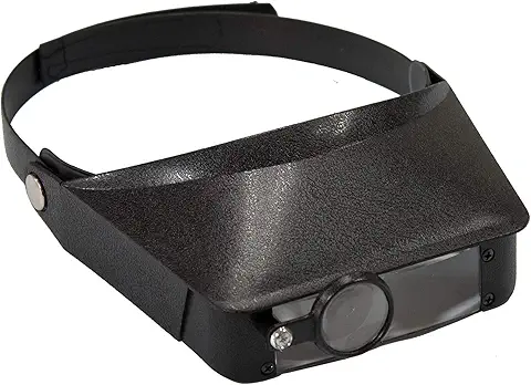

customline Posted November 22, 2024 Posted November 22, 2024 This is what I use and I'm very happy with it. Its an Excel product "MagniVisor" it has 2 levels of magnification (I discarded the loupe). It's light and, even for my fat head, it's quite comfortable ( I sometimes forget I'm wearing it. 🥴 ) $22 on Amazon. 1
LennyB Posted November 22, 2024 Posted November 22, 2024 10 minutes ago, customline said: This is what I use and I'm very happy with it. Its an Excel product "MagniVisor" it has 2 levels of magnification (I discarded the loupe). It's light and, even for my fat head, it's quite comfortable ( I sometimes forget I'm wearing it. 🥴 ) $22 on Amazon. Maybe I'll give that one a try. I've already sent two others back to Amazon.
Zippi Posted November 22, 2024 Author Posted November 22, 2024 1 hour ago, customline said: This is what I use and I'm very happy with it. Its an Excel product "MagniVisor" it has 2 levels of magnification (I discarded the loupe). It's light and, even for my fat head, it's quite comfortable ( I sometimes forget I'm wearing it. 🥴 ) $22 on Amazon. Nice
Zippi Posted November 22, 2024 Author Posted November 22, 2024 56 minutes ago, LennyB said: Maybe I'll give that one a try. I've already sent two others back to Amazon. This is the one I bought a couple years ago. Bought one for the wife also.

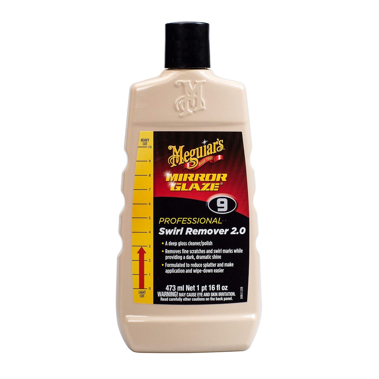

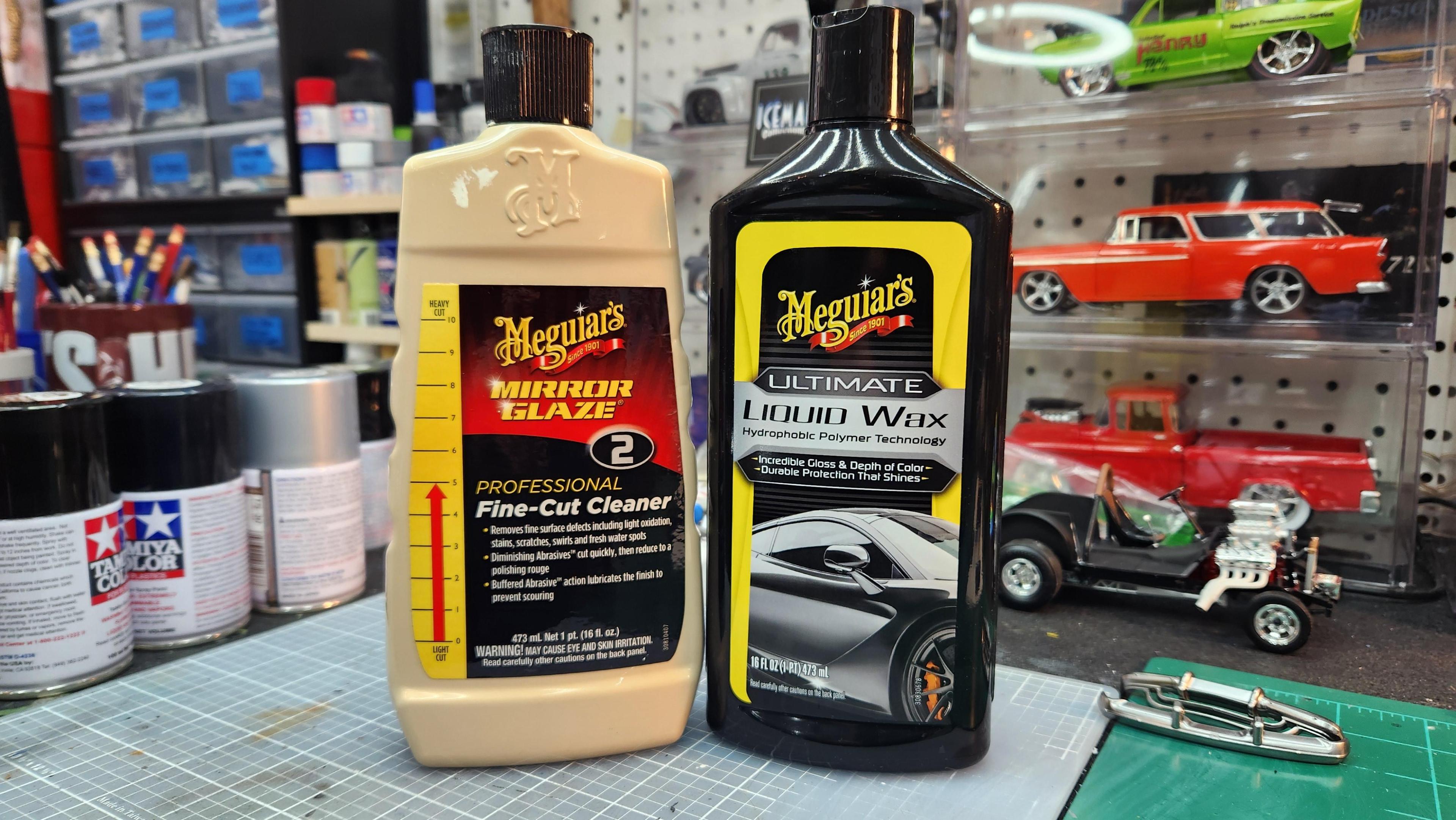

LennyB Posted November 22, 2024 Posted November 22, 2024 On 11/20/2024 at 12:43 PM, Zippi said: The 2K clear on the Olds has been curing out for 3 days so this morning the task at hand was to get some wet sanding done. I started with the hood starting a 3600 then 4000, 6000, 8000, then 12000. I'm at a lose as to what happened. It has lost it's shine and took on a dull look. I used some Meguiar's cutting compound and liquid wax and it did not help. Now I'm in a pickle. I use the Meguires Fine Cut cleaner but it will leave a slightly dull finish. I follow that with their Swirl Remover before I apply a wax. You'll note the scale on the bottle, fine cut is a five and Swirl remover a three. The lower the number the smoother the finish. 1
Zippi Posted November 22, 2024 Author Posted November 22, 2024 53 minutes ago, LennyB said: I use the Meguires Fine Cut cleaner but it will leave a slightly dull finish. I follow that with their Swirl Remover before I apply a wax. You'll note the scale on the bottle, fine cut is a five and Swirl remover a three. The lower the number the smoother the finish. I hear ya Lenny. This is what I used.

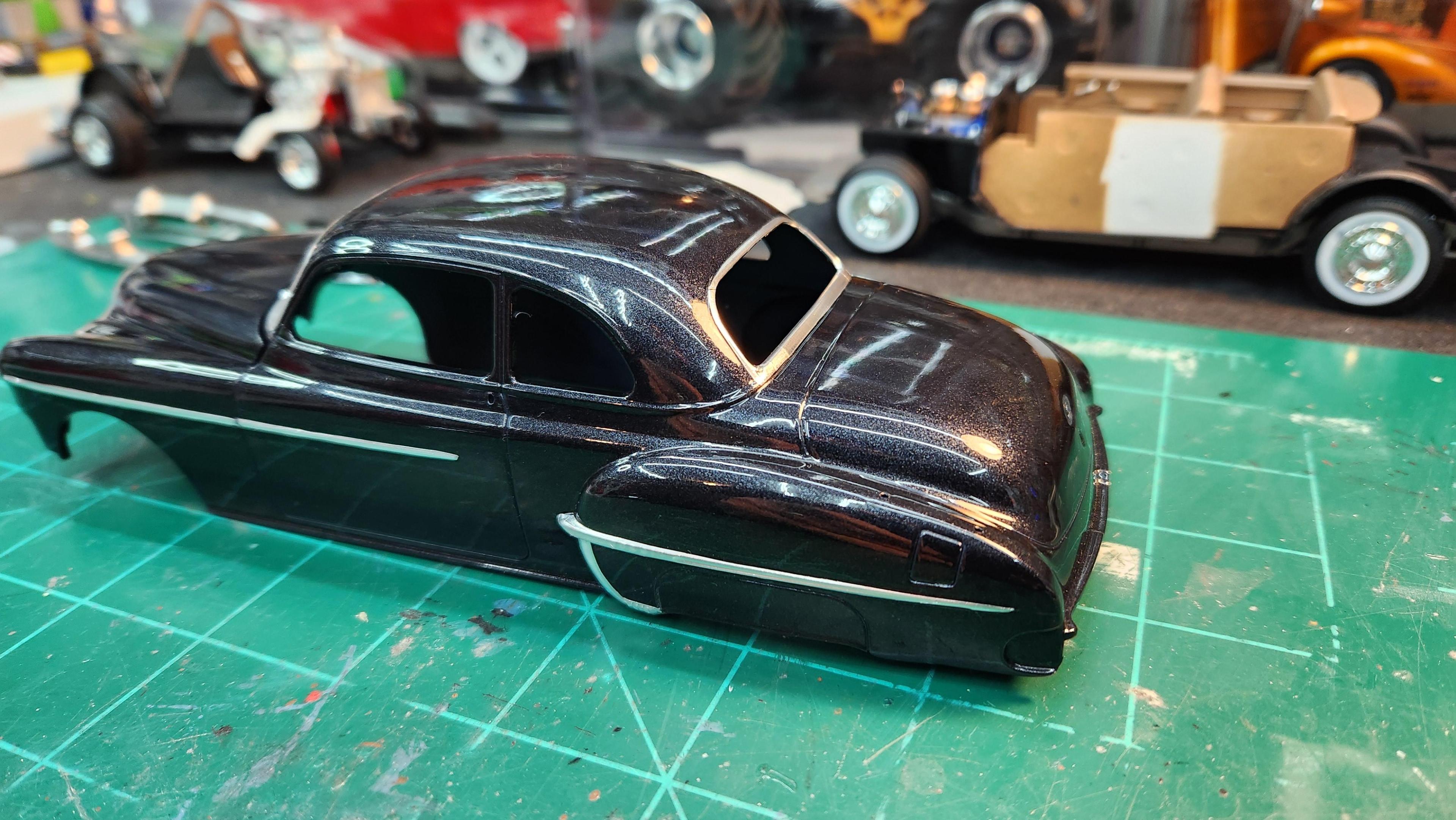

Zippi Posted November 23, 2024 Author Posted November 23, 2024 Well...I decided to just polish, polish, and polish some more on the hood. I was going to strip the wax off the hood and re-shoot a coat of clear but I was afraid I'd mess it up. If you fellows remember a while back the whole community was having issues with the bmf not sticking and tearing due to the company changing vendors. Well, I think I got an old sheet of the Matte Aluminum bmf from my local hobby shop because this bmf did not want to stick and it would tear really easy. I'm going to have to go back over the body and see if I can patch some pieces in where it doesn't look all that great. 3
