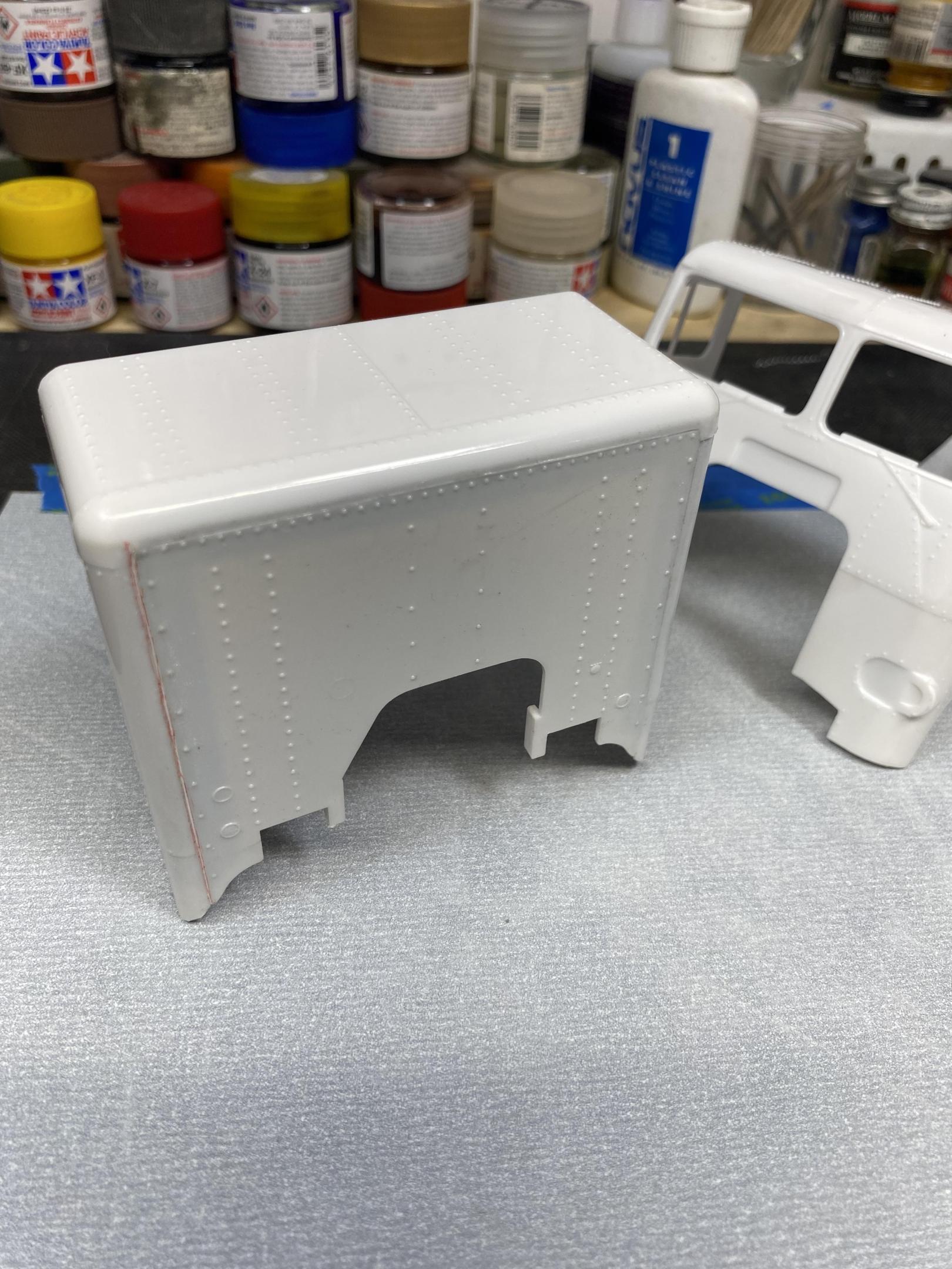

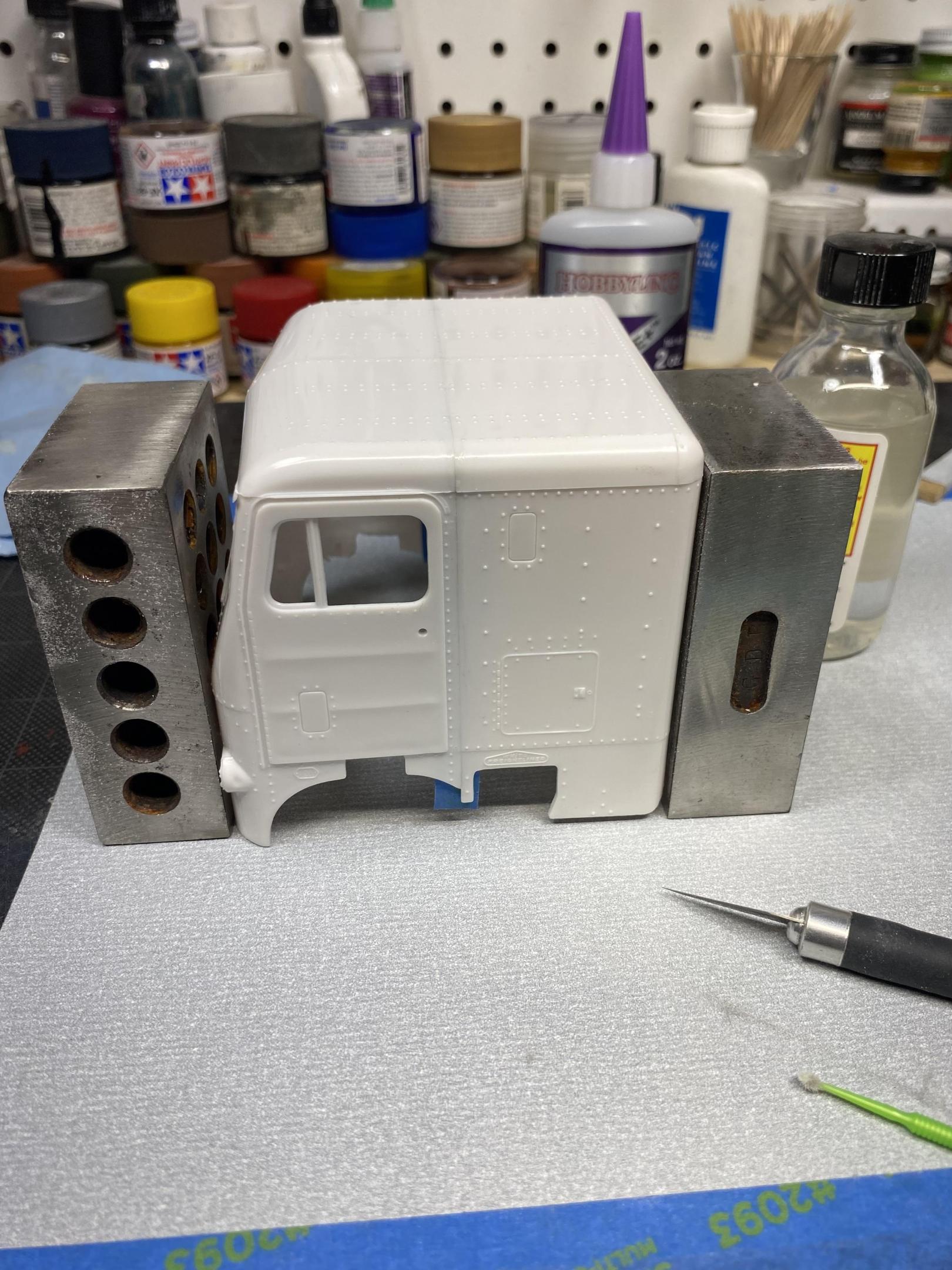

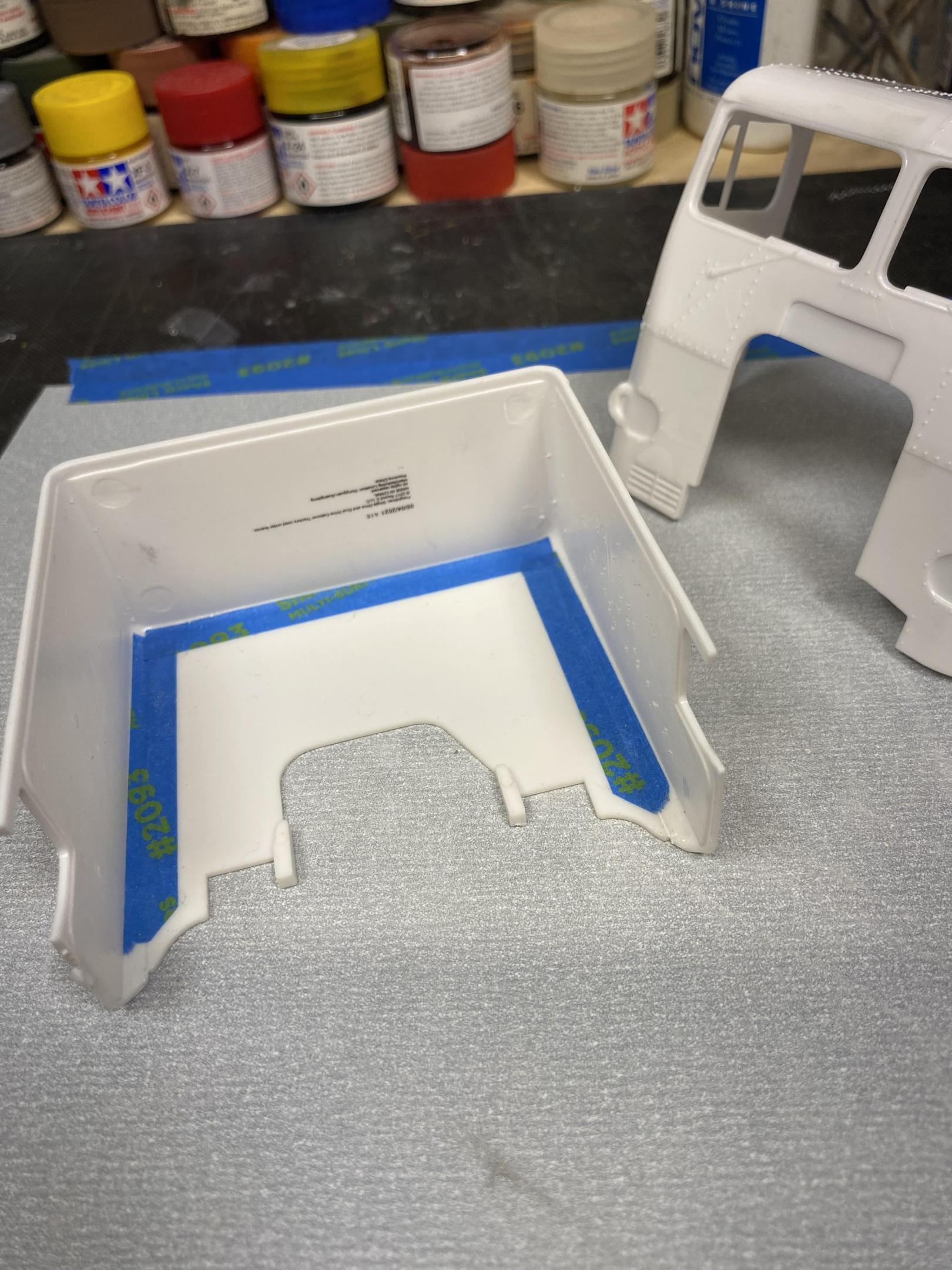

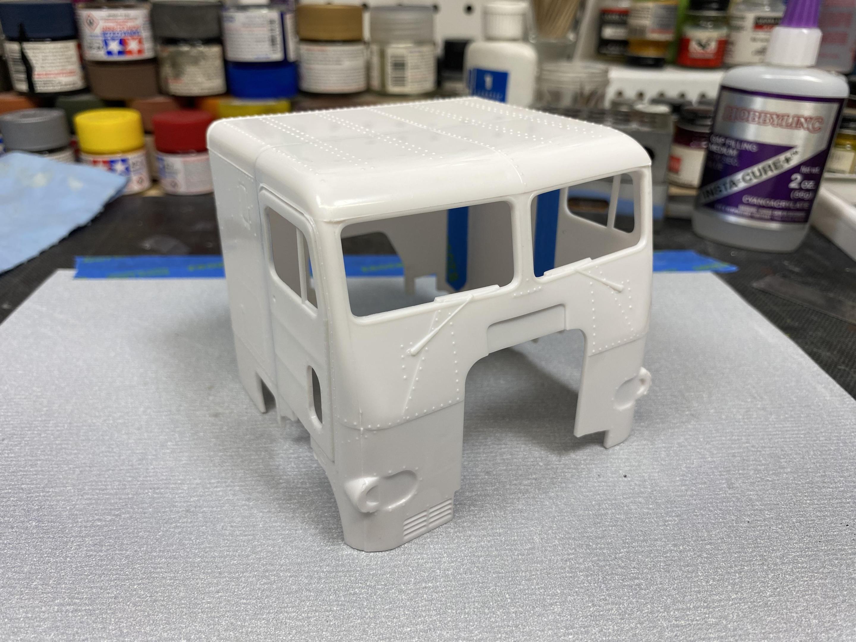

James2 Posted October 31, 2024 Posted October 31, 2024 (edited) Kit arrived on Monday 10/28, I opened it up for a quick glance and stowed it away, but I can’t leave it alone. After researching all the issues with the cab, I decided to assemble it today. I used a 220grit flat surface to straighten the edges and then tape and liquid cement to slowly glue the outside seams together. Then removed the tape and did the inside. The rear panel was undersized so a cut a strip of styrene (red) for filler and glued both side. So this will be my winter build…. Edited November 6, 2024 by James2 6 Quote

RoninUtah Posted November 7, 2024 Posted November 7, 2024 On 11/2/2024 at 9:56 AM, Gary Chastain said: The kit that you are using, did it come with two frames for tandem and single axle? If so the single axle (short frame) could be the donor for a frame section and should be the same height and width. Yeah, the AMT White Freightliner SD/DD kit is probably my favorite donor- you get two frames for the price of one; if you can dig up another front axle and suspension somewhere you get two almost complete chassis! I must have bought a dozen of these over the years and only built two straight out of the box. And one of those wasn't exactly straight out of the box, as I backdated it to the '60s. Looks like you're doing a great job with this one, I'll be interested in seeing what you come up with! Getting rid of the seam between the two cab halves can be tricky, I never liked that idea of AMT's. 3 Quote
James2 Posted November 8, 2024 Author Posted November 8, 2024 6 hours ago, RoninUtah said: Yeah, the AMT White Freightliner SD/DD kit is probably my favorite donor- you get two frames for the price of one; if you can dig up another front axle and suspension somewhere you get two almost complete chassis! I must have bought a dozen of these over the years and only built two straight out of the box. And one of those wasn't exactly straight out of the box, as I backdated it to the '60s. Looks like you're doing a great job with this one, I'll be interested in seeing what you come up with! Getting rid of the seam between the two cab halves can be tricky, I never liked that idea of AMT's. I am glueing the frame together next, hopefully I can keep things straight and untwisted. Taking my time, using machinist blocks, clamps and squares. I think it will be good. I also took a fair amount of time prepping the body and glueing the seams together kind of like a plane fuselage. The seams turned out pretty flush and I'll be trying some Archer resin rivets when the time comes. I am debating on lowering the headlights too, I have an idea that might make that relatively easy. 4 Quote

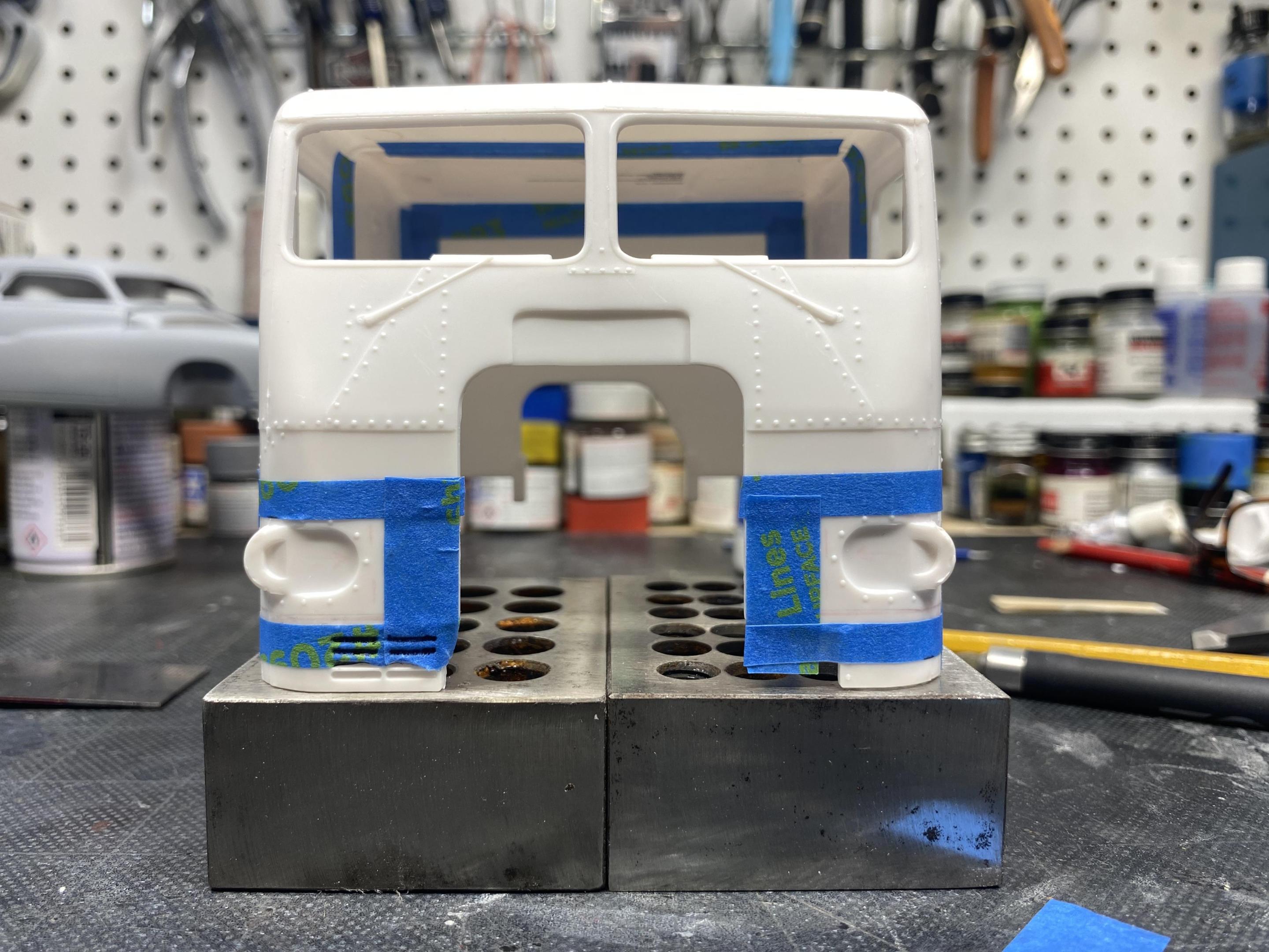

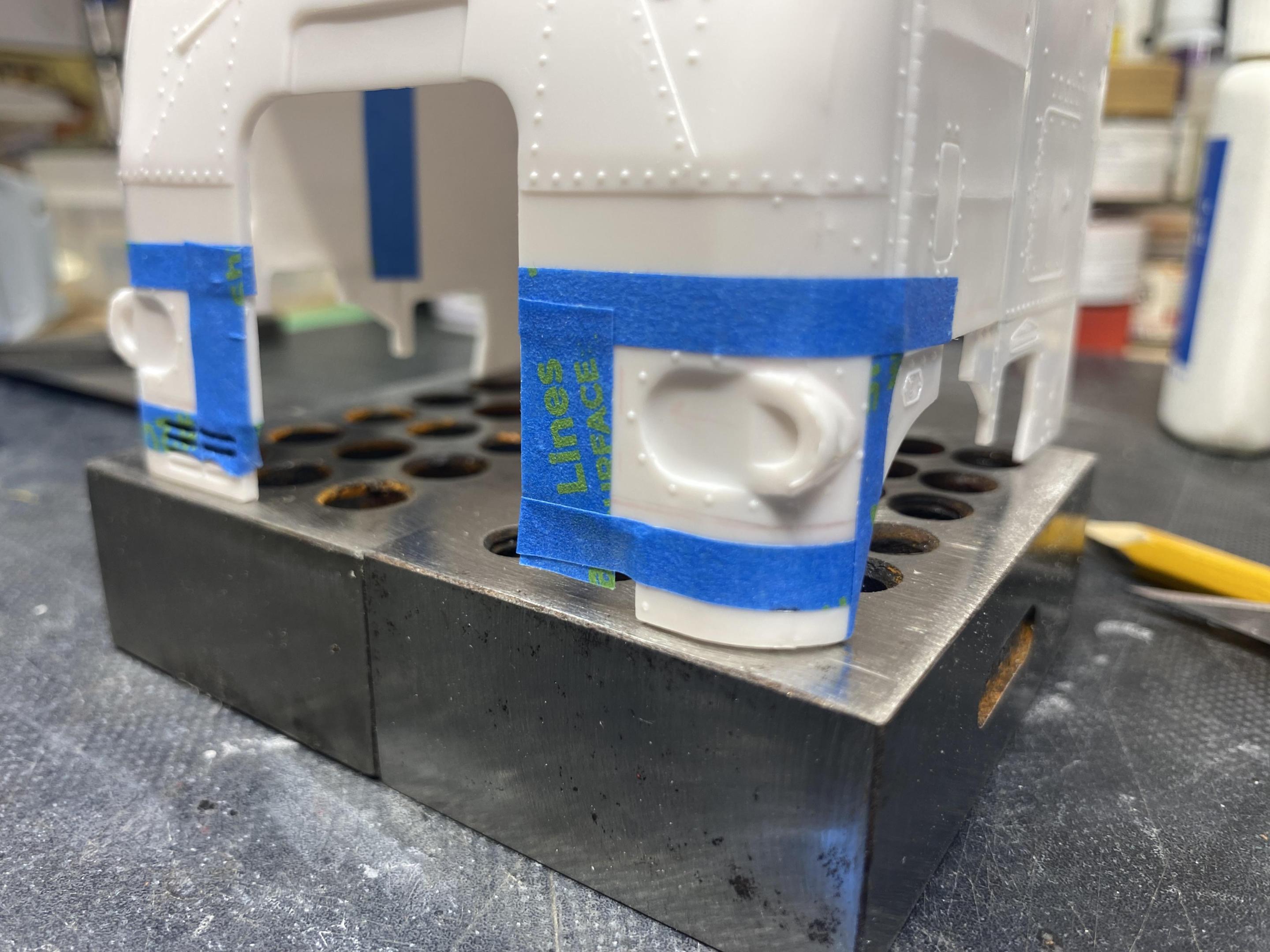

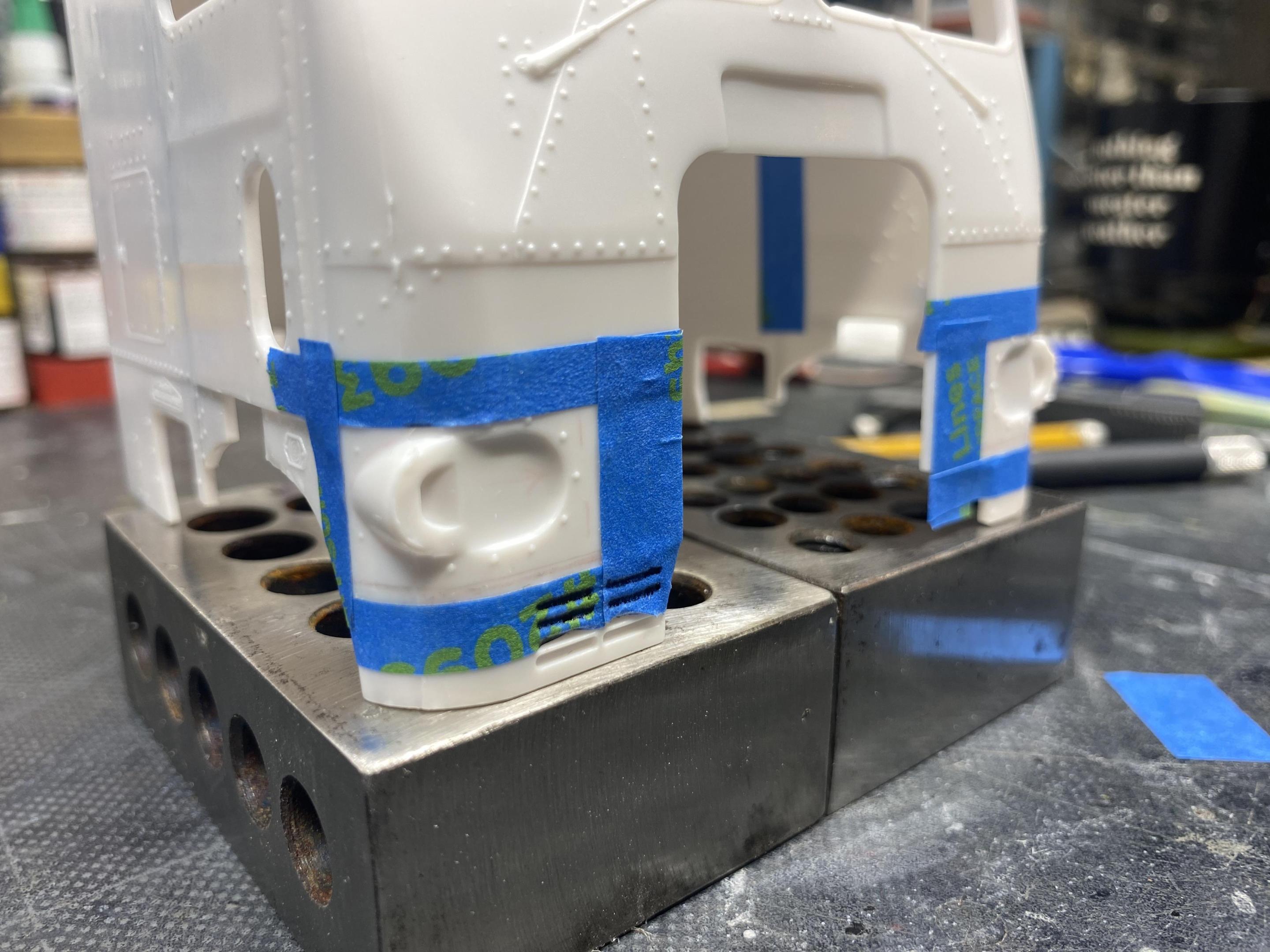

James2 Posted November 9, 2024 Author Posted November 9, 2024 Preliminary set up for the head light correction. My idea is to remove the pieces inside the blue lines and then switch left for right. The offset layout would allow the lights to set lower with minimal damage to the cab. The hard part will be keeping both pieces the same size. Any thoughts? 1 Quote
Jürgen M. Posted November 9, 2024 Posted November 9, 2024 Interesting approach! Hope it turns out as you expect! I'll keep watching! 1 Quote
RoninUtah Posted November 9, 2024 Posted November 9, 2024 I did something similar my first time I tried to tackle that correction. I couldn’t get them back into the right position, though, and it wound up looking a little cock-eyed, and with weird lumps when I tried to grind and putty it all smooth again. The second time, I just ground everything off, drilled in the right places, and then built it up again. I converted it from dual headlights to singles, though, so yours will be different. Also, I suspect that you will be better at the bodywork than I was. Good luck! 4 Quote

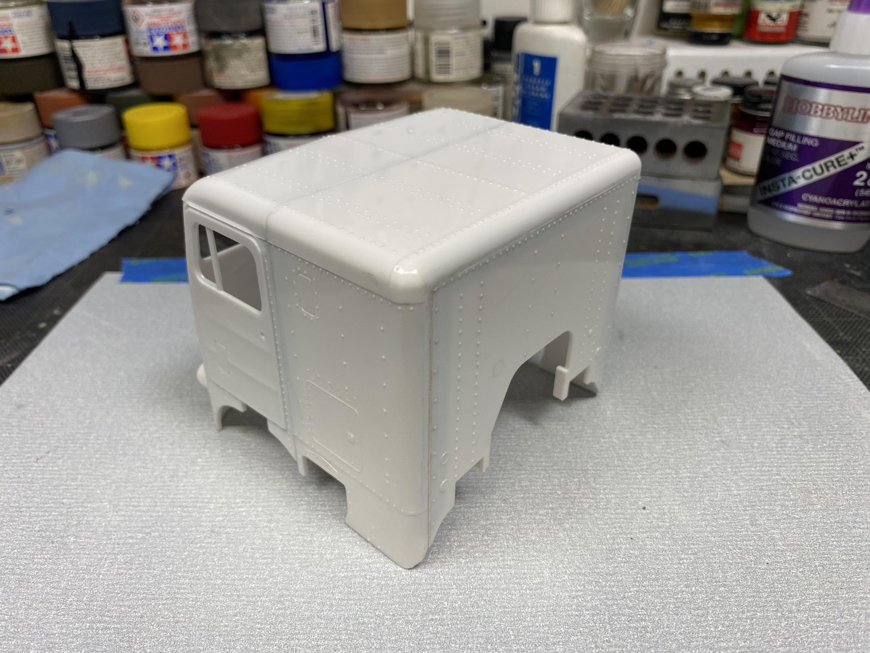

James2 Posted November 10, 2024 Author Posted November 10, 2024 Bench time today. I took a stab at smoothing the roof seam first. After a light coat of primer, I do believe I can get things figured out from here. Also flipped the headlights around to represent the 1:1 truck better. Some more careful smoothing to come. Thoughts so far? 3 Quote
