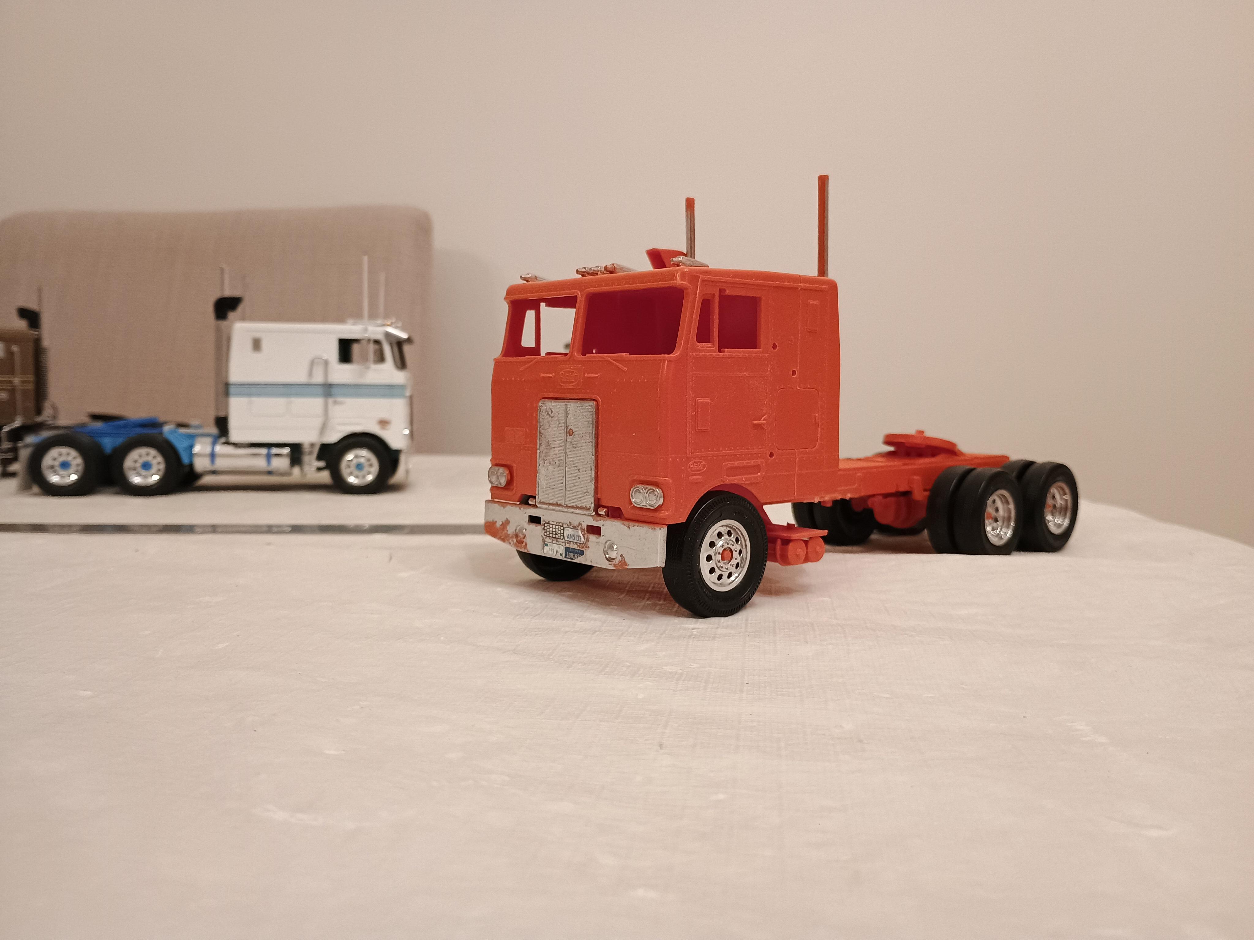

I've already admitted I'm a trailerholic, now I'm suffering from a Caboverdose. I scored this for less than £20 off Extortionbay in August. It's a bit grotty, first job was to give it a scrub in the sink. Chrome is in poor state but we can deal with that.
In the middle of about four projects I found myself stripping everything off the chassis and marking and cutting the cab down from a double to a single sleeper. The chassis is 184 inch. It's not being shortened, should I add a little to it?

It must be Peterbilt cabover season! Looks like this one will be a worthy addition to your fleet. Nice clean job cutting the cab. I'd leave the chassis long, it looks like a West Coast rig of the early 70s.

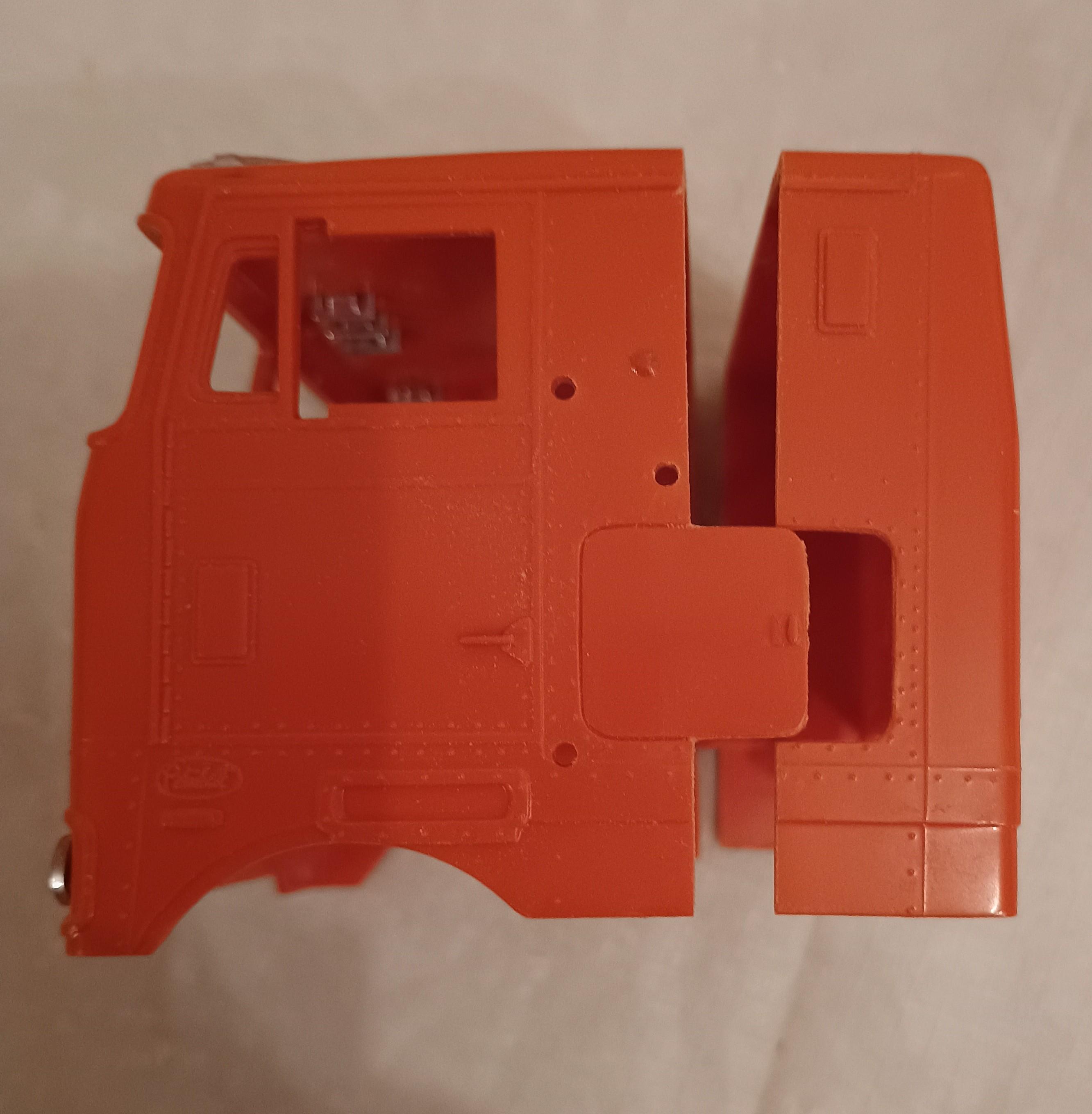

I worked my cuts out as the distance between the rear edge of the locker doors, about 18mm, then used a square on the roof and the lower edge making sure the lines all meet so they were square. Brand new saw blade and just allowed blind terror to ensure careful cutting. I cut to the outside of the lines then just carefully filed the edge down until they mated pretty well. Holding the seam up to a lamp let's you see the high spots.

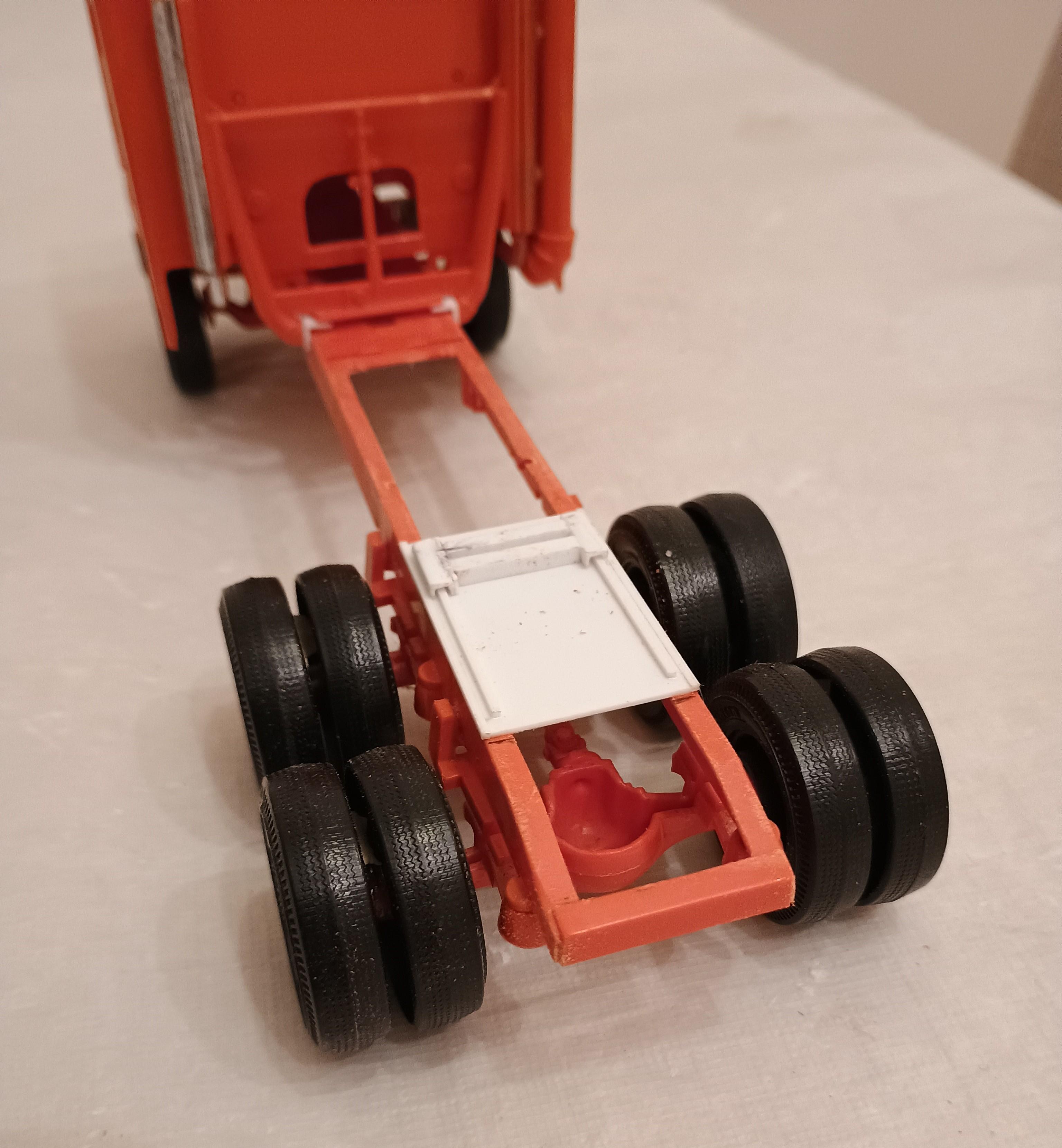

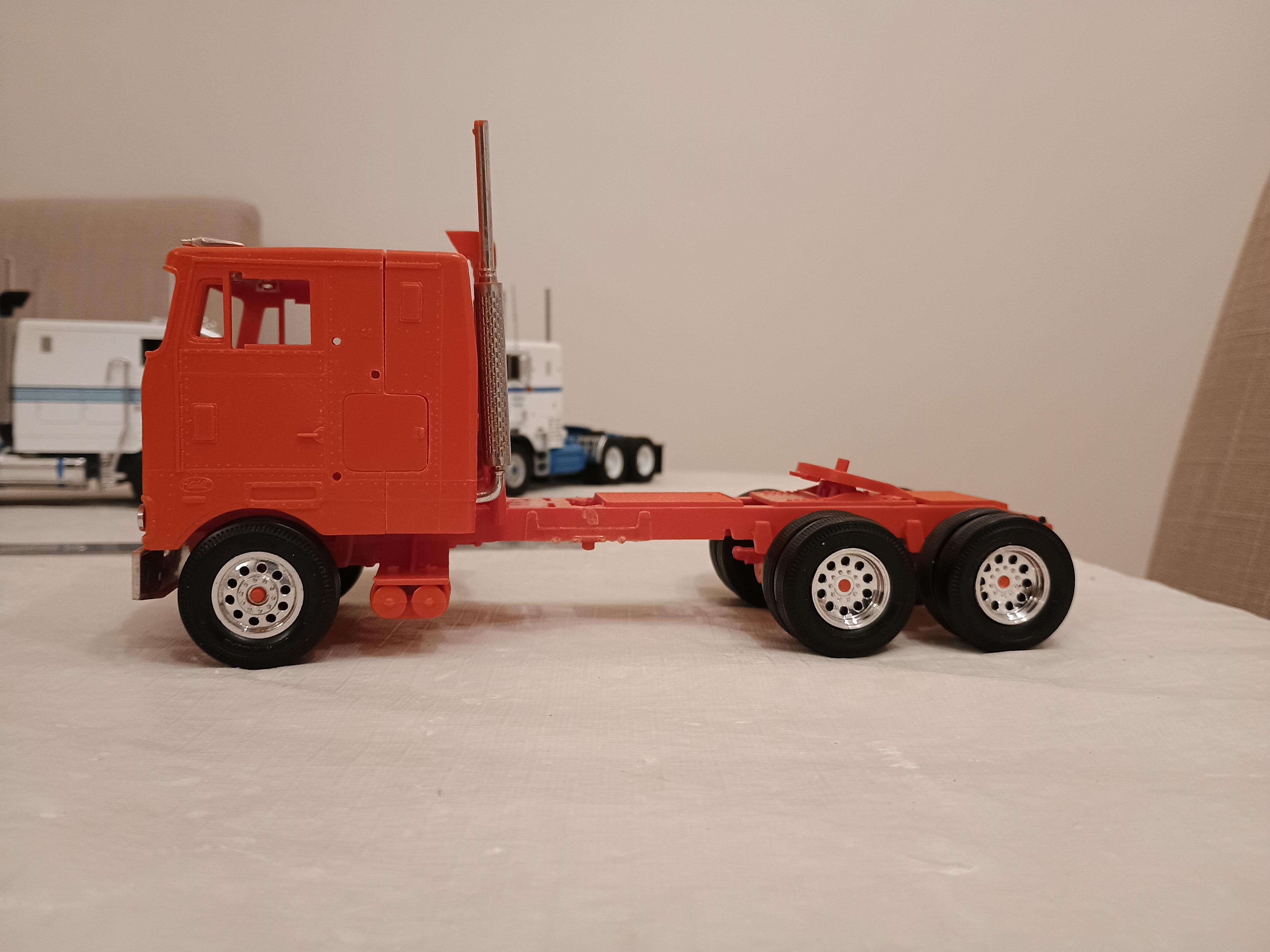

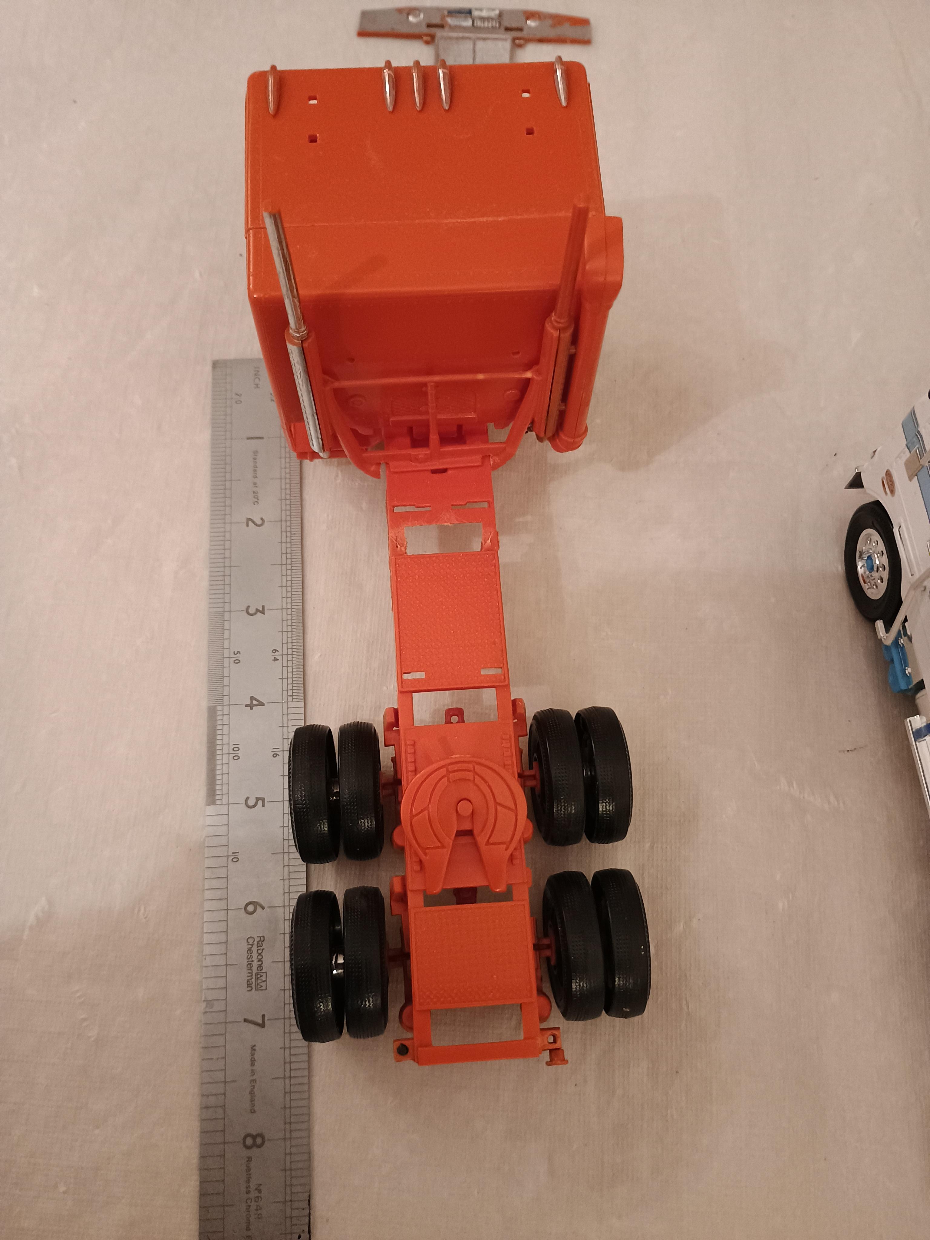

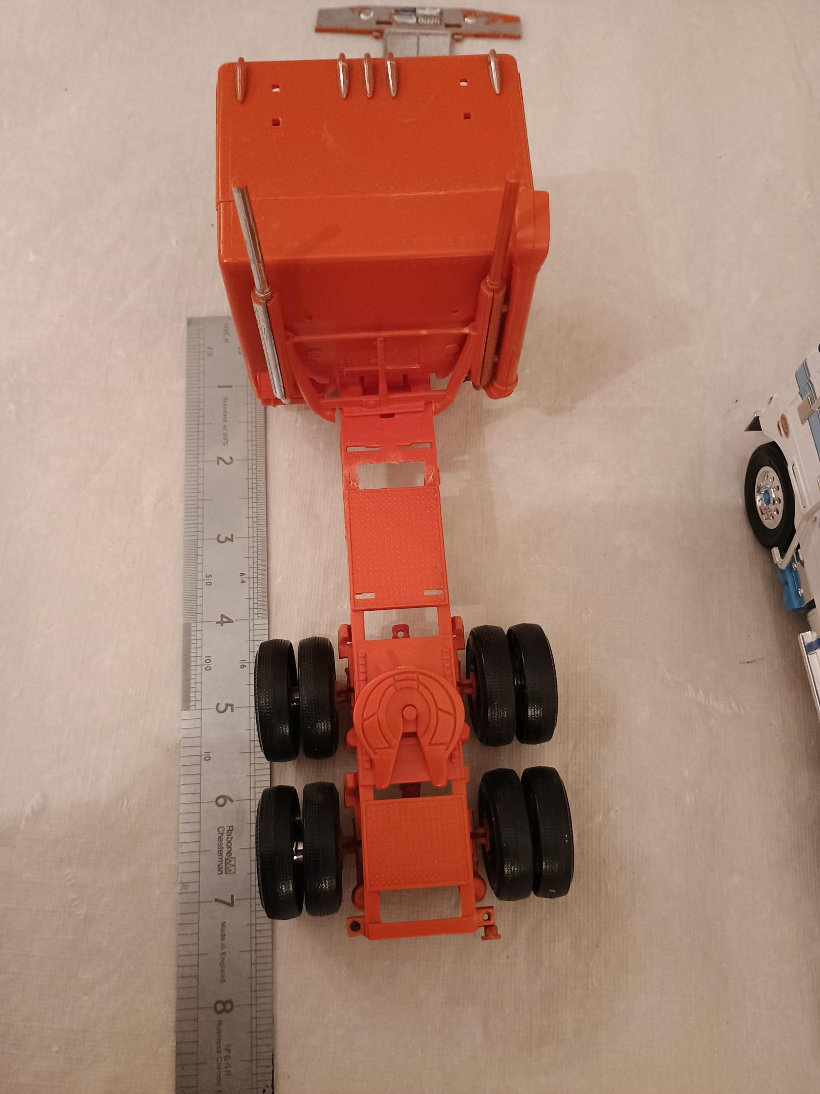

Managed some time on the Pete today.

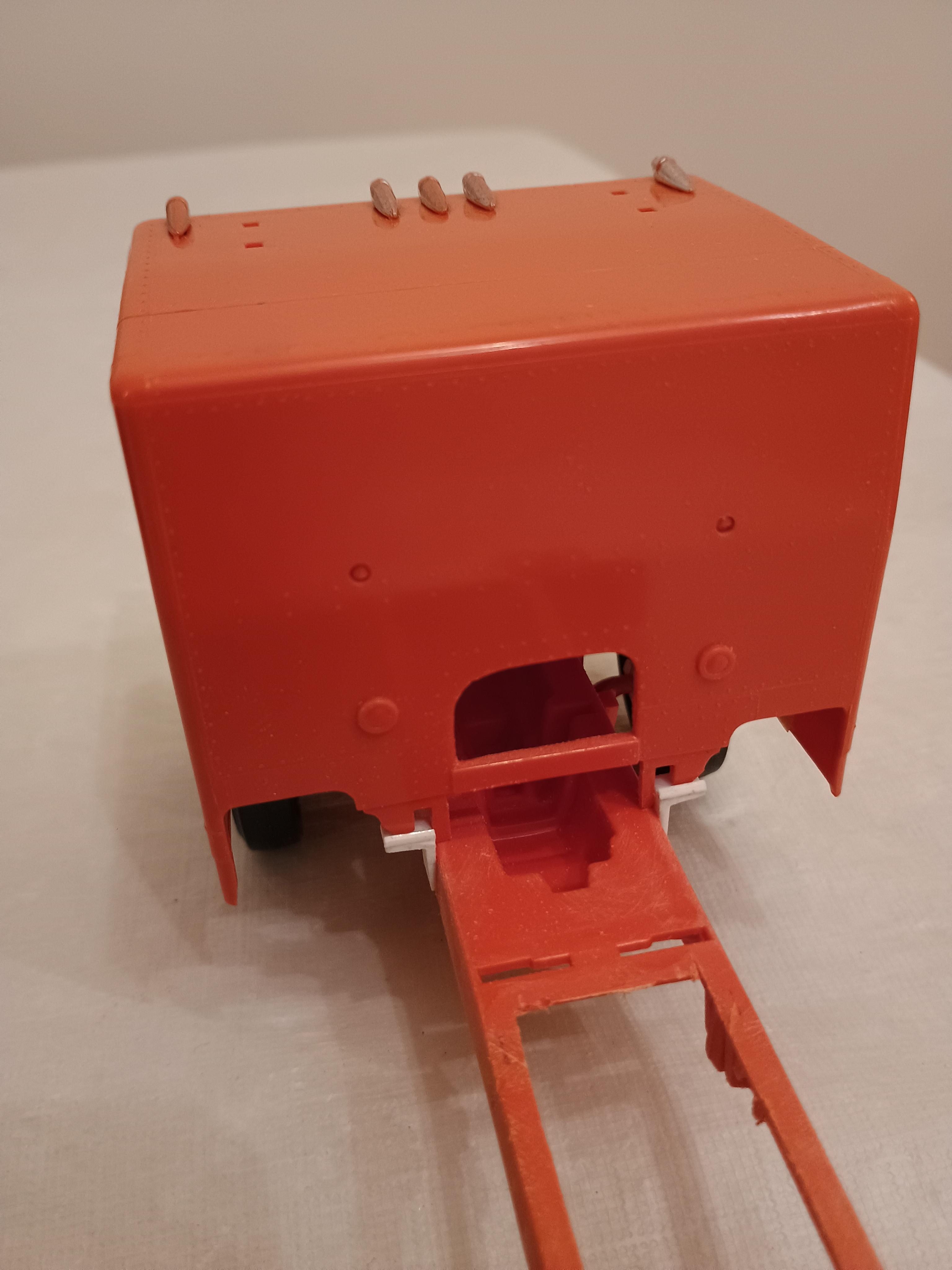

Opened the doghouse grille at the back, started some rear cab mounts so I could cut away the snap fit location.
Removed all the deckplating and the slide plate for the fifth wheel and started making a functional one. Also, deepened the rear wheel dishes which spoil the look of these trucks.

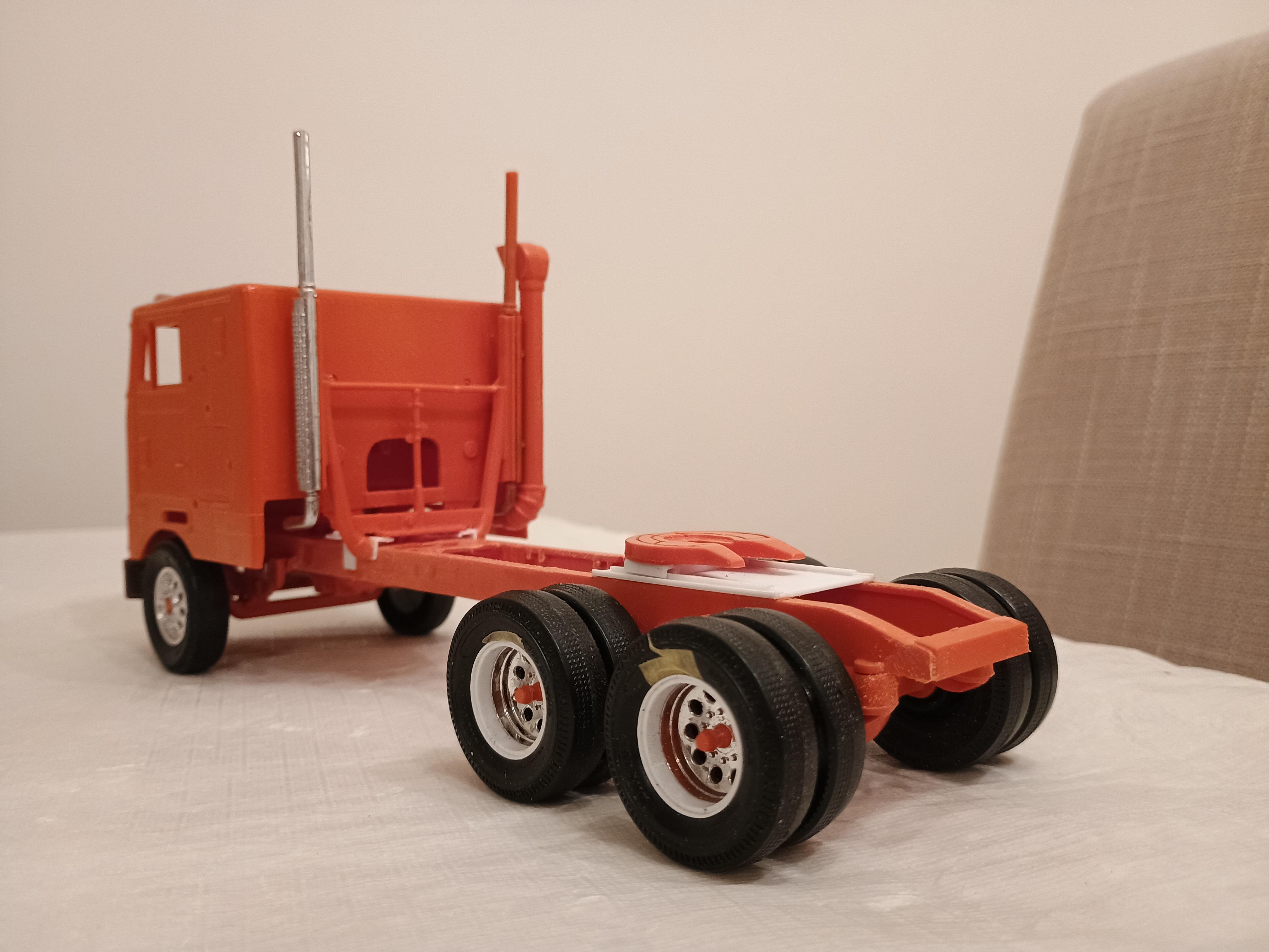

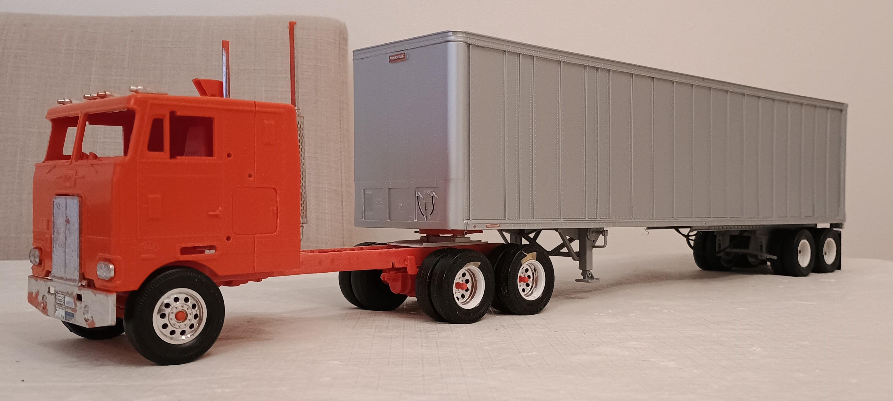

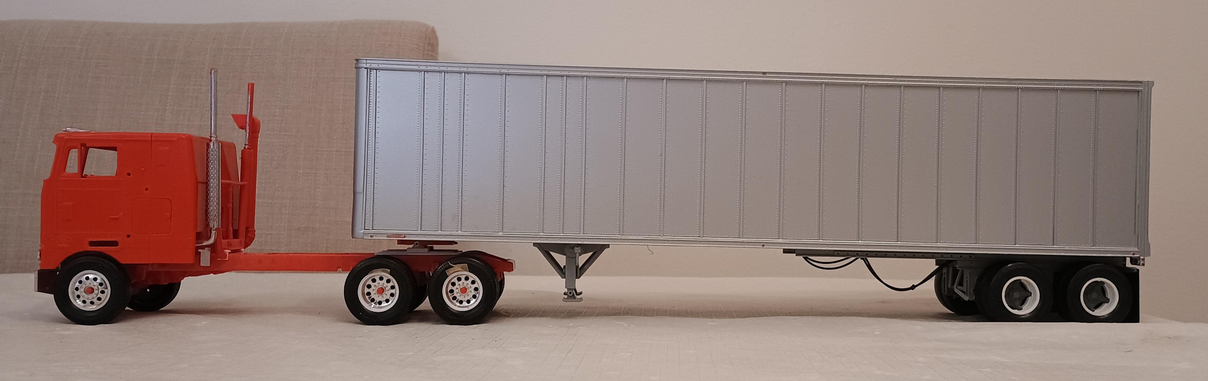

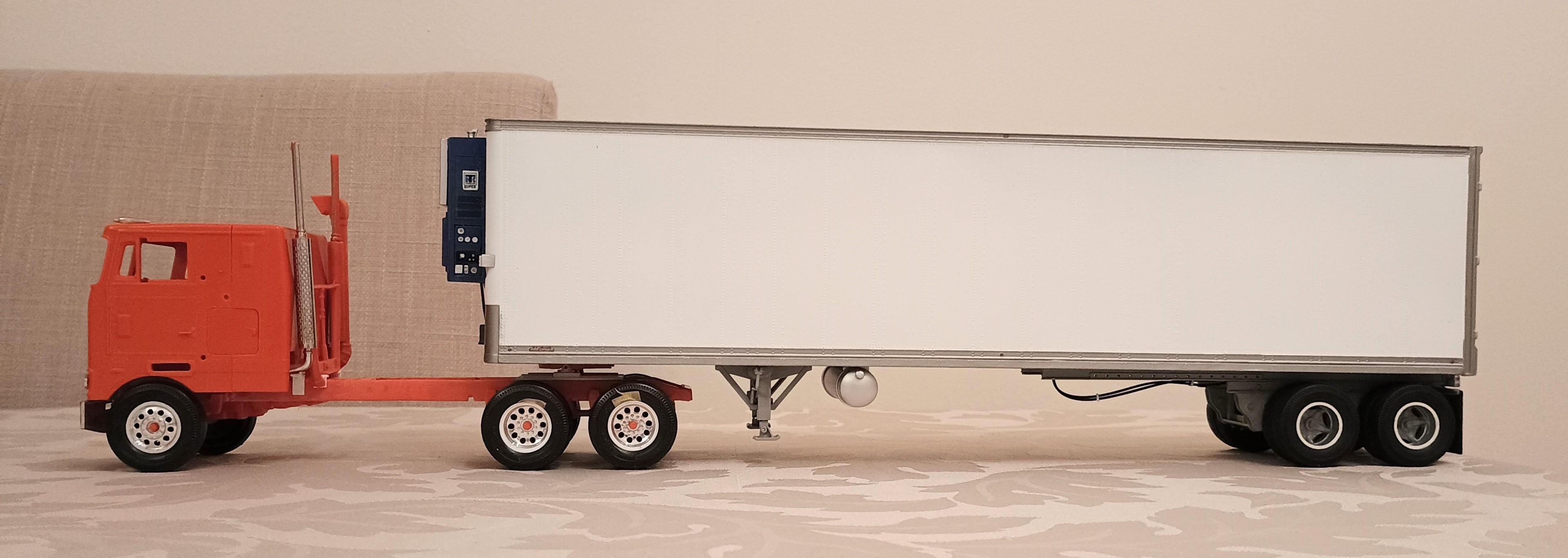

Got my fifth wheel fitted this morning and then couldn't resist getting a trailer on it to see how it looks...
Nice but let’s see it hooked to one of you awesome Reefers.
  • Like 1
  • Thanks 1

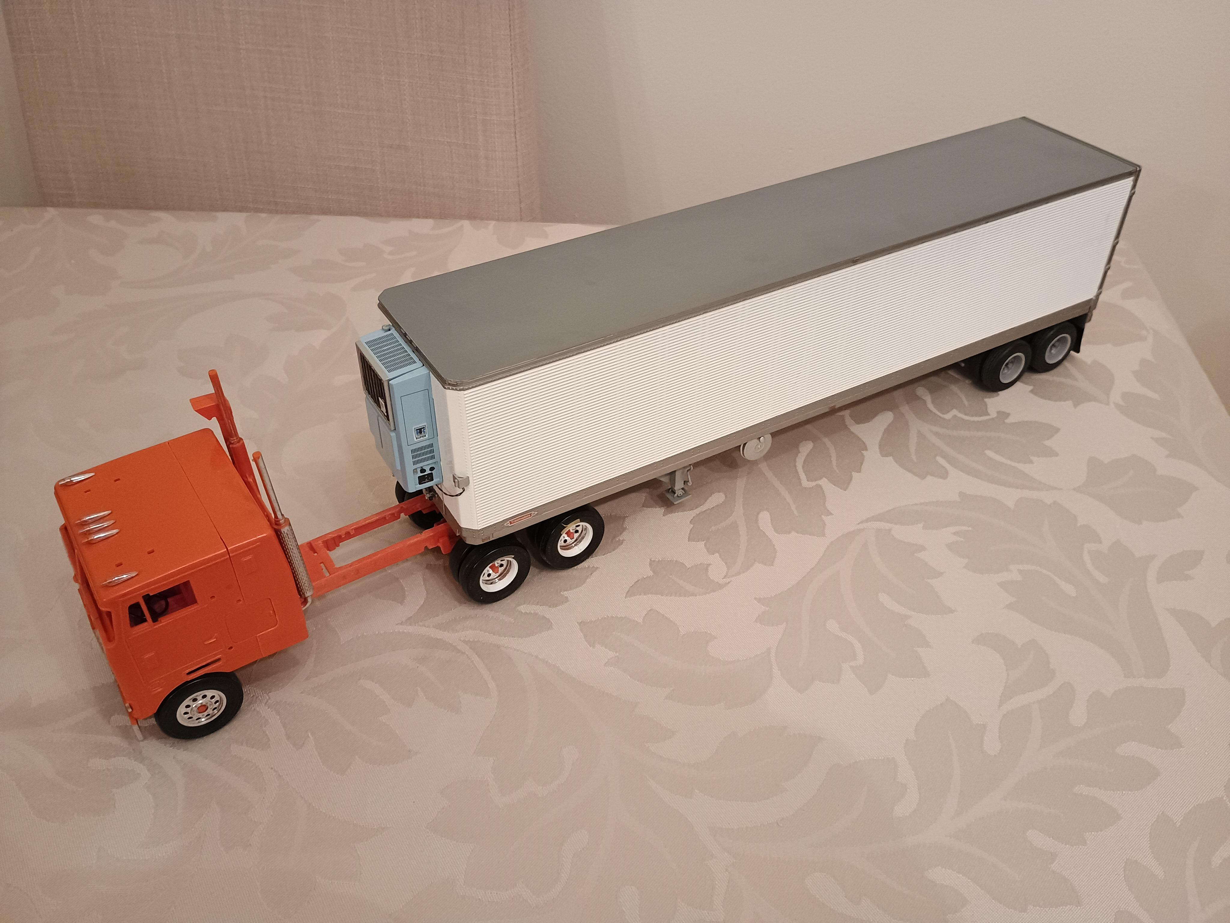

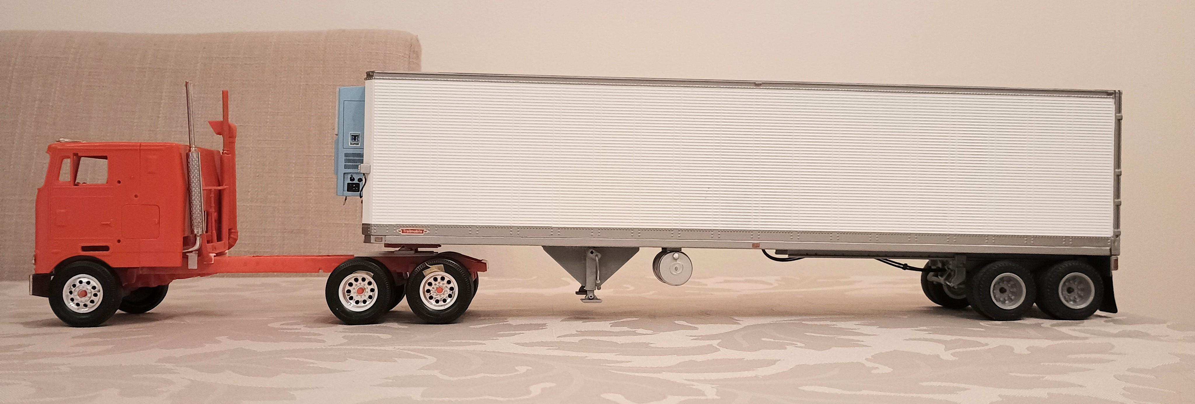

Here goes lads,reefers as requested.
I thought I'd include a flatbed.

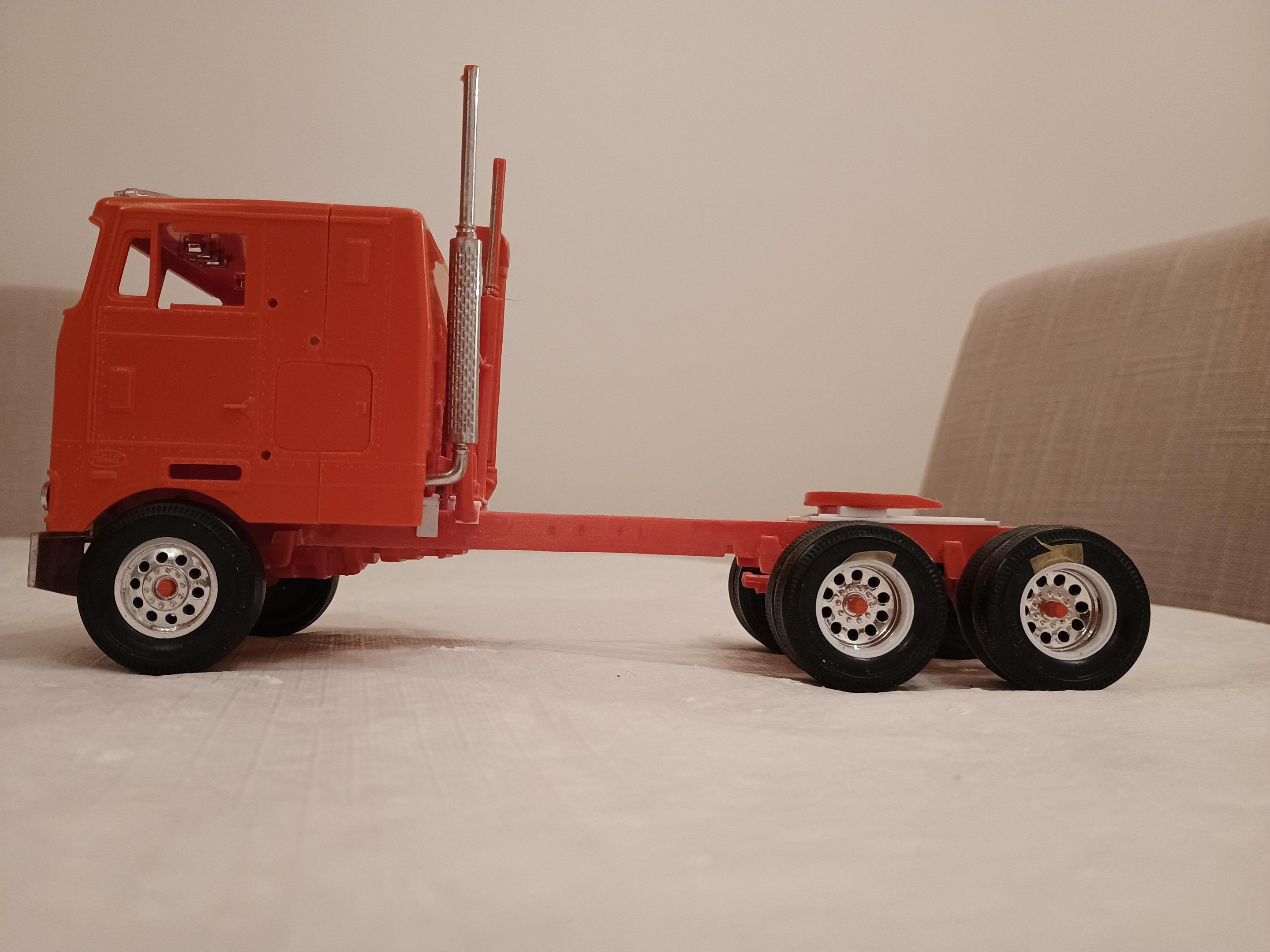

Here's my inspiration for this truck.

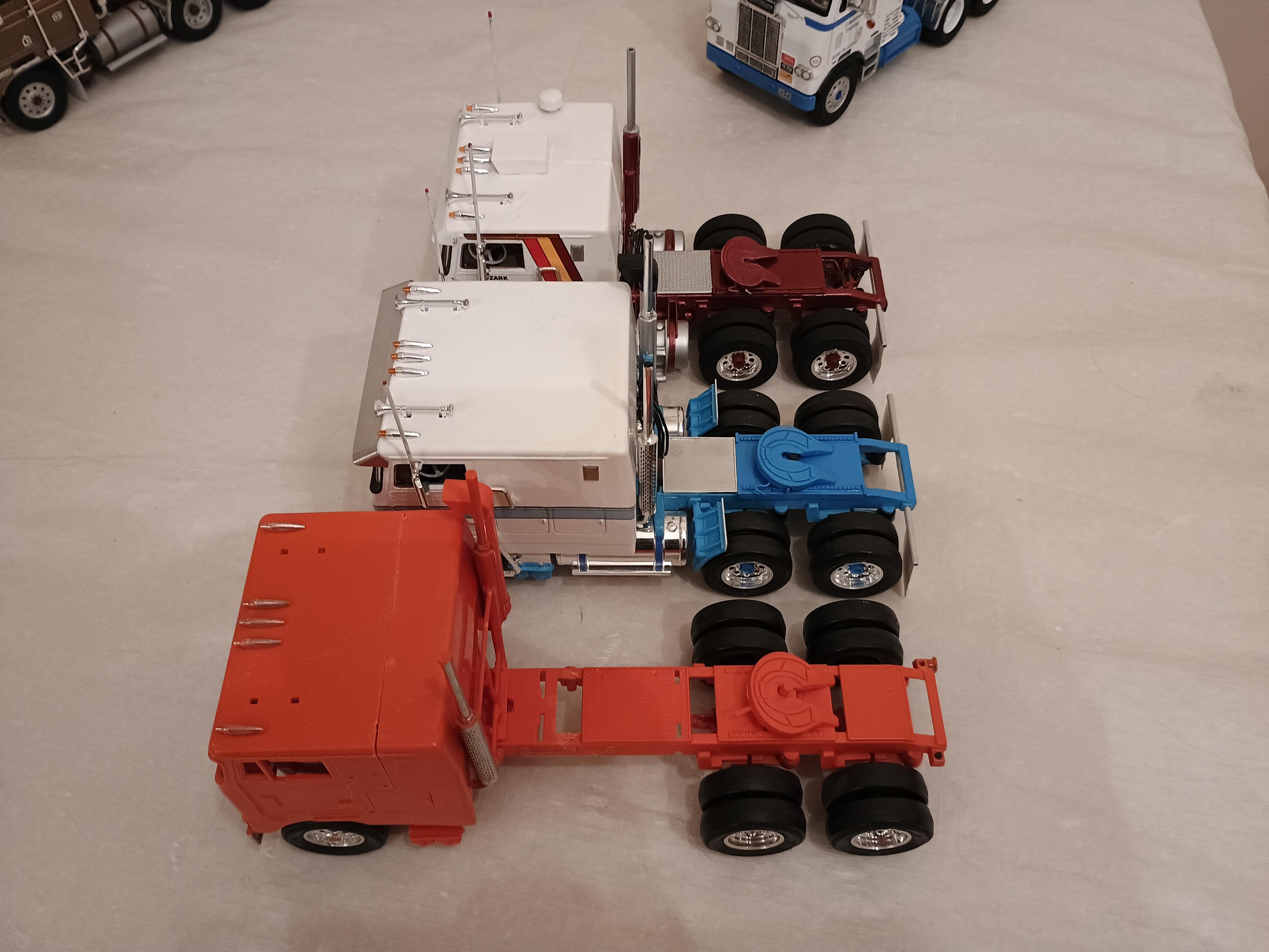

Could actually be longer, should I?
I have never had a good explanation for why people would run a cabover on such a long frame. This doesn't look like it's been a "drom"because of the position of the pogo stick and fifth wheel. Why so long and not a conventional? I suppose you could say Freightliner didn't make a conventional at the time but these trucks aren't alone.
  • Like 4
Great work on this cabover, a big fan of the longer wheelbase tractors and sure this one will come out looking fantastic. Trucks were custom built to customer specifications, IMO, most of these long wheelbase cabovers were originally bought to transport oversize long pieces, so the overhang was more on the truck frame instead of rear of trailer. Others may originally had drom boxes. The WF in the photo is probably with its second or third owner, pogo stick could have easily been relocated.
