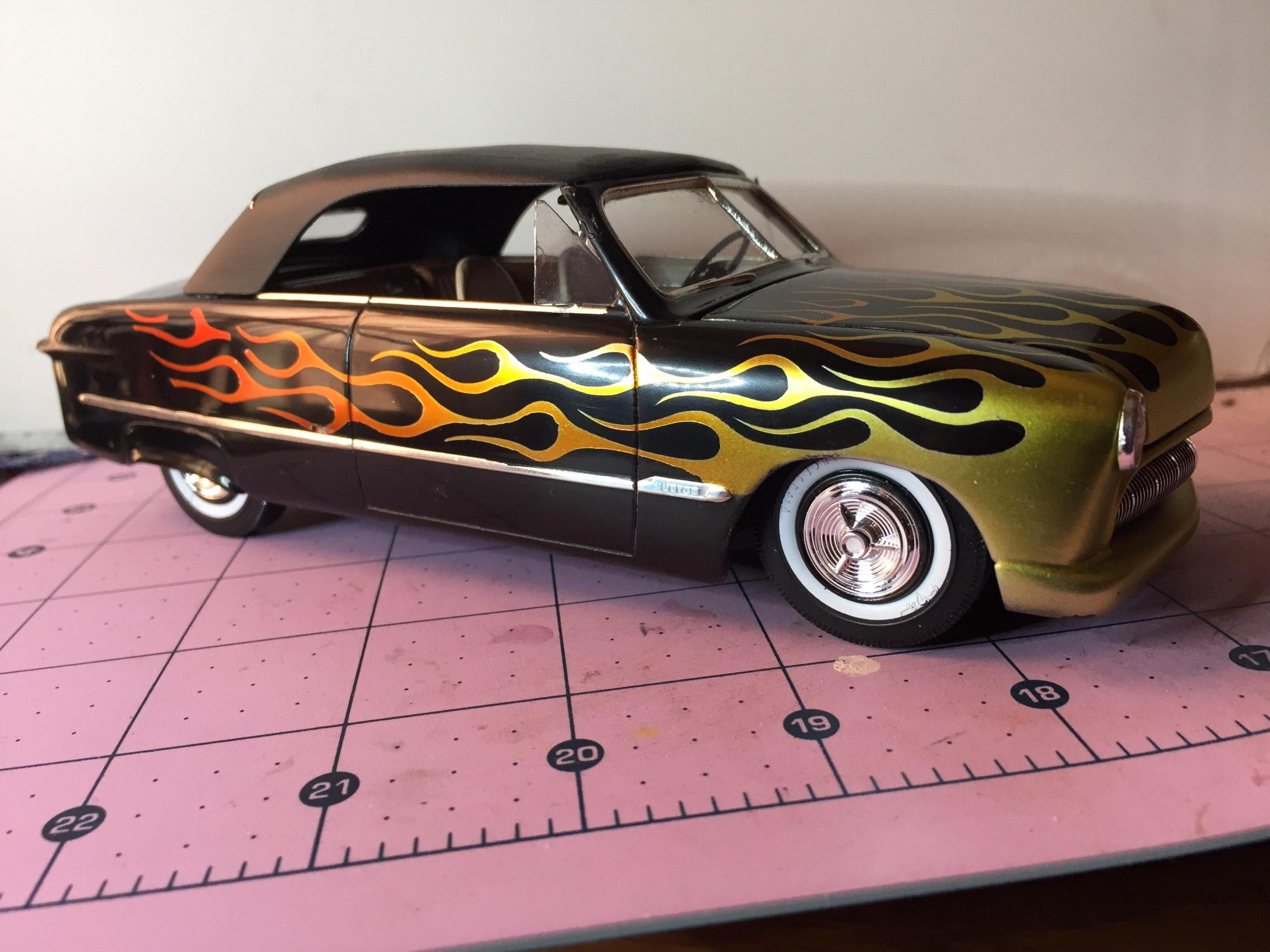

OK, sounds good, I'll leave you with some inspiration

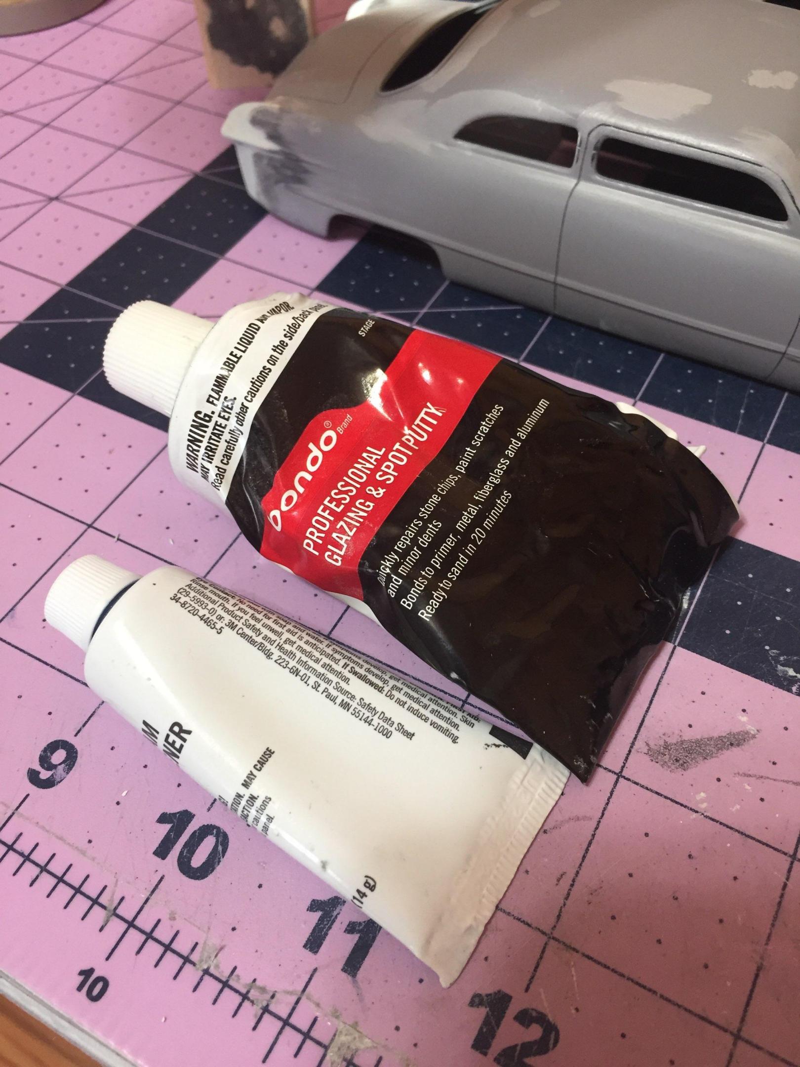

Loving this build Dude! The tail lights are KILLER! May I inquire about the brand body filler you're using?

BONDO!
edit: good BBQ is something that's plentiful around south-eastern VA. 😛
it's the glazing putty, the "professional" catalyzed type. I've been having trouble with quality lately with both parts. I guess when it sits on the shelf for a while it gets like a bottle of ketchup and the watery stuff comes out first, but I just deal with it.  It makes the job really fast, you can stay on it with very little waiting between layers.

If it's the stuff in the 30oz bottle just store it upside down and flip it upright a few minutes before you need to use it.🤔

This is what I use and as you said the watery stuff rises to the top. I store it upside down and shortly before I need to use it I turn it right side up. Helps to keep the watery stuff suspended.

This is what I'm using for the actual body contouring 👇. Its thick enough to use as body filler.  For "glazing" duty, I use Mr. Surfacer 500.
IMG_7147.thumb.jpg.dbc5fe58711fd6a1e14daa27542d94fe.jpgI sorta hafta  purge the watery stuff, there's just no other way. ☹.  But the convenience outweighs that little "drool" issue.

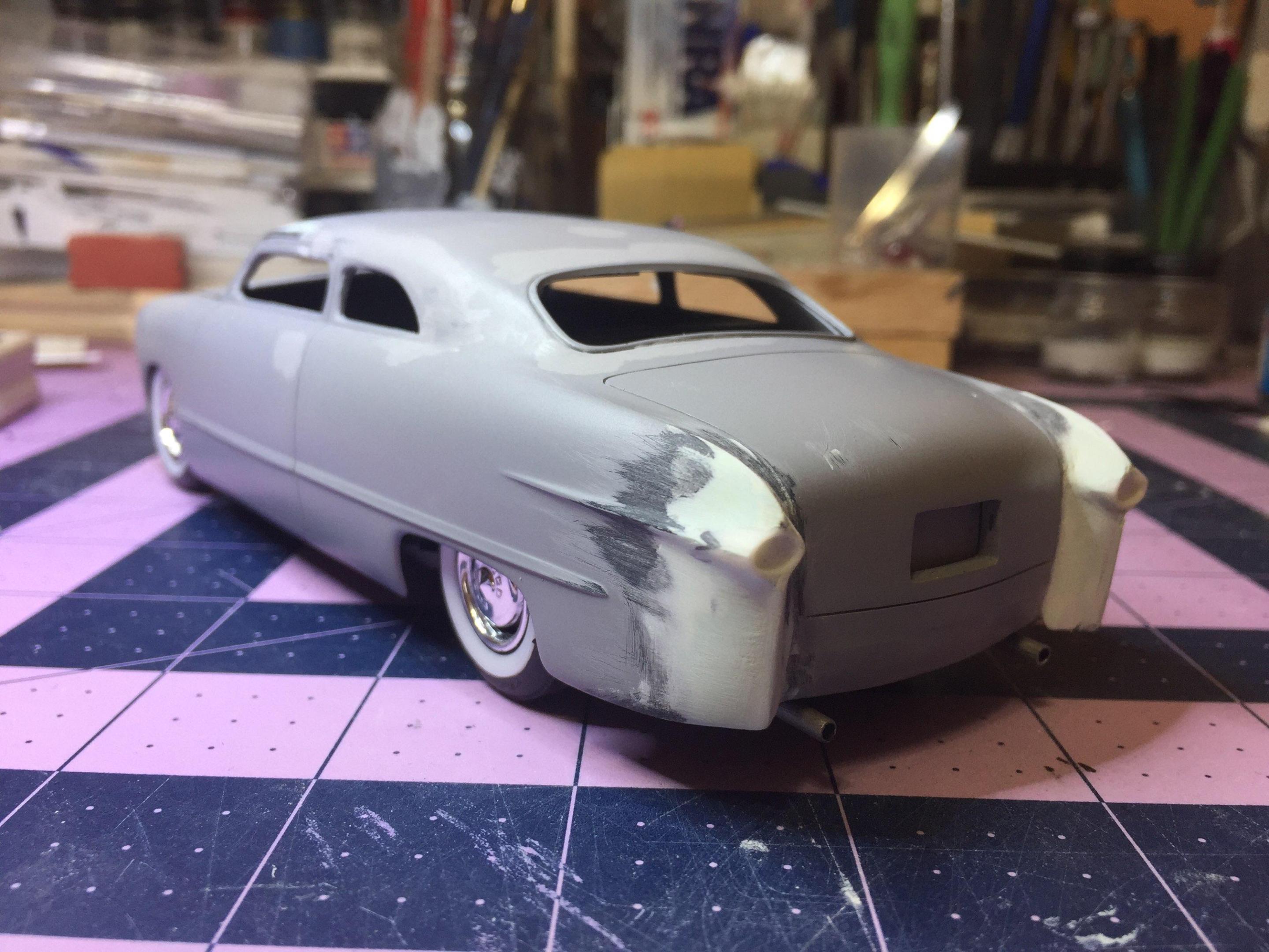

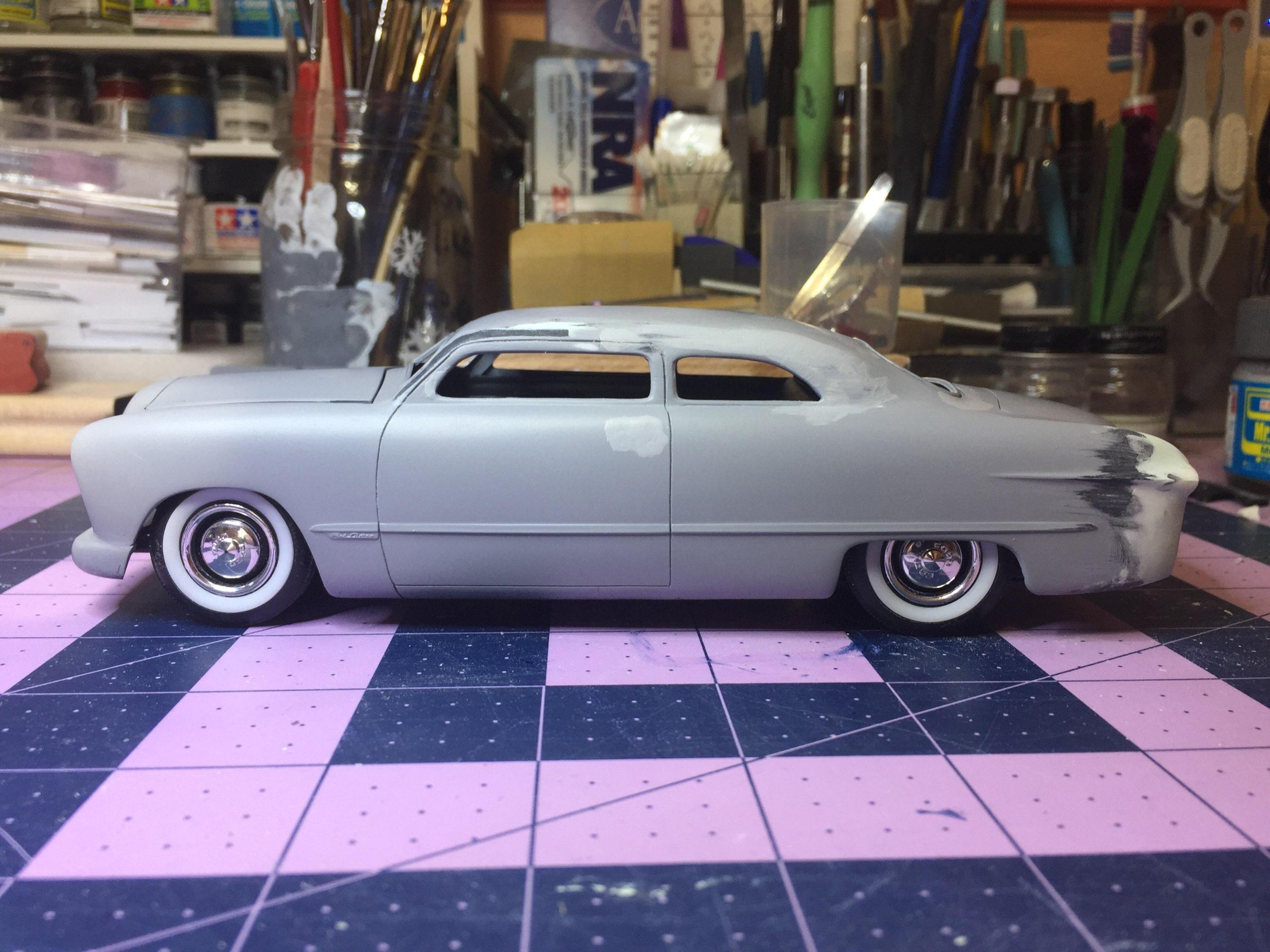

Here's a mock-up
IMG_7148.thumb.jpg.34a9d136a67020abd140cb3512a5ff29.jpgIMG_7151.thumb.jpg.a0c298970e89d36f5b6c80c6f5d1374d.jpg
As I look at these two photos I'm thinking that I need to re-think the area below the light pods. I gotta get some primer on it 🤔 I can't do much with the very bottom, Len, because the chassis comes into play.
There's not much body below the chassis so it's a "take it slow" situation.

Same kinda stuff, just different brand.
Looking good but the area below the light pods needs to be "softened" a bit. I assume you are going without bumpers.
I think maybe a bit more than that, Len. Before I do any more, I need to sand the surface spots and get an overall light coat of primer for a better visual.
Yeah, I hate bumpers. You're not supposed to bump anything. Most self-respecting lead sleds sport big bulbous bumpers. I like a cleaner look.

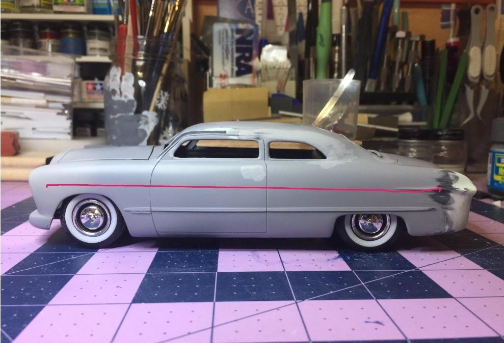

Someone mentioned moving the trim on the side. I just doodled on my phone, as I'm curious about the trim on the Hudson I have in the works.
I am in no way, shape, or form, considered an "artist". I can't draw a stick figure.

I think I know what you are trying to do here, Topher.  Is this it, give or take?

I think by removing the lower trim, and adding an upper piece you could break up the profile some.

That seems to be the prevailing idea, which I agree with. My plan, however, is to temporarily foil the existing spear after priming the whole car again ( it should warm up soon 🥶 )  and reassess the situation. Let's see if the stock trim works well enough.   There are other options. 👇🥴

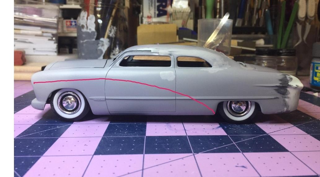

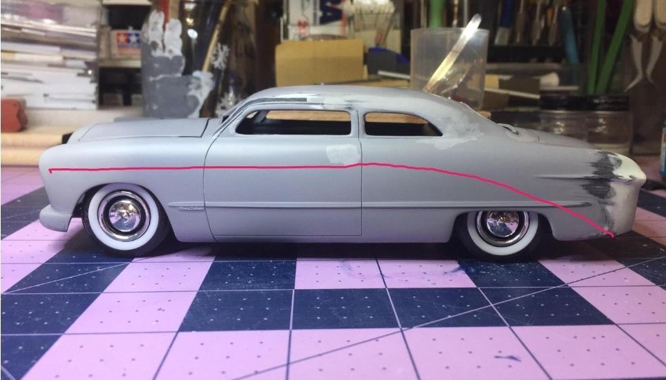

I was thinking something more like this.
I was just reviewing and found this (don't know how I missed it 😒) and it took me several "re-looks" to finally get the picture. How in the he'll did you do that? Moving the spear up does look better but in the rear it runs too close to the wind split but it accomplishes the goal.  Your side trim cred is good with me, Len, but I'm taking it slow until I have seen the big picture more clearly. I worked the rear mods a bit in the wee hours and I hope to get primer on it at half-time 🏈 🥴 🍺 when, hopefully, it reaches 50F. 🌡
I agree it runs too close to the wind split.  Thought of terminating it earlier or kicking it up before the wheel opening and having it align with the wind split.  Not sure about the last option.
short2.jpg.ed78f39d074c98ea21f79ae3e8f2403f.jpgshort1.jpg.22815c20095d9383aa99081cab432b28.jpgtwist.jpg.1dfda4dcbe97e7eeb10aac35f7f98384.jpg

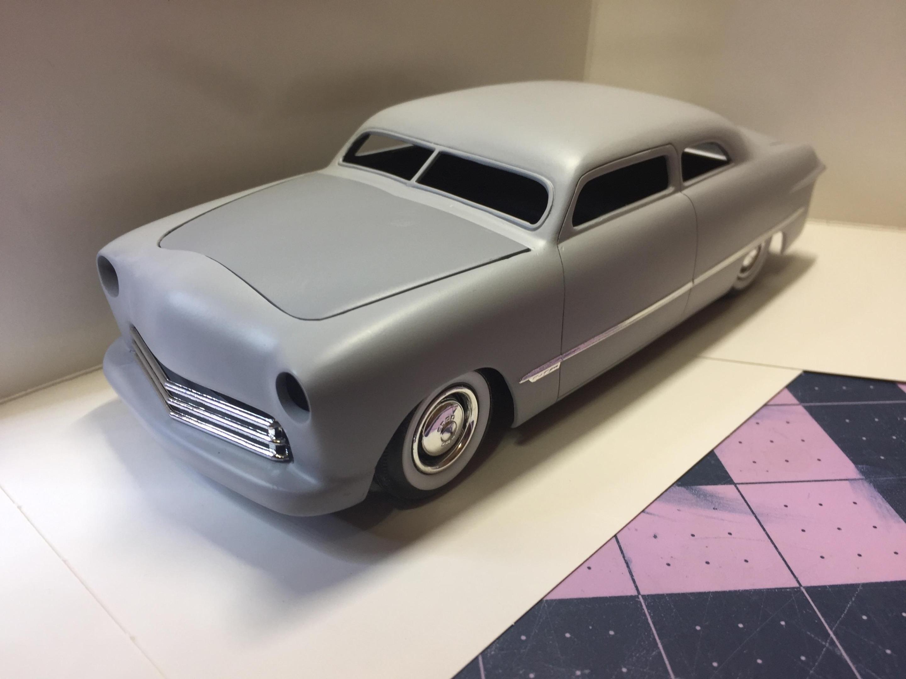

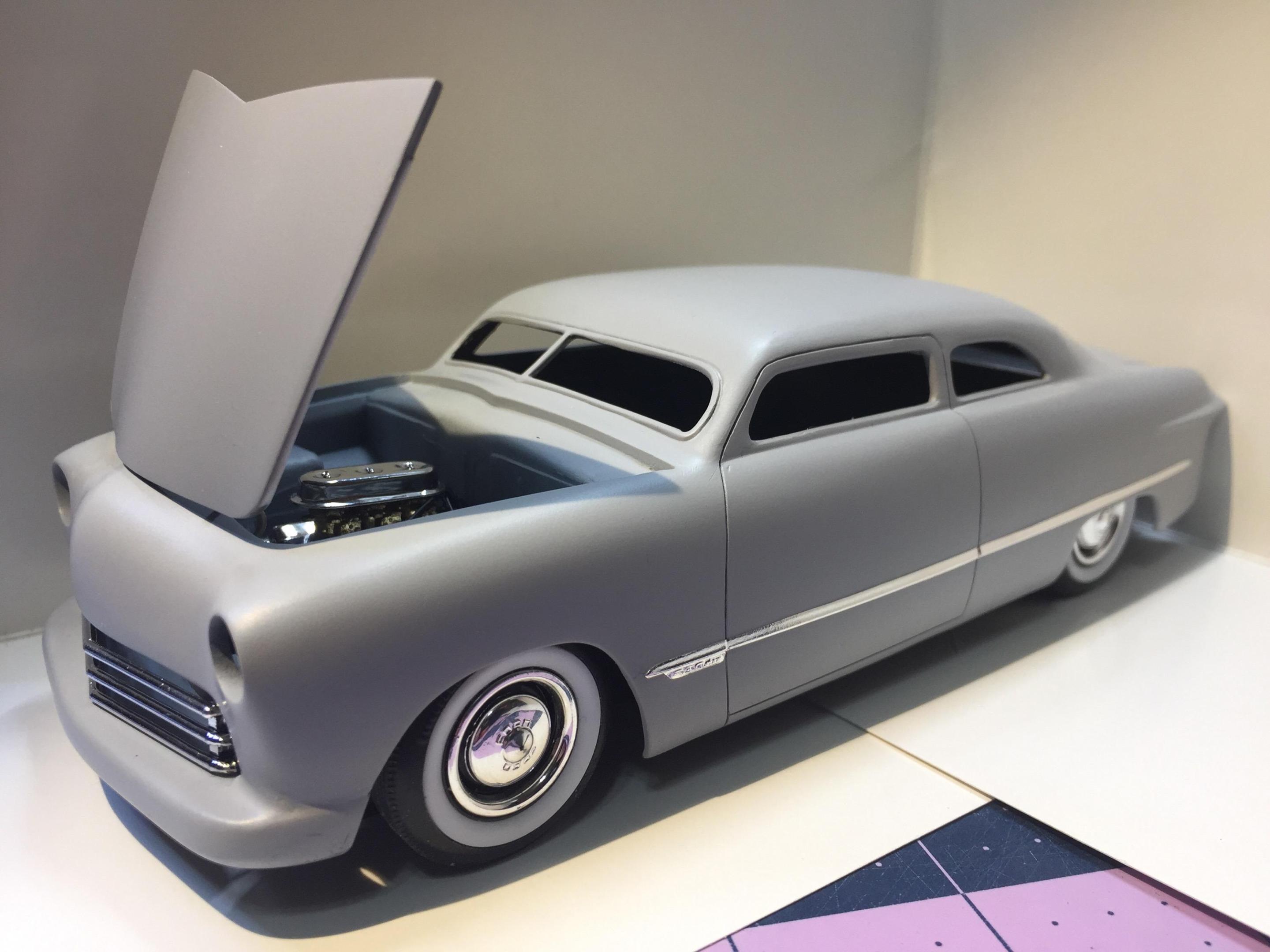

Oooo....there's some food for thought there, Len ( no BBQ though)... I've been busy, you may be pleased to know.  At half-time, (BTW, are you a Jets fan?) It was 49 degrees outside so I was able to heat up a fresh can of Tamiya light gray and got some of it (that the breeze didn't take) on the niner.  And I got foil on the port side spear. 👇
IMG_7182.thumb.jpg.bbc97f30e0f7b256d746fed6e1d2de9d.jpgIMG_7156.jpg.d61523120721aaf70cbe06cf0f8c025b.jpgIMG_7154.jpg.36da08bfdfaaefb2c529213e9836070e.jpgIMG_7152.jpg.a23df126eb415dacba009519de2bf2c5.jpgIMG_7157.thumb.jpg.1cbe7ebf48cd57528c25fd936525a206.jpg

49 degrees, we started out at 16 this morning. And we have snow coming down now and ice promised for the morning. I was never a good spectator, I always preferred to play sports rather then watch. Last time I was at MetLife Stadium it was for Bruce Springsteen.
Anyway, the car looks good with a nice coat of primer. As for your inspiration I'm partial to the 2nd photo with the paint fade on a downward slope. Nice and easy as you don't have a molding to deal with. But ahh, there is the paint issue.🤔
