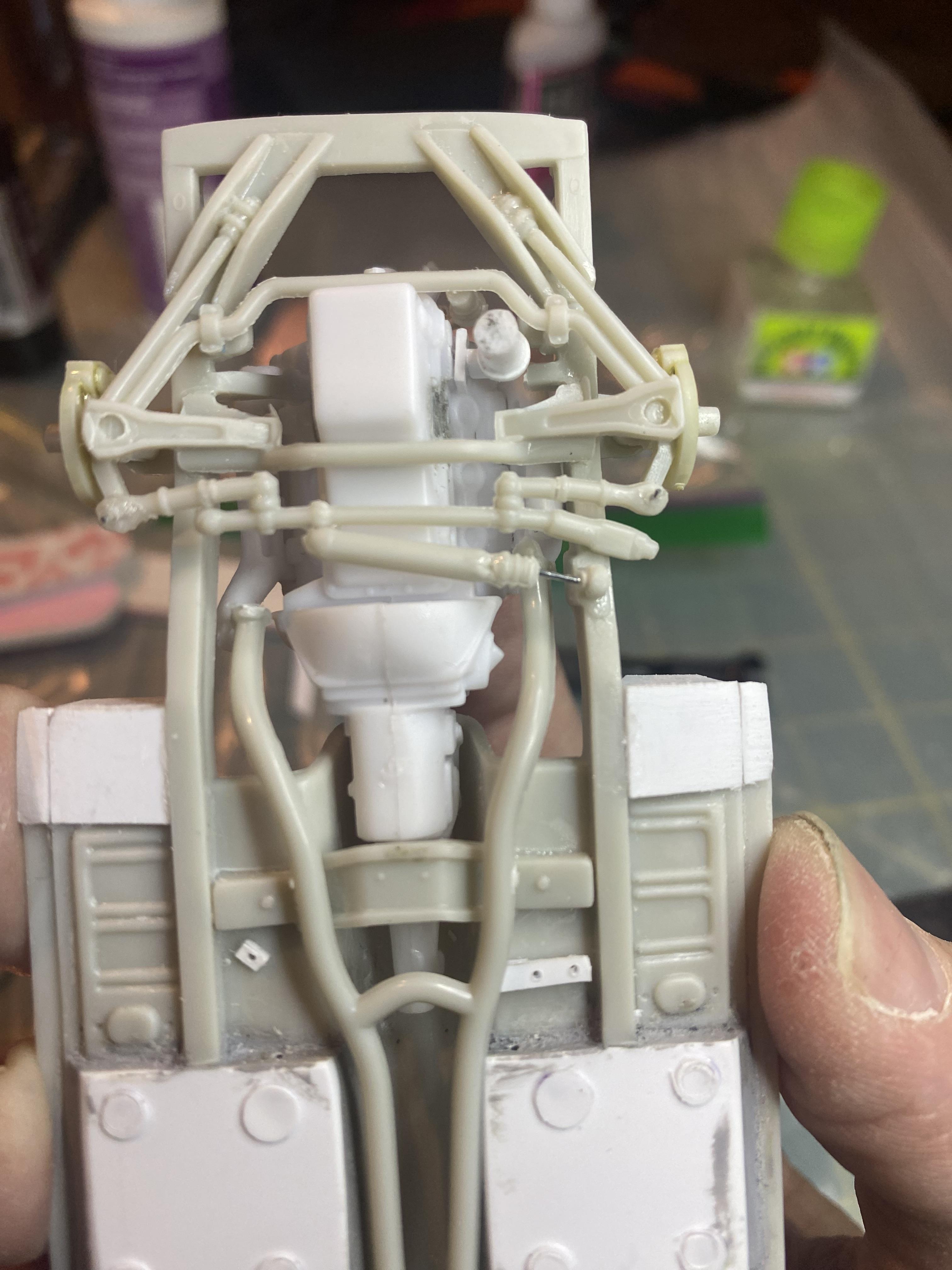

STU111 Posted November 29, 2024 Posted November 29, 2024 A lot of awesome details being incorporated into the chassis and front suspension alone. 👍🏻 1 Quote
Duddly01 Posted November 30, 2024 Author Posted November 30, 2024 10 hours ago, STU111 said: A lot of awesome details being incorporated into the chassis and front suspension alone. 👍🏻 Thank You! Quote

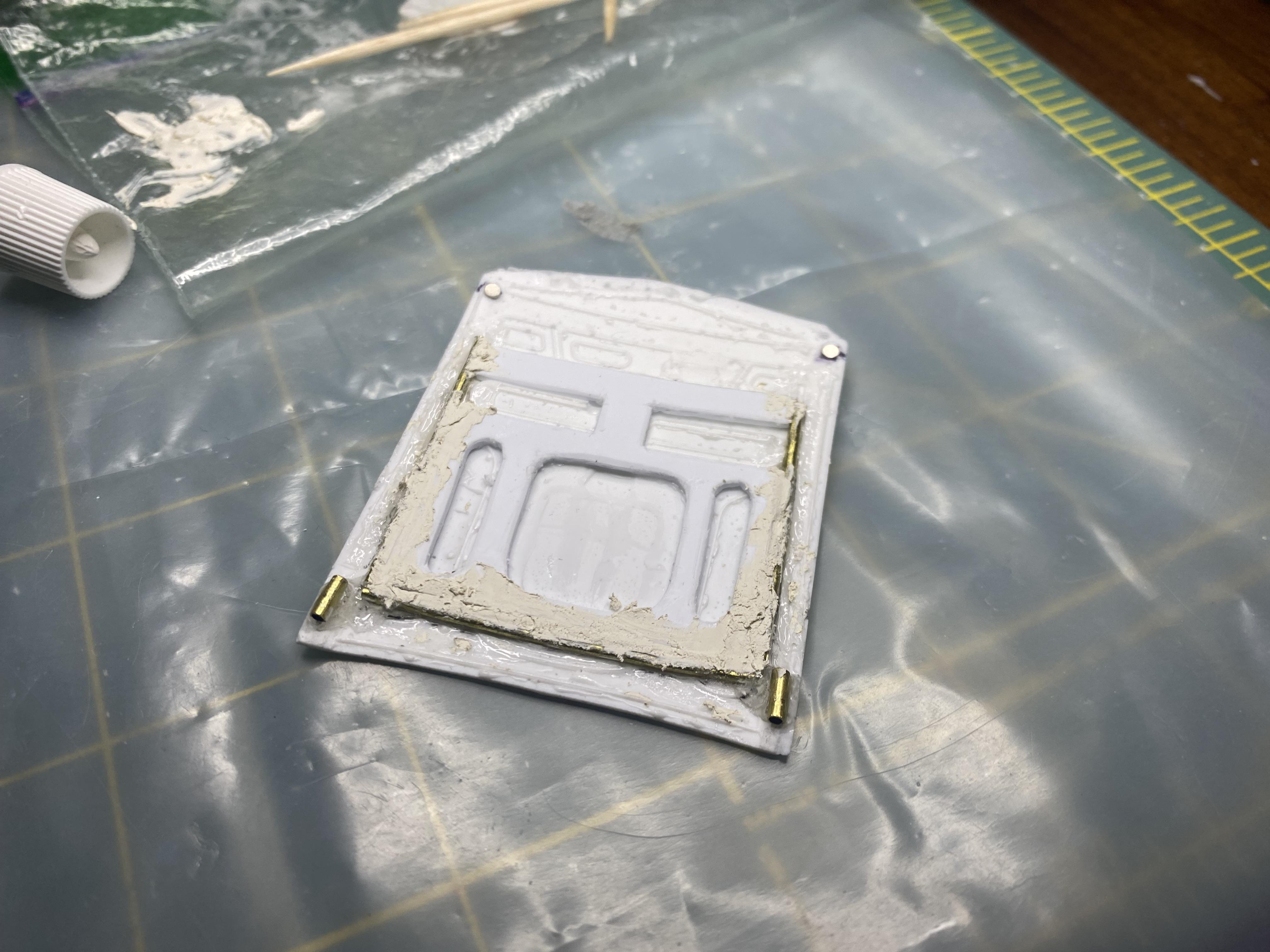

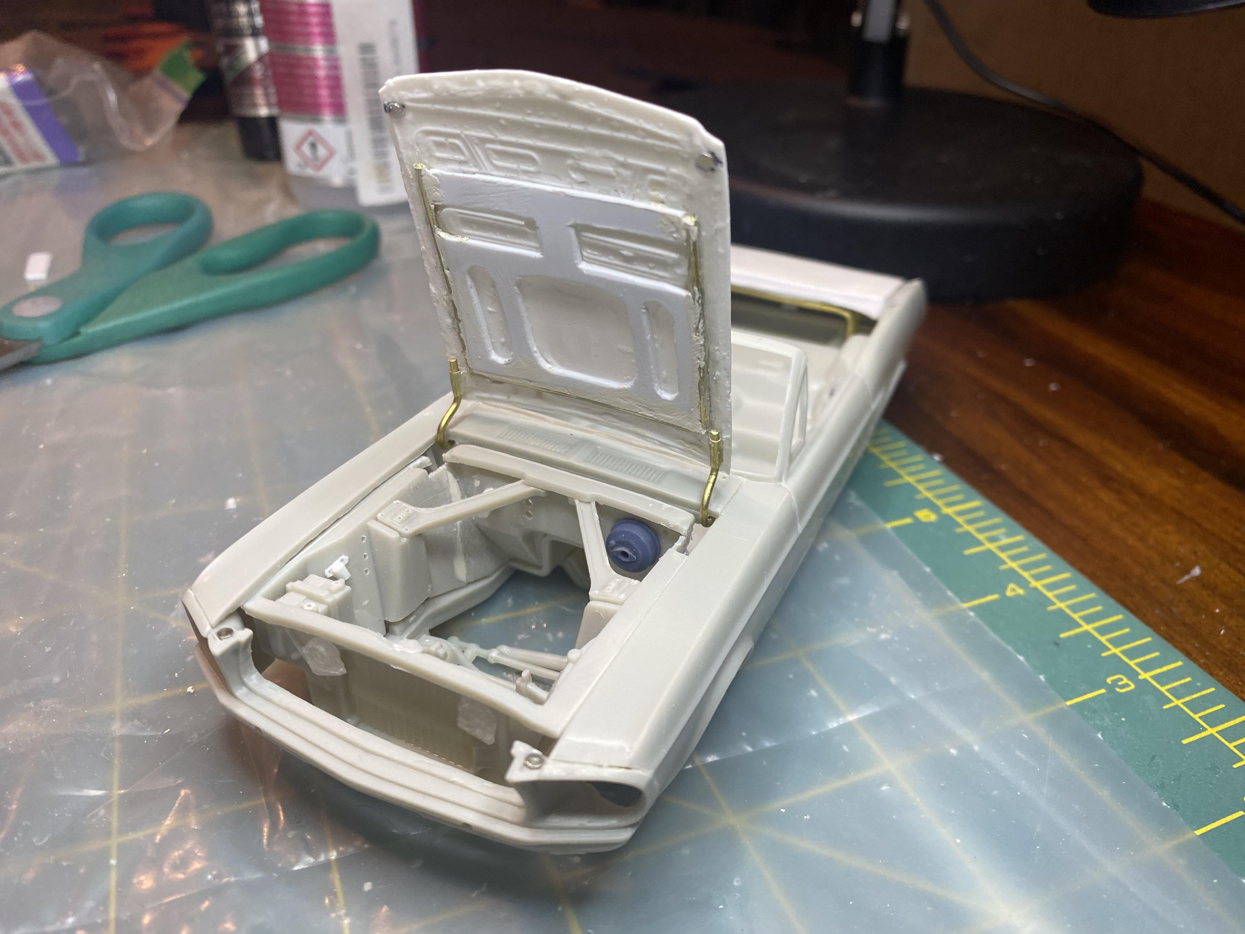

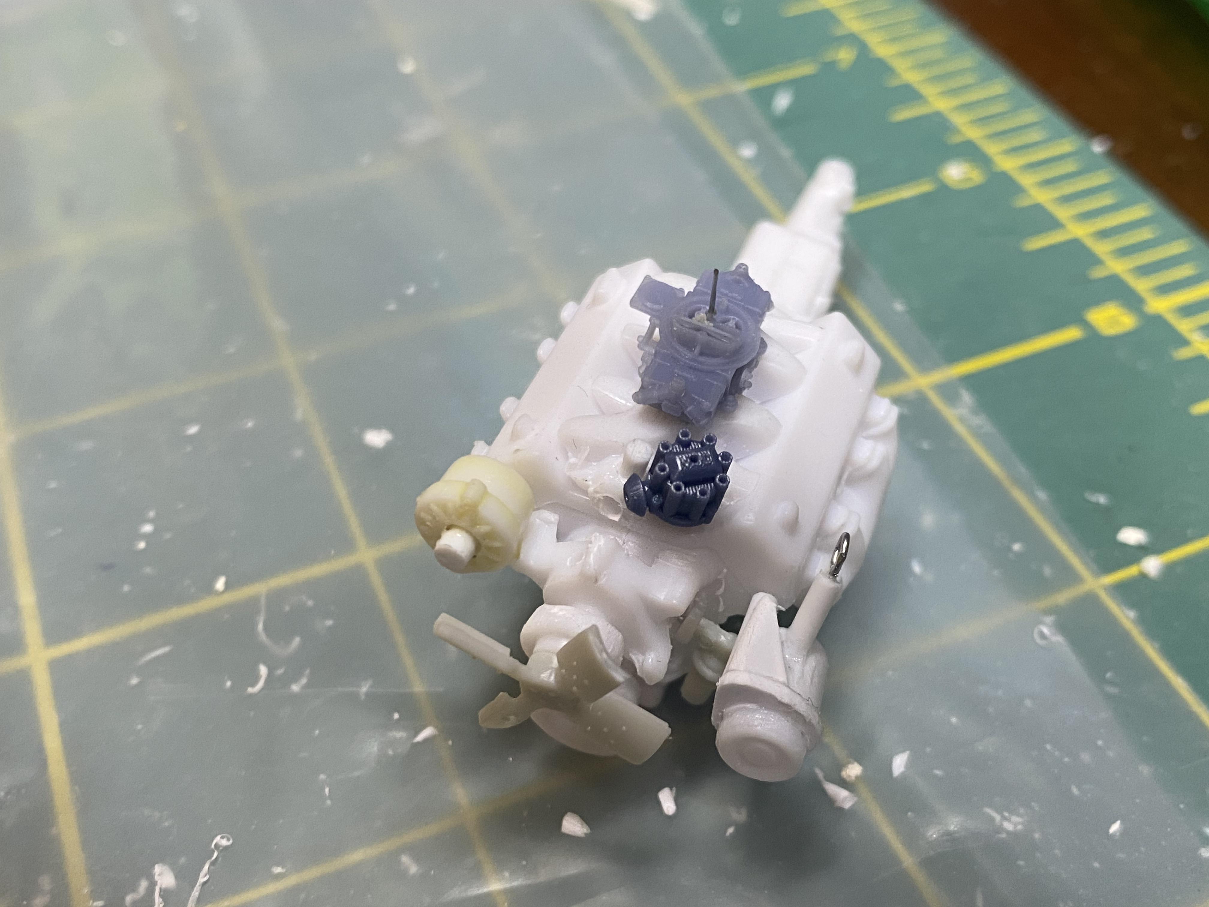

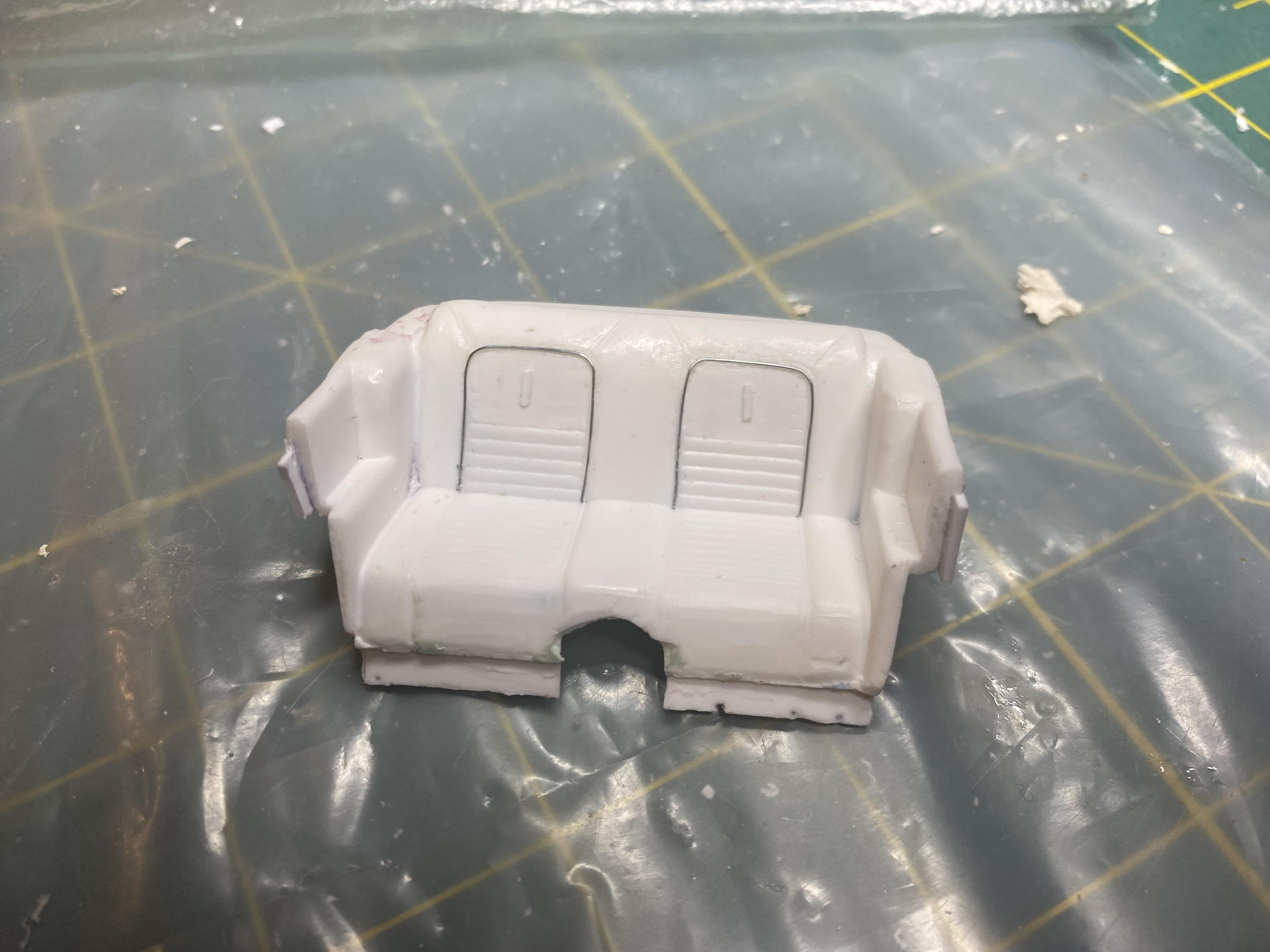

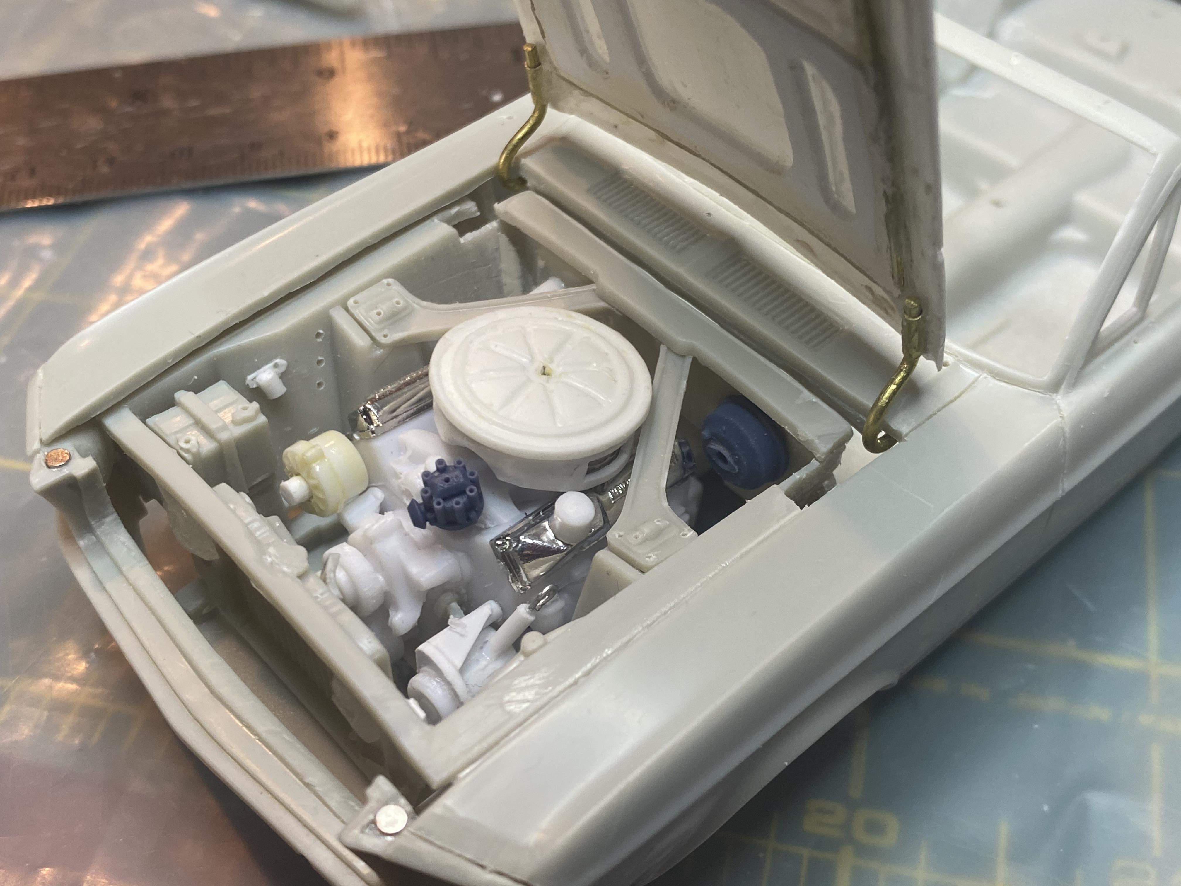

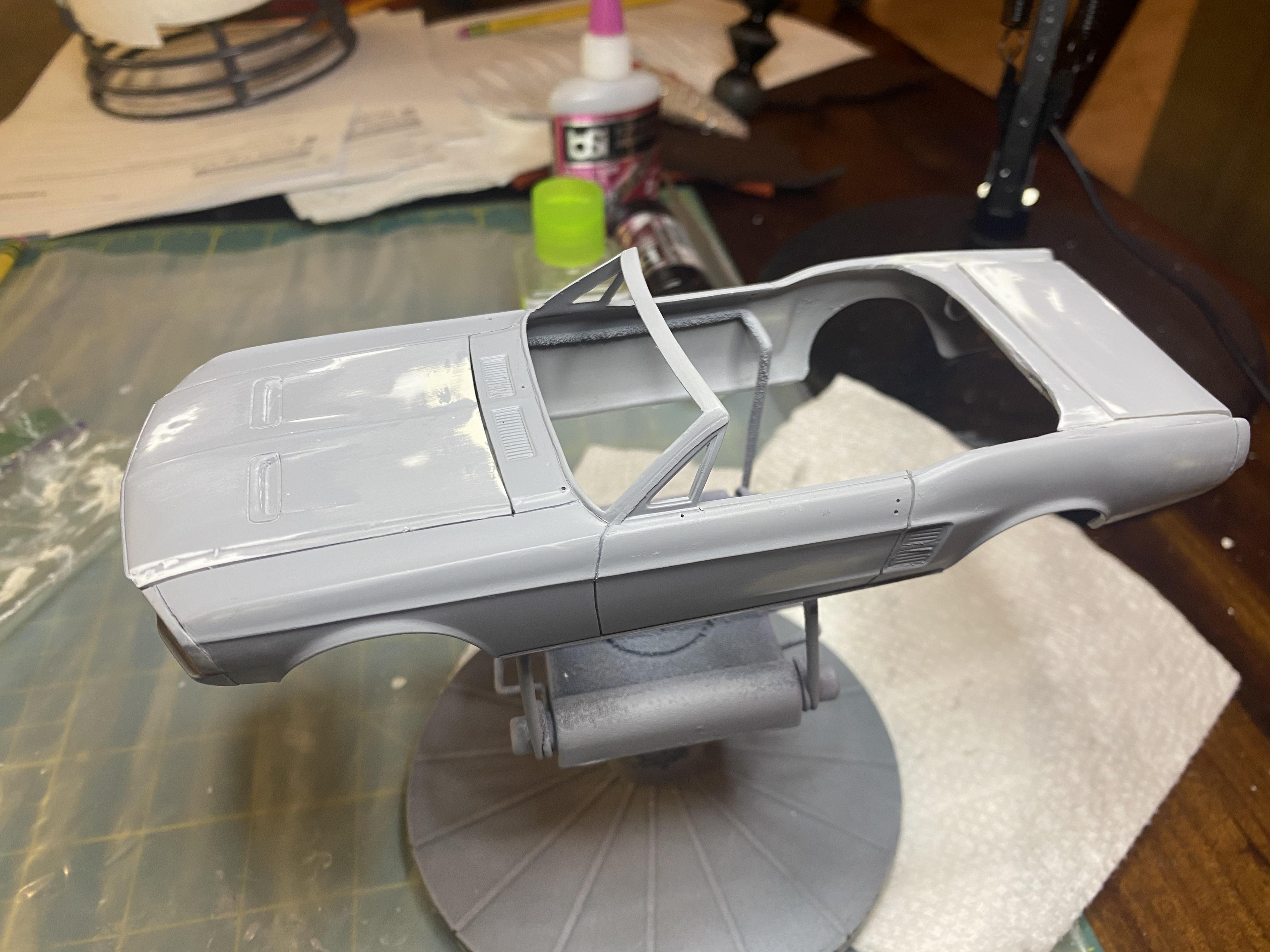

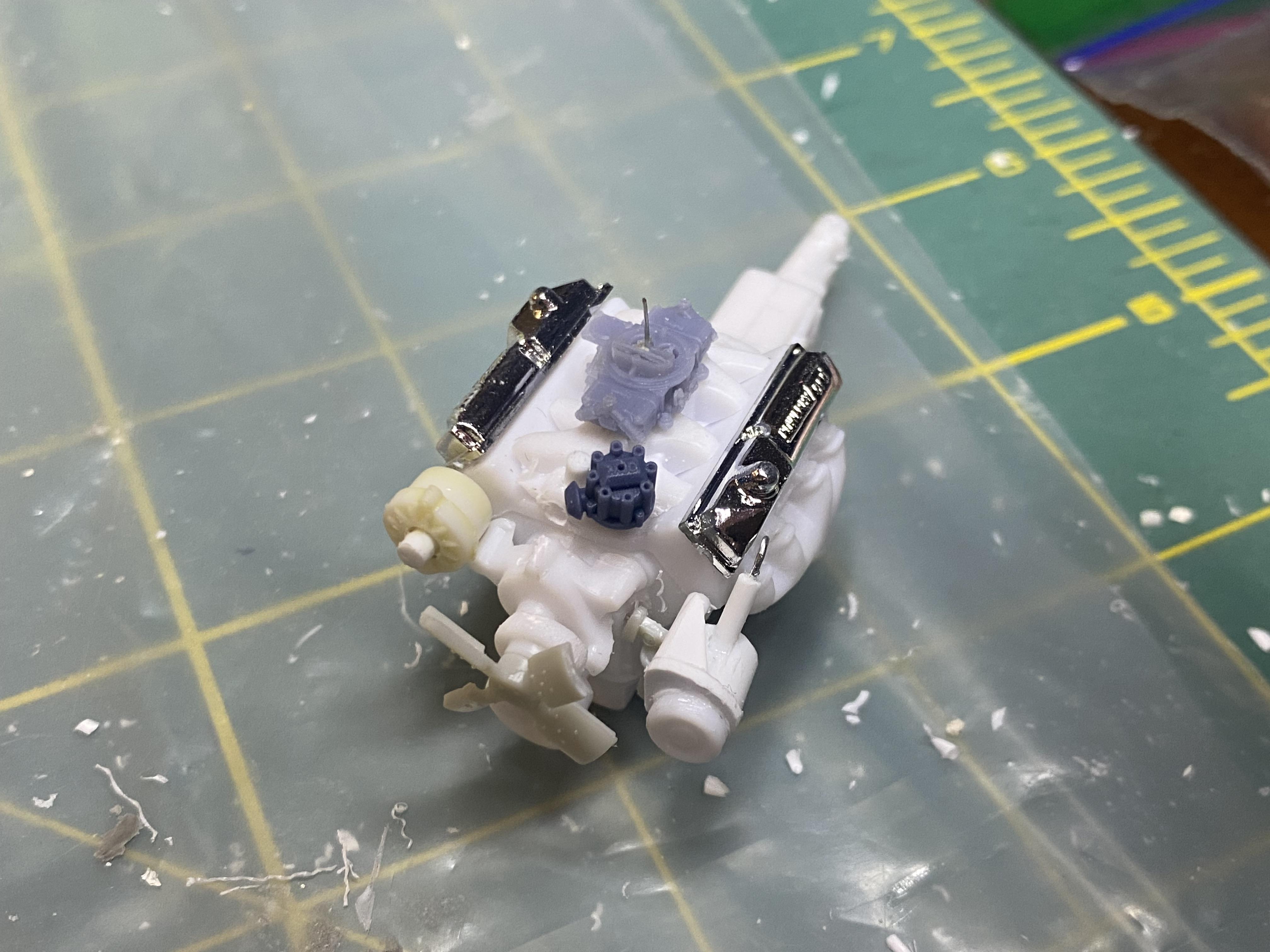

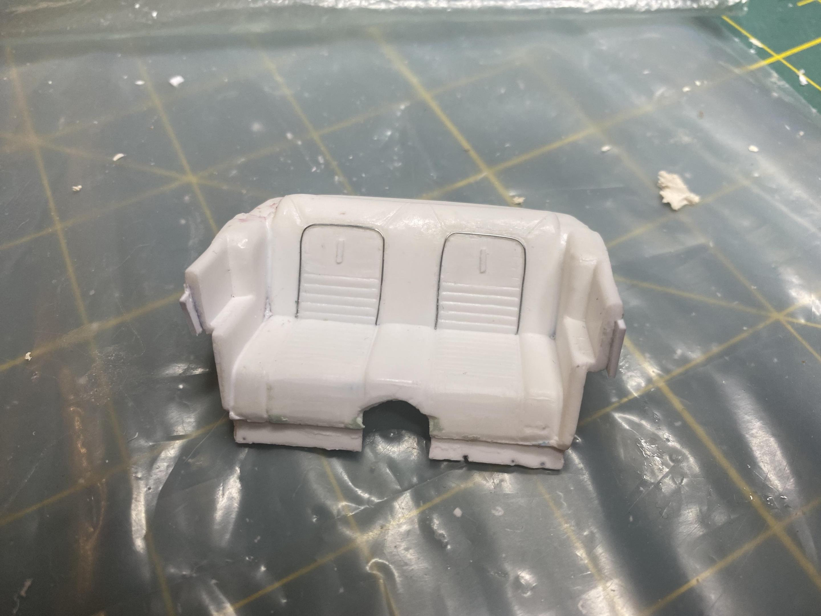

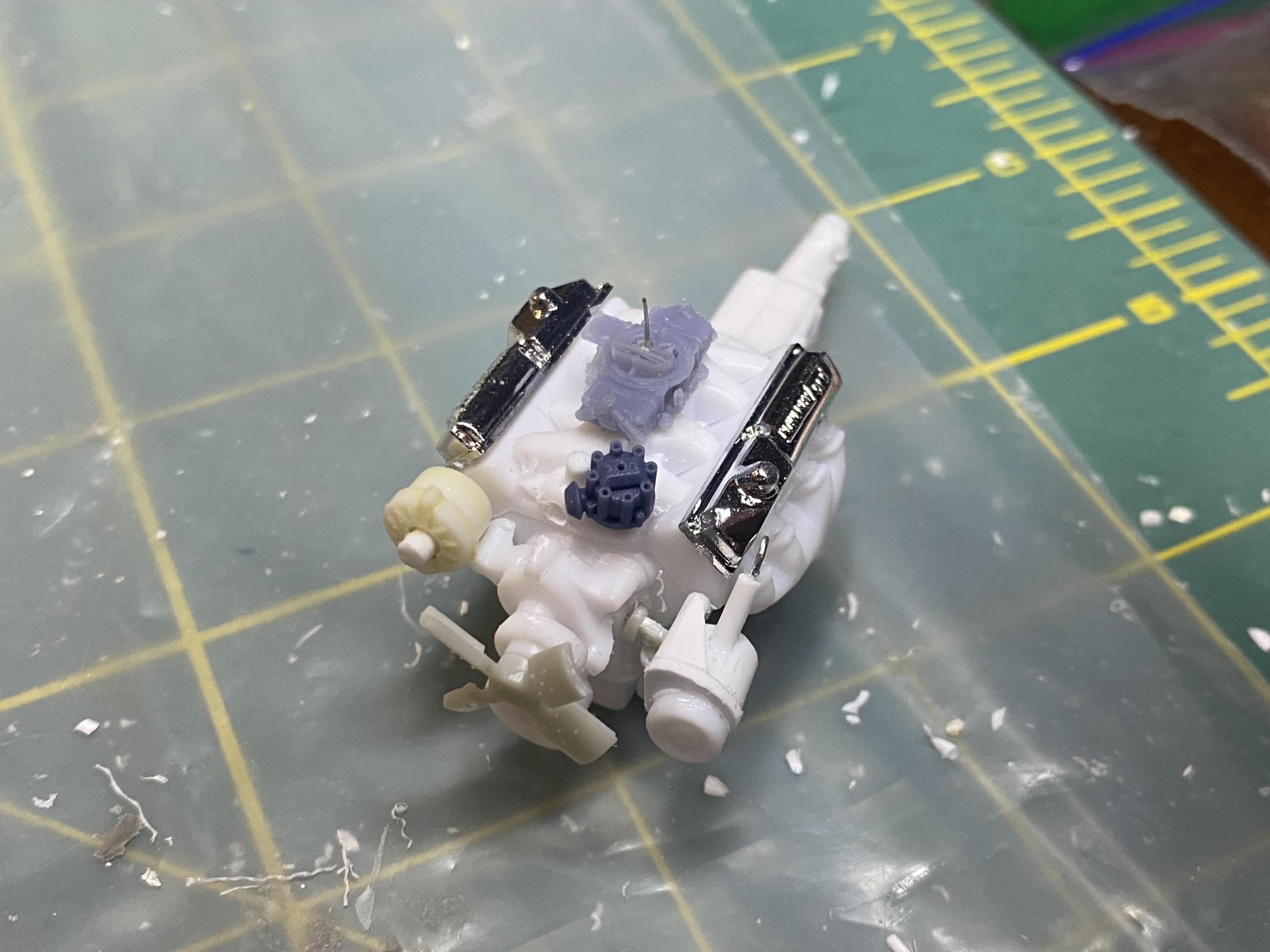

Duddly01 Posted November 30, 2024 Author Posted November 30, 2024 A little bit of work done today. Added a bit oh hood framing to camouflage the reinforcement rods. Added some wire to the back seat to bring out the piping detail a bit better. I had a left over big block from the 1968 GT kit so decided to use it with some heavy modification. I purchased a 3d carburetor and distributor. I removed the belts, they will be replaced with flat elastic to look more realistic. Pinned the alternator and scratch built a power steering pump. I still need to make an oil filter and air cleaner. I have a c6 transmission on order from VCG resins and will be cutting off the transmission from the block once it arrives and trial fitting to the chassis. 2 Quote

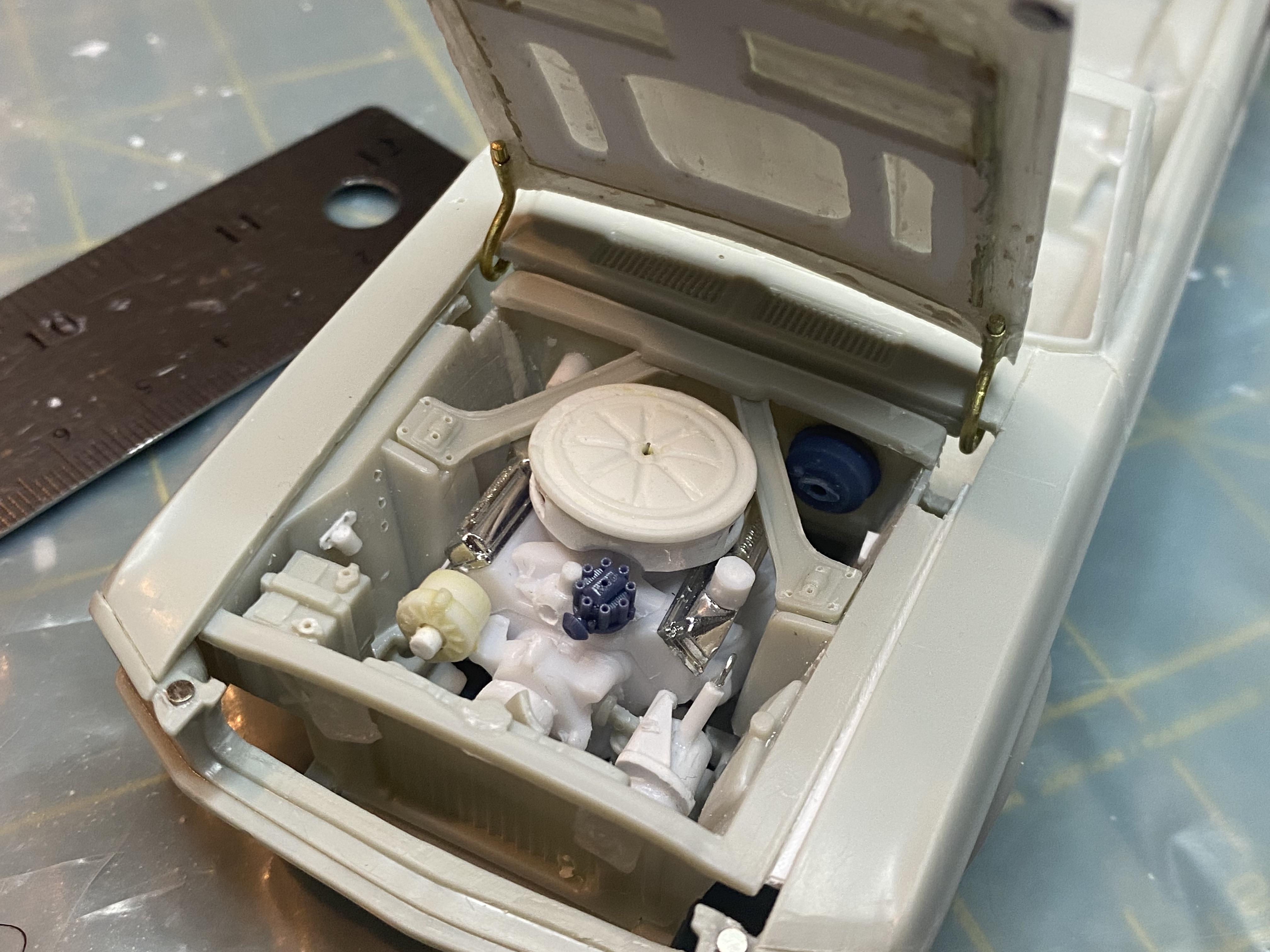

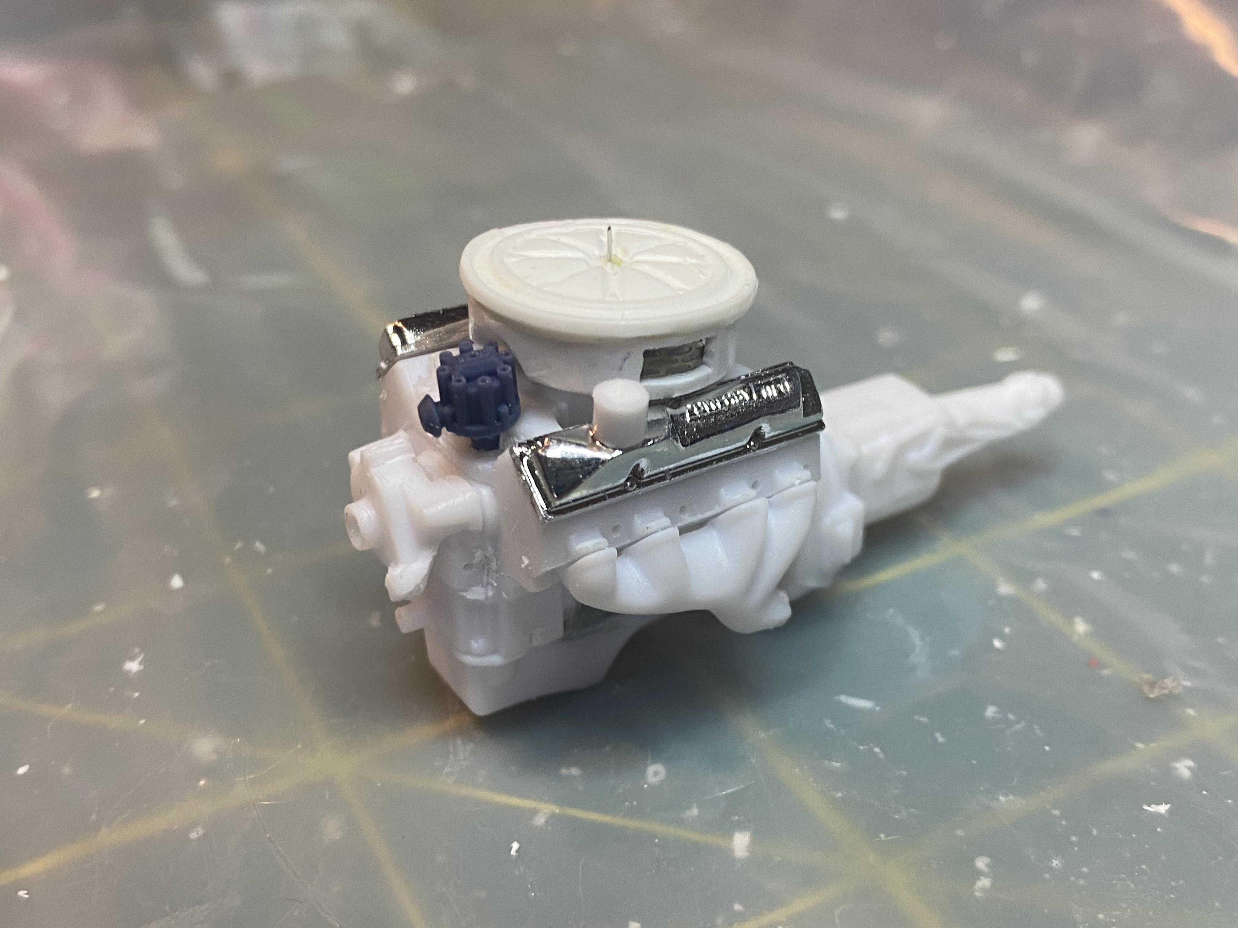

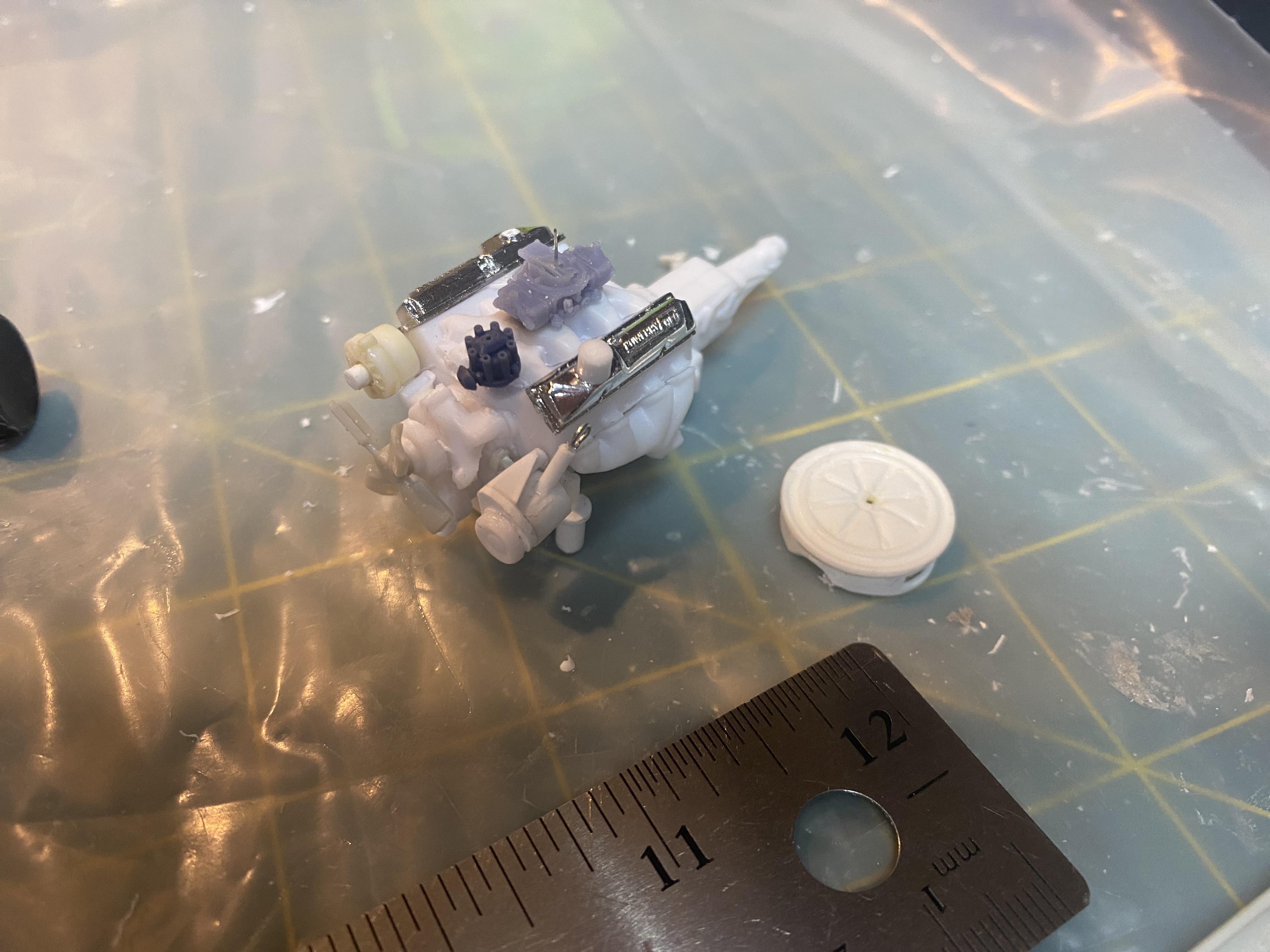

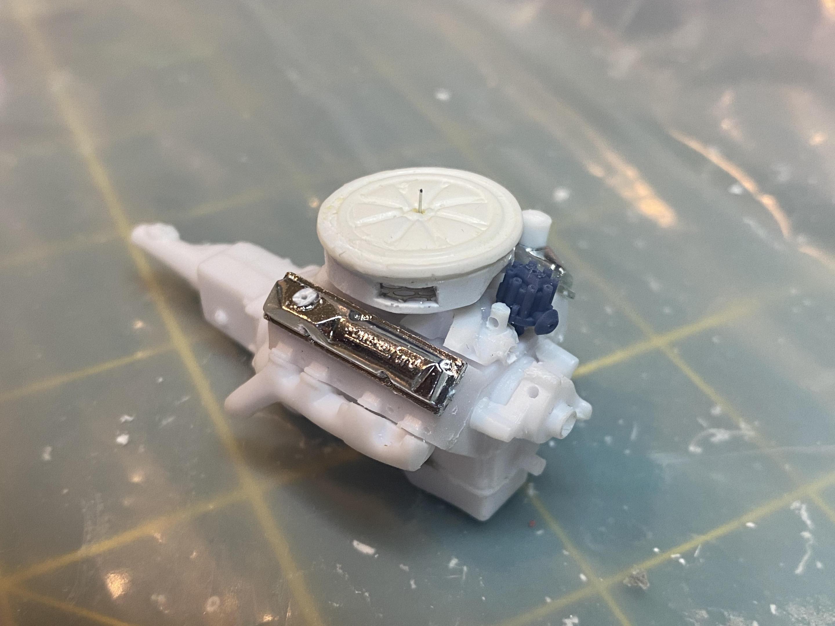

Duddly01 Posted November 30, 2024 Author Posted November 30, 2024 Created the air cleaner and oil filter. White glue mock up with chassis. Oddly the exhaust fits ok. It’s really tight fit in the engine compartment. I am against a wall until the 3d printed c6 transmission arrives before I cut off the old transmission. 3 Quote

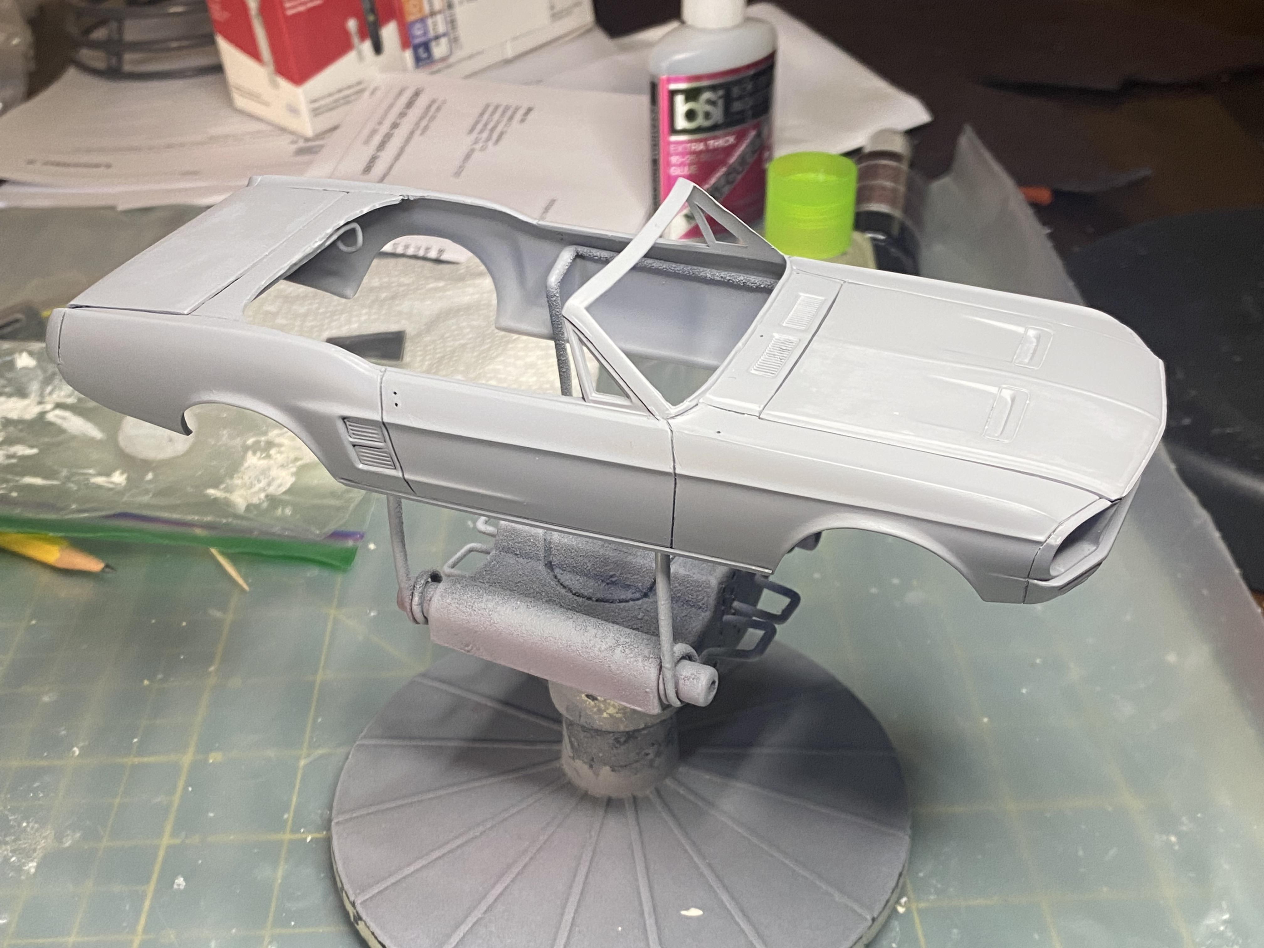

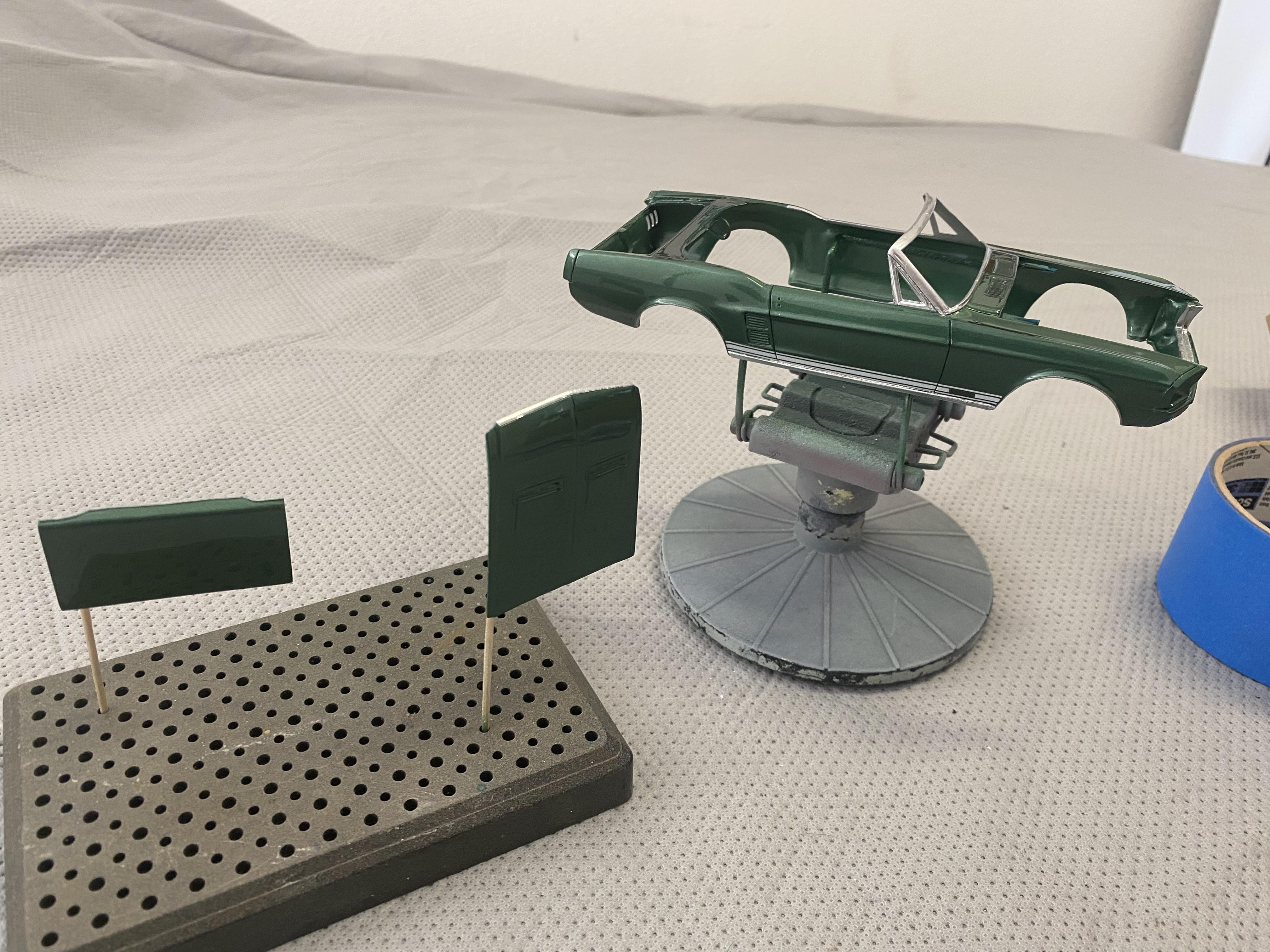

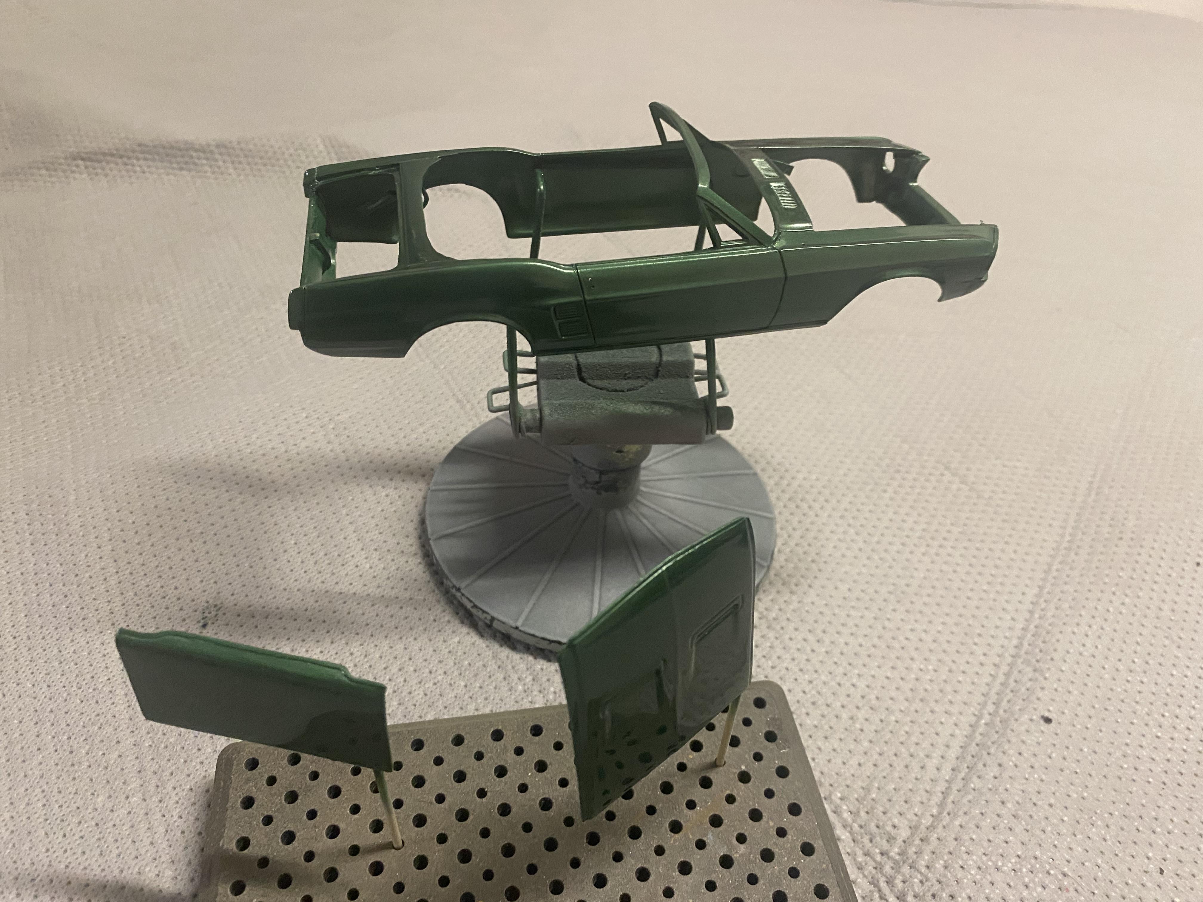

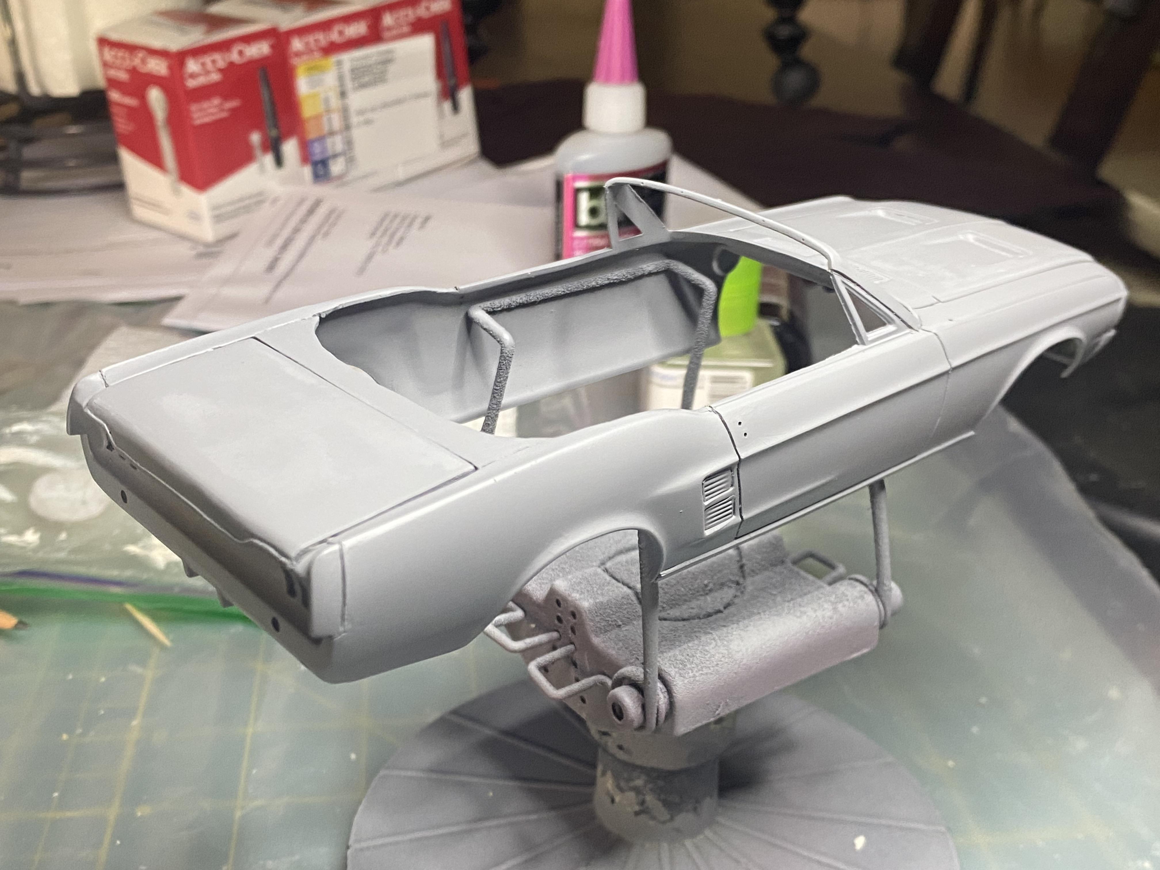

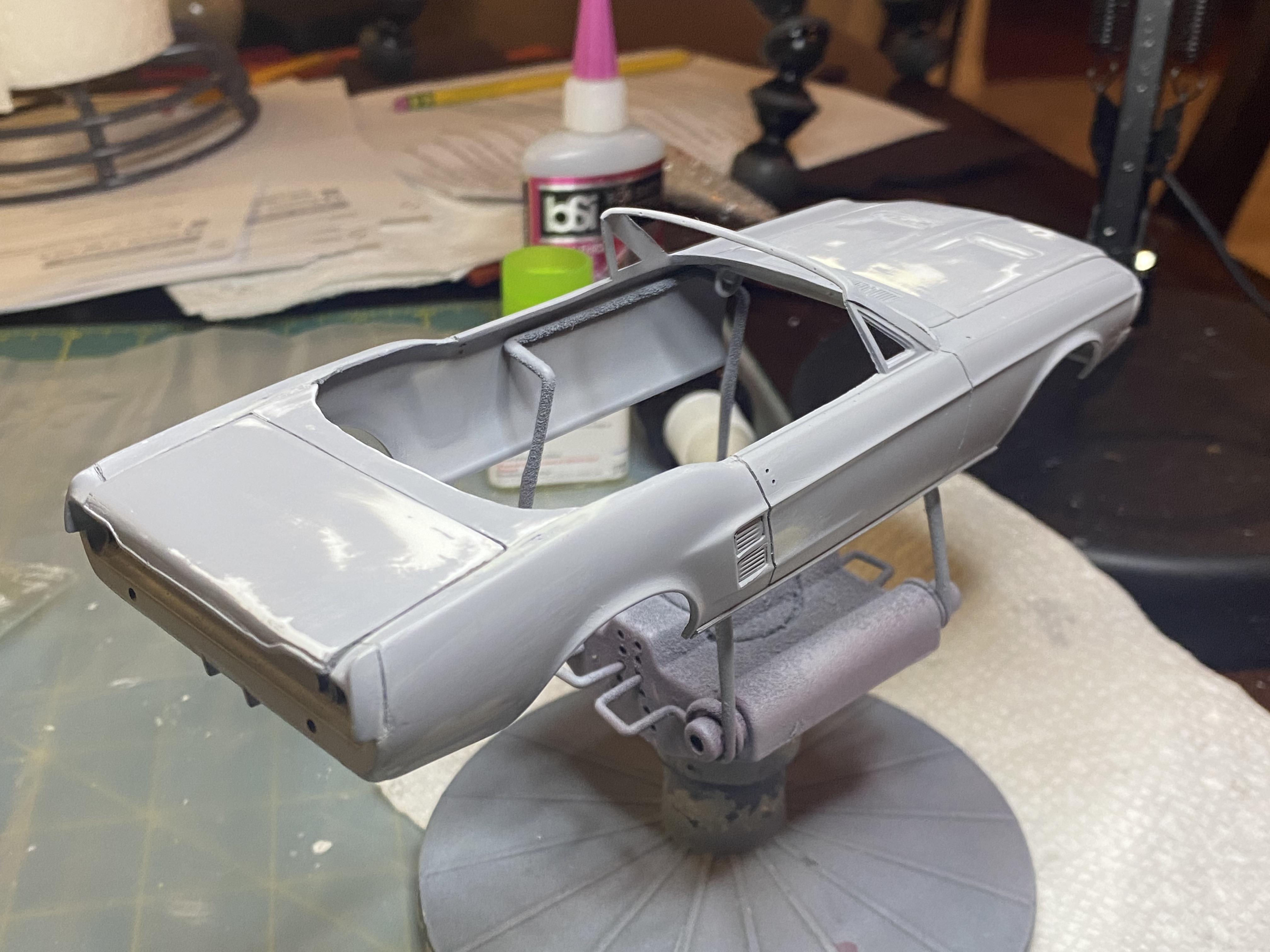

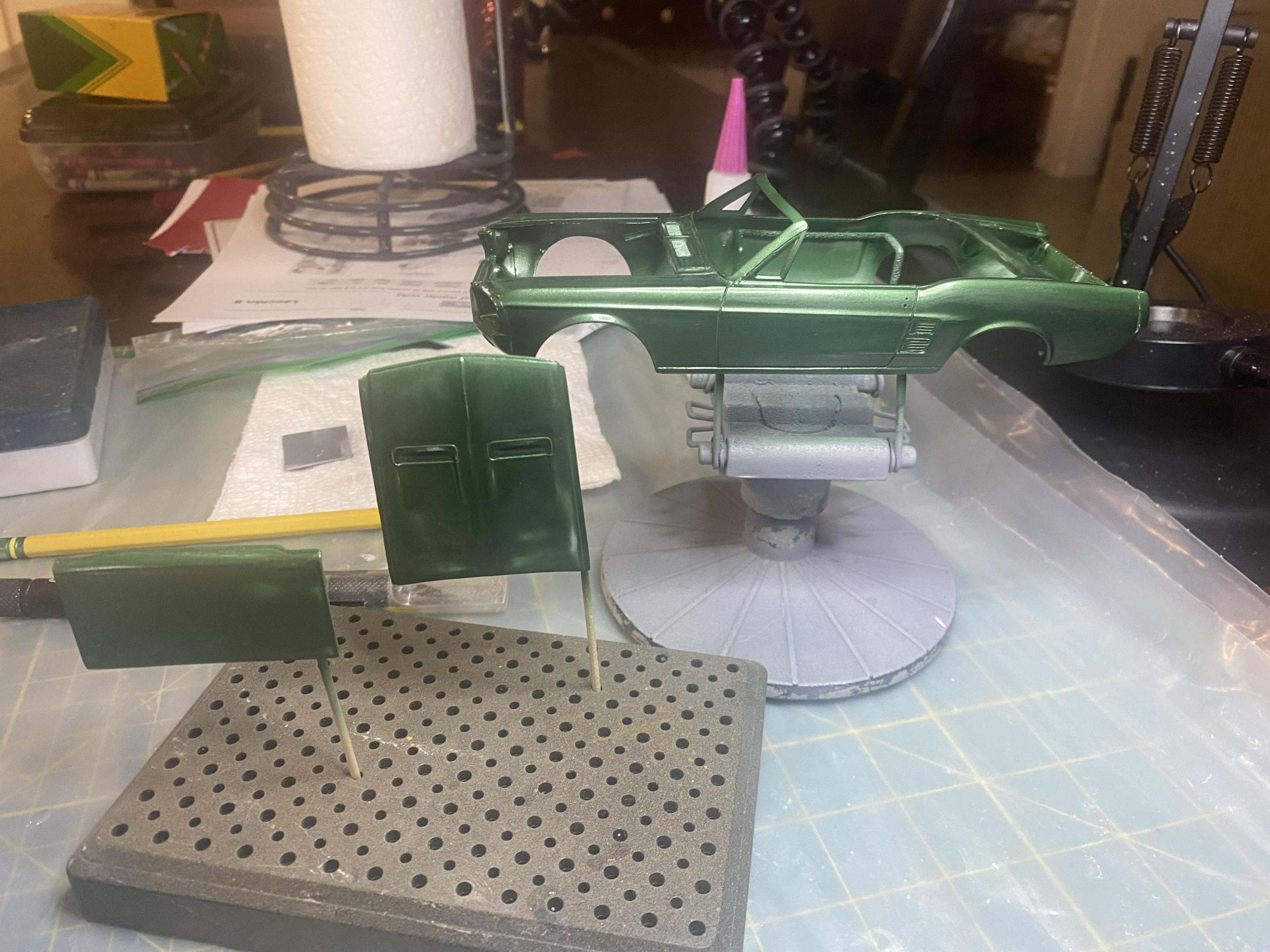

Duddly01 Posted December 3, 2024 Author Posted December 3, 2024 Paint is supposed to arrive Wednesday and body shouldn’t need any more modification based on remaining engine changes. Started the long task of priming, sanding and filling imperfections in the body. 2 Quote

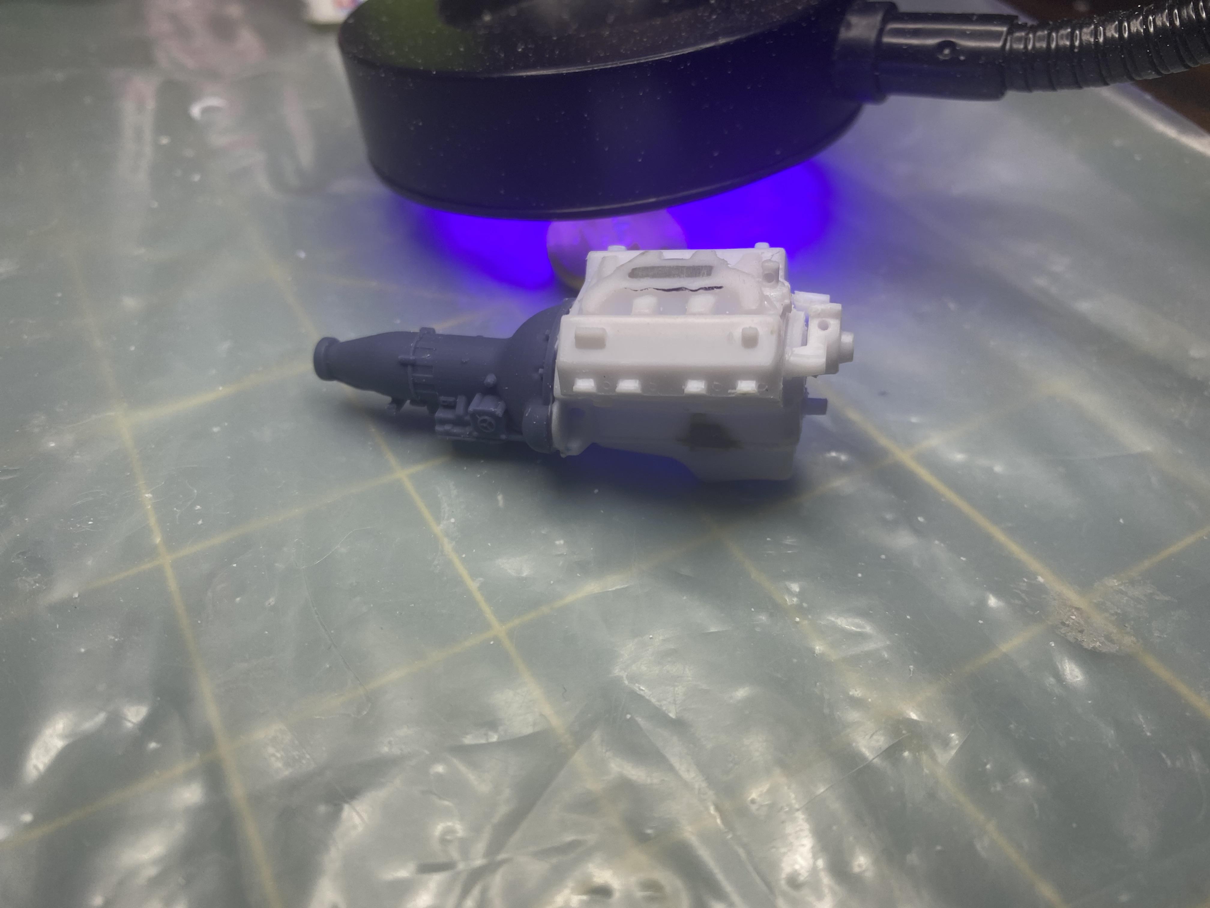

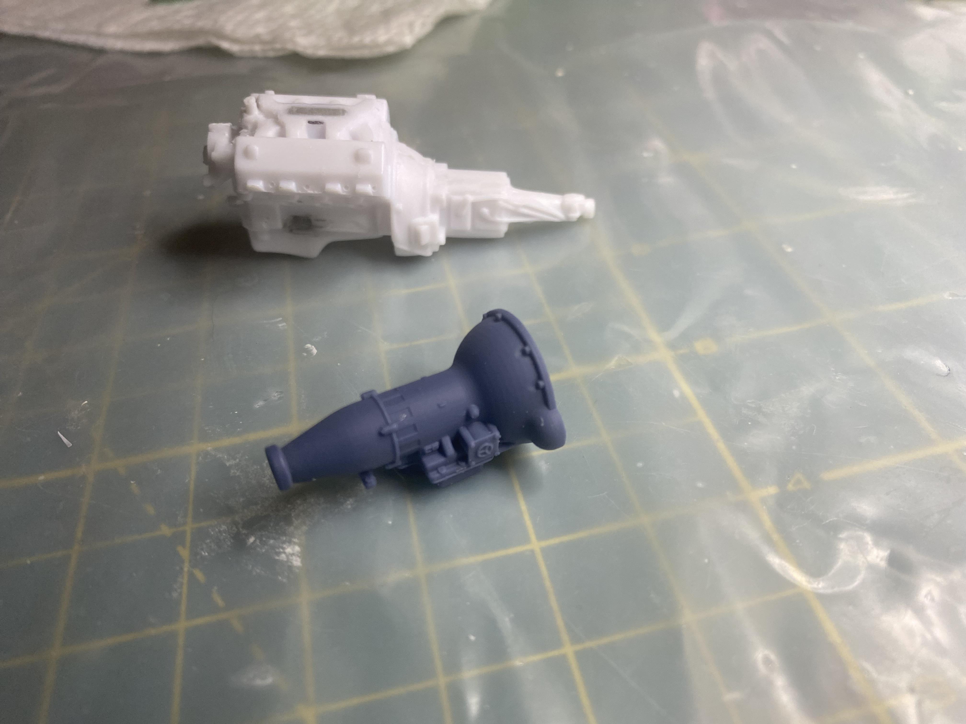

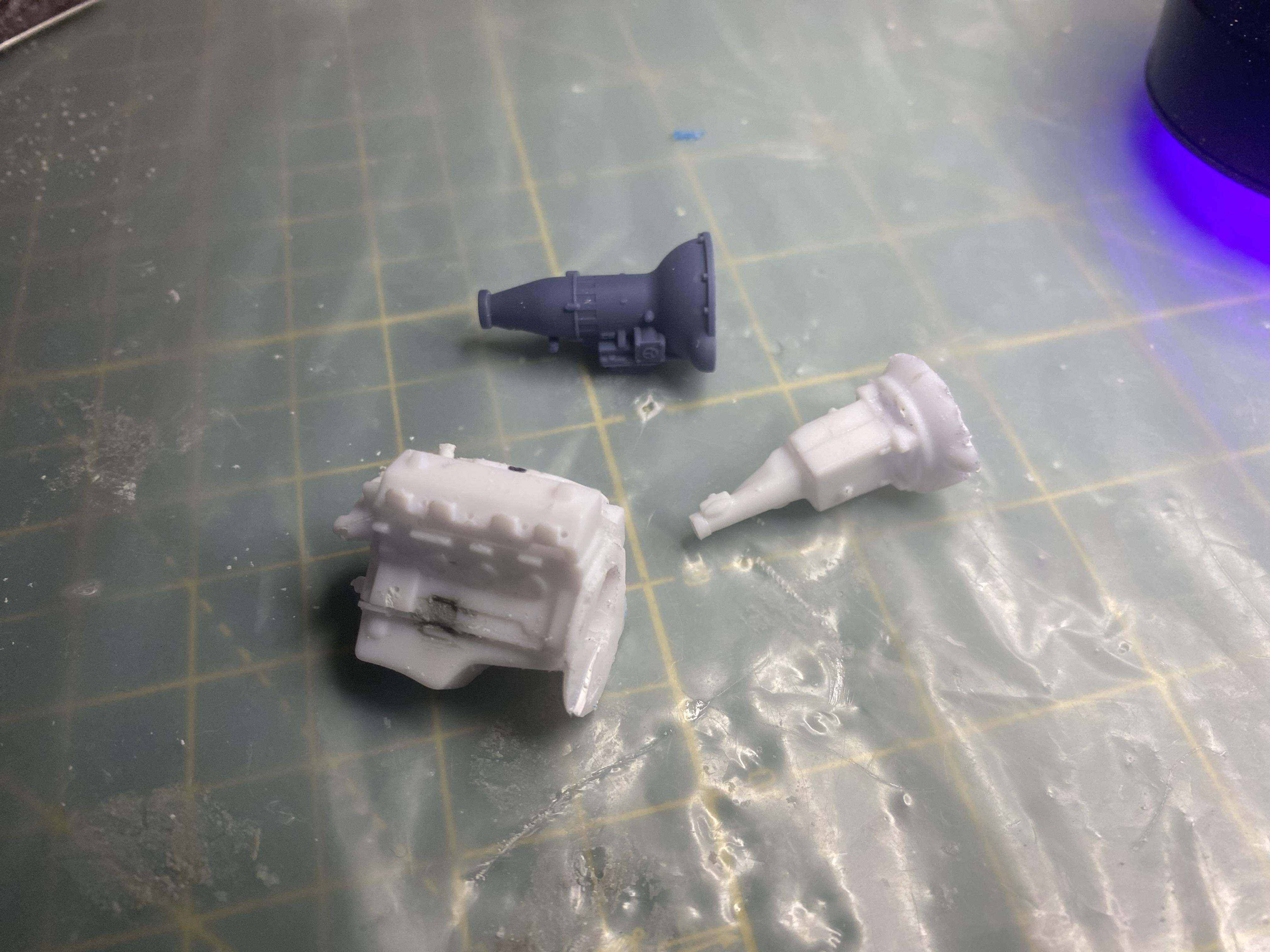

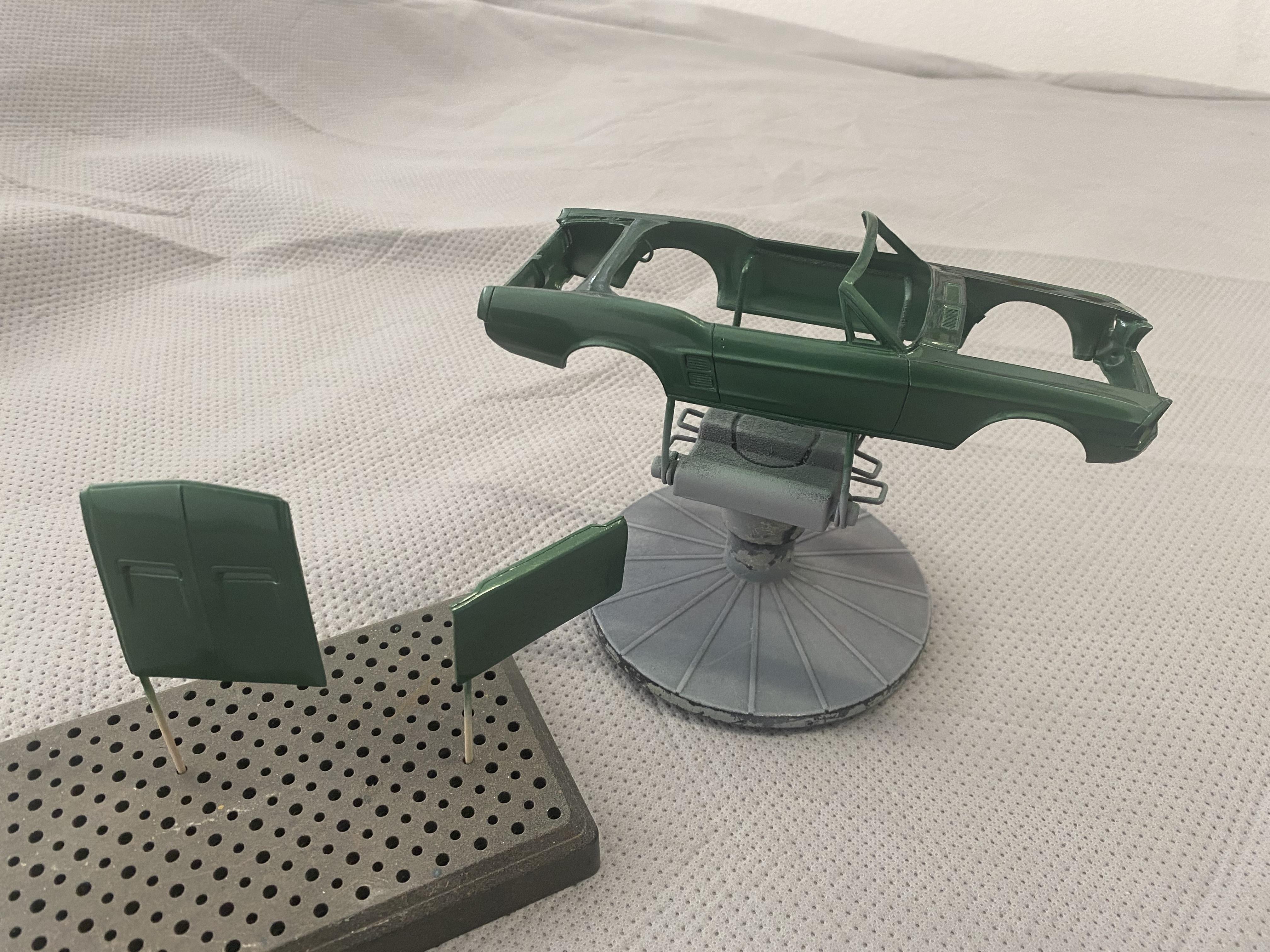

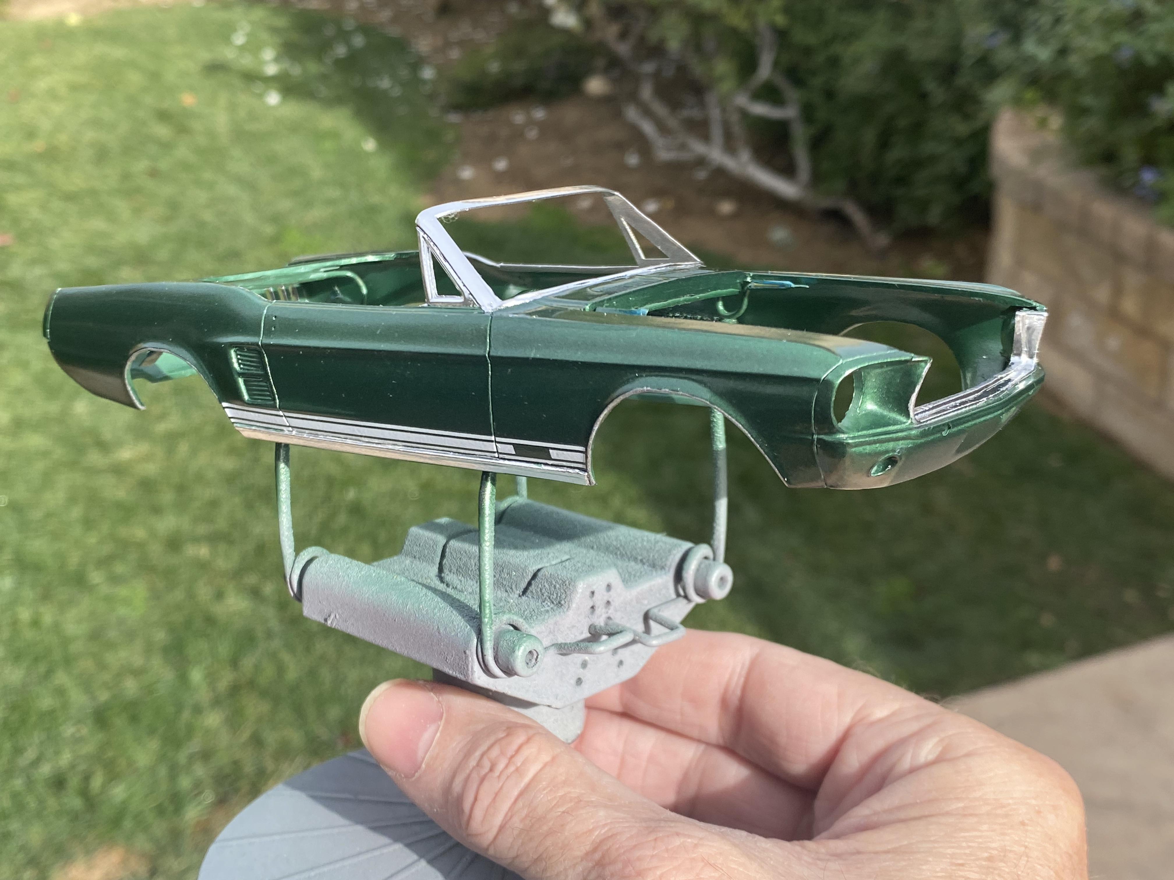

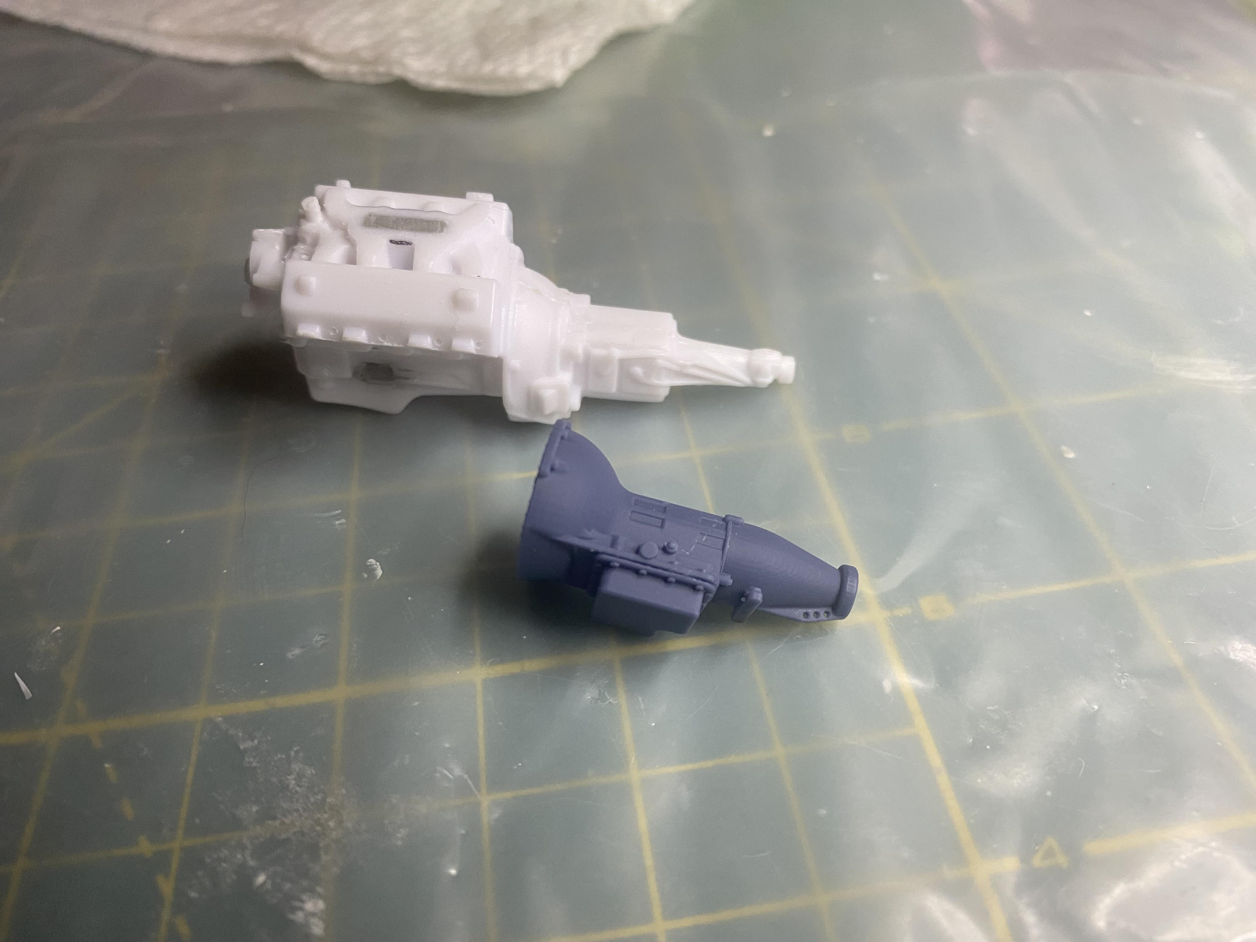

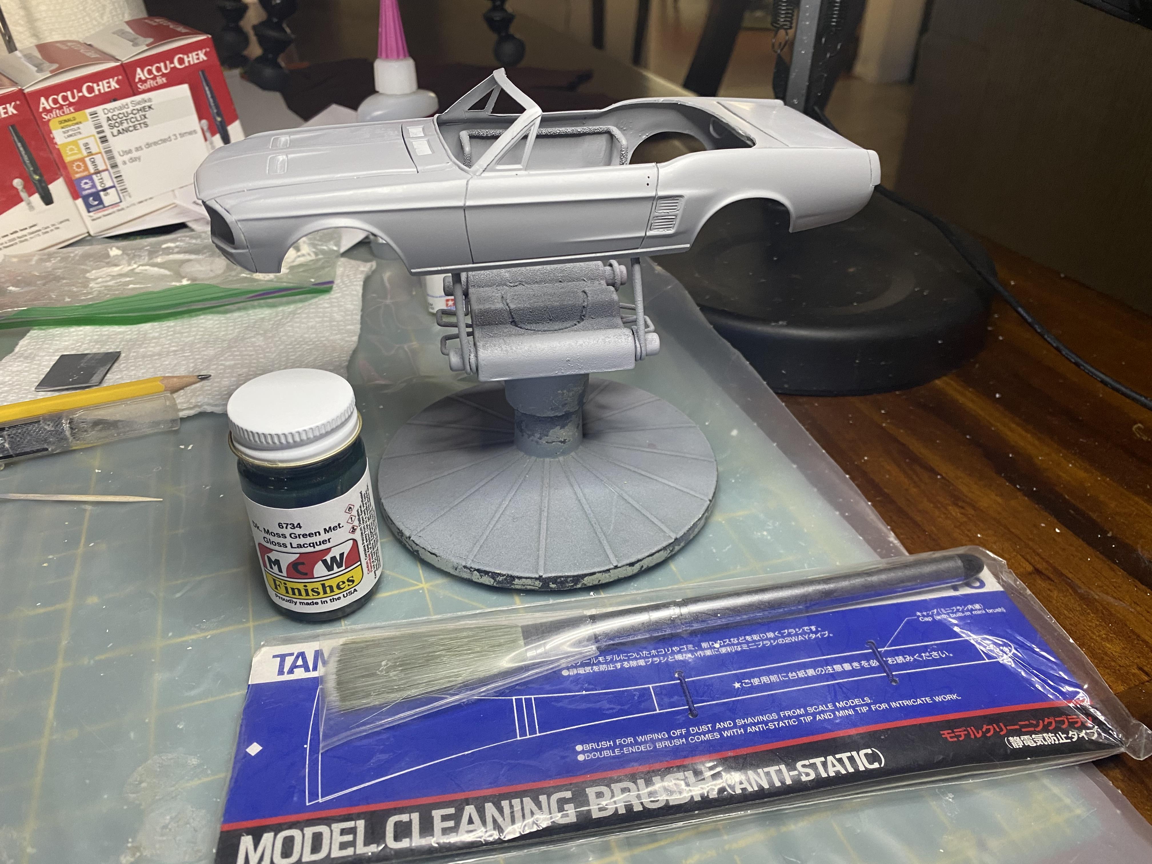

Duddly01 Posted December 6, 2024 Author Posted December 6, 2024 My 3d printed C6 transmission arrived today. Did take a little work to get to fit but nothing too major. after several passes of sanding and filling I put the first couple of coats of base lacquer to find more blemishes and sanded even more. The cutting through the first coats of color were expected. Then added the final wet coats of Dark Moss Green. next on to detailing a bit including chrome trim and stripe decals before 2K clear. 4 Quote

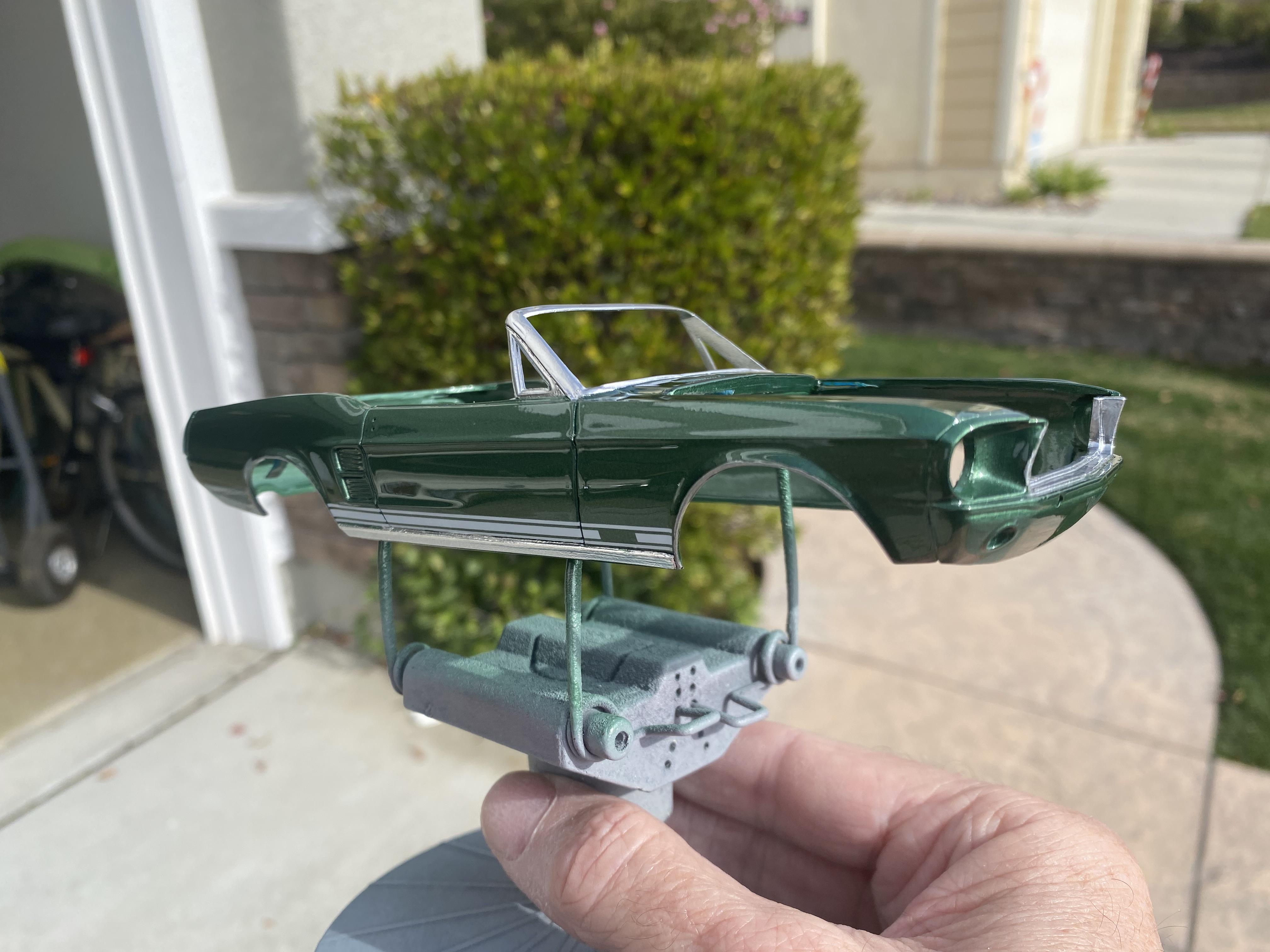

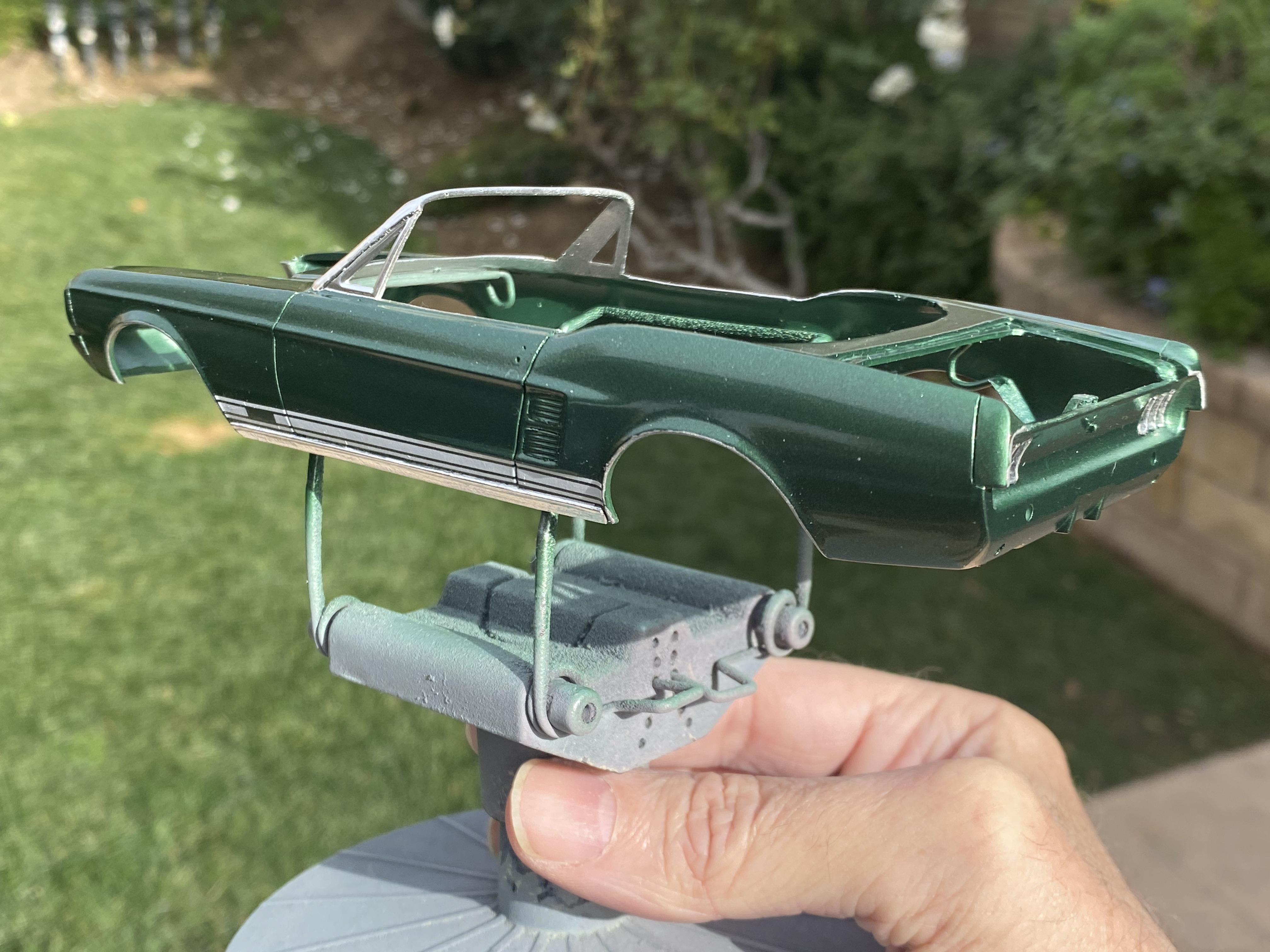

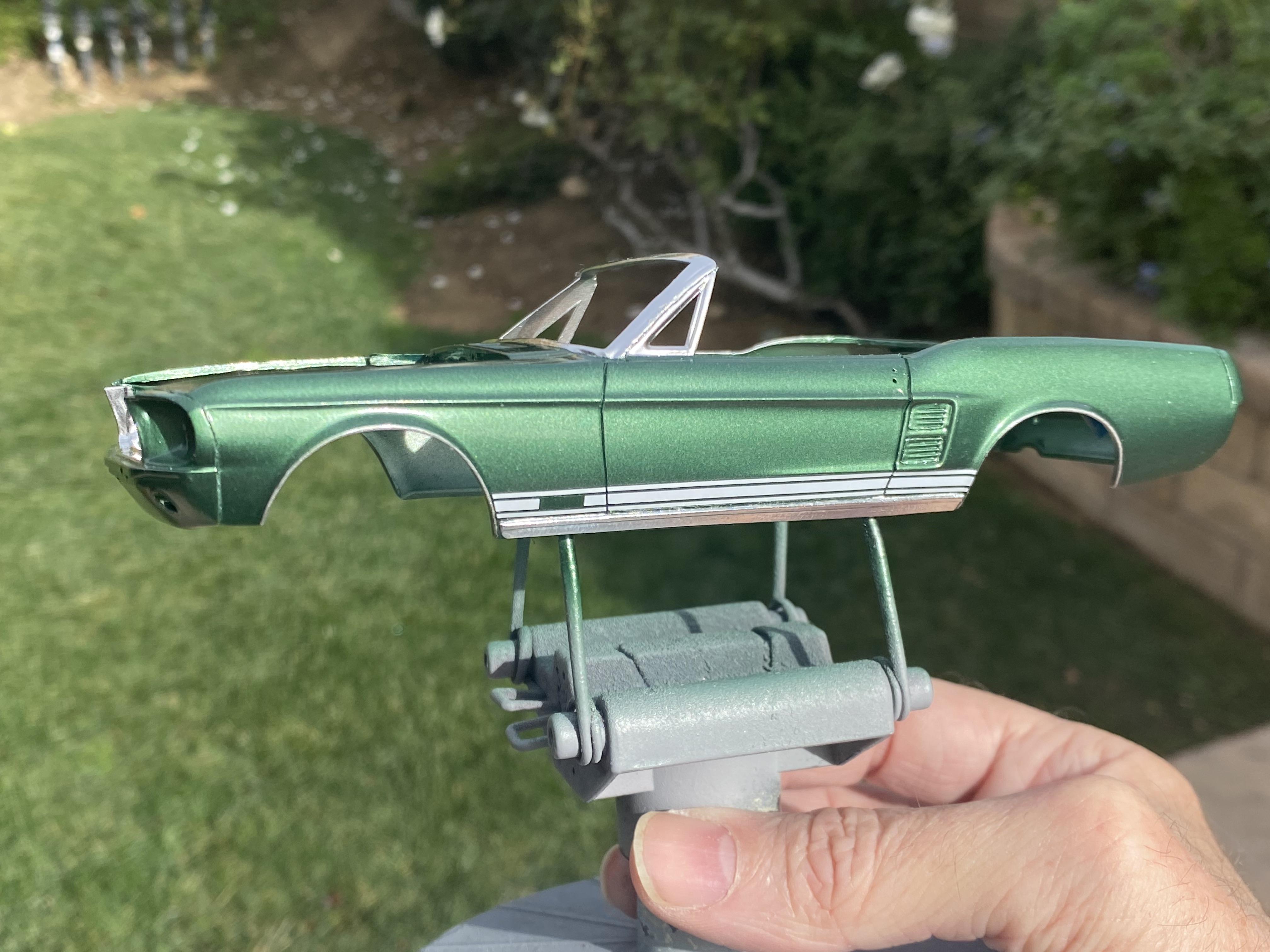

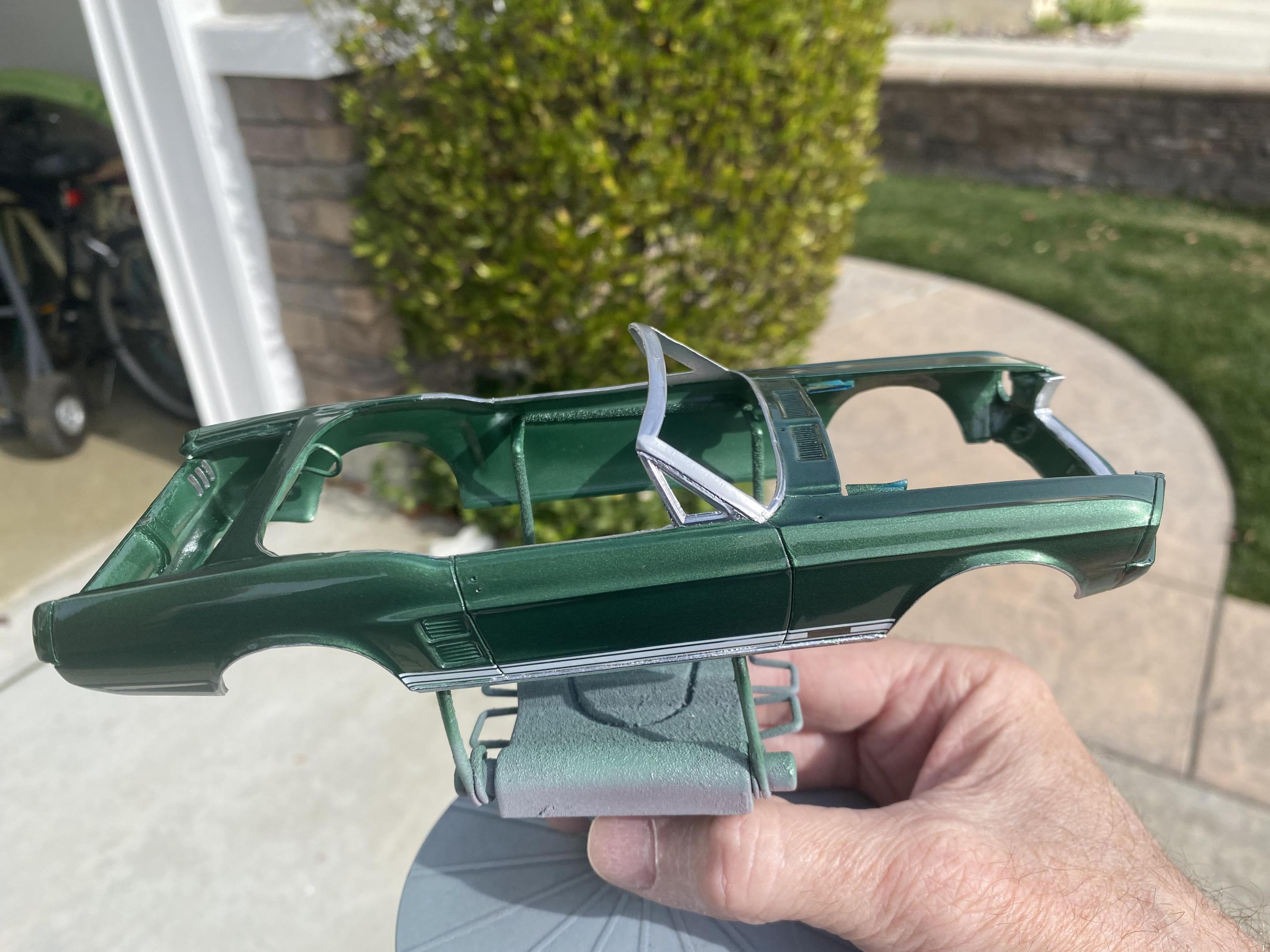

Duddly01 Posted December 8, 2024 Author Posted December 8, 2024 Chrome work and decals done on the body. Still need to 2K clear in a couple days, and then wait to wet sand and polish. I still haven’t started painting the other components yet, doing things a little different this time getting ahead on the body while I was waiting on some supplies to arrive for the engine. I did have to make some modifications to get it to fit so good thing I did wait. . 2 Quote

Duddly01 Posted December 9, 2024 Author Posted December 9, 2024 40 minutes ago, Musclecarbuilder said: Wow it's looking great Donald! Can't wait to see it all polished up! Thanks, me neither. I am looking to shooting the 2K probably Wednesday. Giving it time to completely cure. The Rocker panels are bare metal foil, but the windshield frame and grill are Molotow Chrome through my airbrush and I have found if I give it a good 72 hours to cure, light coats of clear at first, it loses very little to no shine. It's quite a process but it has worked for me... so far. 1 Quote

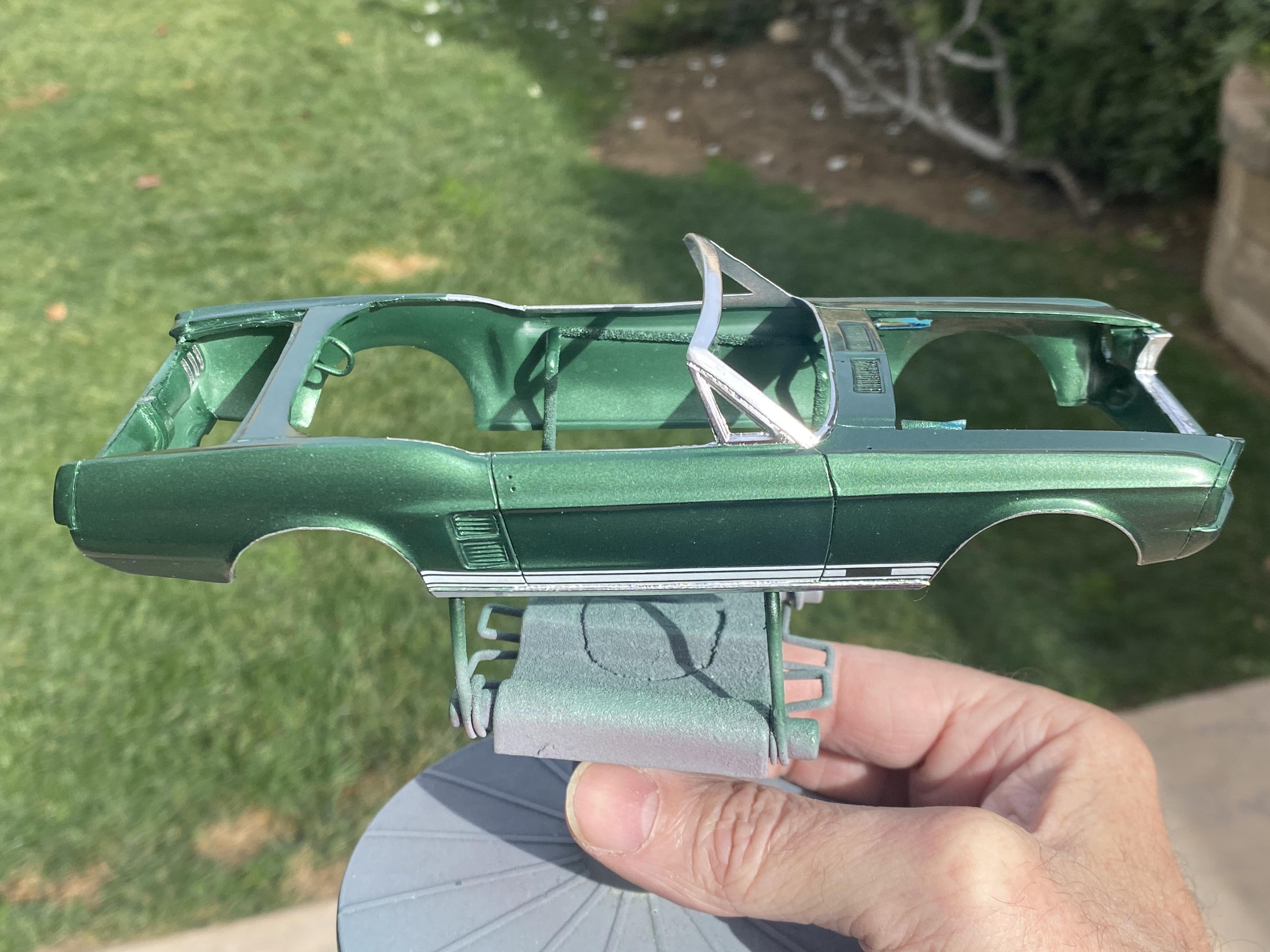

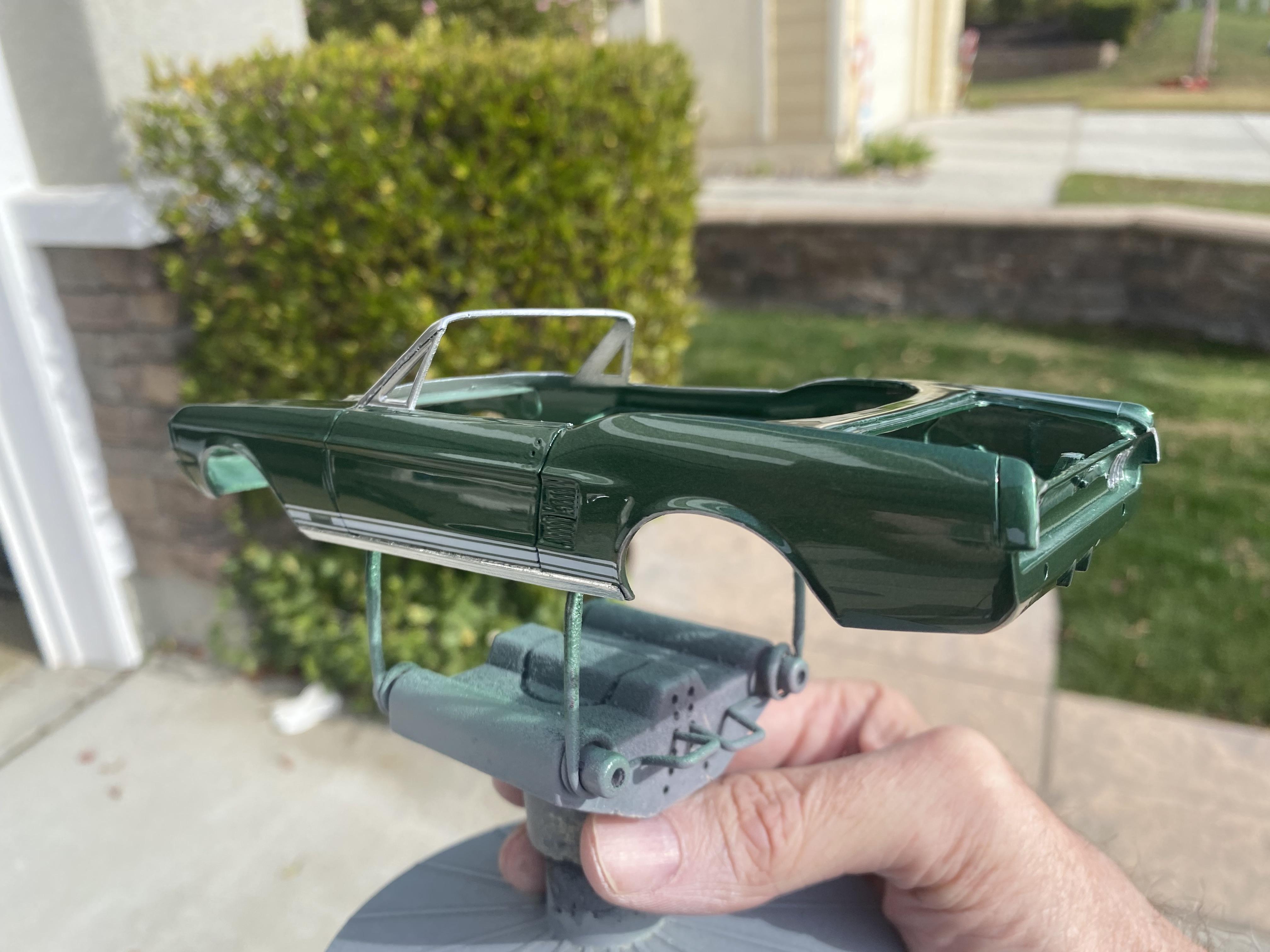

Duddly01 Posted December 11, 2024 Author Posted December 11, 2024 Got the 2K clear on the body today. Just a few specks of trash that will wet sand out easily when I get to the polish phase in a few days. 3 Quote
