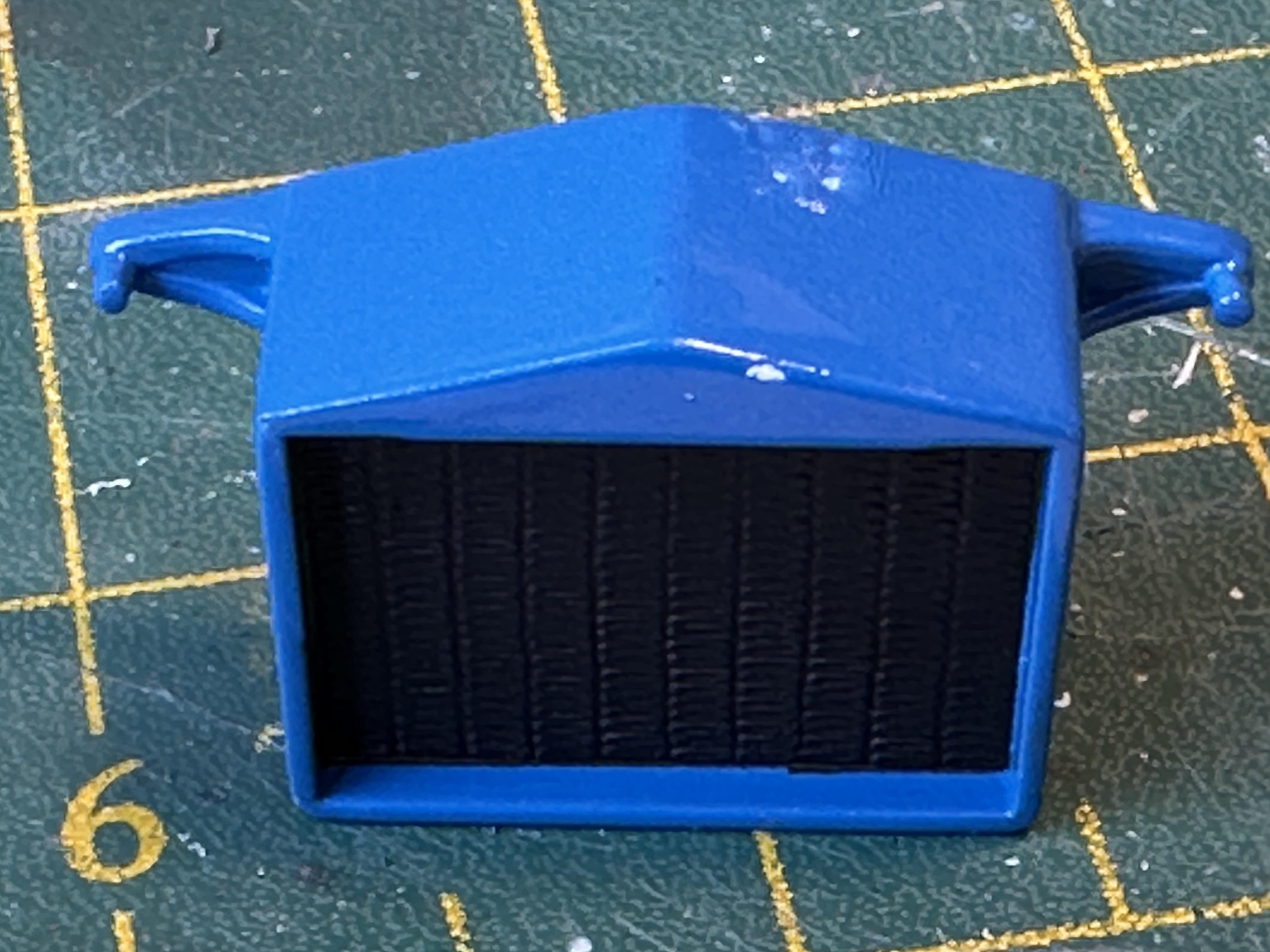

That Plasticated Guy Posted November 27 Share Posted November 27 I've been having problems with taping my projects to paint them. Now, I've been using Scotch blue tape for years and never had a problem. The problem is that a thin layer of adhesive is left over when I peel it off. I've tried WD-40, Goo Gone, and Isopropyl Alcohol. All they did was ruin the paint. I've tried to stick the tape to something else like glass or an old shirt to reduce the adhesion. No luck. I soaked the body in dish soap mixed with warm water. Diddly squat. Am I doing something wrong? Is there another brand of tape that's available at Walmart? Is there an actual solution that works? I don't want to have to order tape online or anything. By the way, I use rattle cans as part of the painting process. Quote Link to comment Share on other sites More sharing options...
stitchdup Posted November 27 Share Posted November 27 you could try polishing compound. i've had success with it on tamiya tapes when they leave the glue behind (though now they seem to eat into the paint) Quote Link to comment Share on other sites More sharing options...
hedotwo Posted November 27 Share Posted November 27 Same as Les I use a light polishing compound like Novus 2 or Tamiya Fine (or heavier depending on how much adhesive is left) on a pointed q-tip to gently polish it off. For what it's worth I use Tamiya tapes only but they aren't at walmart. Quote Link to comment Share on other sites More sharing options...
peteski Posted November 27 Share Posted November 27 Mike, since you mentioned that you have been using the Scotch blue painter's tape problem-free for years, what has changed to cause the problem? Is the blue tape different somehow? Are you using different type of paints/primer? Are you spraying the paint different way than in the past? Are you applying the tape to the painted surface before it is fully dry? That would likely cause the tape adhesive to soften and leave adhesive residue. I like Tamiya masking tape (or Washi tape) but I have used Scotch brand blue tape in the past without problems. Quote Link to comment Share on other sites More sharing options...
Fat Brian Posted November 27 Share Posted November 27 I've had issues with hot paint leaching through the tape and causing the paint beneath to look very similar to the pic you posted. Spraying in thinner layers can help that sometimes, the solvent evaporates before it has time to penetrate the tape. Quote Link to comment Share on other sites More sharing options...
iamsuperdan Posted November 27 Share Posted November 27 I've only had one tape issue so far. Many years ago, I masked the windshield of a Tamiya BMW Z3 with Tamiya tape. The mask worked beautifully! But when I removed the tape, it somehow reacted to the windshield and left residue, which I could not remove with anything. And the windshield itself was actually damaged, with little "holes" in the plastic, almost like the tape ate into it. I still use Tamiya tape, and haven't had an issue since. But I'm always nervous when masking glass now. Quote Link to comment Share on other sites More sharing options...
That Plasticated Guy Posted November 27 Author Share Posted November 27 Peter, the tape is the same and I mostly use Rustoleum paint. The other brand is Testors. And occasionally Krylon. All enamels. But I think that what you and Brian said might be one reason. I'll alter my spraying technique and wait it out overnight to a few days for the paint to fully gas out. If that doesn't help then I'll try the polishing that Les and Rich suggested. Quote Link to comment Share on other sites More sharing options...

Dave G. Posted November 28 Share Posted November 28 It may not be adhesive you're dealing with, but rather tape impression in the paint film. I say that since no adhesive removers removed it. 2 Quote Link to comment Share on other sites More sharing options...
Straightliner59 Posted November 28 Share Posted November 28 53 minutes ago, Dave G. said: It may not be adhesive you're dealing with, but rather tape impression in the paint film. I say that since no adhesive removers removed it. That's an excellent suggestion. If so, the polishing compounds might well be effective. Quote Link to comment Share on other sites More sharing options...

Zoom Zoom Posted November 28 Share Posted November 28 5 hours ago, Dave G. said: It may not be adhesive you're dealing with, but rather tape impression in the paint film. I say that since no adhesive removers removed it. To add to this, the tape impression is due most likely to having trapped solvents that have not fully dried out, especially if a quality masking tape was used, and hardware store tapes meant for home improvement work don't count, there are far better masking tapes out there for your models, like Tamiya's or yellow Frogtape for delicate surfaces which can be bought from big box stores like Home Depot. Thinking one will save a few bucks by using cheaper masking materials isn't worth it if you have to strip/repaint, often repeatedly, the same can be said for the paints themselves. I see builders all the time comment about tape residue when the fact is there was no residue left behind, but impressions of the tape's texture from uncured paint that was masked. I learned this on my own the hard way, now it never happens anymore, and I do a lot of masking. I also learned to not leave tape on any longer than necessary, trying to remove masking tape before the accent color itself has cured, often within 10 minutes or so after shooting the accent color. Also, don't put masked parts into a dehydrator, unmask the part before using the dehydrator. Using quality hobby lacquers is cost-effective due to quick drying/curing times, so there's less chance of masked areas getting damaged from uncured solvents below the surface. Patience is key, let stuff dry the appropriate amount of time before masking. Current project (ZoomOn Toyota bB OpenDeck), a lot of masking was involved, including multiple steps on the body for the main color, roof color, gloss black areas and matte black areas. It would have been a mess if I had tried brush painting the gloss & matte black areas... 1 1 Quote Link to comment Share on other sites More sharing options...

StevenGuthmiller Posted November 29 Share Posted November 29 Yup, it’s my guess that what the OP is experiencing is the tape’s impression in the paint, and not actual adhesive residue. Adhesive is actually quite easy to remove in a variety of ways. Letting the paint cure completely, (with enamel, that could be quite some time) and using good tapes will eliminate any issues such as this in the future. You can do some amazing things with good masking tape! Steve Quote Link to comment Share on other sites More sharing options...

bill-e-boy Posted November 29 Share Posted November 29 A few things from the above that I agree with - The issue looks like the tape adhesive burning into the tape not tape residue - And yup - keep it out of a hot environment. Put it in the dehydrator by all means but leave the heat off - Cheap aint always the best - Letting paint cure before masking helps - all about patience - Dont rush it - patience again - And Tamiya masking tape can burn into a paint job This was done recently - Testors enamel thinned with Testors reducer through air brush. Tamiya masking tape - factors that I see that caused issues are fresh paint and heat in my paint curing box (like a dehydrator). I masked the blue to paint the flat black - just a bit hard to see the manky result but it looks like orange peel and the white was where the The whole issue of masking tape affecting paint jobs is debilitating to say the least Quote Link to comment Share on other sites More sharing options...
