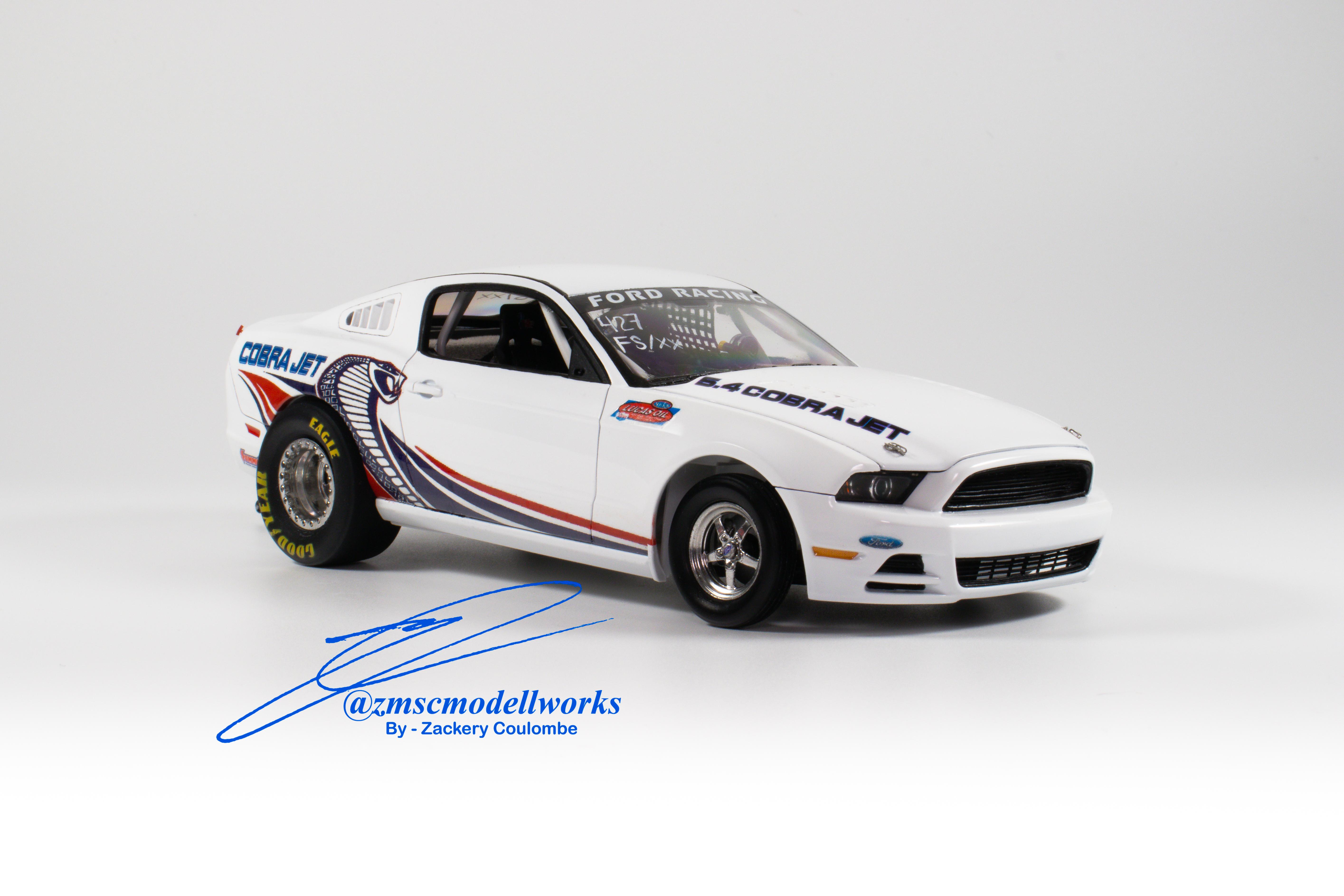

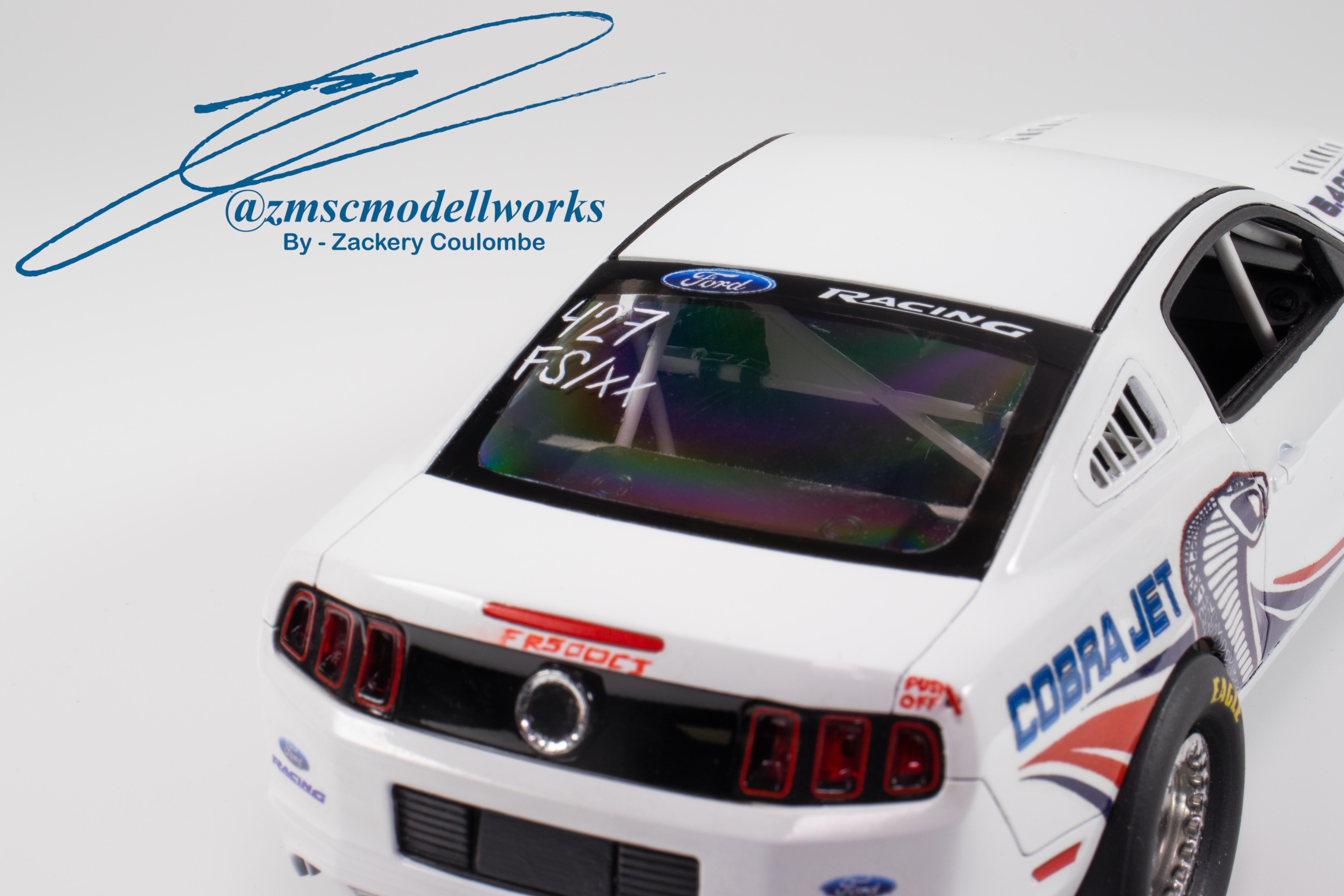

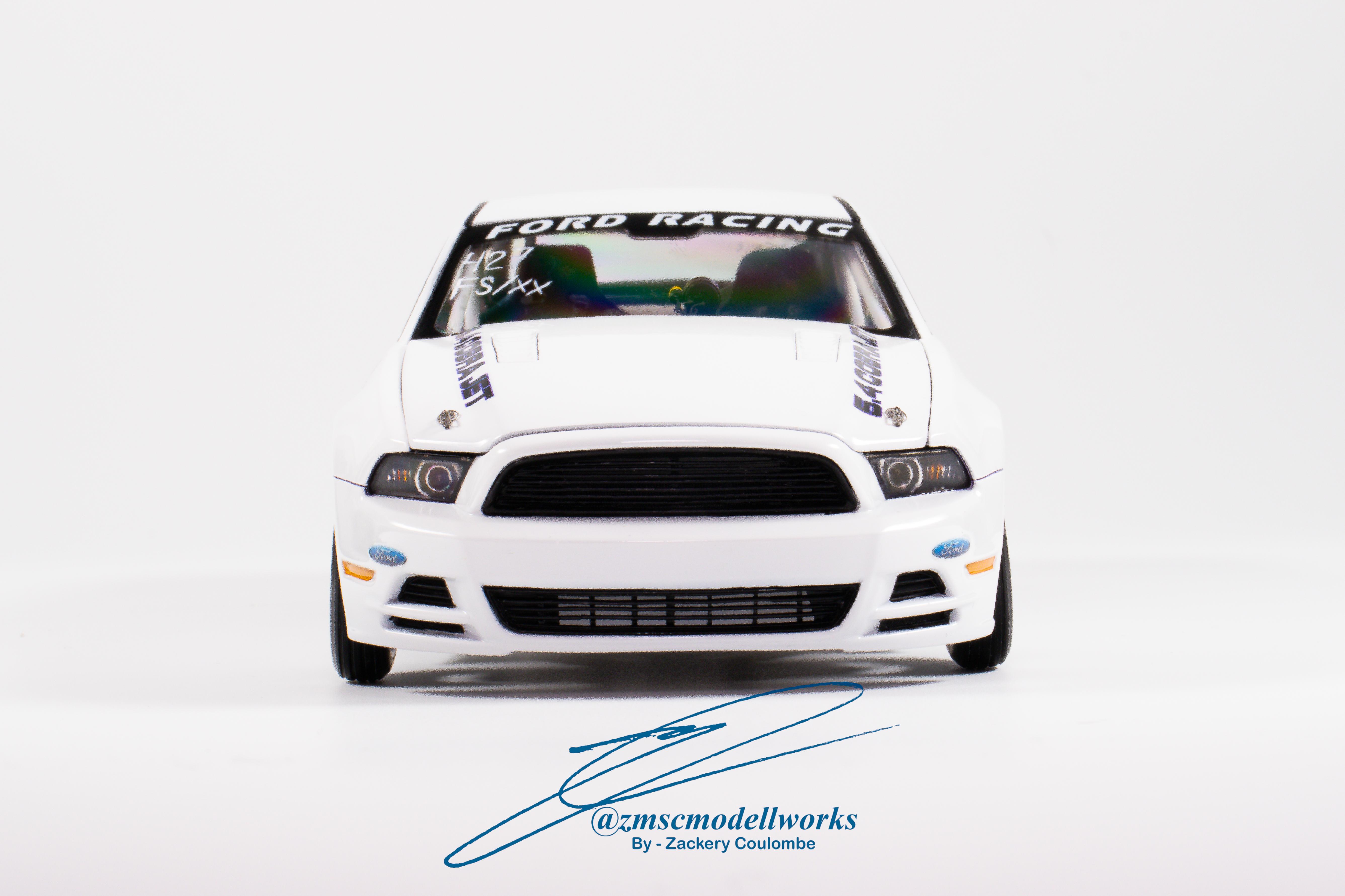

Converted from a 2013 Mustang GT, plenty of modifications tho its better to just read it from my site as that's where it was recorded. Here you just get to see the ub-bridled beauty. Most notably is the window net is poseable, cage was built from scratch, and decals wee knockoffs of the Slixx set. Because of me not knowing at the time and finding out later, I went and bought the whole Cobra Jet line and intend to build them all as an apology to Slixx and to myself for not doing my research.

Pretty sweet late model Mustang build. Headers and the whole under carriage looks fantastic. I like the adjustable rear anti sway bar, for added traction.  I have a late model Firebird Formula I’d like to build in a similar way.
Bro, your Mustang is outstanding..The only thing it's missing is the Cal-Tracs bars for wheel hop..I see you put some FS decals on it..Instead of XX, I would put FS/AAA because it looks like you have an automatic in the the car..If it was a stick it would FS/AS..The build is really a nice rendering of those FS cars..I'm on a NHRA Top Sportsman team and love watching Super Stockers/Stockers run..The detail you put into this build is outstanding..Great build and I can't wait to see what comes out your head..The reason I would put XX on the car is because NHRA uses that for experimental cars...If you're calling it that, then you are correct. Not knocking your build because again, it's a Bitchin build!!!

@Maurice Henderson Thank you a tonne for your criticism, and just so that its clear, this is NOT sarcasm. I truly do appreciate when someone with more experience and more knowledge tells me exactly where I went wrong or how I should have done things.
This was the first drag car I really build with intent. It was part of a 2 month Racing The Strip buildoff on instagram. Box unopened. The intent was originally to build the CJ but when I opened the box I had no idea the amount of work that was going to be undertaken. I found alot of my references on places like bringatrailer and Mecum and compiled them HERE . Yes the transmission is not correct as it was a compromise between fitment and time. it should have a 3spd Auto but instead is a 5spd stock tranny from the kit. I did manage to find the proper engine/ transmission combos now so when I do the next one it will be 3D printed and accurate. The window markings were a total guess, and I guess were almost right. I believe ( and correct me if I'm wrong because of your knowledge) but the original 3 test mules Ford sent out to test wore XX markings. Again, could be wrong but at least I guessed half right.
Thanks again for your feedback, and in the future, do you have any resources to look at for markings and classes? I have a few more factory stock builds in the lineup that I would like to get right next time. PM me with those details when you have a minute because I would love to pick your brain.

I'm not up on all the nhra stock/super stocker rules but cal track bars are designed for leaf spring suspension setups, these s197 mustangs used 3 or 4 link rear suspension i believe.  Awesome build though, very nice detail.

Bro  you build is really nice..For your 1st drag car really nice..For classes you can Google NHRA classes indexes or NHRA Factory Stock or Super Stock..You will get a breakdown of class indexes..If you type Factory Stock indexes you will see halfway down the list Factory Stock..It will show the class like FS/AAA..Google pics of Factory Stock cars and you will see different cars for the class..Factory Stock Showdown cars are a heads up class with Mustangs, COPO Camaros and Drag Pac Challengers that motors that can't be no bigger 350 cubic inch and supercharged on a 9" tires..Make 1500 hp and run 7.70's @180mph..You tube is great source.. Again outstanding build..

That is one Great looking Ford Cobra Jet Zack.  I love everything about it this build.  Nicely done.
