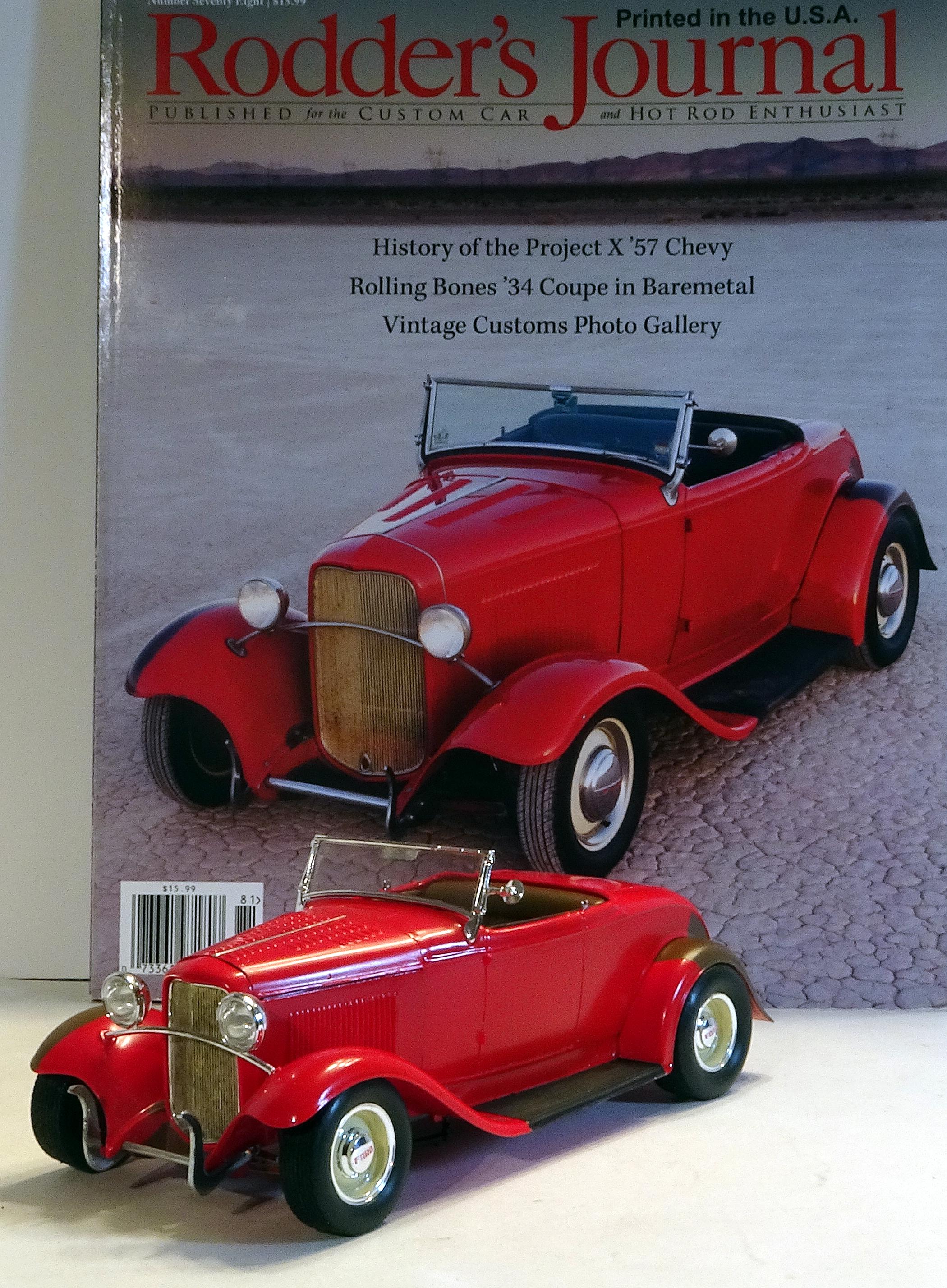

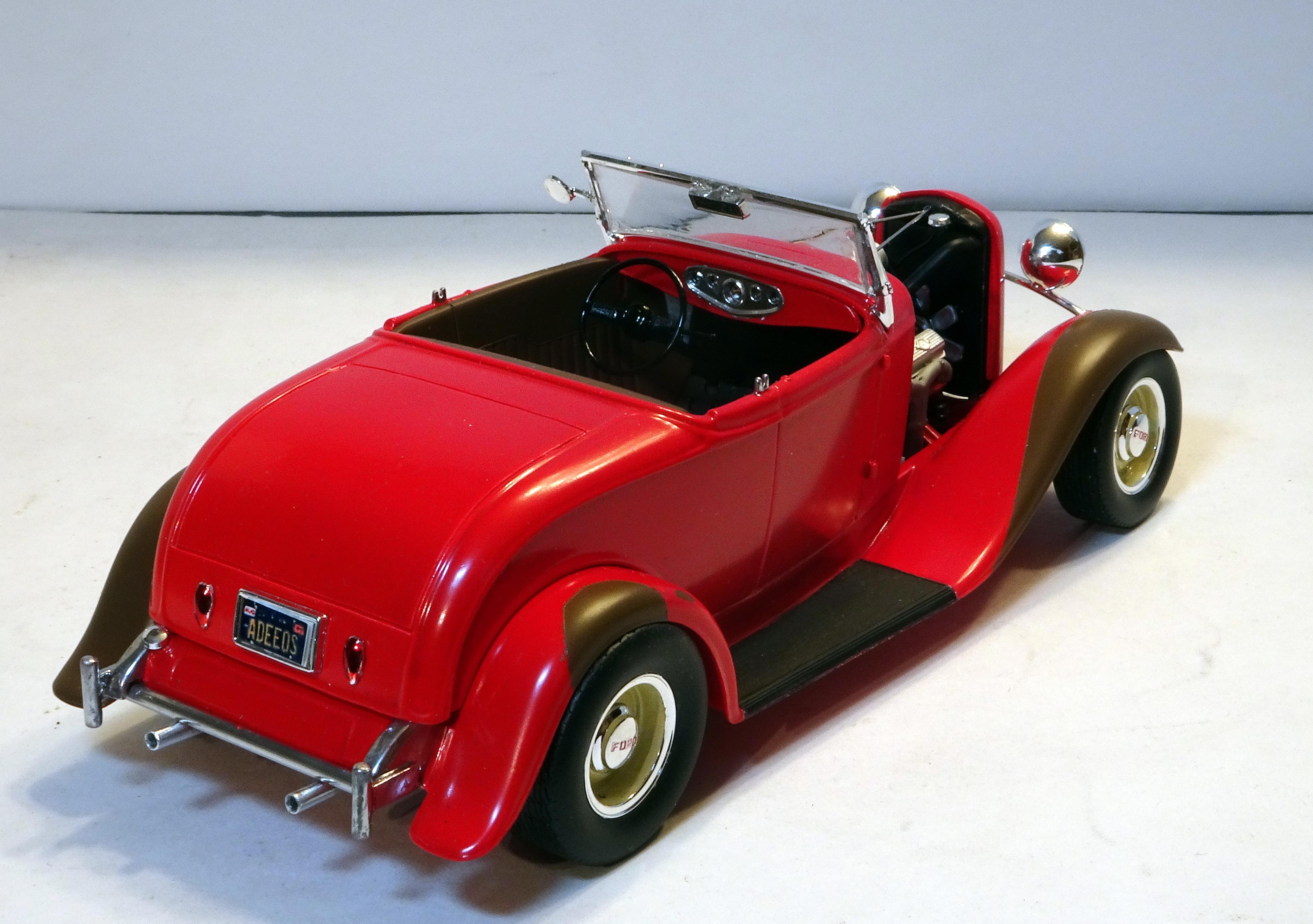

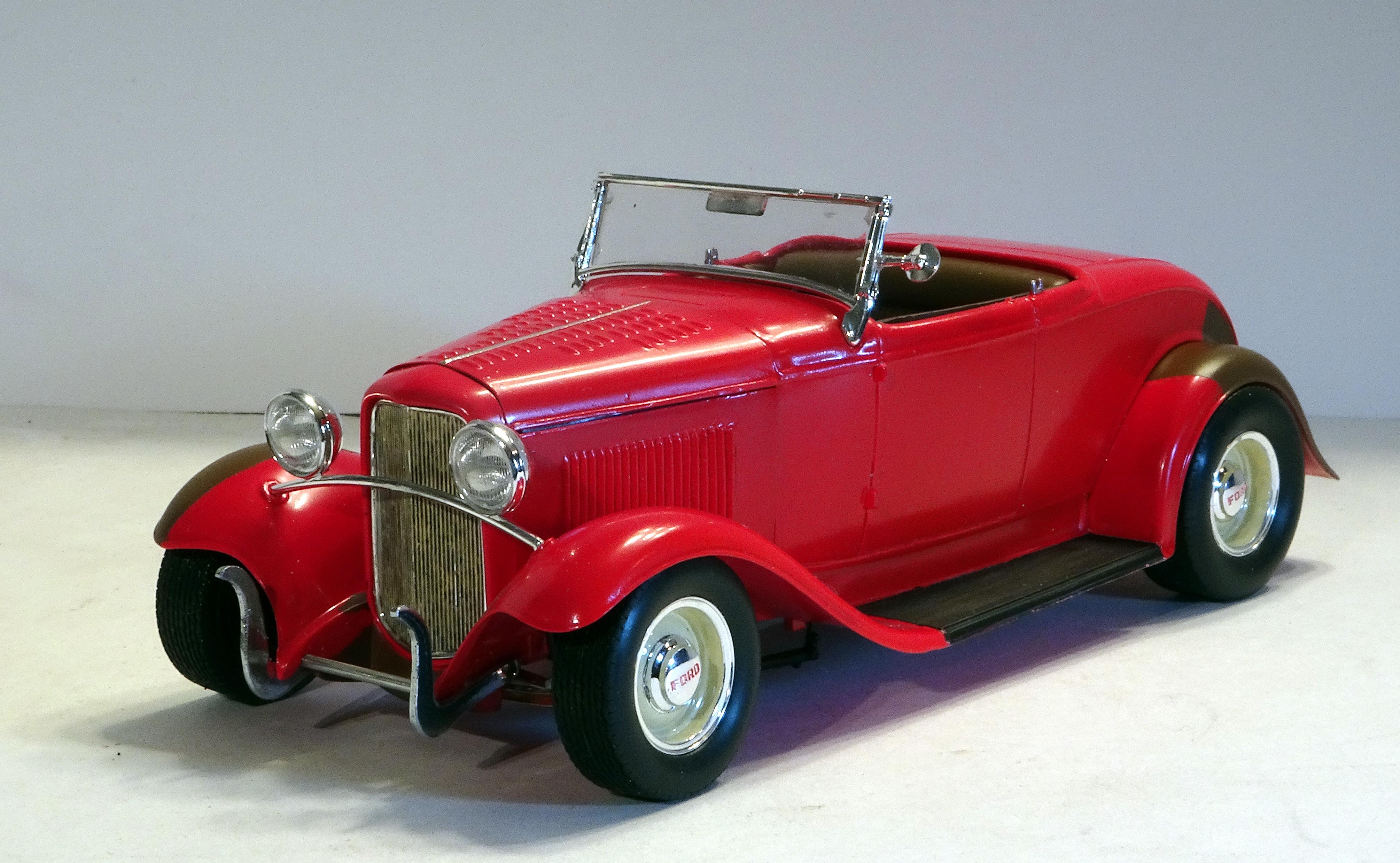

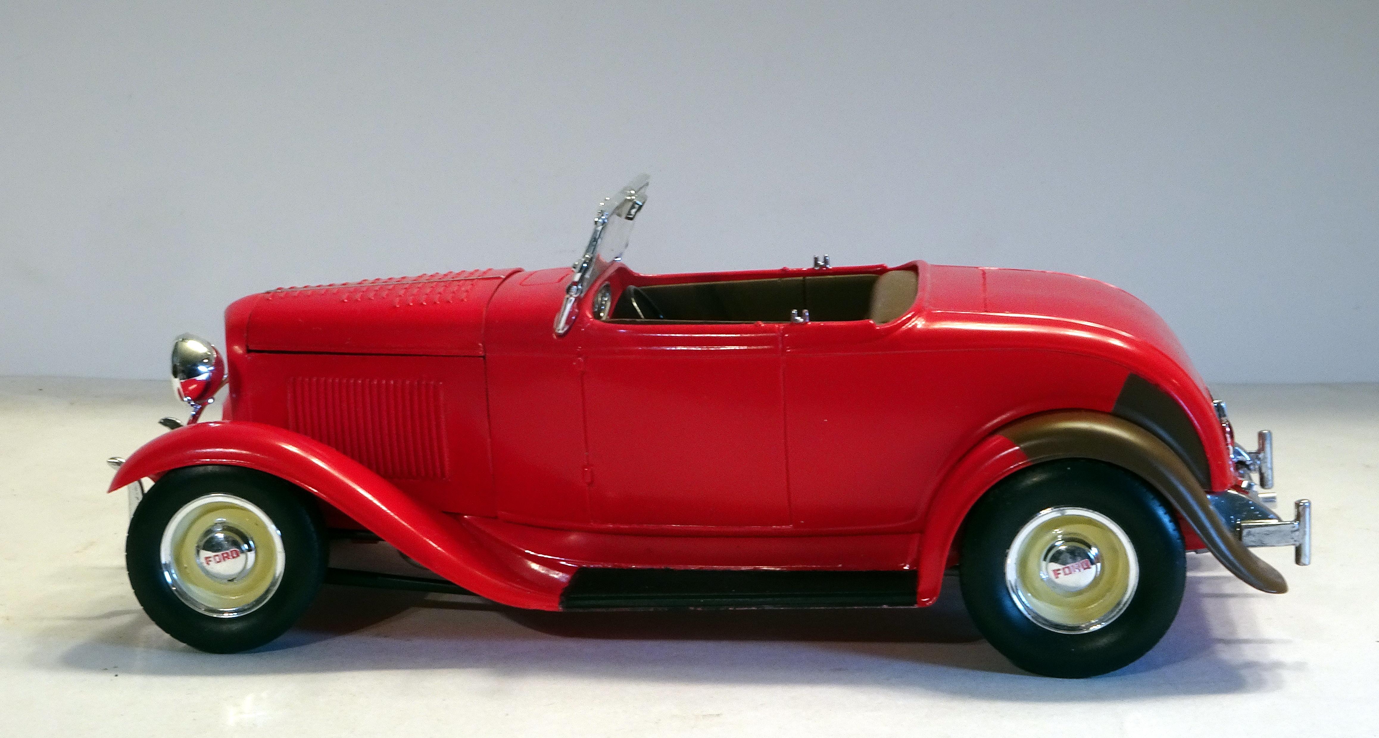

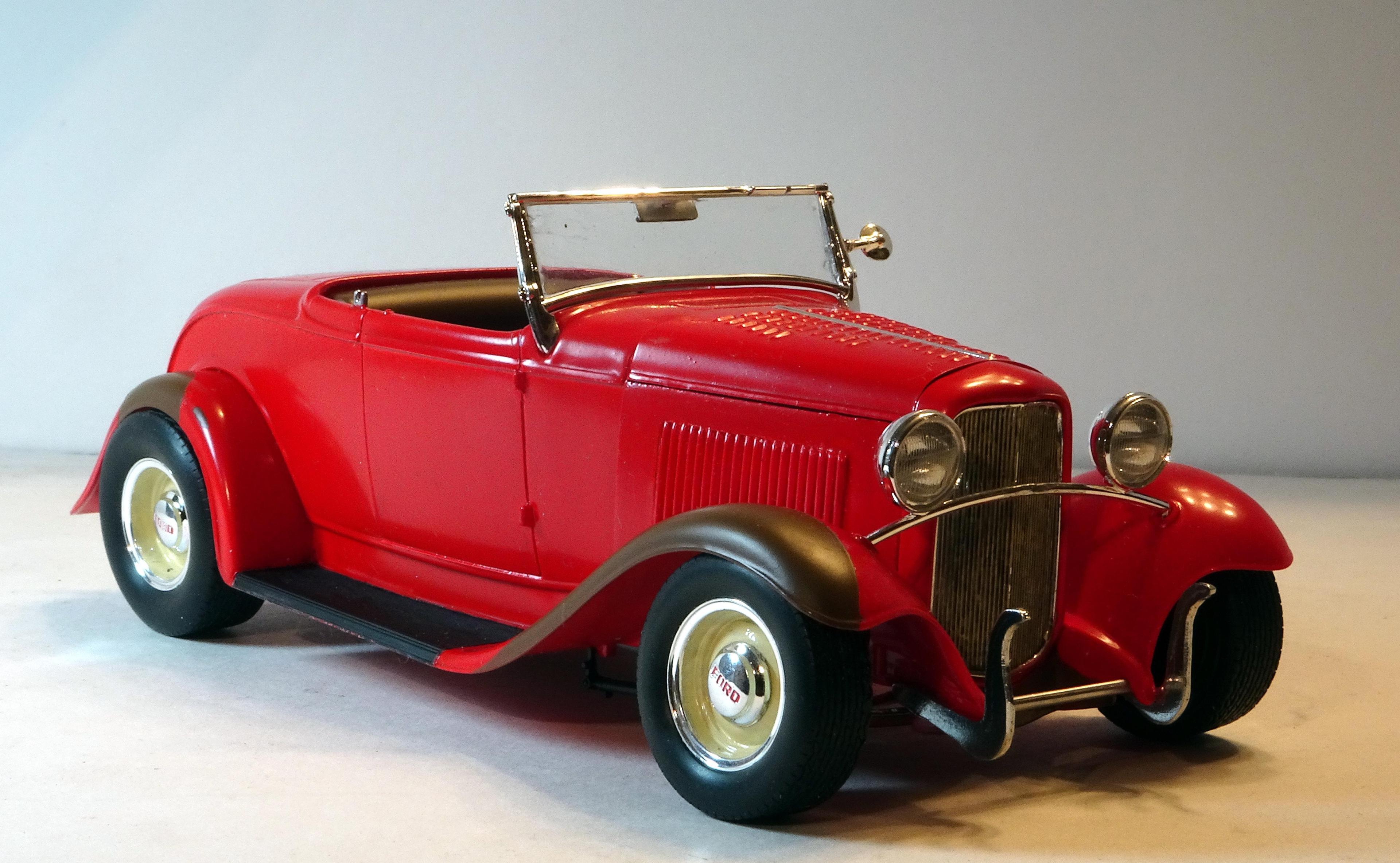

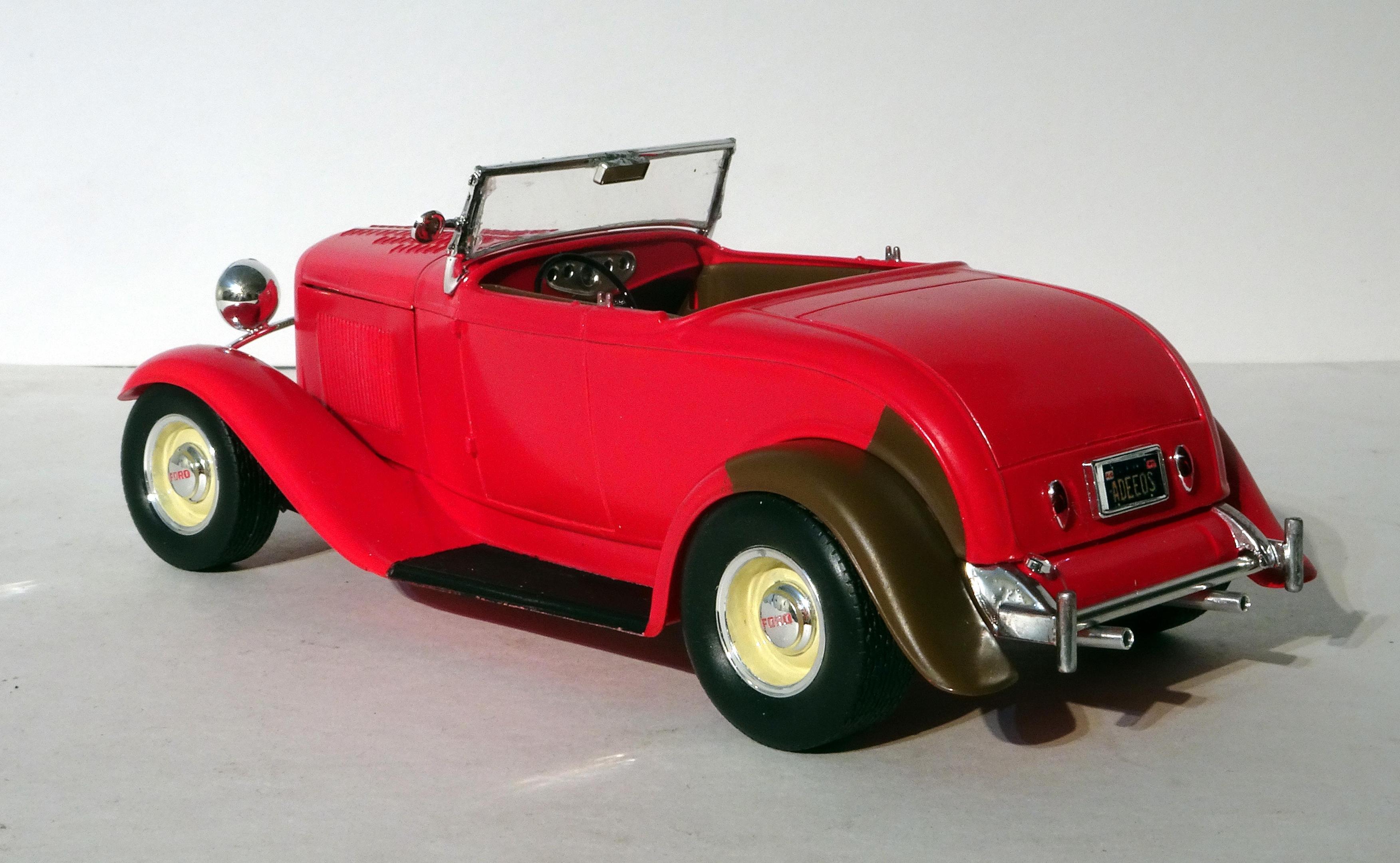

This model is a tribute to the well known ’32 Ford Roadster that was the daily driver of the late - lamented Gray Baskerville who was a popular photographer and writer for Hot Rod and Rod & Custom magazines. In 2007 for the 75th anniversary of the ’32 Ford, Gray’s hot rod was identified as one of 75 most significant Deuces. A cover story on the car that appeared in Rodders’ Journal made me realize how similar in many respects the 1/24 Revell/Monogram ’32 Roadster kit is to Gray’s car. My intention was not to build an exact replica but a model that captures many of the distinctive features of Gray’s hot rod as I really enjoy building tribute models. With some previous models I have strived for them to be very close replicas but lately my new strategy has been “close counts” or least making the model recognizable or reminiscent of the actual car that inspired it. For instance, with this model, I concentrated on the upside but maintained the kit rearend and transmission. Gray’s rod had a ’52 Lincoln rearend with split wishbones and the transmission was a Powerglide.
2024-11-2919_14_45.thumb.jpg.ee11145d272a4f2080b9724667eb438b.jpg2024-11-2919_18_01.thumb.jpg.8ad404d726145574b5118ec645b42906.jpg
ALTERATIONS & ADDITIONS
Removed bumper brackets and fabricated nerf bars
Aluminum spreader bars front & rear
Firewall to radiator stay rods are sewing needles
Added radiator cap
Filled holes for door handles and rumble seat handles and smoothed the radiator grill shell top
Removed V-8 emblem from headlight bar
Headlight lenses from current Revell Model A kit
Column shifter steering column from AMT ’49 Merc with a ’40 Ford steering wheel from Rev 5-W kit
Adapted interior from Revell 5-Window Coupe
Black faced gauges added behind drilled out kit dash
Rearview mirrors added the windshield
Grafted in stock hood side louvers from Rev 1/25 Deuce kit
Lowered suspension front and rear
Body painted with Tamiya Italian Red overcoated with Simi-gloss clear. Interior and primer painted with Tamiya Red Brown

I looked up images of the original car, and your build is very faithful to the original. I like it a lot. Cool looking 32.👍🏻
Great job capturing the look of the real car. Correct shade of red and the primer. Realistic looking engine and interior details. The Nerf Bars, wheel color and hub caps, mirrors, and license plate are all correct.
