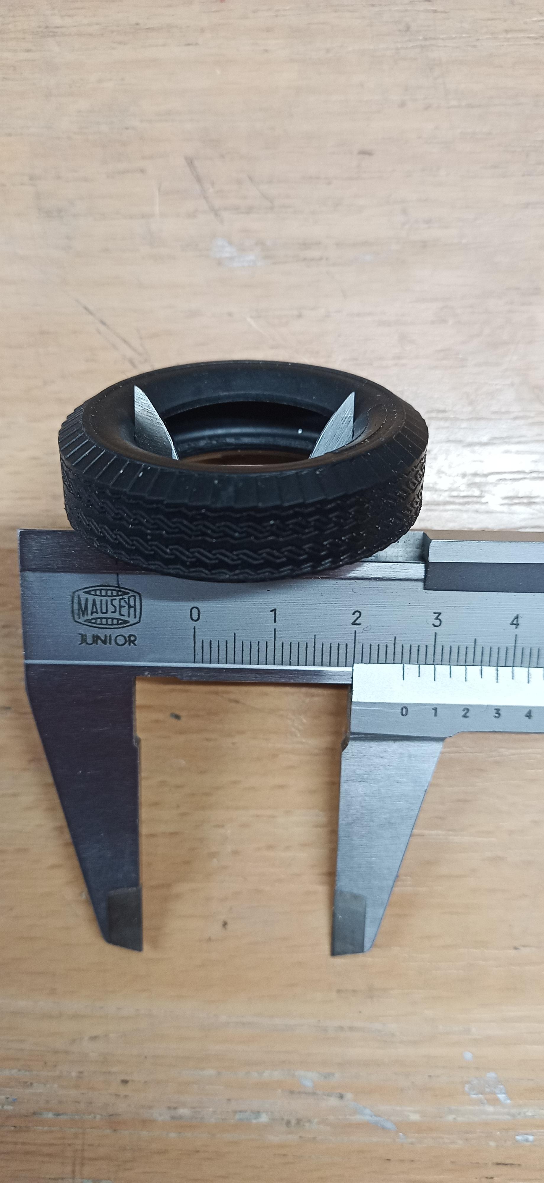

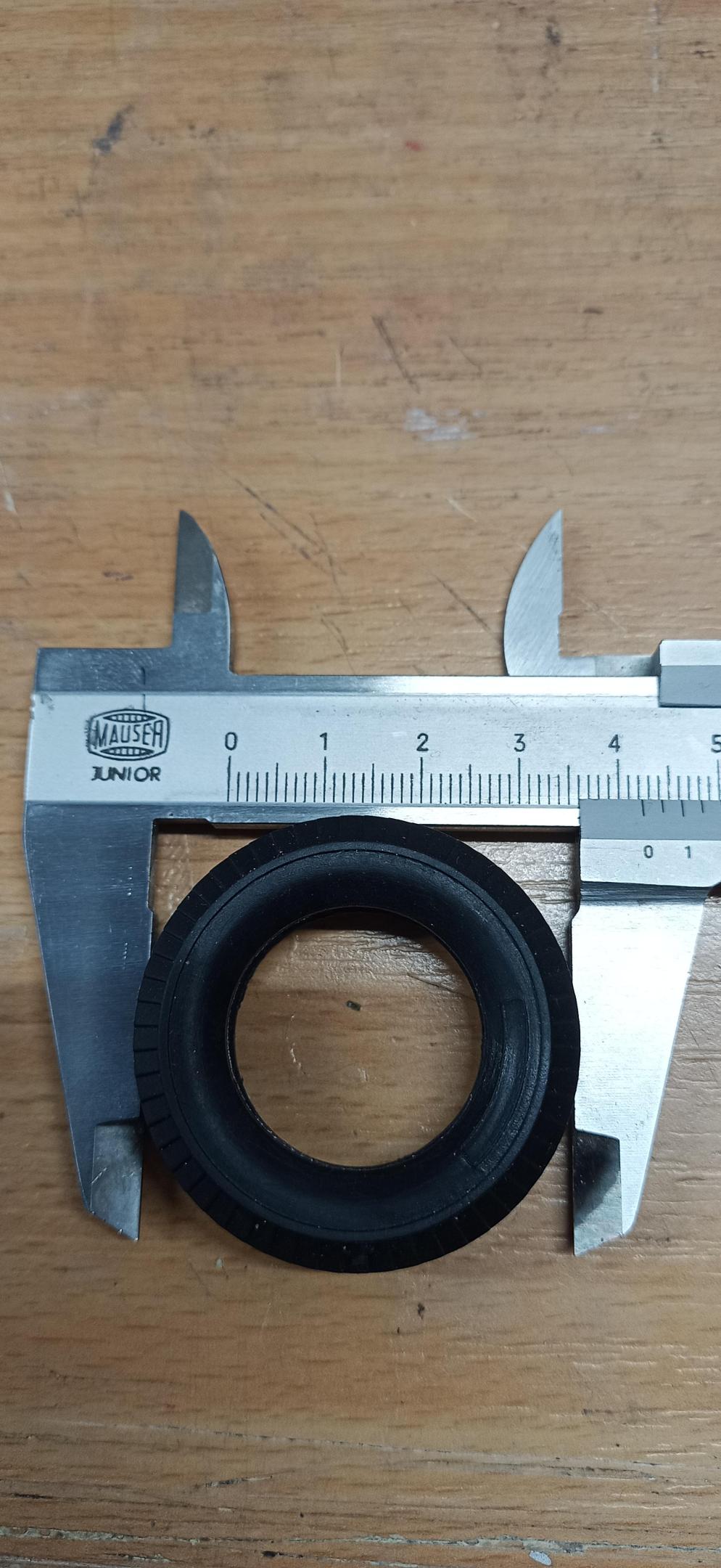

Hi James,
No problem!
The inside diameter is 26mms.
The outside is 42.5 mms!
They're nice tires! Look pretty good!
Don't wanna hijack, just for you to see how they look!

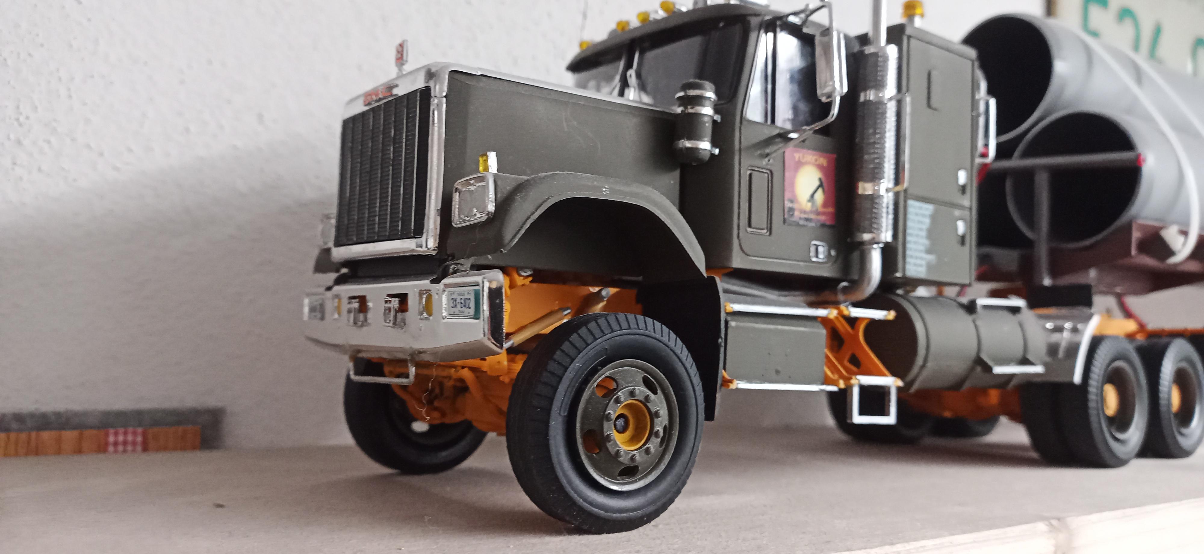

Hey Scott, nice looking rig!
Just a tip, tyo get the tires to fit tighter to the rim I use rolled up napkins or kleenex to hold they out at the bead.

I actually believe that these tires are 1/24 even if sold as 1/25! I used 1/24 rims for my General and they fit perfectly! Otherwise I would have had to print some!
Edited by Jürgen M.
  • Like 2
