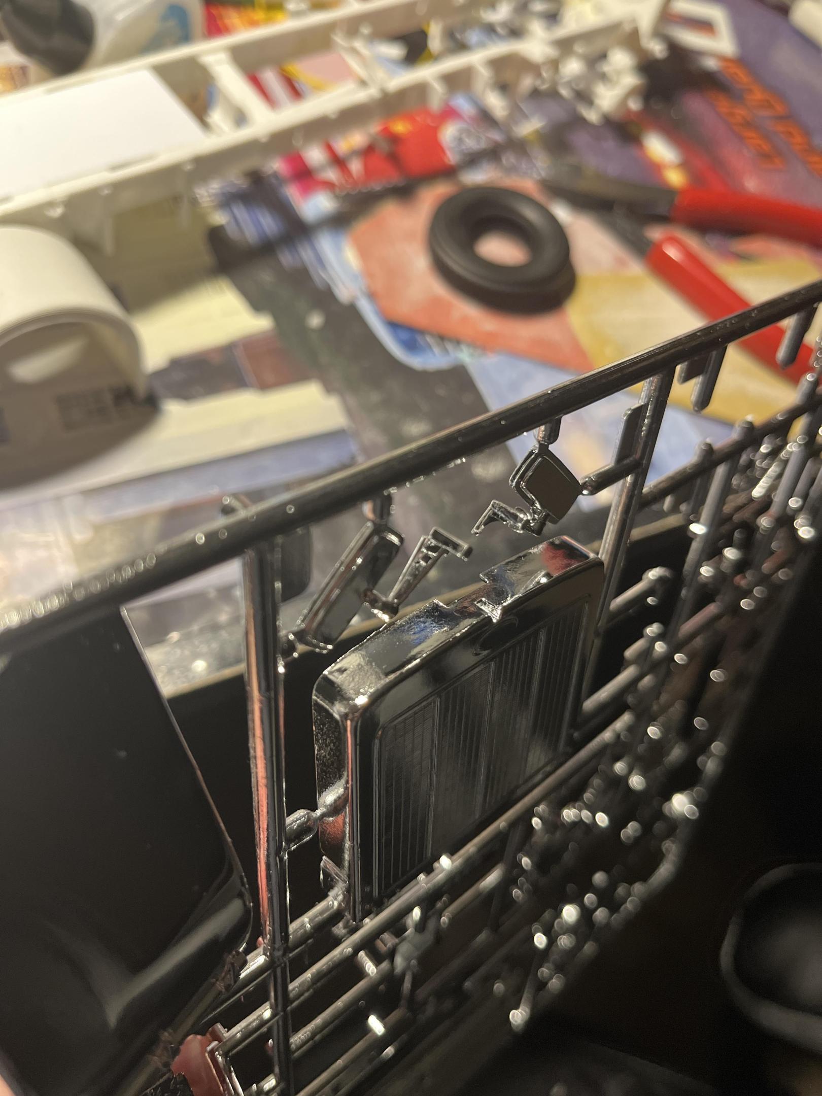

BOZ Posted December 28, 2024 Author Posted December 28, 2024 First major problem has been encountered. Many of the pieces of this kit have come with scratches on them. I hoped to correct this by sanding with 1500 grit sandpaper and using high build primer. I went to paint some of the larger body pieces today, and found that my effort to repair these scratches was not enough. Time for some more sanding of these areas and possibly putty work which will hopefully correct the problem. There is also a large spot on the grill which I am unsure how I will correct at the moment. 3
ShakyCraftsman Posted December 28, 2024 Posted December 28, 2024 Hey BOZ Use some Mr. Surfacer 500 or 1000 on the paintable parts. Use Molotow pen on the grill. Ron G 2

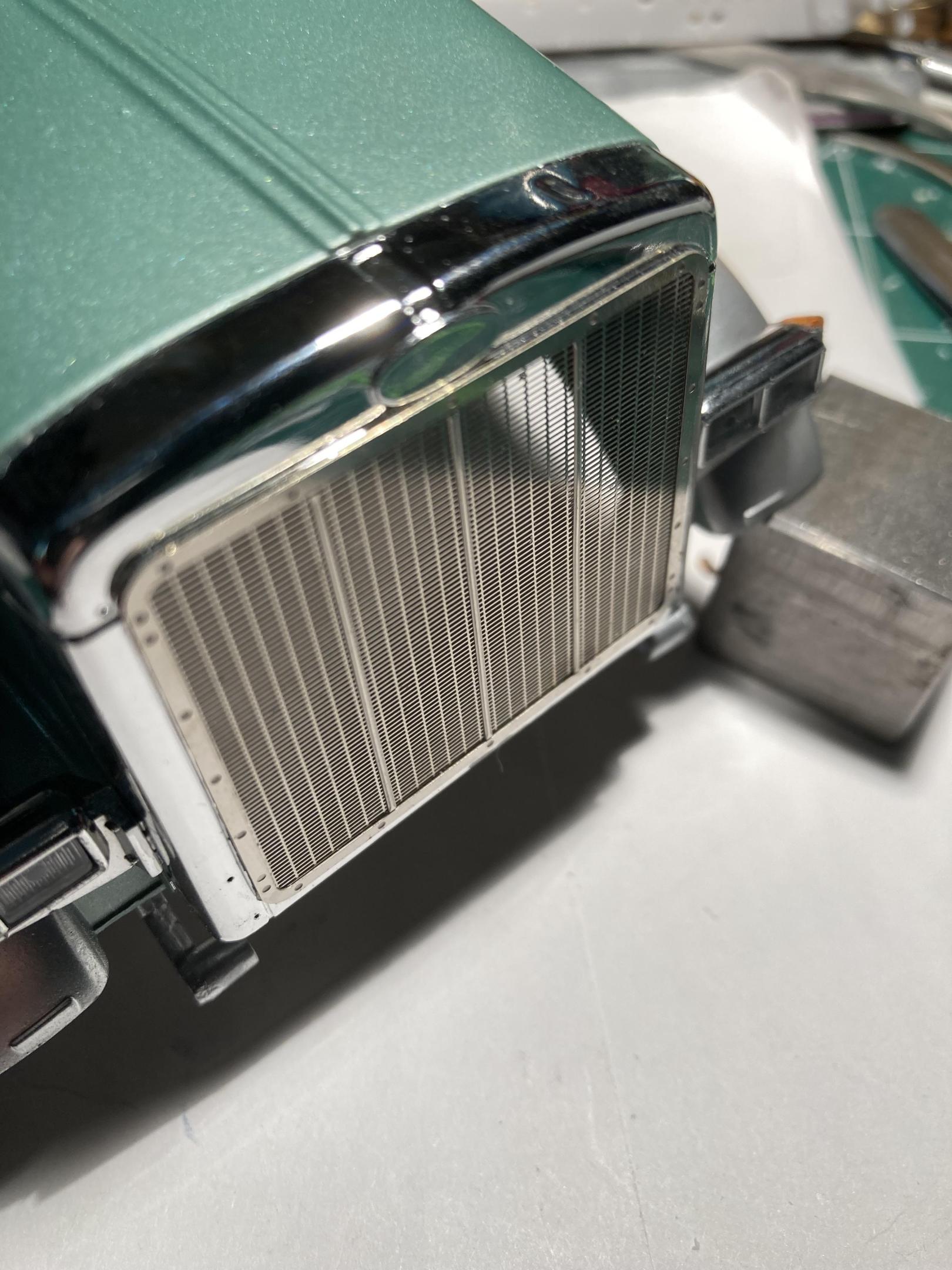

Biggu Posted December 28, 2024 Posted December 28, 2024 A p/e grille would look awesome on this build. 2

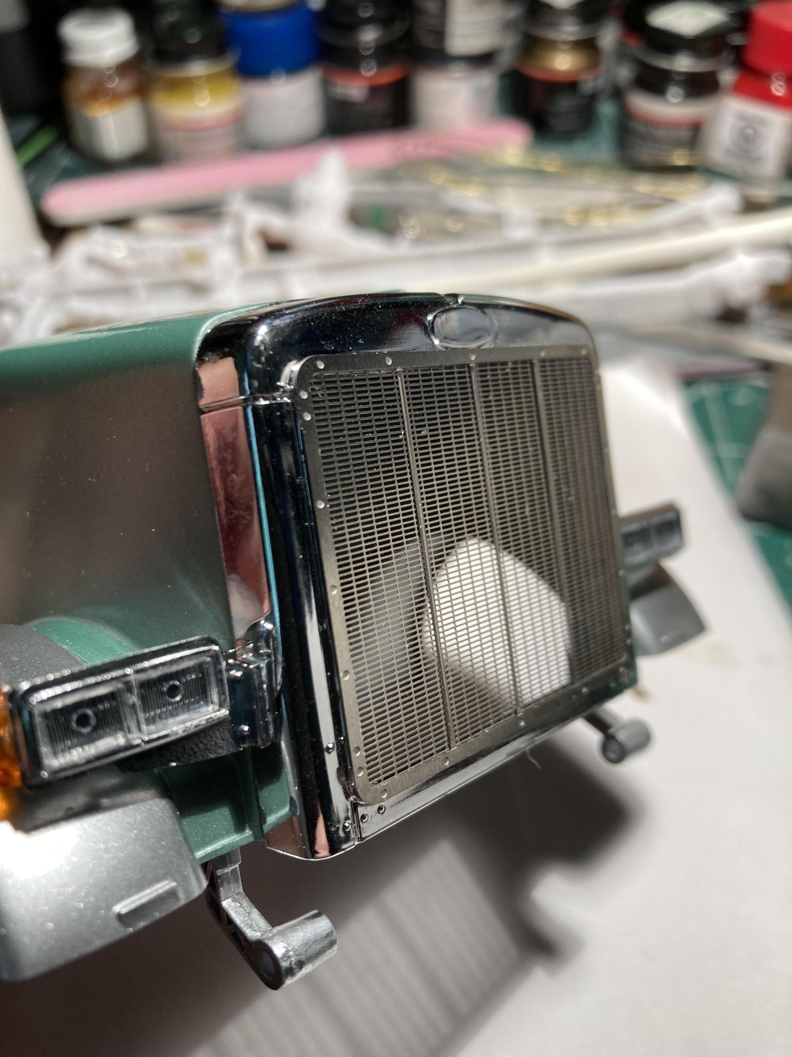

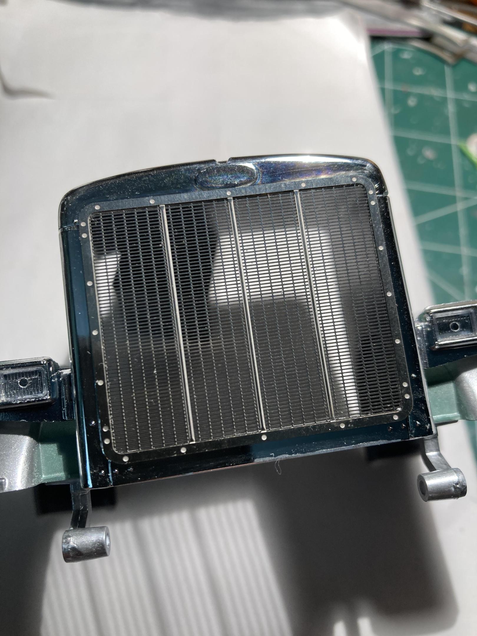

Biggu Posted December 28, 2024 Posted December 28, 2024 52 minutes ago, BOZ said: Not sure what you mean by p/e? Photo etch like I did with my Pete, pics for reference not to highjack your thread 2

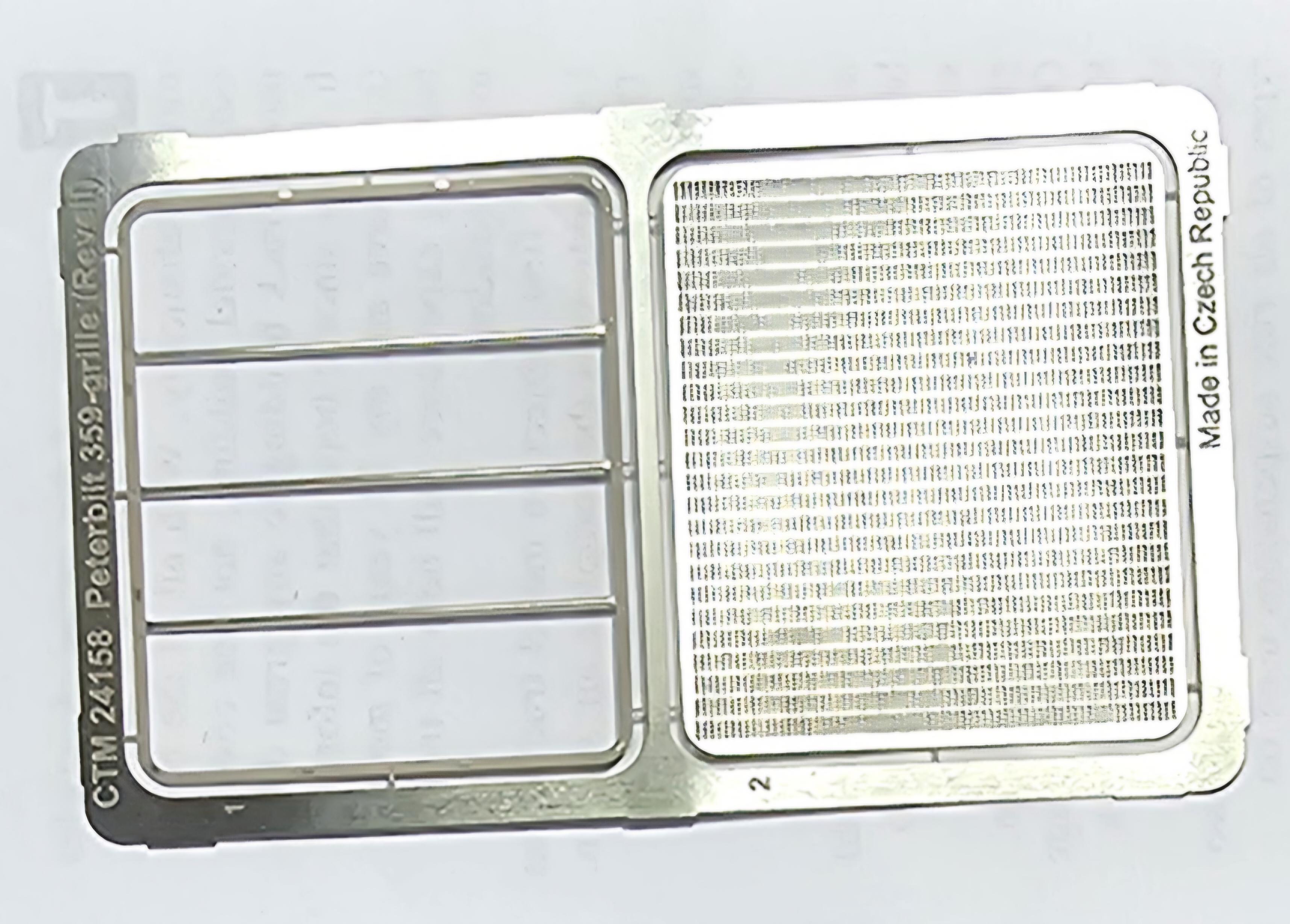

ShakyCraftsman Posted December 28, 2024 Posted December 28, 2024 54 minutes ago, BOZ said: Not sure what you mean by p/e? CTM has a set for the ROG Pete's Ron G 2
Biggu Posted December 28, 2024 Posted December 28, 2024 Just now, ShakyCraftsman said: CTM has a set for the ROG Pete's Ron G That's the set I had in mind. I think that upgrade will make this build epic. 3
BOZ Posted December 28, 2024 Author Posted December 28, 2024 32 minutes ago, Biggu said: Photo etch like I did with my Pete, pics for reference not to highjack your thread No worries, thank you for the reference pics. I don’t have any experience with photo etch, does it include the whole grill or just that insert? 1

ShakyCraftsman Posted December 28, 2024 Posted December 28, 2024 1 hour ago, BOZ said: No worries, thank you for the reference pics. I don’t have any experience with photo etch, does it include the whole grill or just that insert? Just these two peices. 1 1

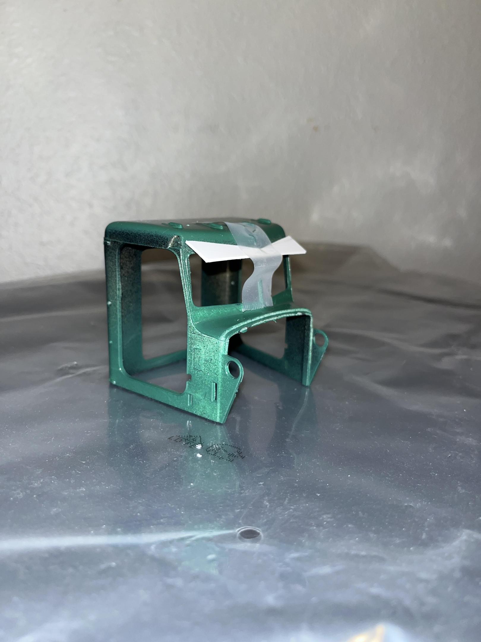

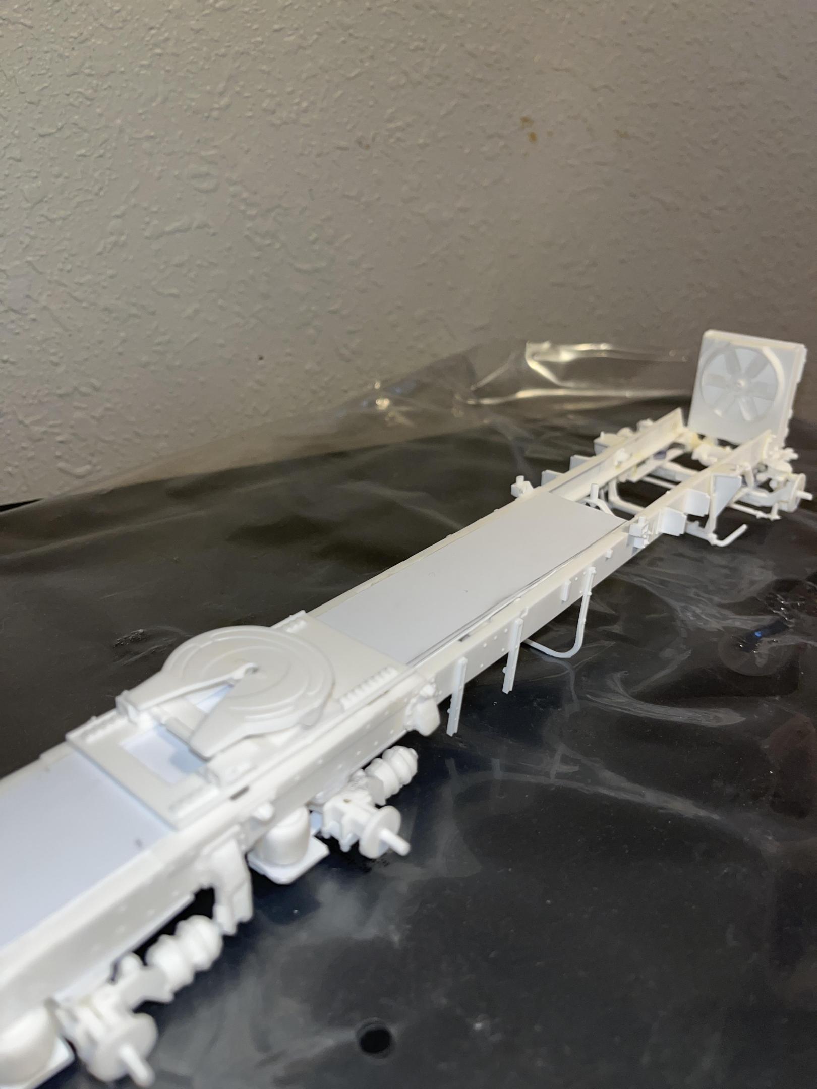

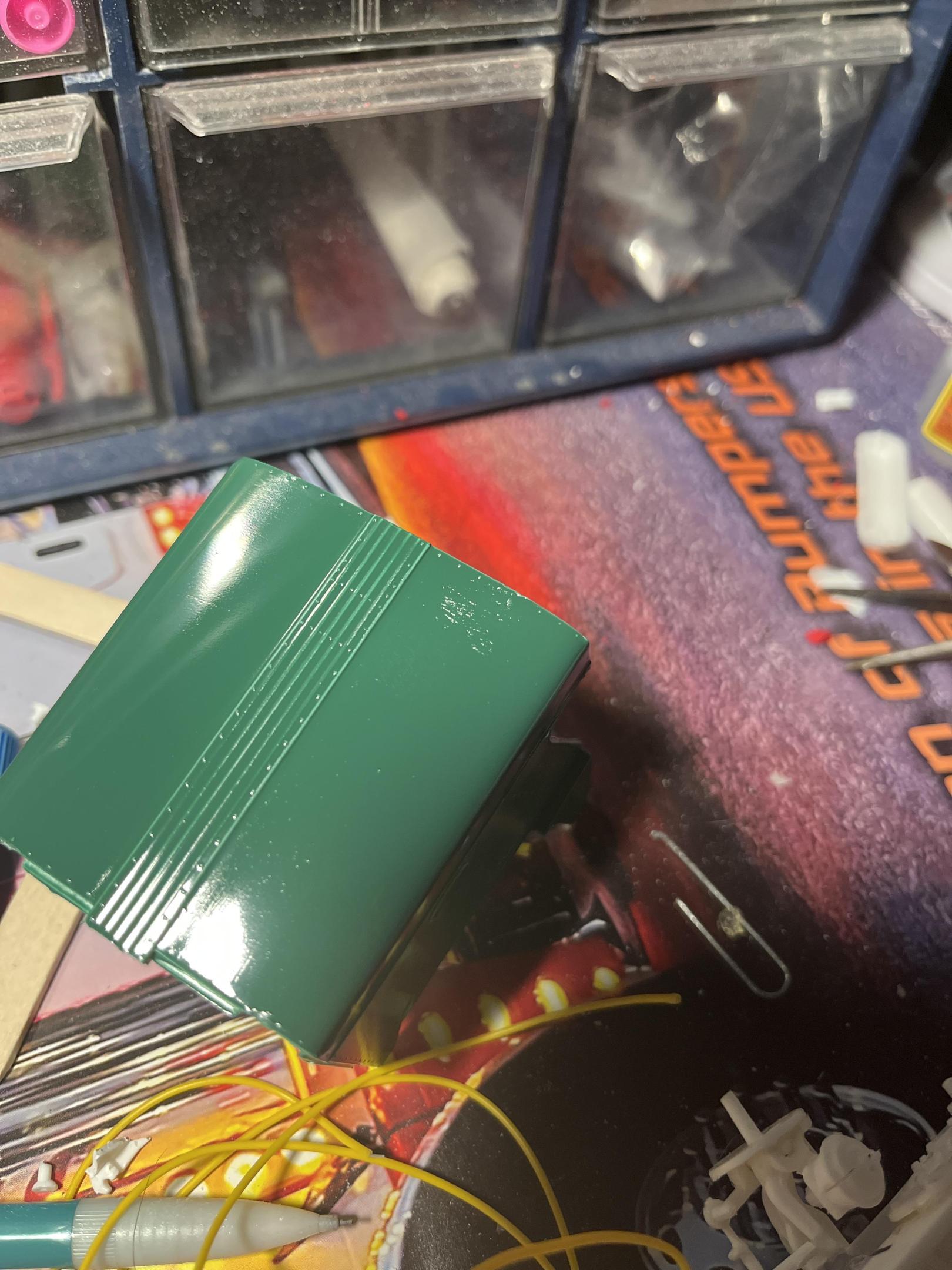

BOZ Posted January 4 Author Posted January 4 Wasn’t able to spend much time at the bench this week but was still able to get a few parts made and make some headway on this build. I fabricated: Custom “little window” style visor from sheet styrene Deck plate which will run the full length of the frame I also made a few filler panels which will go in between the rear fenders. A few parts were painted this week including the engine and hood. I have also made the decision to convert this truck to a day cab and ditch the large sleeper so stay tuned for updates on that. 2
ShakyCraftsman Posted January 4 Posted January 4 2 minutes ago, BOZ said: Wasn’t able to spend much time at the bench this week but was still able to get a few parts made and make some headway on this build. I fabricated: Custom “little window” style visor from sheet styrene Deck plate which will run the full length of the frame I also made a few filler panels which will go in between the rear fenders. A few parts were painted this week including the engine and hood. I have also made the decision to convert this truck to a day cab and ditch the large sleeper so stay tuned for updates on that. Hey Boz You need to get ride of the line that runs down the front window pillar to the hood, on both sides. It should not be there. The horizontal one from the door opening to the hood is okay. Ron G 1 1
BOZ Posted January 4 Author Posted January 4 3 minutes ago, ShakyCraftsman said: Hey Boz You need to get ride of the line that runs down the front window pillar to the hood, on both sides. It should not be there. The horizontal one from the door opening to the hood is okay. Ron G Yup, I just hit the cab with a bit of green since it shows those lines off a lot more than white, they’ll be a lot easier to remove now that I can see them easier. Thank you for the reminder! 1
