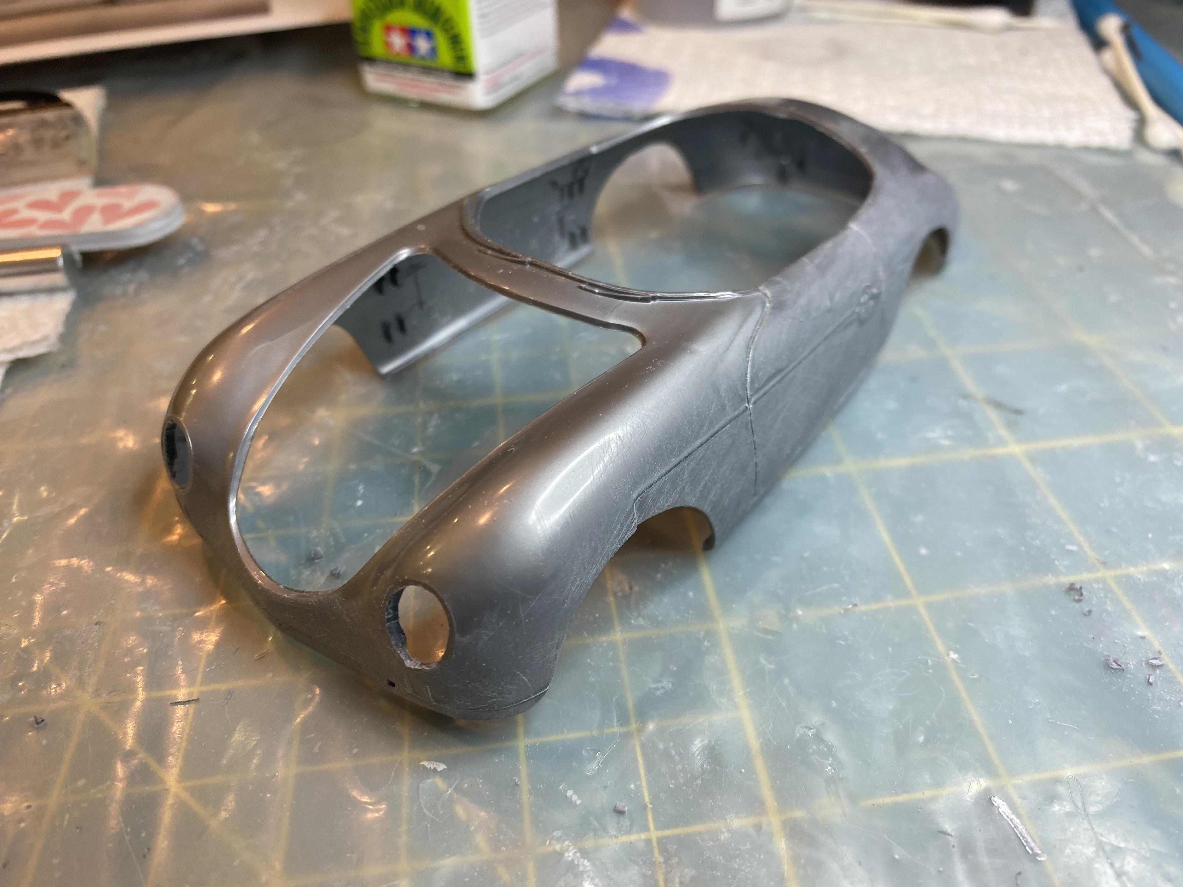

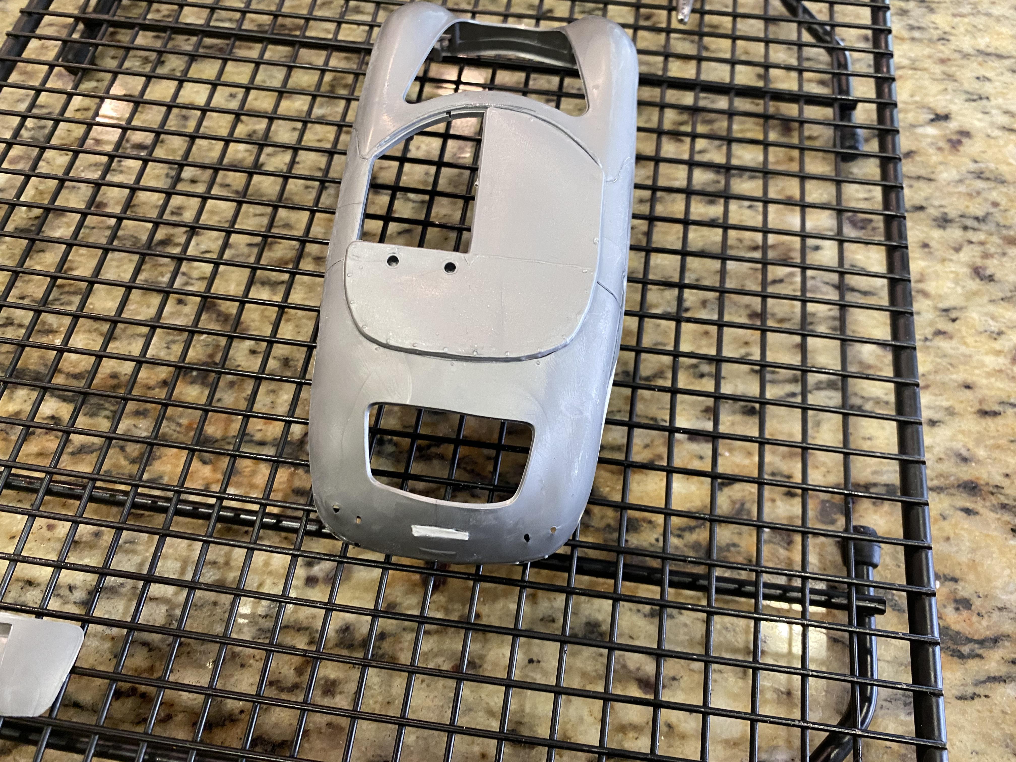

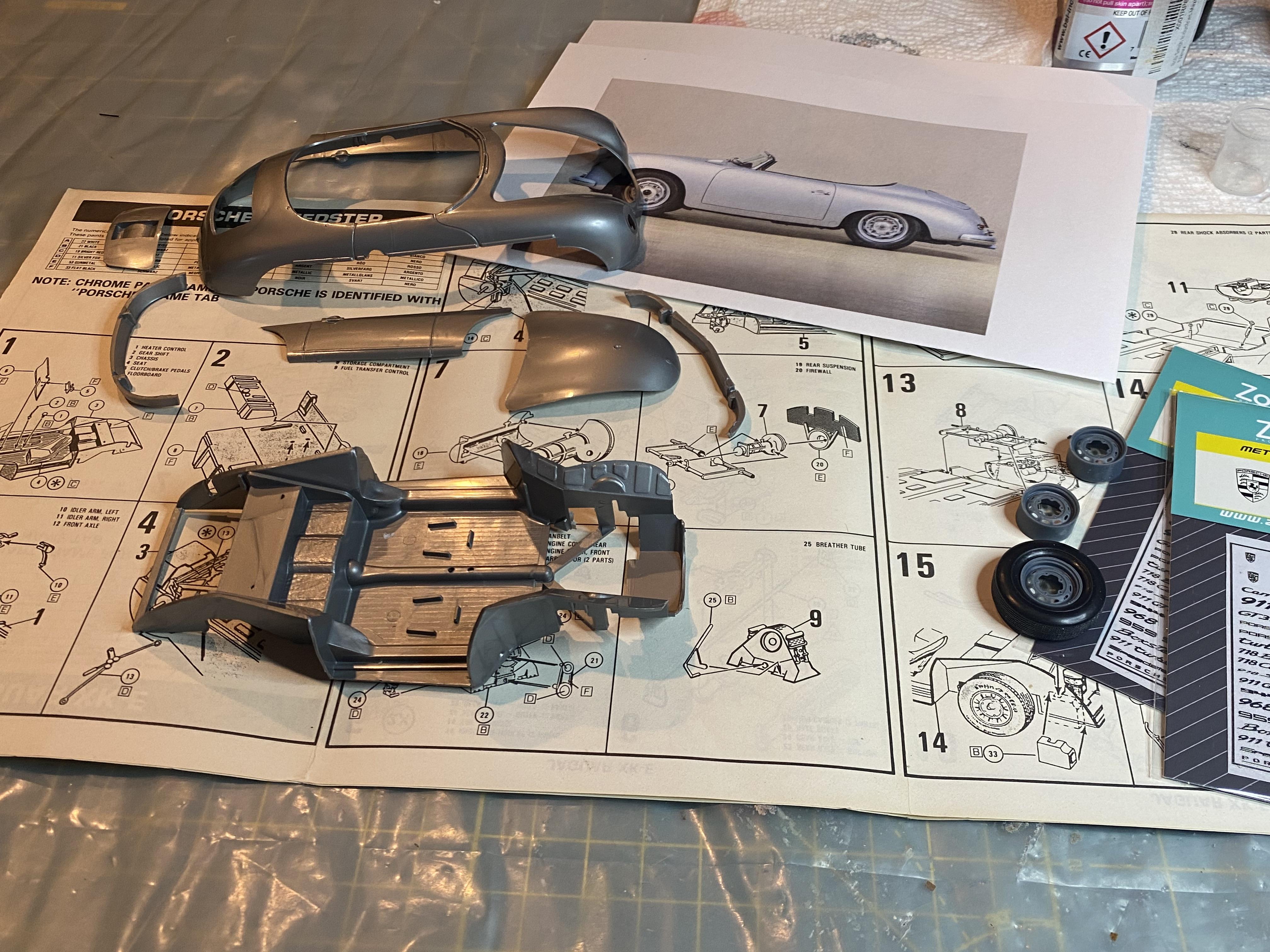

Being the glutton for punishment I appear to be I decided to start on my next project while I literally wait for paint to dry to complete my 1967 Mustang GTA convertible build. I picked up a Three Legends model set for a what I thought was a reasonable price for an early Jaguar XK-E, Datsun 240Z and a Porsche 356 Speedster. I absolutely love early Porsche air cooled cars, and especially 356s. When I was young my parents had a 1957 Porsche 356A coupe.  As it turns out the Revell Porsche Speedster seems to have been originally released around 1962, and it shows it’s age. Multiple part body that has major issues. I have sense picked up an amazing Fujimi kit but for some reason I have decided to go ahead and try to make something of this really really not good kit. I will be doing a lot of fabrication, modification and scratch building on this one for sure. It will get the full LED treatment, headlights, taillights & gauge lights as well as possible steering.

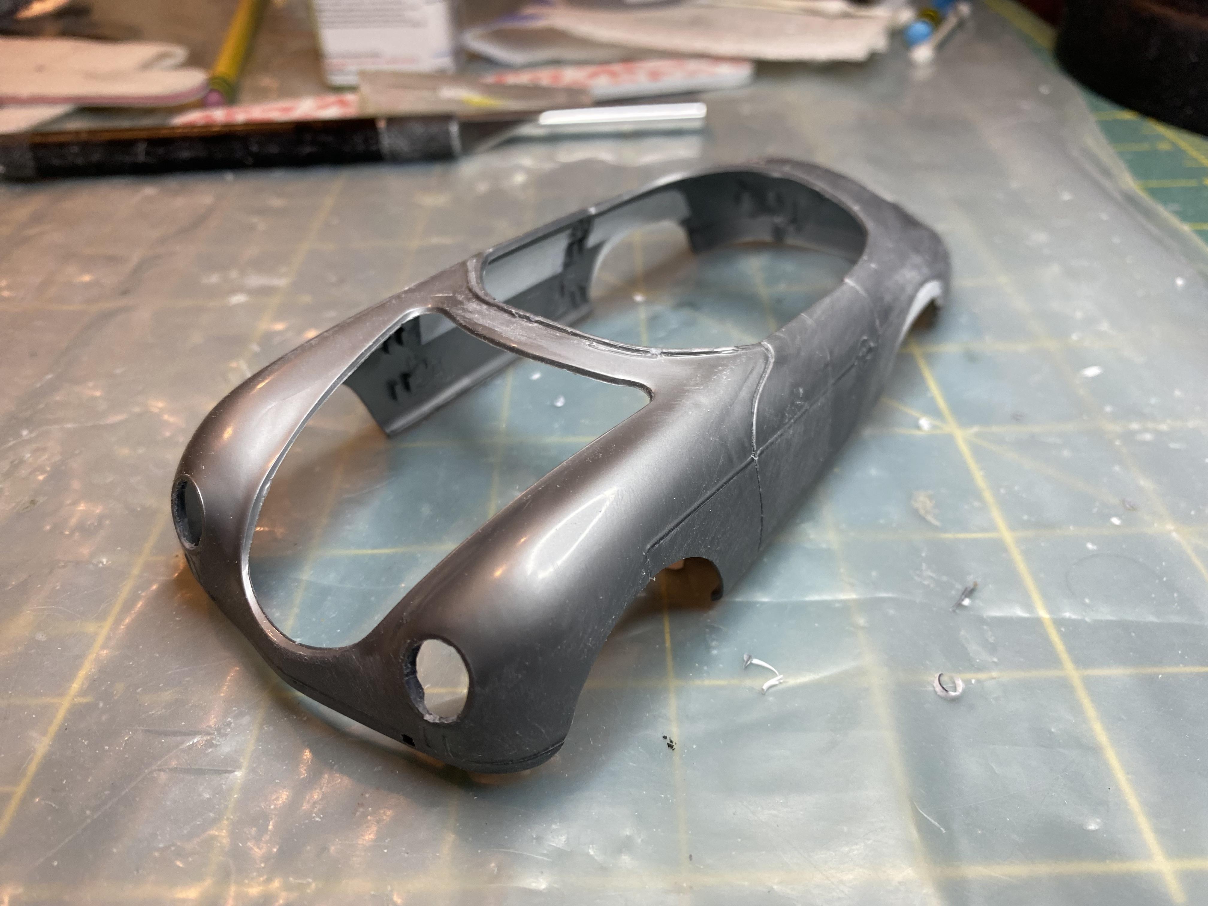

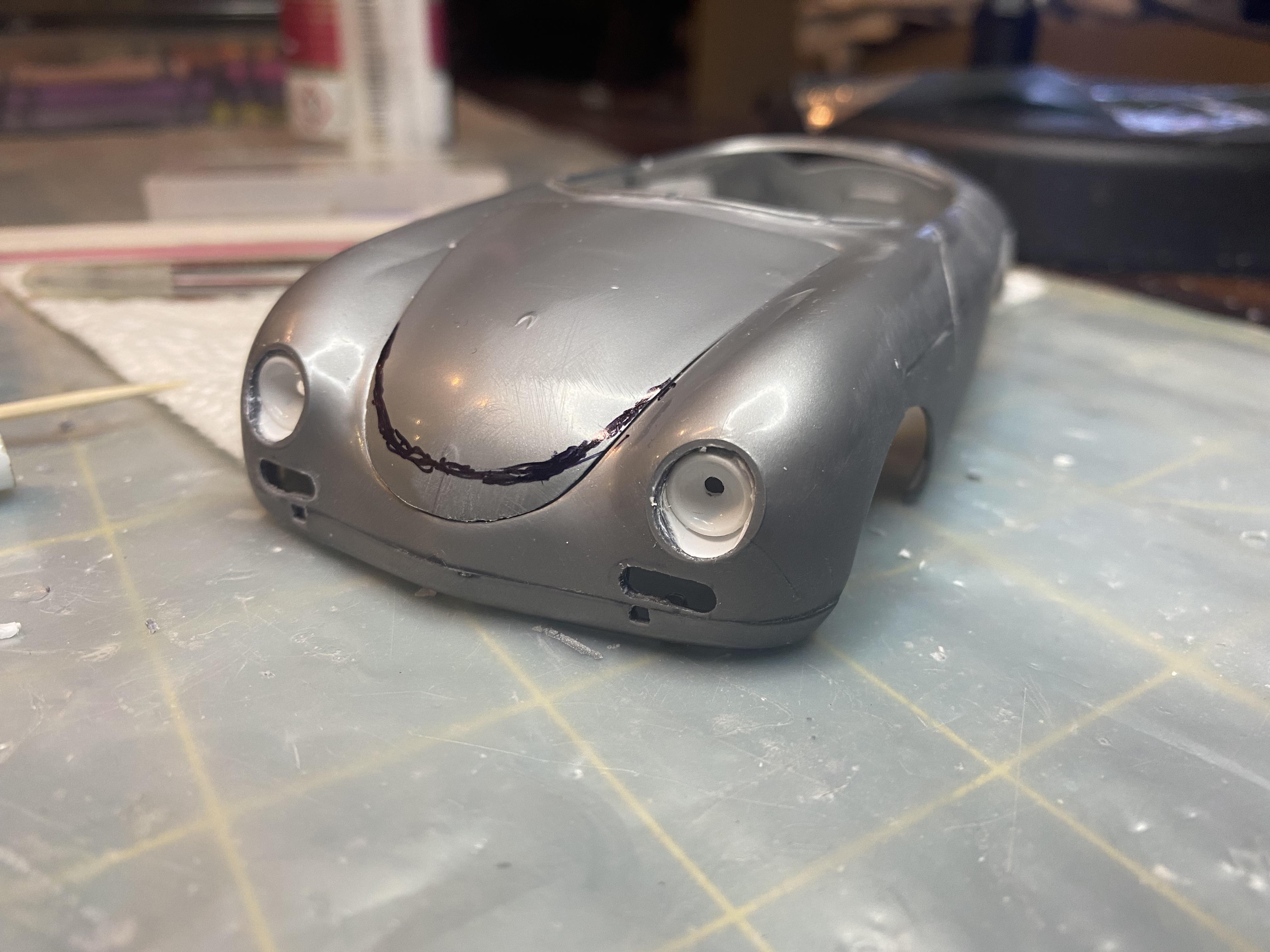

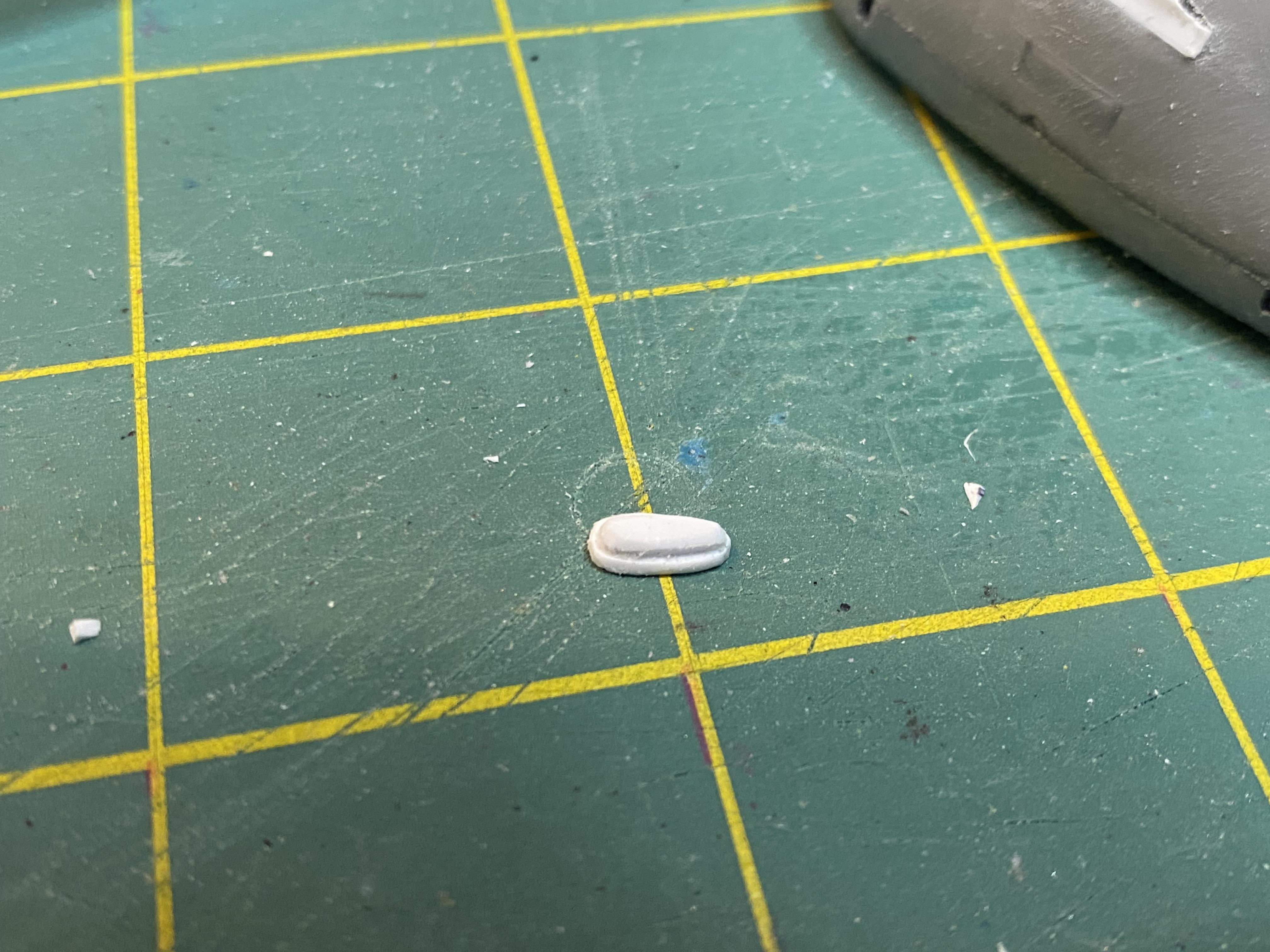

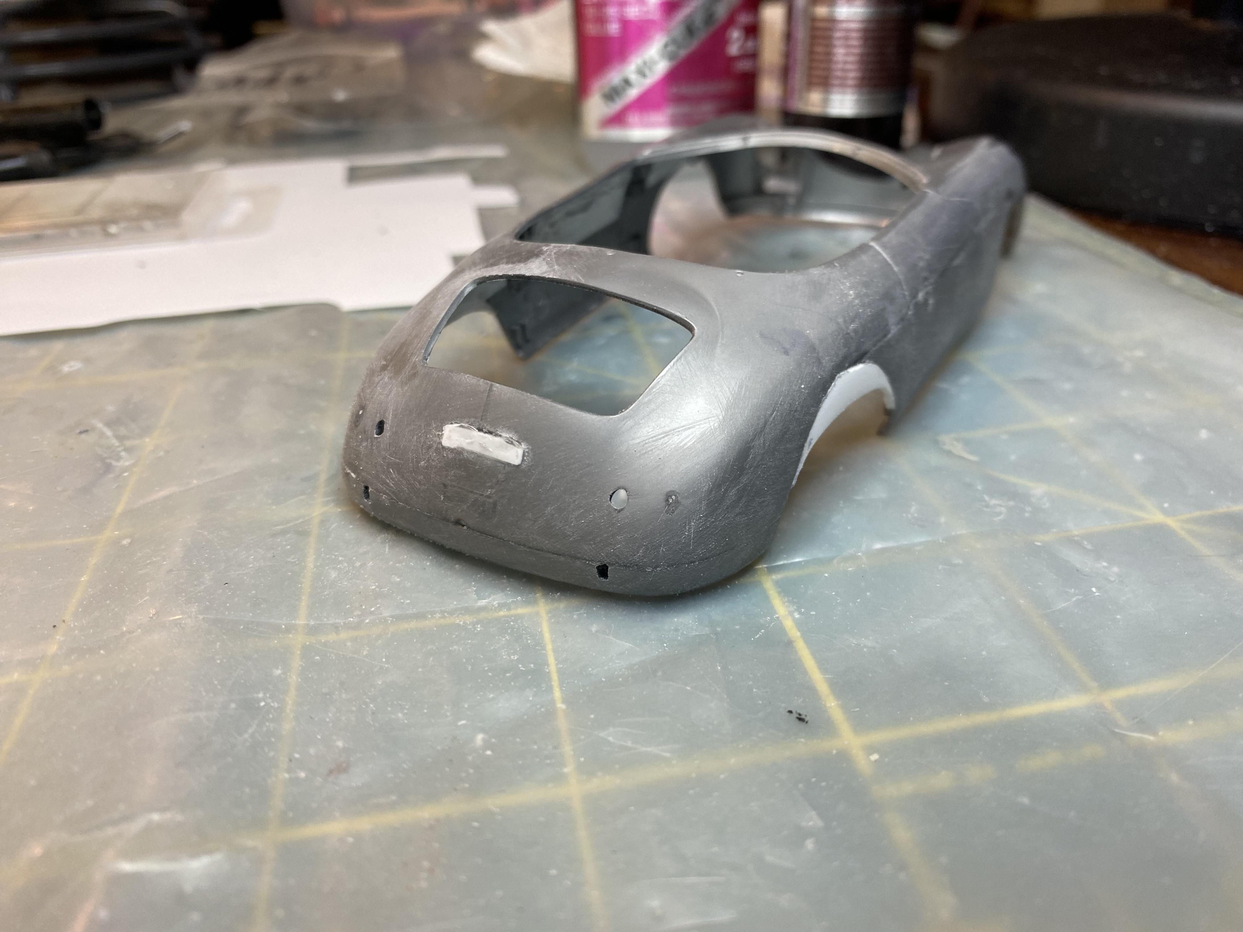

I assembled the body, drilled out the headlights, sanded bad seams, added reinforcements for the joined parts and added filler patches to correct the terrible rear wheel arches. I got a set of 3d printed early 356 rims, metal Porsche decals from ZoomOn, found a decent set of tires from my stash and created a template to fix the wheel arches and cut the doors more correctly.

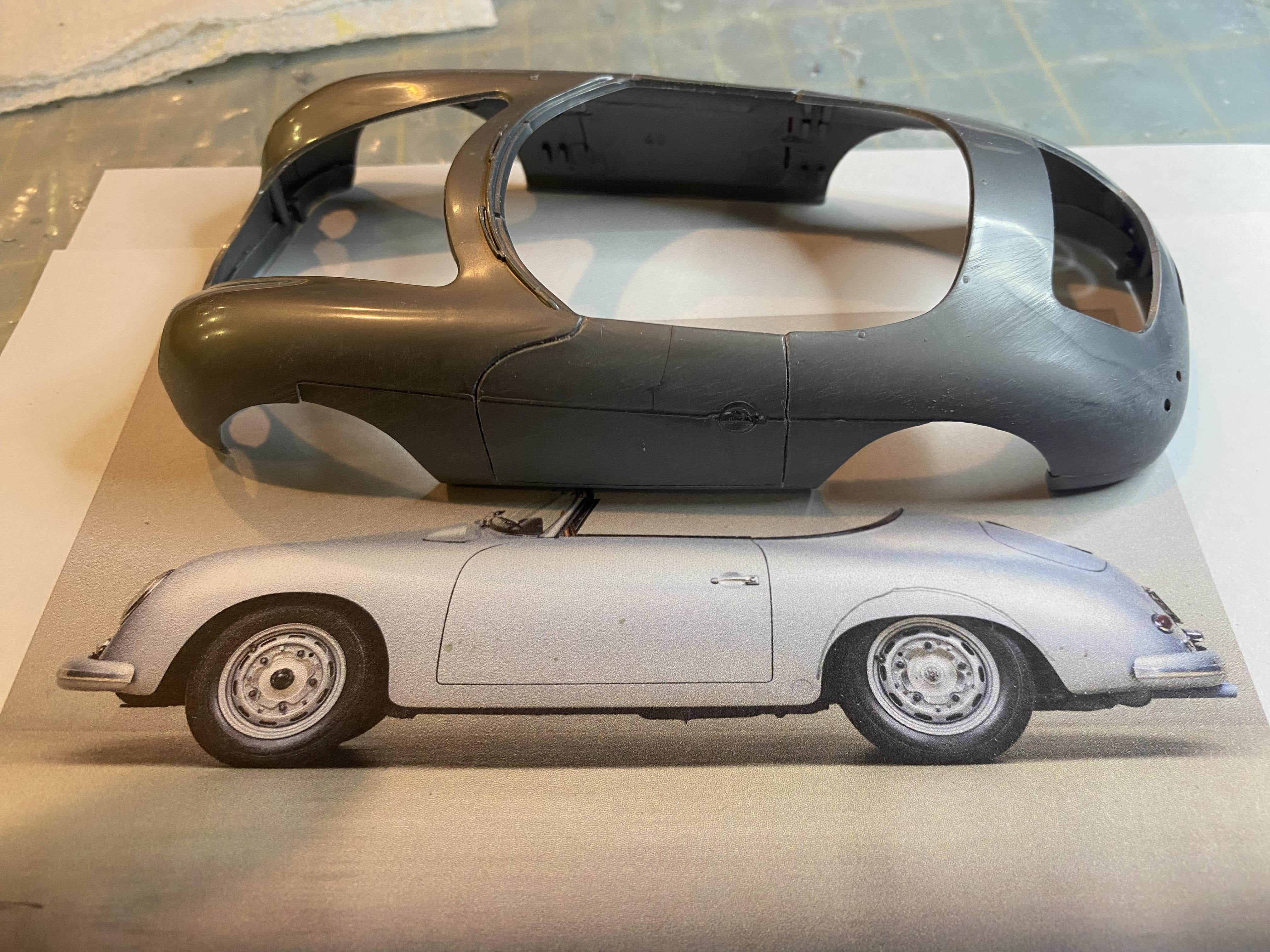

this is the box art of the set and the Porsche kit by itself. Look at how bad that looks, what was I thinking???

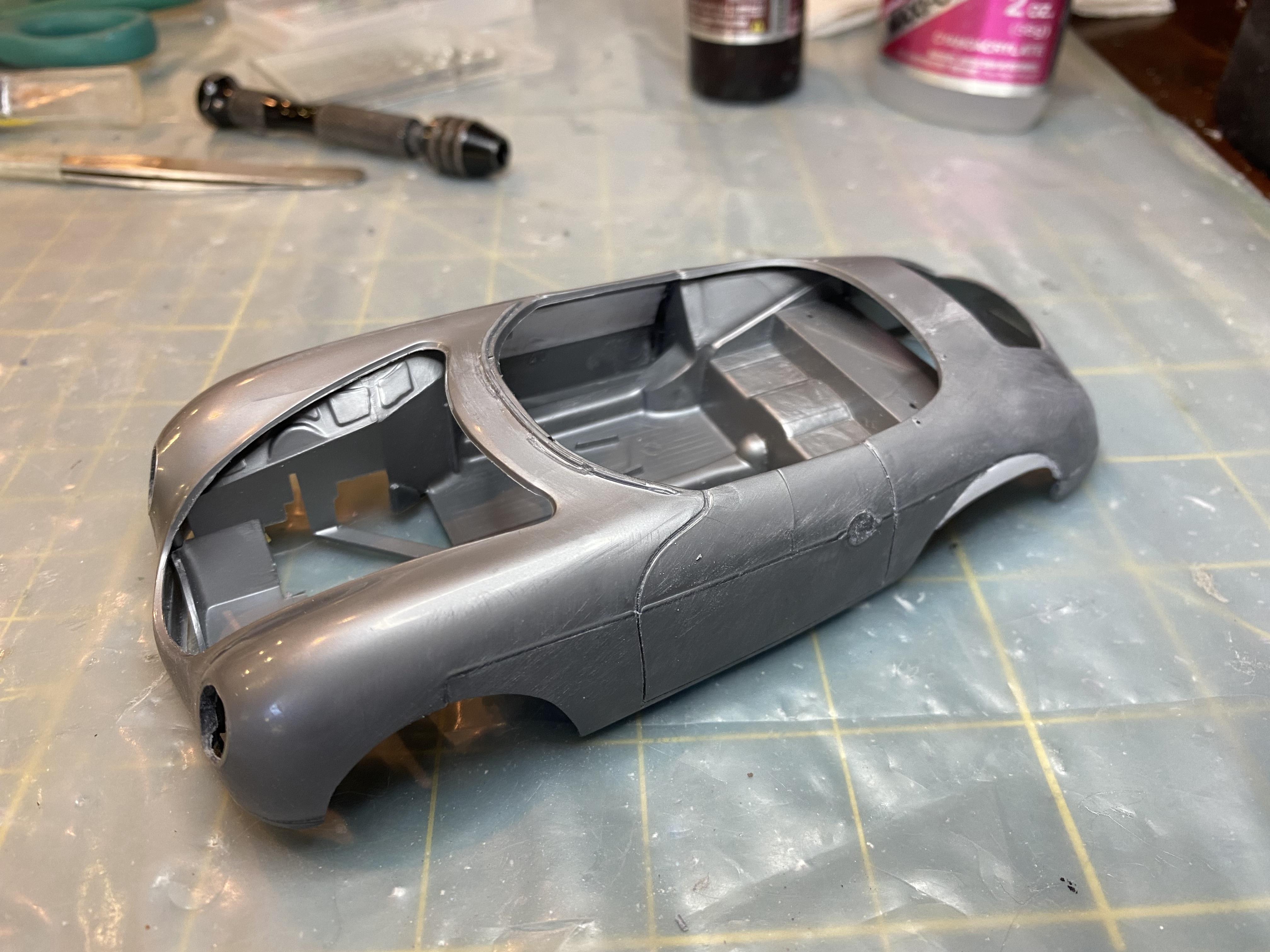

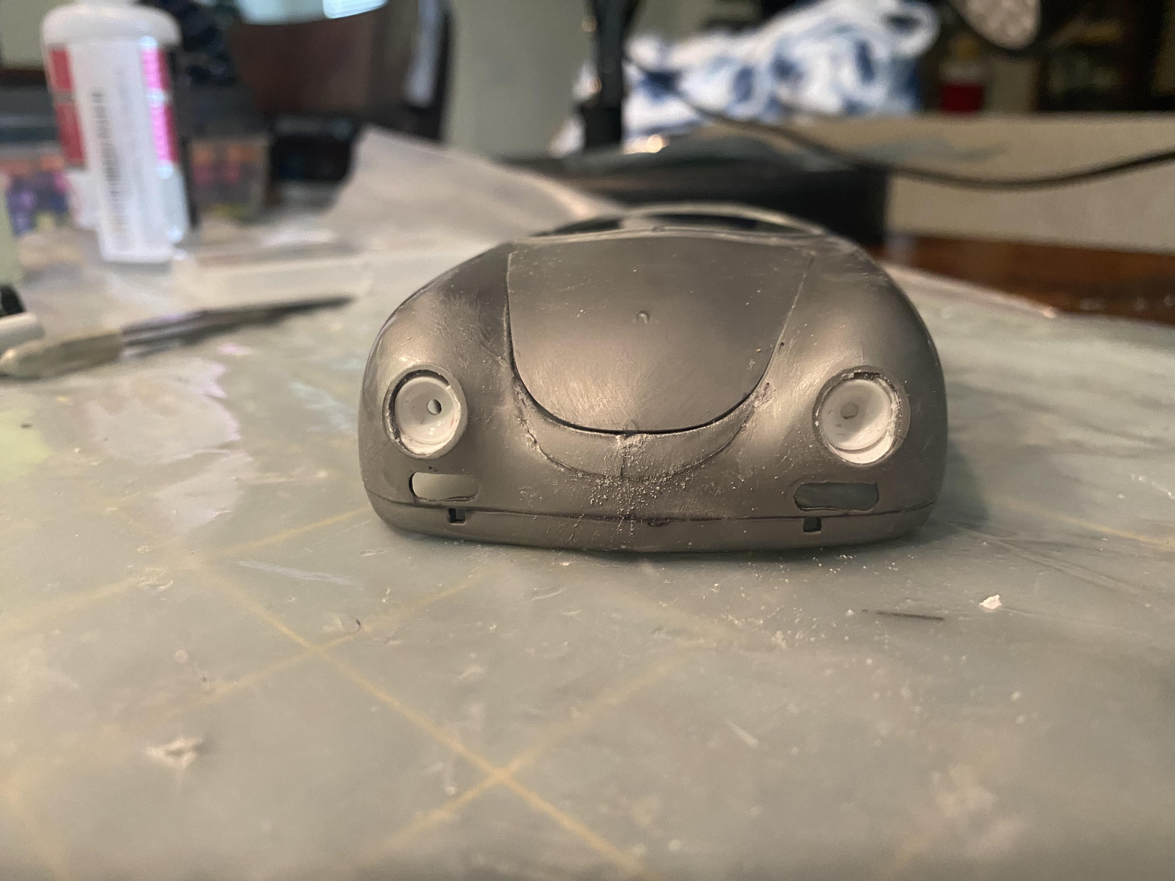

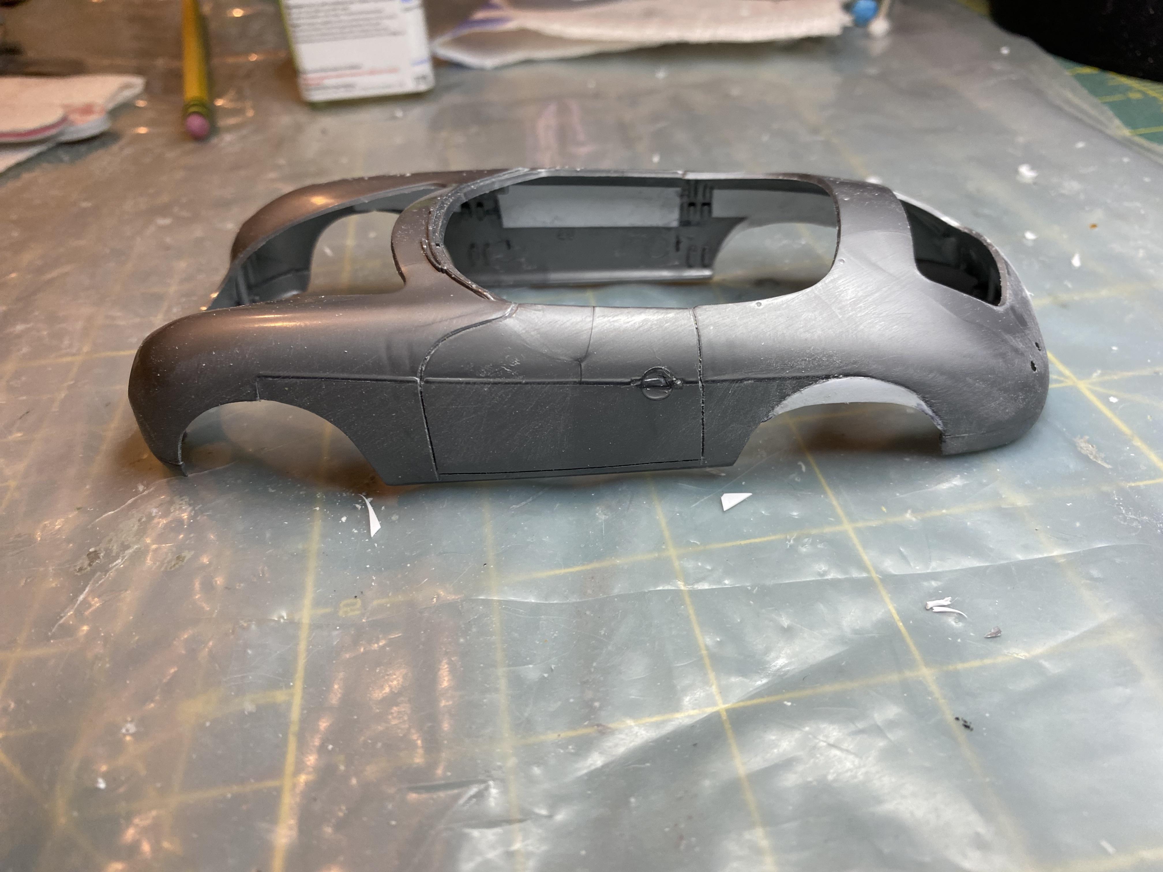

glued together the body cut out the headlights and checked the rear wheel arches.
IMG_6123.thumb.jpeg.190f07cee9e974054d711a9ca4083fb2.jpegIMG_6125.thumb.jpeg.ceaf092f4c7c1d169e9ac1d61e617fc8.jpegIMG_6128.thumb.jpeg.c4c43a79d35c589ceef11b3c545cbb2c.jpegIMG_6129.thumb.jpeg.ca3c1f40e9e034bd95ce1f1d7fa58f16.jpeg
added the filler pieces and reinforcements.
IMG_6130.thumb.jpeg.b44fb5d20bbfd2752445db5d6421973d.jpegIMG_6132.thumb.jpeg.c08f2e27323a2341911fe6aefccf44f9.jpeg

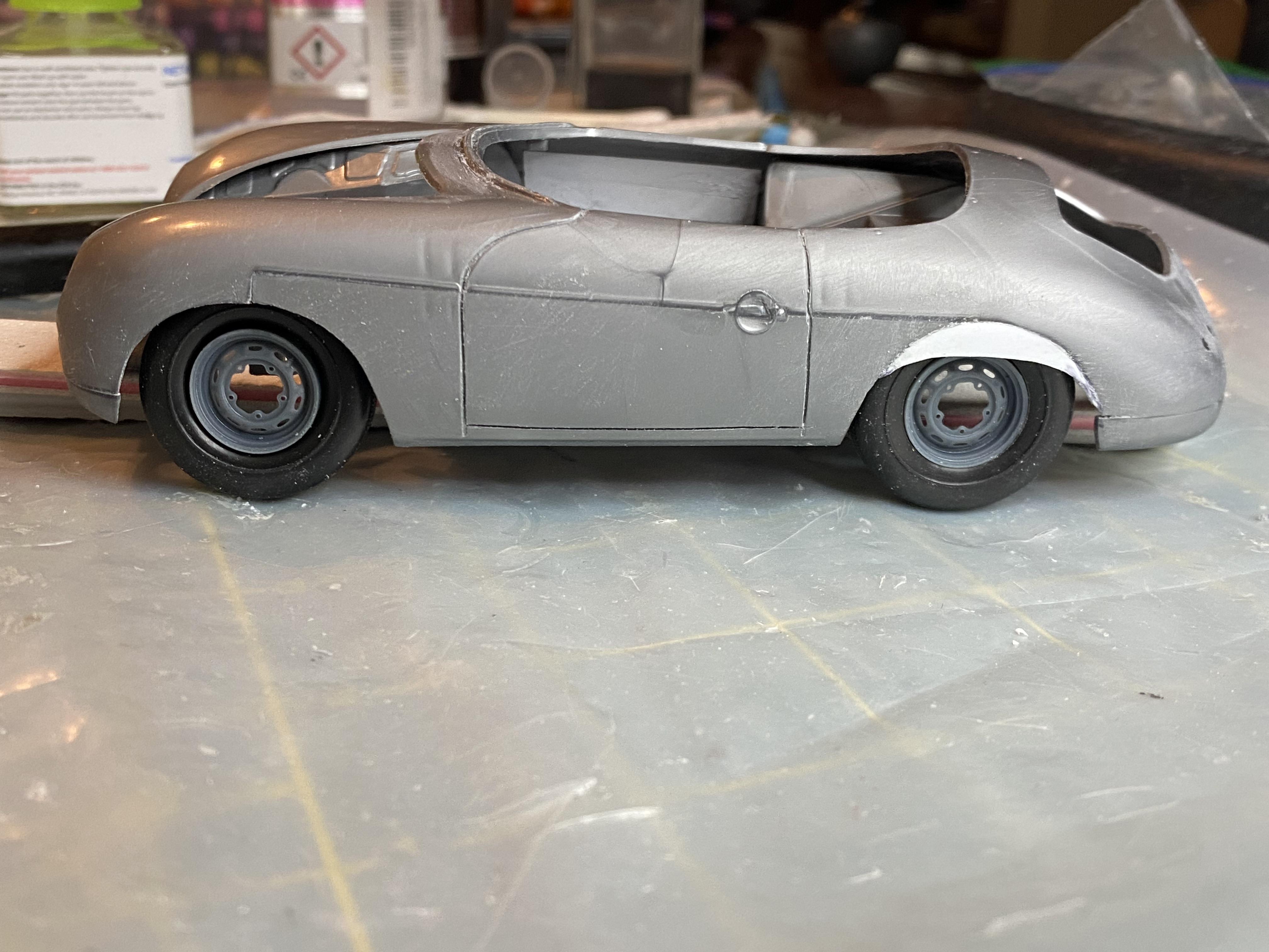

removed what I think was supposed to be wipers, they will be photo-etch later.
IMG_6133.thumb.jpeg.b2d7abce862f2fb844b0079bbd3930fc.jpegIMG_6134.thumb.jpeg.1fa4489e380512862b504a2e88fa985e.jpeg
trial fit to make sure the wheels will fit inside the fenders. I am sure the suspension will need work.
This is what I am going to be going for. Scratch building the bumpers, etc. I will be going with Ivory over red interior.

I wonder how they got the rear wheel arches so wrong - I wonder if the prototype they modeled from was like that?  Weird…
Looks like you’re making a good start!  Nice work!
Thank you! I suspect it was necessary to get their two part wheels that stick out of the wheel openings to work. Not to mention the side pieces were easier to make with a straight edge. Remember this was early 1960s mold making tech.

I have made to scale views of a real speedster as a template, and your right, it is a big mess. Much does line up just not quite right and will require modifying heavily.

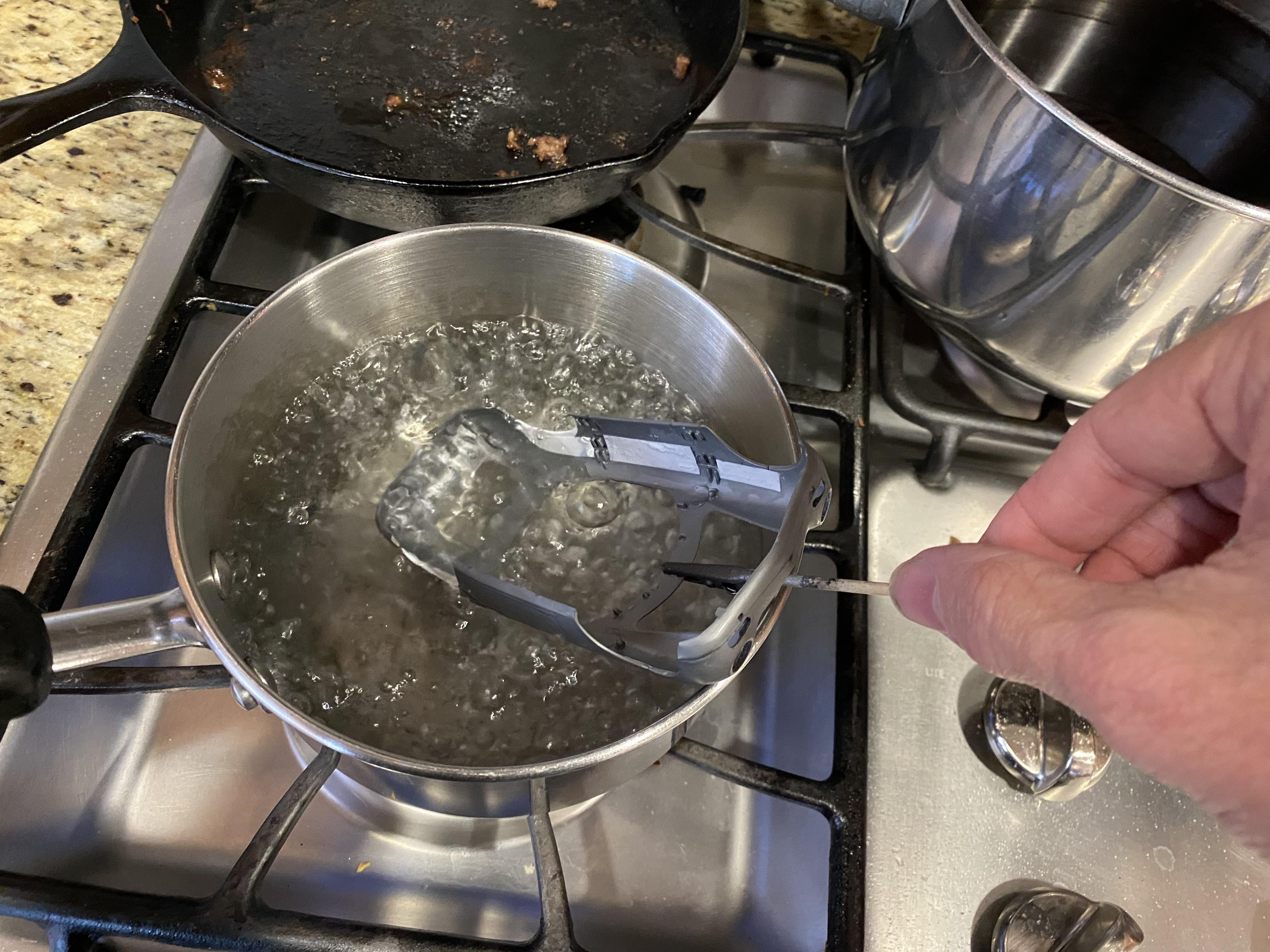

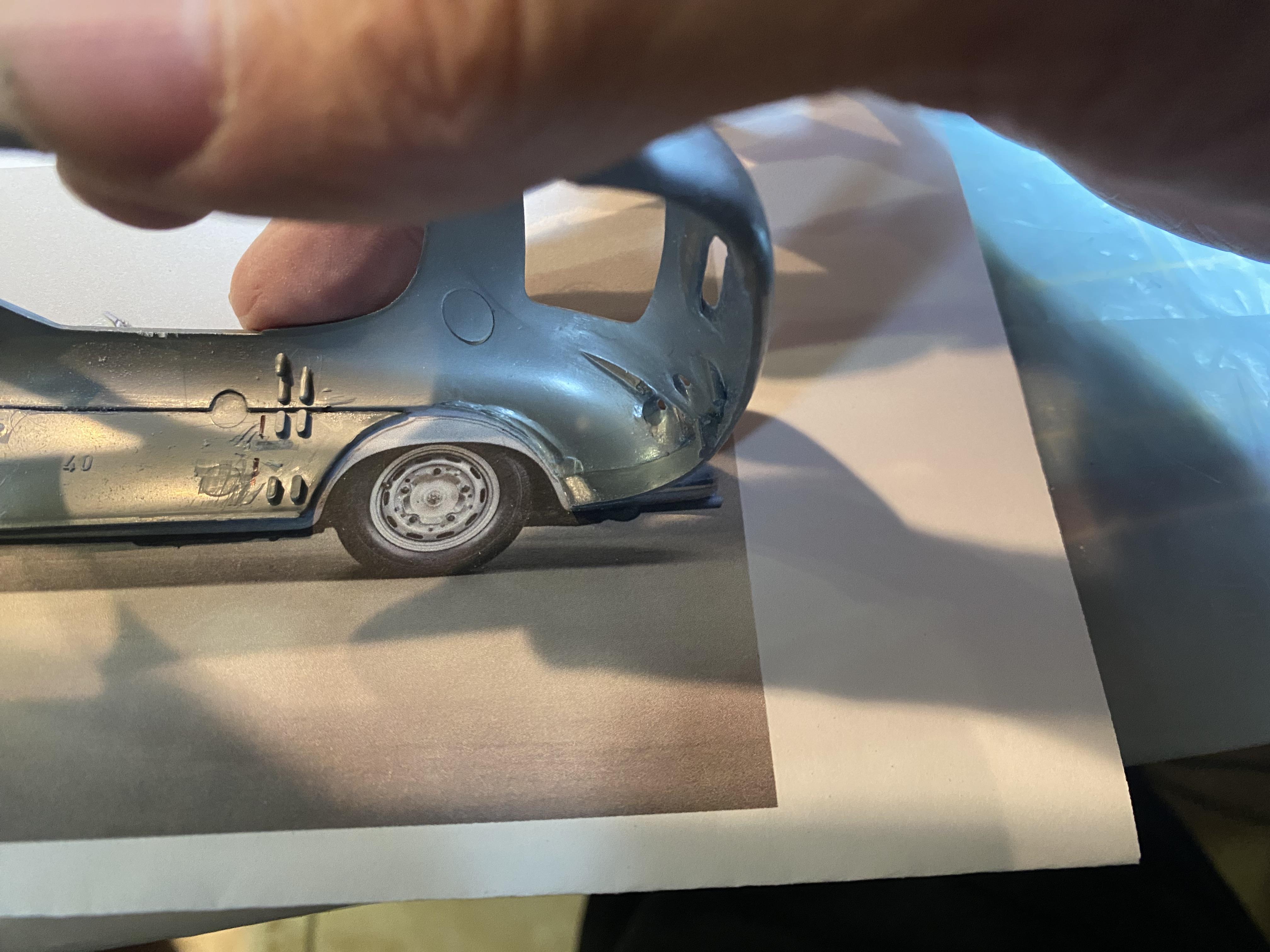

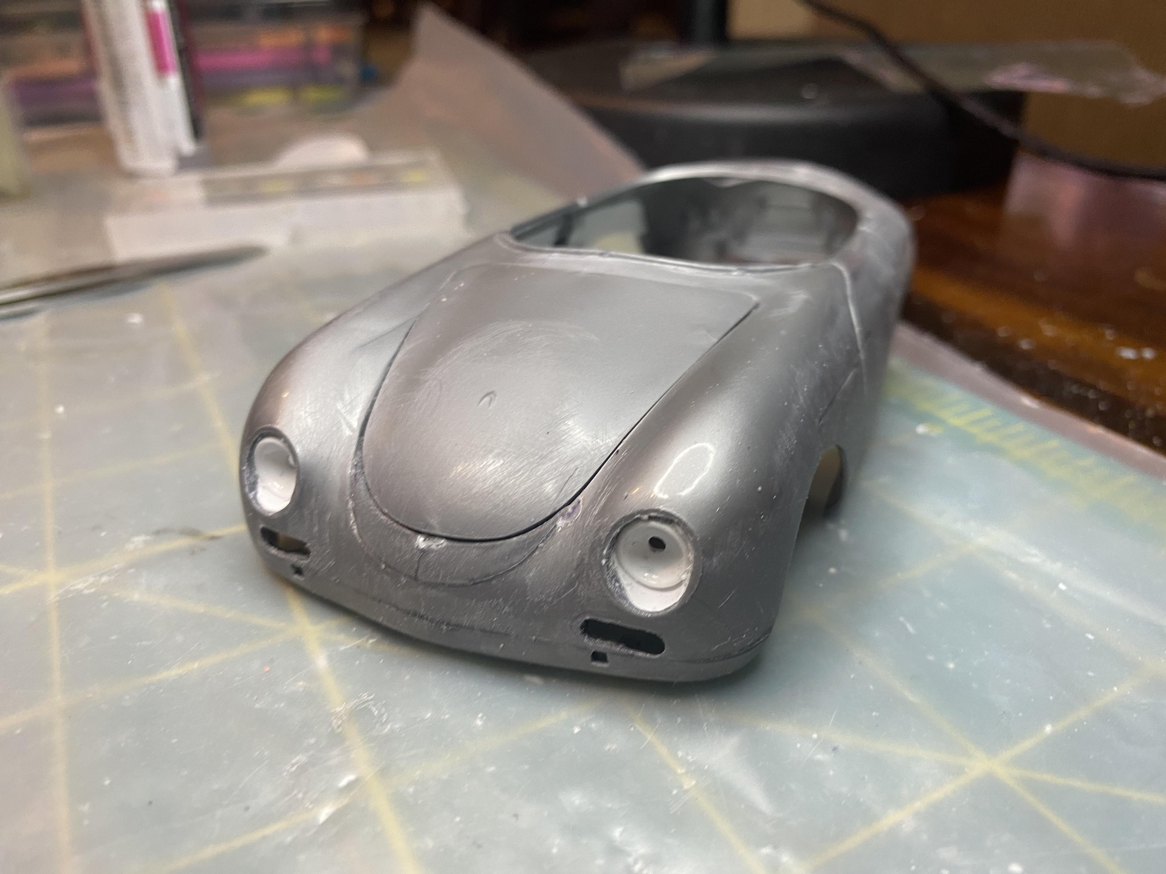

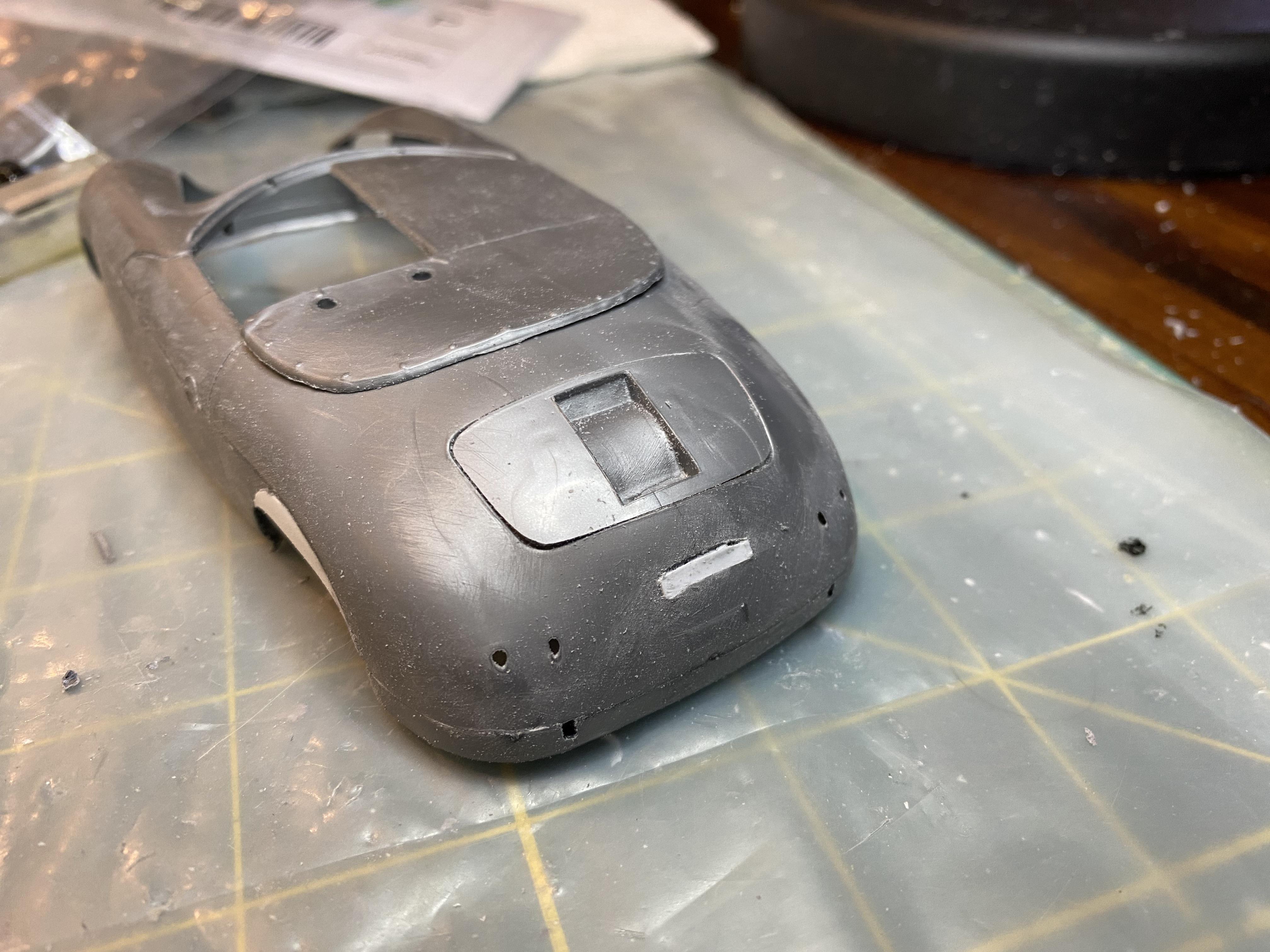

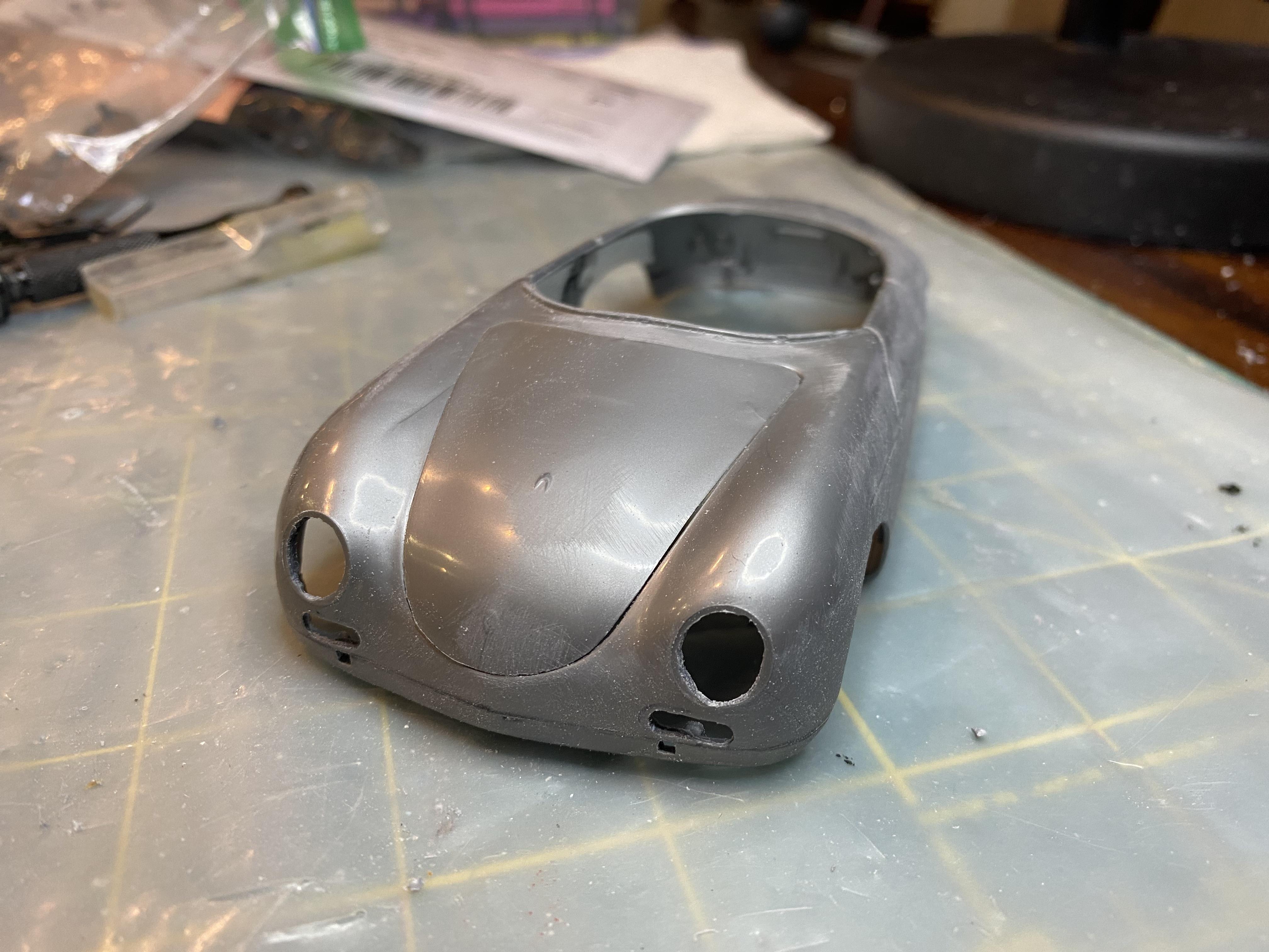

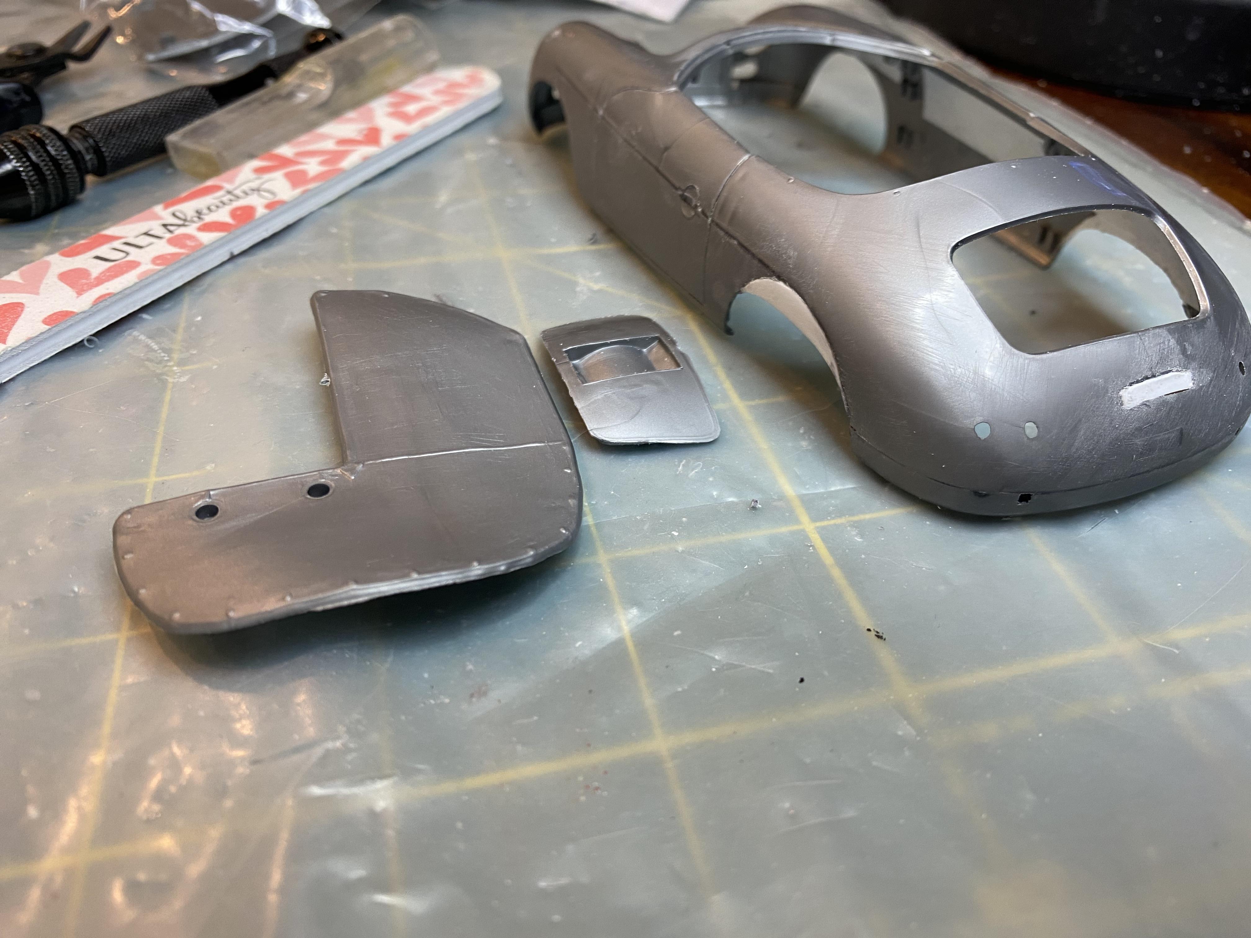

Just a little more work on the body today. The rear section of the car was way too rounded and high so I literally boiled the body to flatten it out to have the correct shape.
IMG_6172.thumb.jpeg.a3230fa878b5759a61ba3d11198bbe2e.jpegIMG_6173.thumb.jpeg.dd9d273f8de85fc13ff60d6d6544bdfe.jpeg

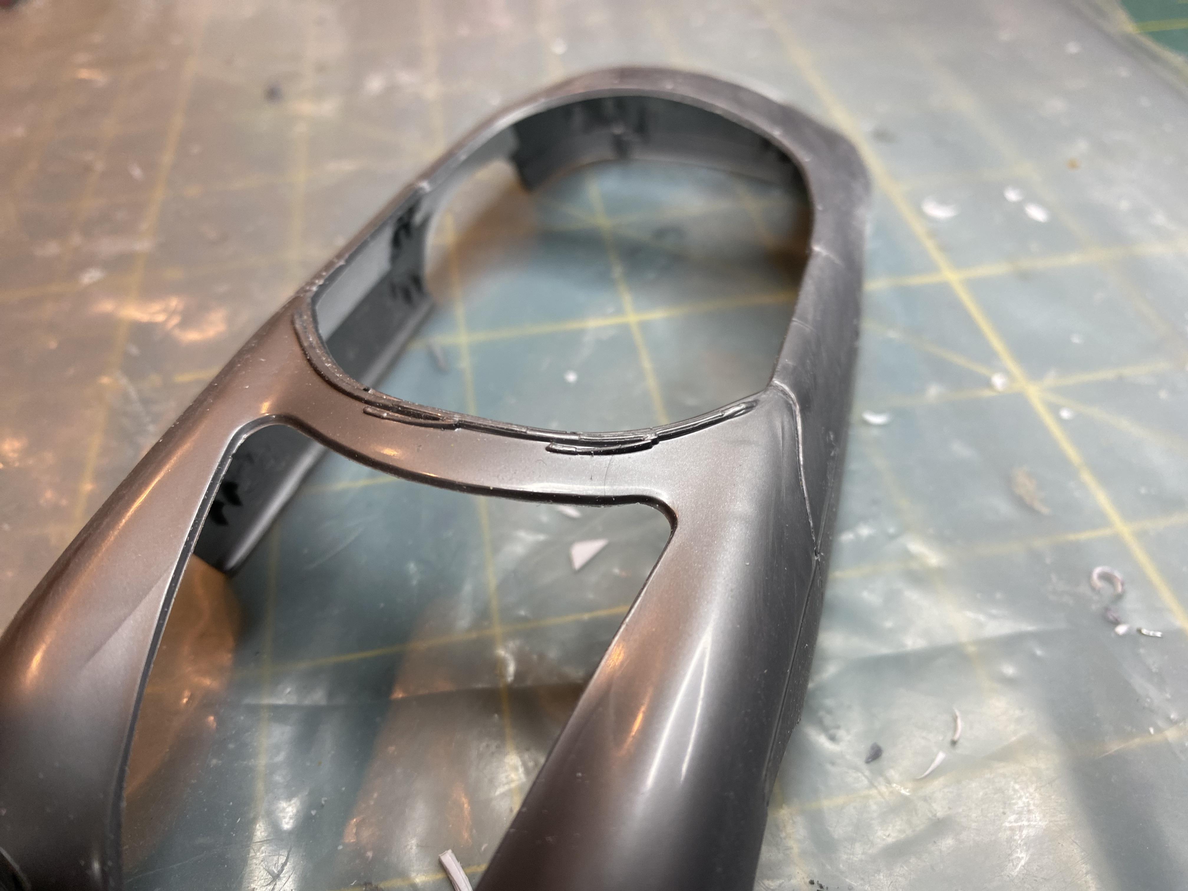

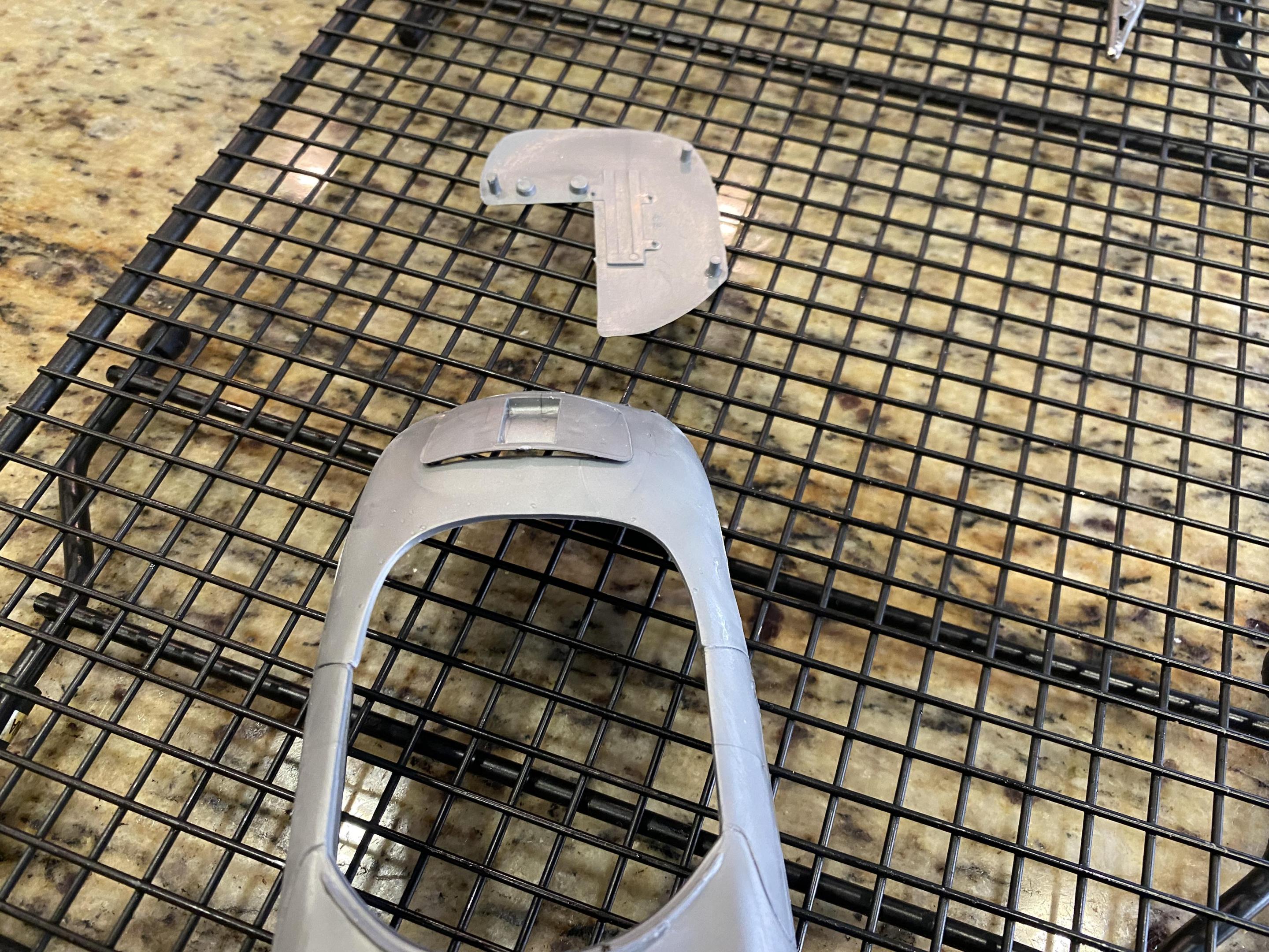

Flattened the body and then had to flatten the back of the cover and rear hood. I am not even sure I will use the cover, at least not all of it, but I am remaining prepared.
IMG_6175.thumb.jpeg.0892c179e3cc3be58b6070b829bd4dab.jpegIMG_6176.thumb.jpeg.8bf0c88e7a60a8e78225c2a2befb7972.jpegIMG_6177.thumb.jpeg.bb0d8a7ec9f3f1949d8060a9bcd50822.jpegIMG_6178.thumb.jpeg.4e62f3263bfb68686d35fe4e9d4696bd.jpeg
luckily the frunk (front trunk) fits better than expected. I also cut out the front vents.

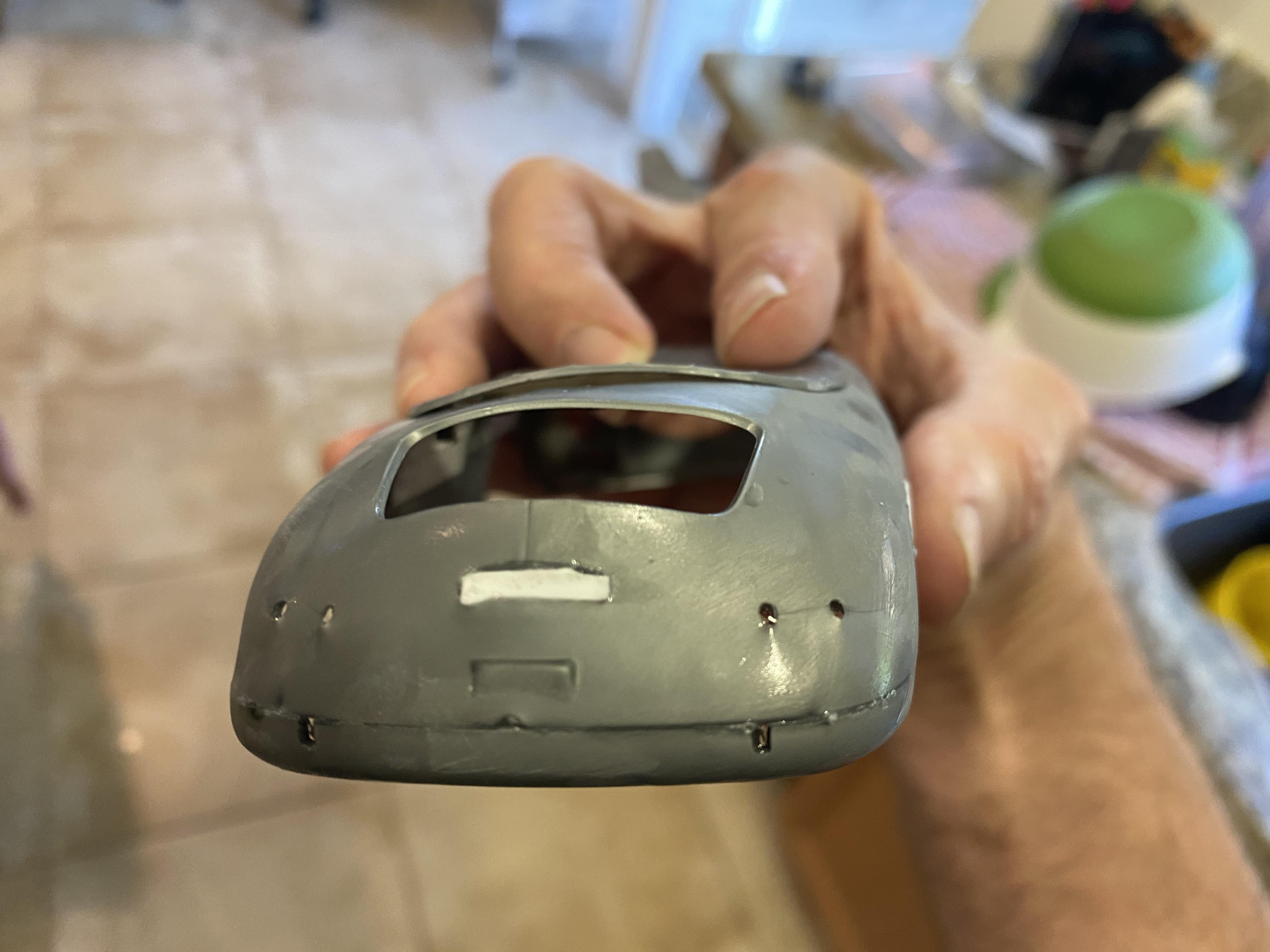

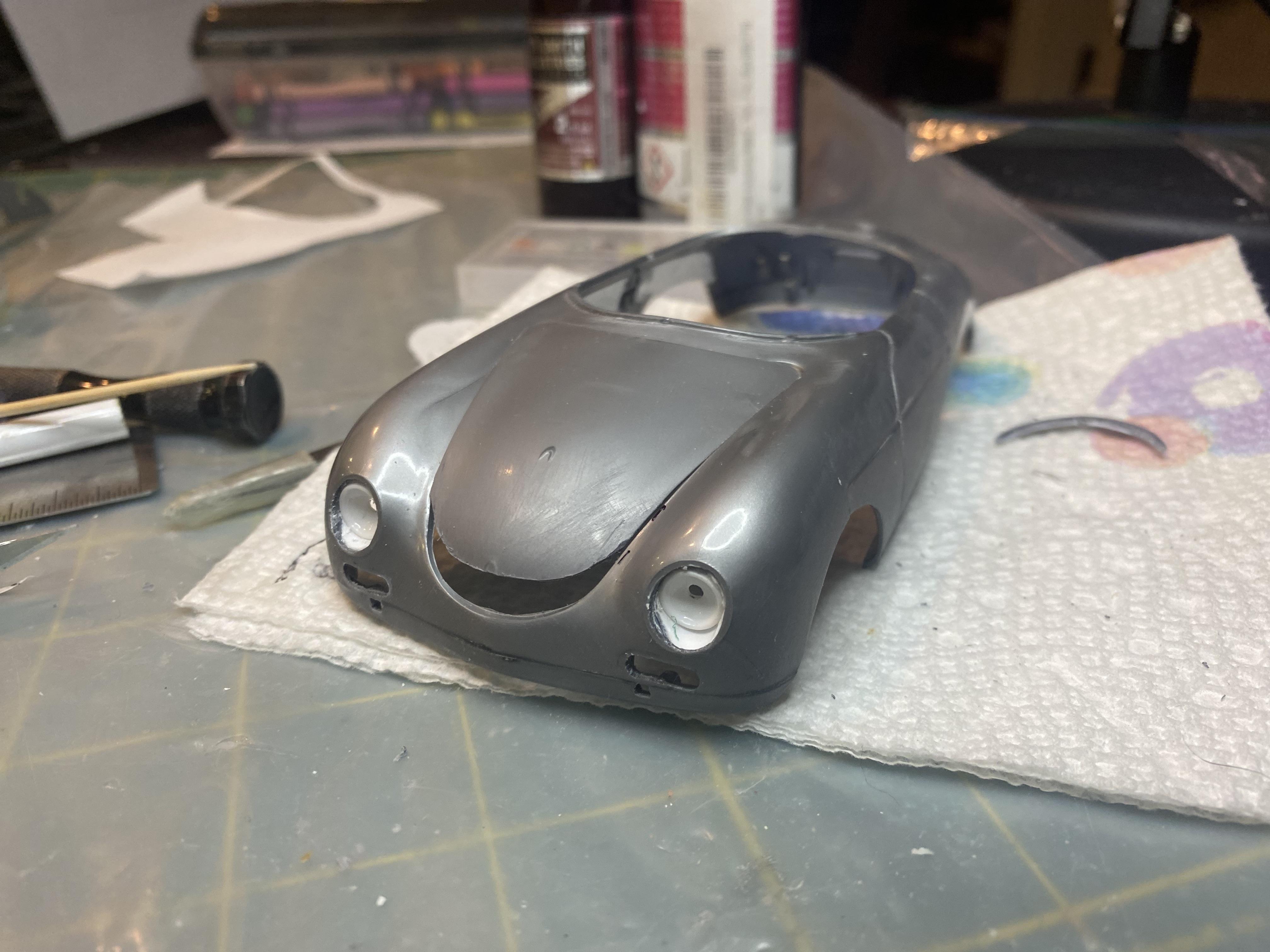

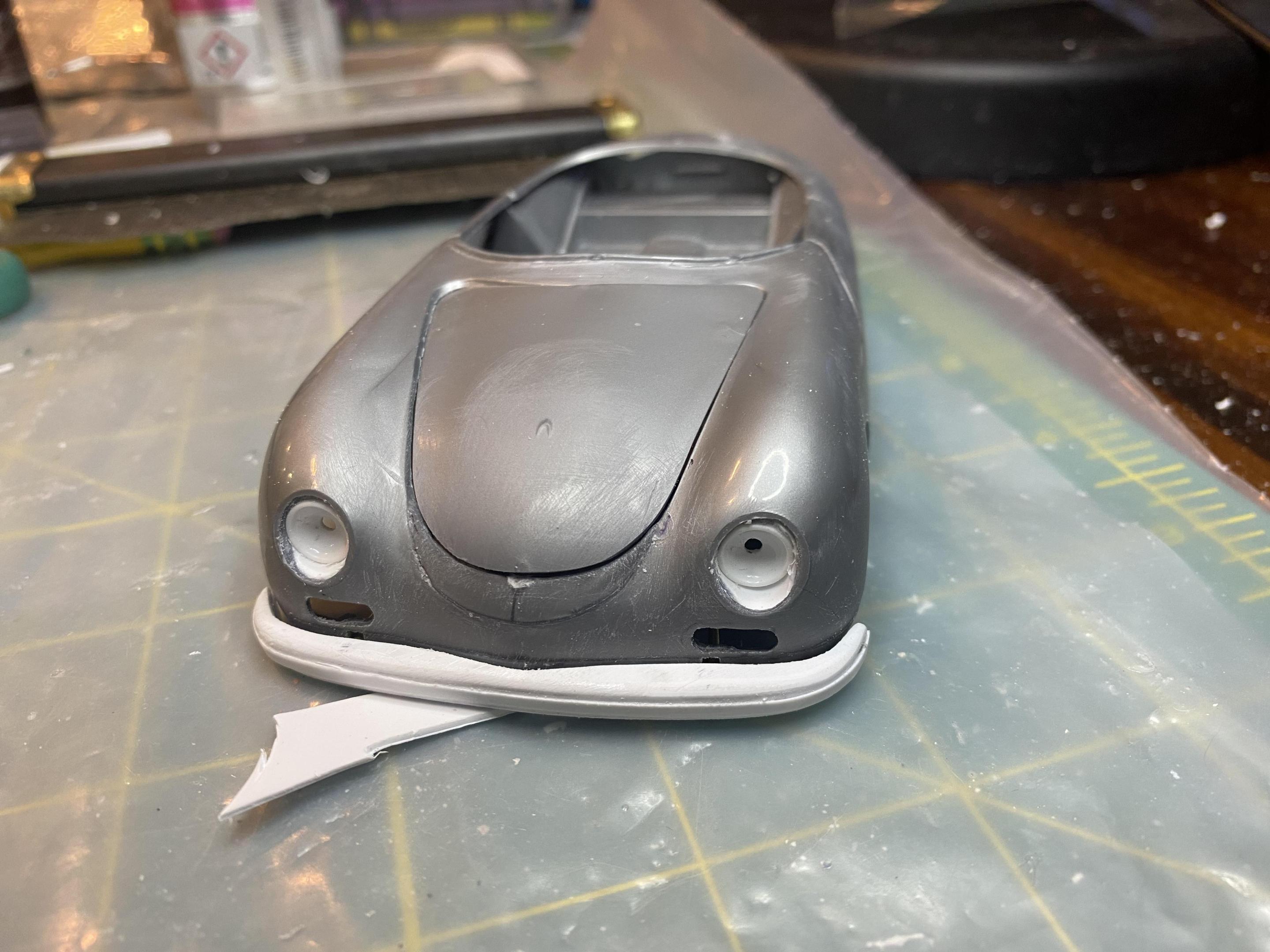

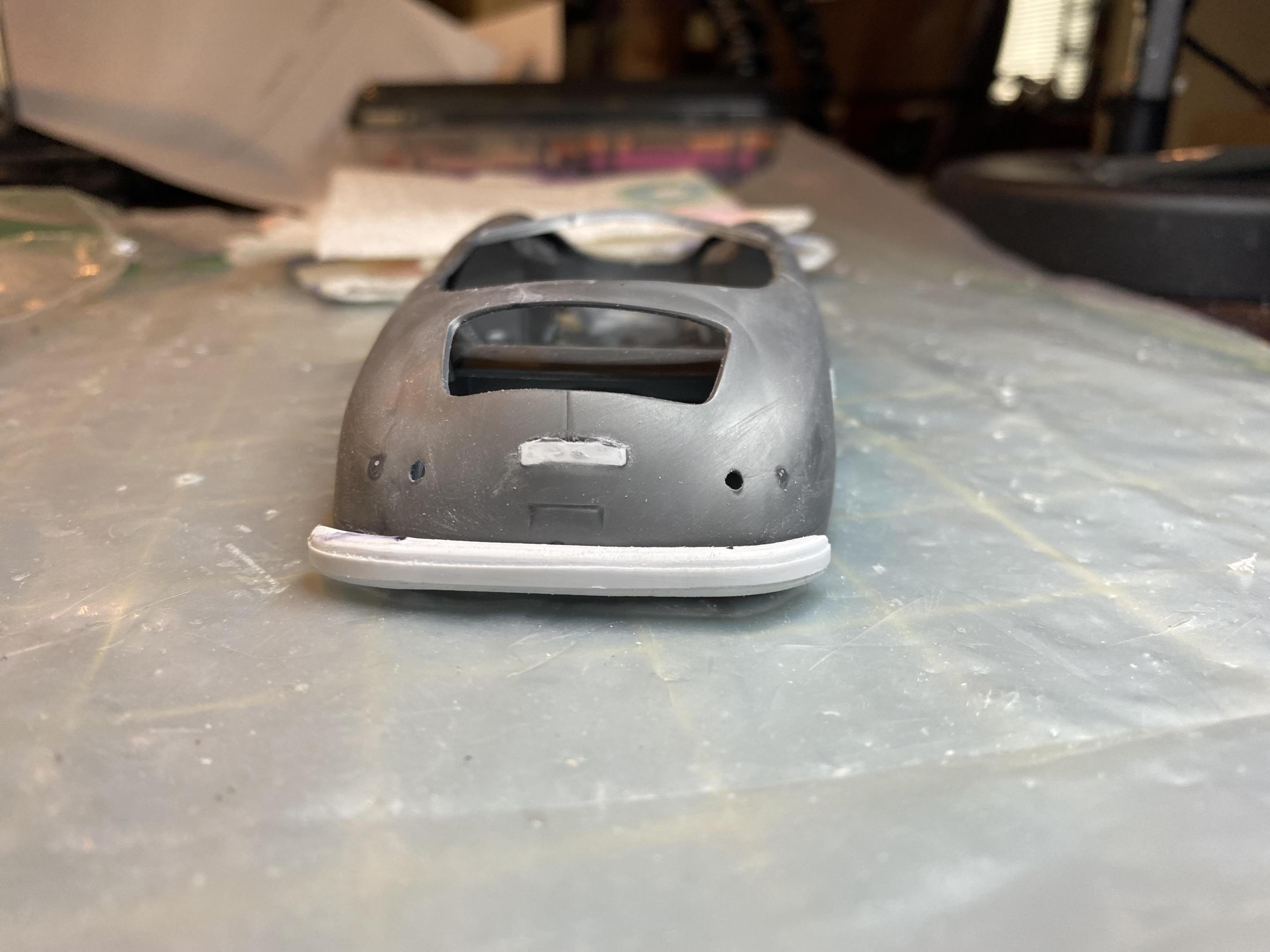

There really isn’t a single part of the body of this kit that is quite right. I created the headlight buckets. It will get inner lenses and outer clear covers like the real car. The front hood was way too long and extended far too low.
It almost looks like it is smiling now that it is getting fixed to look right. 😁
IMG_6184.thumb.jpeg.5880746809149b84724be5c97836bba1.jpegIMG_6187.thumb.jpeg.79b57b50d9299ad27a862400b761053f.jpegIMG_6188.thumb.jpeg.de97722c2f510de529f9b3d6810f18af.jpeg

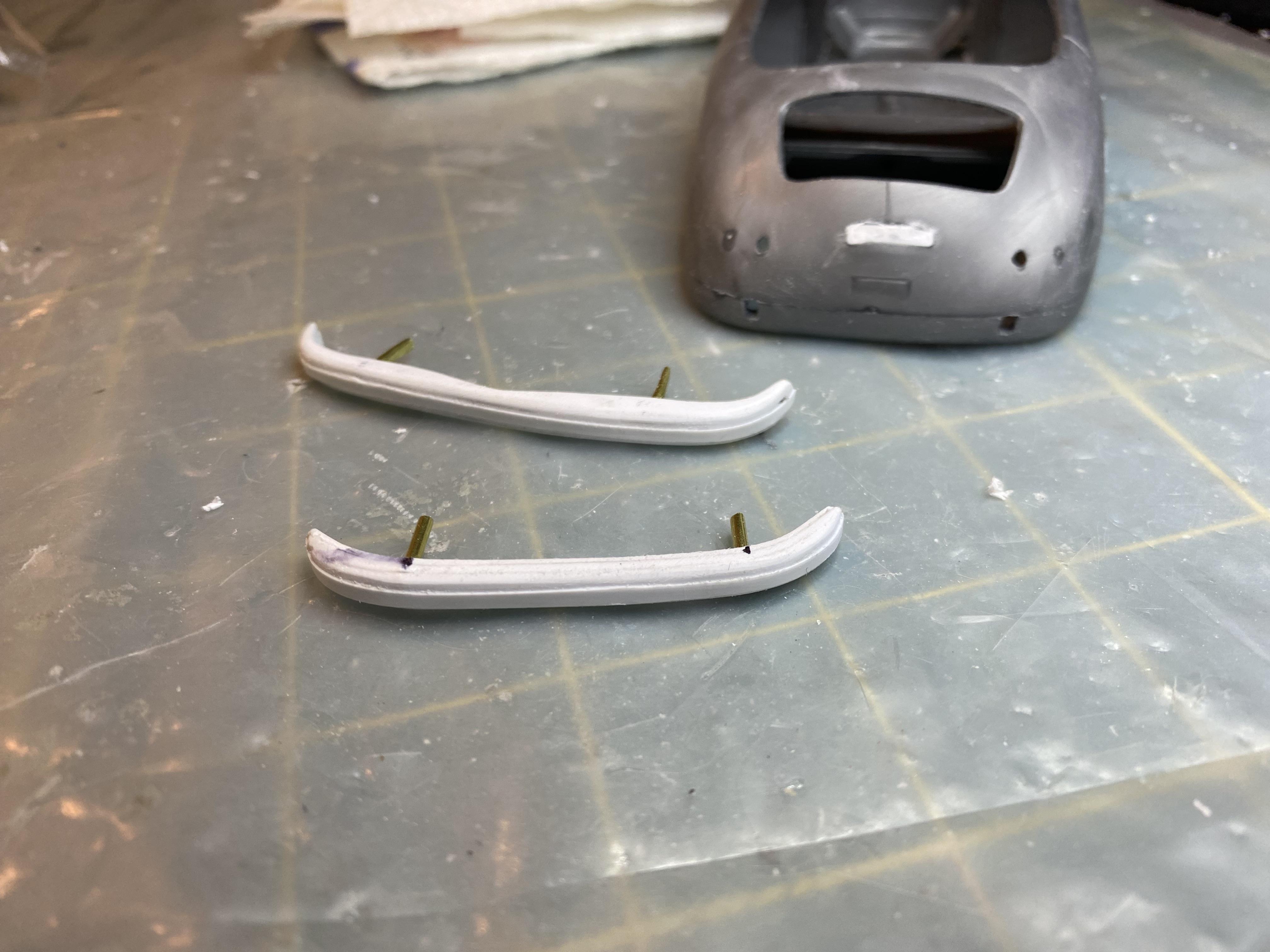

Created front and rear bumpers. I am not happy with rear bumper yet, but I will get it right.
IMG_1814.jpeg.2d107b695b0611c4270c3e3ad96c2358.jpegIMG_6191.thumb.jpeg.6524842d5ecca73323bc56e745efe25d.jpegIMG_6193.thumb.jpeg.66f40139969dd7528eaa5ee7e287d085.jpegIMG_6194.thumb.jpeg.82e865ee17b2ae0a58a5488789eef8f3.jpegIMG_1808.jpeg.c8892a18f6693098210eb5db6585a58a.jpeg
