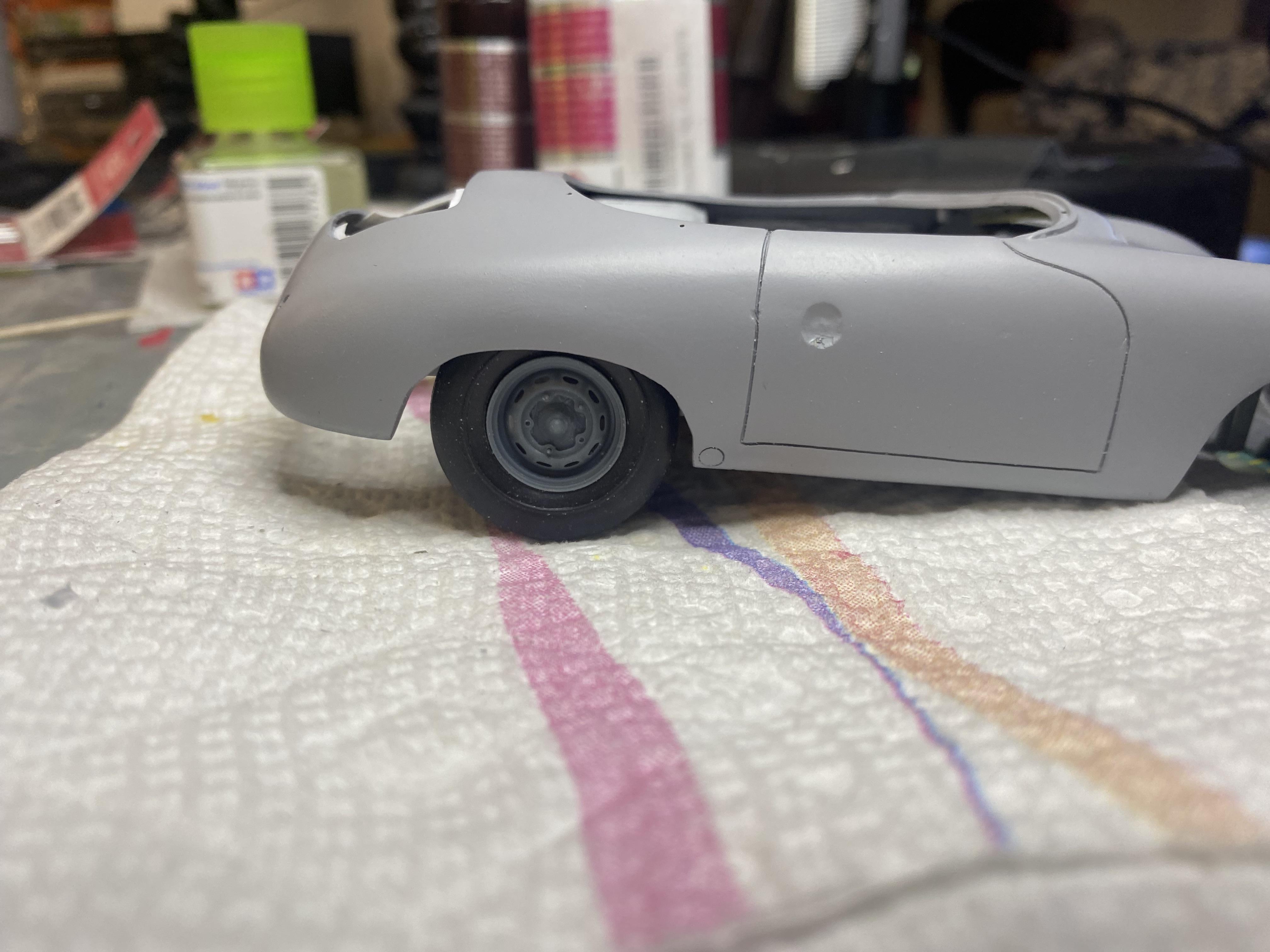

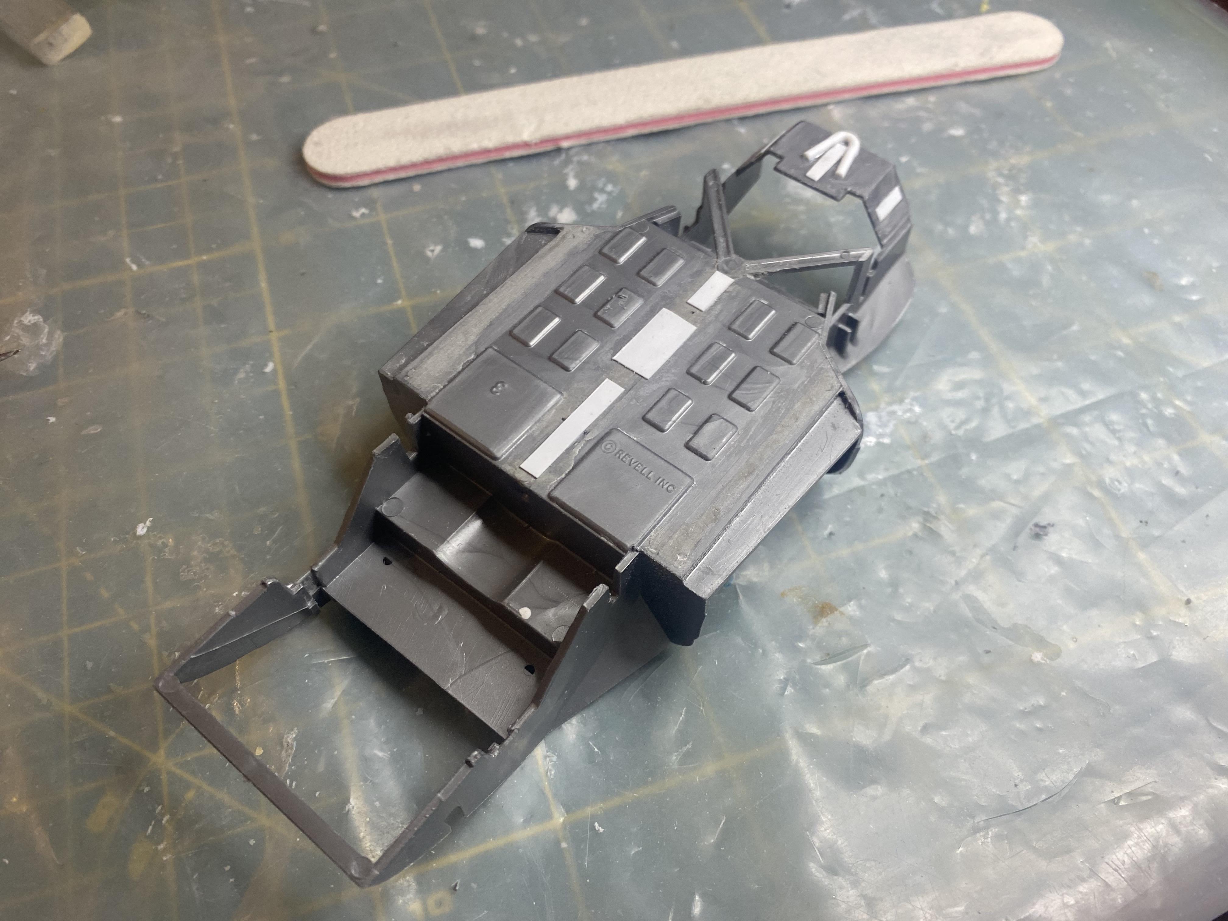

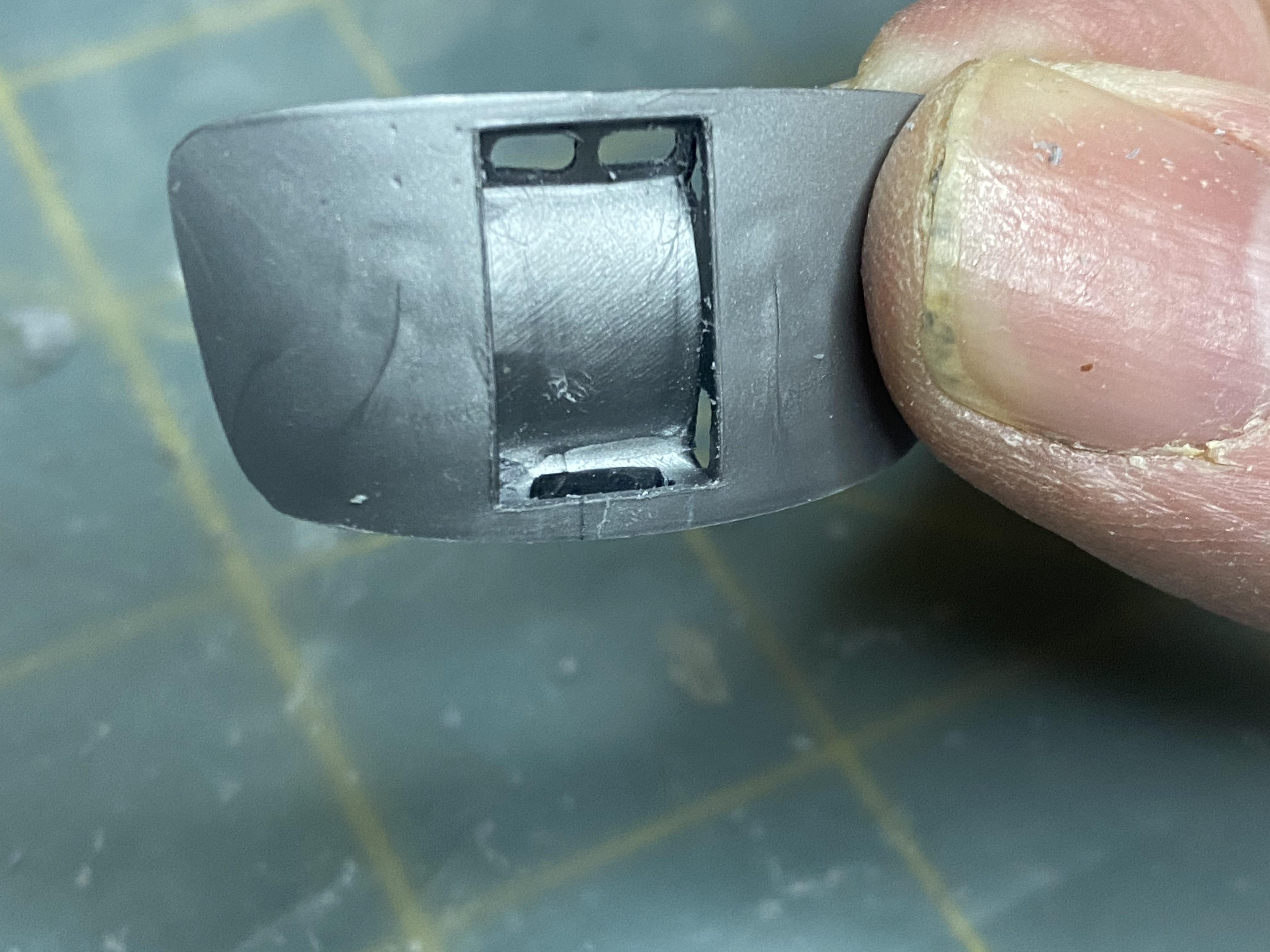

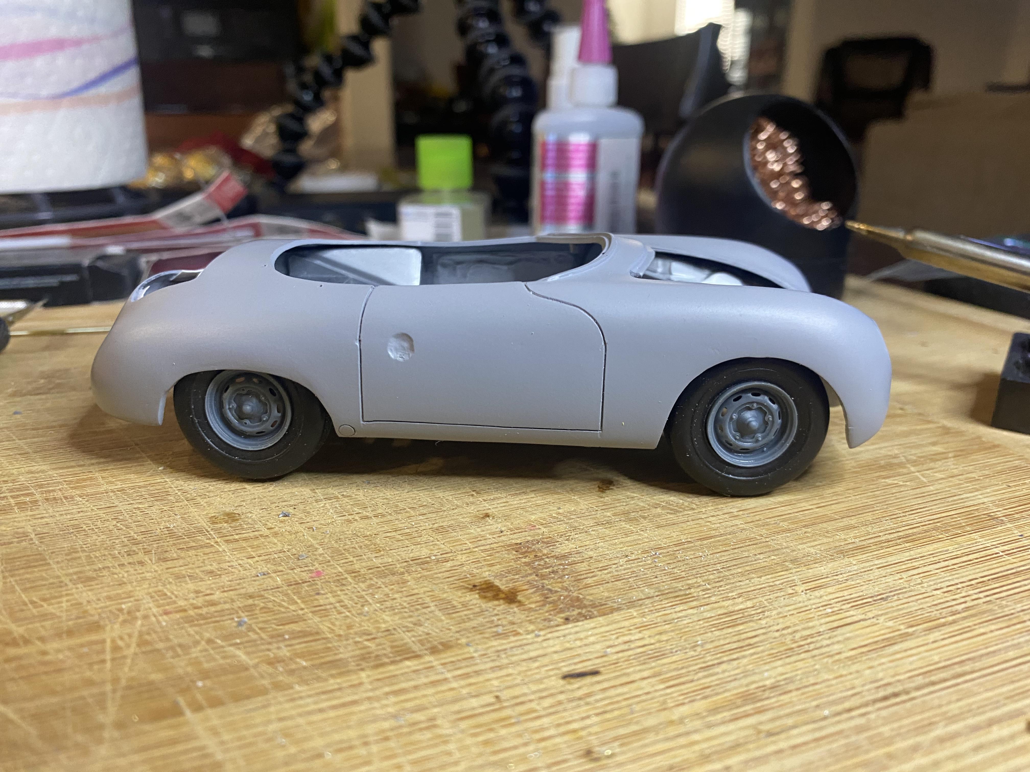

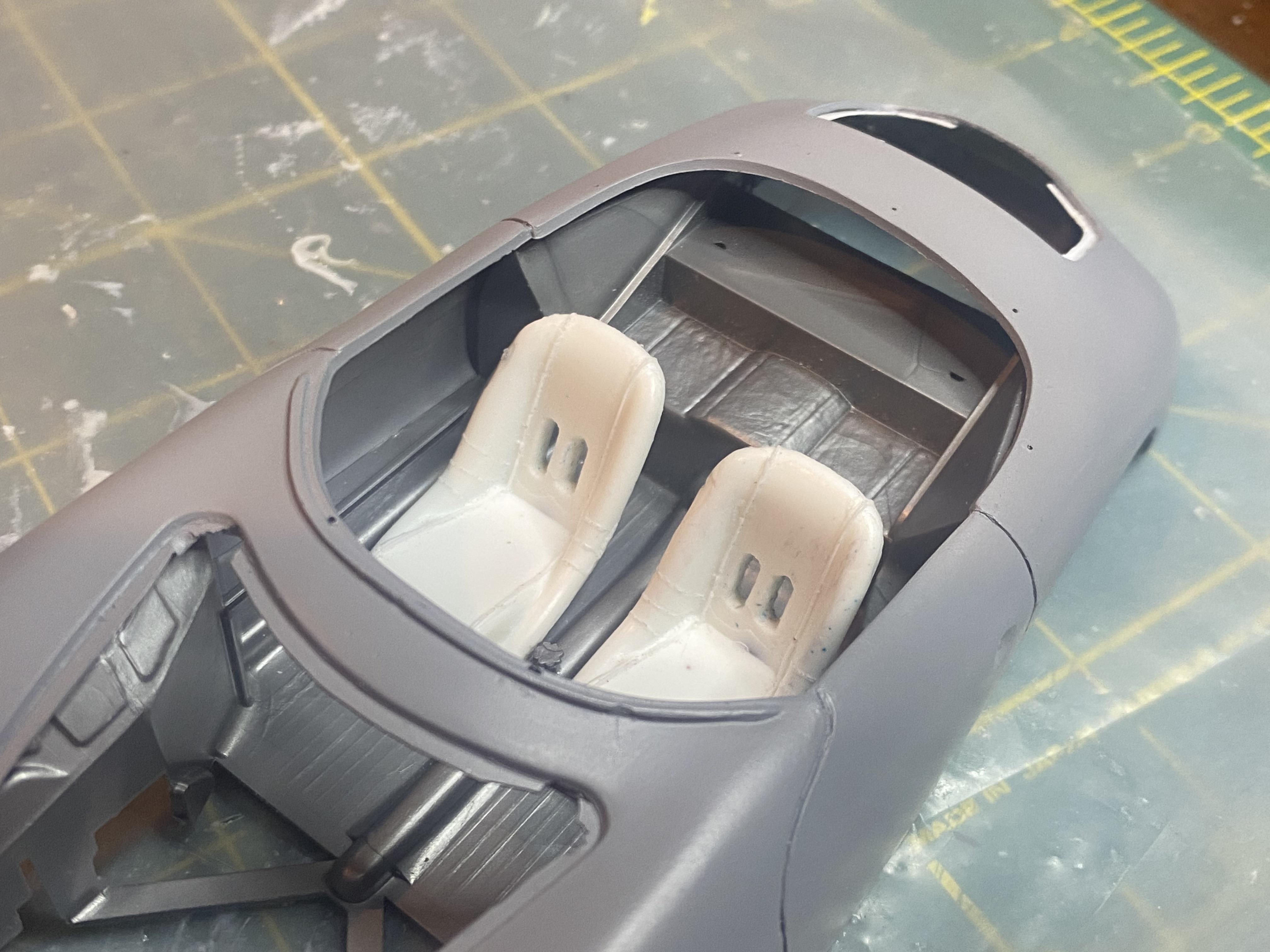

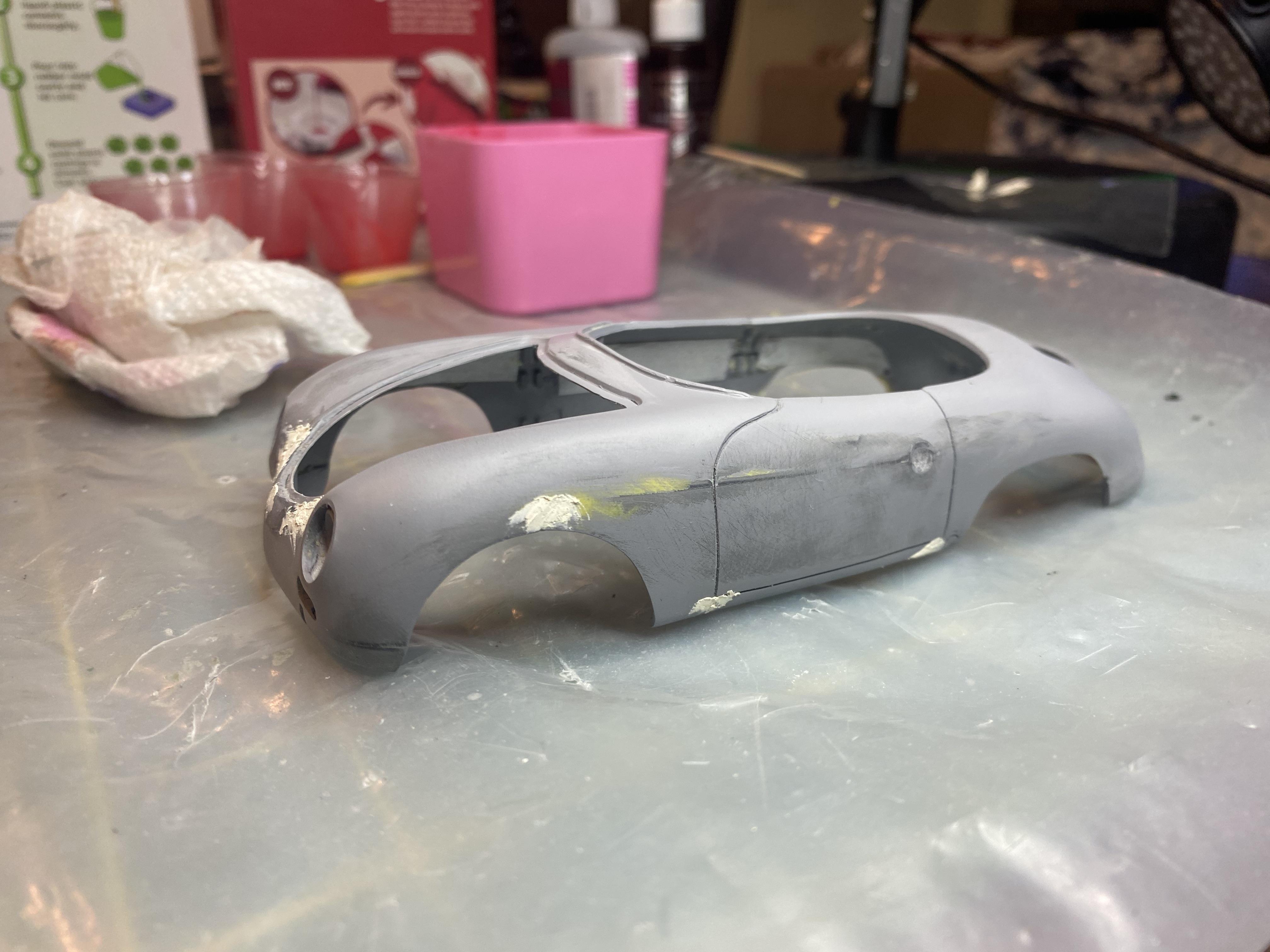

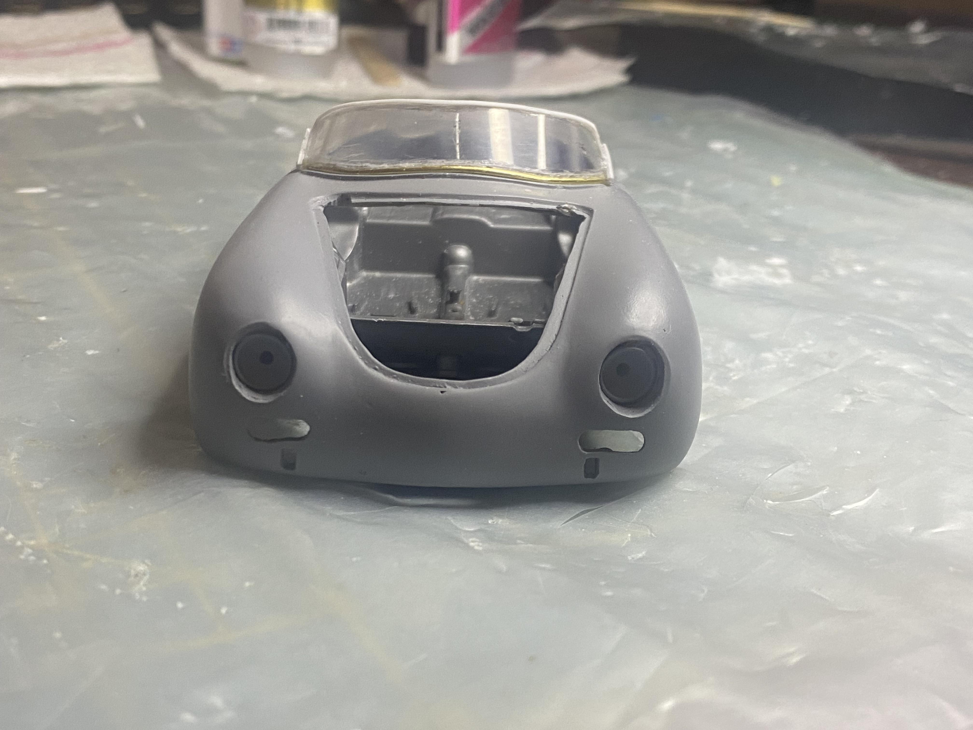

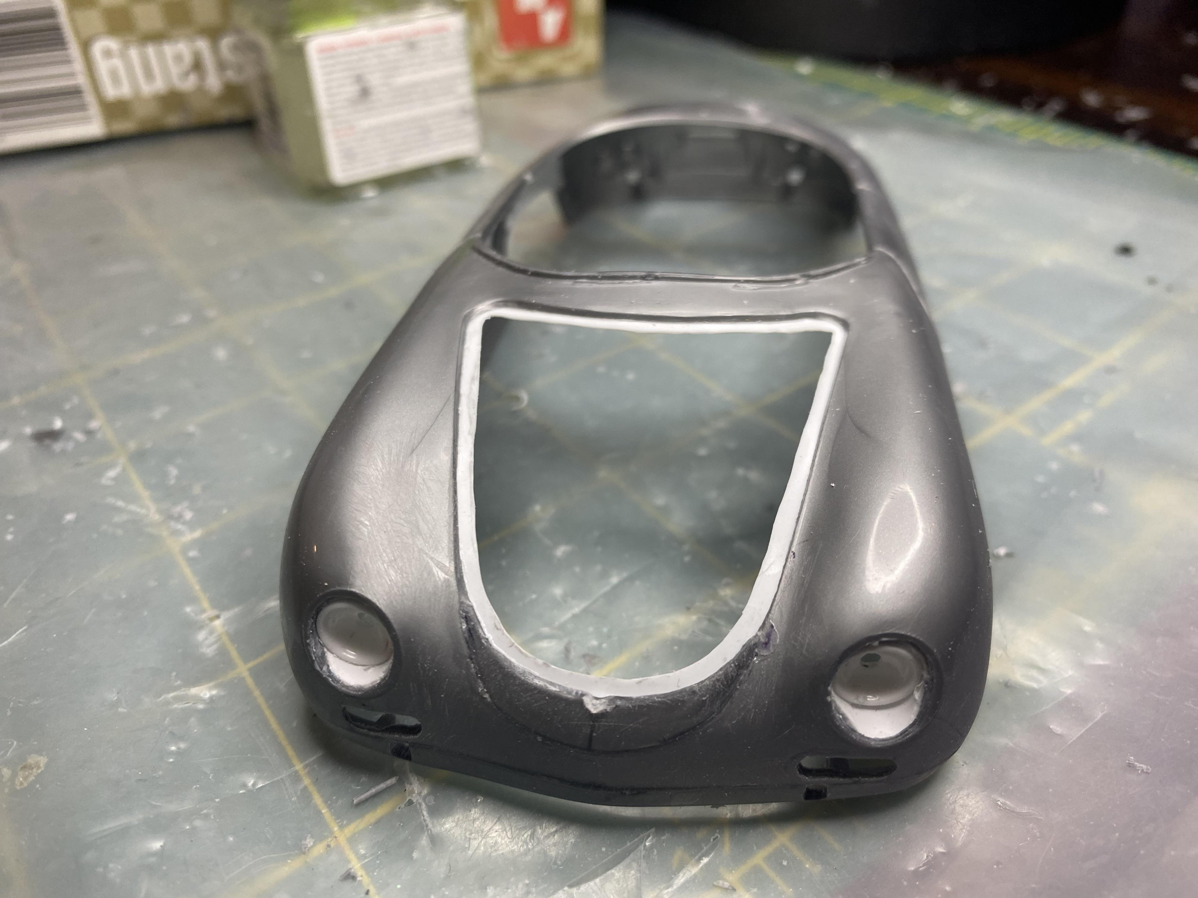

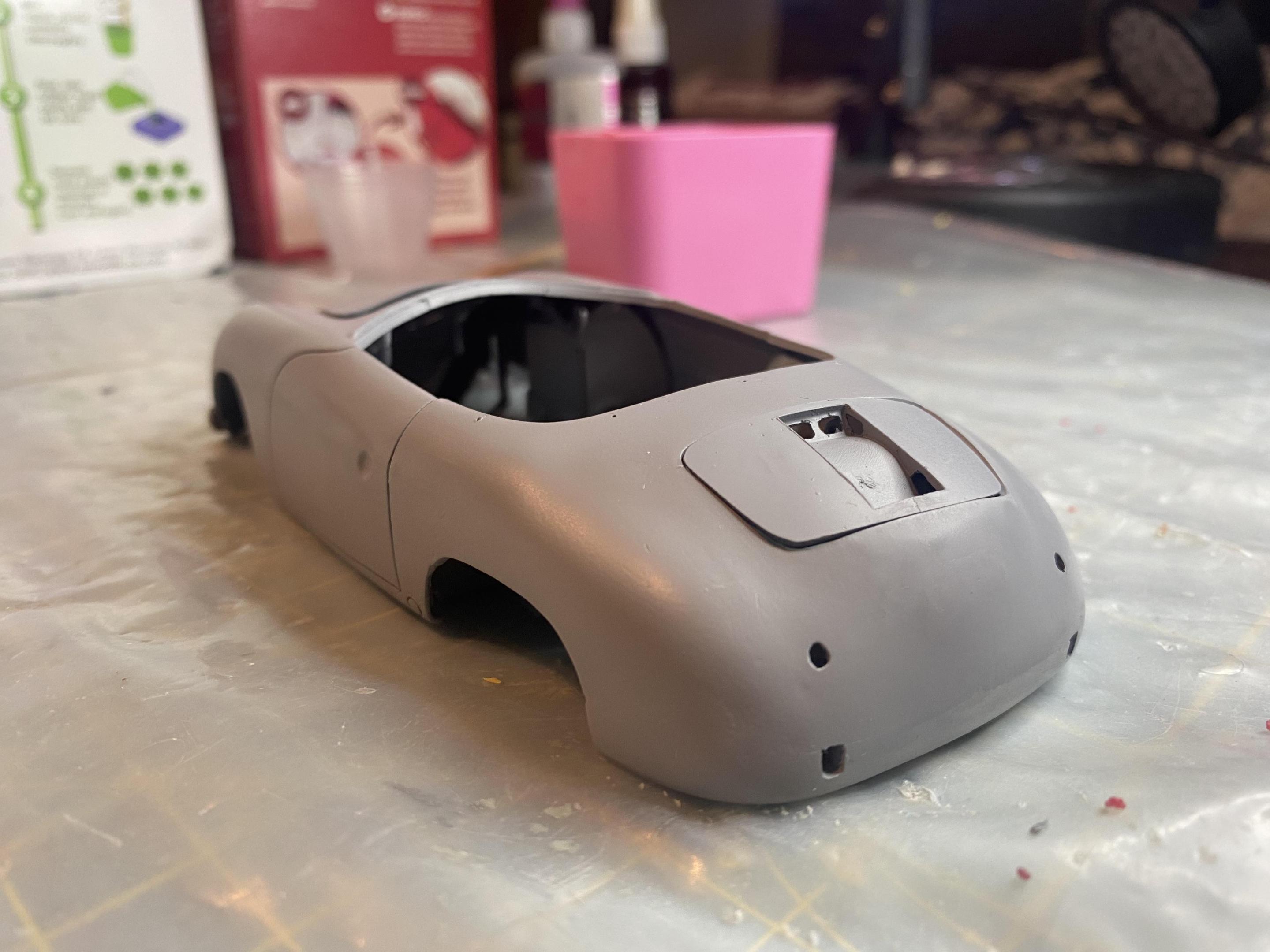

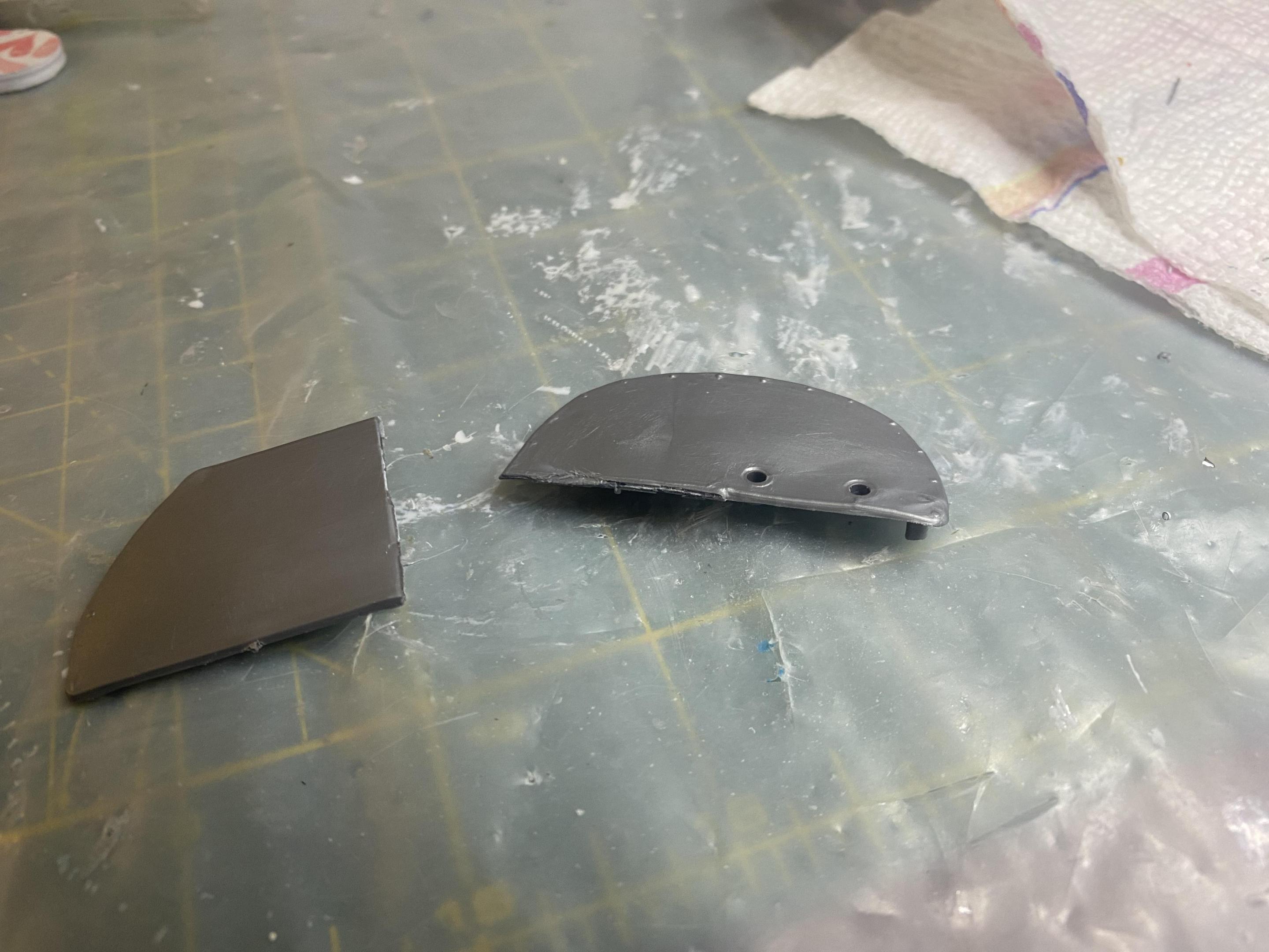

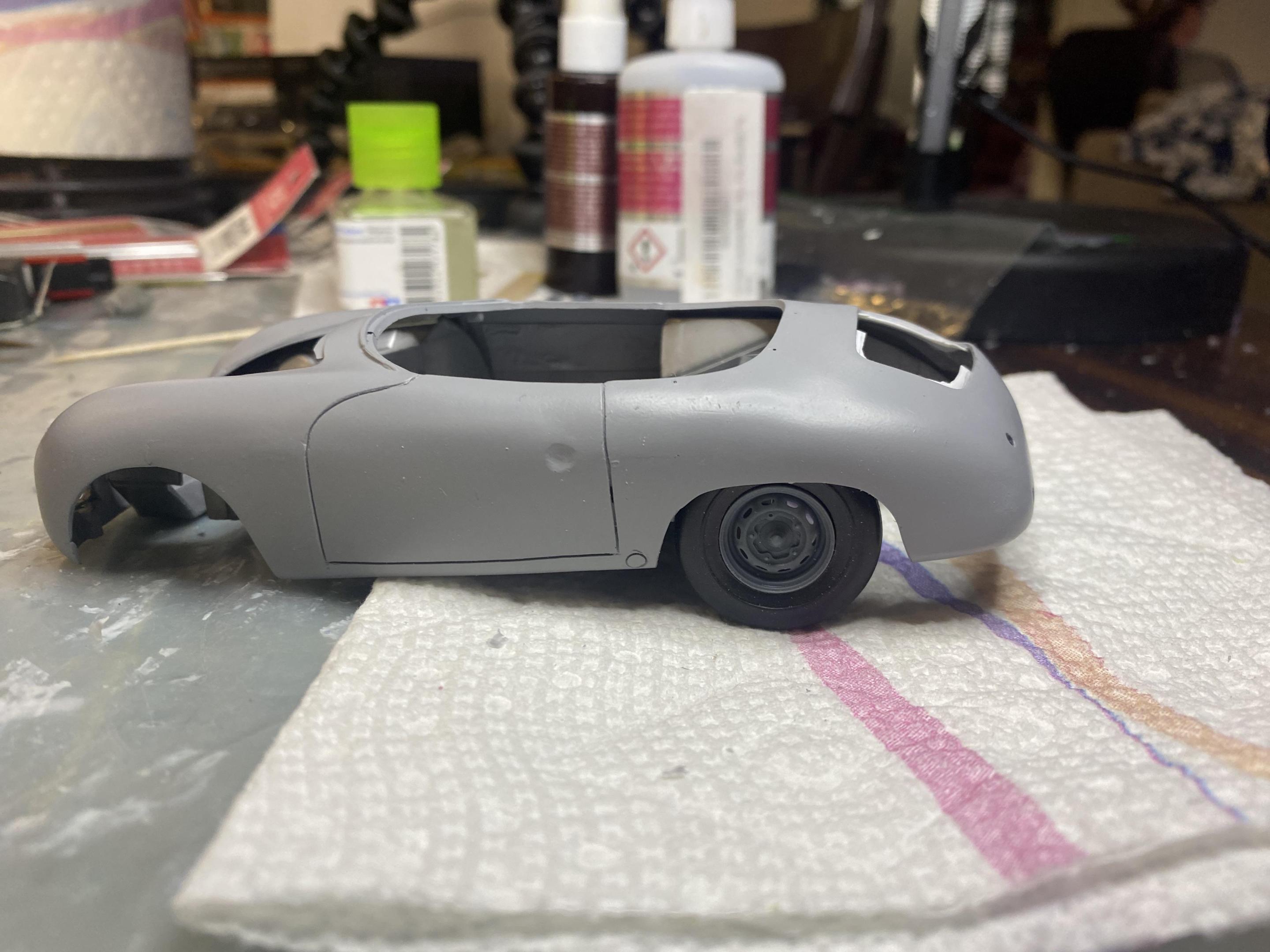

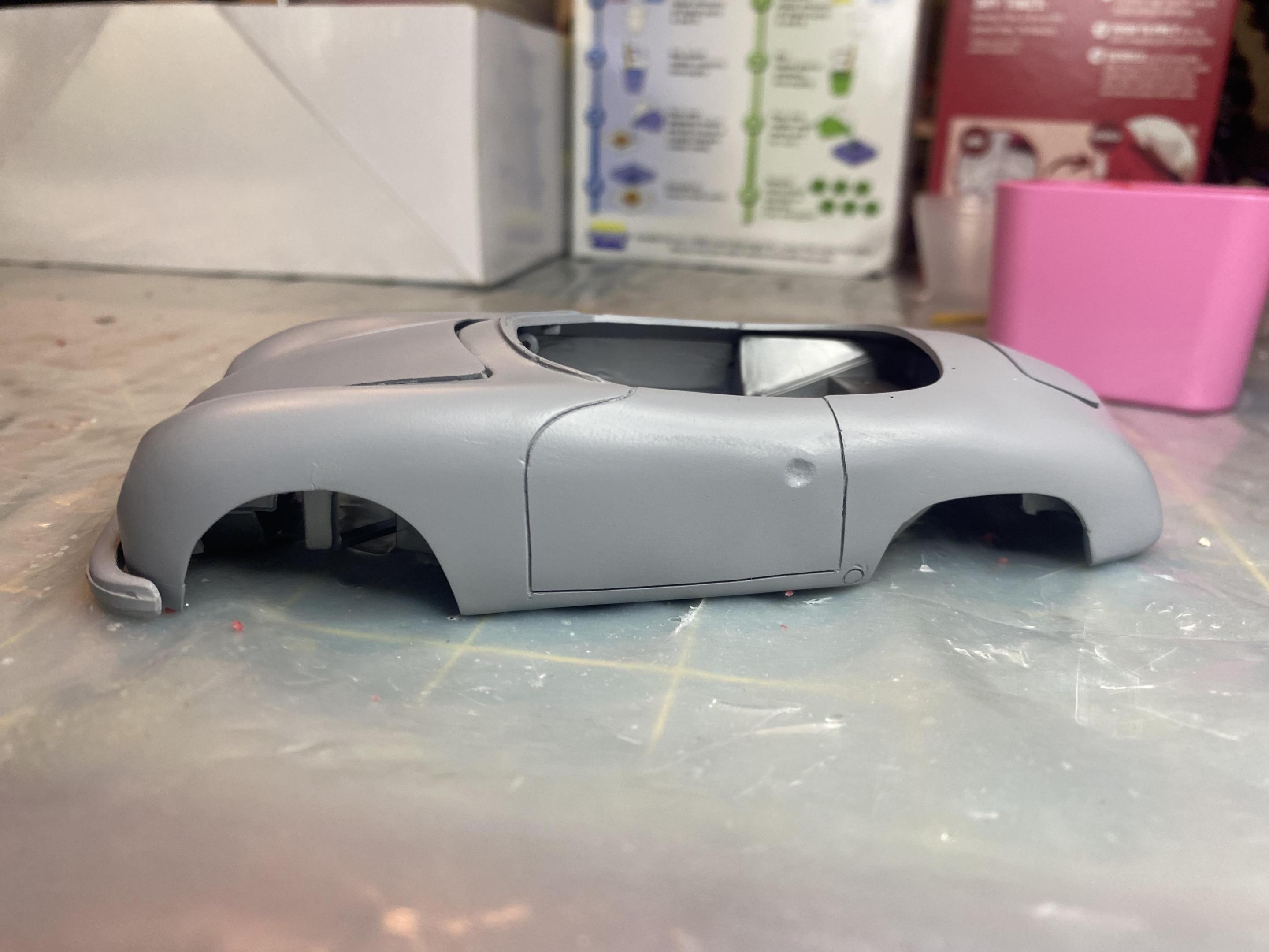

Duddly01 Posted December 25, 2024 Author Posted December 25, 2024 Body modifications pretty much complete and body in primer. Added front hood edge, cut rear hood vent openings, polyester putty, sanding and priming. The interior is no better than the body. It only comes with one seat that has no detail and only the drivers door panel. Cut the two openings and added wire for the piping and started making a mold of the seat. 3 1

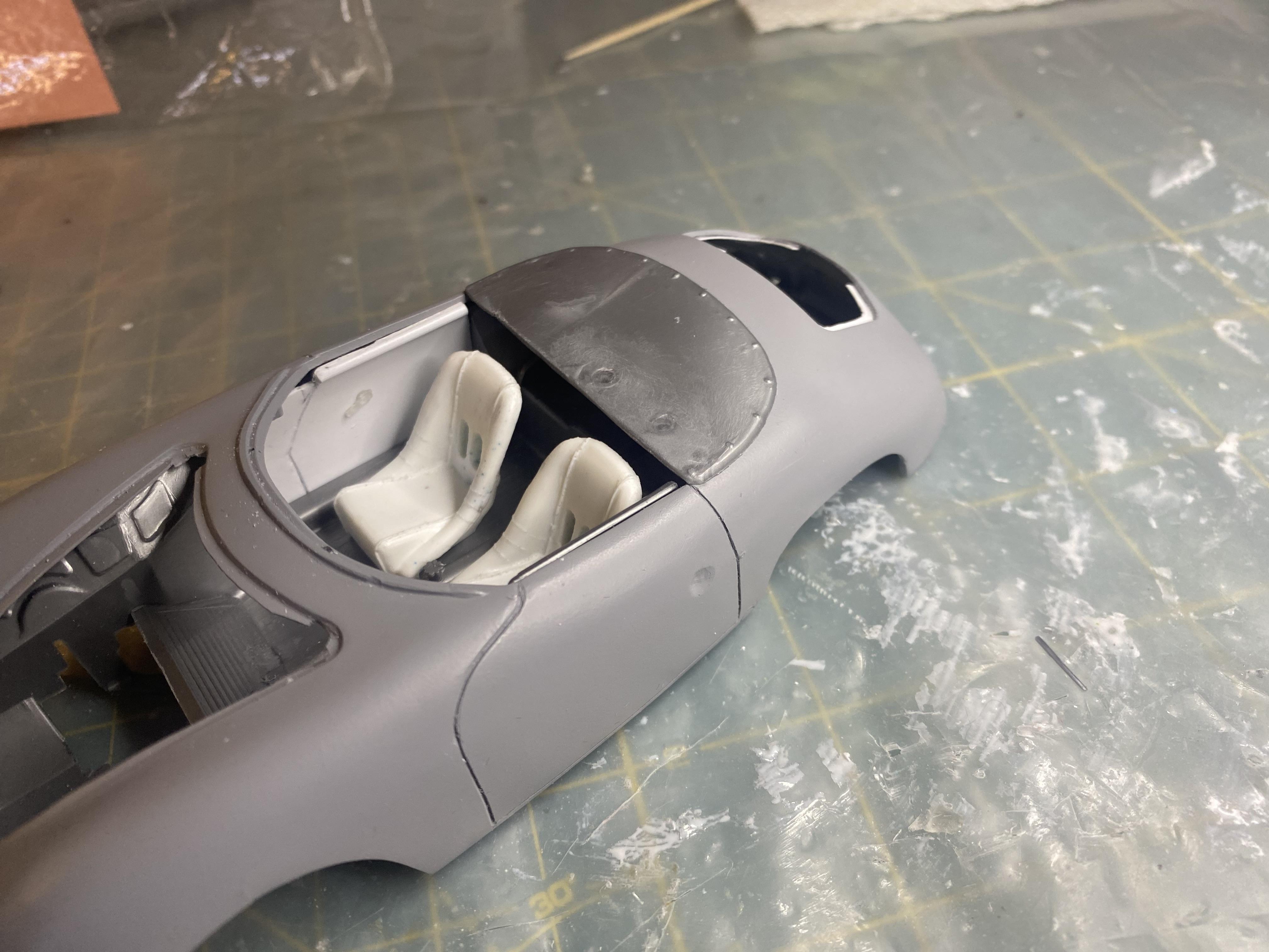

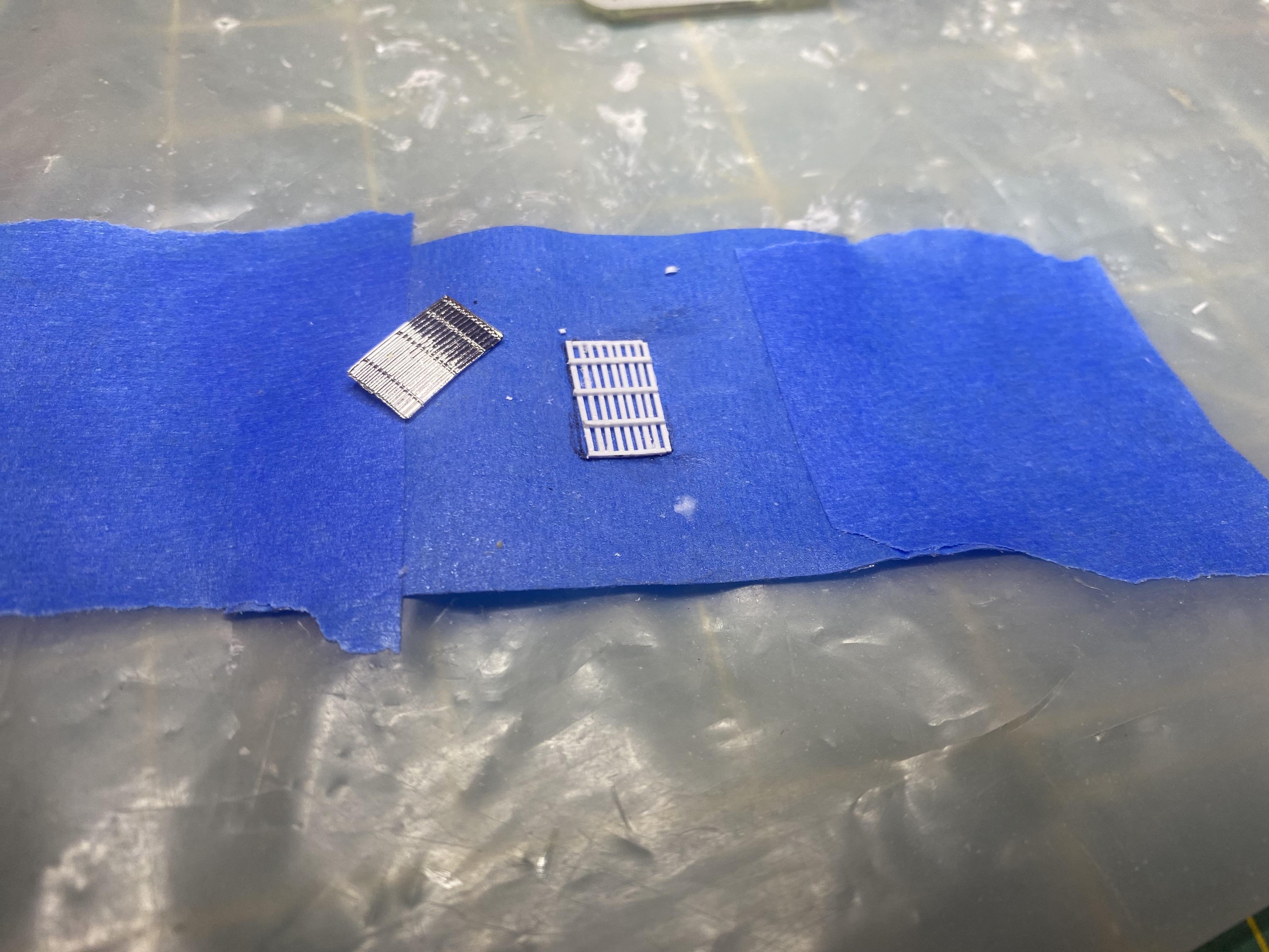

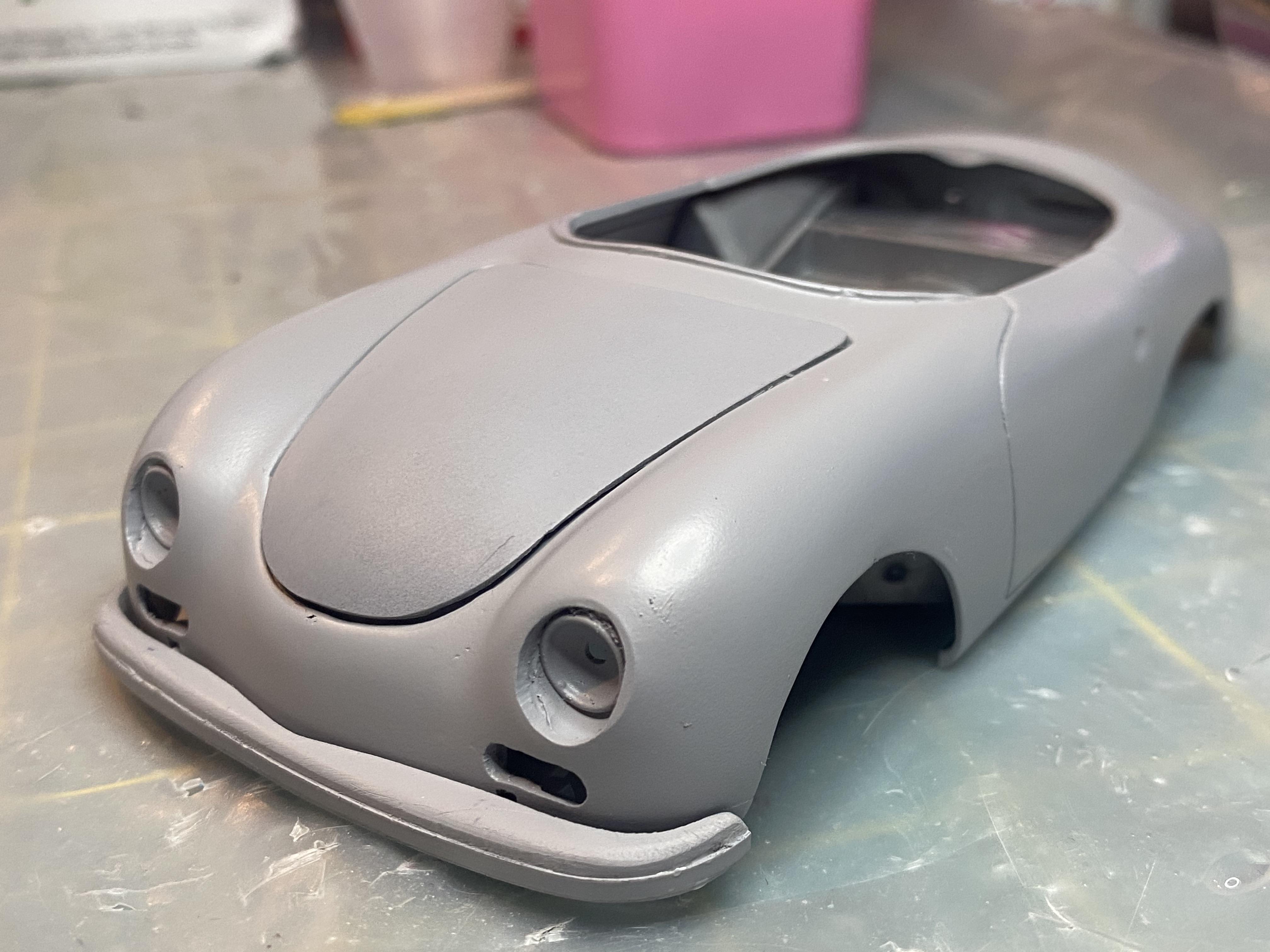

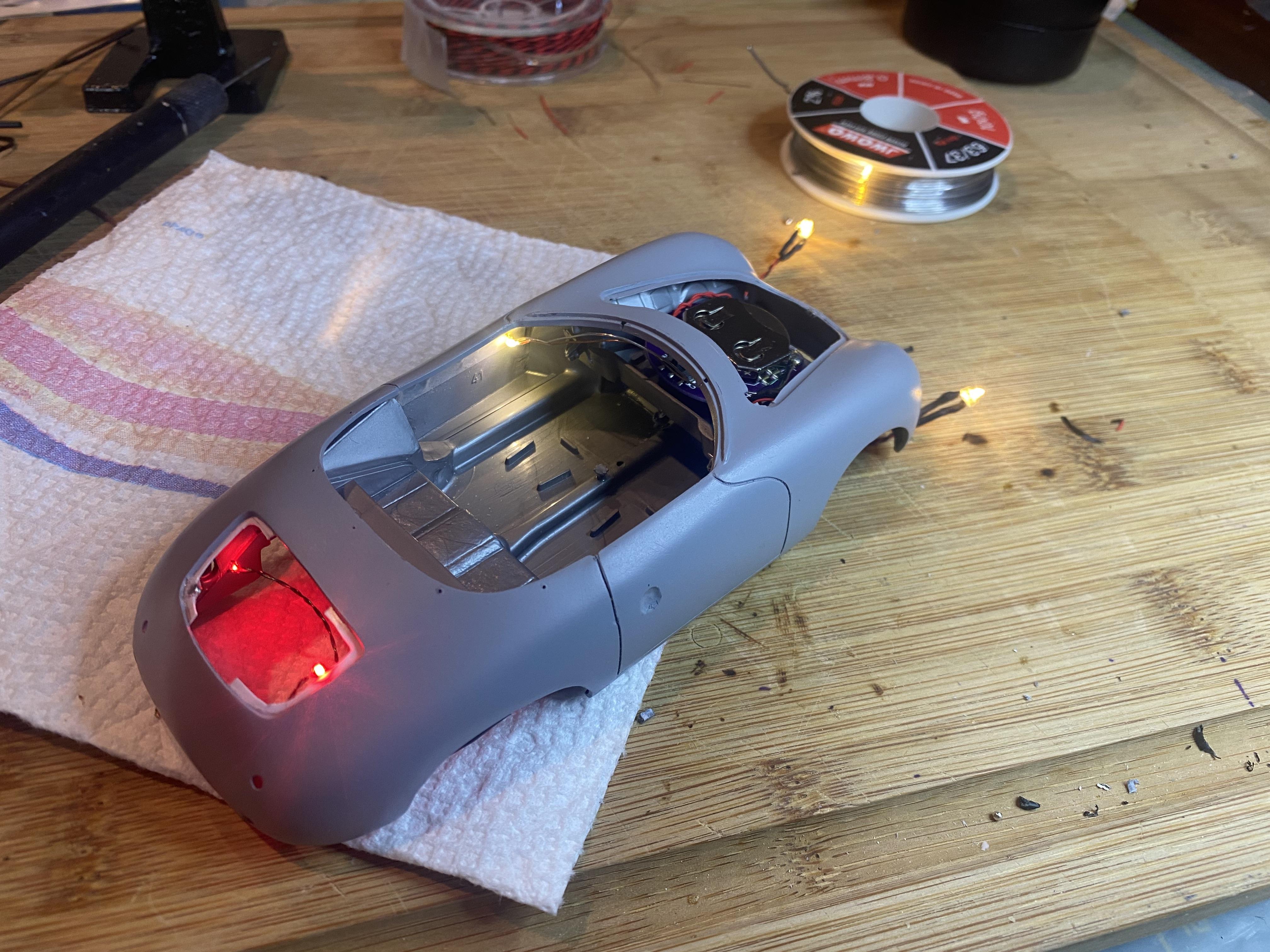

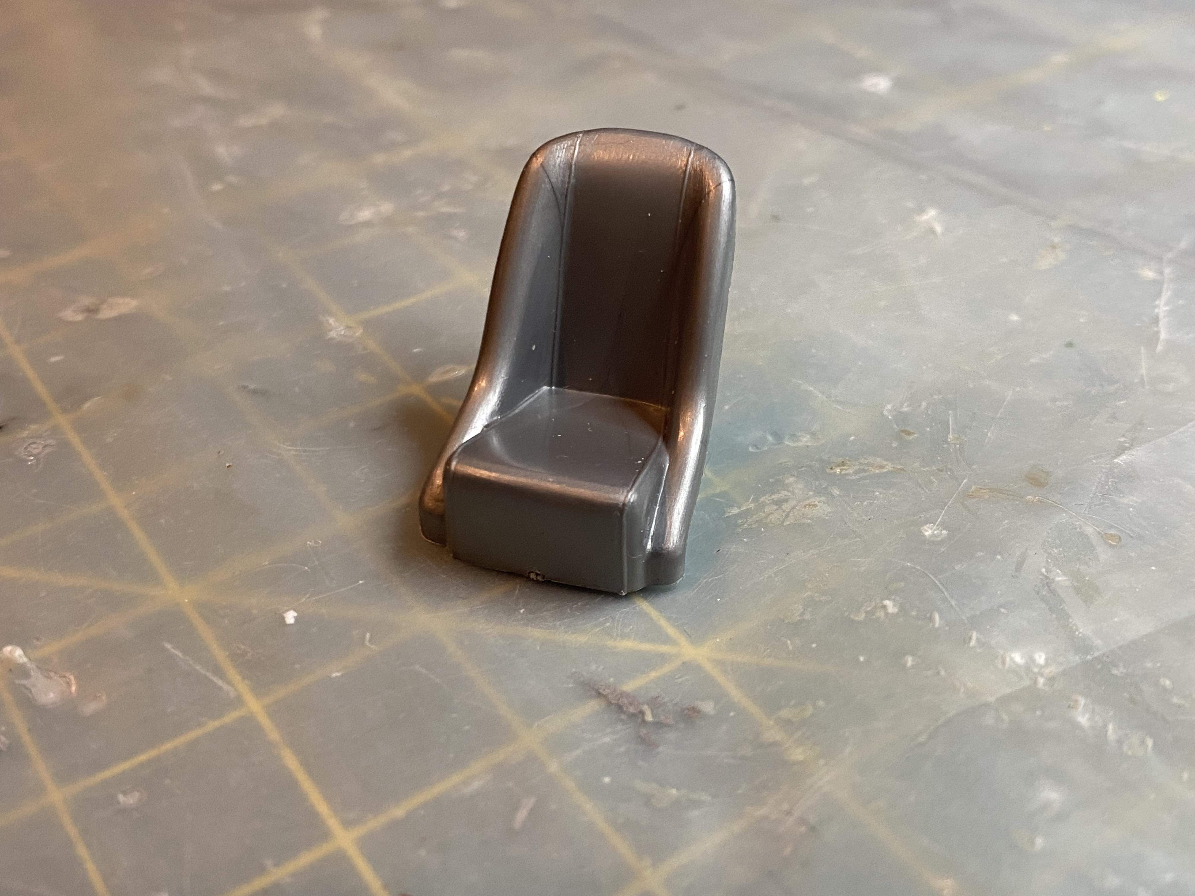

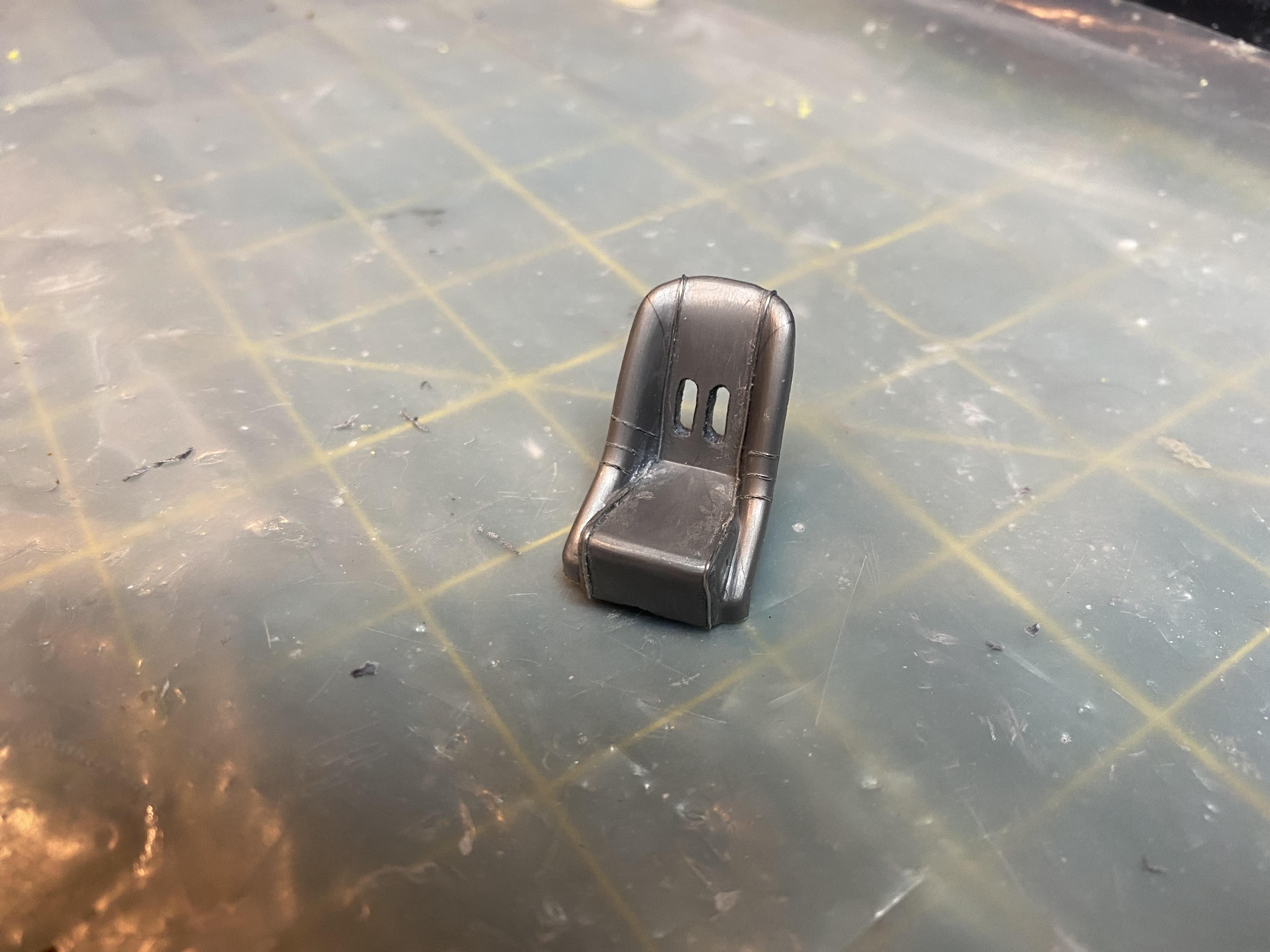

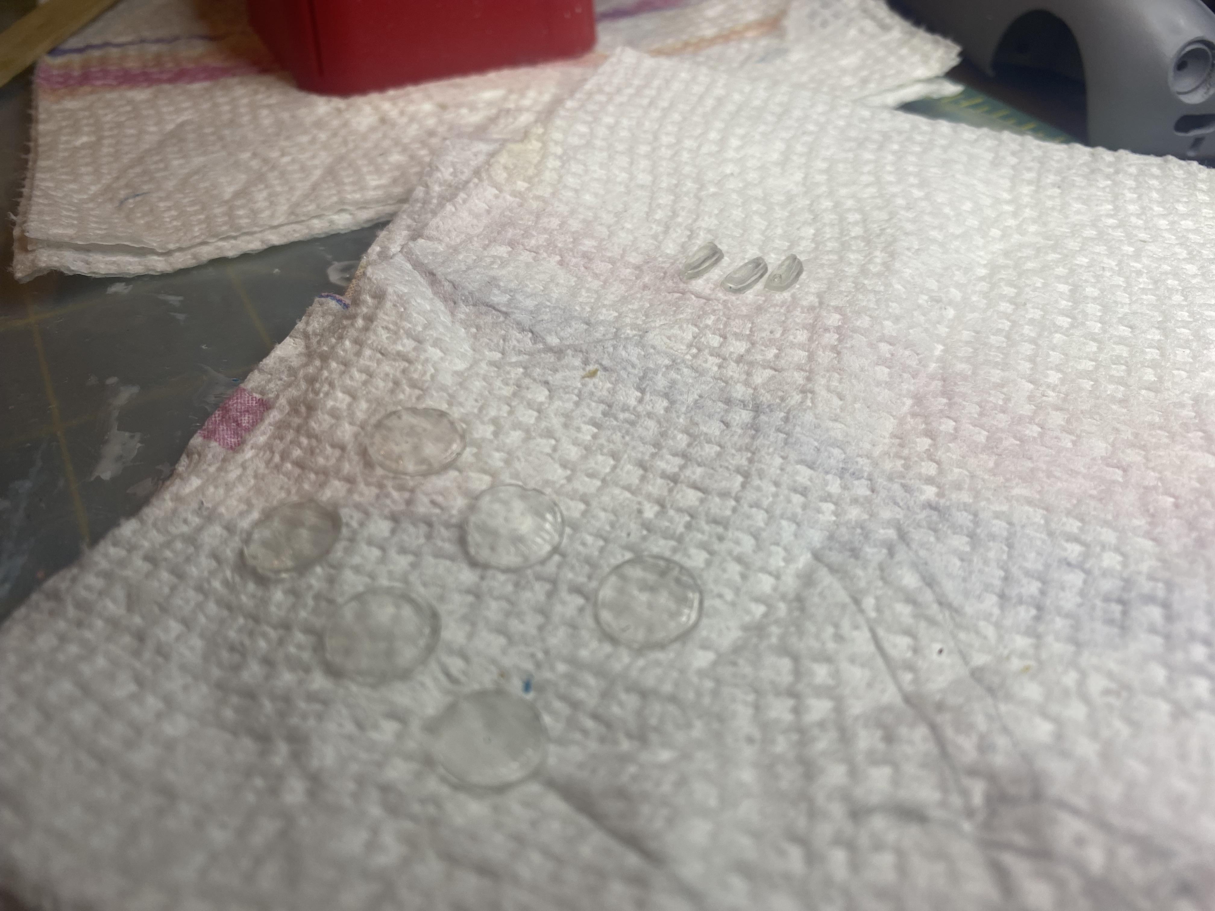

Duddly01 Posted December 26, 2024 Author Posted December 26, 2024 Created clear UV resin headlight covers and taillights and cast seats. 2 1
NOBLNG Posted December 26, 2024 Posted December 26, 2024 (edited) It’s coming along nicely!👍 What brand of UV resin did you use for the headlight covers? The stuff I have is yellowish. Edited December 26, 2024 by NOBLNG 1
Duddly01 Posted December 26, 2024 Author Posted December 26, 2024 3 hours ago, NOBLNG said: It’s coming along nicely!👍 What brand of UV resin did you use for the headlight covers? The stuff I have is yellowish. I got it from Amazon, don’t really see a name. 1

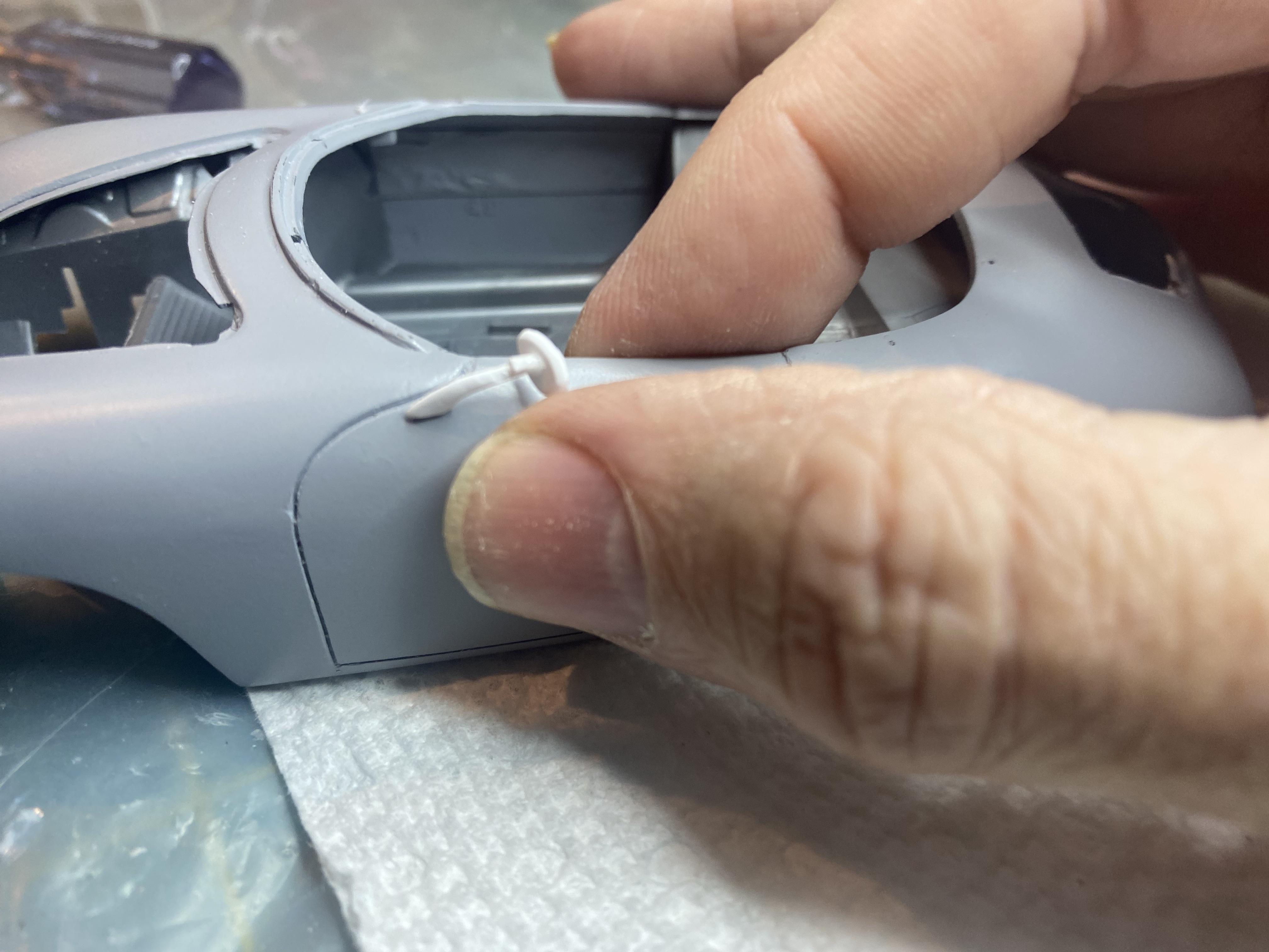

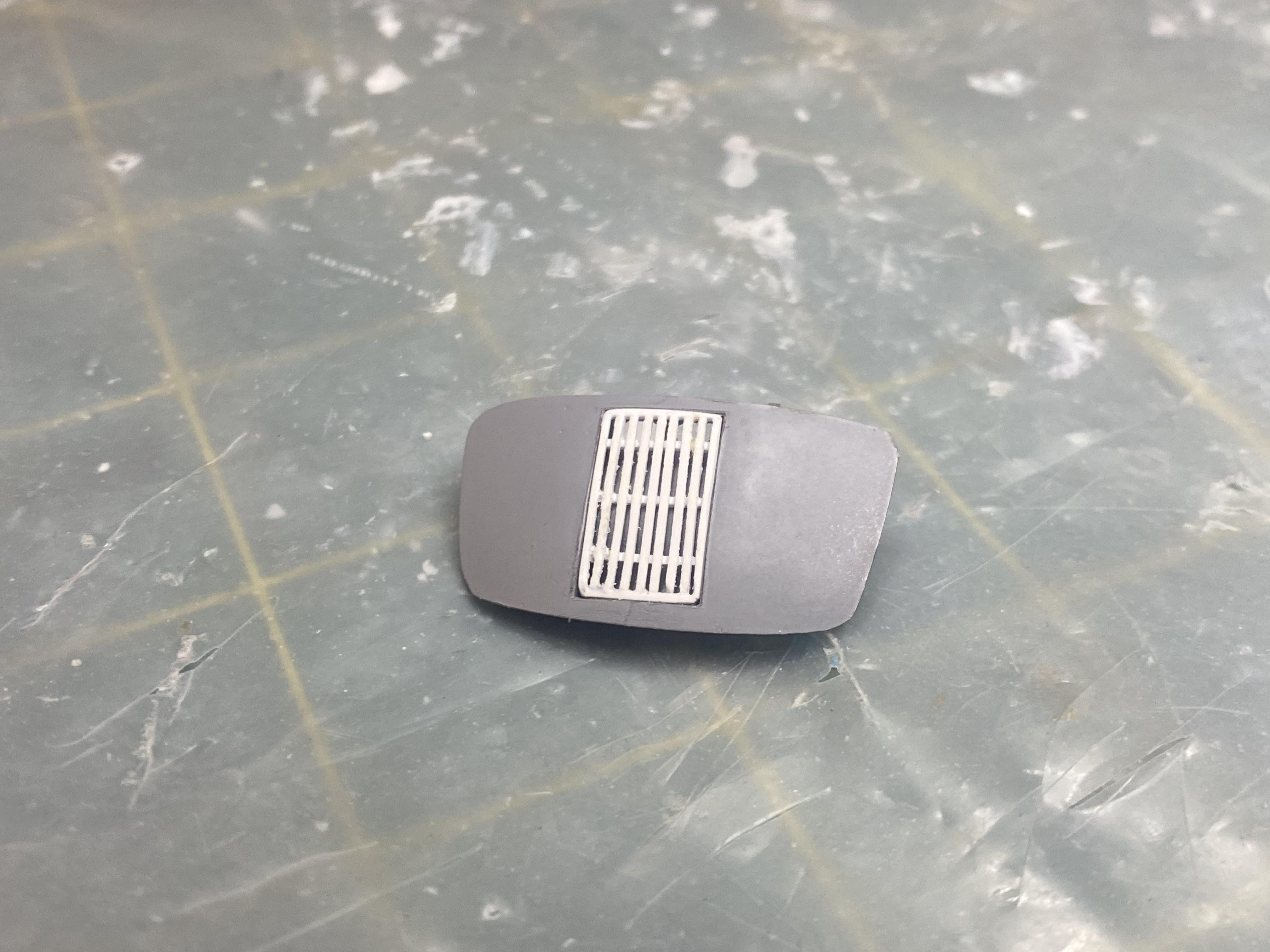

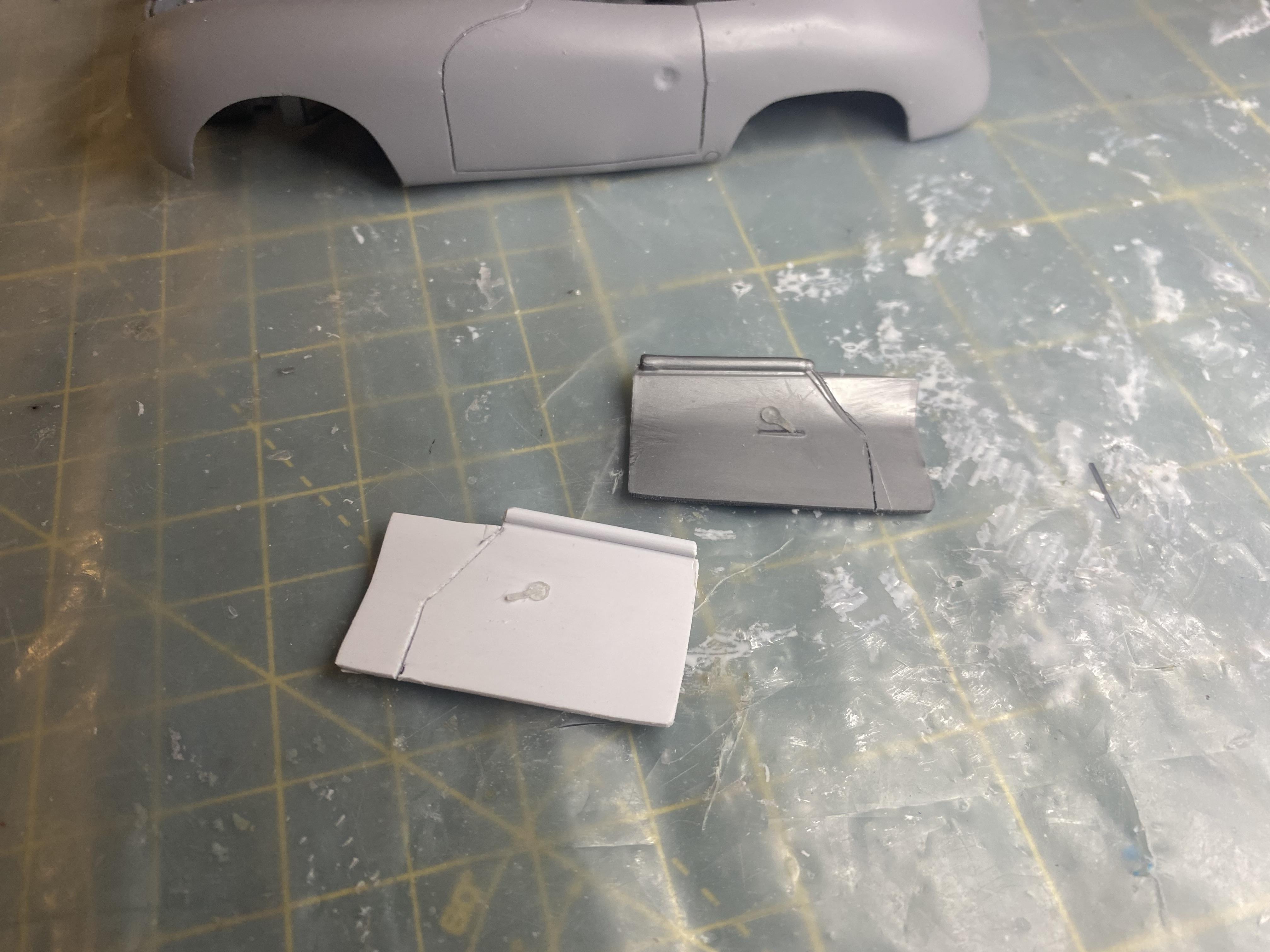

Duddly01 Posted December 26, 2024 Author Posted December 26, 2024 I cut down the tonneau cover and filled the holes for the roll bar. I figured out the only place I will be able to fit the lily pad battery holder. I will need to figure out how to hide it. I made a couple of door opening handles and the passenger door panel. 1

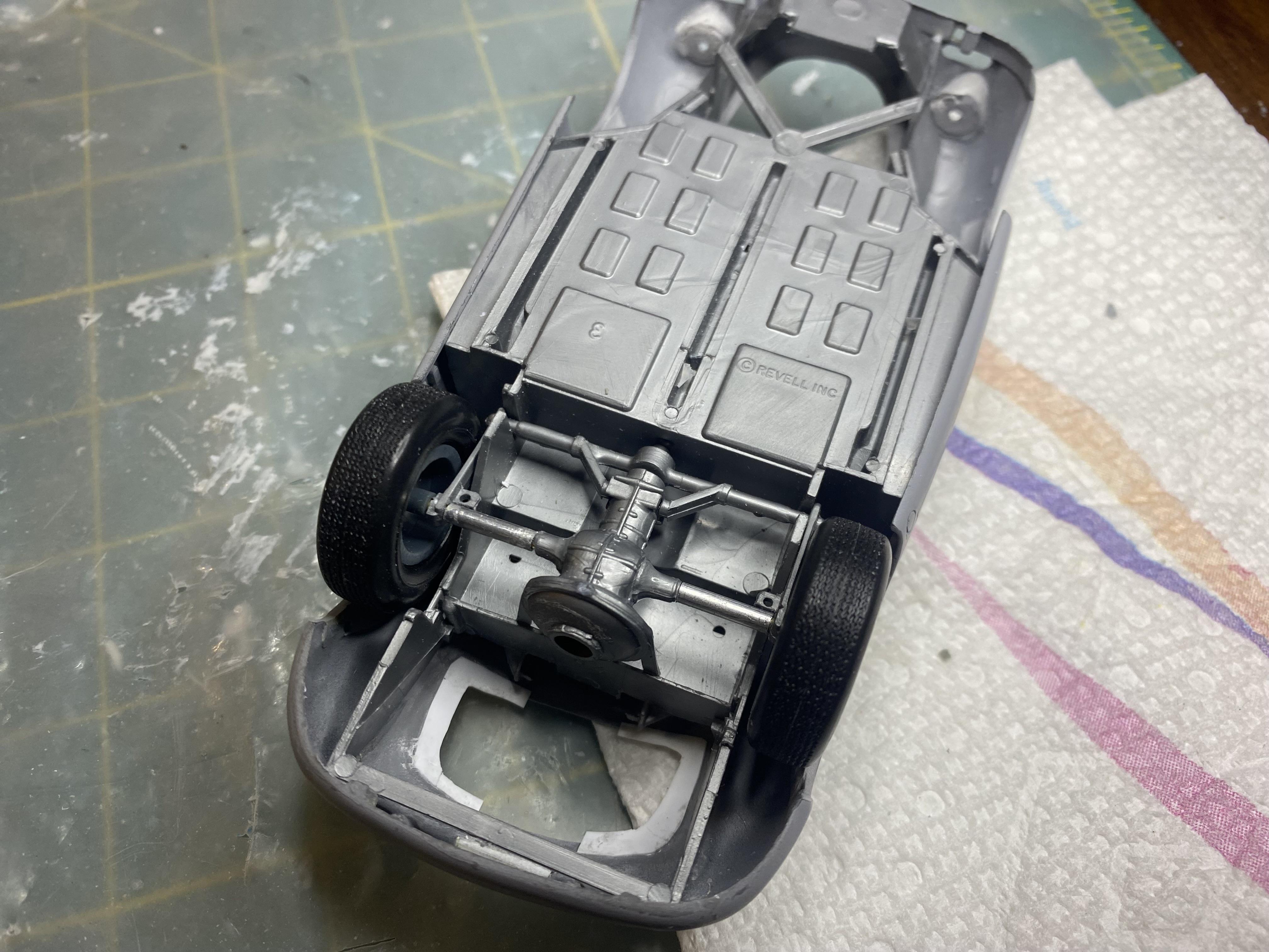

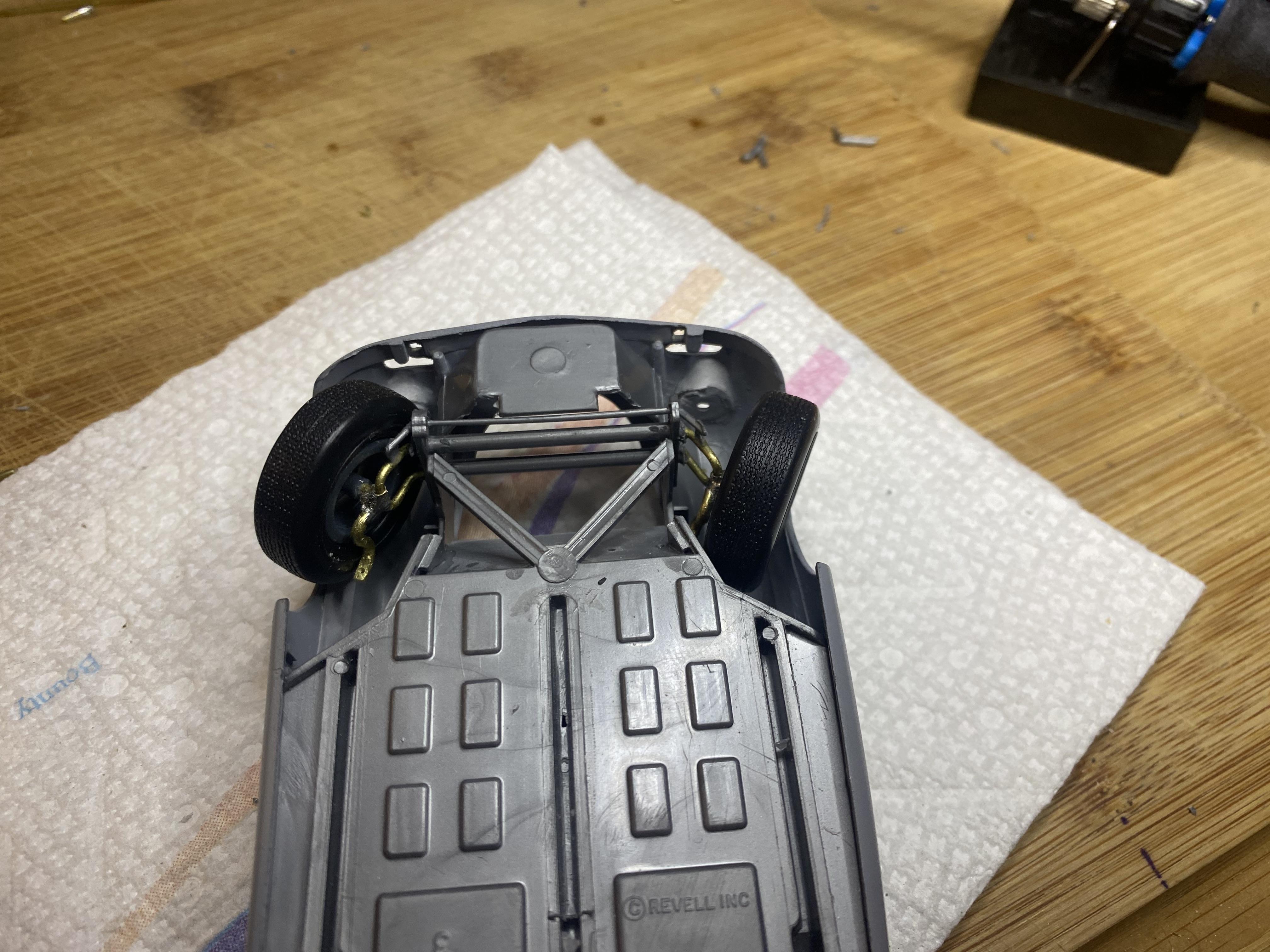

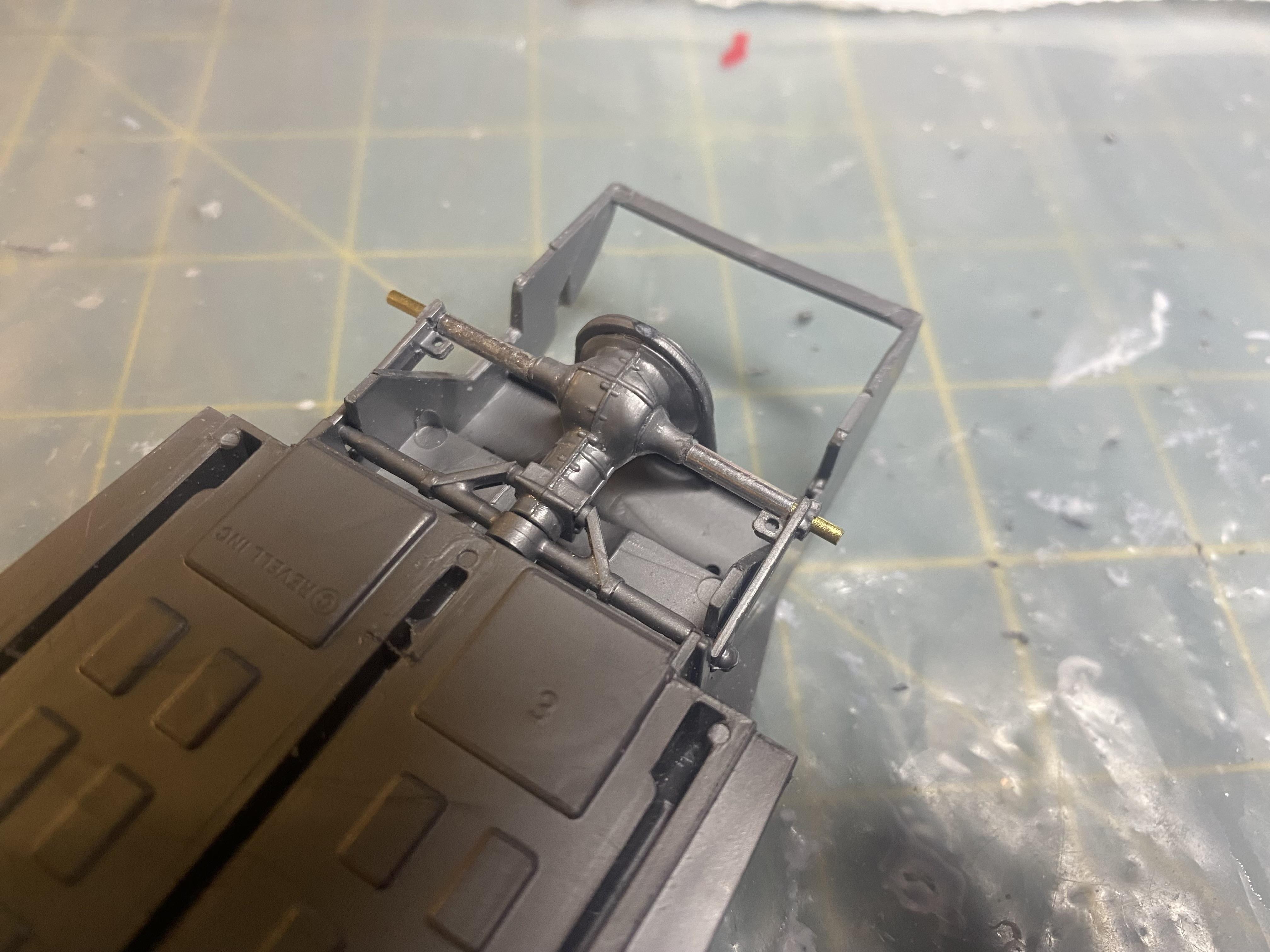

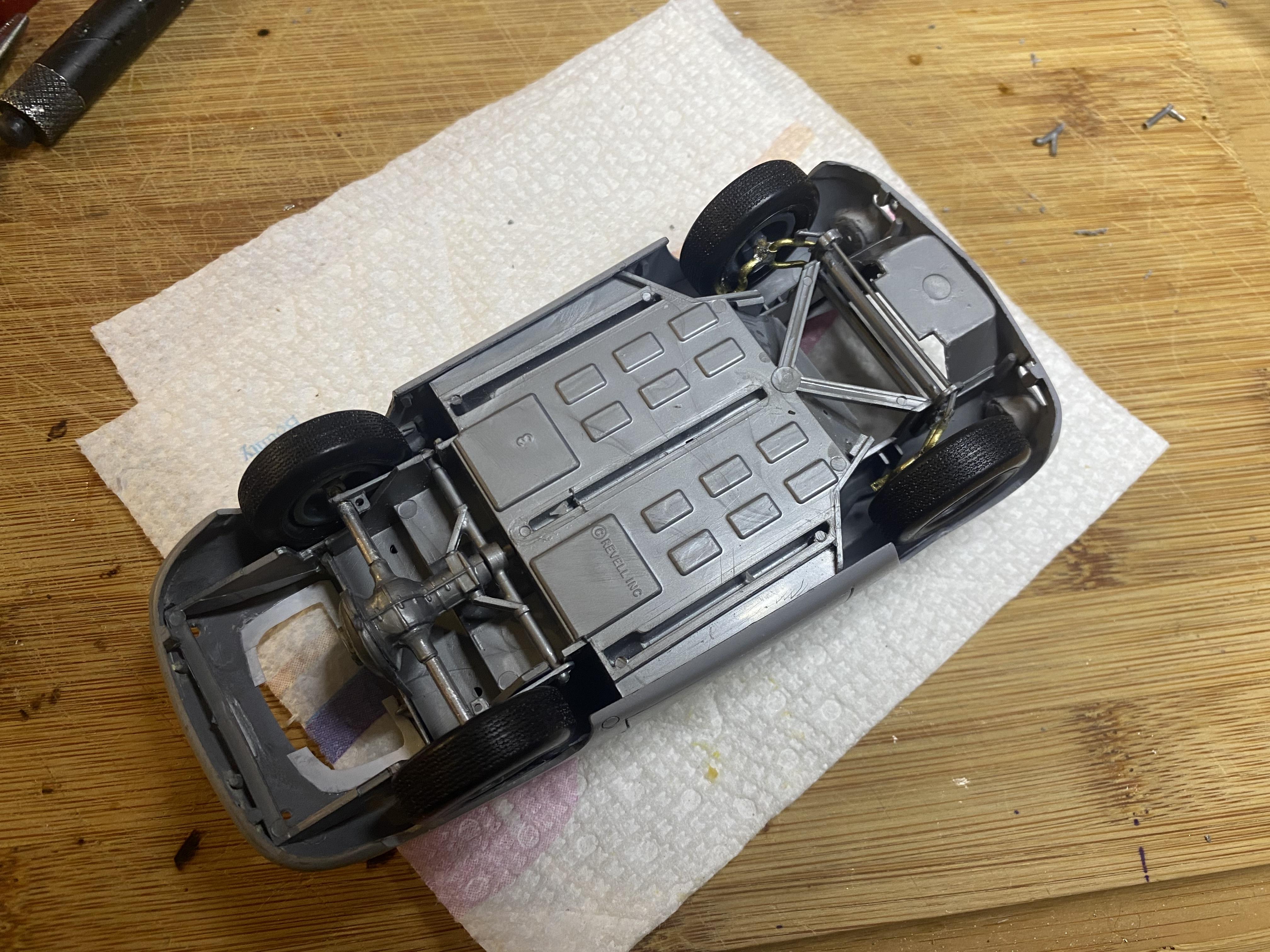

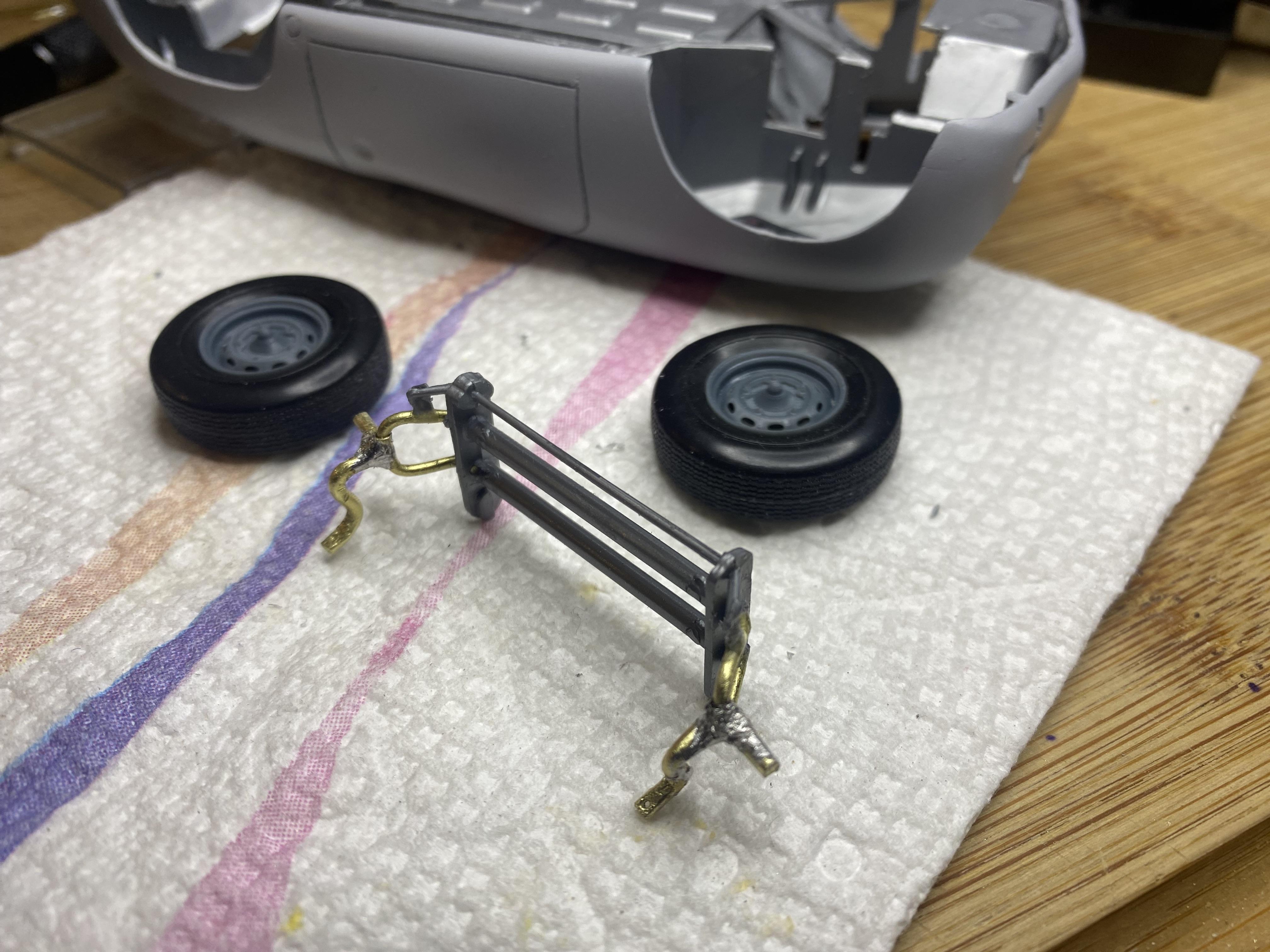

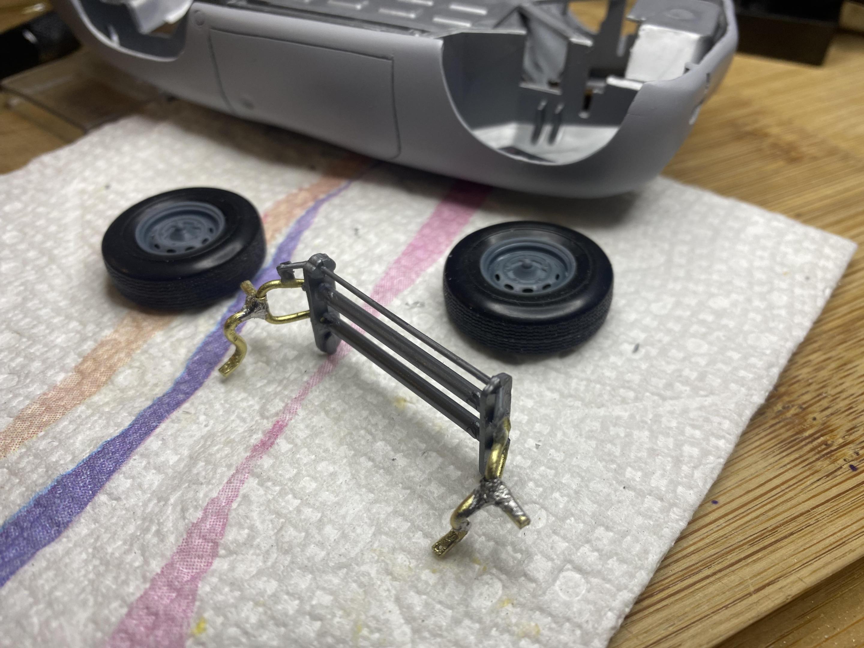

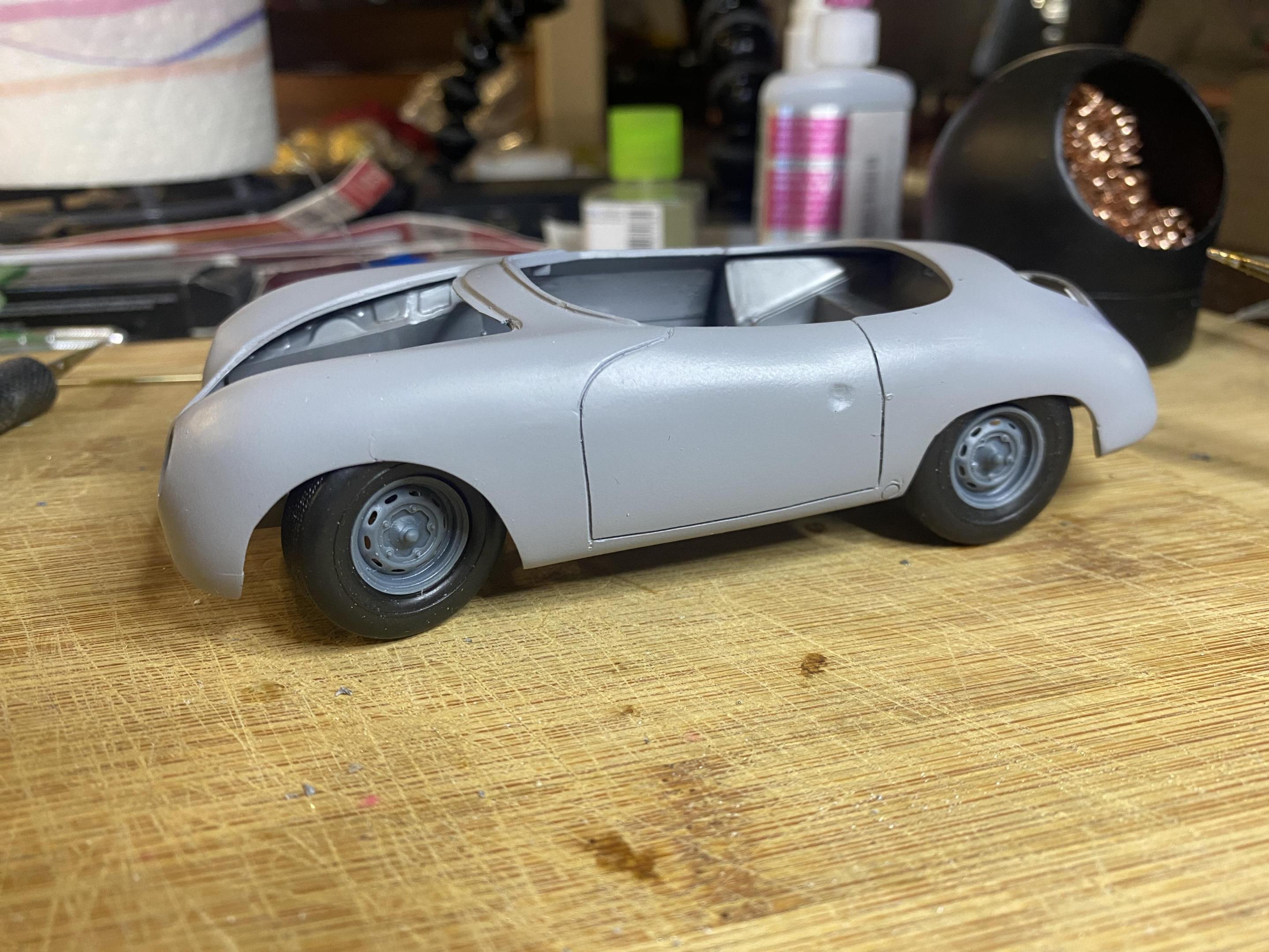

Duddly01 Posted December 28, 2024 Author Posted December 28, 2024 Got some work done on fitting the suspension. The rear now has aluminum tubes and brass rod to hold and allow the rear wheels to turn. Modified the front suspension with brass rod and tube to make the front wheels fit in the wheel wells and be poseable. 4

Duddly01 Posted December 28, 2024 Author Posted December 28, 2024 8 hours ago, Pierre Rivard said: Huge progress. How does it look now next to your Fujimi body? The body of the Fujimi is accurate out of the box, this one as you can see took a lot to get it there. With that said I feel this body is comparable now, but a lot of the other parts will also need a whole lot of work to get anywhere close to where you start out of the box with the Fujimi kit, not to mention the need for 3d printed rims and other additions.

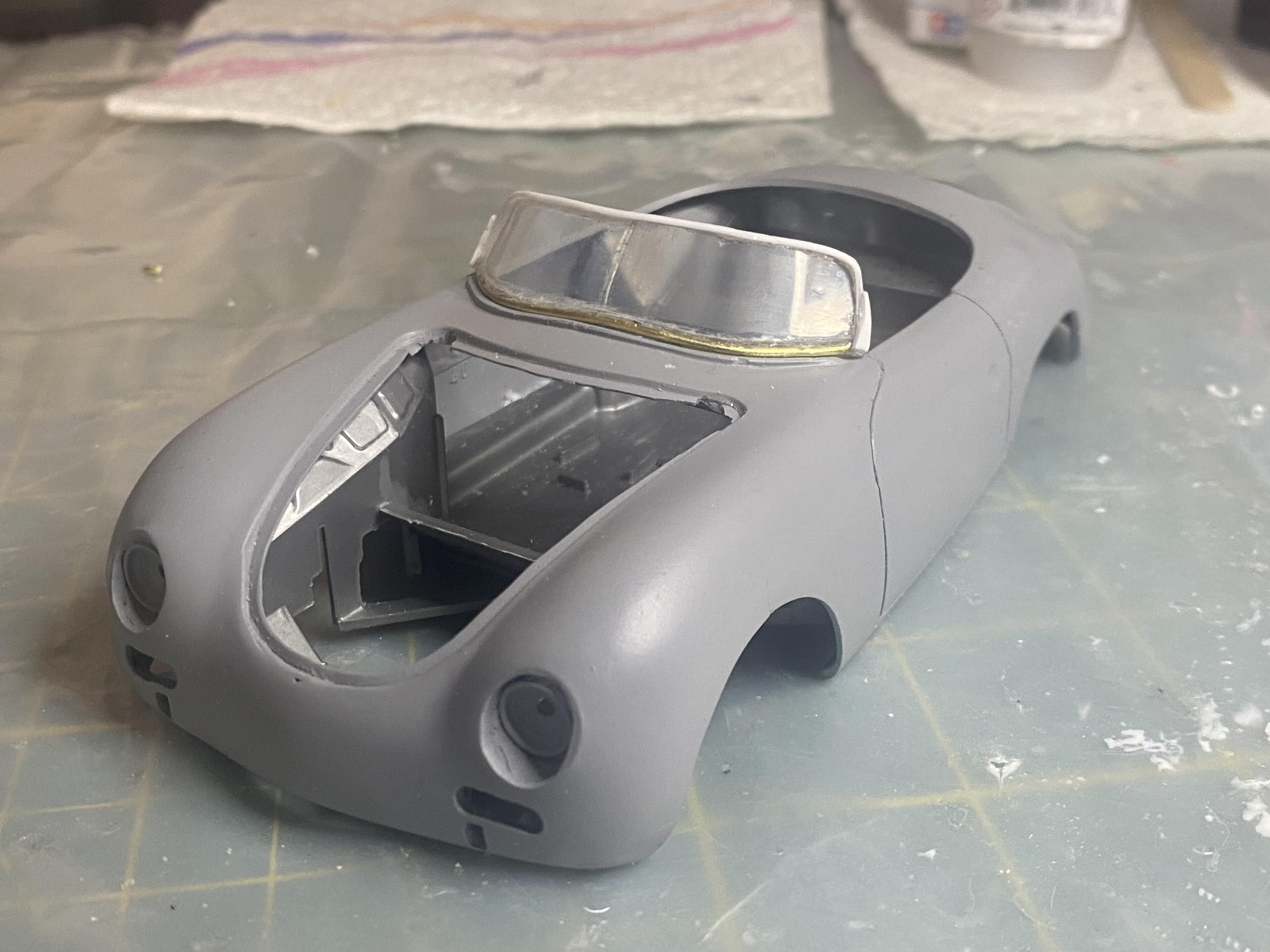

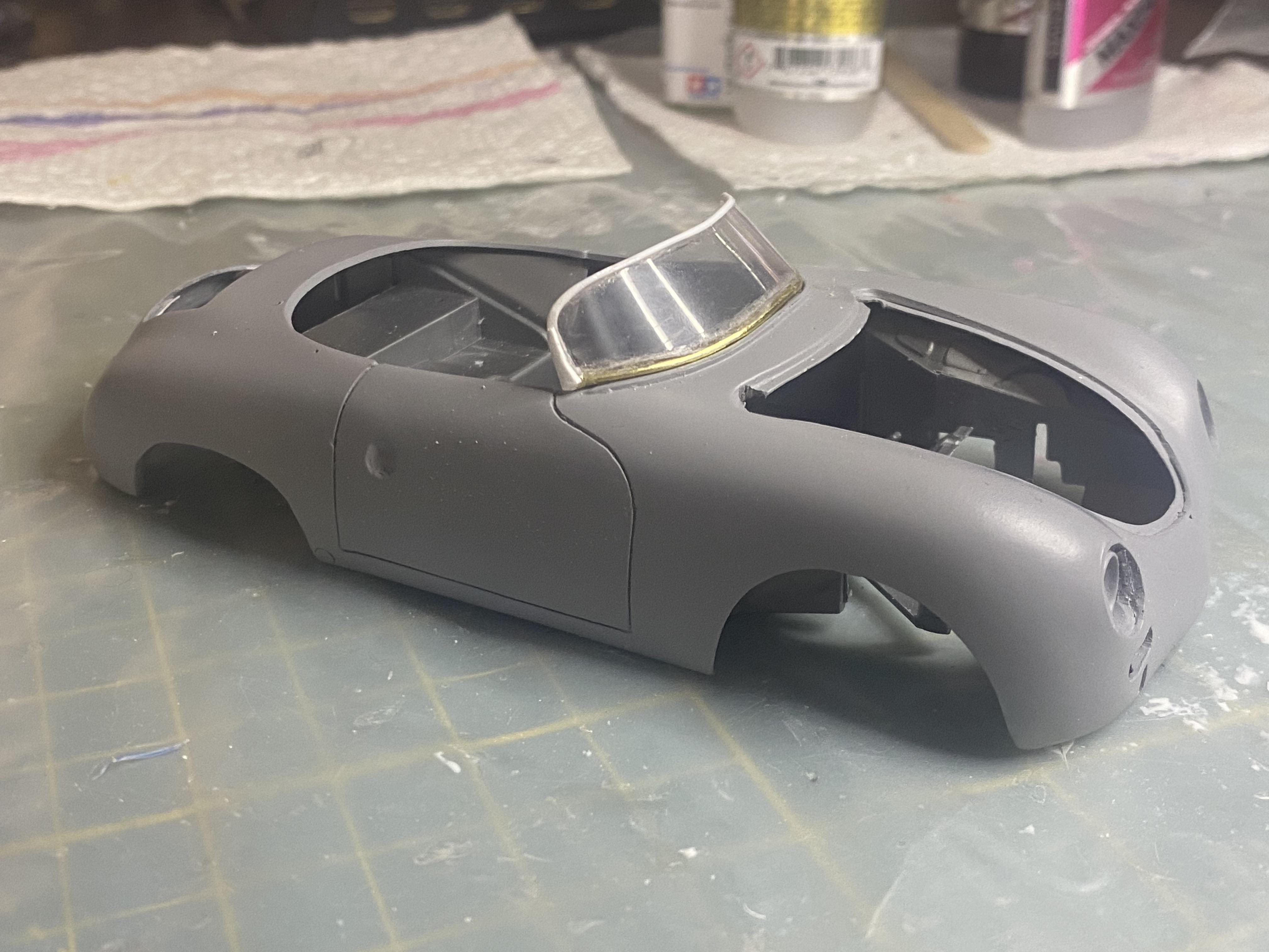

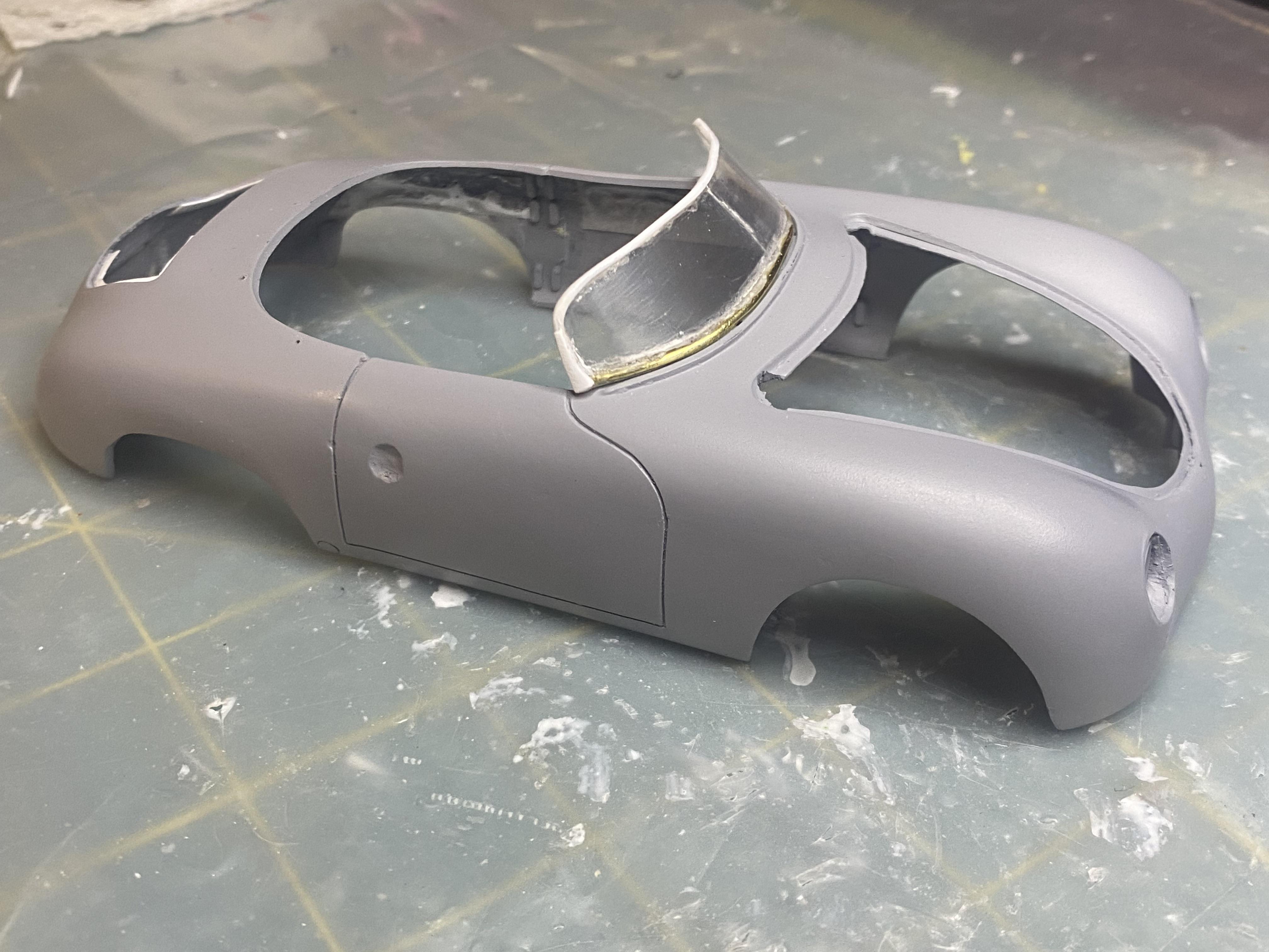

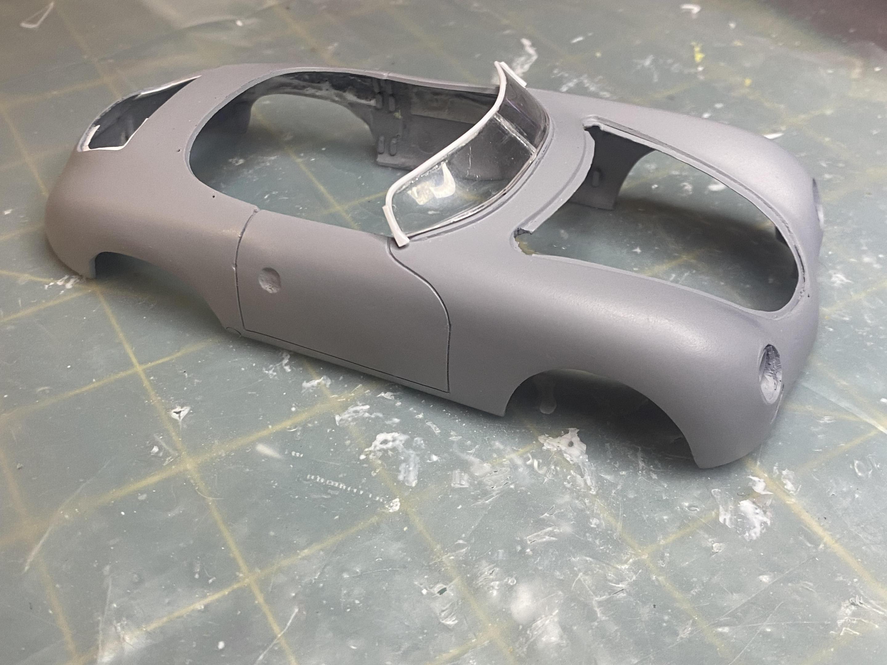

Duddly01 Posted December 28, 2024 Author Posted December 28, 2024 I created what I think is a fairly accurate windshield. Not perfect but not too bad either.
Duddly01 Posted December 29, 2024 Author Posted December 29, 2024 I added some minor details to the undercarriage, created an open rear hood vent and added trim to the cut down windshield. I am going to likely make the windshields optional. Next I need to make the LED wiring harness and make something in the front trunk to hide the battery.

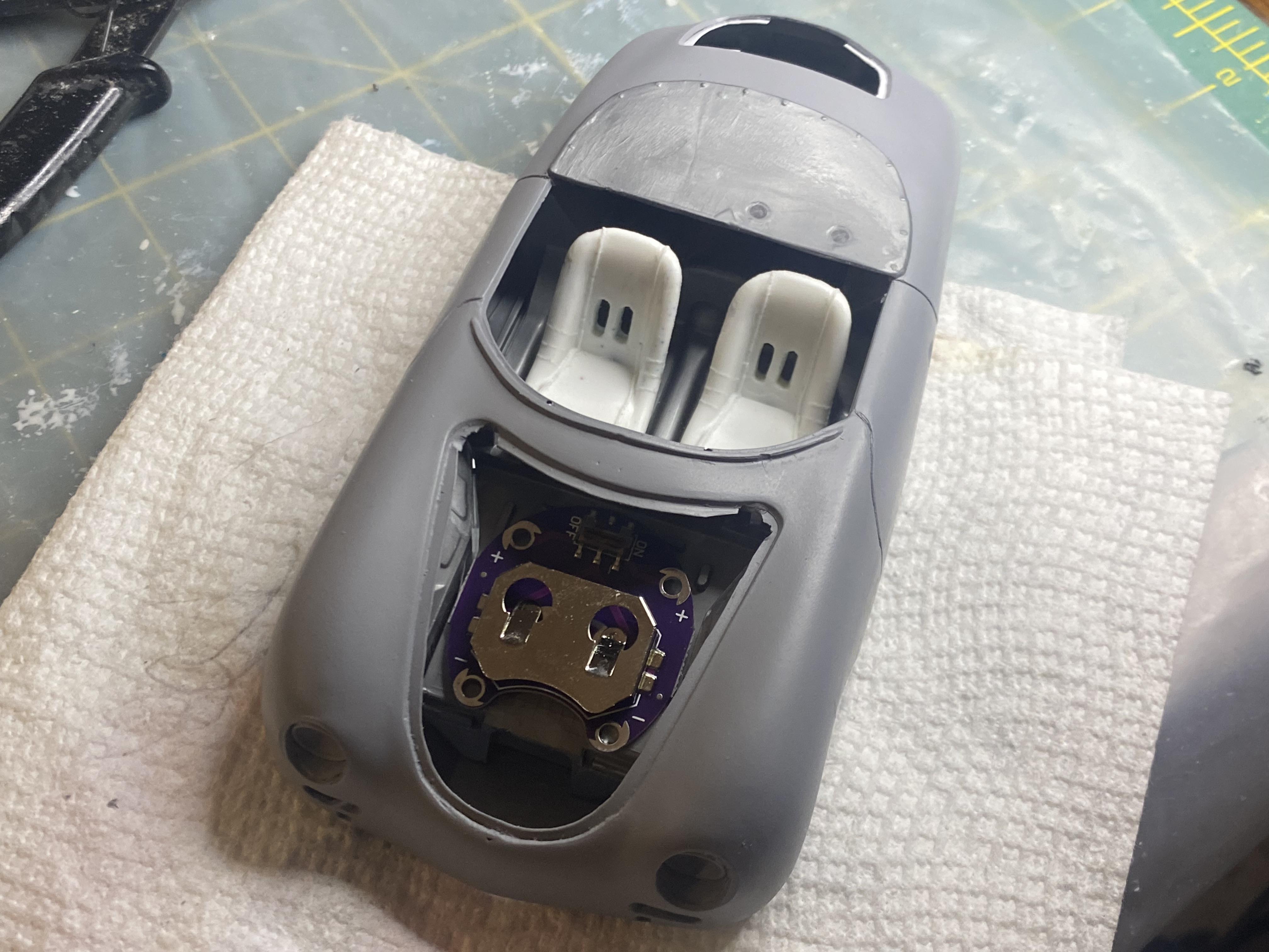

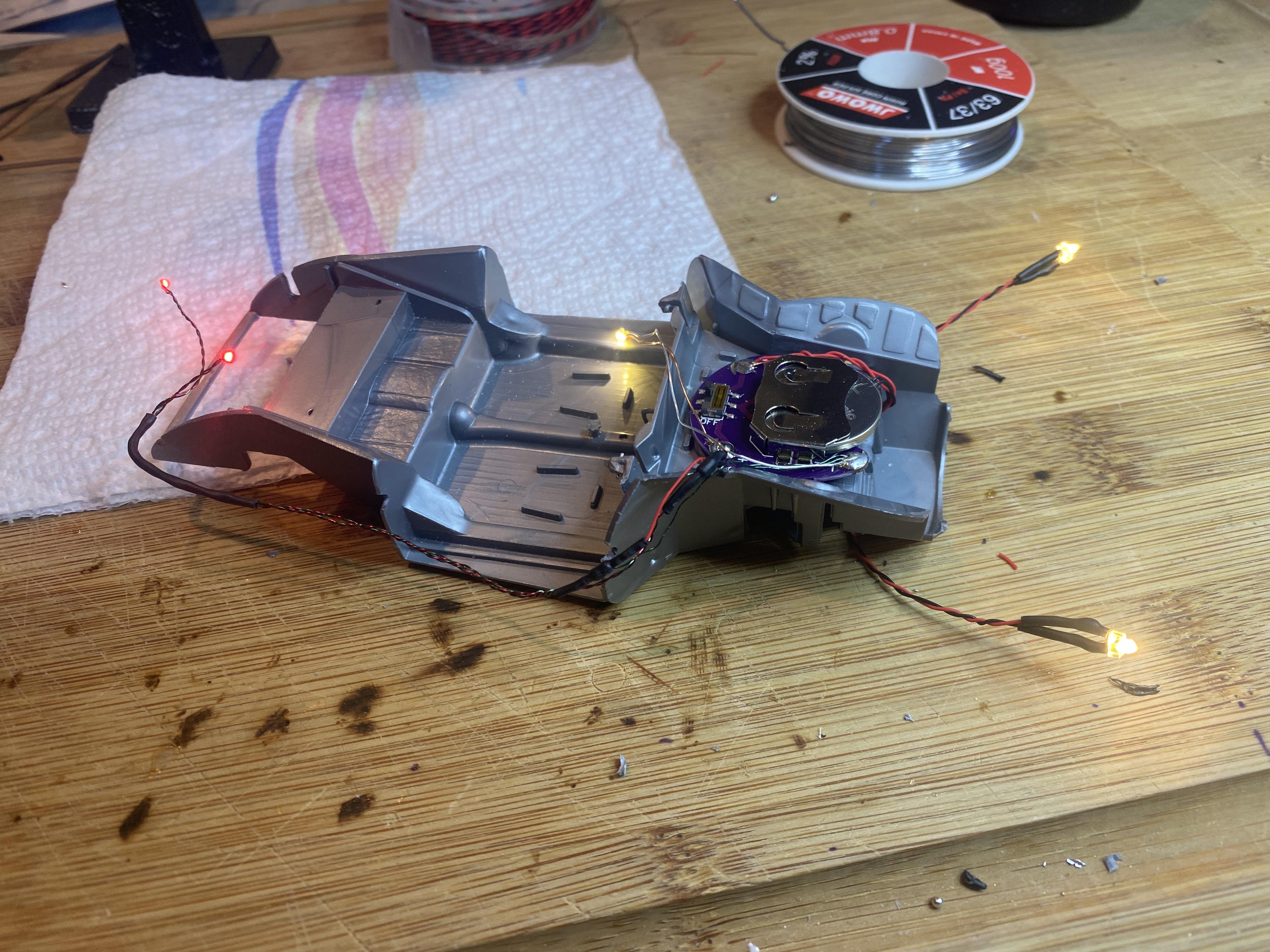

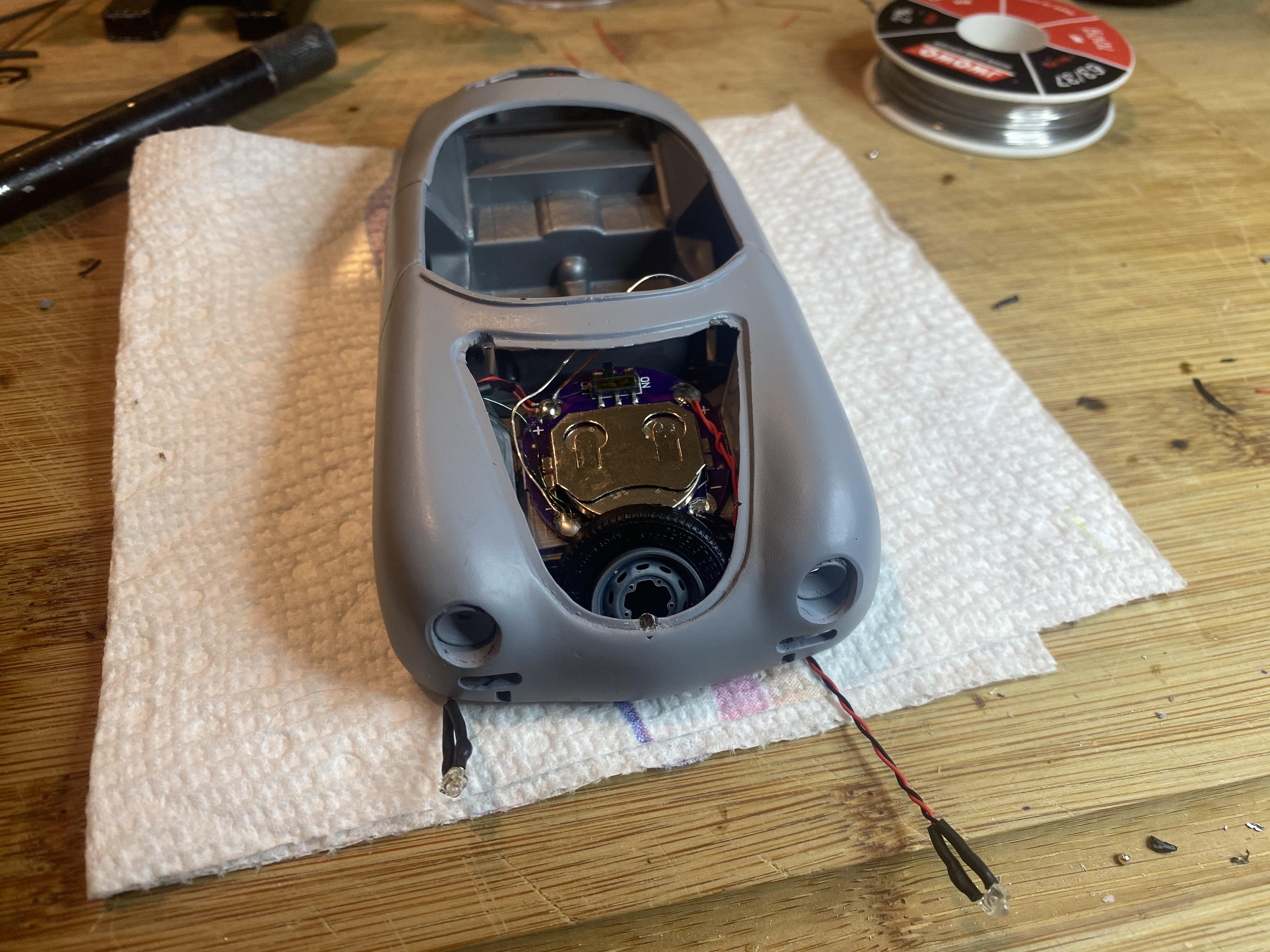

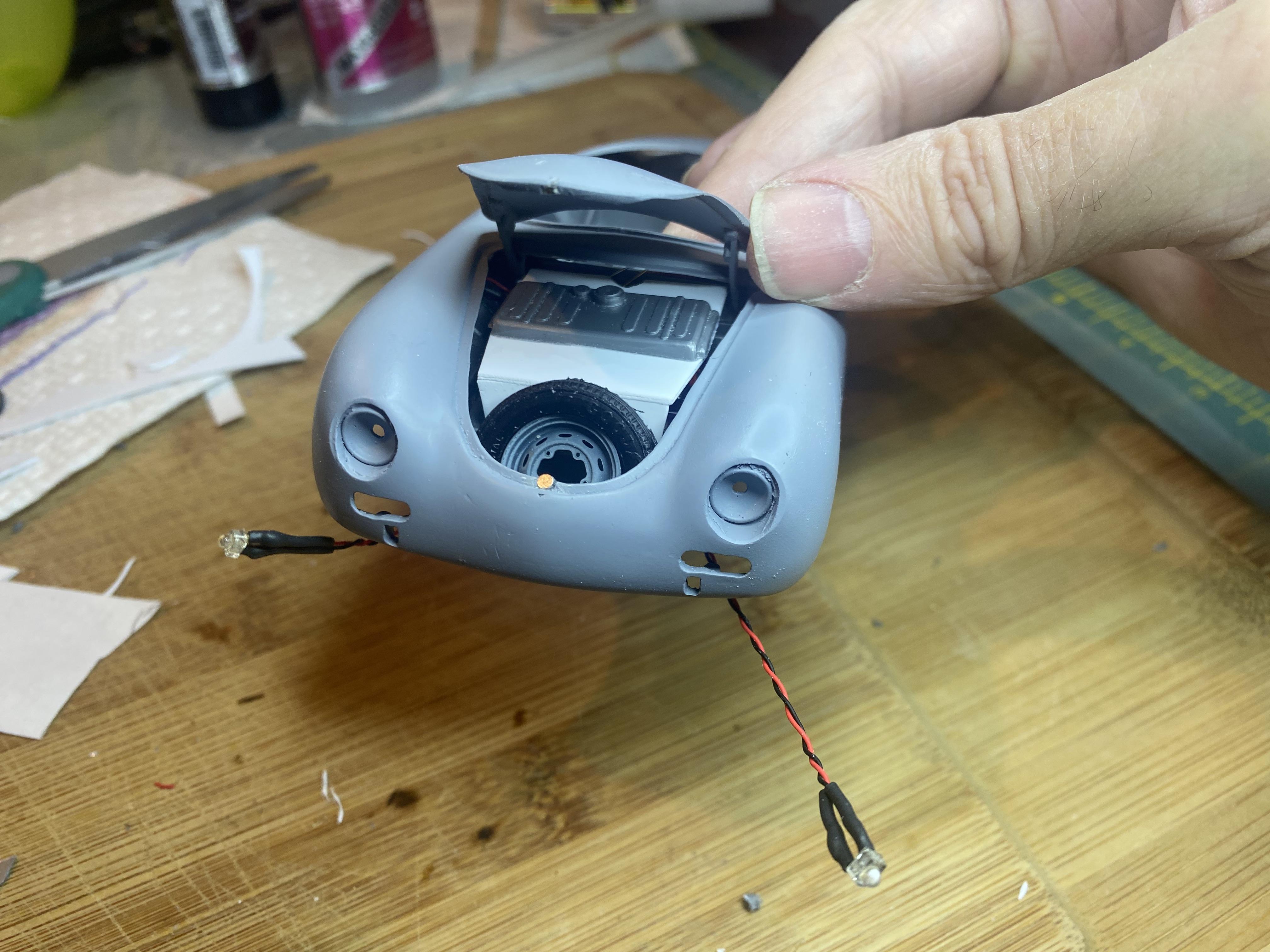

Duddly01 Posted December 30, 2024 Author Posted December 30, 2024 I created and test fit the LED wiring harness. I then created a trunk panel and spare to hide the battery holder. Then I scratch made the rear view mirror. Getting close to finishing fabrication and about ready to move to paint and body. I also drilled out the lug nuts in the rims to add hex rivet lug nut details to the wheels much like I did for the 1967 Mustang Convertible. I really am beginning to doubt this is going to be recognizable as a revell speedster kit any more. 2
Ace-Garageguy Posted December 31, 2024 Posted December 31, 2024 Significant improvement in overall shape and lines, definitely. 1
Straightliner59 Posted December 31, 2024 Posted December 31, 2024 What an excellent job of fixing this thing Love the steering components you built! 1
Duddly01 Posted December 31, 2024 Author Posted December 31, 2024 3 hours ago, drodg said: Impressive Thank You! 3 hours ago, Ace-Garageguy said: Significant improvement in overall shape and lines, definitely. Thank You! It was a lot of work to get looking right. Boiling the back section to reshape could have gone so wrong fast but I think I got lucky. 2 hours ago, Straightliner59 said: What an excellent job of fixing this thing Love the steering components you built! Thank You! I really wanted to add poseable steering considering all the work I had to do anyway.
