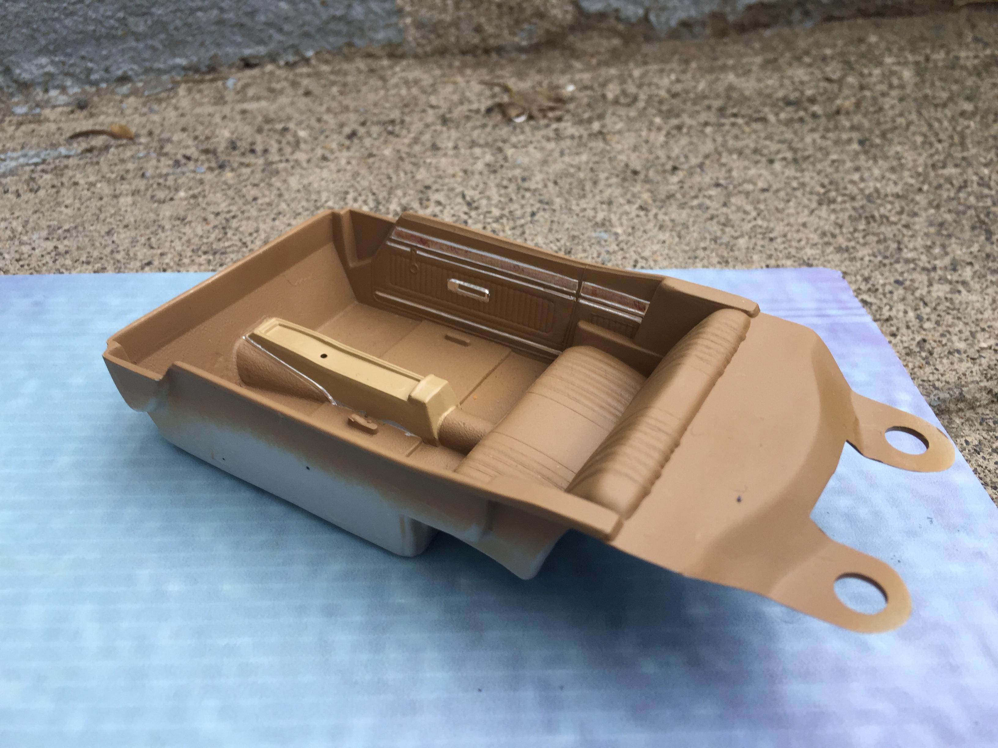

kelson Posted December 25, 2024 Posted December 25, 2024 Hey everyone back on the bench,haven't built anything Mopar in a long time,decided to build a Coronet R/T using a old transkit from PSF Hobbies.But had problems right from the start,the transkit had 2 scoops for the passenger side,😡luckily i bought 2 and the other was okay. However the scoops were way to large!rather than give up i cut the scoops into sections then sanded them down and reglued them. Have the chassis semi complete 3

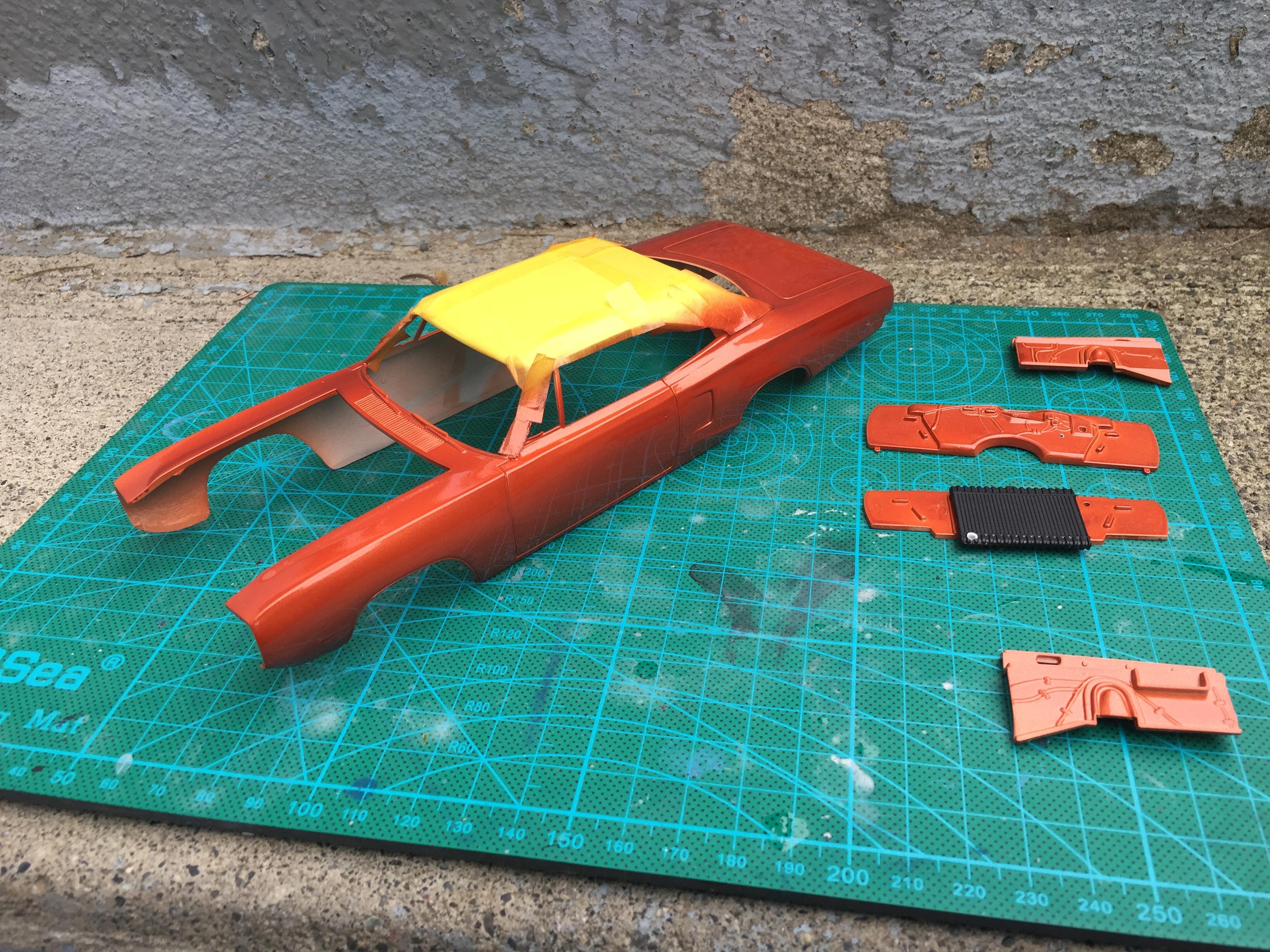

kelson Posted December 25, 2024 Author Posted December 25, 2024 Part 2,the body is painted k5 deep burnt orange from Scalefinishes,adding a vinyl roof to. Going with a tan interior,doing the bmf/woodgrain was tough,i covered the area with bmf first ,then applied some light sand as a base for the woodgrain decals,i used the same technique on the console and shifter and the dashboard,thats it for now. 4
Steamboat Posted December 25, 2024 Posted December 25, 2024 I built this a long time ago when it first came out. Be sure to test fit the engine to hood clearance. I could not get the air cleaner to fit. It might have just been me. IDK if they fixed the issue or not on later versions. 1

kelson Posted December 31, 2024 Author Posted December 31, 2024 7 hours ago, slusher said: Curtis, May I ask how you do your wood grain? I use an old decal sheet from Detail Master,you just paint a light color for a base and lay the decal overtop.I don't have the skill to do it by hand. 1
