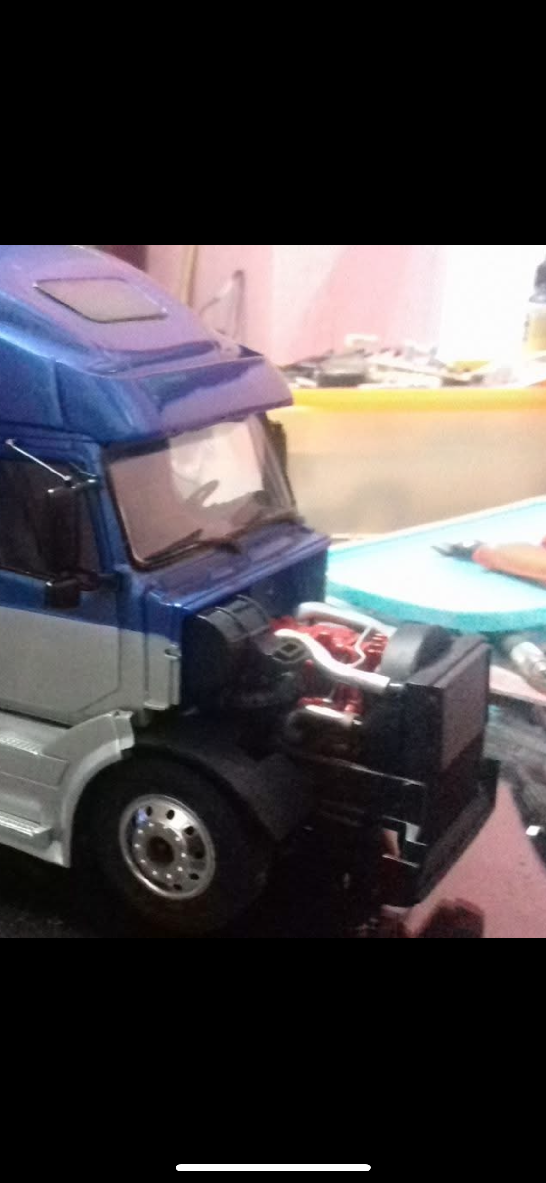

I’ve seen a few guys on FB put an engine in it, and I’ve got plans to eventually do it myself.
Depending on the extent of detail and accuracy you’re after, hinging the hood, cutting out lower engine portion that’s molded into the chassis, and installing an engine is your basic job.
If you’re wanting to go further, you’d need to scratch build the air intake system (I plan to use a modified  under hood cleaner from an Ltl 9000) along with the duct work on the underside of the hood, and modifying the firewall to fit the engine and to look more realistic. Other under-hood components, like coolant and washer reservoirs, steering shaft, etc, could be added as well.
For the engine choice, a widely-available Italeri Detroit Series 60 would be a good choice for the 2004 model the kit represents. An A&N resin Cummins ISX 15 would also be a good choice for the next few model years. For a late model, A&N also has a Volvo D13TC engine, and that would work if the truck is from the 2017 model year. Though, the VNL’s from 2015-17 had a slightly different bumper, updated mirrors, and fairings. In 2018, the VNL was updated quite a lot, beyond what the kit can easily represent.IMG_9617.jpeg.ff7b32fc12534c6dae258f5c12715e58.jpegIMG_9616.jpeg.31bcccfbe636974642e02b861c629f8e.jpegIMG_9615.jpeg.c86bd1012827f5ae56adba07beeed6ec.jpegIMG_9614.jpeg.2630228c097024cddf66aef30d205b0d.jpegIMG_0090.thumb.png.1fbb67d482cfa30e23e70d7c495c3282.png
