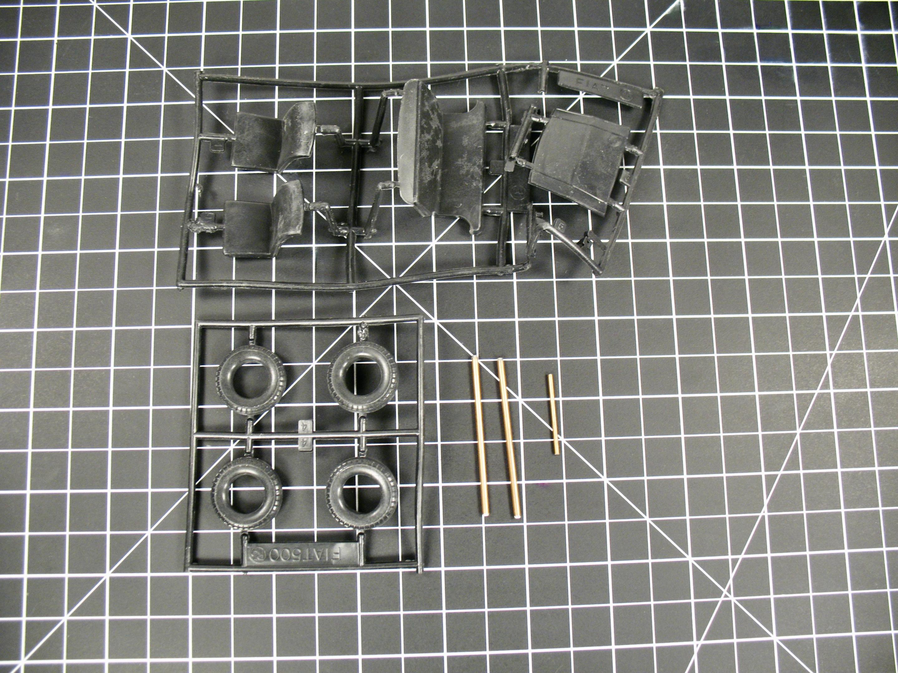

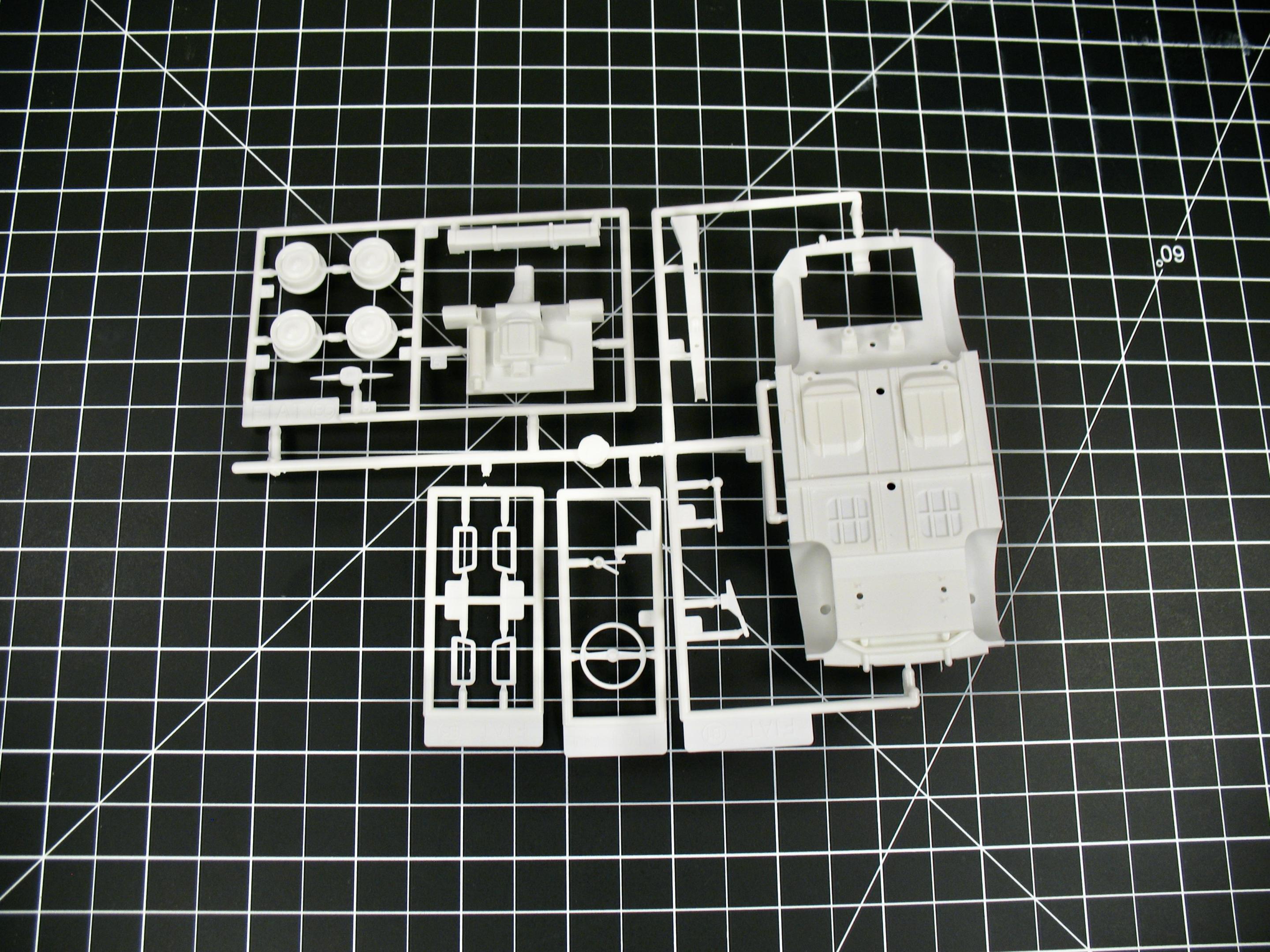

The kit over all, keeping in mind that came out in 1985, is pretty good and almost not flashing around the casting. I'm not a big fan of the seats that are casted in rubber like the tires and rag top. Another thing that I notice, is the hood on the rear, where the motor is. It is pre cut in some area, making me wonder if they were thinking to add a motor to the kit and after decided not to.

Some of the Gunze (Mr Hobby) kits were made as semi-curbside, as well as full detail kits with many common parts. It’s like that on their E-Type and Lotus Elan kits.

Thanks Sonny! I wonder if in some kits they were planning to offer it as a full kit. I mean they put so much details in some parts and lack on others. Maybe they were trying to keep a certain price. I'm probably going to add few things on mine. :)

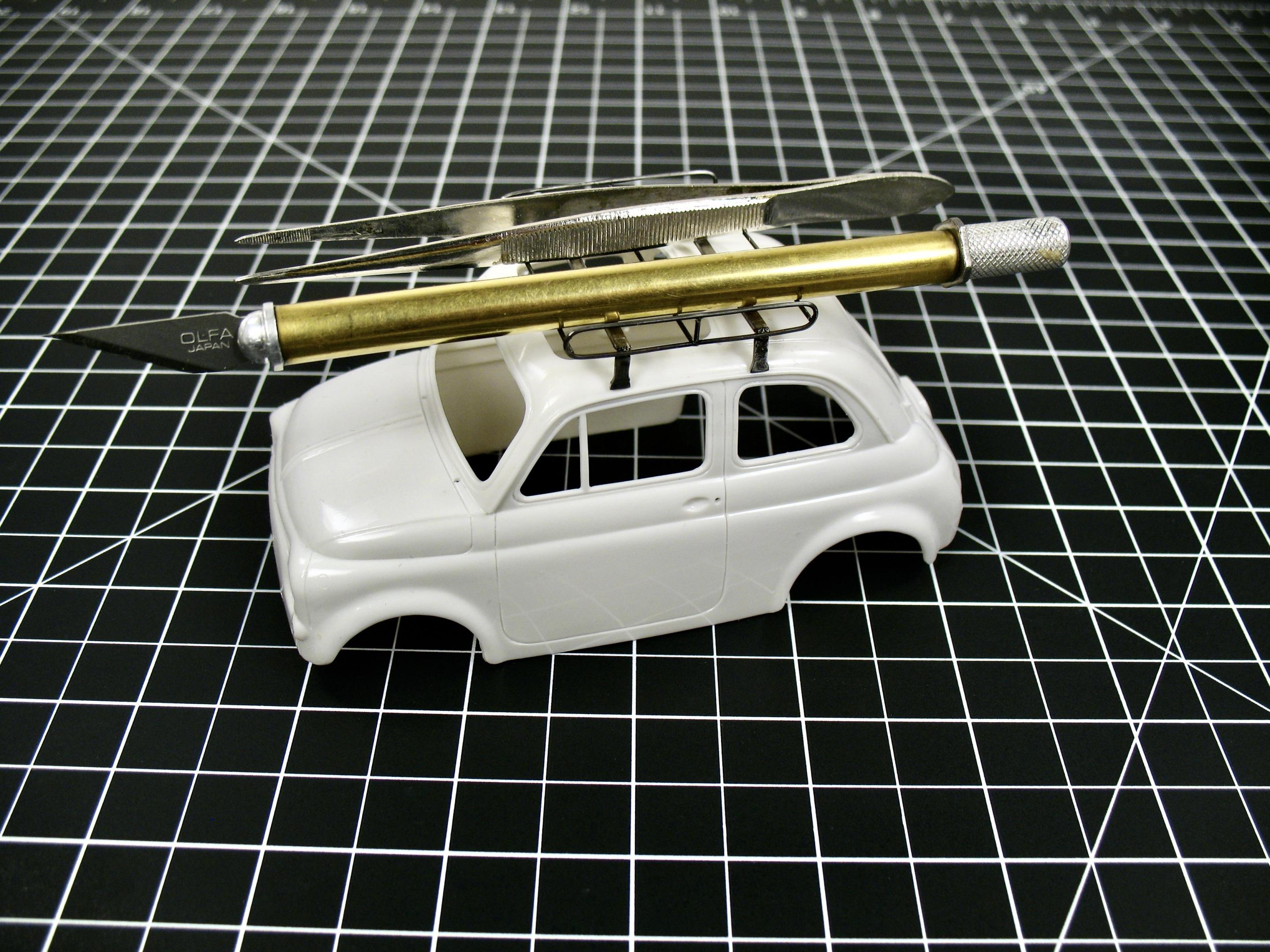

Made a metal roof rack for the Fiat 500. I always wanted to do it, and finally did it. I remember seen different 500's with a roof rack, with all sort of items on it, but mostly of the time they were empty.
Here a raw version of the roof rack. I will add details for the clamp later.

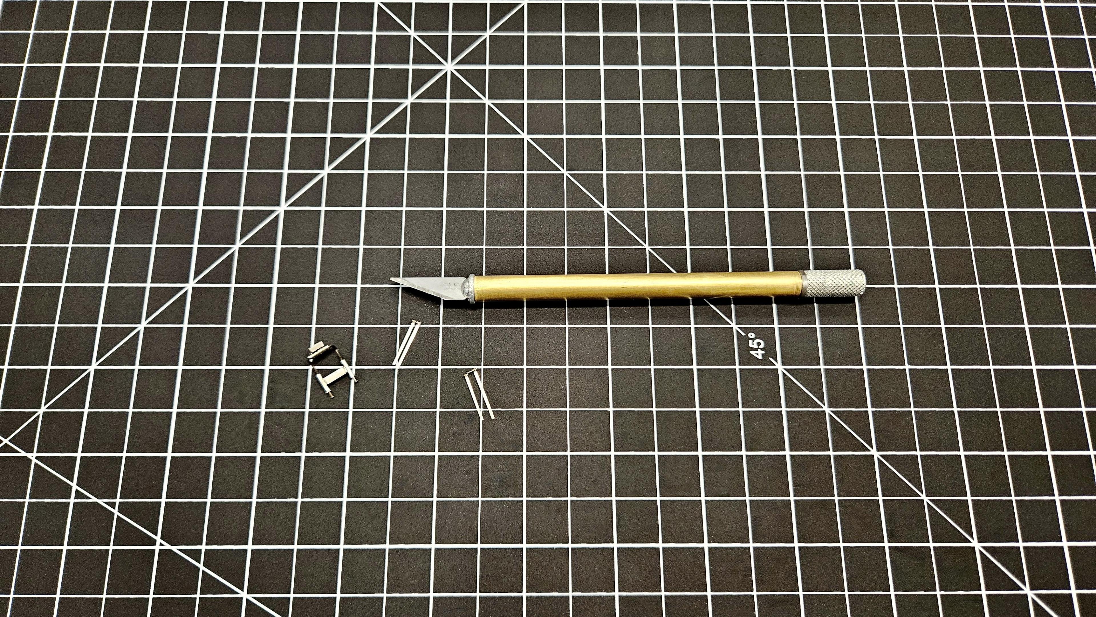

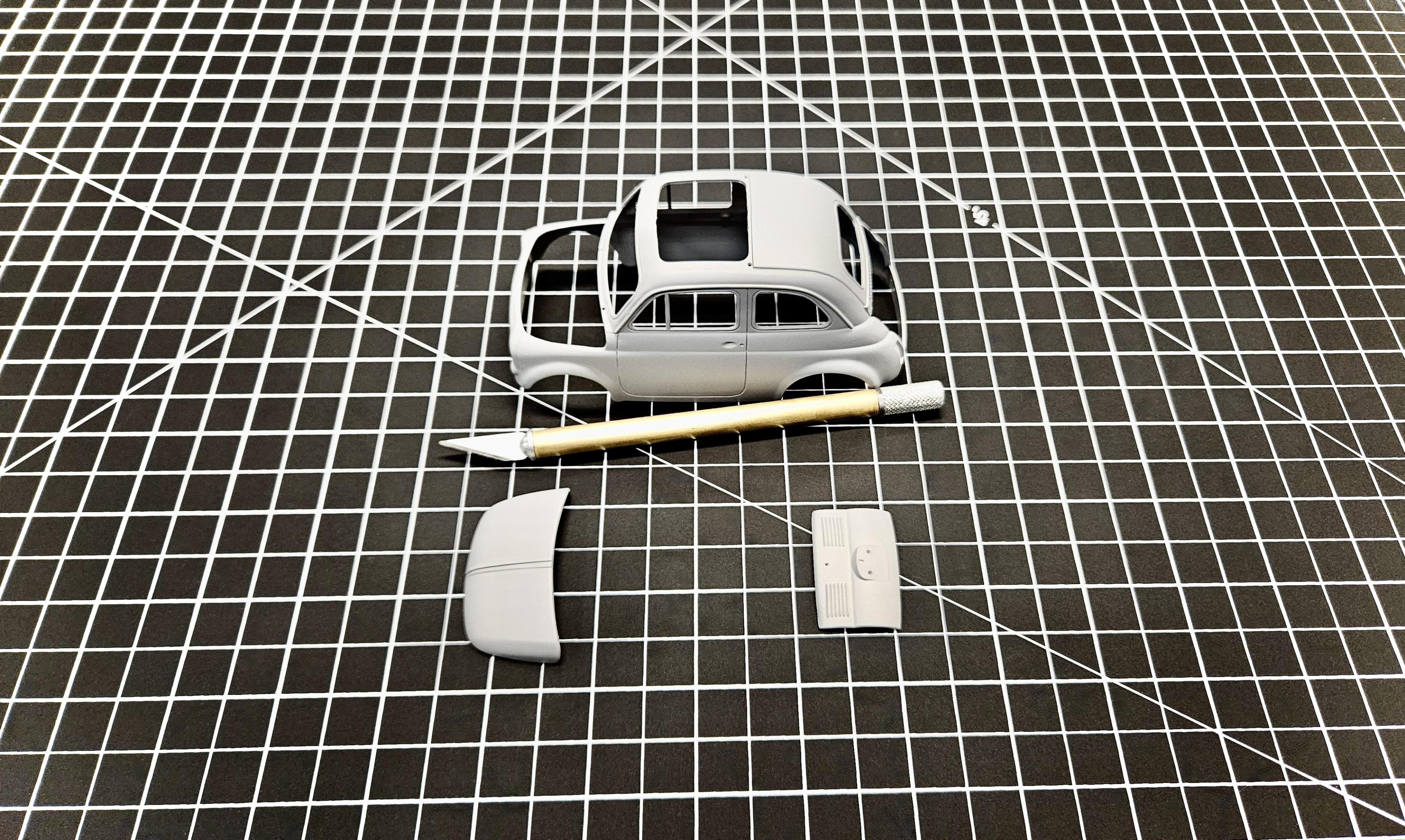

Some update on the Fiat 500! Made some metal hinges for teh front and rear hood. On the left is the one for the front, and right the two for the rear. The one for the rear I will cut and bend them in a "L" shape.

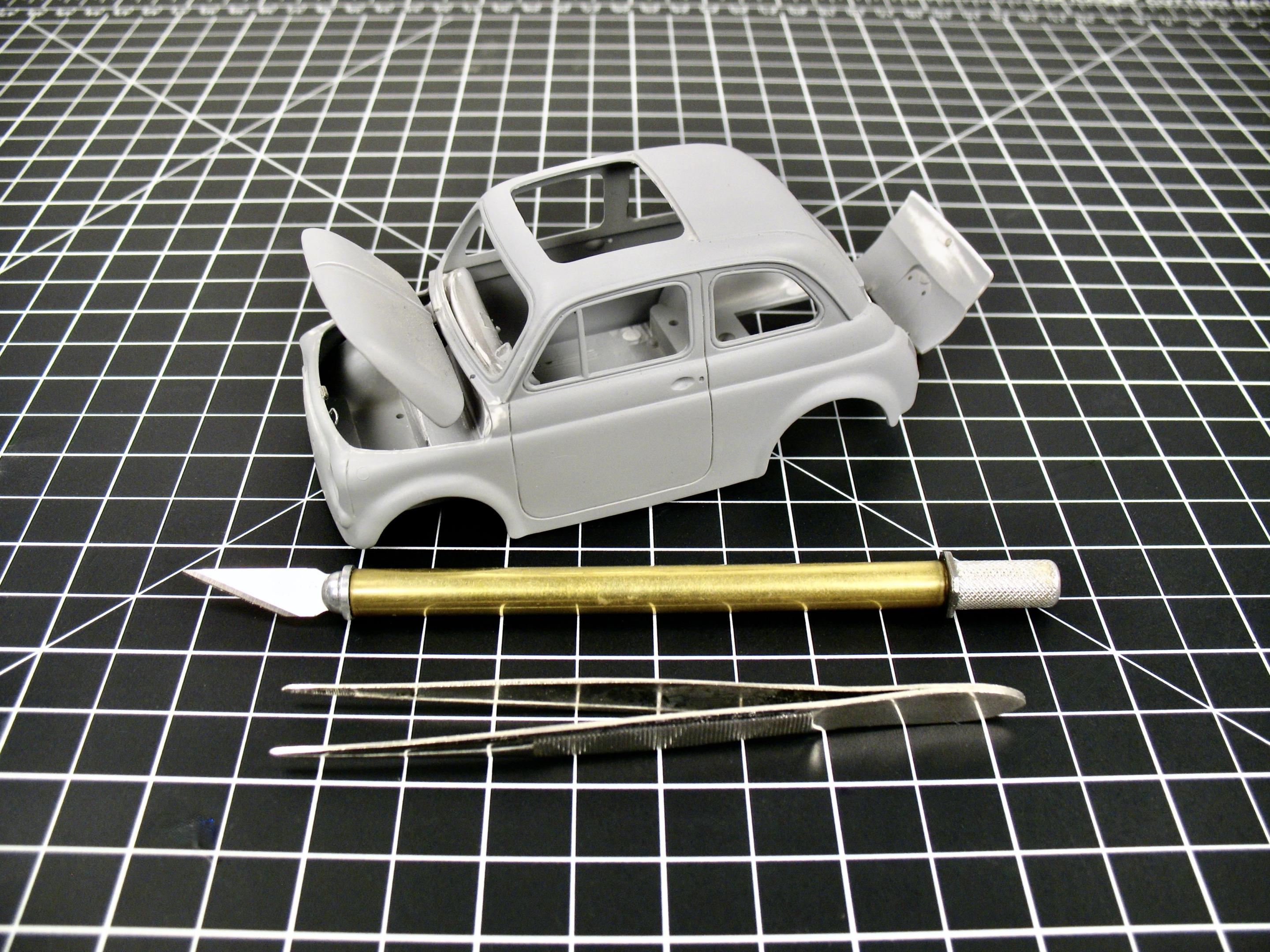

Front and rear hood cut from the body. Because the kit does not have engine for the rear, and gas tank and trunk bay for the front of the car, I will have to make some pieces...
  • Like 4
