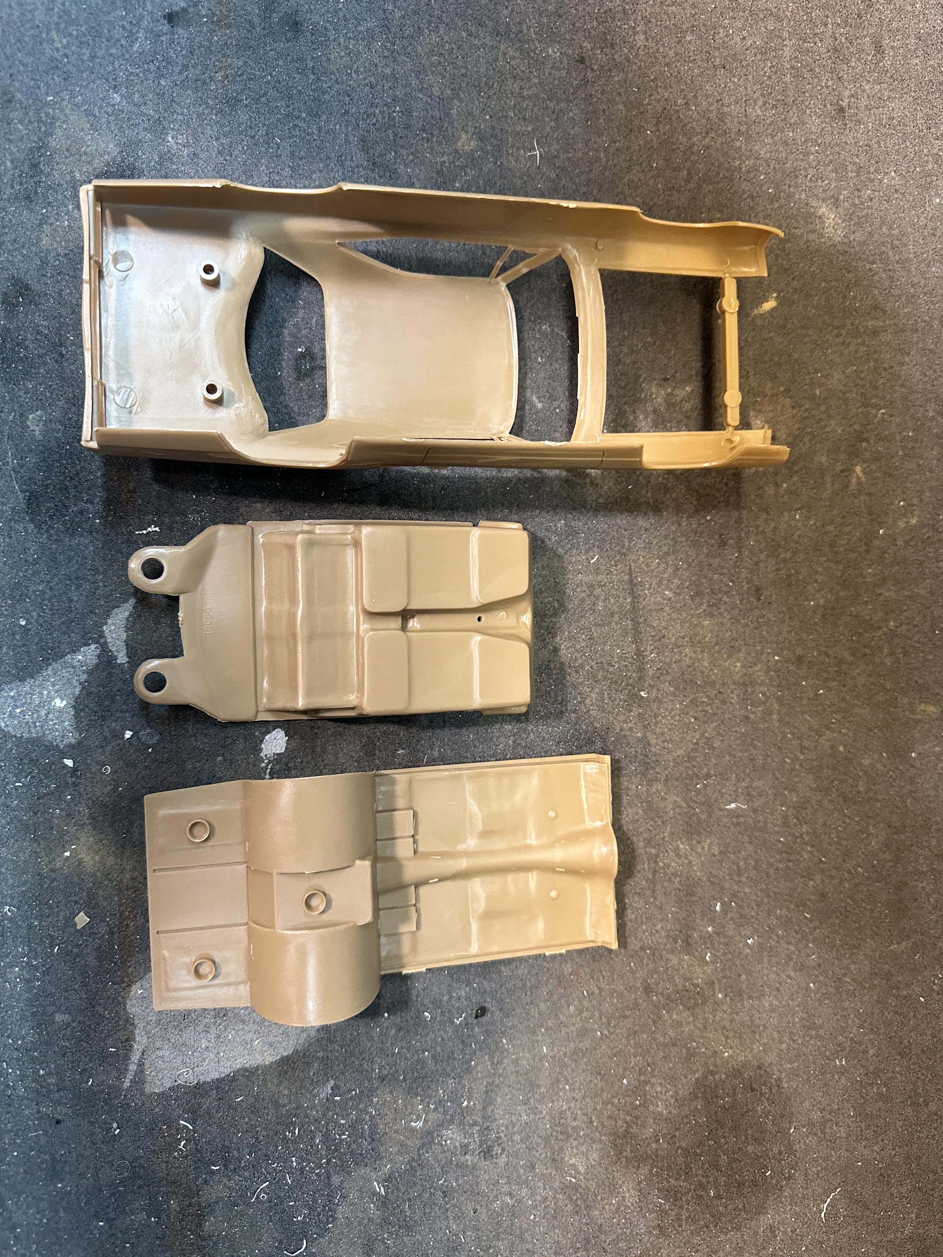

kymdlr Posted January 7 Share Posted January 7 This was a 70 superbee, initially I thought it was an AMT but due to the brown plastic I’m thinking a different manufacturer. I got it as a painted rebuilder. I’ve done plenty of glue bomb rebuilder kits before but this is a first . As usual , I soaked it between purple power and DOT3 for several days to remove the paint & glue build up. Upon removing it from the last soak in DOT3 and scrubbing the remaining paint off, the plastic basically disintegrated. I’ve done plenty of fixer uppers but this one is pretty much too far gone. Any idea what went wrong? Quote Link to comment Share on other sites More sharing options...
Ace-Garageguy Posted January 7 Share Posted January 7 Brake fluid occasionally makes old plastic brittle and crumbly. I'd guess that's what happened here. 1 Quote Link to comment Share on other sites More sharing options...
Mark Posted January 7 Share Posted January 7 Brown plastic would make it a first issue Pro Street version from the early Nineties. As for the brittle plastic, it may have been stripped and repainted already prior to your getting it. I've got a couple of car bodies with damage from multiple strip/repaint/strip jobs. One had all of the detail and crisp edges softened into mush, another is so brittle that the most gentle handling makes it crumble. 1 Quote Link to comment Share on other sites More sharing options...
Bainford Posted January 7 Share Posted January 7 Very interesting reaction. Out of curiosity, what brand and grade of brake fluid did you use? Quote Link to comment Share on other sites More sharing options...
peteski Posted January 7 Share Posted January 7 DOT3 brake fluid is glycol-based. Some hobby plastic-safe strippers are also glycol-based, but they are slightly different chemically. I have seen many examples of DOT3 brake fluid affecting polystyrene, especially after long duration immersion. I am not too surprised your model fell apart. Safer plastic-safe stripping alternatives are Lye (sodium hydroxide) based Those will not harm polystyrene, even after long exposure. Another one is 99% Isopropyl alcohol. Quote Link to comment Share on other sites More sharing options...

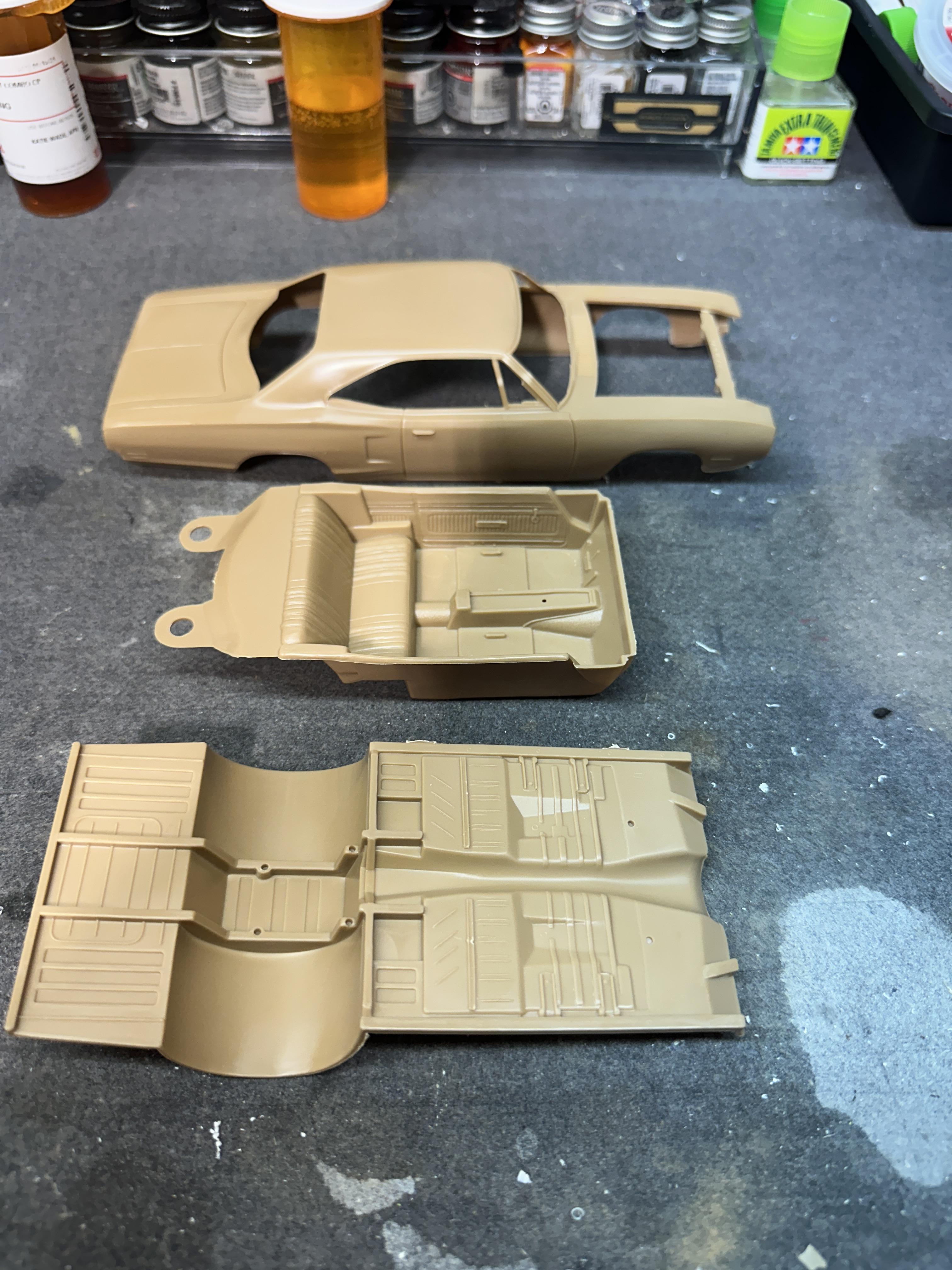

Keef Posted January 11 Share Posted January 11 Freshly opened kit just for pics. I’m leaning towards it being a resin repop as well. Quote Link to comment Share on other sites More sharing options...
