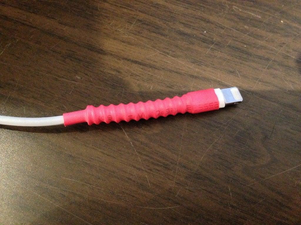

johnyrotten Posted January 10 Posted January 10 My wife used this for a phone charger repair, found it on reddit. Pen spring and heat shrink. Looks convincing 2
Ace-Garageguy Posted January 10 Posted January 10 Similar to the above ideas but different...decide what diameter wire would look right for the steering links coming out of the rack, drill the rack to accept about 3/16" of it, then wrap 1/4" inch or so that sticks out with appropriate wire, and put some heat-shrink tube over the whole thing. Look at photos of real steering racks to see the effect you need to achieve. AND...even though rack boot ridges aren't spirals like a wire-wrap will be, nobody but the most hardened nitpicker will ever notice. NOTE: Probably not wise to try heat-shrink on or close to kit plastic, ya know? 2
