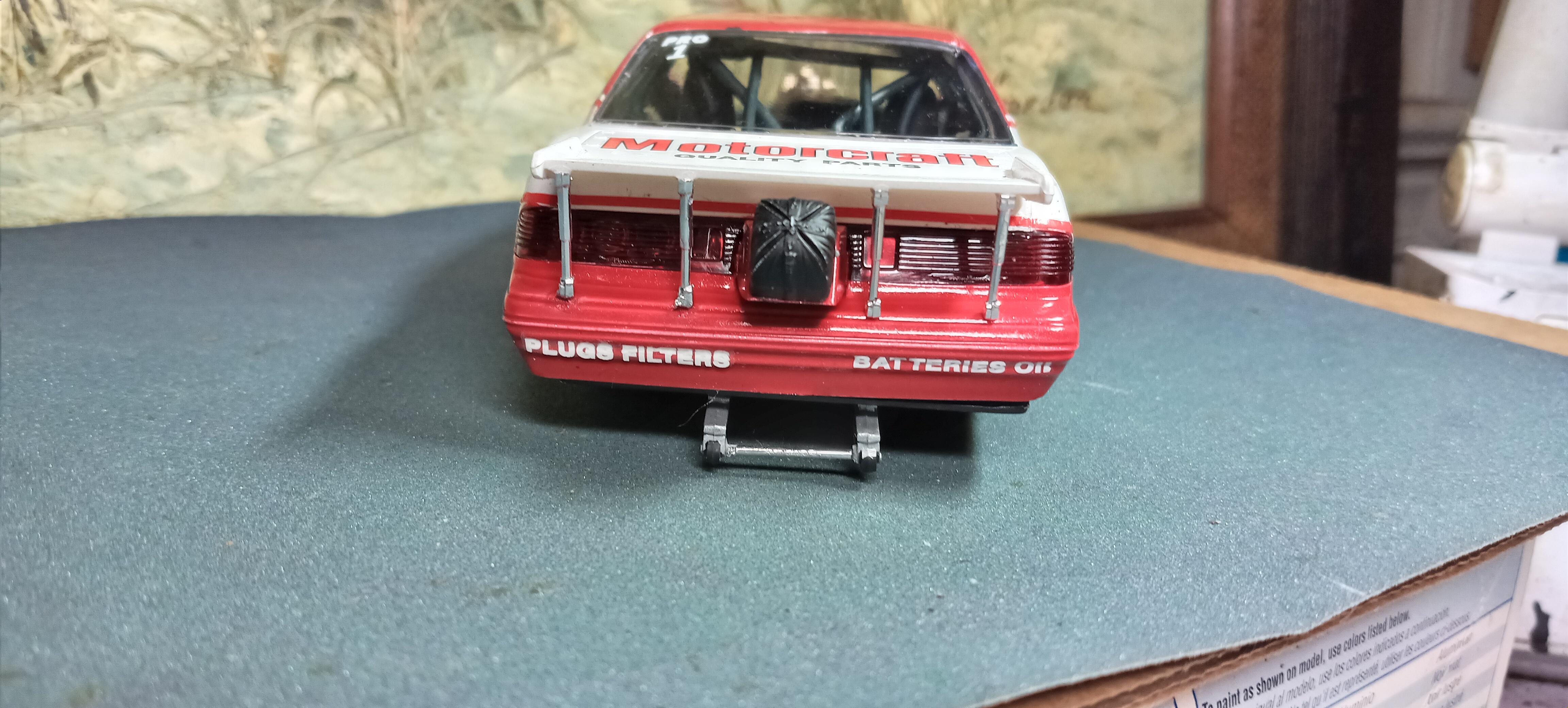

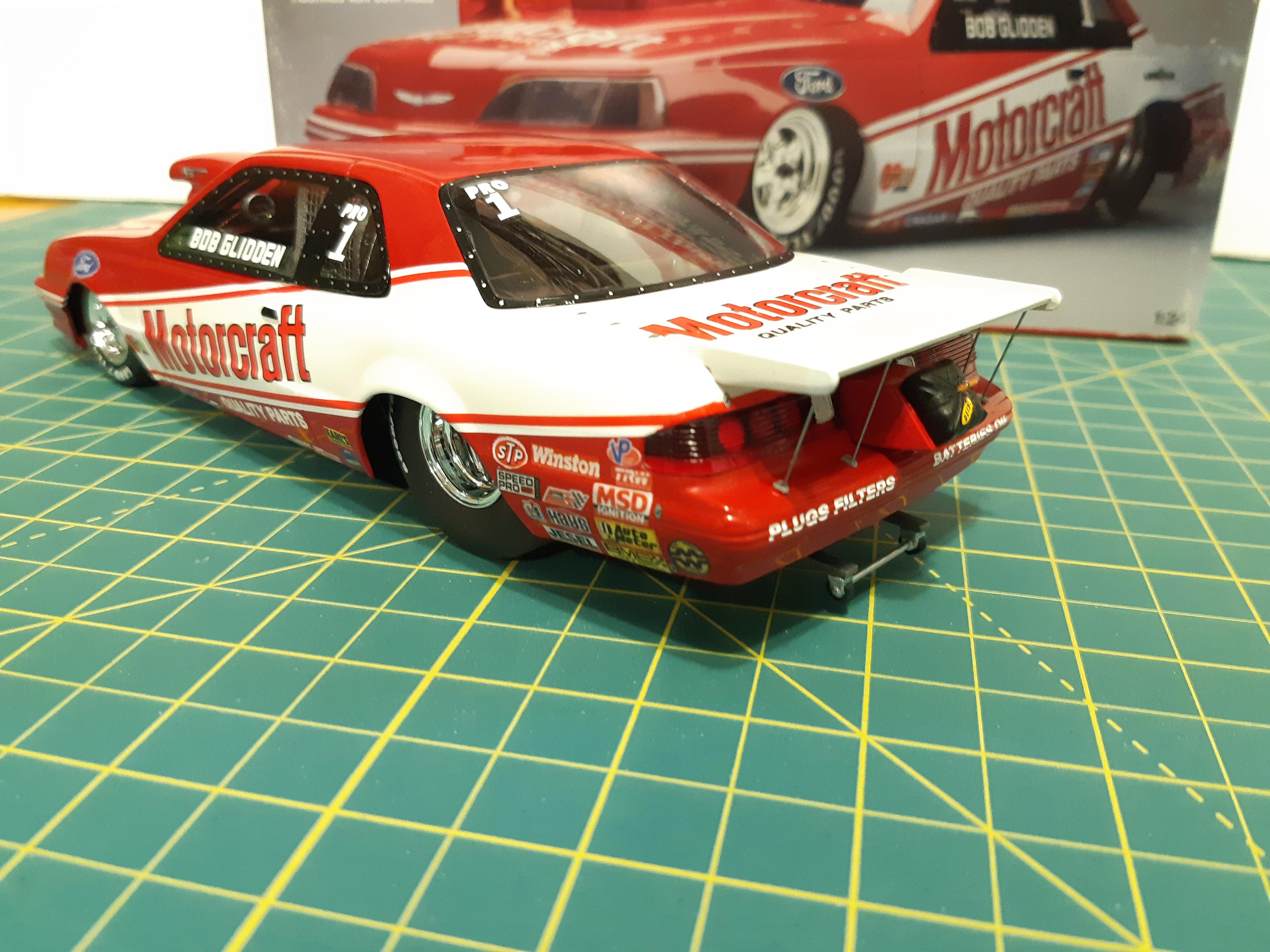

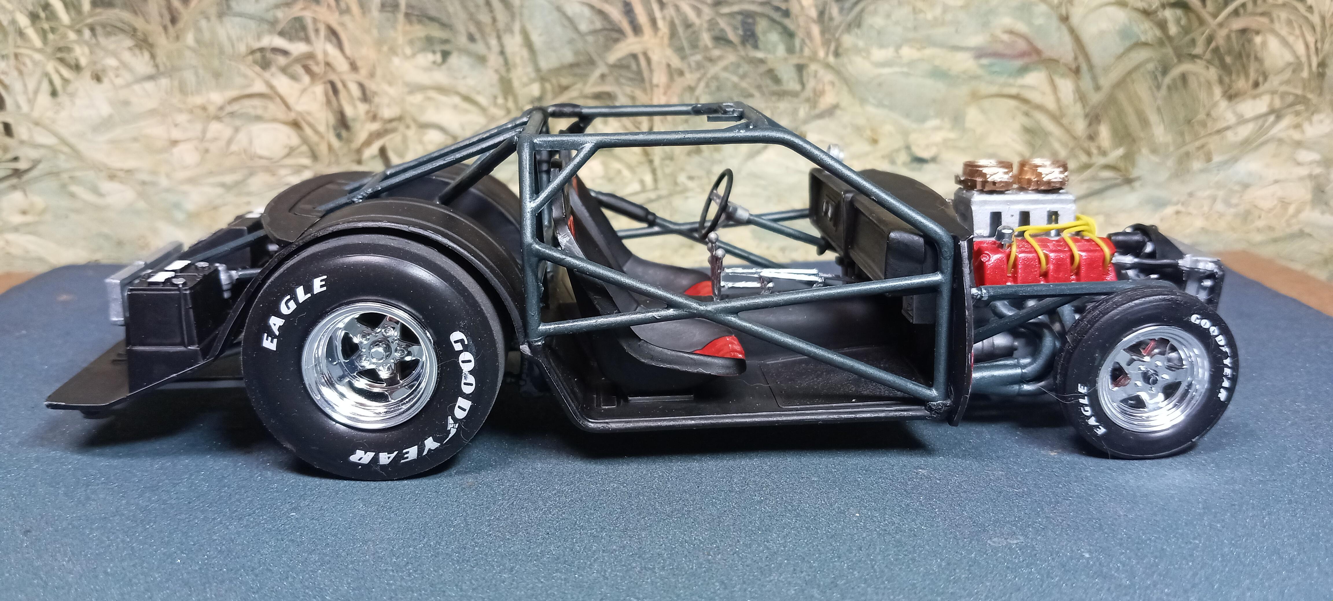

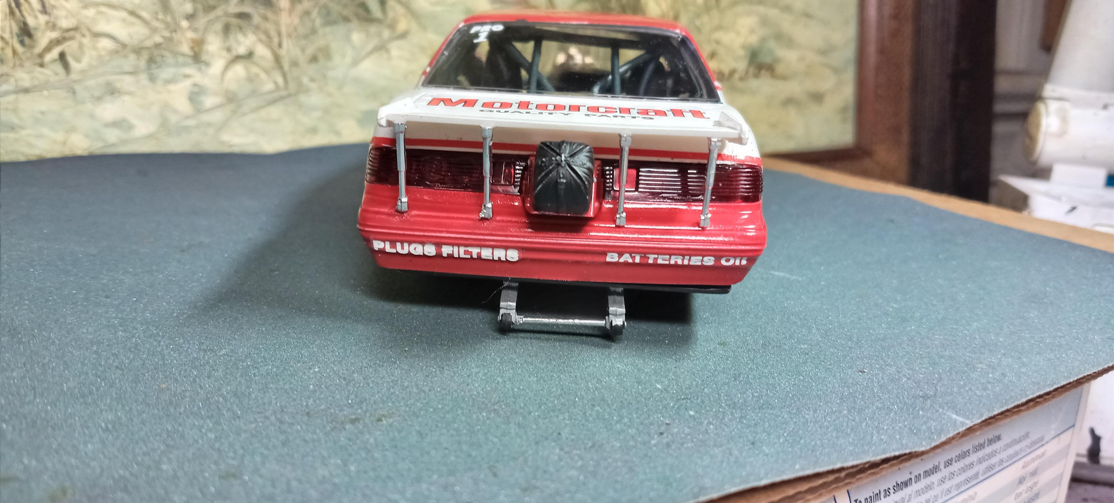

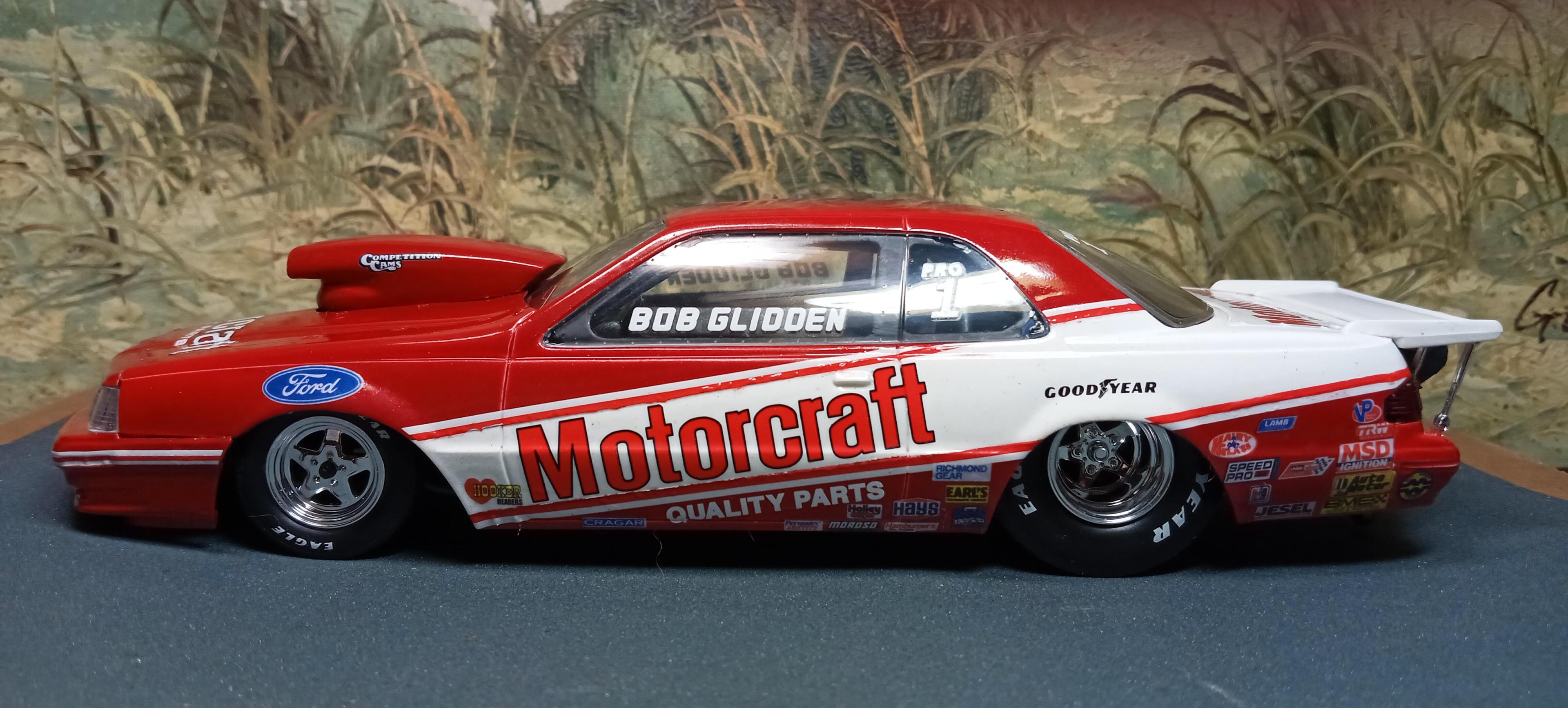

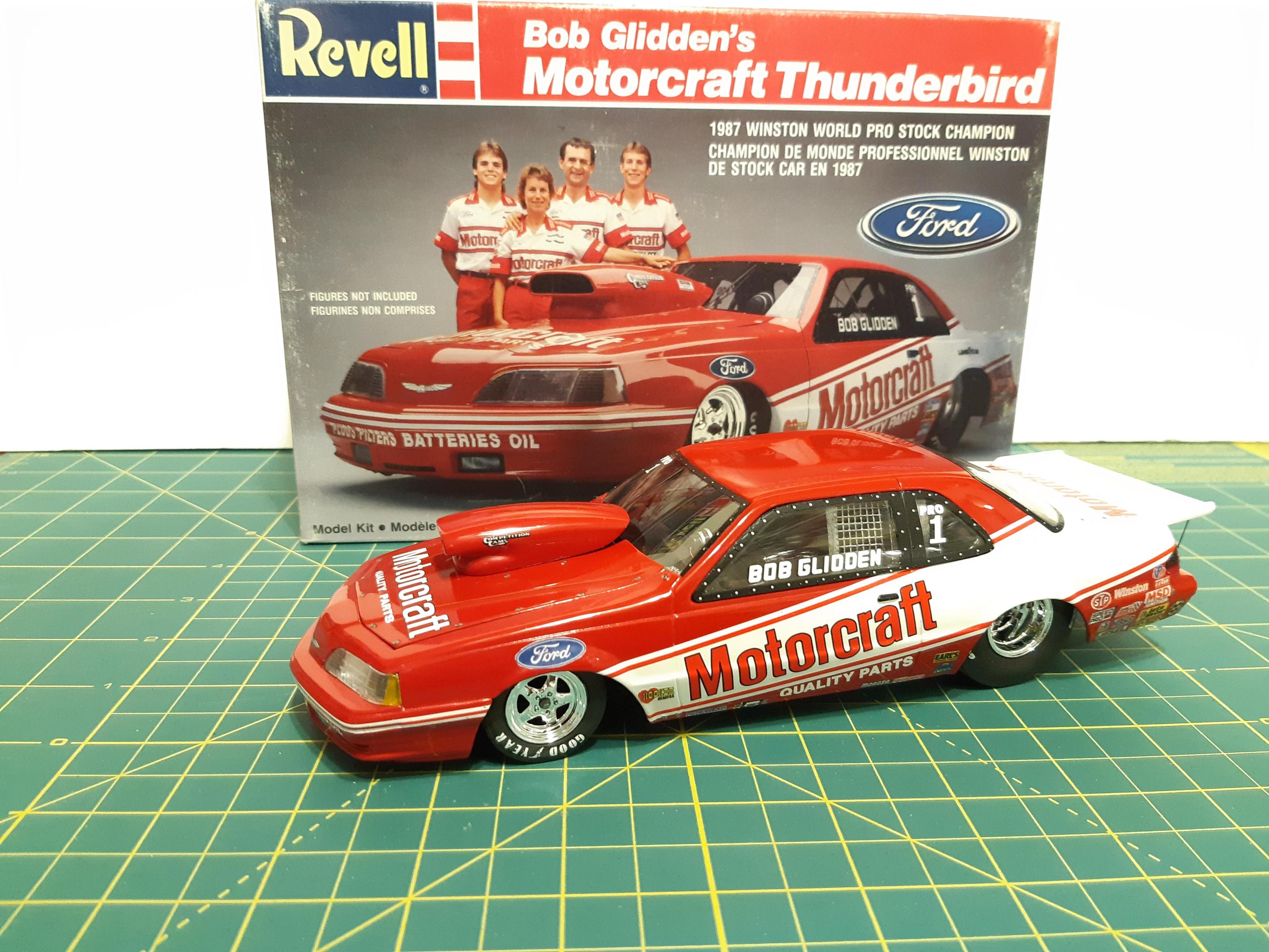

As usual i forget to take pictures of WIP, so this one goes straight into the done pile.

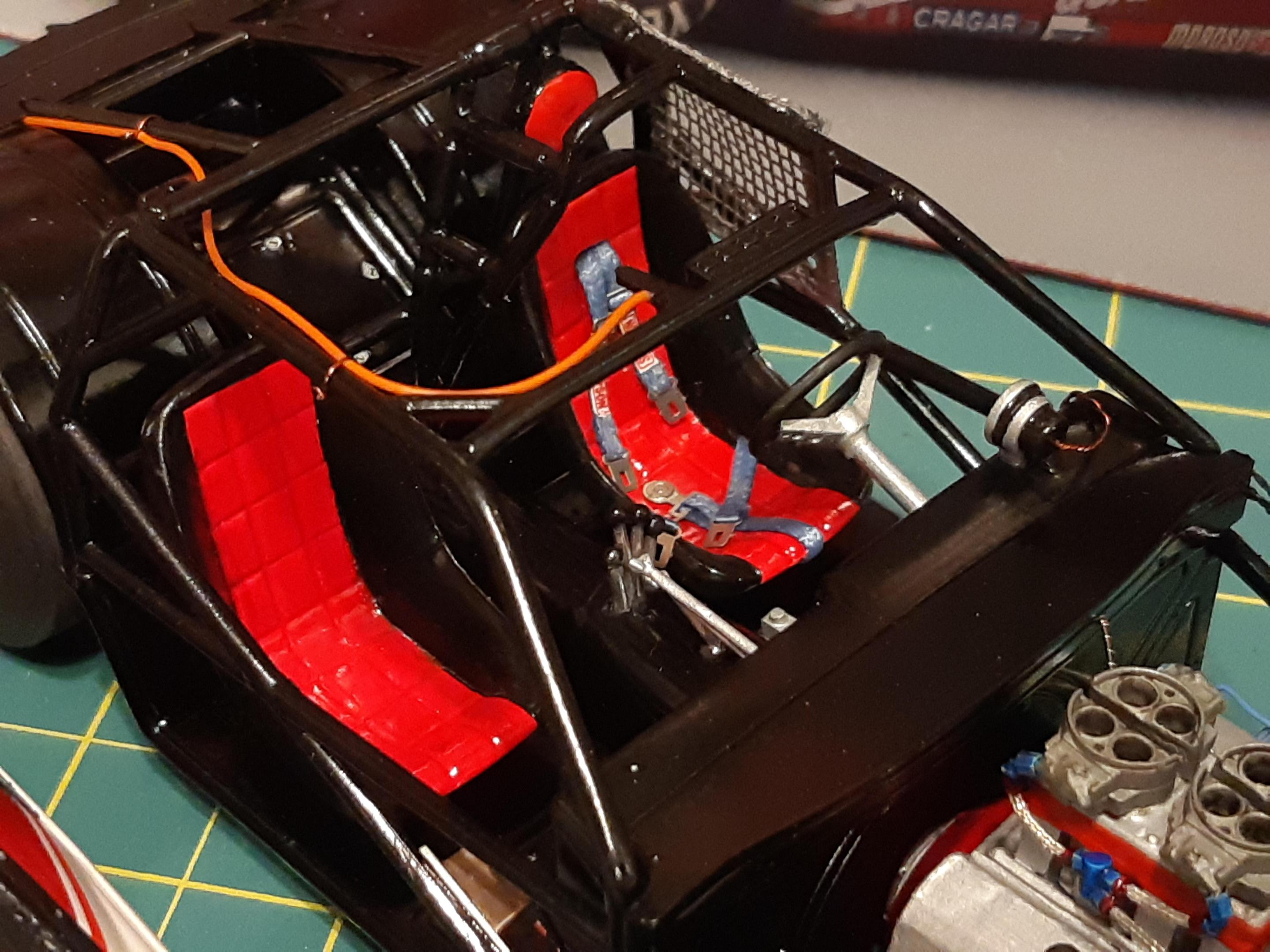

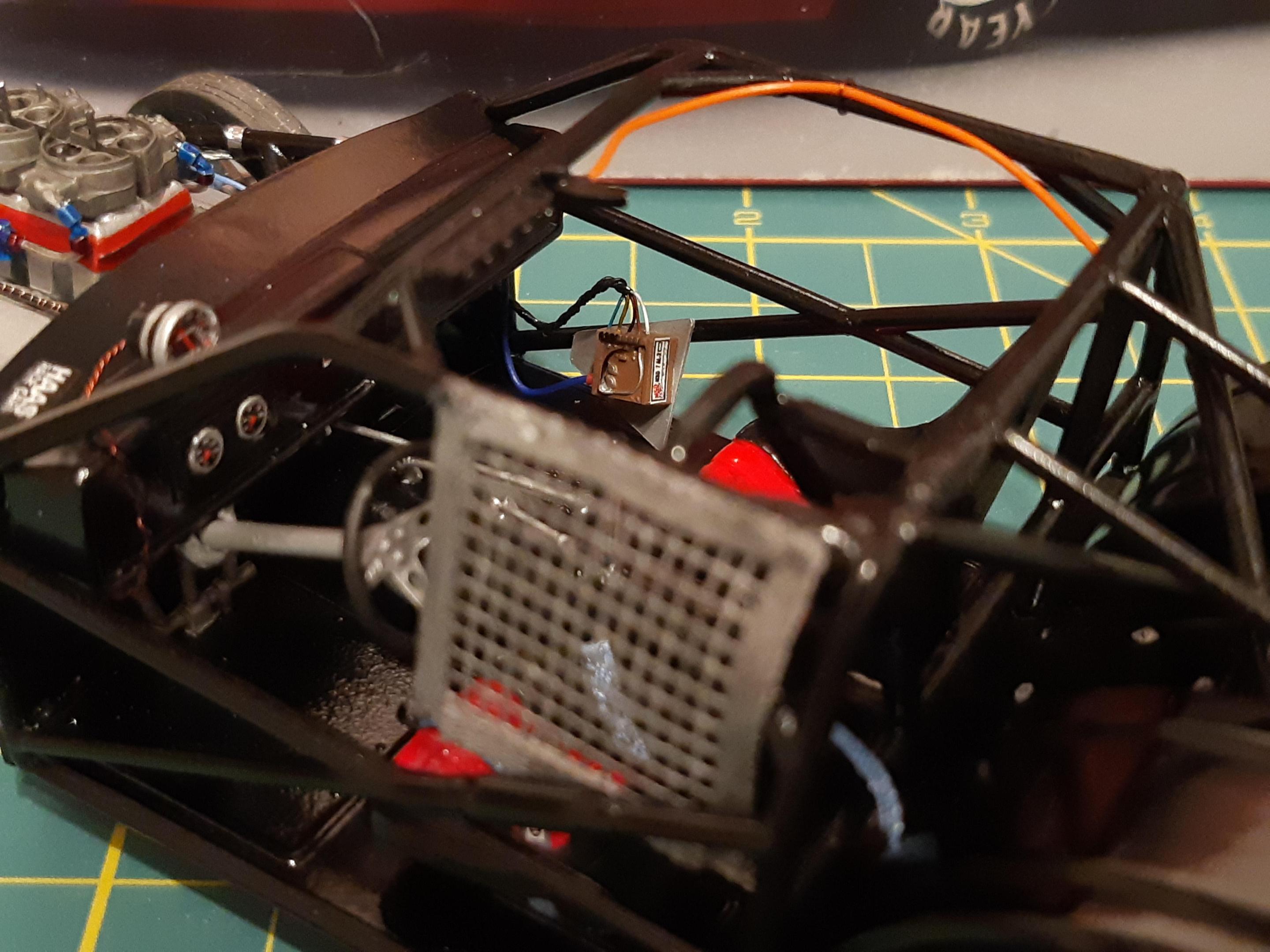

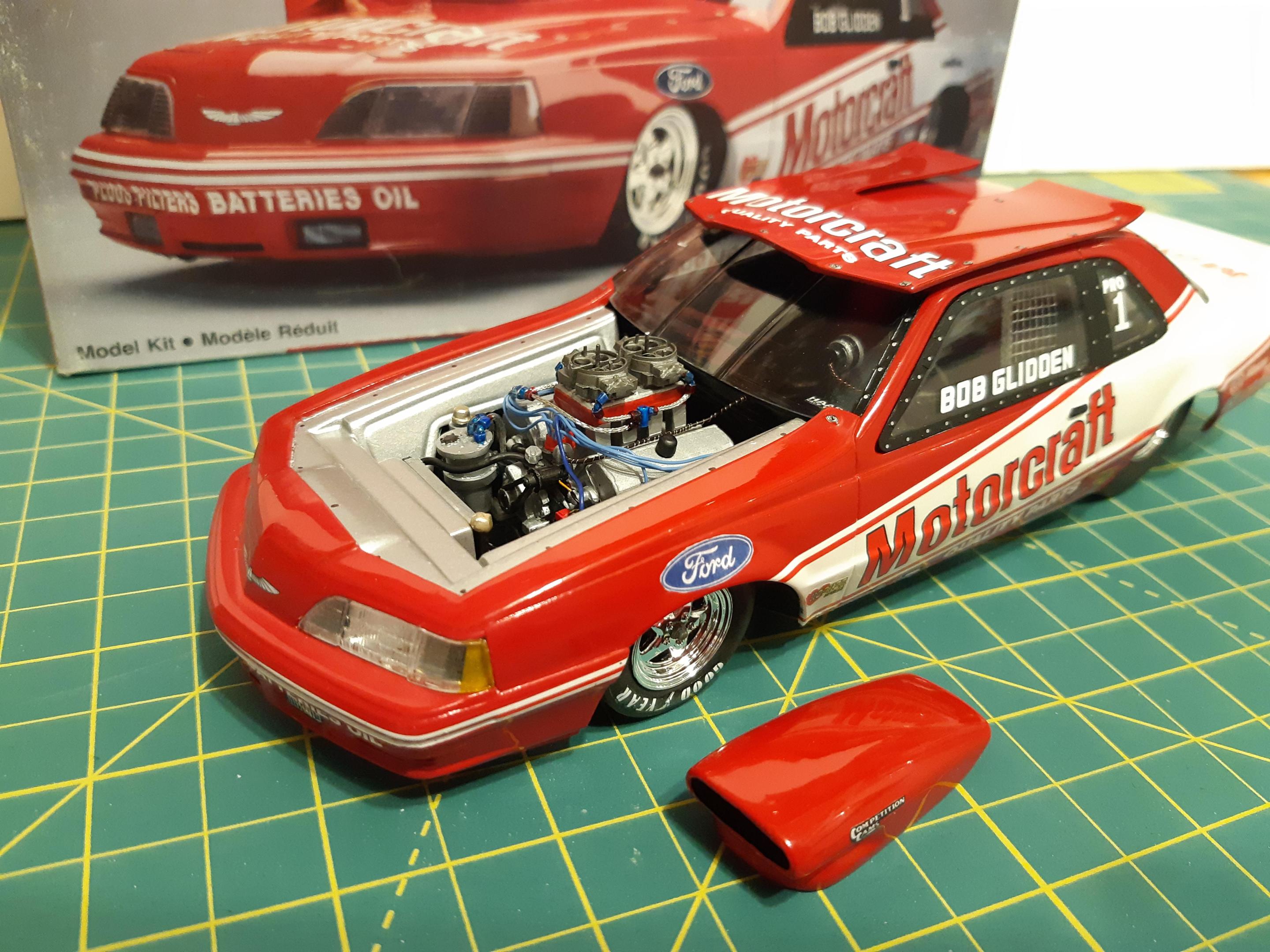

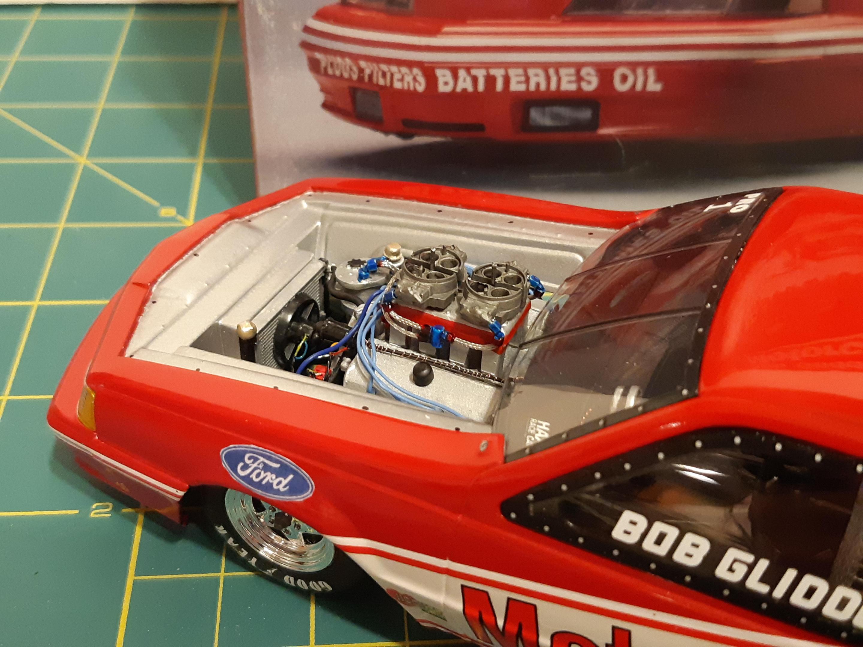

Lots of work to modify the original kit to more accurately represent Bob Gliddens T-bird.  I added the extra cage around the driver, cut off the head rests that said Don Hardy, since this car is a Jerry Haas prep'd unit.  I built the valve covers from sheet plastic to make them look like welded aluminum and split the 1150 dominators in 1/2 as his IHRA prepped car was equiped.  Made a few missing decals,  sanded down the tires really good, painted with duplicolor autostore paint, no clear, just polishing.  I used an original issue of the kit, but used the decals from the reissue from a few years back.  all wired and plumbed, used 11/0 seed beads for the fittings, reconfigured all the oil tanks and lines, added an electric fan, made new rad hoses, and generally changed alot of the engine bay to better represent the real car.  Scratch built some of the MSD parts, wired the MSD 7AL box in the interior, made a window net from fiberglass window screen and seatbelt ribbon.

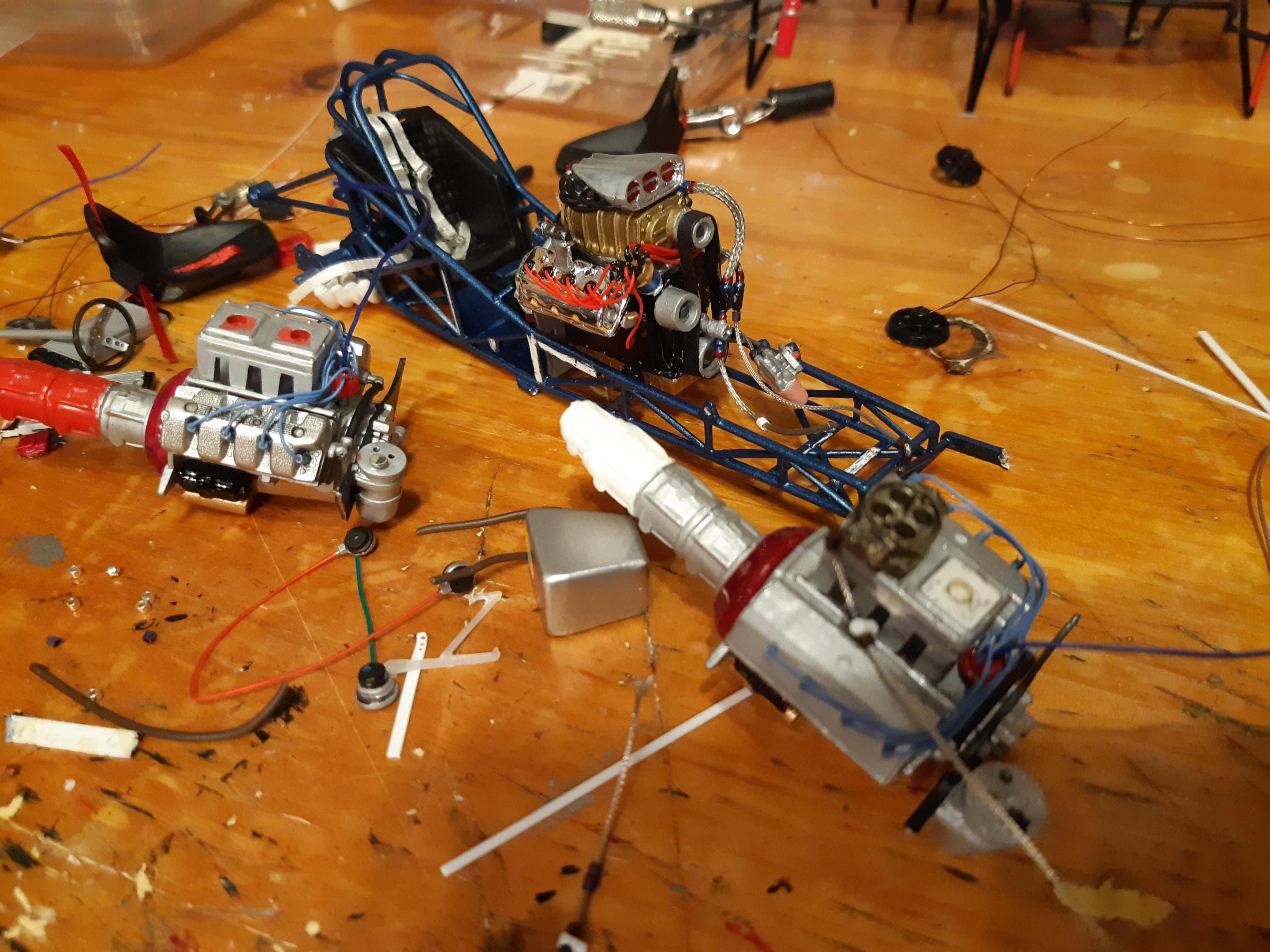

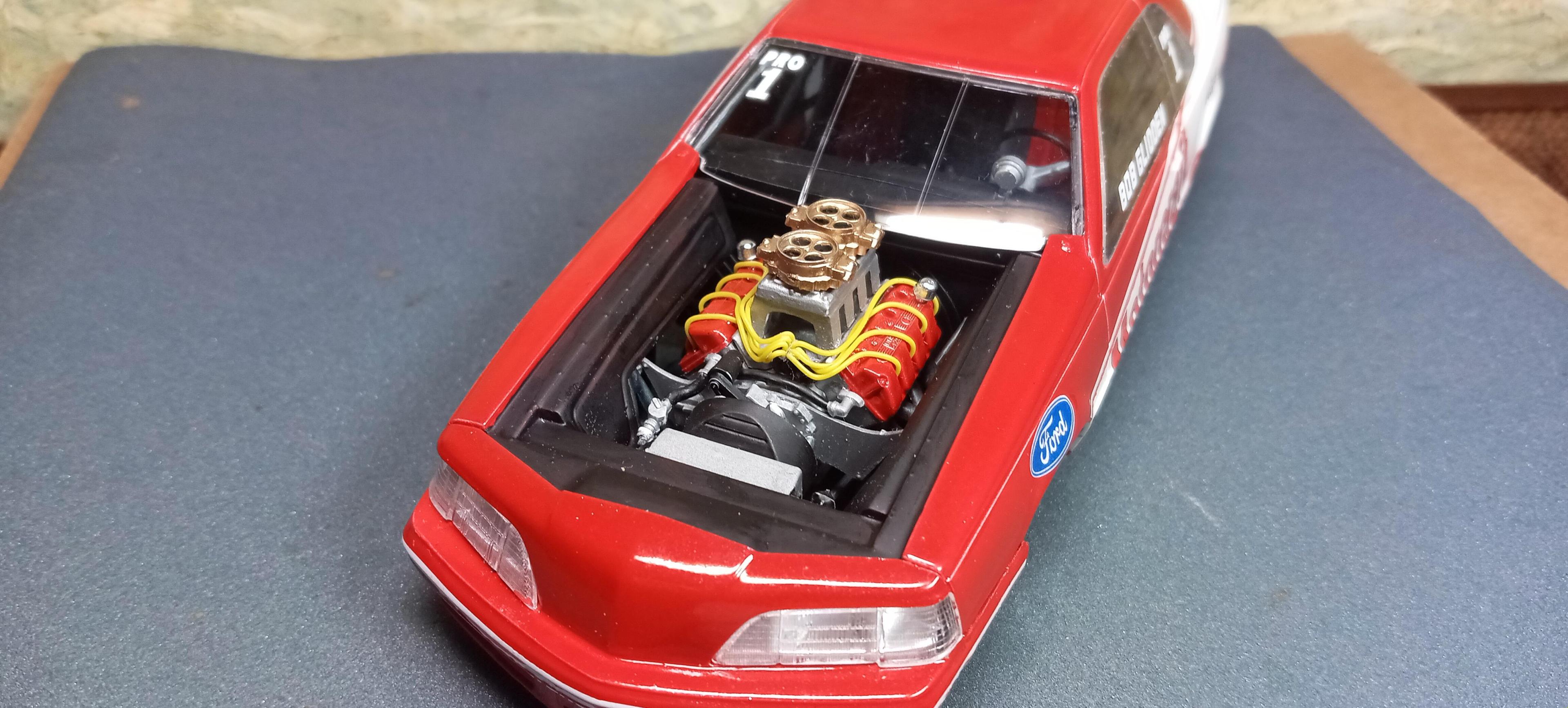

i found a coupe crappy WIP pics with some parts along with a funny car i was working on at the same time, doesnt show too much but you can see some of the mods between the more stock kit engine and my welded valve covers and seat mods.

My friend, this is one of the best Bob Glidden builds I have ever seen...Your detail is on point..Especially the spitting of the 1150 Dominators..Back then in Pro Stock, engine builders would cut them in half and place them closer to the runners to work like fuel injection with the intake runners. David Reher of Reher & Morrison Pro Stock fame  told me this.I work on my buddy Keith Raftery NHRA Top Sportsman 68 Nitrous & 2021 Procharger Camaro.. Reher & Morrison freshens our 784 & 862 Nitrous motors..Your paint is outstanding and overall model is phenomenal..Mad Dog was the man is Pro Stock, but I'm a WJ fan..You sir hit it out the park on this build..Job well done.

Beautiful build David, and very nicely detailed. Did you lower the ride height a bit? Looks perfect. I always loved these cars as pro stocks. Still have 2 of these in the stash. My favourite part of this kit is the Pro Star wheels, love em. I can’t understand why these wheels have not found their way into other kits…
