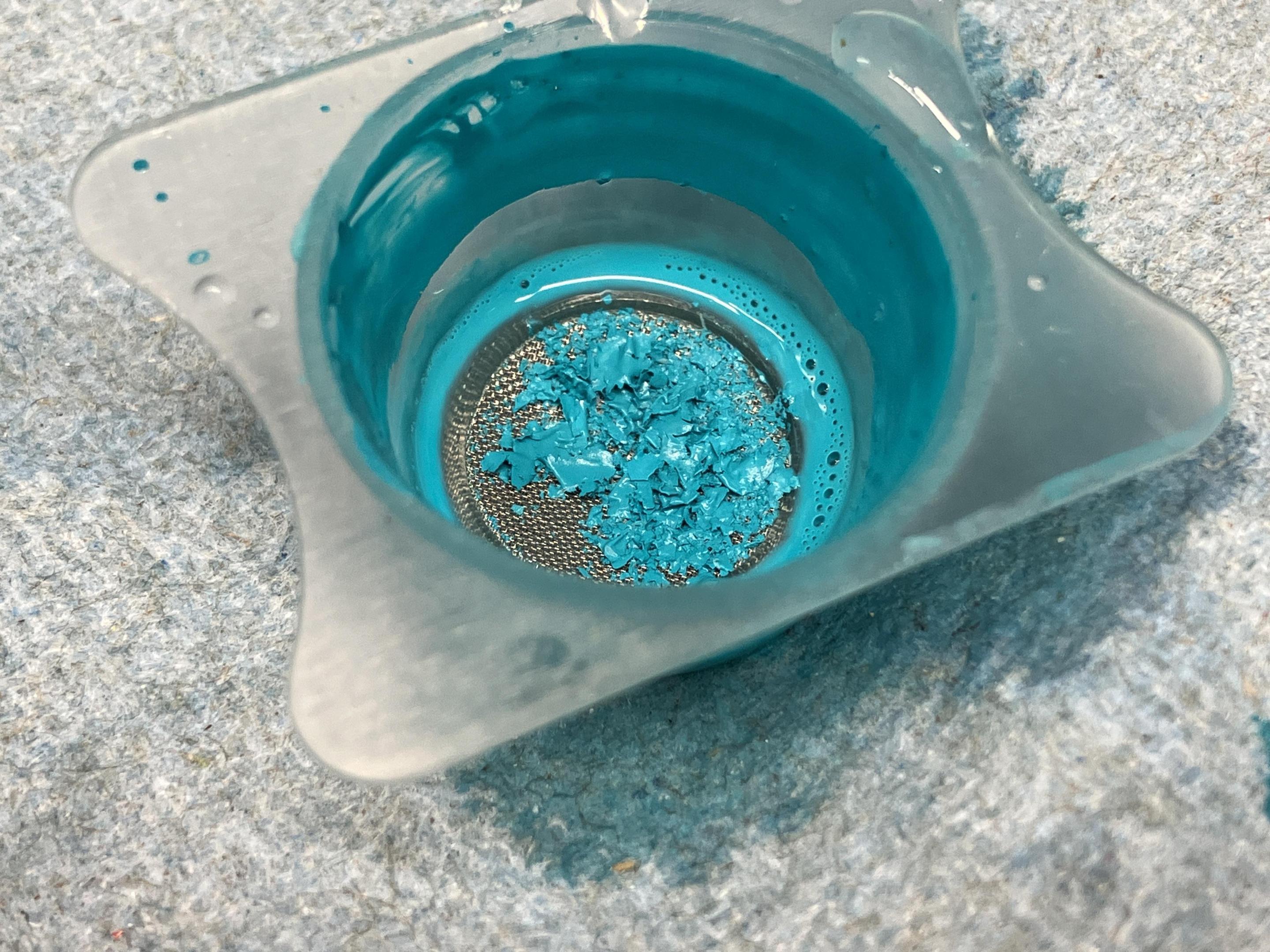

NOBLNG Posted February 5 Posted February 5 This is what I filtered out of a previously used bottle of paint. 1
