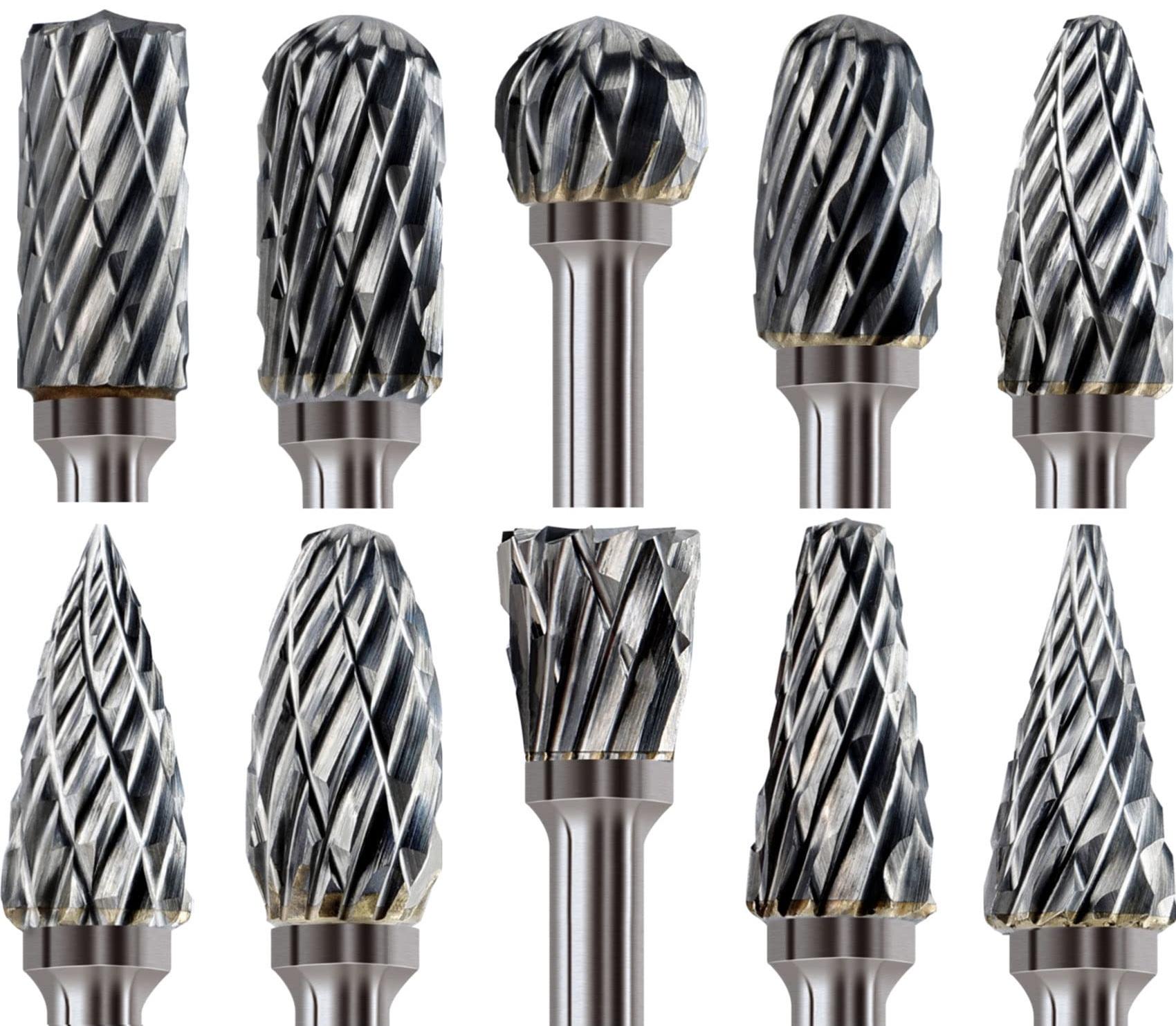

NOBLNG Posted March 11 Posted March 11 (edited) The razor saw I mostly use for making square cuts on Evergreen stock in a mitre box. It could be used for long straight cuts like a chop or section job, but I prefer to score the line with a panel scriber then finish the cut with a photo etch saw. The dremel hopefully has a low enough speed that it will not melt the plastic. The abrasive discs I believe will just clog up. For cutting you may need something like saw blades. I mostly use my rotary tool with sanding drums and burrs for shaping. You can always practice on a scrap body especially with the dremel. A slip up with it can quickly do a lot of damage…and not just to the plastic.😬 Edited March 11 by NOBLNG 1 1
Ace-Garageguy Posted March 11 Posted March 11 Keep the Dremel speeds down when cutting plastic, or it will melt and clog the cutters. Keeping a bar of something like Ivory soap on the bench and running your cutting bits in it occasionally may help the bits to not get clogged with melted plastic. 2 1

NOBLNG Posted March 11 Posted March 11 Also, since most rotary tools don’t have an awful lot of torque, multiple light passes are usually better than trying to take too much material out in one pass. 1
Bugatti Fan Posted March 11 Posted March 11 (edited) Even the lowest speeds of a Dremel might be a bit fierce for plastic. If the Dremel could be plugged into a speed reduction device it might be able to reduce the revs right down to a suitable speed. I think for accurate cutting the various fine hand saws would give much better control than using a Dremel or similar that might prove a bit cumbersome for this type of work. Don't get me wrong. The Dremel is a superb tool as I have one with some of their sccessories. But it's horses for courses and in this instance I would be going down the razor saw route. The Dremel would come into its own if building a rusted out vehicle using burrs from the inside to create where the dust is breaking through. Edited March 11 by Bugatti Fan 1

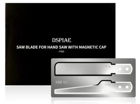

NOBLNG Posted March 12 Posted March 12 (edited) I really like these sawblades. They make a nice aluminum handle for them, but I just trimmed the shank a touch so they would fit a regular exacto handle. They are like a photo etch blade but far more sturdy. Edited March 12 by NOBLNG 1
peteski Posted March 12 Posted March 12 44 minutes ago, NOBLNG said: I really like these sawblades. They make a nice aluminum handle for them, but I just trimmed the shank a touch so they would fit a regular exacto handle. They are like a photo etch blade but far more sturdy. These are likely also photoetched but just from a thicker metal. 1

Bugatti Fan Posted March 12 Posted March 12 (edited) There are special mitre cutting boxes available that are designed for tools with extra fine thin blades. Dspiae might be a source for such a tool set. Edited March 12 by Bugatti Fan
