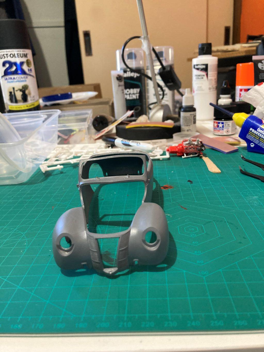

Here is the '40 I'm working on first coat of primer. This is my first attempt in a VERY VERY long time, so please be kind but constructive, I'm a big boy, I can stand criticism, as long as it's constructive. To me I think this needs sanding, but I'm no expert. Thanks
Don
Don
It looks like you need more primer around the headlights, the mold lines are starting to show and they will only get more noticable as paint and clear goes on. I like to use a guide coat on primer, it can be any paint as you'll be sanding it off anyway. I use my near finished rattle tins for guide coatsand after i think its smoooth enough it gets one last coat. if your doing multiple layers it can sometimes help to start with 600 grit and work up to 1000 or so on each primer layer
Thanks Les. Apart from the things you have pointed out, I think the primer is too rough anyway. Time to get to work.

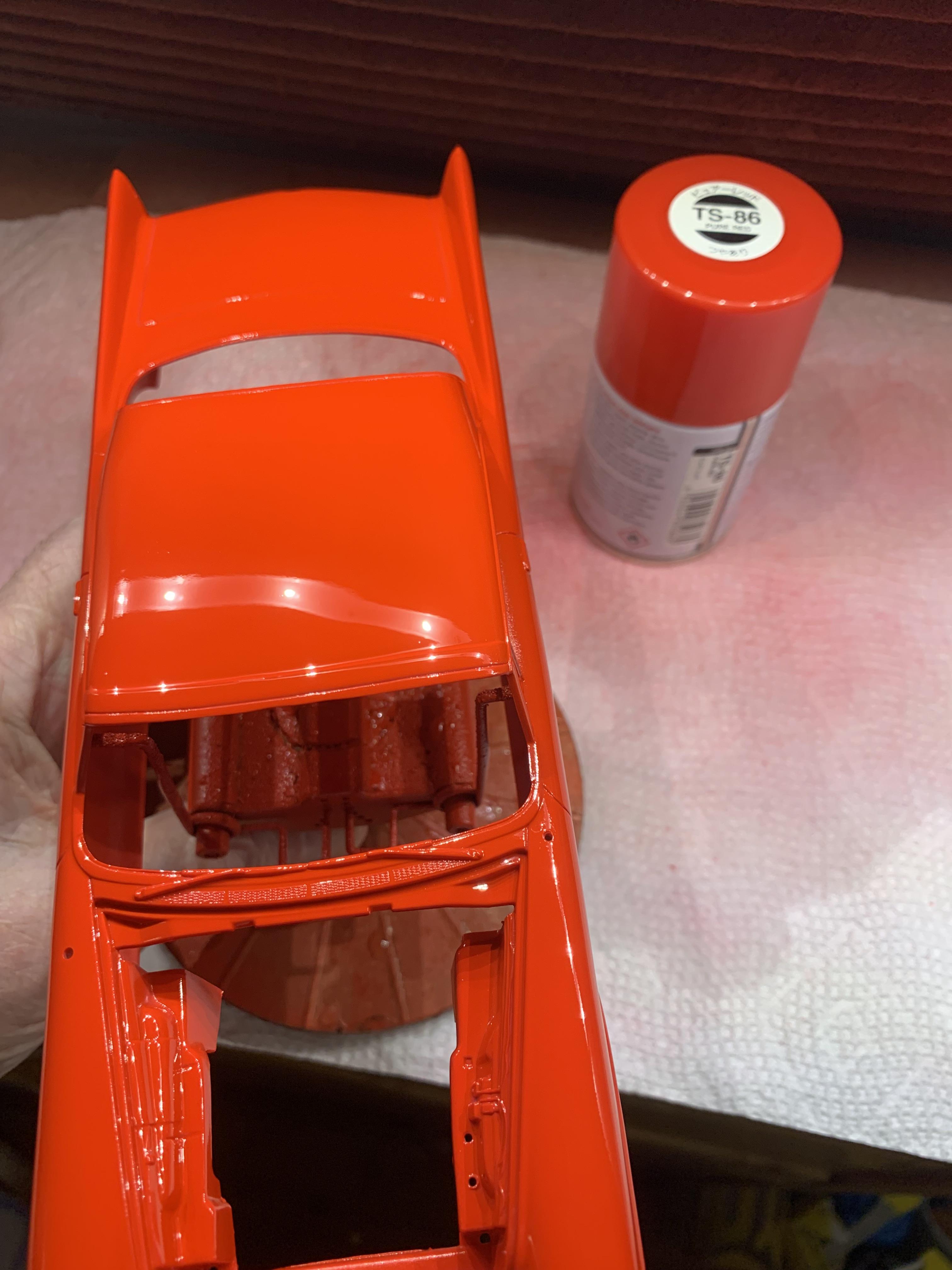

First of all, you will NEVER go wrong with Ace’s advice on anything covered on this forum.  Me, I am lazy, and a super shiny paint job with hours of time priming, sanding, painting, incremental sanding again, polishing, etc., is not what drives me in modeling.  I am, however, allergic to inauthenticity in the mechanical parts of modeling (engines, trans chassis, etc.).  My paint jobs generally consist of no primer and TS series Tamiya paint (spray cans).  It just takes cleanliness and a little practice.
  • Like 4

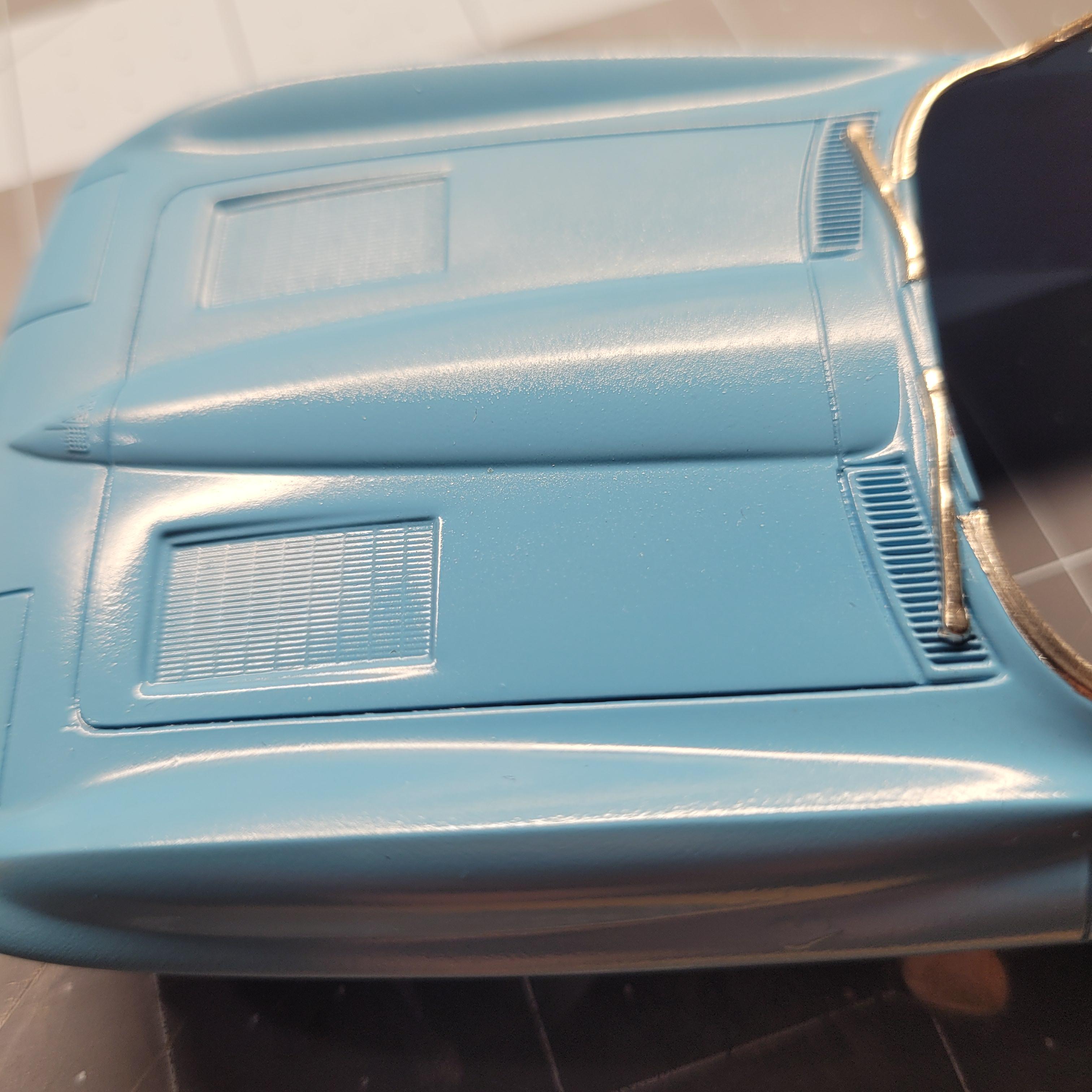

Don, here's a perfect example of a rookie paint issue. This is testors enamel thinned with lacquer thinner. First time using that technique. The primer was smooth, but the thinner a bit too aggressive and I got a bit of crazing. Most of this body has smooth, glossy paint, half of the hood looks dry and a little textured. I'll probably end up clear coating it. I've got no issue with showing my goof ups.
  • Like 2

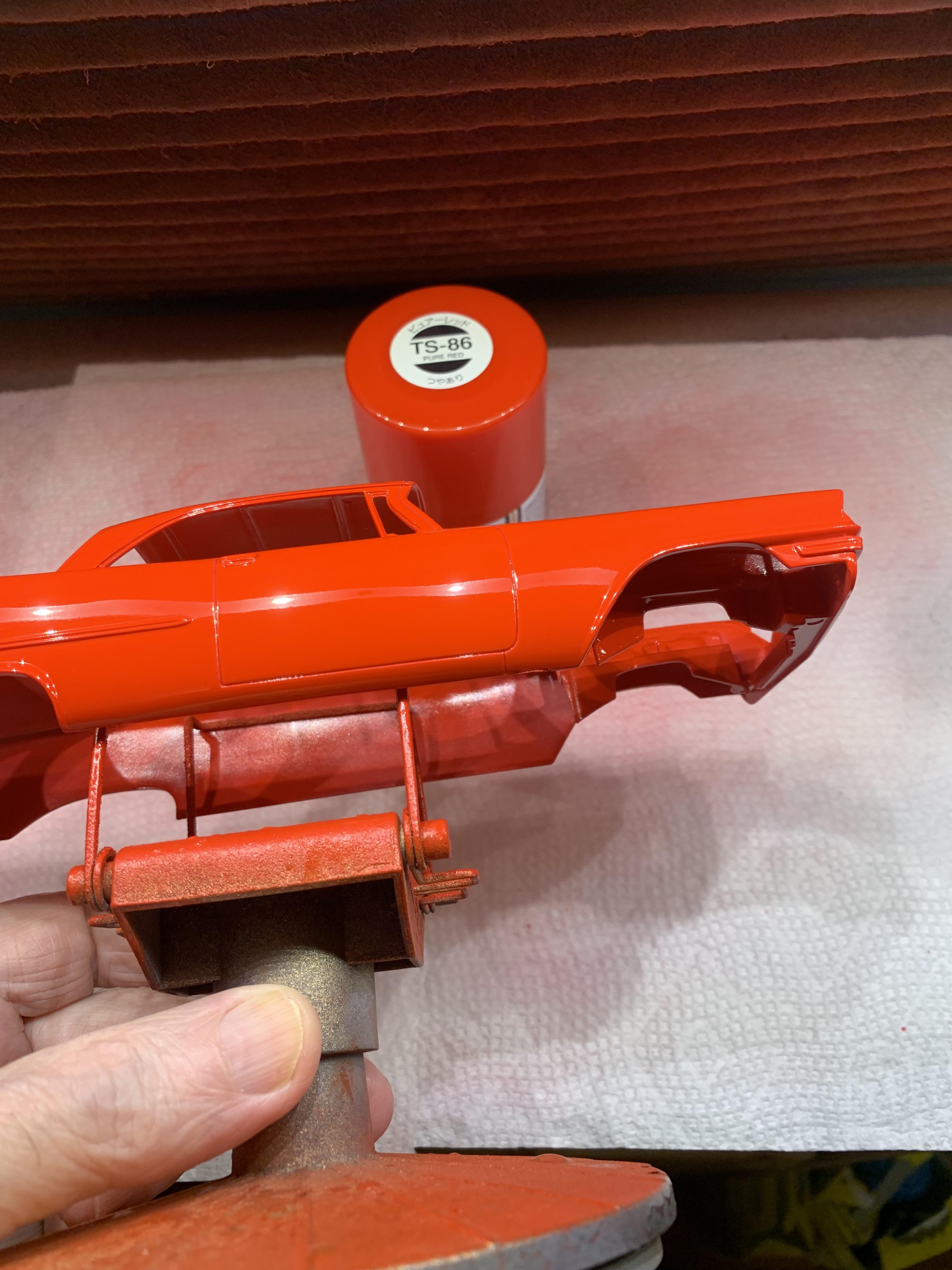

This forum and YT are a great source of information no doubt. There are also many gifted model builders out there who have never watched a video or visited a forum. They learn by….experience.
  • Like 4

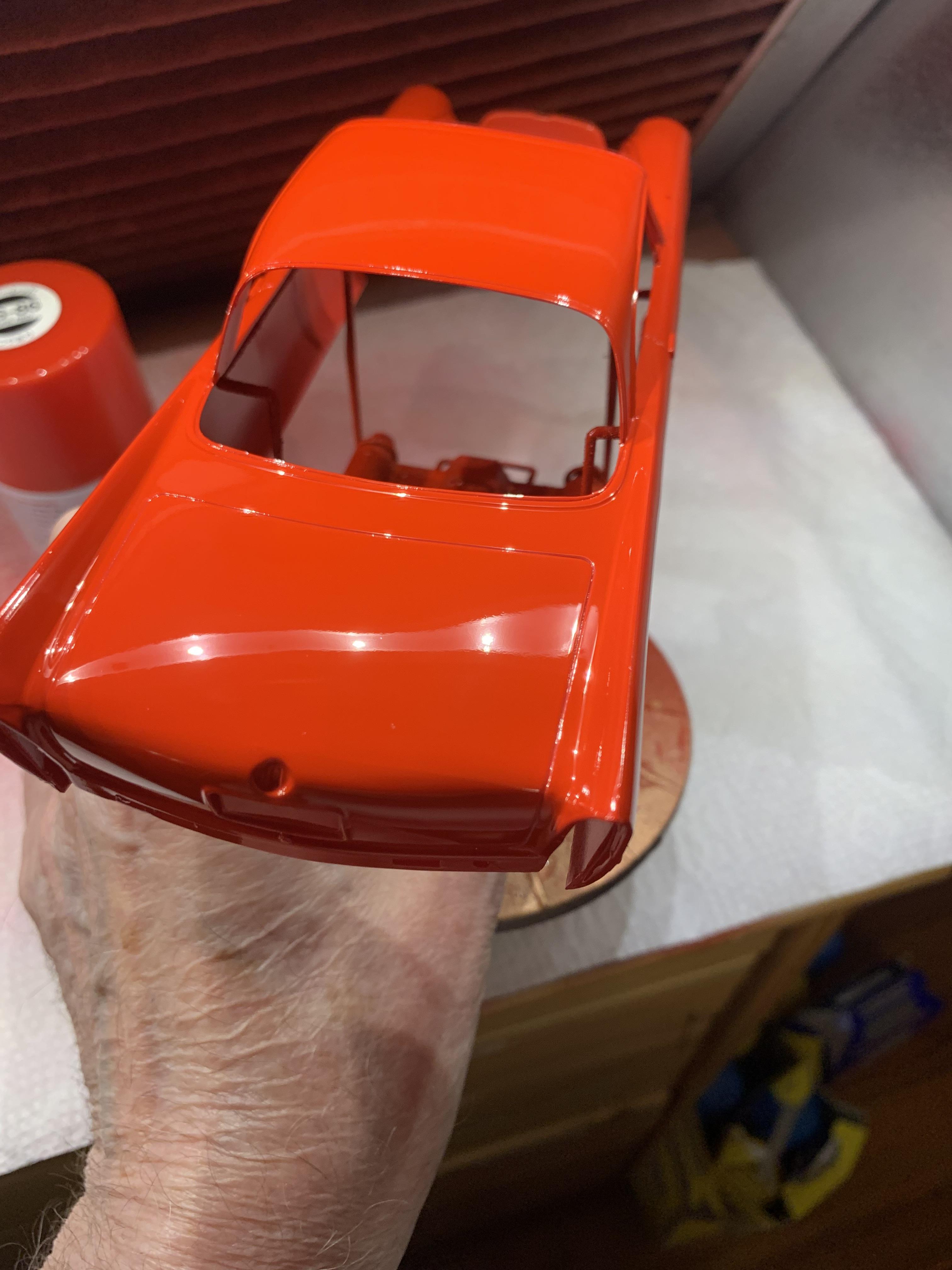

That Chrysler looks great, but I am gun shy about using Tamiya without primer. I have not found anything that will strip Tamiya if the paintjob goes south and there is no primer underneath to soften.
